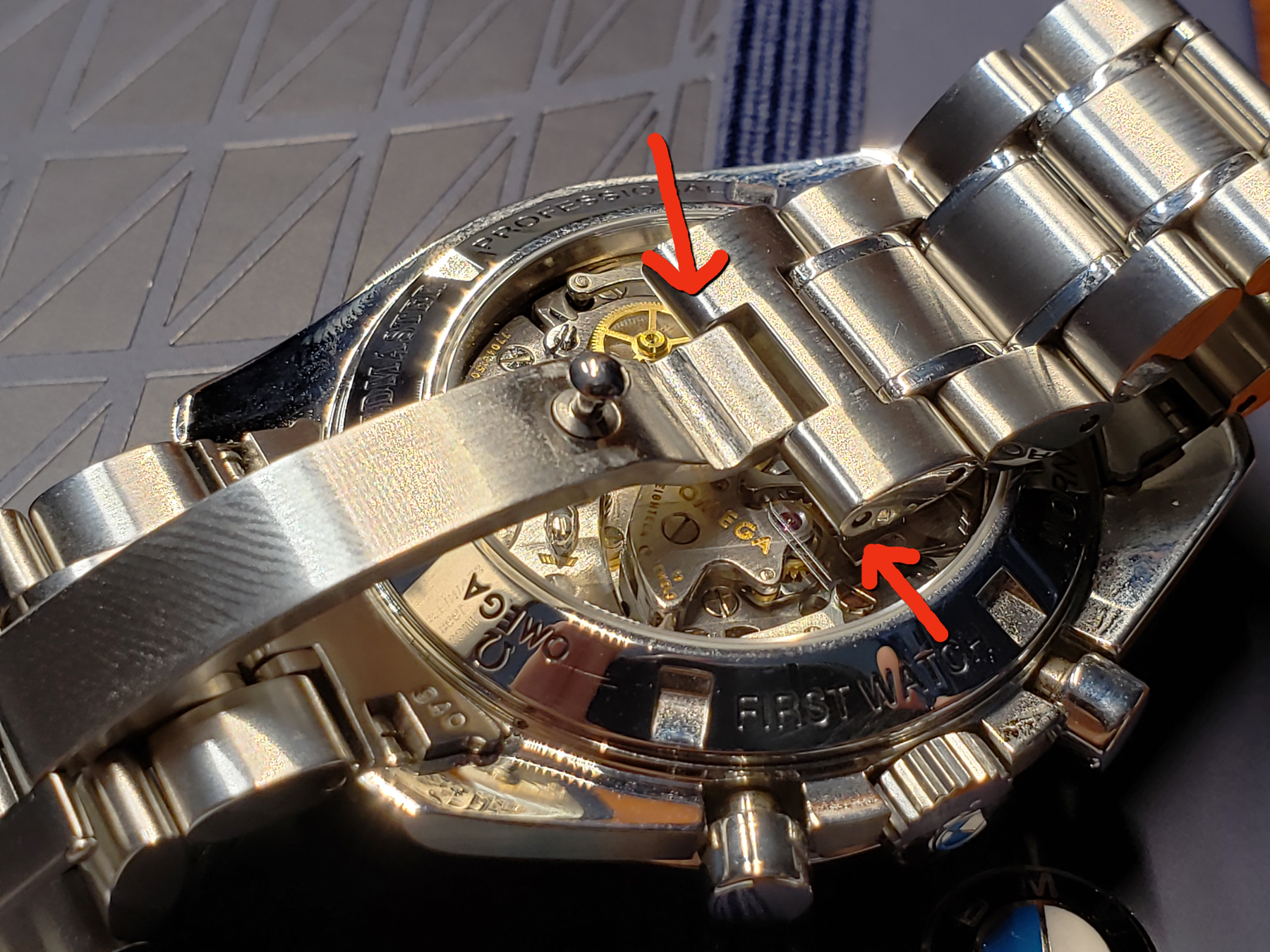

Does anybody know the part number for the bracelet tube that connects the clasp to the attaching link of the 1998 bracelet? See pic. Both the tube and pin are different from the ones used on the links. The pin is starting to slip out on its own and I've tried squeezing the tube with a pair of pliers, but after about 2 days of use, the pin starts slipping out again. Pin visually shows no wear so I'm confident the tube itself is what needs replacement.

Two possibilities for the tubes and pins, and I'm guessing there may have been variations in the bracelet over time, which is not unheard of.
The tubes is either a 201ST0210 or 201ST0515.
The pin is either a 128ST2002 or a 128ST2003.
You should always change them as a set, so the pins and tubes together.
