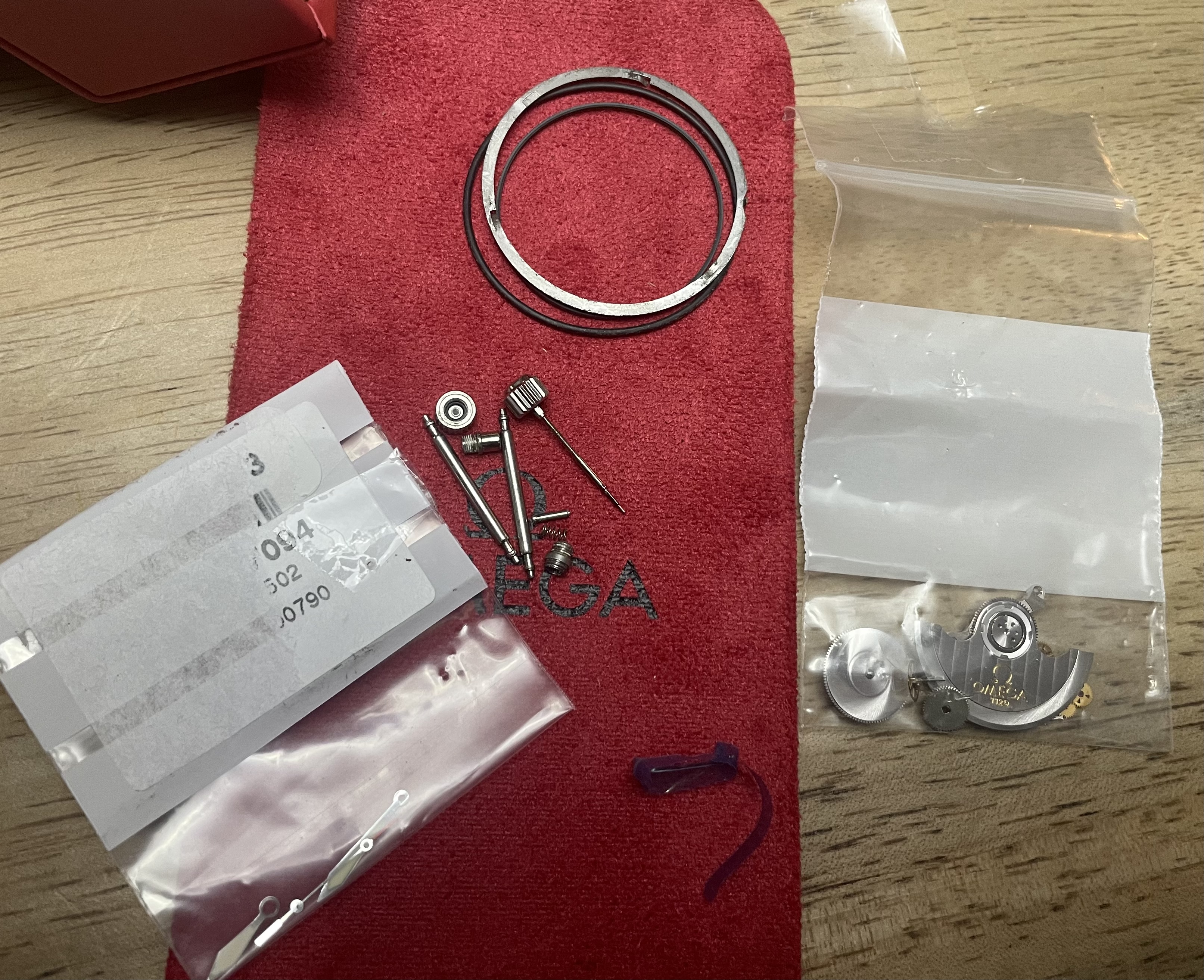

Got my watch back from service today! I was very surprised with all the parts they replaced!
That is all pretty standard for the service center. There are typically a lot of parts wasted when servicing at Omega. There's likely nothing wrong with the hands, but they get replaced as standard practice at each service.
The HEV can just have the two seals replaced inside, but they replace the entire unit - not really needed. The kicker is the vale they replaced it with can;t be repaired like the original one could, so now there's no choice but to replace the entire unit at every service, when all it needs is those two small Orings replaced. I always do whatever I can to preserve the type than van be serviced, as a new valve is over $80, where the two seals are $19.
The mainspring barrel they replace the entire unit instead of just replacing the spring - the spring is often the only thing that needs replacing, so they throw away a perfectly good barrel drum, barrel cover, and barrel arbor. They don't even disassemble it to check the condition, because that takes time.
The rotor is another example - the bearing can be replaced, but there's likely some wear on the top of the rotor that is purely cosmetic, that prompted it to be replaced.
So this comment is absolutely true:
I think the omega service centers usually rather replace as much as possible to get the watch back to as-close-to-new-condition as possible.
An independent may replace less parts.
Independent watchmakers tend to replace what's needed only, and not a lot of additional parts that are just fine.

Can't blame them though.
If I am running the Omega service department, I would replace as much as possible to reduce the risk of any bounce backs during the repair warranty period.
A bounce back repair would cost them way more than a handful of extra parts.
Labour is the most expensive thing in the business world nowadays.
They don't do it because it's necessary to prevent a watch coming back, they do it to save time in the initial service.
151
131
That makes sense.
In a way, that is also for saving labour/money.
Faster to make the watchmaker yanking the whole part out and replacing it, than trying to take time to figure out which bit of the part is broken.
A part costs Omega like a few dollars? A watchmaker's labour probably costs them like $30 bucks an hour?

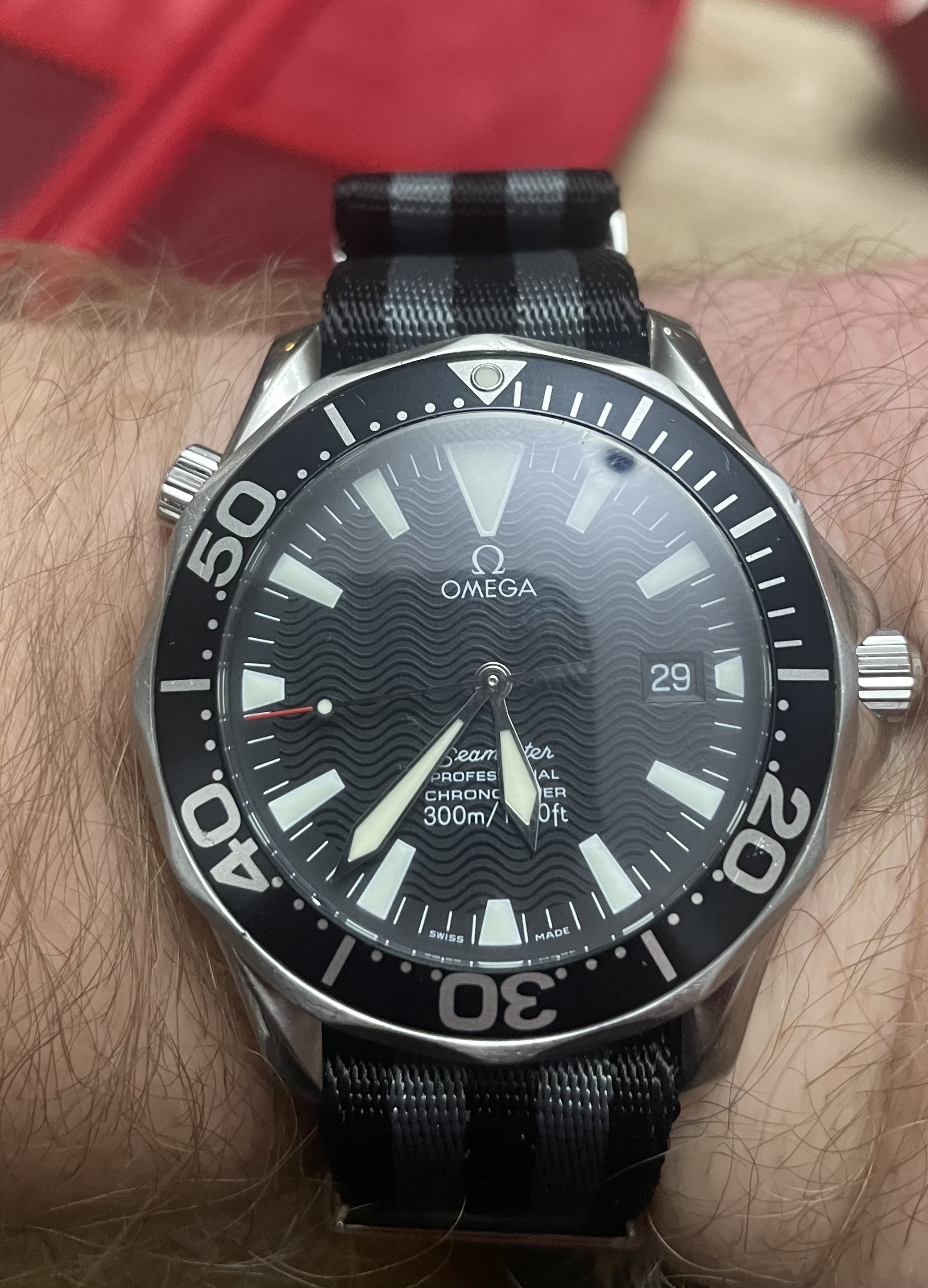

Hey, this may be a dumb question but can automatic watches fluctuate there time? As in +/- time. I just got mine back from service Tuesday and until earlier today it was running +1 a day. I looked at it a few minutes ago and it was running -1. Is that normal?
There are many factors involved so there may be no one correct answer.
But simplistically, a mechanical watch is powered by a spring. The rate of force exerted by the spring varies from fully wound to run flat.
Your watch will also have variations in timekeeping depending on its position at rest, when being worn and regularity of winding (either manually or automatically).
So, slight variations are normal in most cases.
It normal that mechanical watches vary, as other have stated. Depending on how you place the watch while not wearing it this will also have an influence.
I’ve noted that my 2252.52 (36mm version of your watch) Runs well when placed on the side with the helium valve downwards.

Interesting. I lay my watch down flat at night when I sleep. I’ve thought about getting a winder but I don’t really know if that is a help or a hindrance. I’ve not done much research into the topic. When I got my watch back from service I looked at the service card and it said +1 and that’s what it was running. It was at +2 or 3 before the service and that doesn’t bother me. It seems to be running fine and I’m excited to have it. I still can’t believe that I do have it. It’s been THE watch for me for so many years and I have it. It’s funny I like to watch reviews of other watch’s and I look at my wrist and think “it’s not this watch”. I’ve never been much for Rolex, the explorer would be the only one I would buy given the chance. The sub is so typical and I know many people with one and it doesn’t wow me. I’m not sure if I’m the only one that feels that way. But to me there has always been something more special in a seamaster. And I’m not sure what it is. I’m usually a big fan of the coin edge bezel but the scalloped bezel on a seamaster is different. Takes a little getting used to. But I wouldn’t have it any other way.

So I’ve had my watch back for a few weeks now, on my service card it says it’s running +1 sec a day. But I’ve been seeing -1 sec a day depending on how I lay it down at night. If I lay it crown up I get -1 if I lay it face up -1, if I lay it crown down it loses 3 seconds. I haven’t tried face down. Is this something I should be concerned about? I understand it’s just a watch but when you pay a lot for a watch then a service you would expect better.
Your watch is running quite well based on the description you have given. It will run differently depending on the position it's in (physics) so some will run fast, and some will run slow. All mechanical watches will do this to some degree.
You can try various positions to find one that doesn't cause this loss.

Thanks. I’ve also thought about it’s age. Not sure if that’s a factor considering how much they replaced in the movement. I keep trying different positions. I’ve thought about a watch wonder but I’m not sure if that’s the best thing for a watch.
