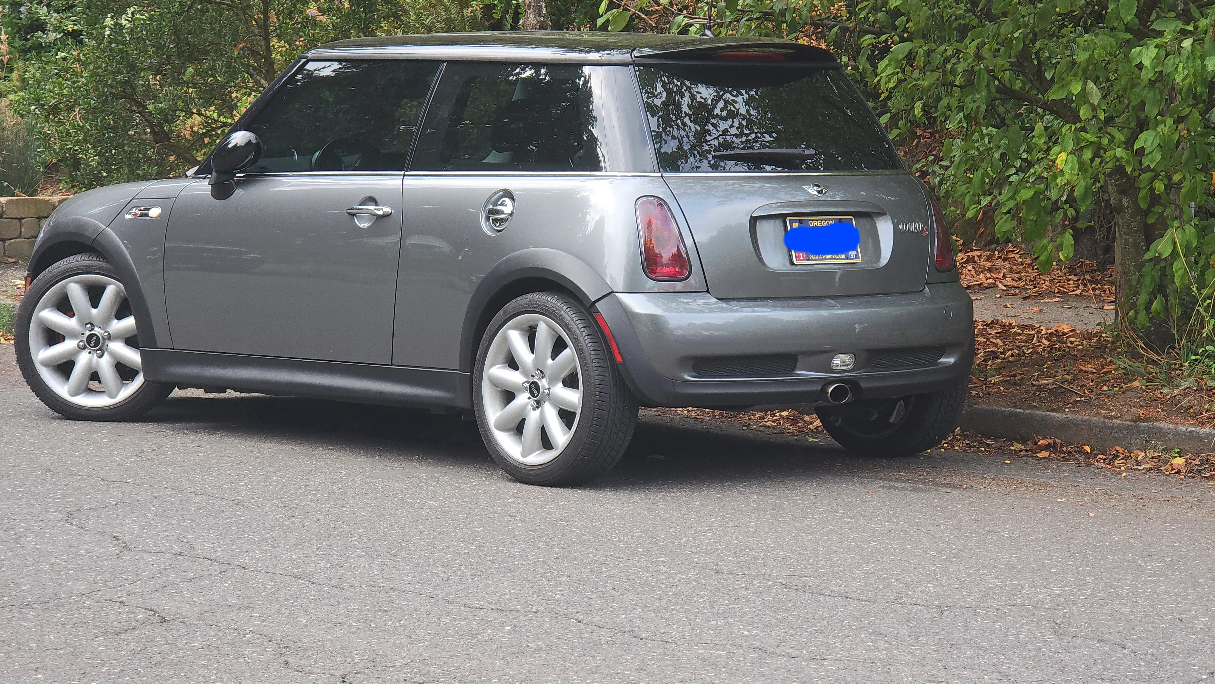

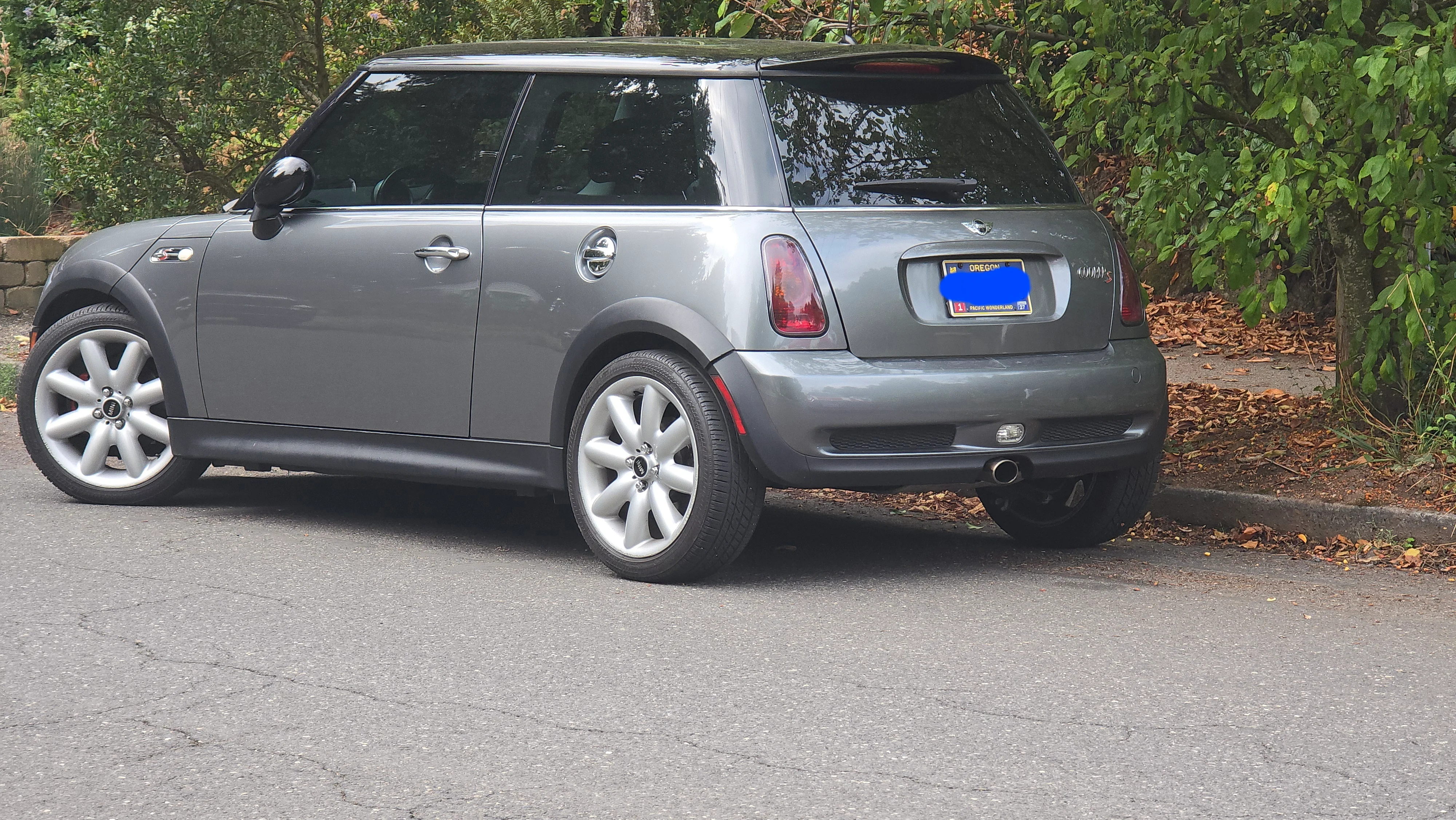

I've got Bridgestone run flats on my 2004 mini S.
I was going to replace them with PS 4S because the ride felt hard, but the run flats were almost new so I am living with them. The ride does seem hard but the car has zero lean in corners so I've gotten used to them. I haven't driven this car with air tires so can't say how much is related to the tires. Many mini owners say they are harder and noisier and many have switched.
As far as not having a spare, I figured it didn't matter. I've had 2 flats in my almost 7 decades. It just doesn't happen that often, and if it did, call a tow truck. If you're not driving in the Yukon on the way to Alaska, you can get by without a spare. The cars that come with run flats aren't off road bajas anyway. Get the best tires for your preferred ride.
