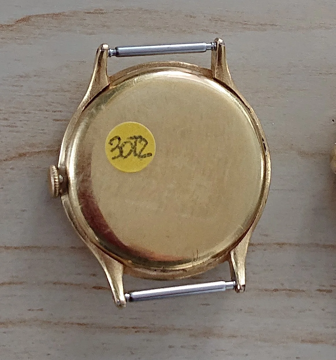

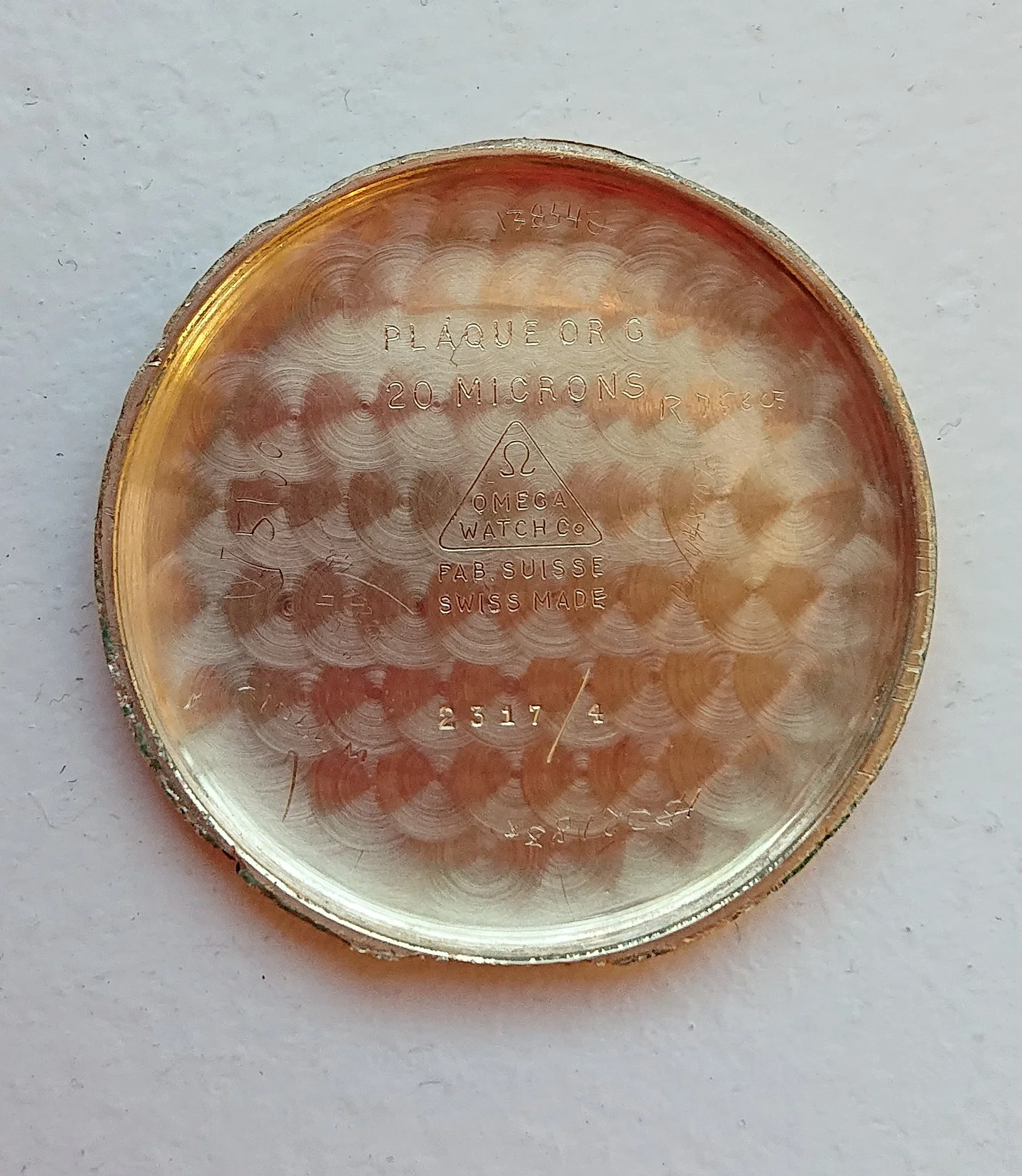

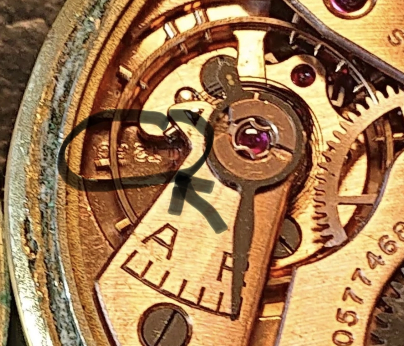

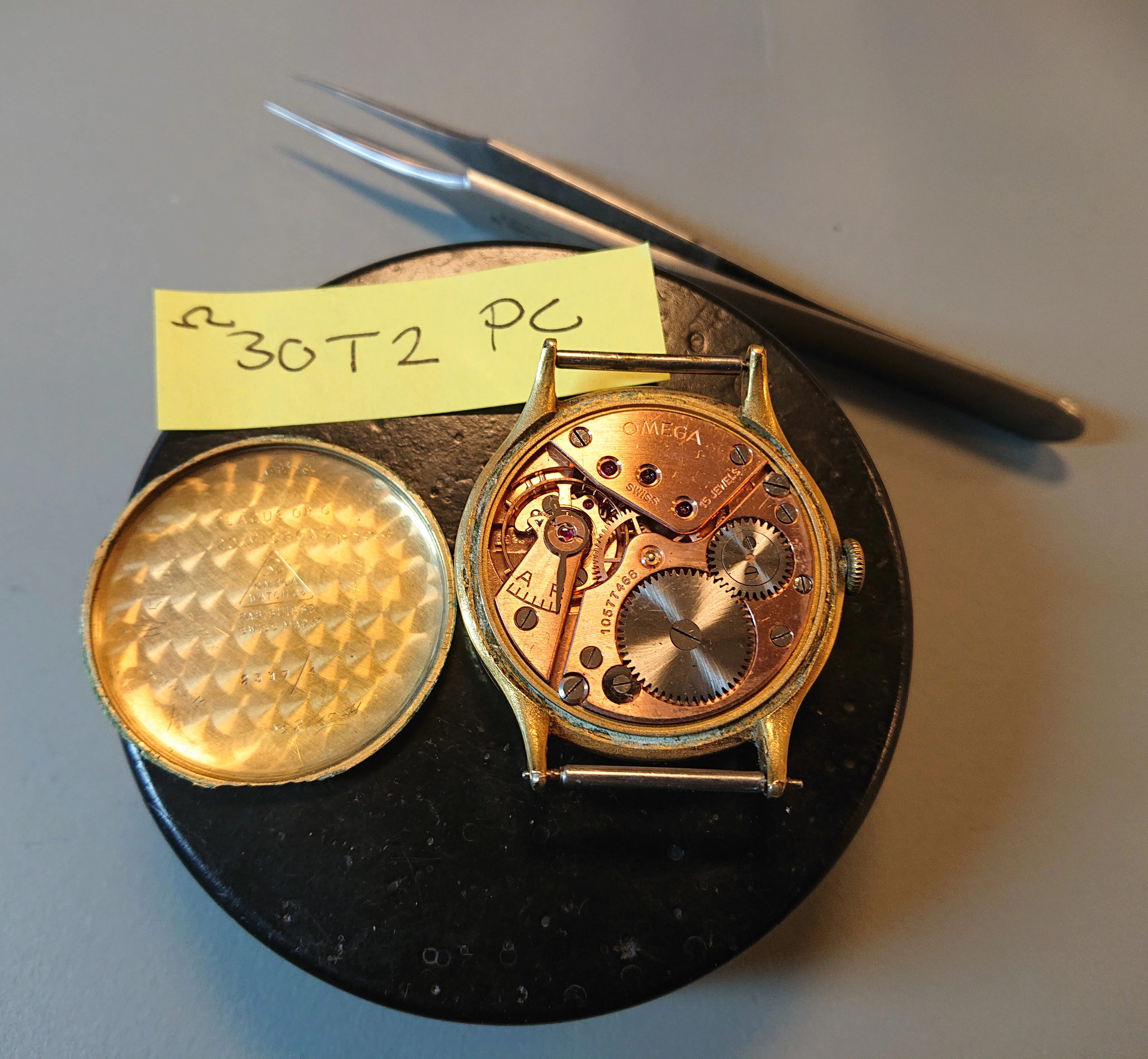

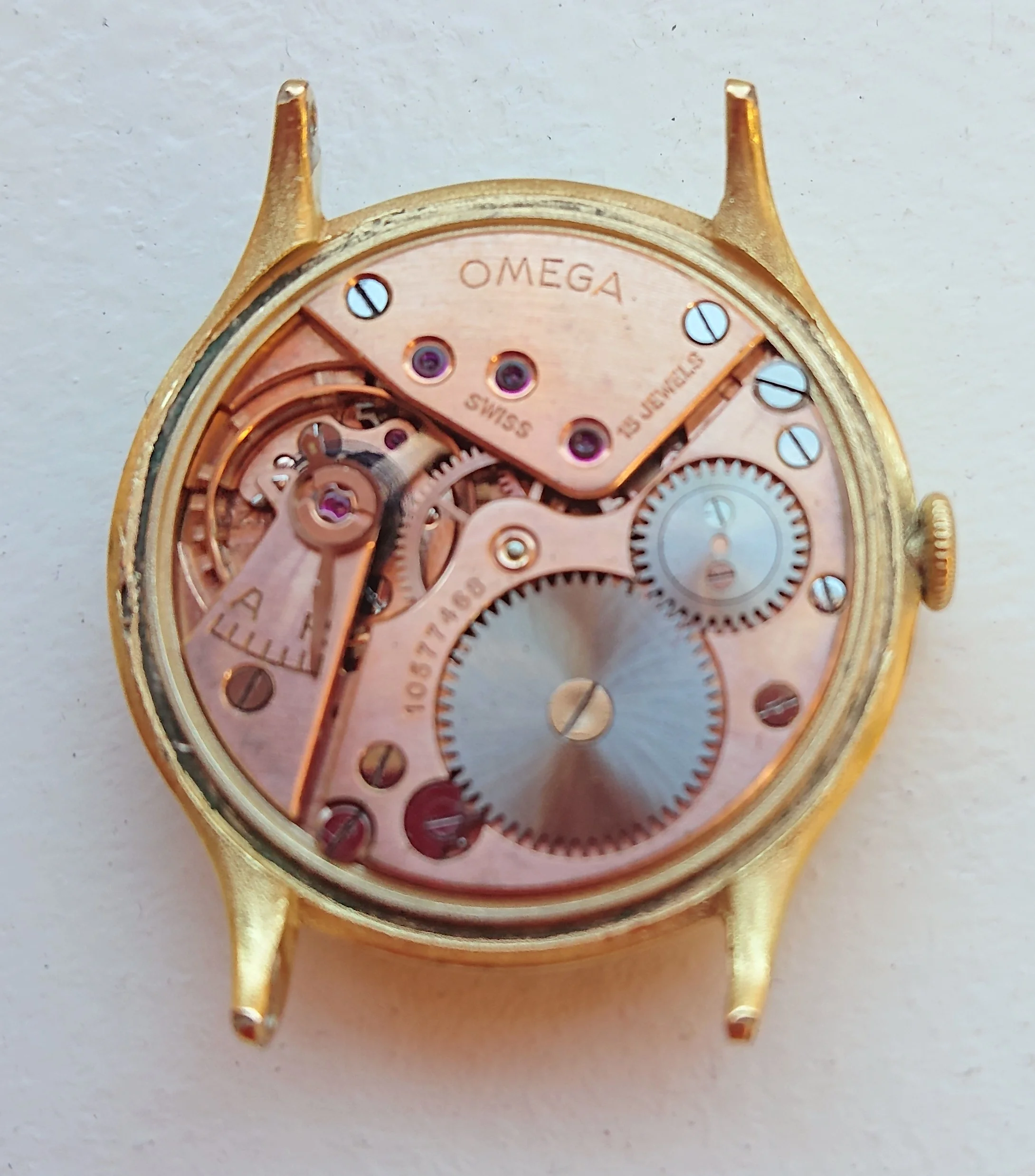

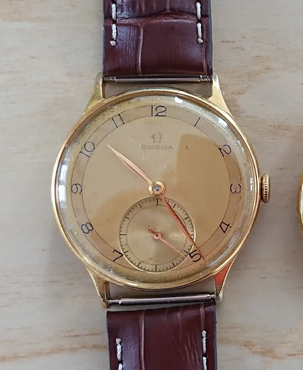

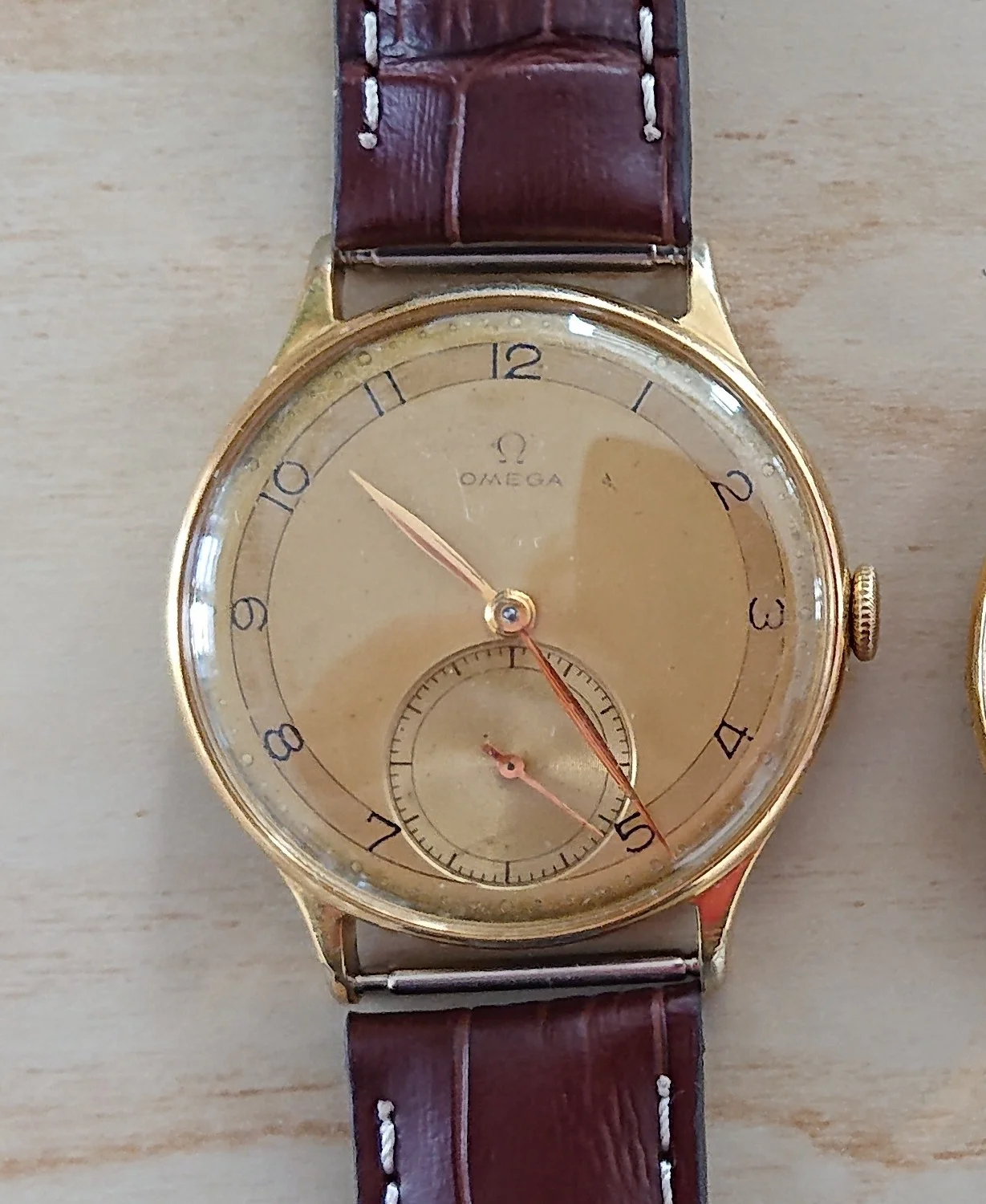

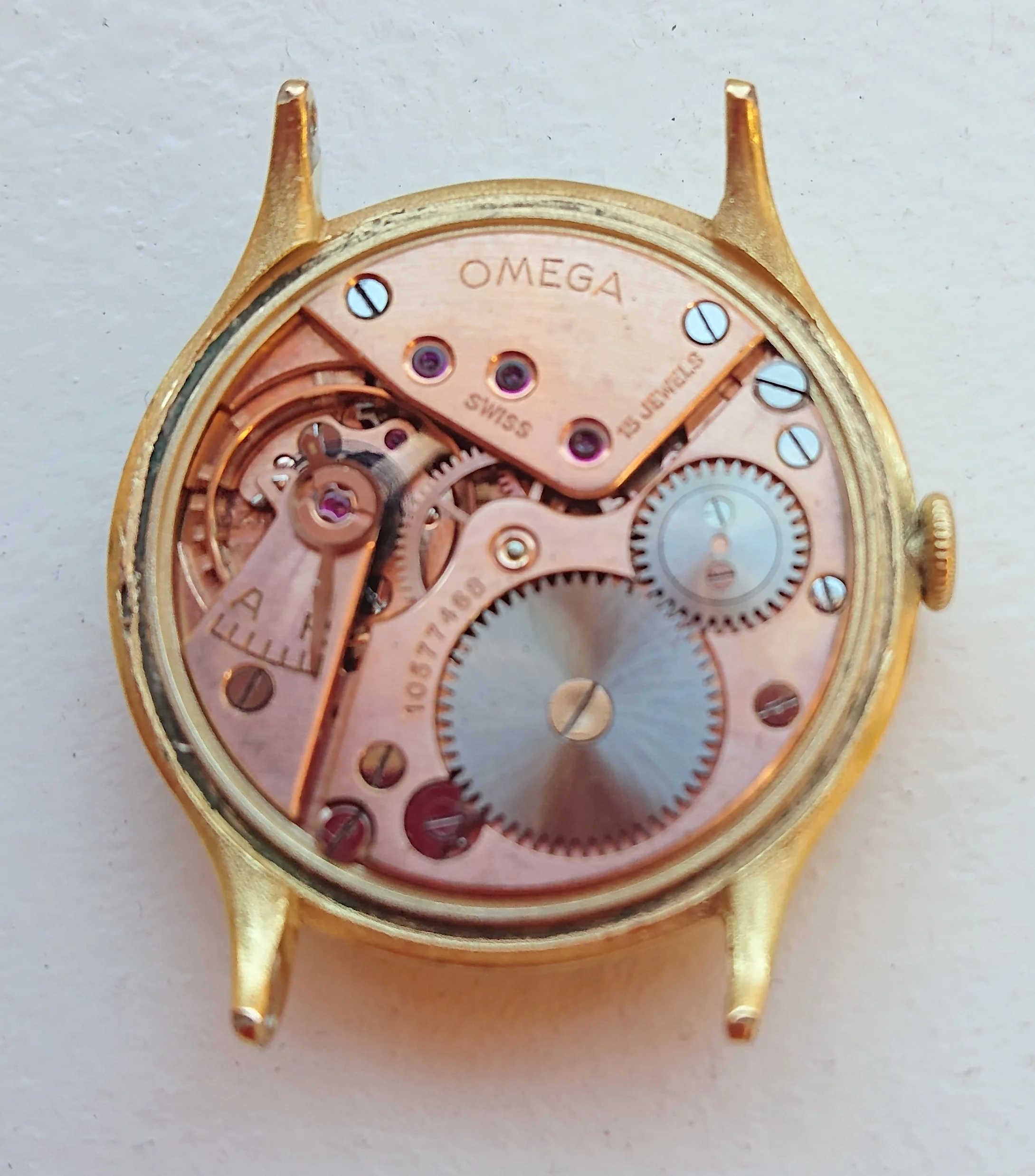

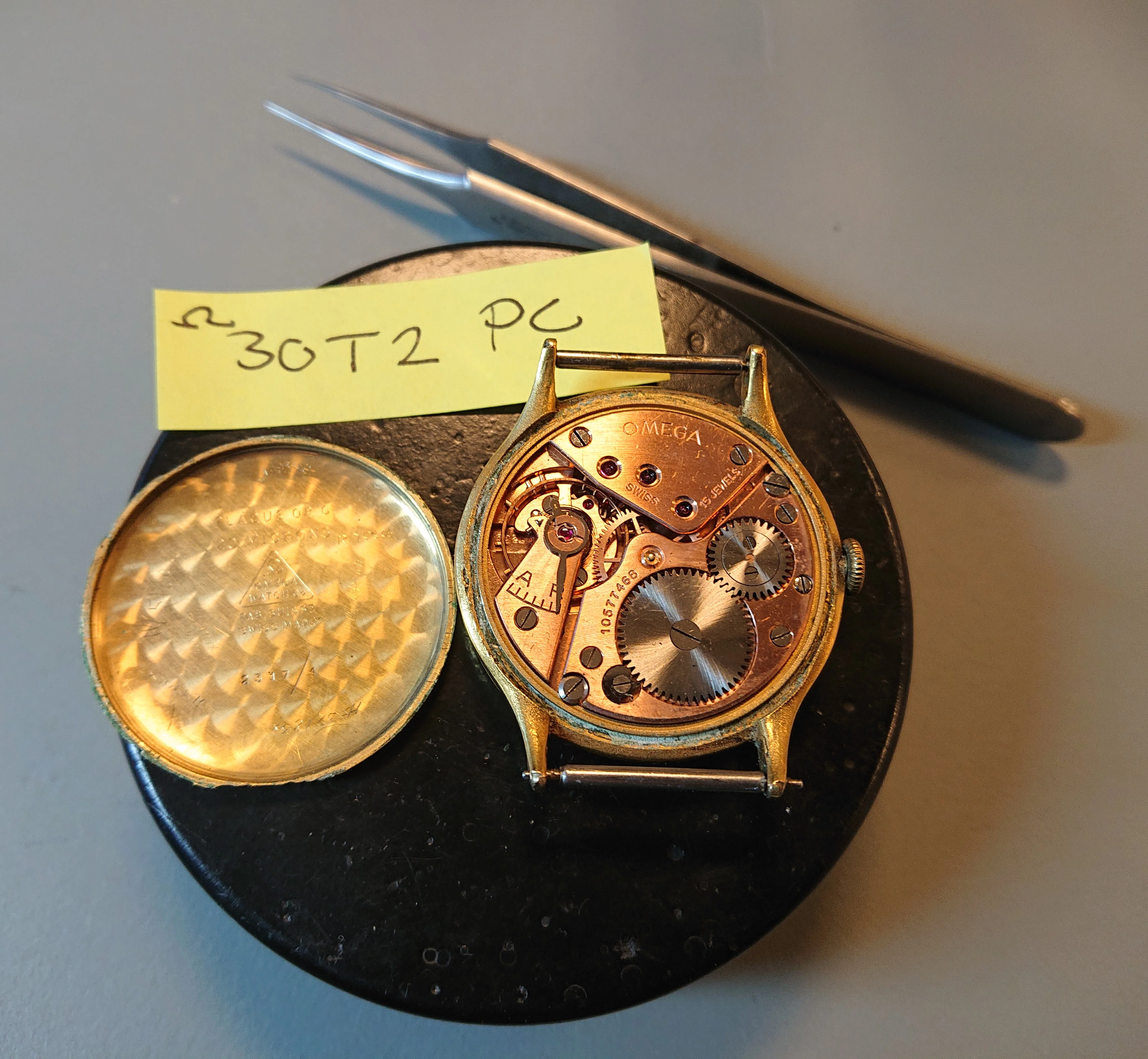

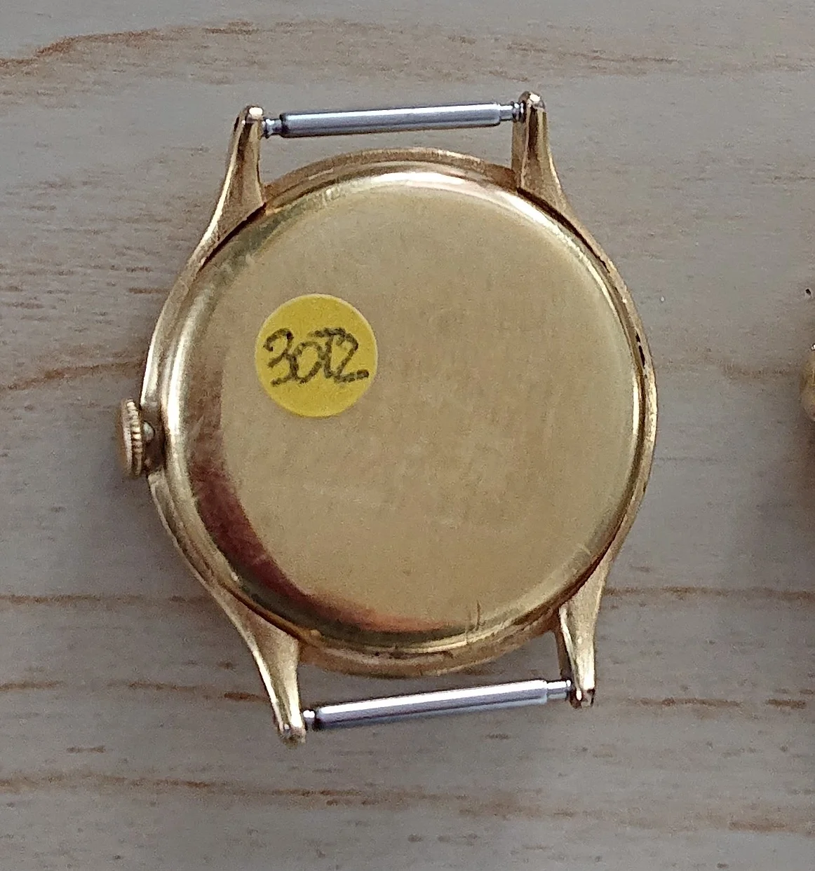

From my late watchmaker father Kurt Tranberg I have this very fine 30T2 from 1944. Working perfectly well and fully serviced by professionel Oct 2025. Please help me verifying if it is a 30T2 PC - as some have told me - and what is the difference between the PC-model and the "regular" 30T2 ? Finally, what should I expect / demand as selling price ex shipment ?
PC stands for shock protector which the plain 30 T2 does not have

If you demanded $100USD for that watch from me , I would hand over the money. Demand $10,000 and I am out.
Others may differ.
24,815
55,159

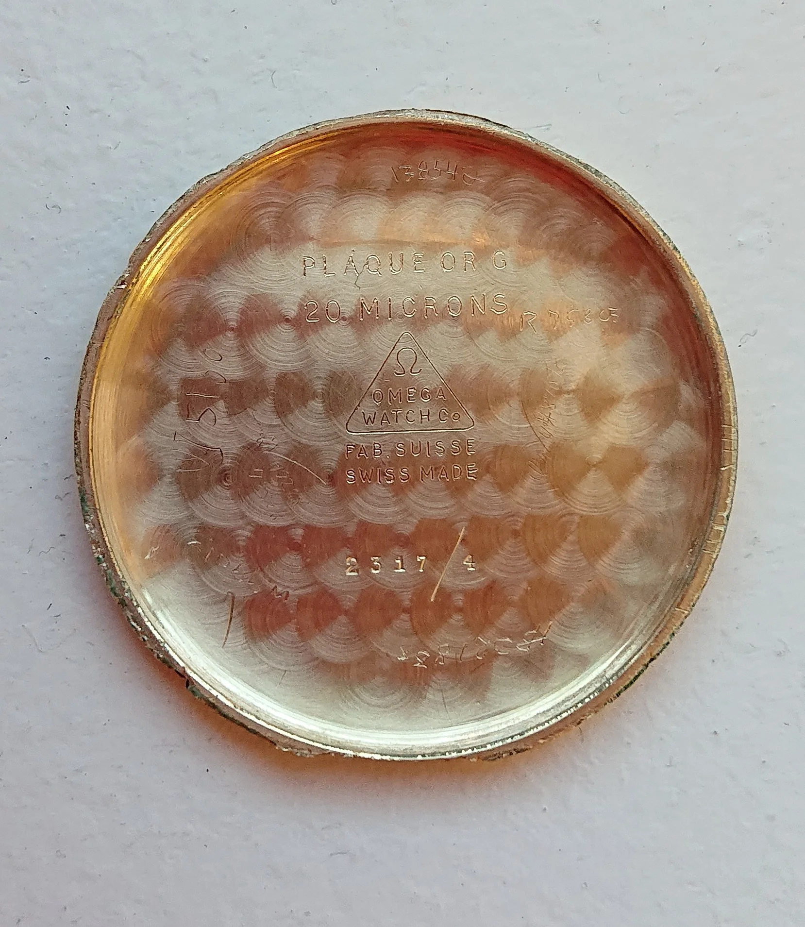

Honestly , the value is mostly sentimental because the gold plated case is in poor condition, with brassing at the lugs.

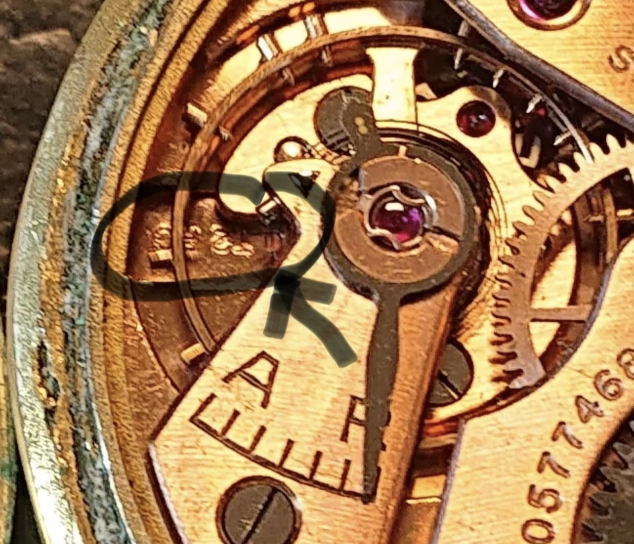

For the correct denomination, have a good look below the balance wheel.
