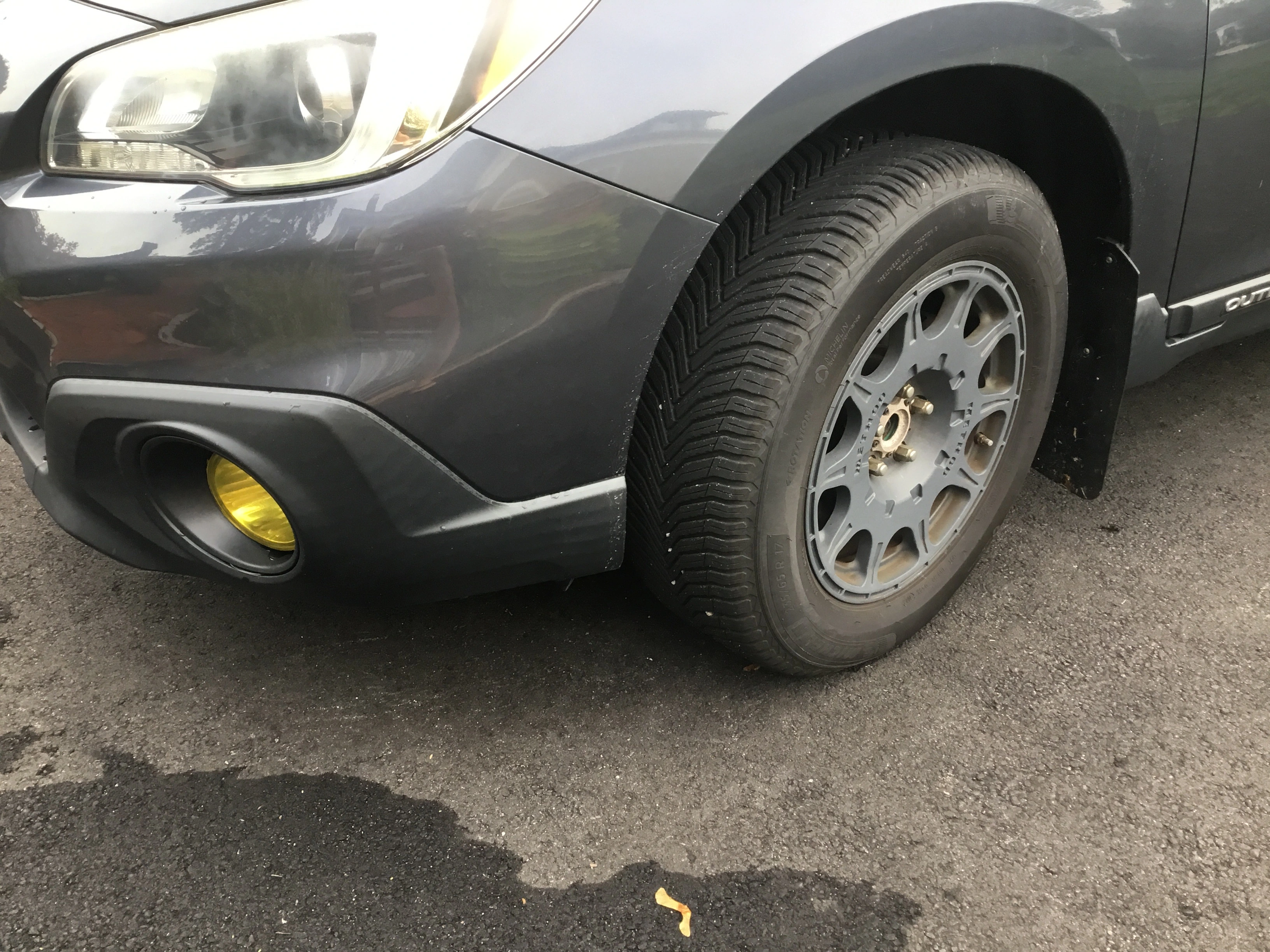

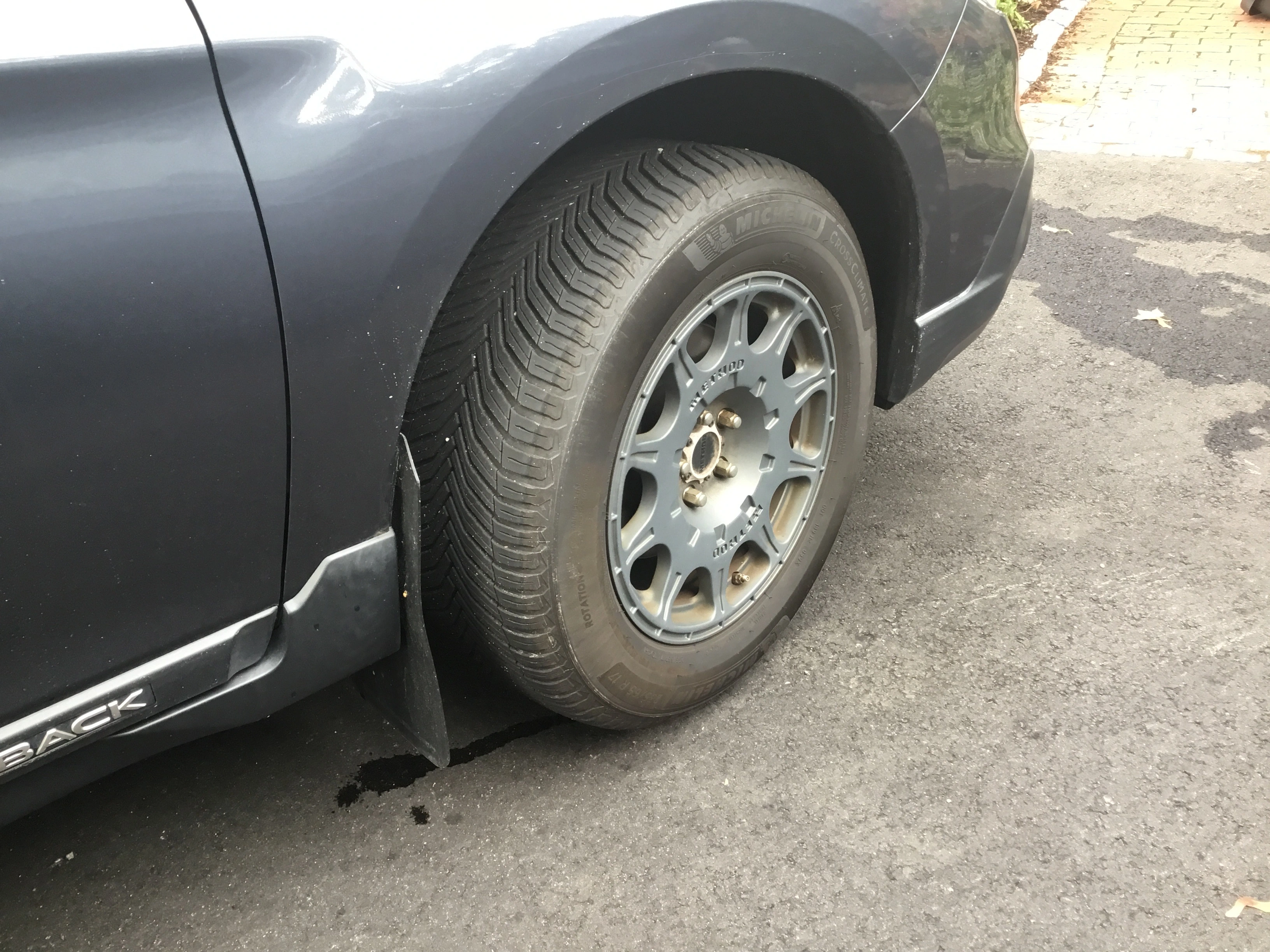

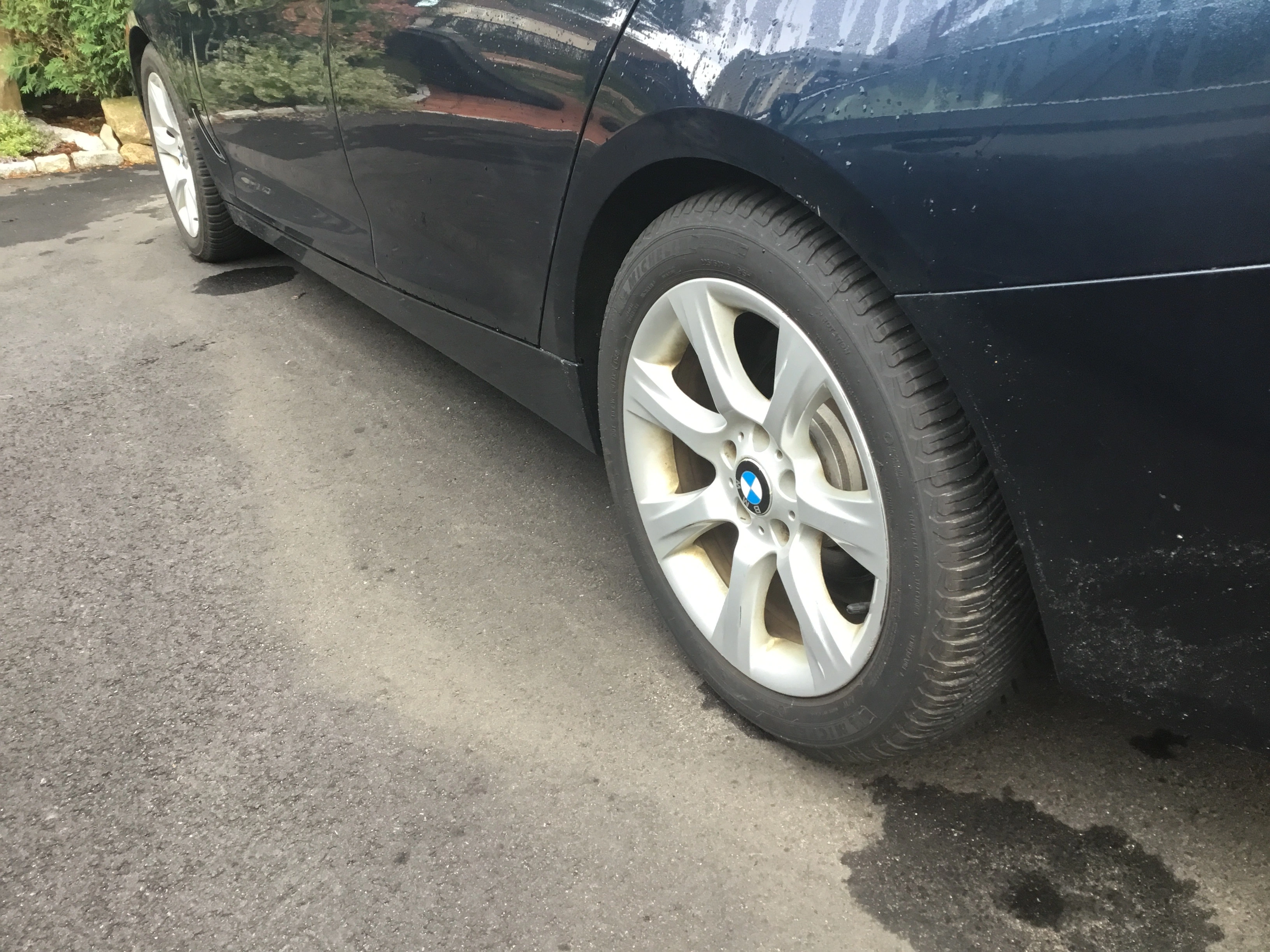

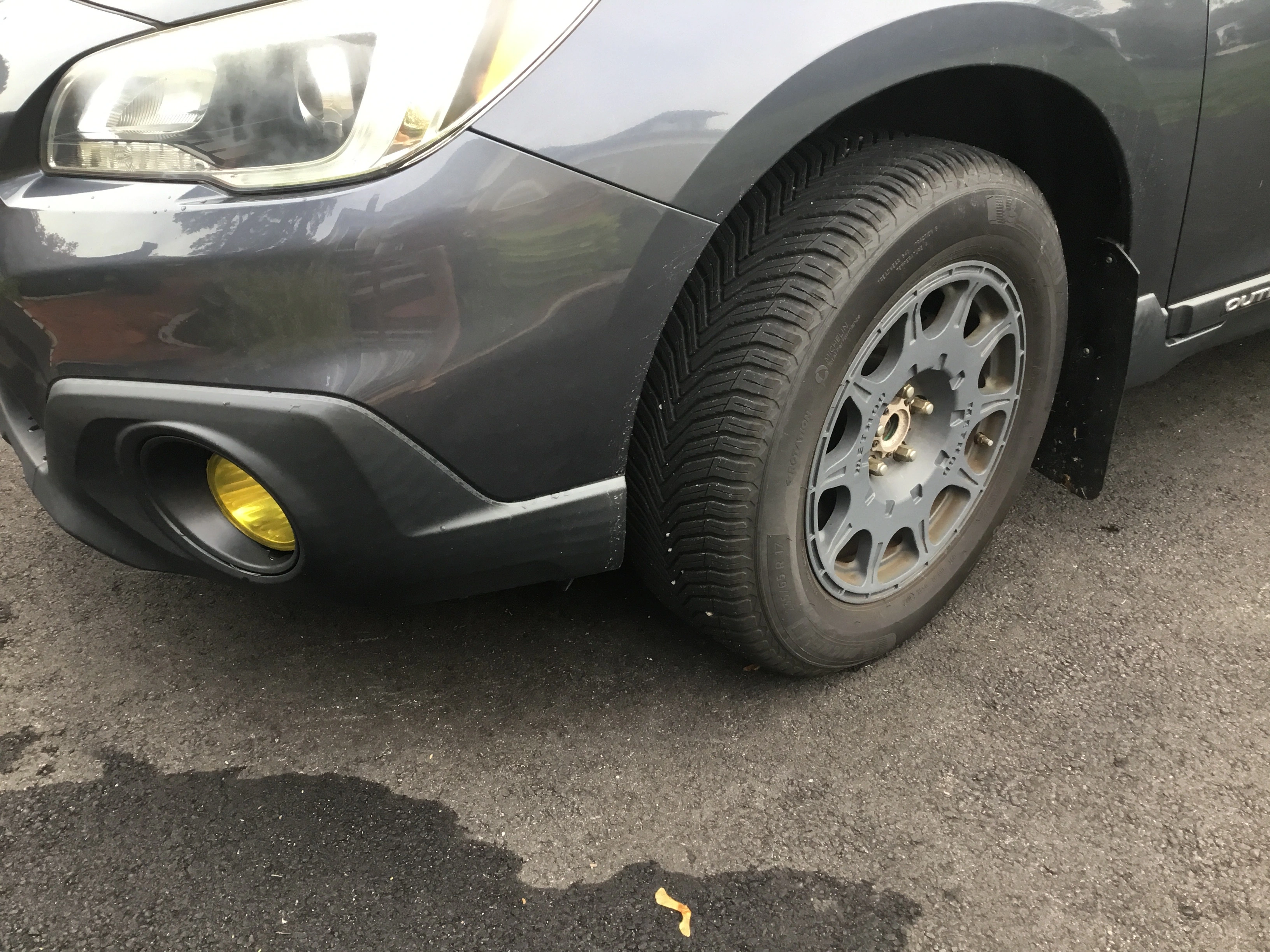

Then check out the best tires anyone makes: Michelin CrossClimate2.

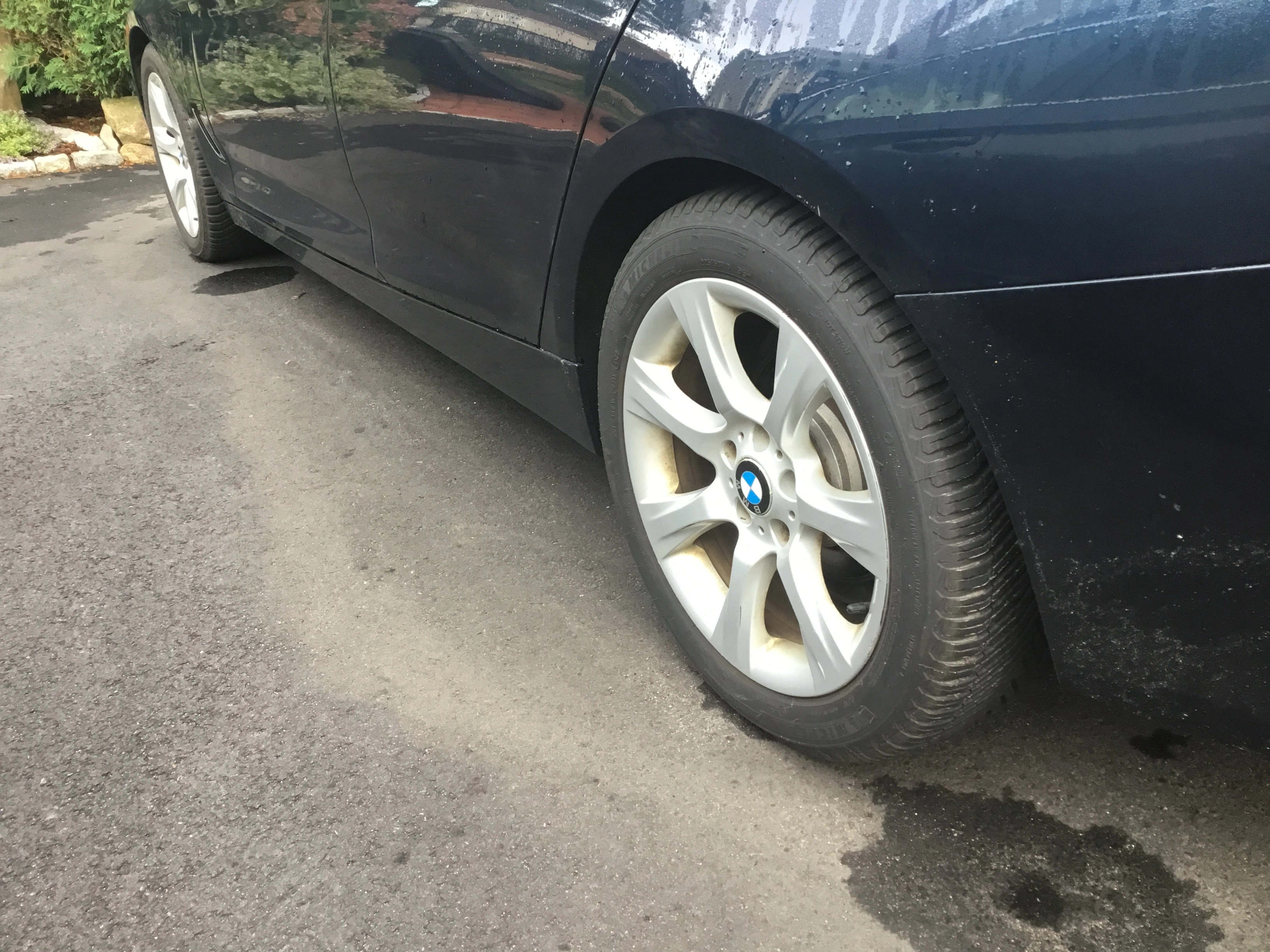

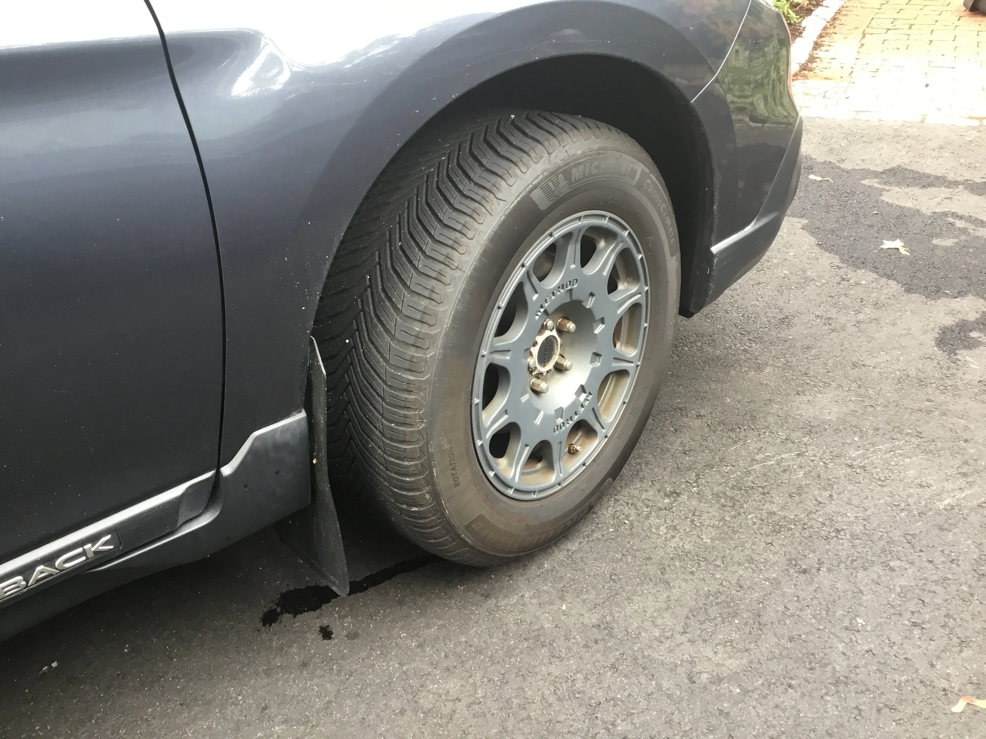

I now have them on my Subaru Outback (upsized to 235) and my wife’s BMW 3-series GT (after swapping out the stock run-flats). The tread pattern looks like it might be loud, but it’s not at all. Remarkable and noticeable improvement across all categories.
Don’t just take my word for it. Read the ratings and reviews on the Tire Rack website, etc.
Sorry for what appear to be stains in the driveway. It rained last night.
I also have these on a Volvo SUV, and they are incredible. The name almost does them an injustice. They are probably the best all season tire right now. Performance in the rain and light snow is great, and in the summer they do just fine too.

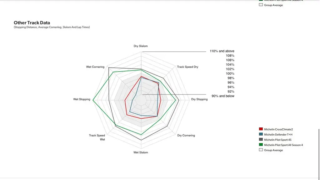

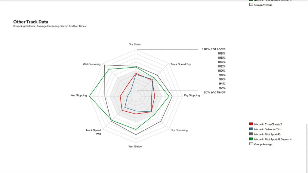

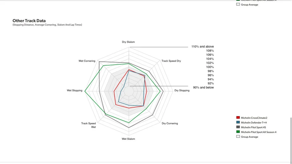

Maybe some actual Tire Rack data is needed. The AS4 runs circles, literally, around the CrossClimate 2. Snow and longevity may be not.
920
2,894
There are always tradeoffs. I have not put the AS4 on my SUV, but I do value something that allows me to get away with no tire changes. I need the rain and light snow performance. In other climates, without rain/snow, I am sure the AS4s are better.

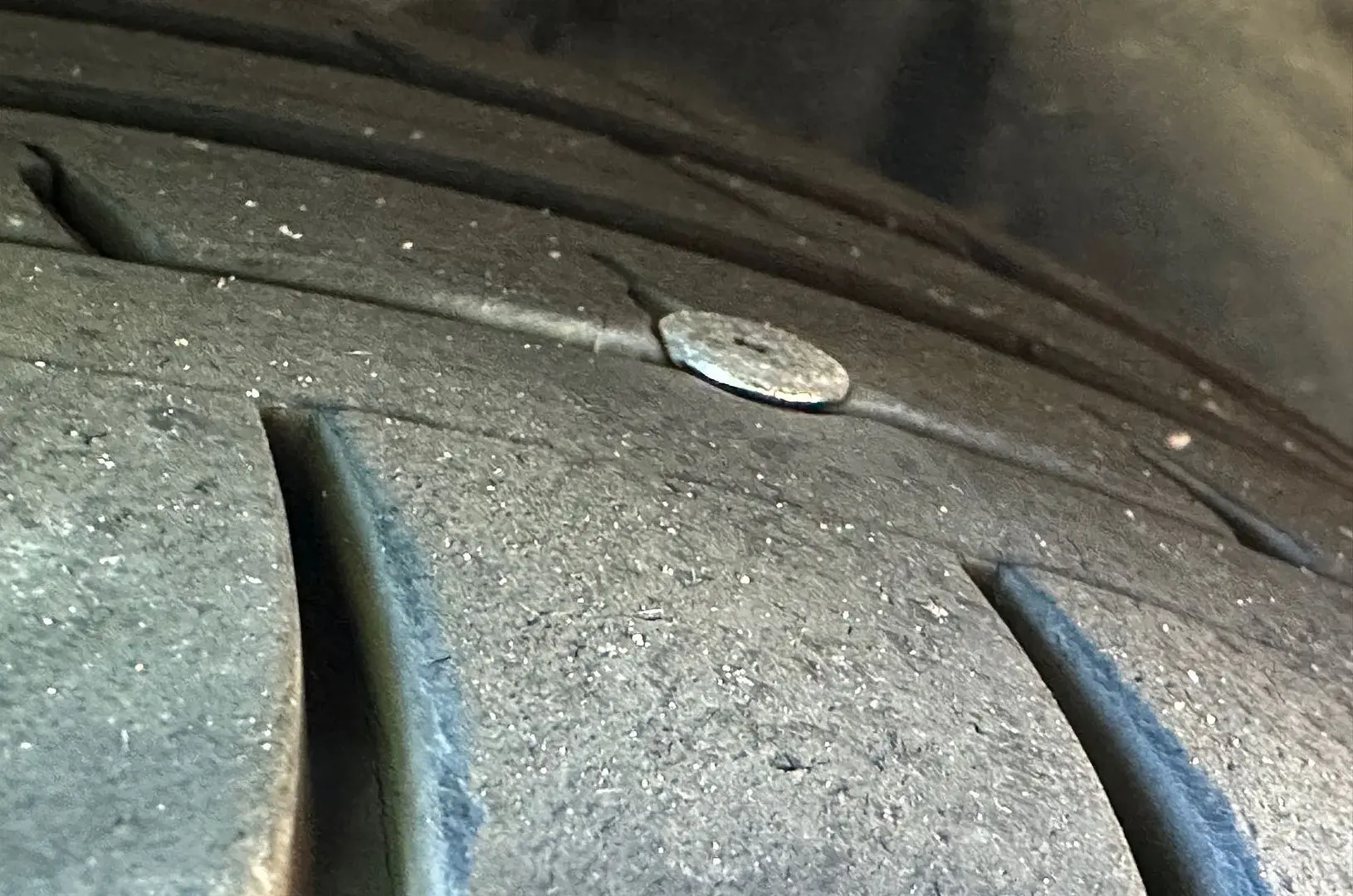

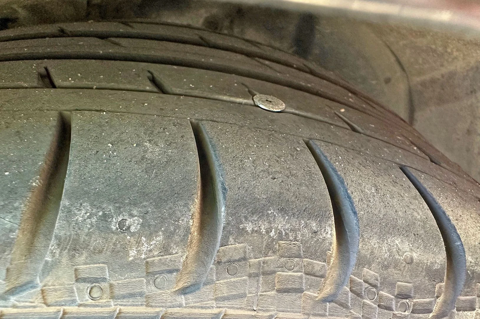

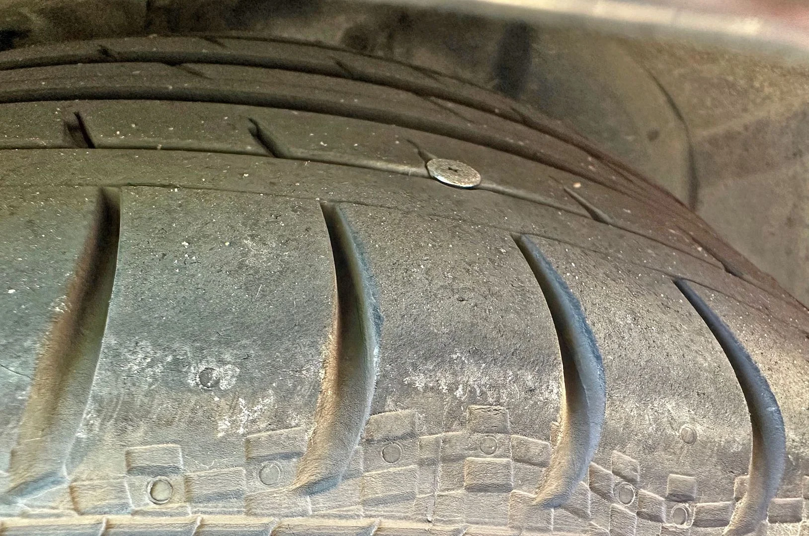

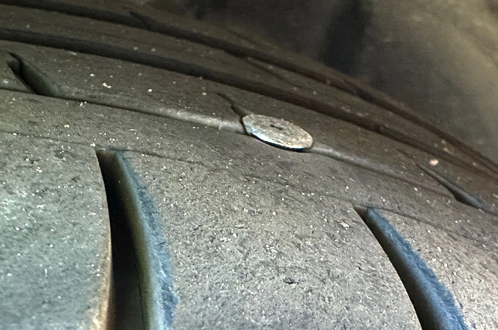

Well this thread was some sort of jinx...only my second ever puncture (my wife has had 3 or 4):
Can't quite tell if it's a nail or screw...
On the way to tennis when I got the alert that the front left tire was low. Found a spot to pull over and looked at both fronts - couldn't see a difference. Since we were about a km away from the courts I got back in and drove there carefully without incident.
After we finished 2 hours later, went out to the car to call a garage that was about 500m from the courts, where I had my only other puncture plugged maybe 35 years ago. They were not doing that anymore, and suggested I call the Canadian Tire store - I did but no one was working in service on Sunday.
Meanwhile my wife is on the phone with CAA, and I took out the gunk from the trunk - sealant and compressor. I didn't want to use the sealant if I didn't have to, so I hooked up the compressor, which has a gauge on it, and the tire is at 30 psi so only 5 pounds down. I pumped it back up to 35 and let it sit as we got the tow truck scheduled, but it was going to be 2.5 hour wait, and they would not drop us off at home even though they would drive right by taking the car to the dealer.
So my wife said she would walk home, I would go with the tow truck, and she would meet me at the dealer to pick me up. This meant she would have to walk on a 2 lane road with no sidewalks where people drive fast, and I was not comfortable with that. Checked the tire (now 30 minutes after I pumped it up) and it hadn't dropped any pressure. We cancelled the truck, and I drive it home carefully. Got home and it was still 35.
So will have to see what they say about patching this, and if it holds pressure enough for me to drive it in or if I will need a tow. Might need a new tire, but maybe not - we'll see. I haven't replaced any so not sure how expensive these will be...

That should be able to be patched, so long as the nail went straight in and did not damage the sidewall.
Bummer ☹️.
Doesn't look like it's hit the sidewall so a plug should work fine.

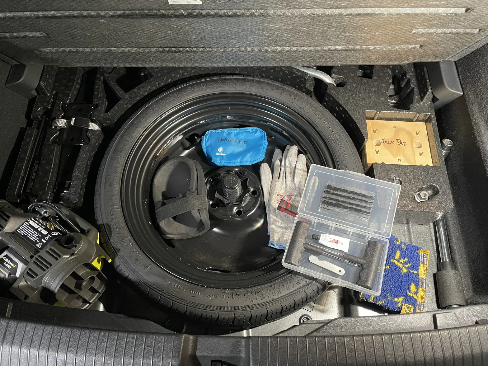

I carry a plug kit and an 18V inflator in the boot. Only ever needed to use it once, on a bush track miles from anywhere.

Neither does Audi. They don’t give you a spare either.
They do give you a custom air pump which plugs into your 12V takeoff. This has a port for a can of fix-a-flat, that is also provided.
I would rather just call roadside assistance and let them handle it.
gatorcpa
yeah, that is getting more common. My Camaro also. I bought a one off rim and used an old tire at tire change time and put it in the trunk. I had two catastrophic flats on that car before I put together a full sized spare and the fix-a-flat and air pump weren't of any use.
It's been holding pressure pretty well all week. Got a chance to drive it to a local tire shop today, and 20 minutes later and $25 and it's done. They showed me the screw that came out, and honestly it was quite short so must have just barely punctured the tire.

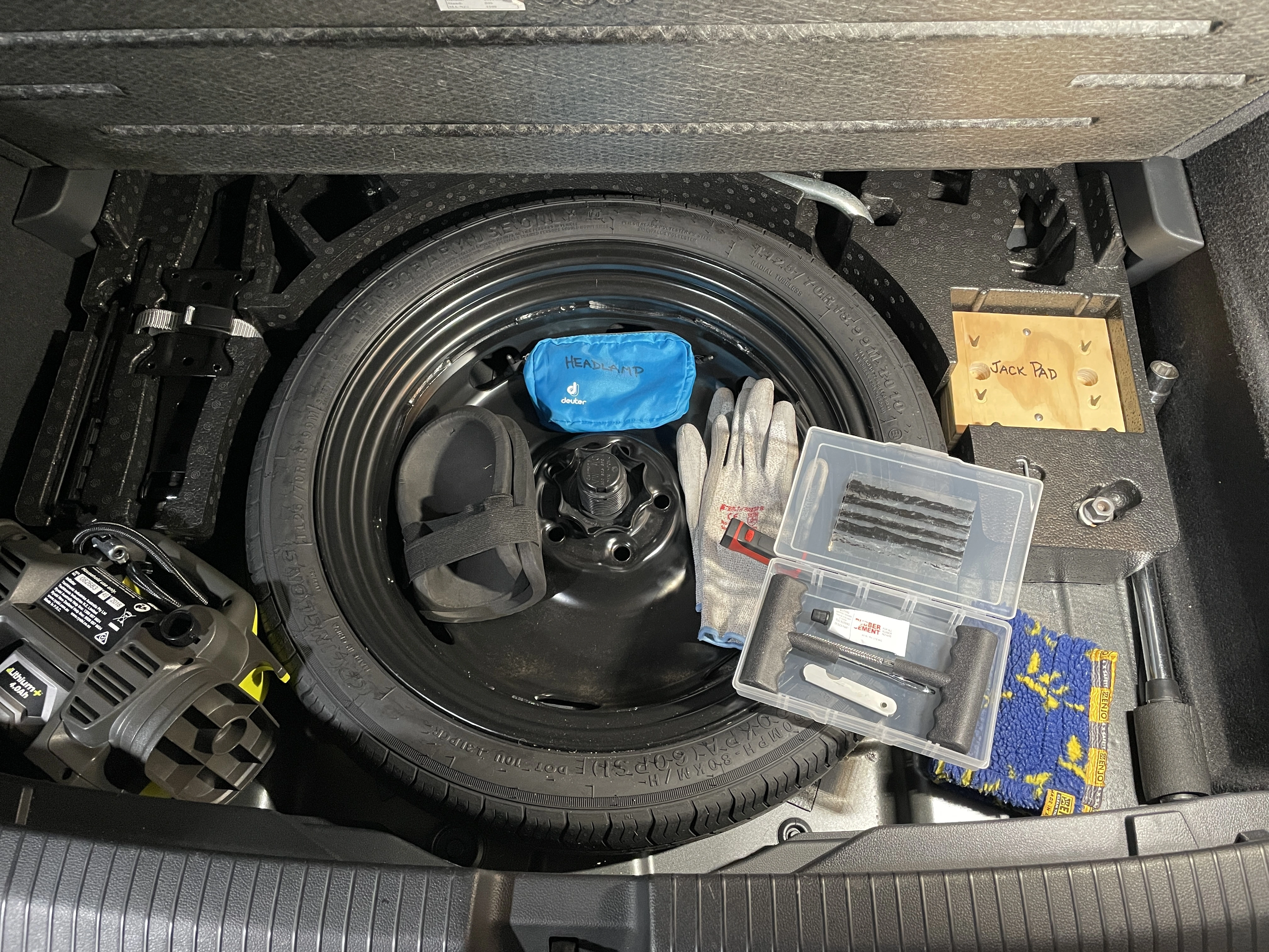

Vehicle that has a spare? Traditional tires
No spare? Run flats for me
Forgot to add - when I got to the tire shop they handed the keys to a young guy - he looked like he might have been 18 or so. He went out and got in my car, and then got right back out and went inside. An older guy came out and got in - he smiled and he said the young guy can't drive a manual...::facepalm1::
I'm glad that at least he didn't try to learn in my car!
