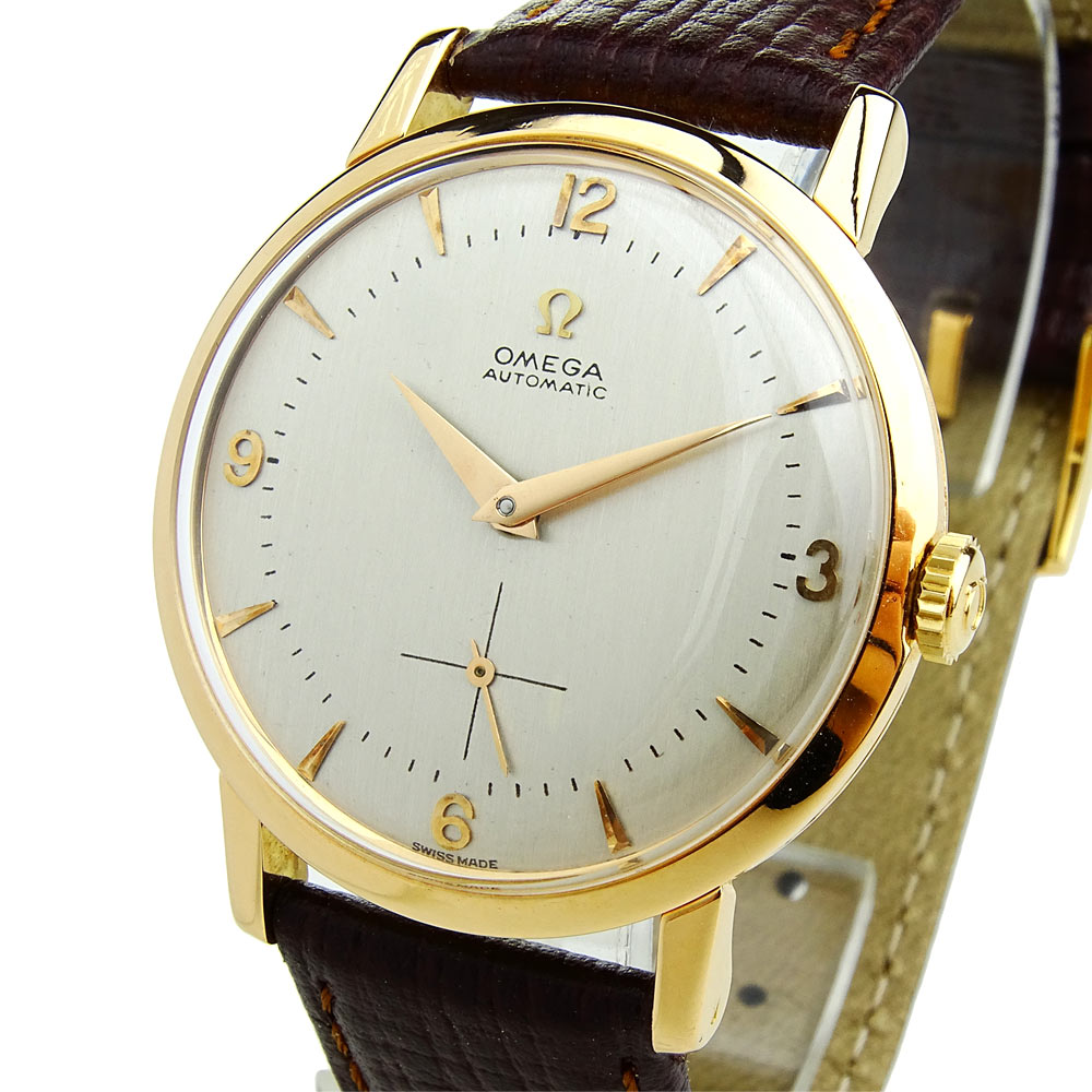

Looking at this but bothered By a few things. Indices at12 run over the track. Also no marking to confirm gold content. Any thoughts? Have asked for caseback.
617
2,986
Hi @eternalover .
In my opinion the dial had been refinished... The Omega and Automatic font are off and the minute track is too thick. The one at 28th position gives it away for me.
The case seems to have lost it's sharp edges too through polishing... It does not look so appealing to me, to be honest!
