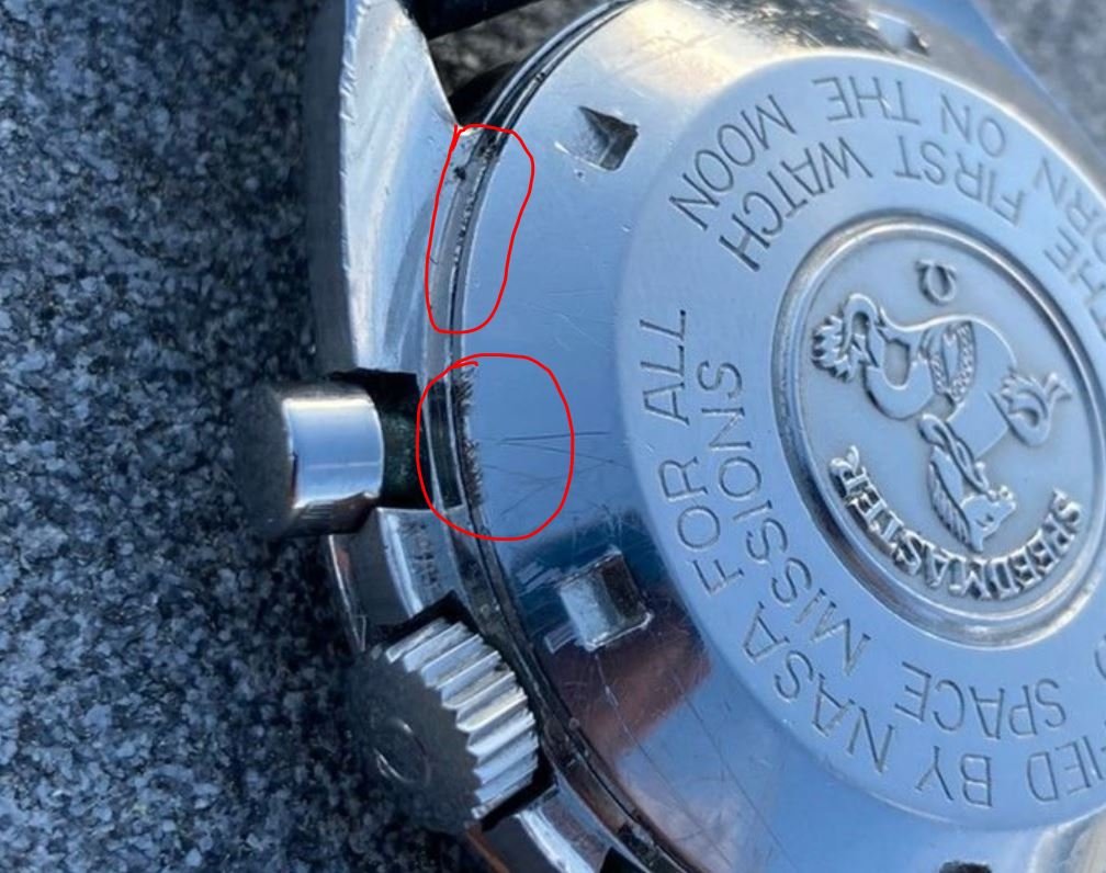

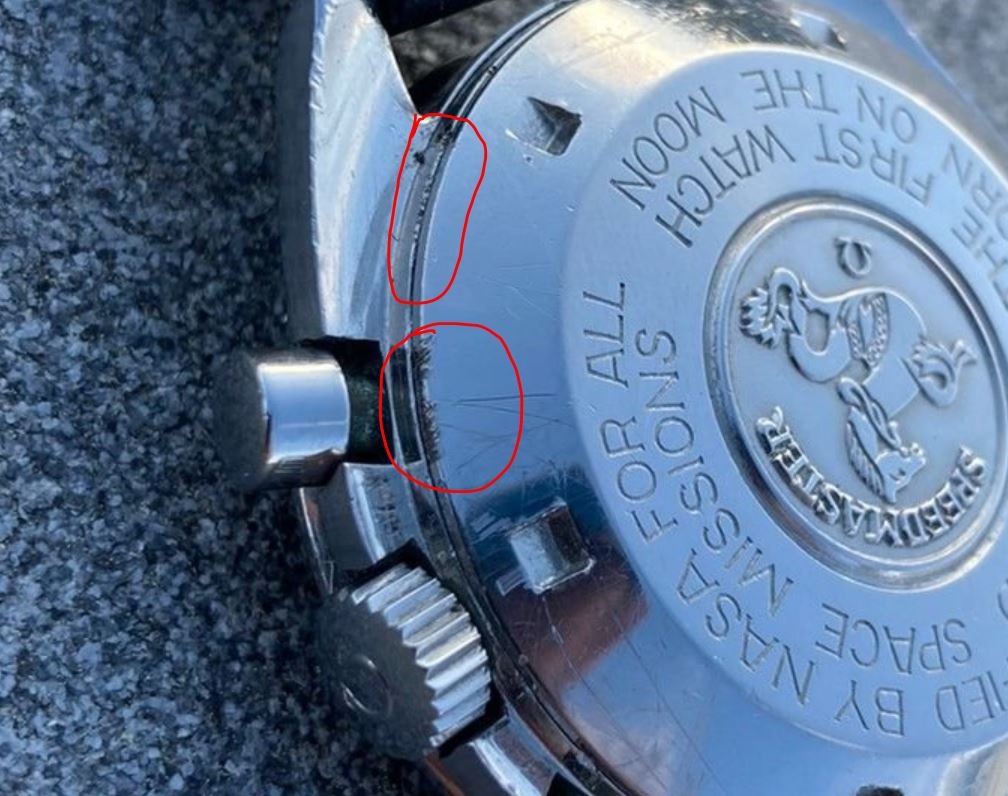

When you meet, check for corrosion between the case back and the mid case, as shown here:
With luck its just the poor photo, but I would strongly urge you to take the back off.

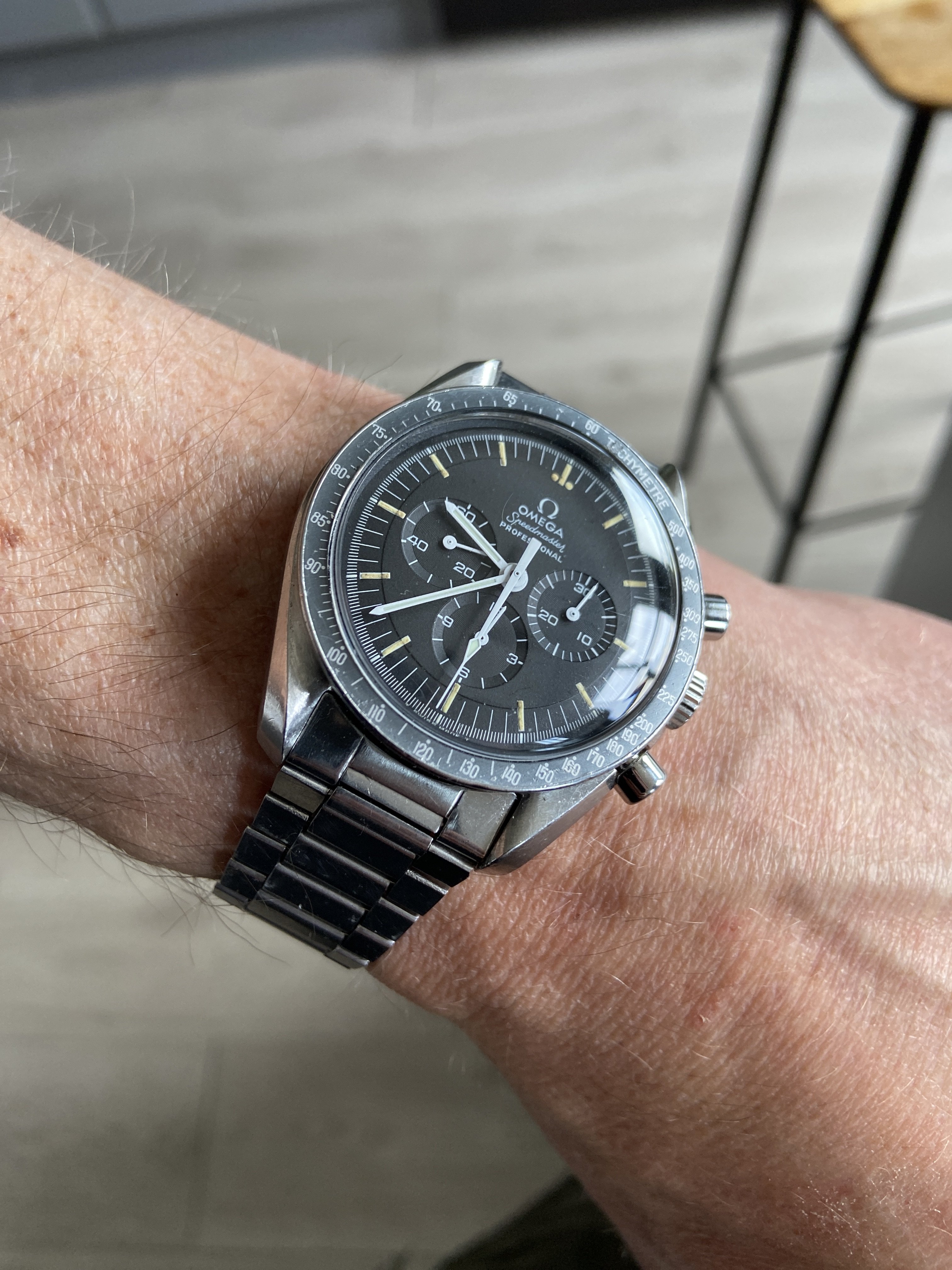

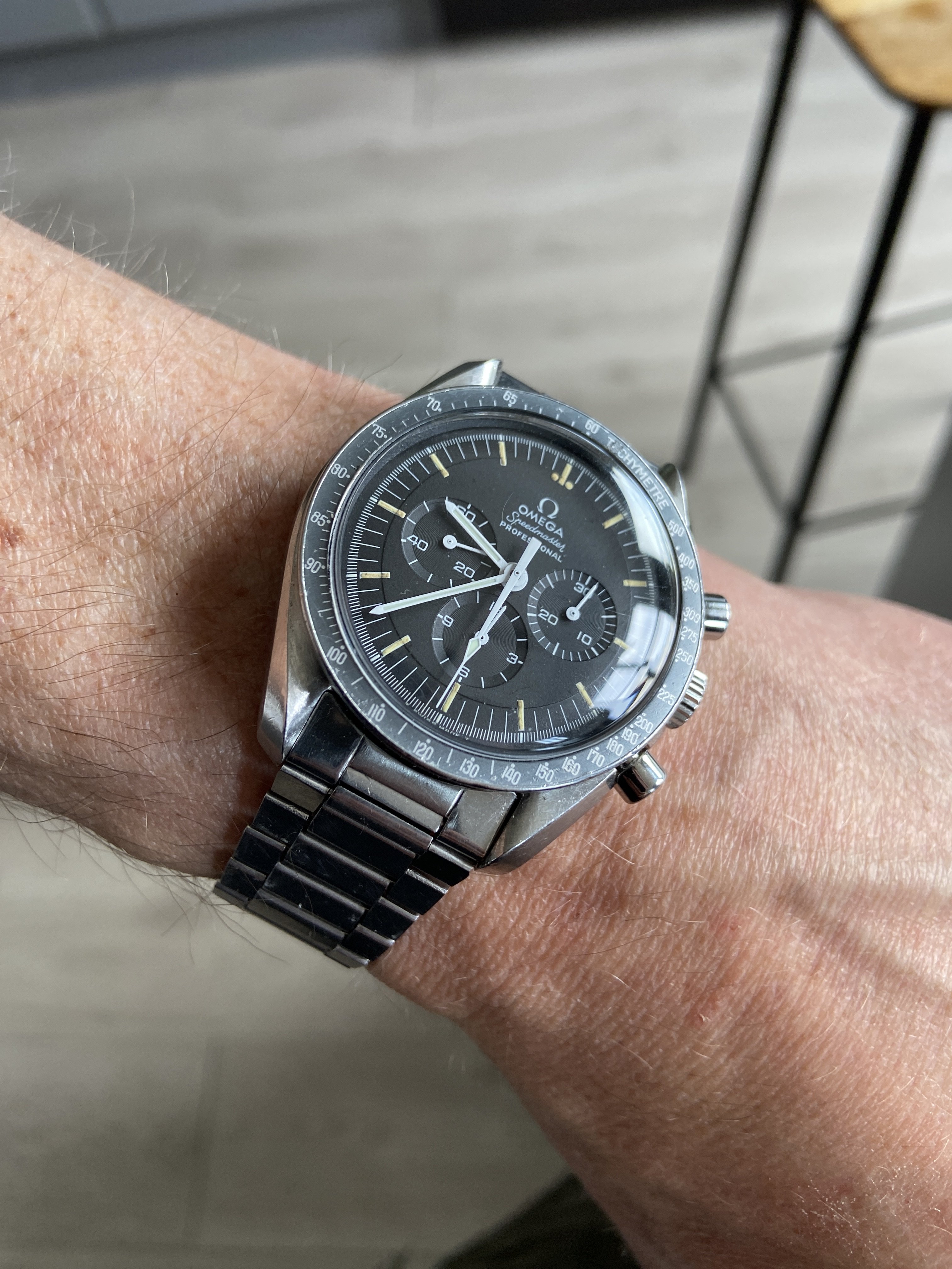

Well, I couldn’t help myself
Seeing the watch in real life was very comforting, it has a pleasing patina.
the dial has not been relumed I think, I took a close look with a magnifying glass. The dials, except one has been replaced it seems.
what looked like corrosion in the picture was a combination of scratches and dirt.
it runs a bit fast, about a second per hour.
I will use it as is a couple of days before having it serviced.
The feeling right now is happy!

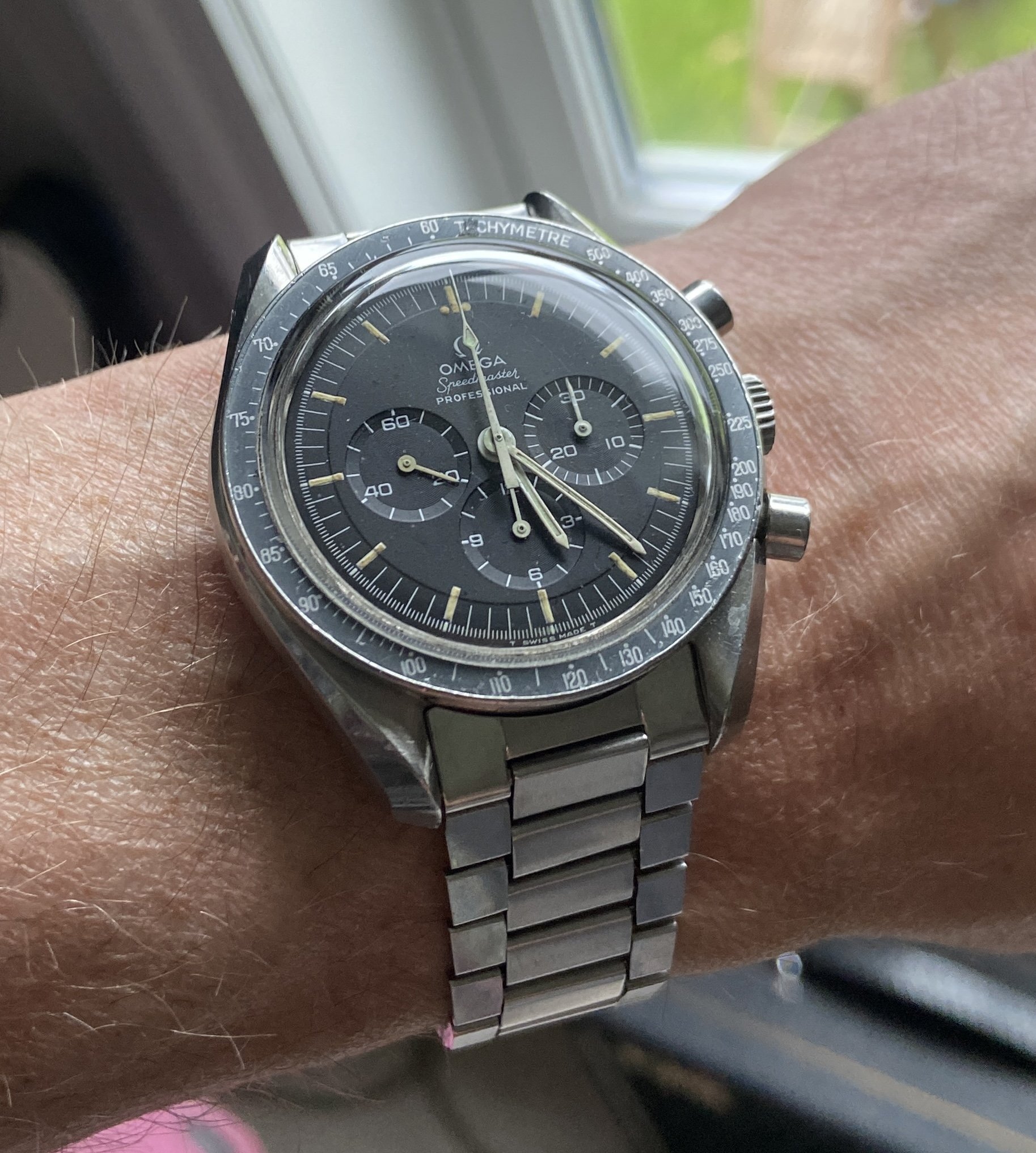

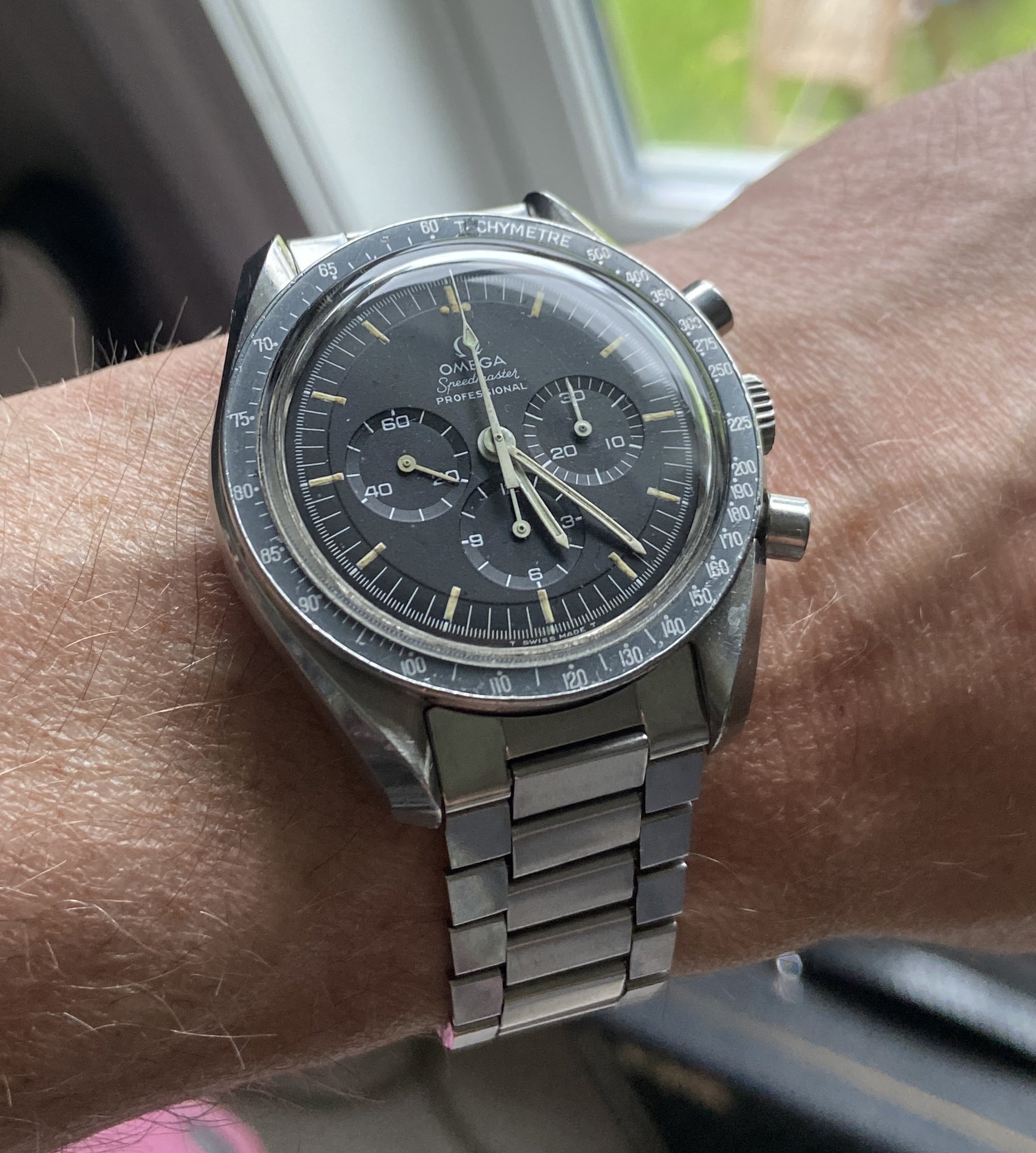

Congratulations! The Speedy looks great on your wrist. The watch looks consistent and correct to me, while I'm no expert lumologist I think it looks like vintage lume with some effects of age consistent with rest of watch.
Be sure to give it to independent Omega certified watchmaker with Omega parts account, who is attuned to sensibilities of vintage watch enthusiasts- not to Omega.
You will need to consider water resistance which may dictate replacing old pushers and crown to allow it to pass a pressure test, vs maintaining the original parts and just staying out of the rain. Don't wear it for too long before service as its likely running on decades-old lubrication which could be hard on parts. Ask lots of questions prior to service and you can post the service quote and plan here if you like, many experts (which I am not one) available to help.

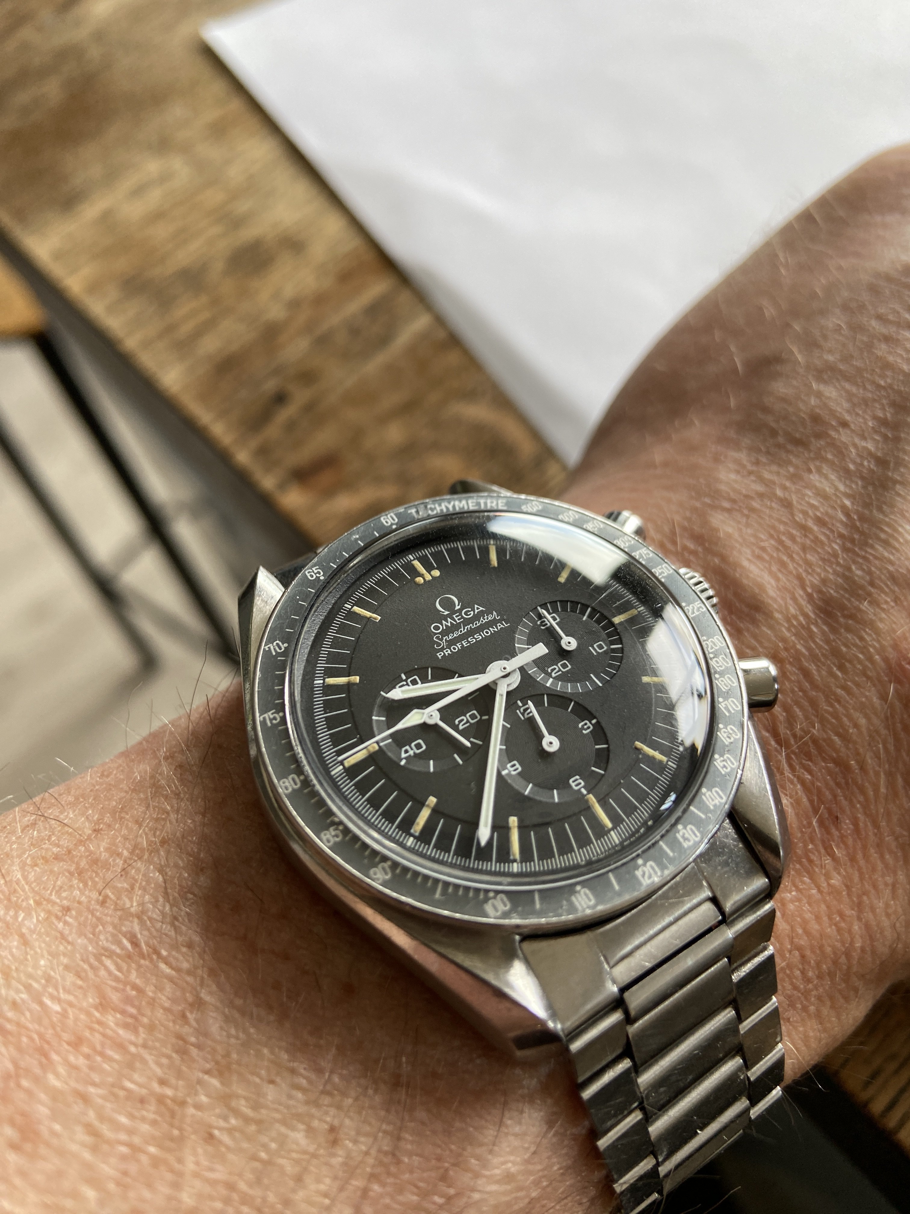

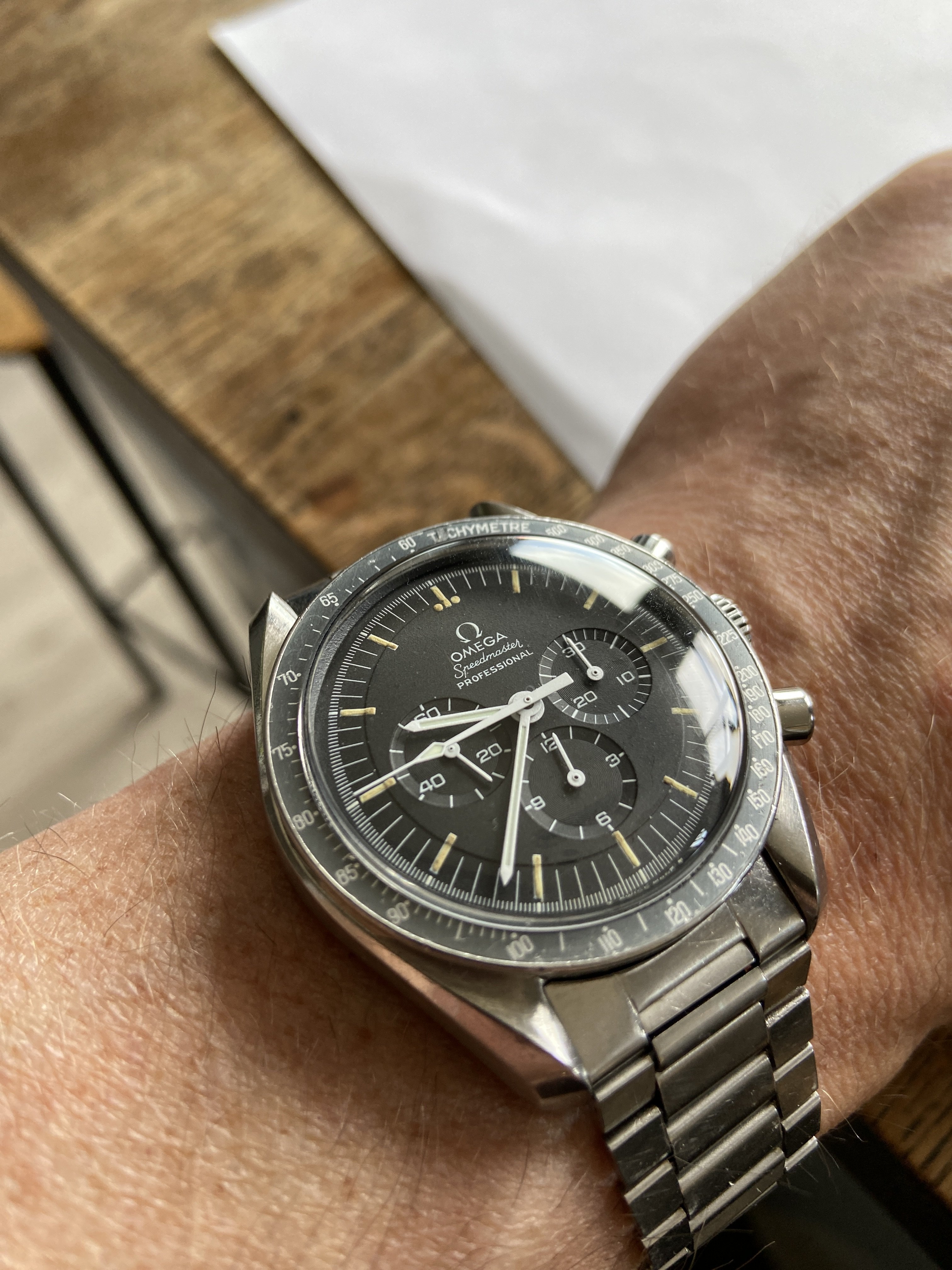

Congratulations and wear in good health. A very desirable vintage piece! Love the step dial.
They always look better in real life than in the macro photos..

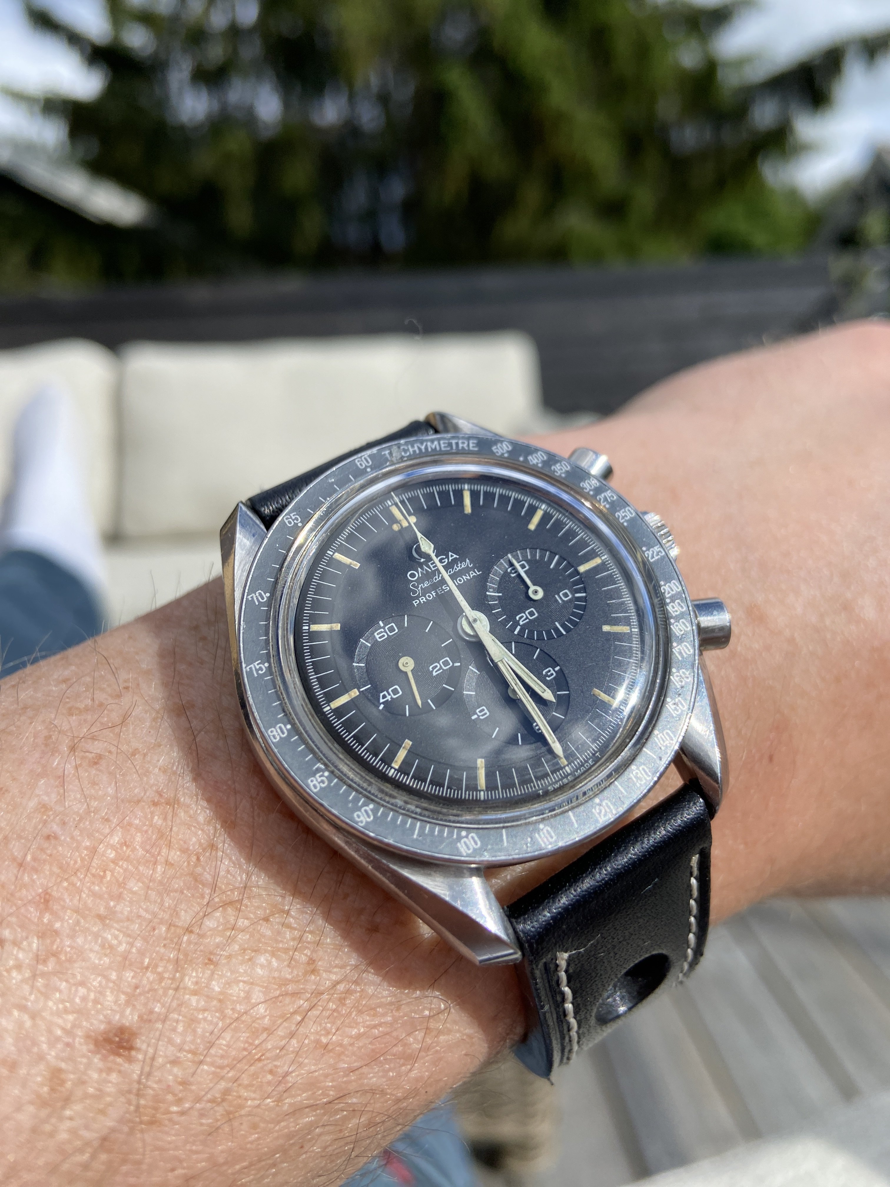

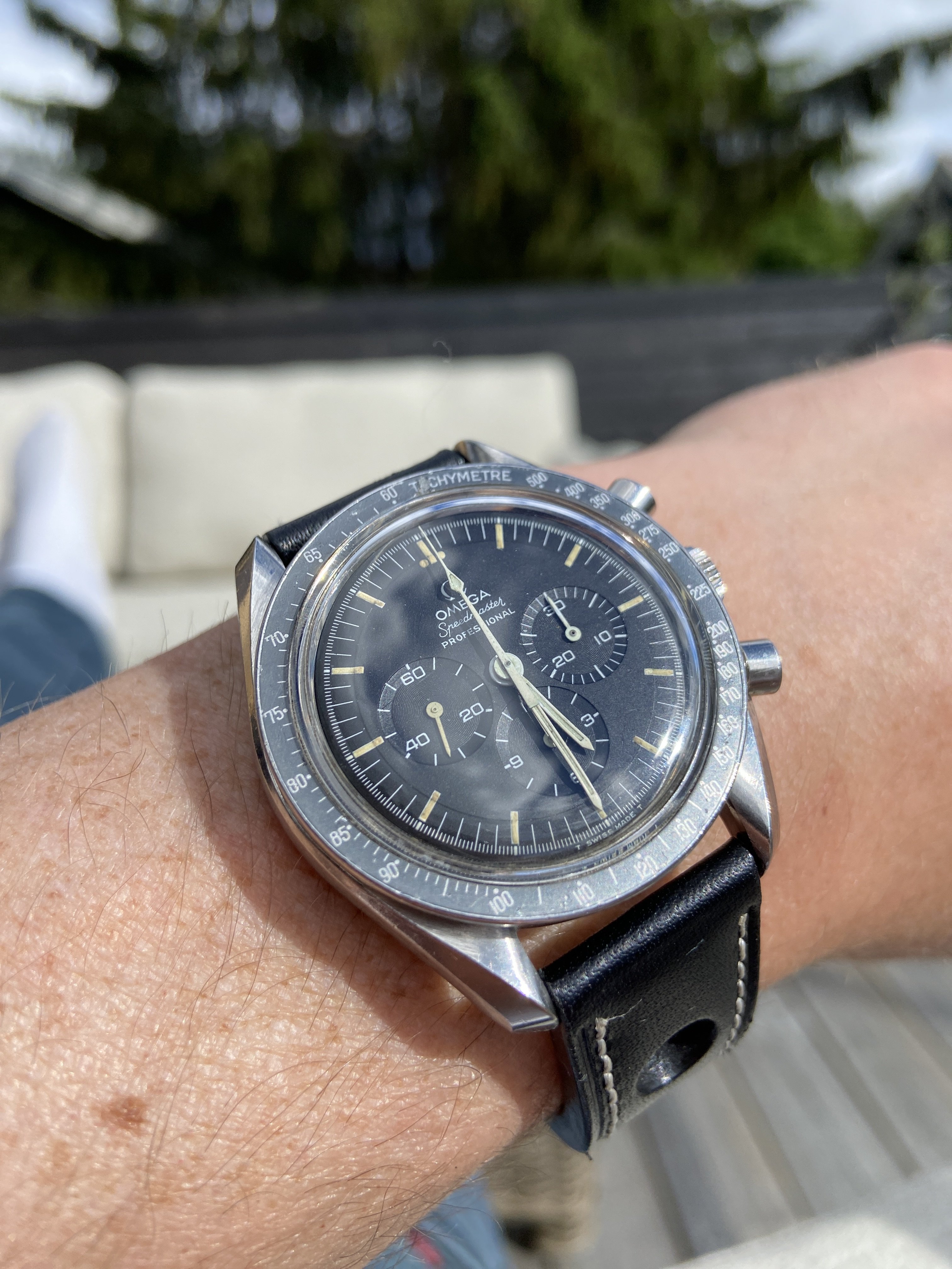

Looks good … nice even vintage patina. Congratulations!
Thank you!

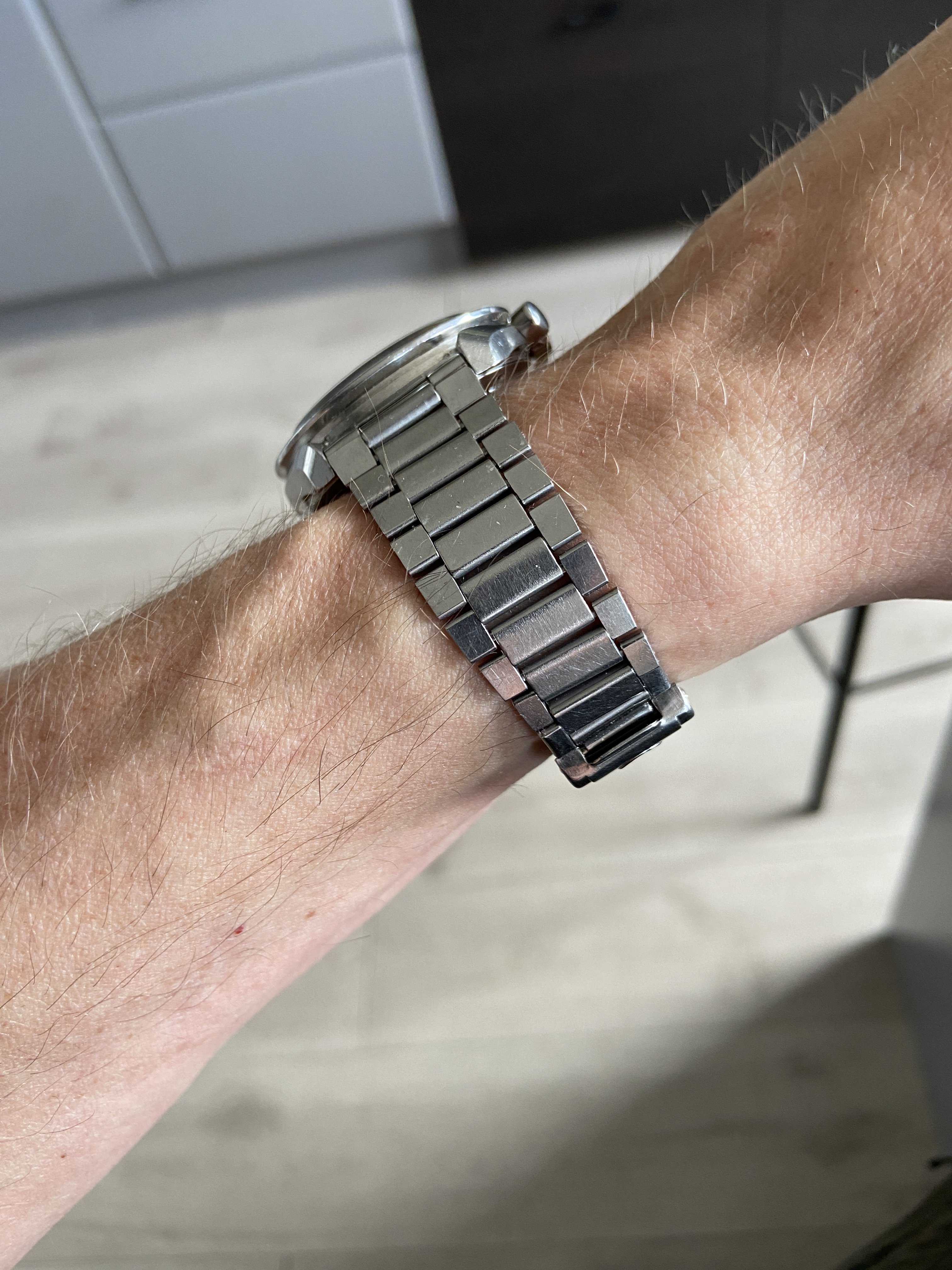

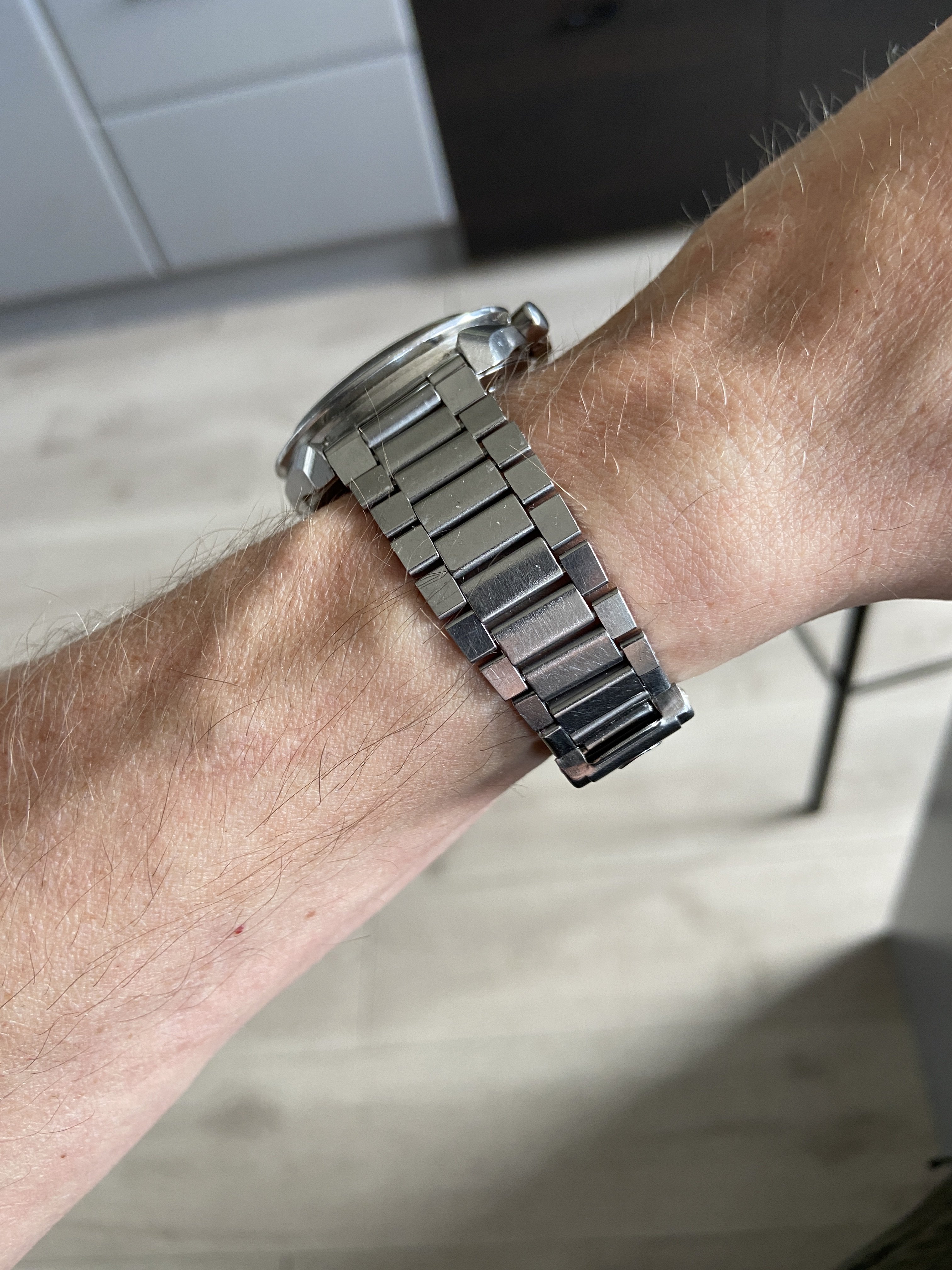

A bonus photo with the flat link bracelet.
Some of the springs are missing, but I have ordered a bunch to rejuvenate the bracelet.

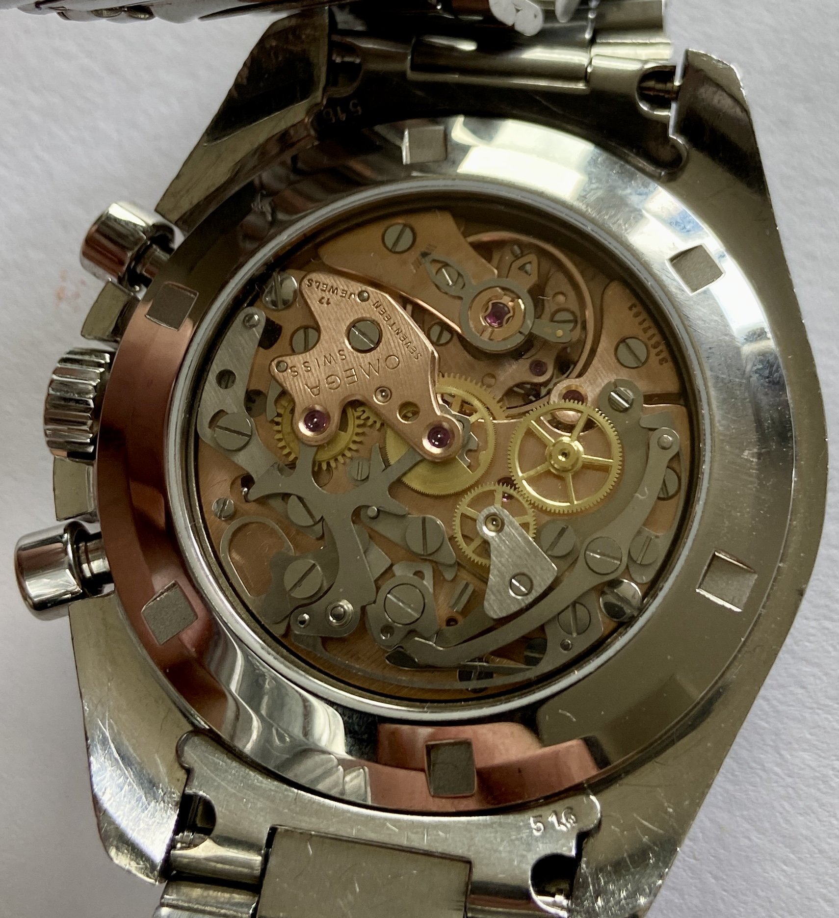

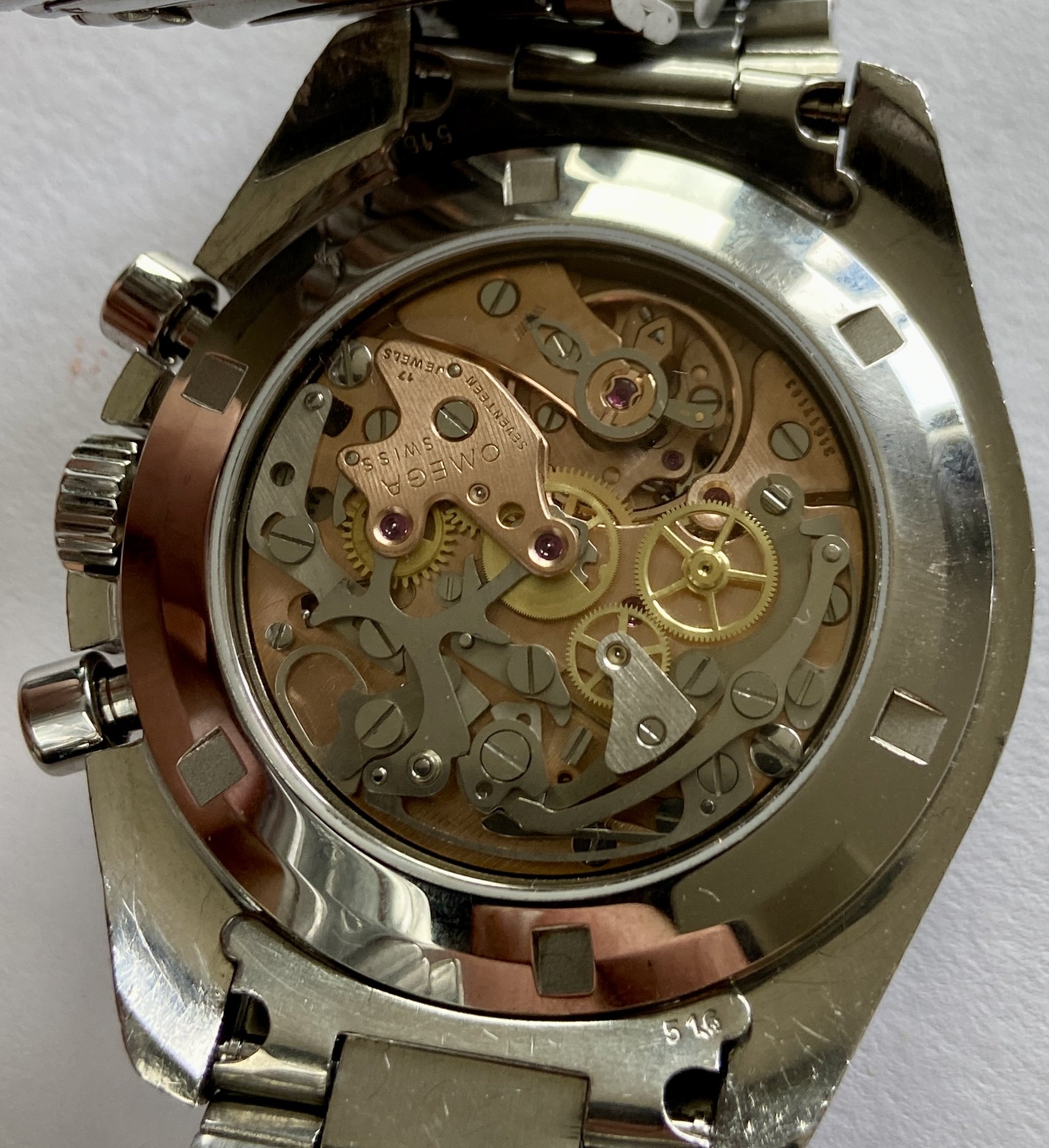

I have also installed a see through back cover, from Spiralwinder Watch Parts.
...of course keeping the original back cover with the other parts😁
Perhaps I have made some bad decisions regarding the servicing of this watch, but considering all replaced parts are kept safe, I feel good about it.
