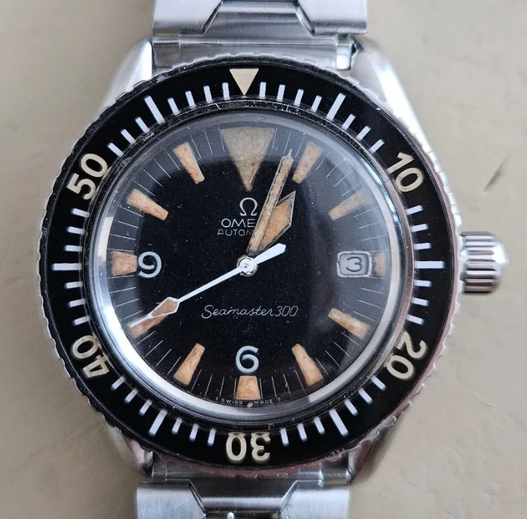

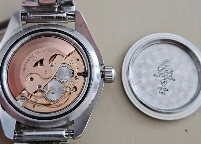

Hello.
I'm still not so deep in thematic to share my personal opinion and/or not to ask for the opinion of specialists...
In this regard, I ask you to look at the attached photos: are these watches worth our attention?
Thanks in advance..

166.024/165.024-references have many variations, and there's no single resource where most of them are described.
Dial has an atypical font - I assume it's authentic.
Case and bezel also look OK to me, but I'm not sure if this combination of all the elements is correct.
Same with caliber - many questions, but no canswers yet.

Thank you for the link - it's well known resource which normally helps to recognize most common variations, but not all of them.
If to compare shown wristwatch with resource pictures, you'll find that nothing is match completely: not bezel (due to: all minutes marks are white), dial (due to: font slant is different), back lid (text stamping looks different).
That's actually why I asked here for opinions.

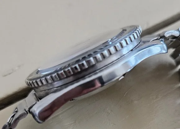

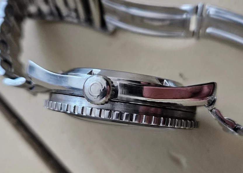

side of the case looks polished, caseback like new , minute (look at!) and hour hand relumed ??.... hm.....
look at smimilar ones and compare , esp the lume of the hands

Sure, minute hand is wrong, hands relume is awful, on the dial also different tones of luminophore (big triangle vs other marks)..
So it's franken watch, made of Omega components or what it is?

I wonder whether this was always a Big Triangle or whether a dial with the stubby at 12 has been over painted. Also, I know pin holes are not definitive but the absence of them on this watch is a red flag for me.

... are these watches worth our attention?

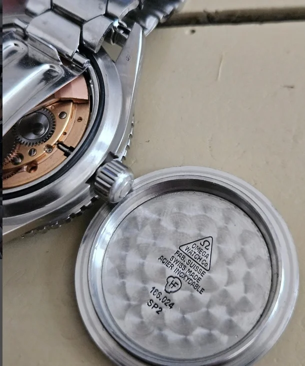

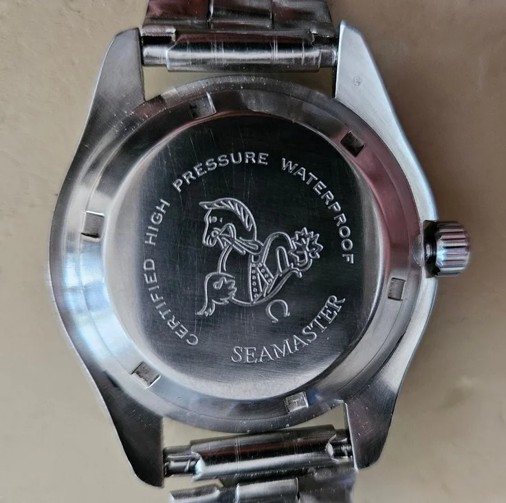

In short, no.
Caseback - fake.
Caseband - fake.
Bezel - fake with aftermarket 'glue on' insert.
Dial - completely repainted, in best case.
Crown and tube - wrong.
Hands - fake/wrong.

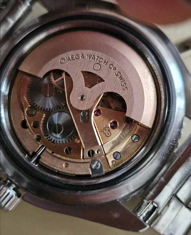

Movement - ok.
This one has been dressed up a little more than usual for the dance - leave while you can

Ok.. That's what was needed!
Thank you..
The item is being sold at a Swedish auction and is receiving a lot of bids.

When the case-back is so obviously fake, just stop looking and move on.

Complete fake, including the dial--see the date window shape... only movement is genuine Omega...
Fakers are getting better and better though!
