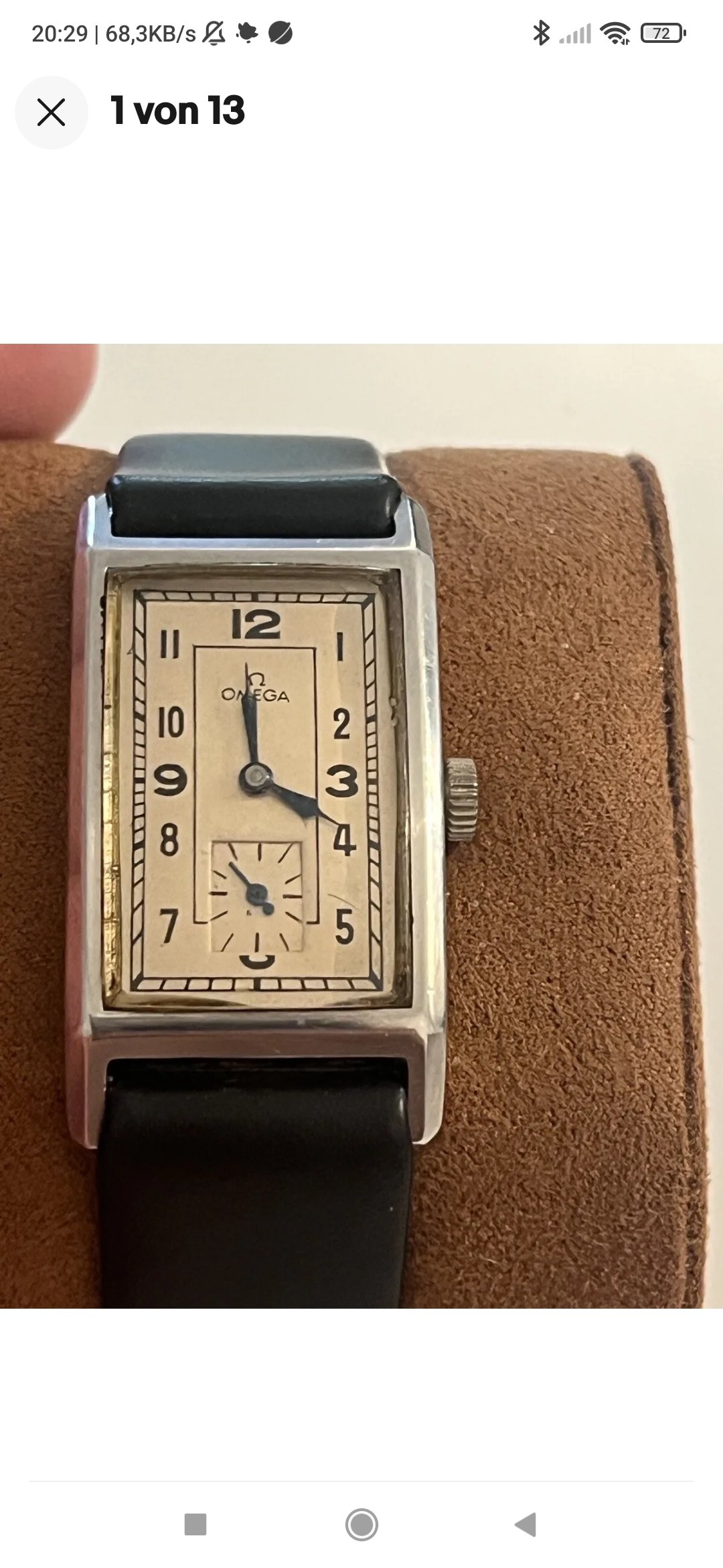

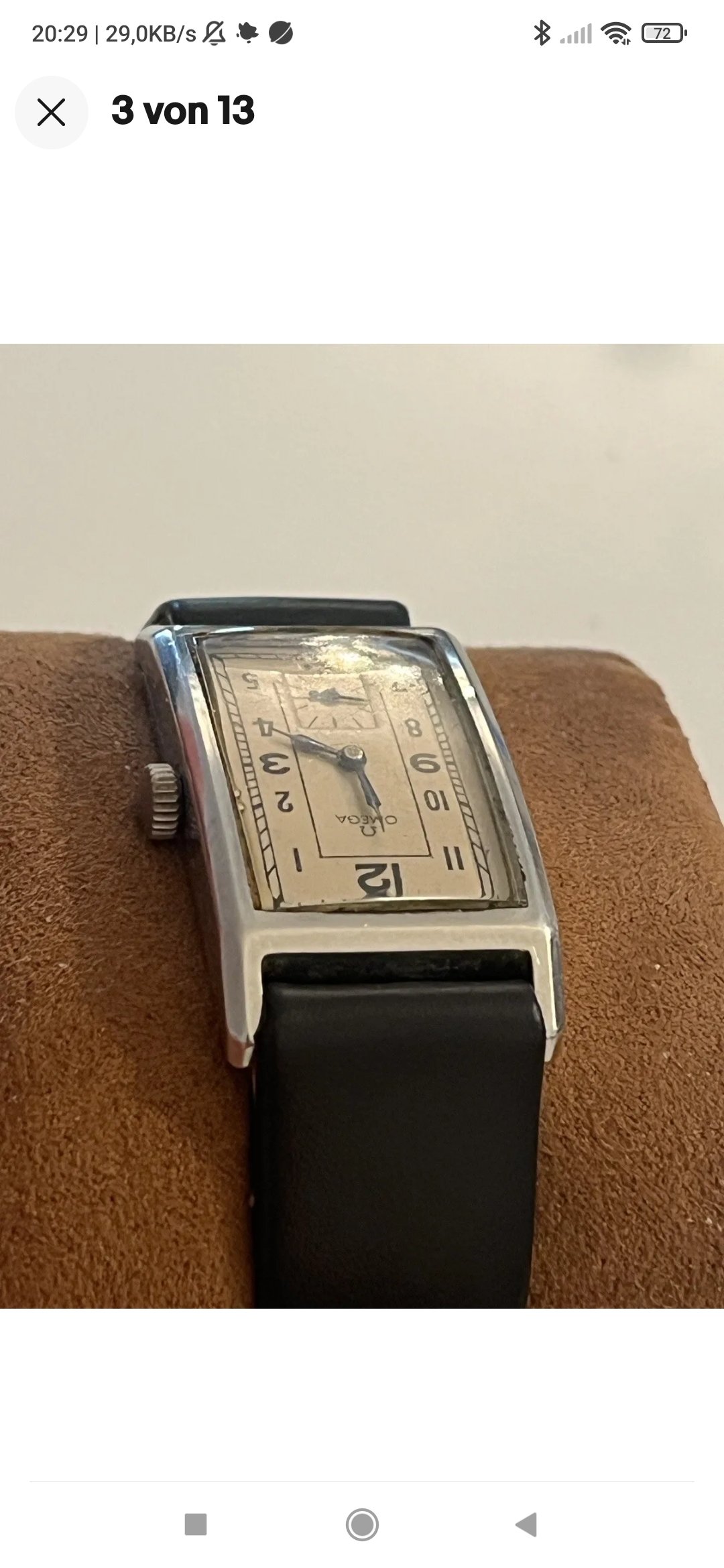

Hello, i just bought this very lovely looking watch for 500 Euros. Im just concerned about the condition, it looks great but i cant really tell whats going on on the outer edges of the case? Was it worth the 500 euros? Thanks in advance!
13,505
31,838
You have heard from the two top authorities on such watches, return it if you can.

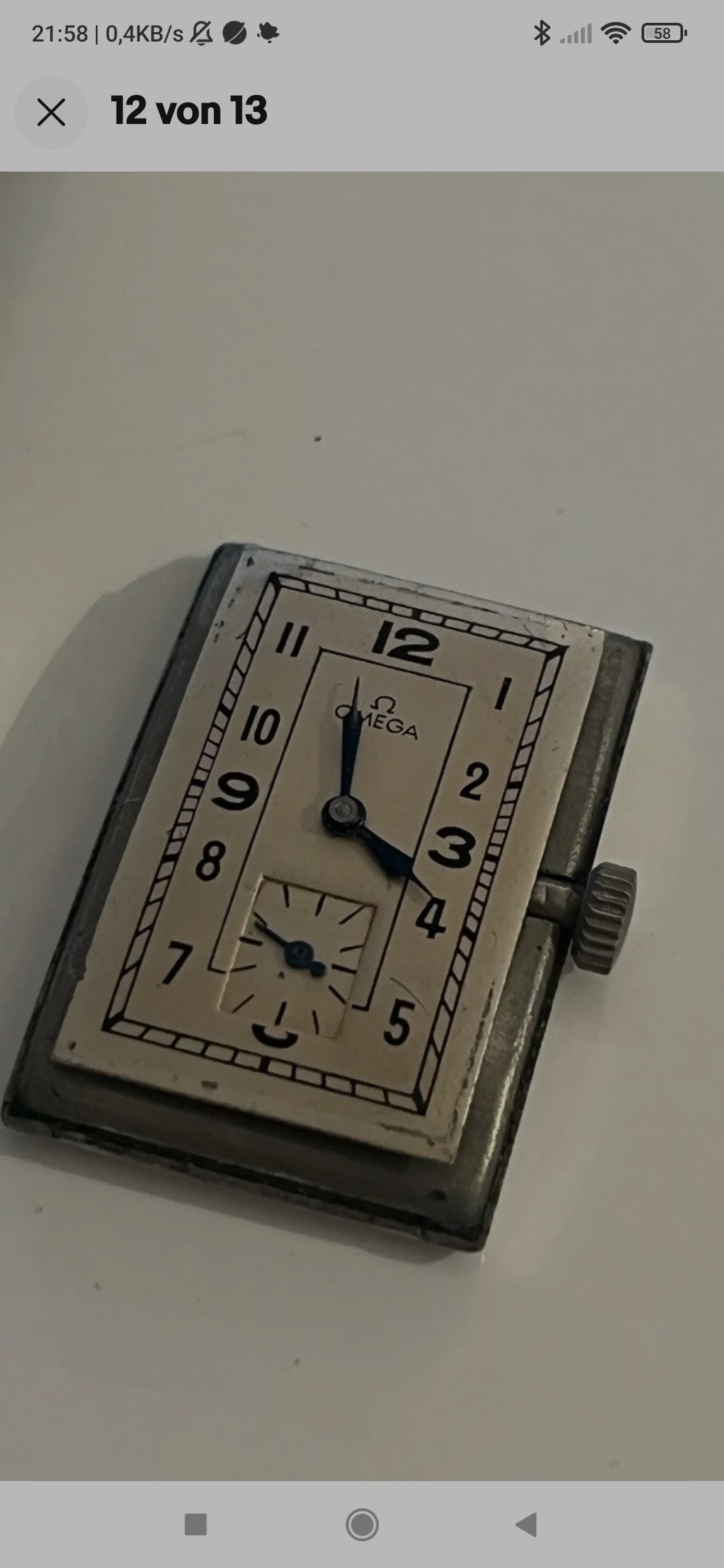

Thanks for thr replies, i will do so! I would never have thought that the dial was redone.. have to be incredibly careful, but thanks to people like you helping us out. Heres another photo of the dial:
8,889
62,989
If you never thought upon sight, please look at one or two original dialed Omega watches.
Plenty to be found at this Forum
Welcome
24,844
55,271
The logo and OMEGA printing are totally wrong. With some experience, you will recognize this quickly.
51
60
You are right about that.
