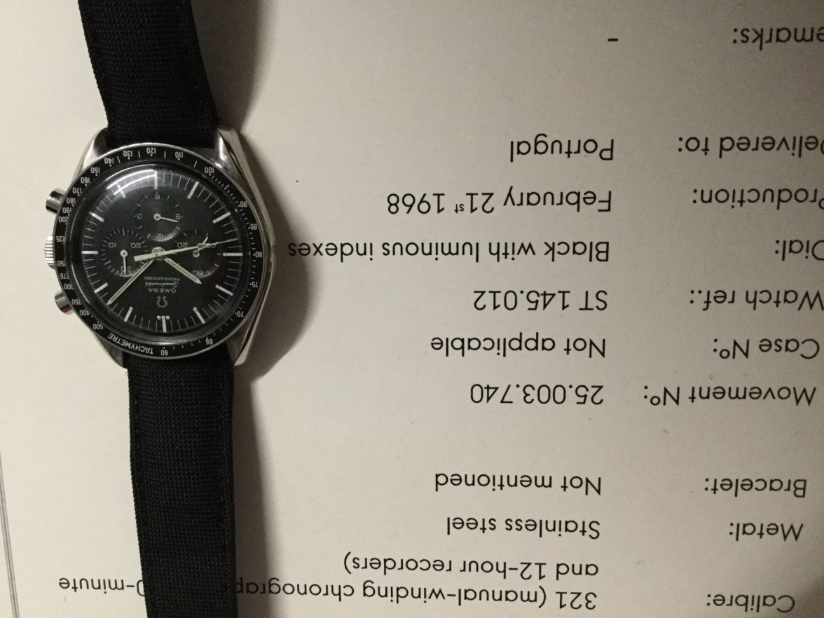

    Hi guys
    Maybe a good place to ask regarding a cal. 321 Speedmaster which I'm looking to buy.
    What do you think about the watch? Anything weird? It's a 145.012, Cal. 361 from 1968. I want to avoid making a mistake, as it will be my first Speedmaster I'm not an expert and thankful for any Inputs.
    According to the seller the watch is all original except that the Bezel was replaced and the caseback was replaced.
    The watch is in working condition, but needs a service as the reset of the 12h Display is not always working. As well the back shows slight traces of corrosion.
    As I'm not in a hurry and don't want to overpay; What do you think would be an appropriate Price range for such a watch in that condition?
    As well, what does a proper Service at a Omega Boutique costs (as I will have to include this Costs as well in my decision making).
    Still quite new to the Forum, appreciate the help ;)! Thx.

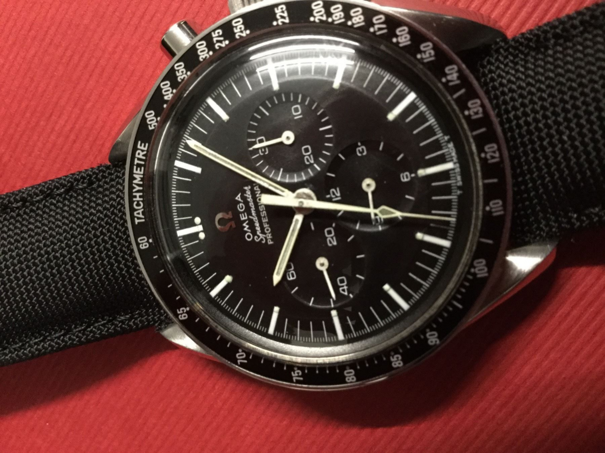

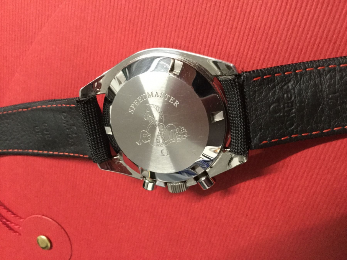

    I would keep my hands off! Replacement caseback is a nogo for me. Lume is washed off, crown not correct and so on. Not a watch which will find a lot of friends..

    Bezel is modern service one too..Check out my avatar.. This watch should have “dot over 90”

    Its only value is in its parts, to be honest. Unless you're intentionally looking for a project watch, you should move on.

    All said. This is a terrible example of a pretty much put together watch I'd say. According to the Extract delivered to Portugal in/around 1968, it should bear a customs hallmark on the upper left lug..but it doesn't.

    This is a terrible watch.
    It has no endearing qualities, apart perhaps from the fact it has an extract.
    Well done for asking here, you are saving yourself a headache. This is a watch that if you bought it, would simply become more and more unattractive as you owned it, as it’s shortcomings become more and more obvious to you.
    As with everything, it’s down to price as well - but even if this was cheap, it would still be unattractive - it’s got too many replacement parts, and those that remain so ugly, that if it is priced anything above the price of a movement the it’s going to disappoint.
    The difference between an experienced buyer and a novice, is that the experienced buyer sees in a few seconds what the novice might take several weeks or months to notice, then investigate, then realise just how he has been fooled.
    It is not rocket science, but comparables really help. Find a really nice watch or one where the colours of the dial and lume attract you. Then see if it is admired by the wider community (when you are learning - consensus can help you discover if it’s real or not).
    For example there is a recent sale on eBay of an attractive 145.012 with a brown dial. Ask yourself, do you like it? Do you like the colours? Don’t worry if you don’t - not everyone does, and that’s part of the fun. Learn what you like, and as long as the dial is genuine, and you are aware of any work done, you should be ok. In the case of the op watch the lume has been removed and no one likes that.
    Also the op watch has a replacement bezel - which jars my eyes, and a replacement back - we have to wonder why? Then we have to wonder if the back has been replaced, how much of the movement is original, indeed is the mid case original? If not, then when you own it small little niggling doubts as to the general integrity and honesty of the watch might creep into your mind and ruin the enjoyment of ownership.
    Again, this doesn’t hold so true if the watch is bought knowing all these things and for a price that truly reflects the state of the watch.
    Look at the forums, where people show the watch they just bought or, like you have, asked about a watch on offer.
    Allow yourself to choose what you like, then verify the integrity of the parts.
    A short cut is to buy a watch and wear it. You will then get to know it intimately and it seems to jumpstart knowledge base in those who want to get a good one, but who know little. To that end, look for a trusted seller and buy something that grabs you by the balls and says “buy me!” - spending what you can afford to be without for a while, no more.

    Where’s the ‘68 from? Serial number? What is the case back reference (inside)? Serial # 25– - but thought ‘68 is 26 serial, MAYBE 27...
    Is 25 considered ‘68 ??
    Dial really lacking. I mean, no patina (some ‘nice’ degradation) and not a nice yellowish hue. Really lacking.
    Good to check here. Buy the Moonwatch Book. Tons helpful. And of course, browse these pages patiently ... you’ll be rewarded !!

    I'd buy this if I found it in a pawnshop for $2K. At $3K I'd realize it was technically worth it for the parts, but still would pass. I'm going to guess that the seller is asking around $6K and at that price it is such a hard "NOPE" its not even funny. Walk away.
