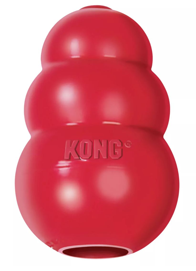

This Kong dog toy will get the other one open. I'd get it in the medium size, and as Archer said, everything should be clean. Works much better than a ball for me, and no inflation uncertainty.

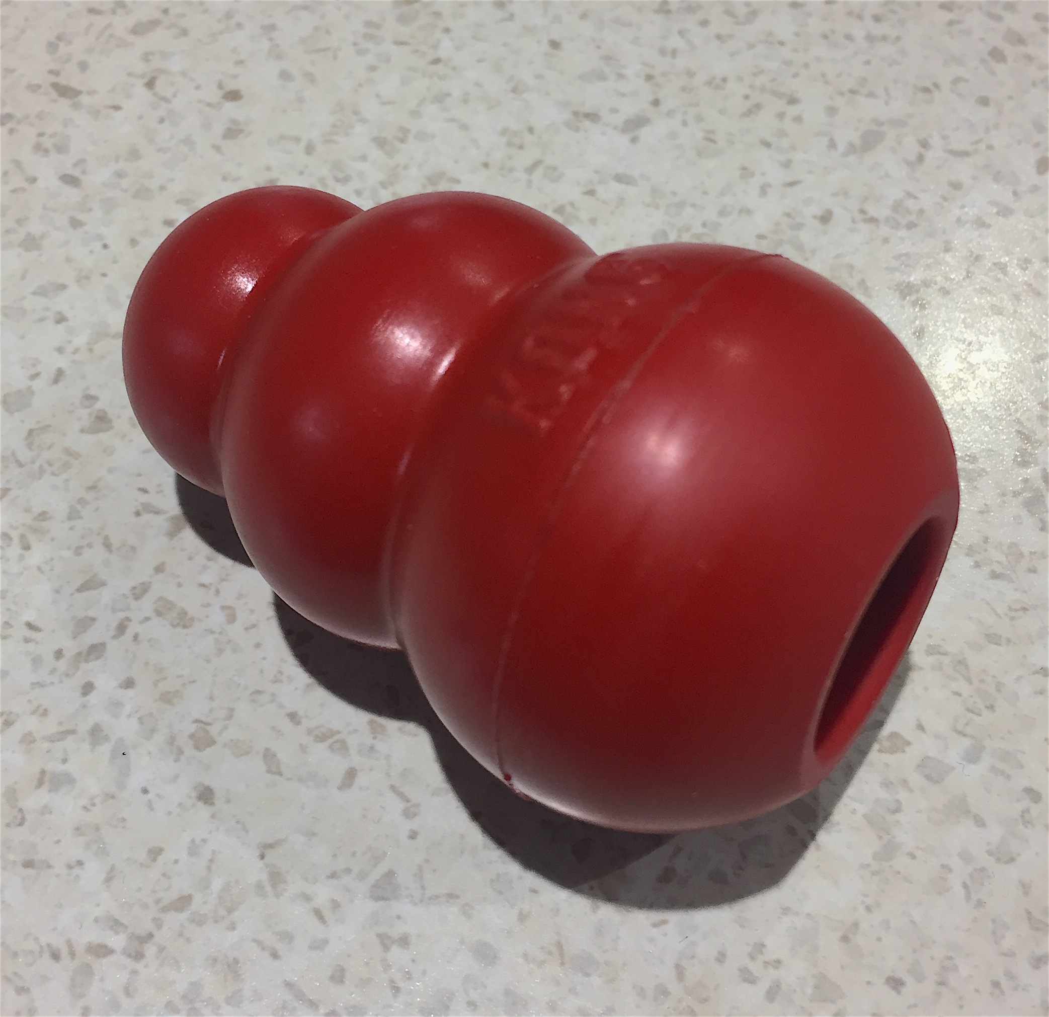

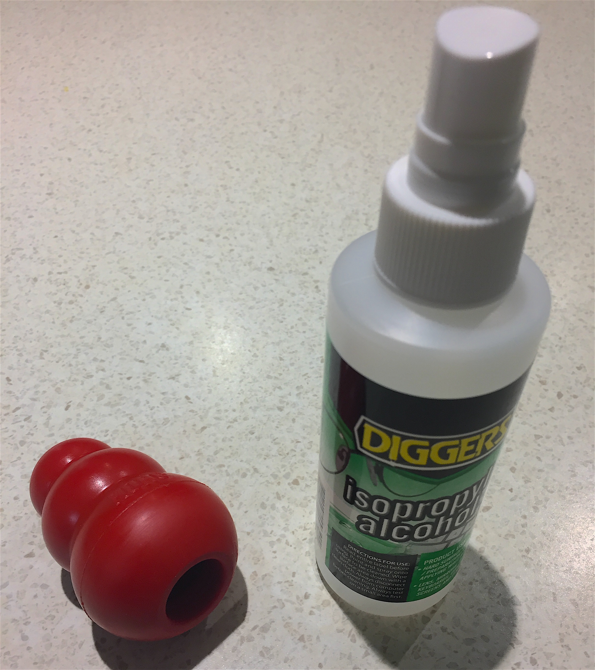

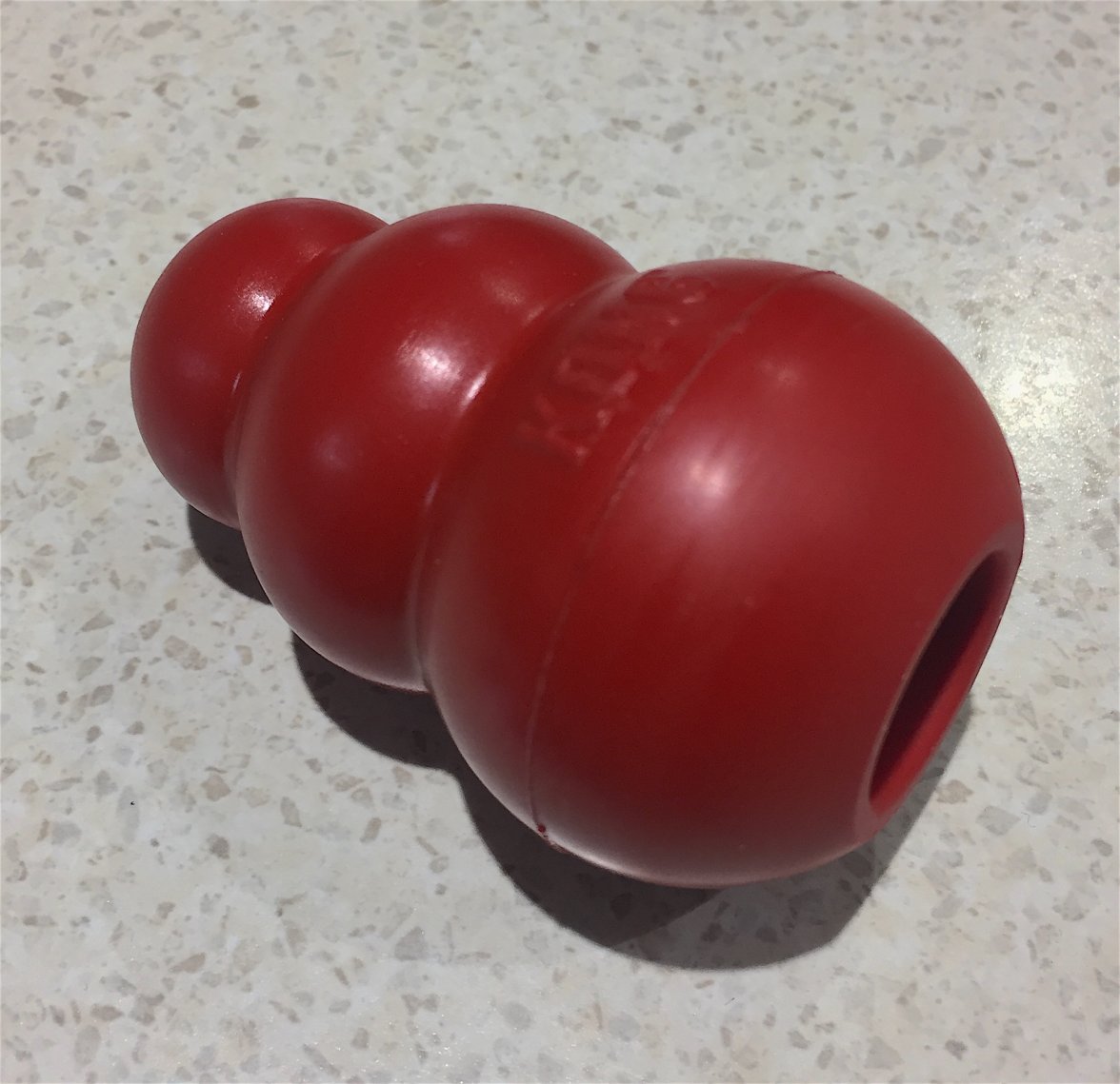

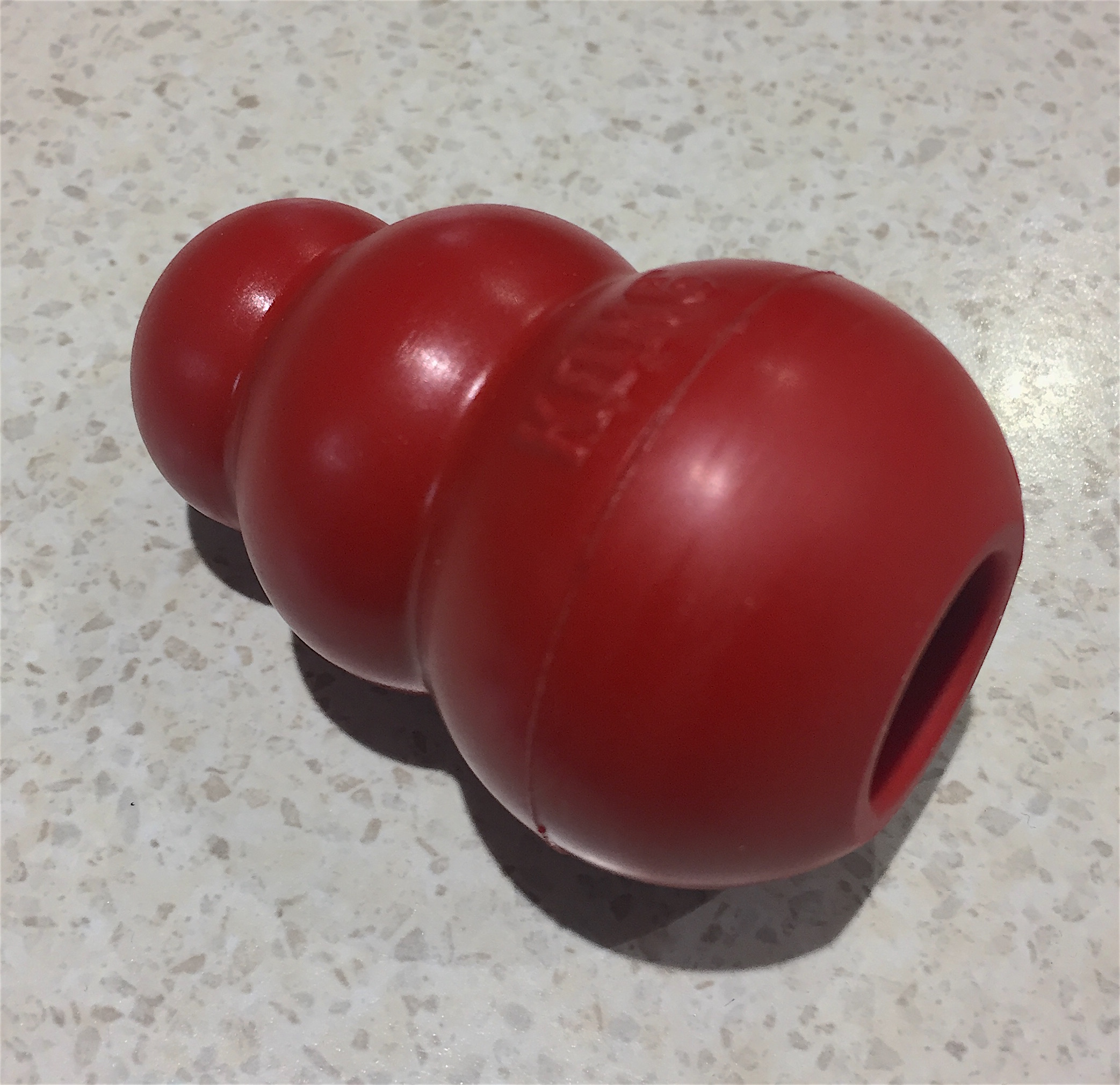

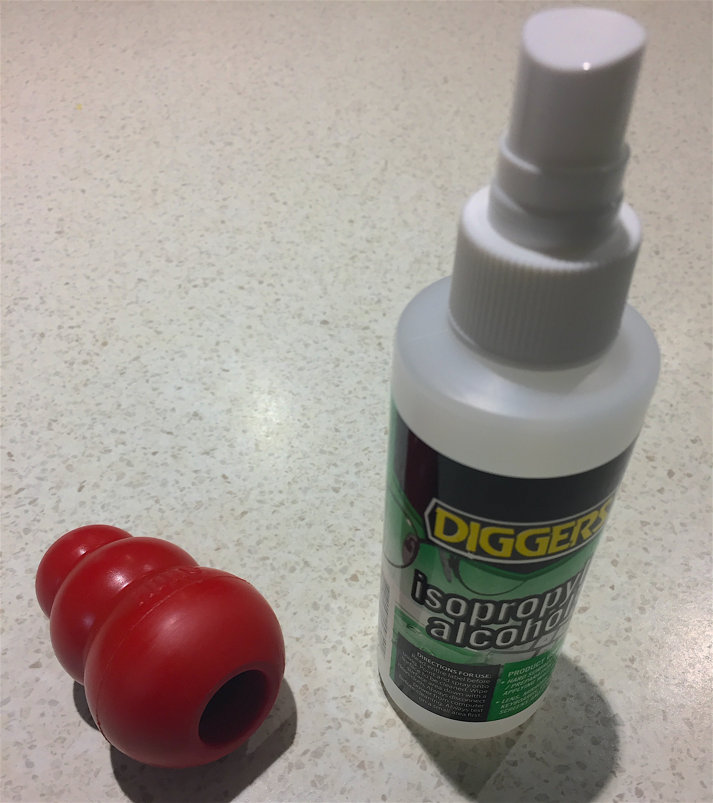

Just a tip with the Kong toy. They're heavily coated with a silicone mould release agent which is very slippery.
Give the base a good clean with something like isopropyl alcohol to remove the slippery stuff.
Here you can see the upper shiny part that still has the release agent residue and the bottom part where I've cleaned it off.

I love this as another solution! I will grab one next time I am at the pet store! I had success with the ball again last night, I inflated it a bit more and then it worked a treat on the second watch! Now I can get onto requesting an extract of archive, then to get it serviced....then to wear and enjoy 😀
