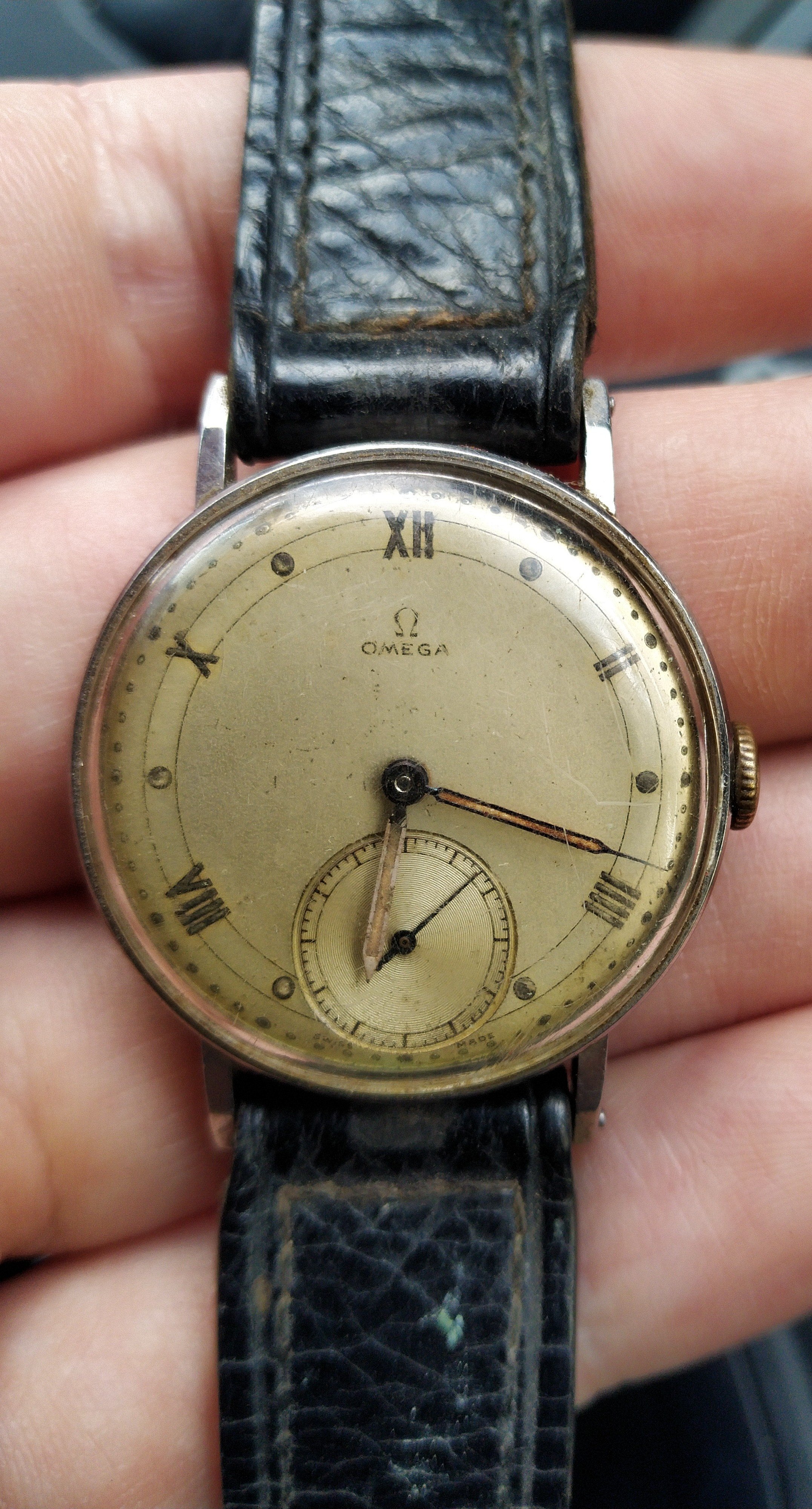

Good evening all,
I bought this yesterday after going through a huge watch collection that came into a local shop.
Now I know the fifth point of the pinned thread said to not open the case, but I didn't have a choice here, as the back was missing! It won't wind back, but the crown does come out and allows me to set the time.
I am in love with this thing, and it'll be a nice dress alternative to my 80s Omega Quartz. But is there anyway to find out what case it should have? The serial number just gave me a manufacturing year, being 1943.
Thank you Omega experts!

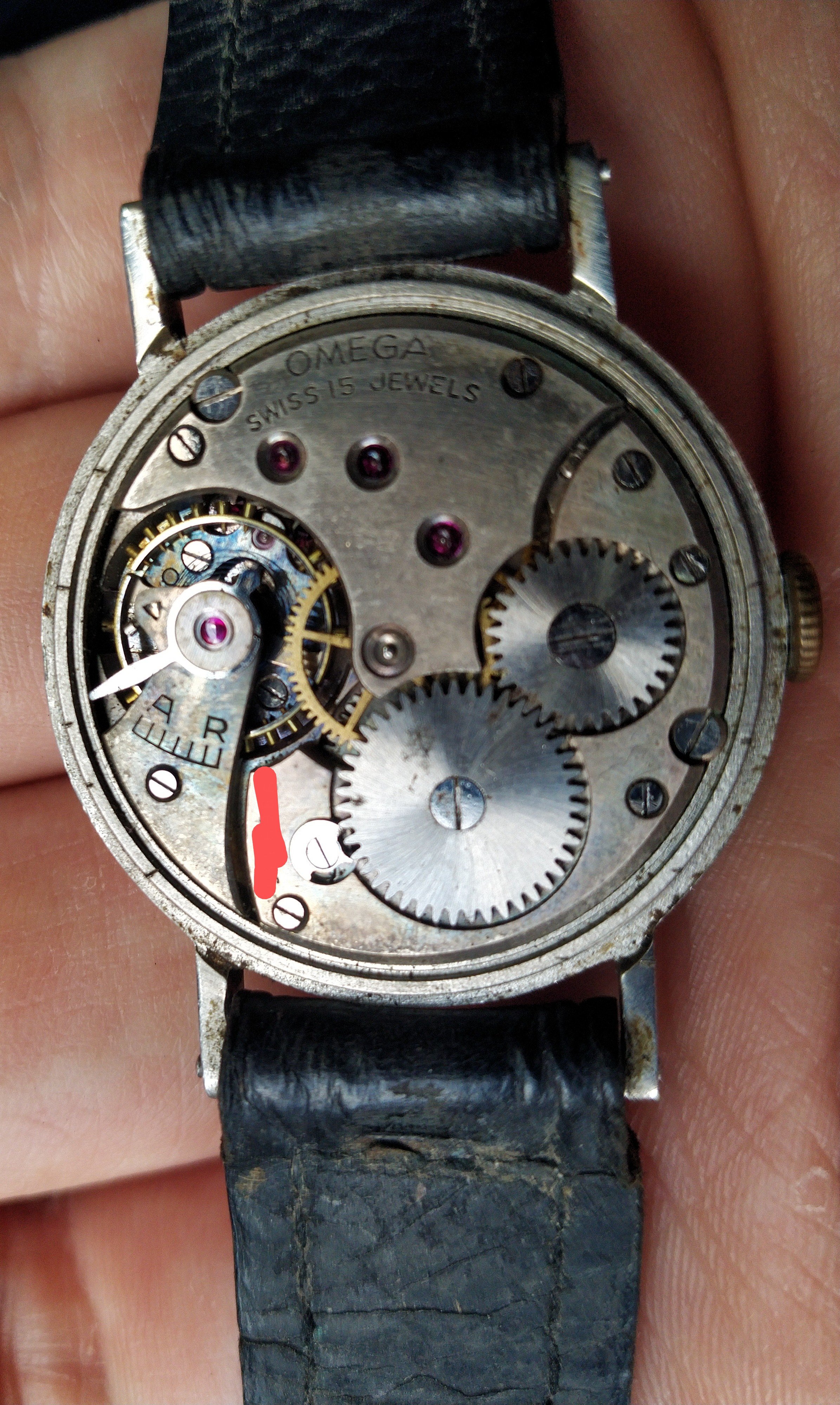

I think something like a 2180
That'd be a 30T2 then, right? I did a quick google.

I suggested 2180 based on the lug shape and dial style, but I think @gatorcpa is correct with movement being a 26.5 then it will be a different case reference.

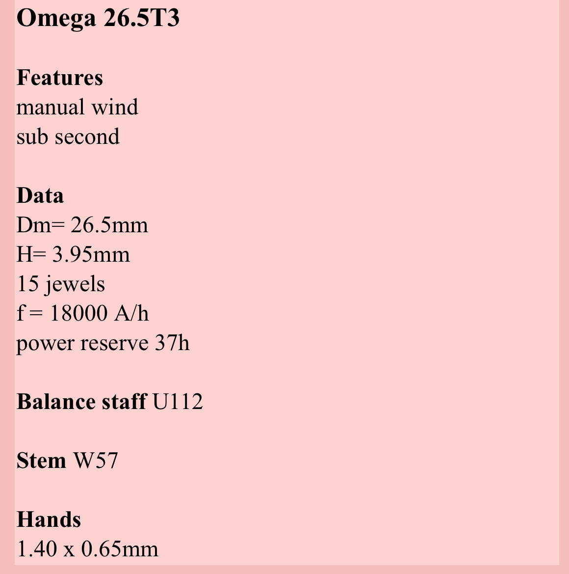

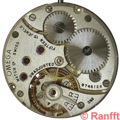

No, more like a cal. 26,5T3.

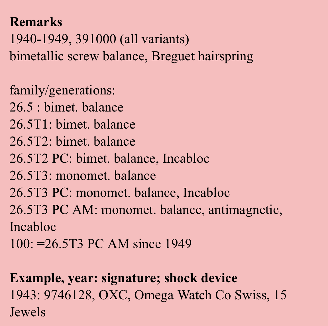

No, sorry...

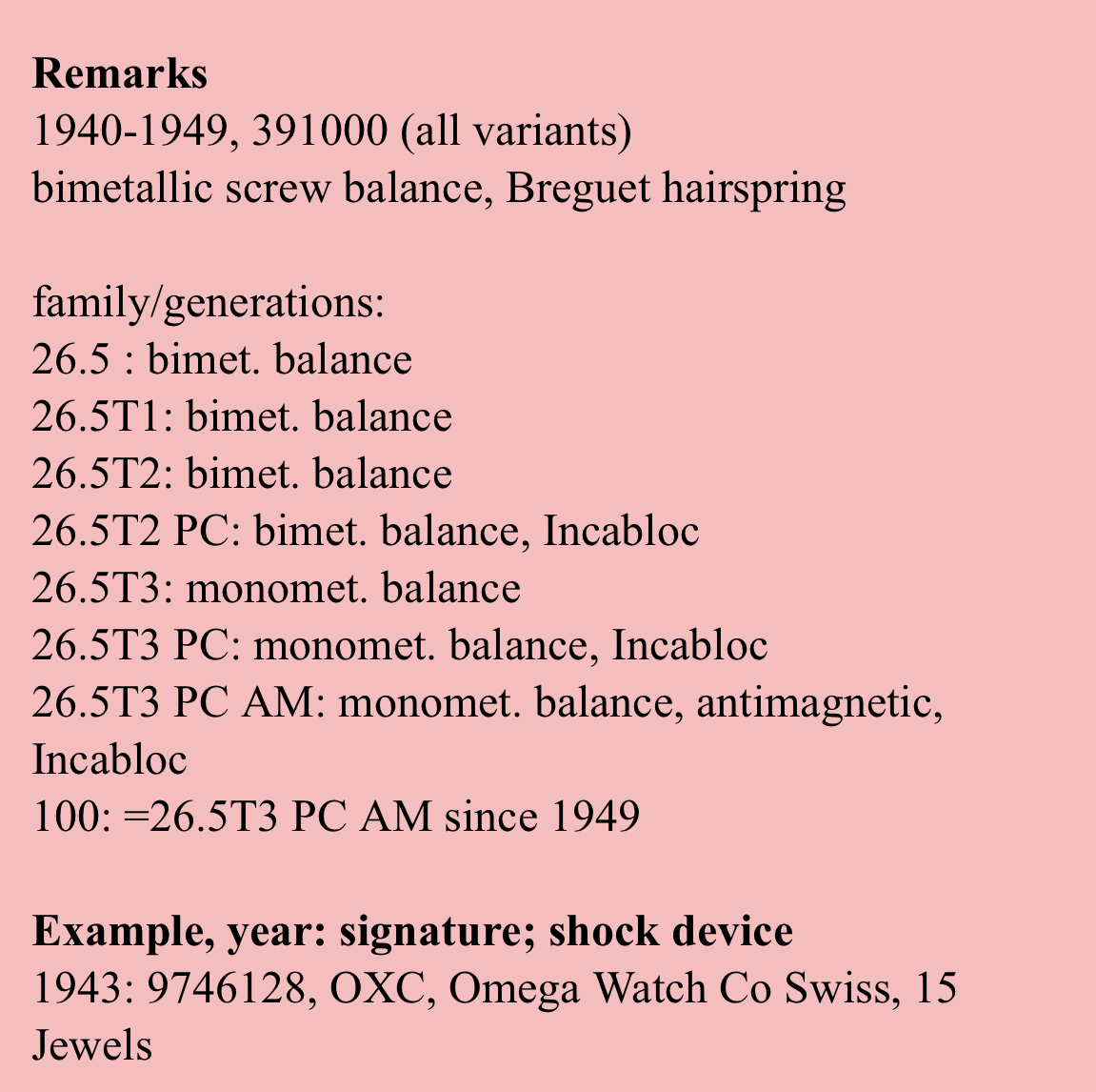

A T3 would have a monometallic balance.
More likely it is a T2 because the photo clearly shows a bimetallic balance.

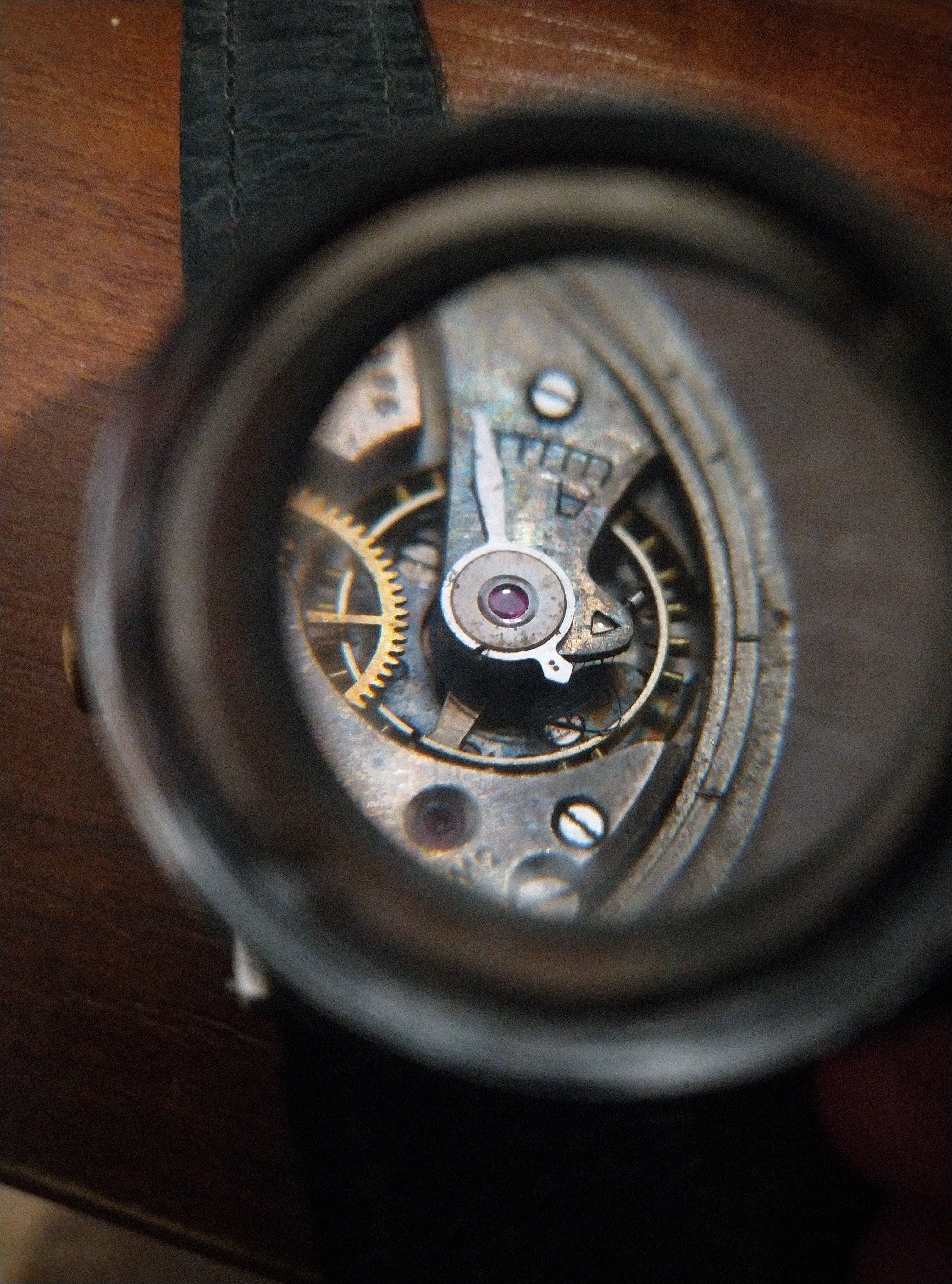

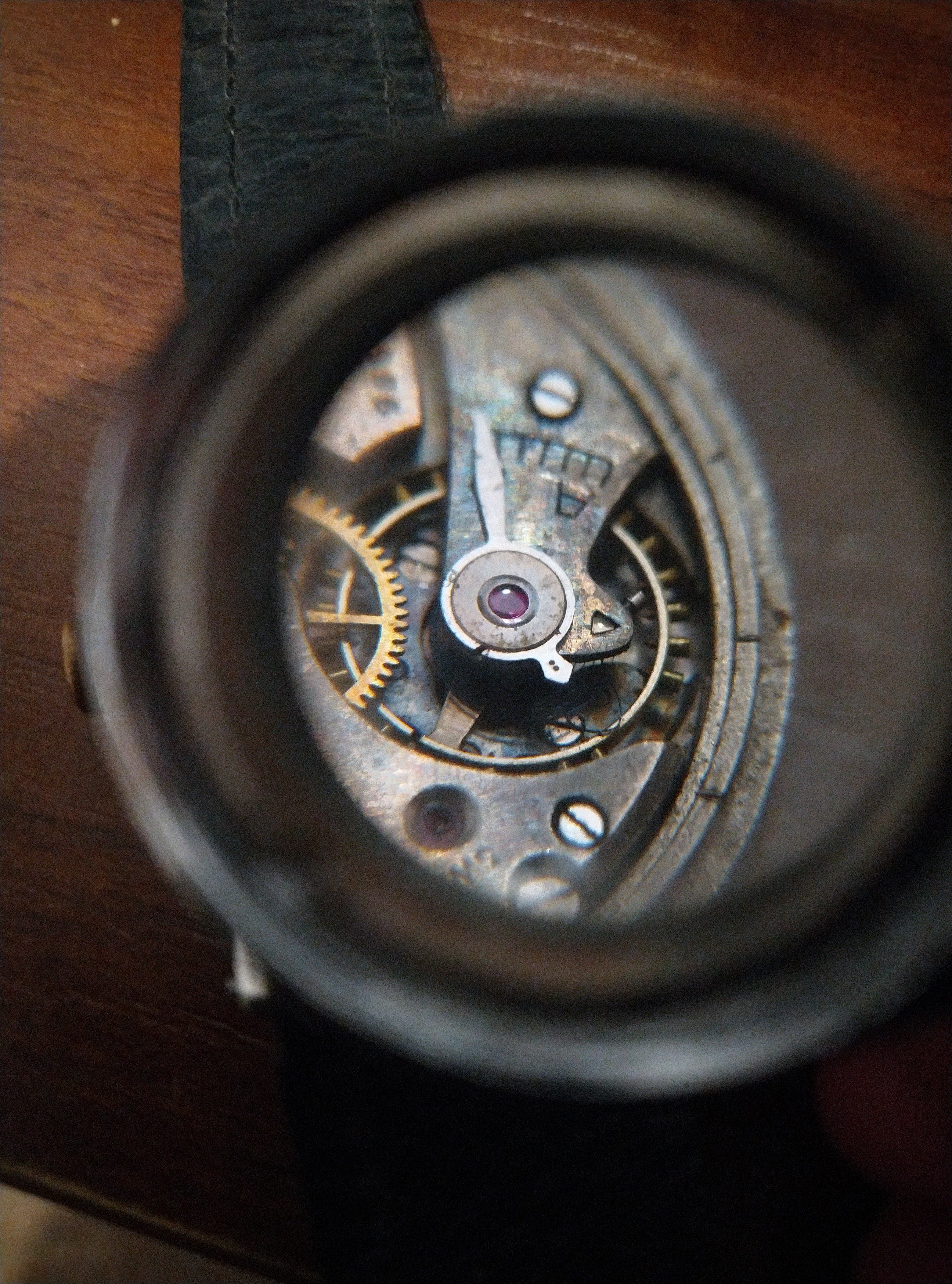

I really know nothing here, but I've looked at it through a loop just now and the small blue wire-like spring has a bit of it sticking up and out.
No, sorry...

Again, forgive my lack of knowledge and experience, but google tells me that's the balance spring that I'm looking at?
Yes, complete balance with spring.
And that little bit of spring you can see bent or curved over the wheel is bad, right?
Yes from what I can see the piece of the hairspring looks badly bent - you are correct.
My comment was a response to @gatorcpa´s. He thought it was a caliber 26.5 T3 but it is a 26.5 T2 (or T1, rather unlikely) going by the type of balance. The balances between T2 and T3 are different. Hope this helps to understand now...
