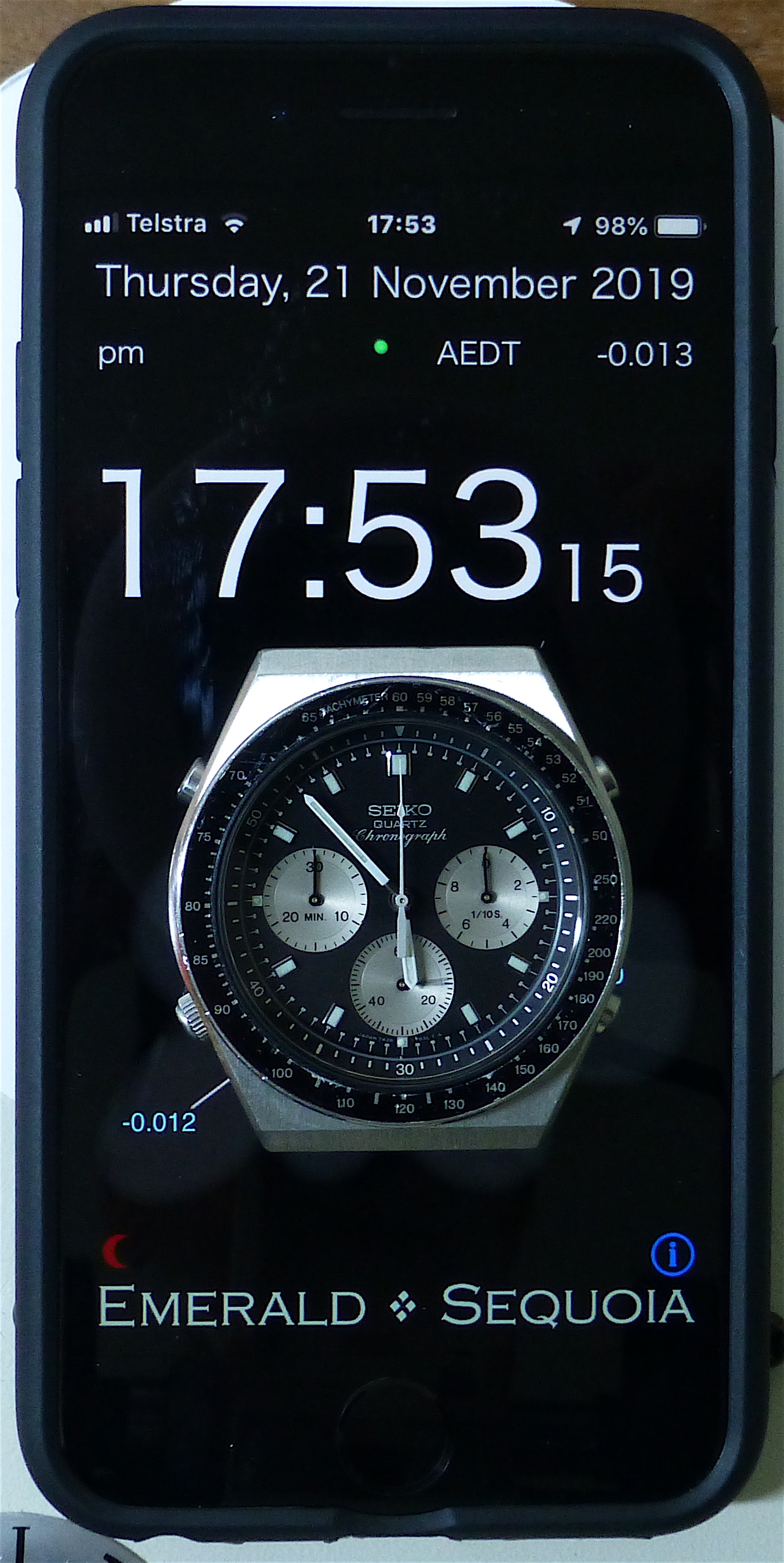

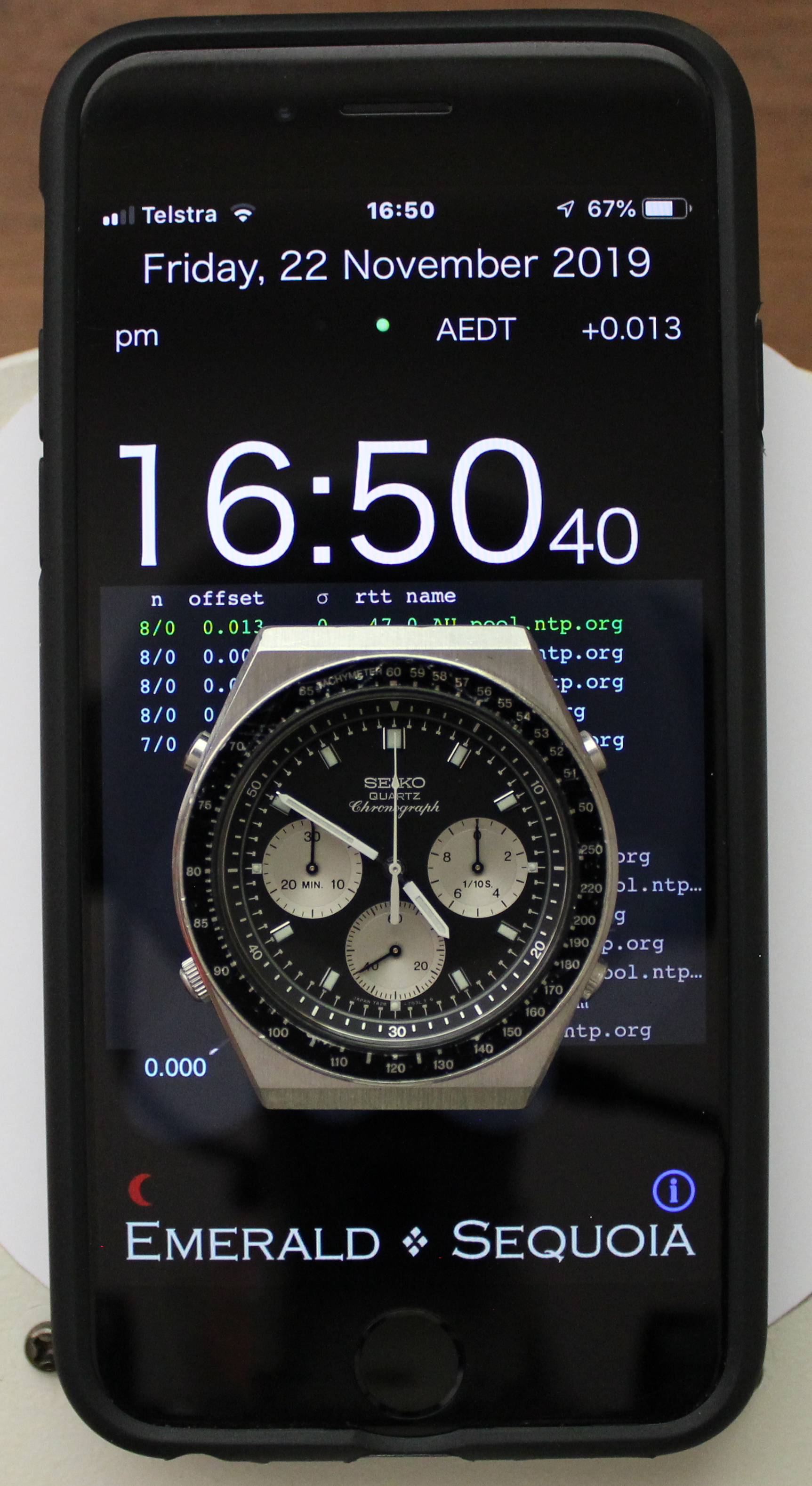

After a few days testing I'm calling it done.
Keeping time to within one second of my phone clock.
So tomorrow it's off back home to it's patient owner.

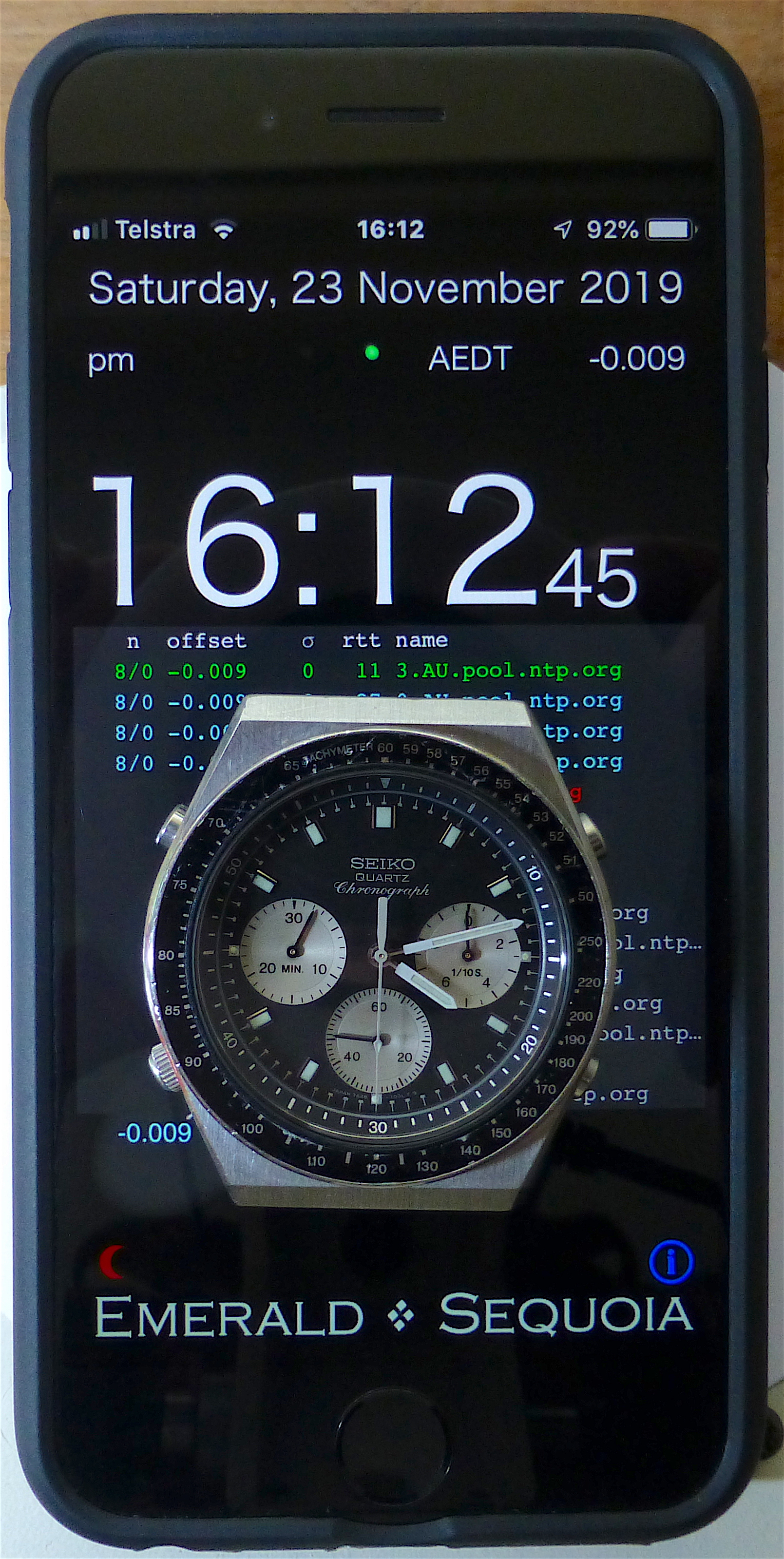

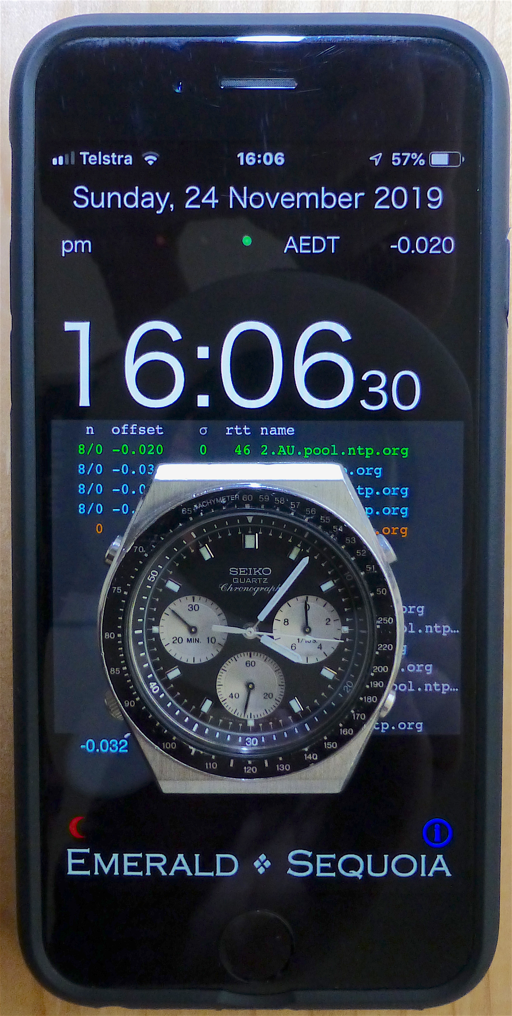

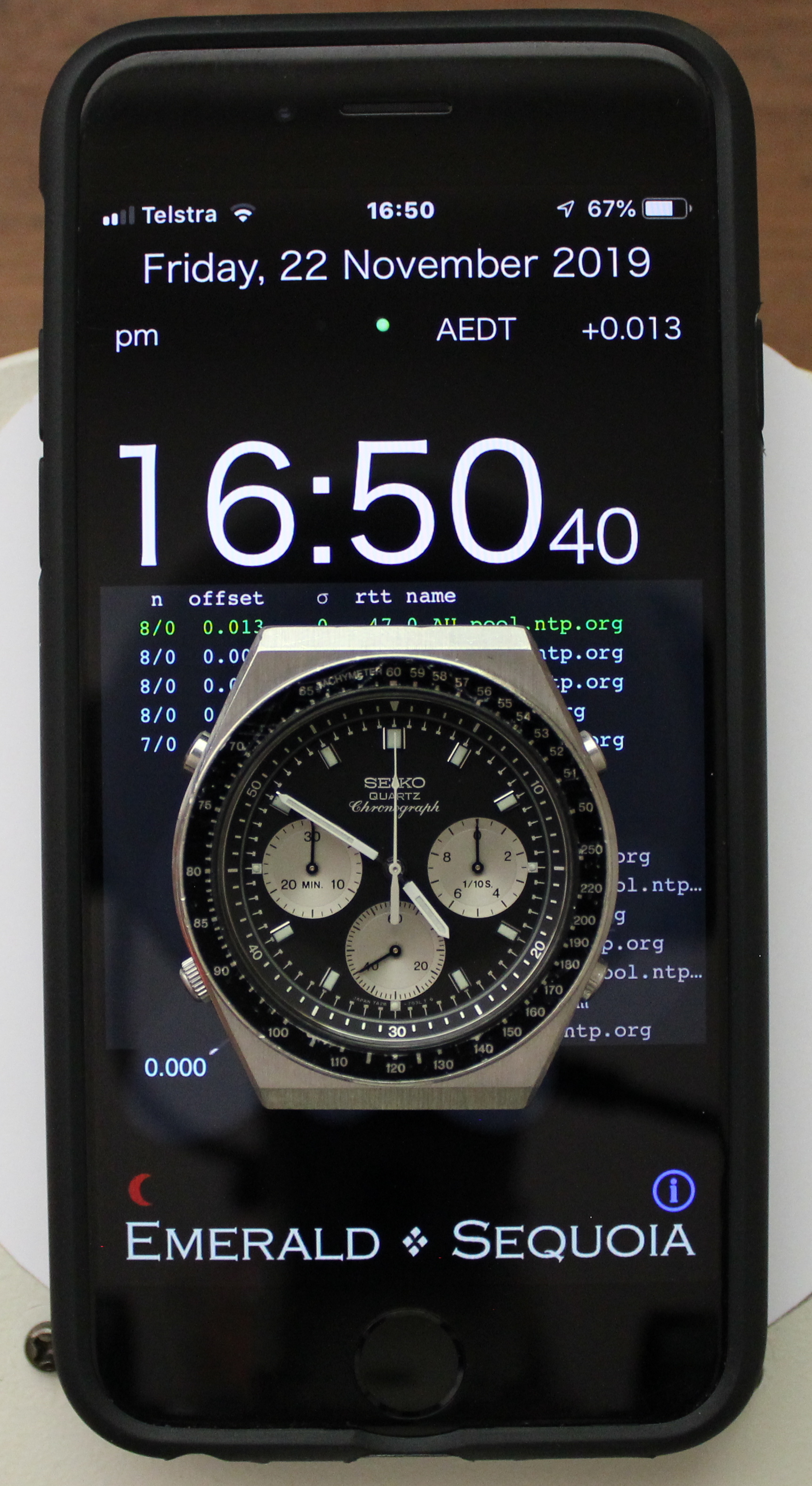

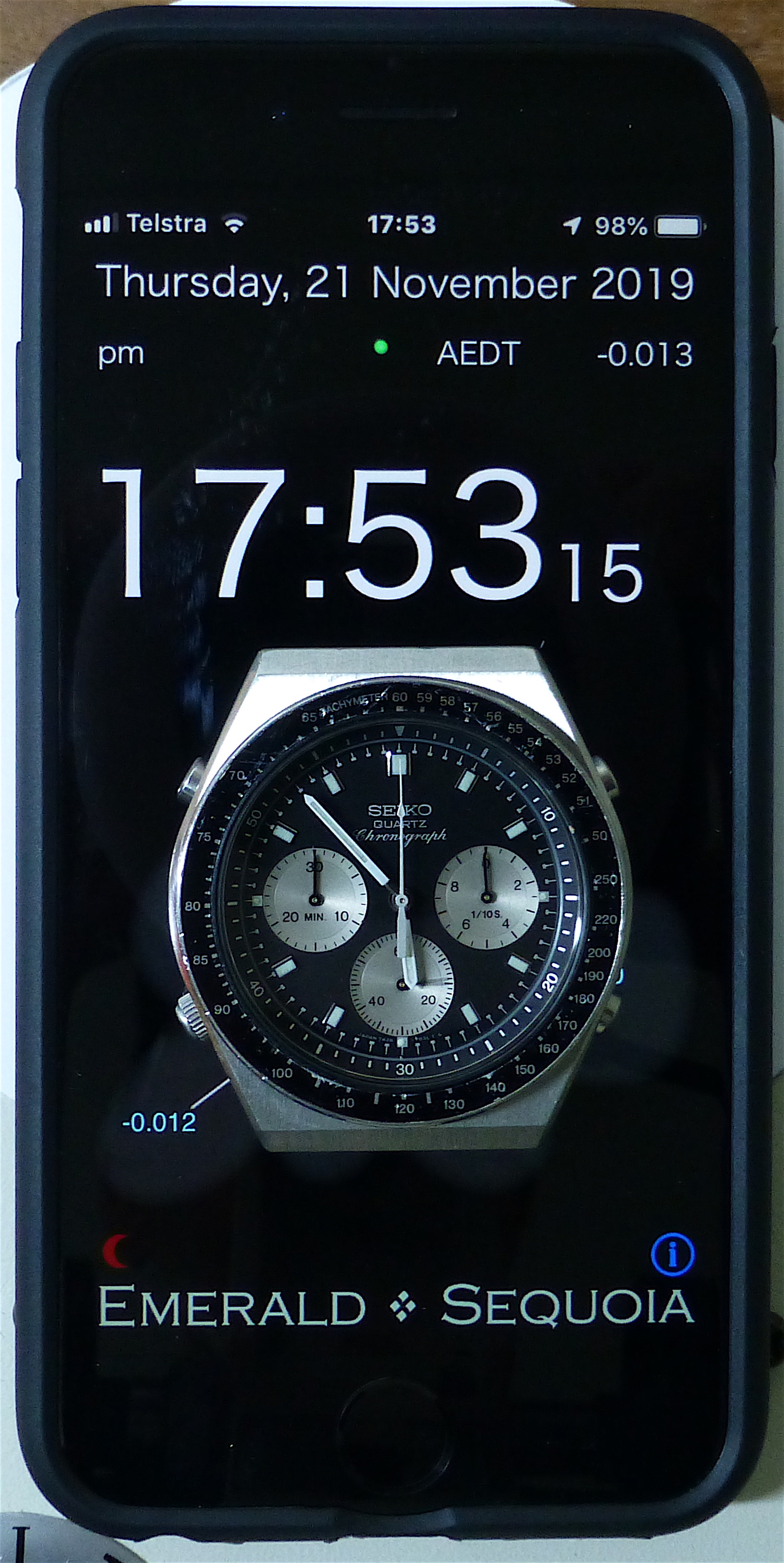

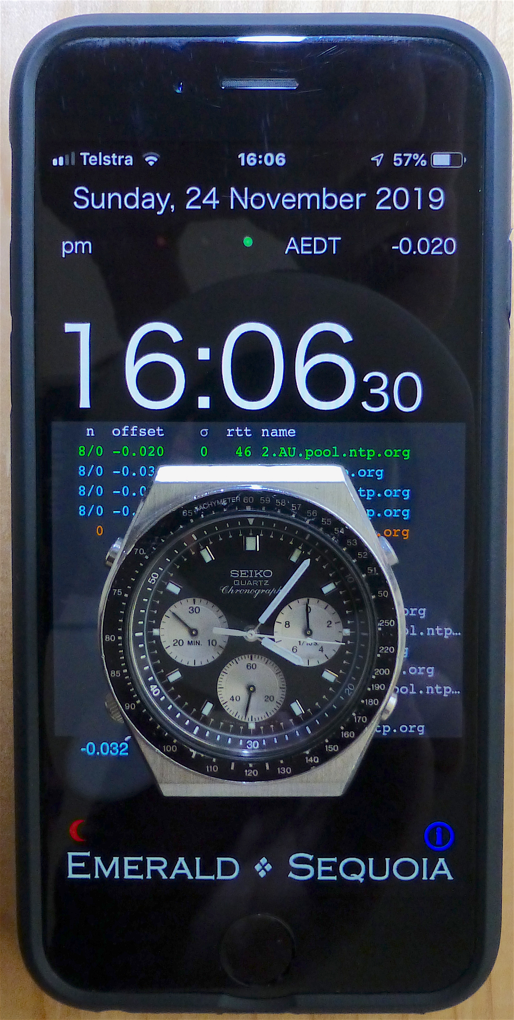

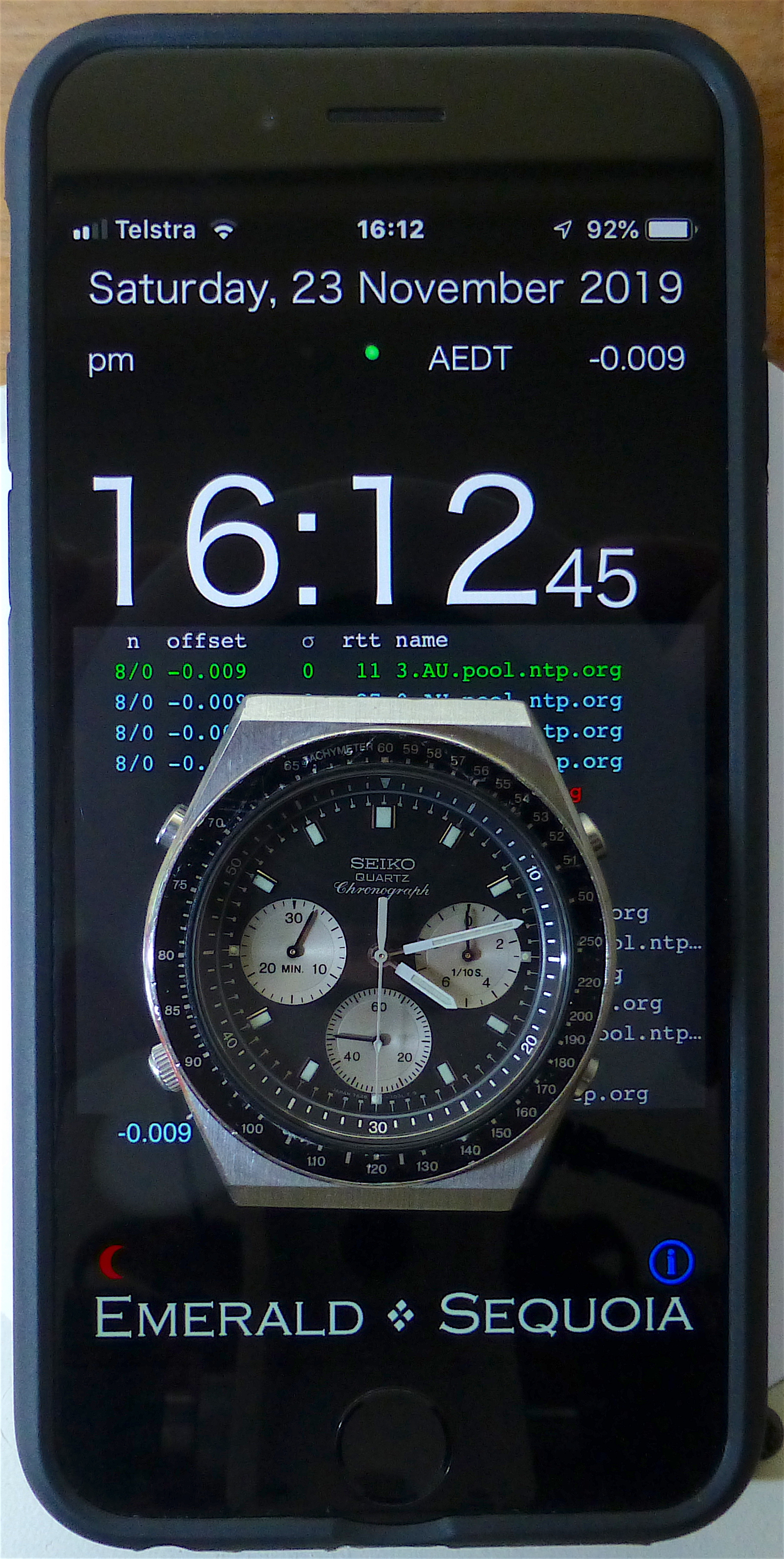

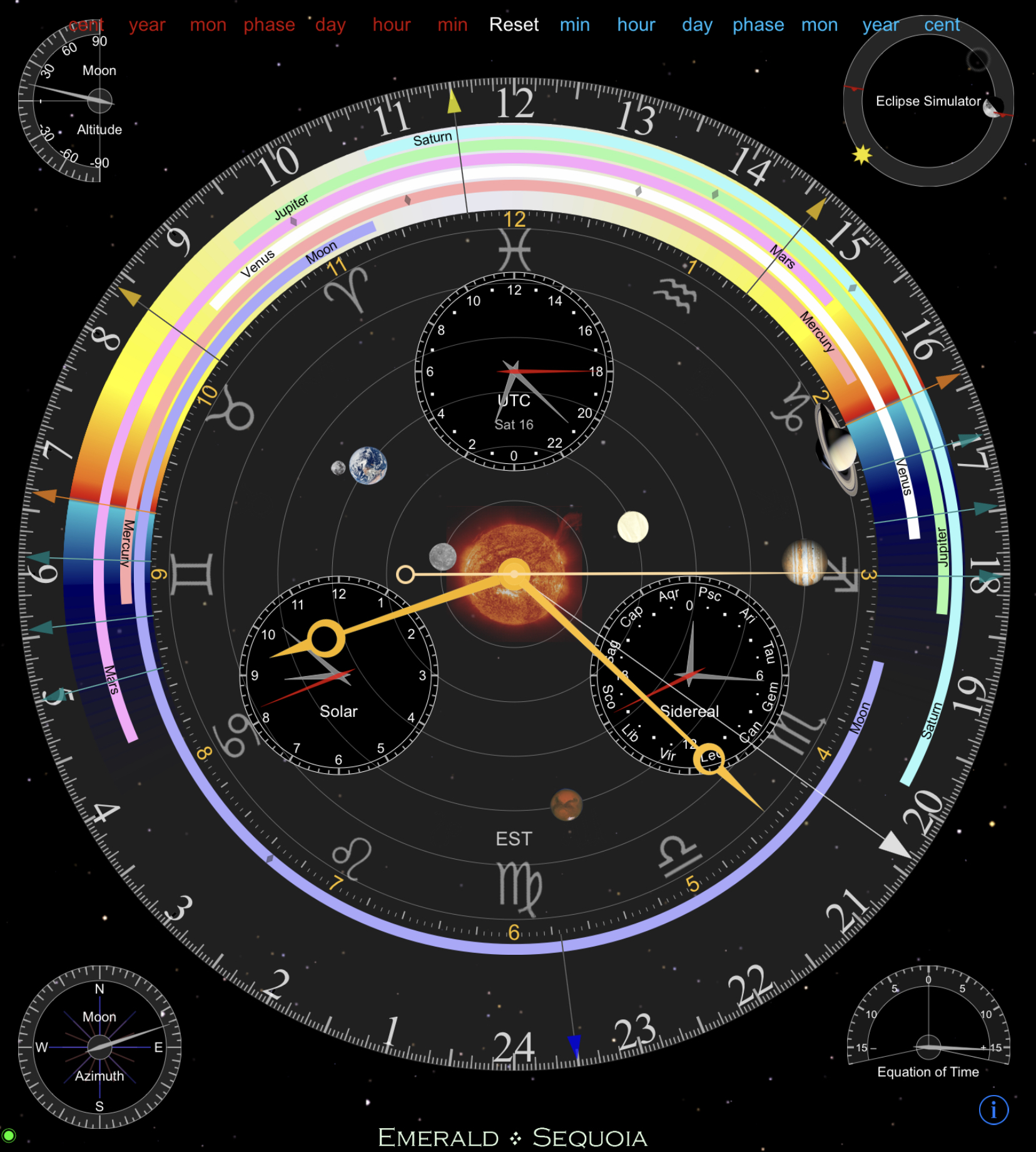

What's the app?
18,730
38,879
What's the app?
Not really a timegrapher style app, just one of the Emerald Sequoia time apps.
I set the watch to the time, take a shot, wait 24 hours and take another etc. Then see how far out the second hand is each day.
479
4,727
I use that Emerald Sequoia app to set my watches too as the phone time tends to be off. They have a nice orrery app too:

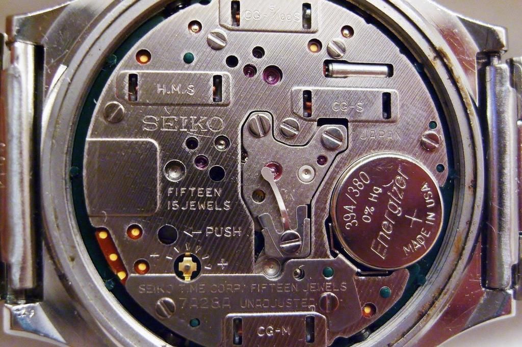

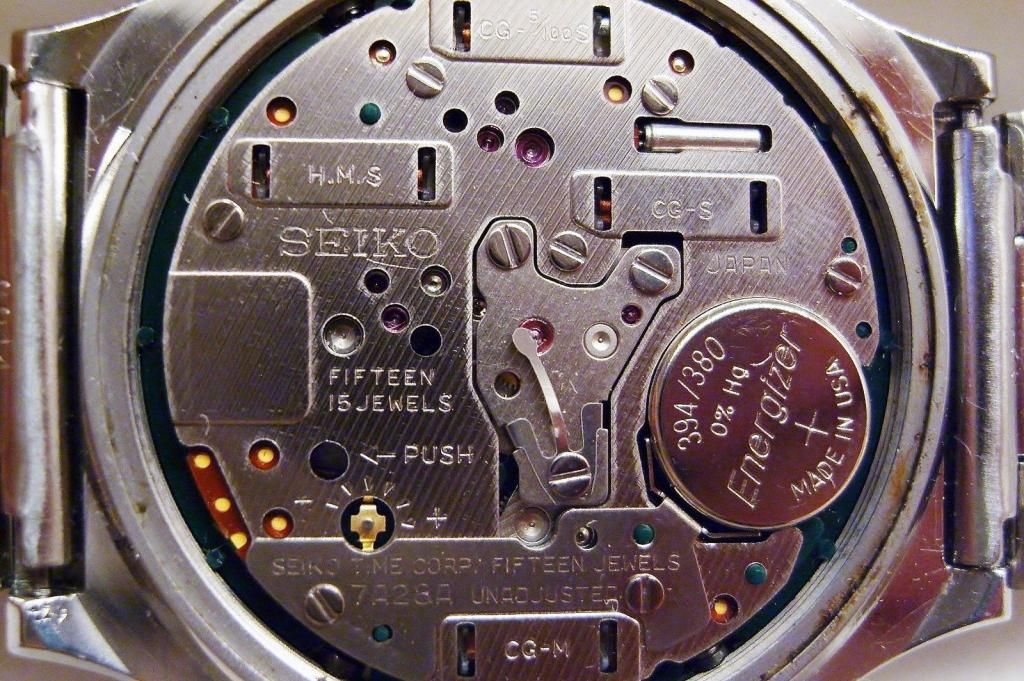

After cleaning around the caseback with a pegwood stick and a brush, it鈥檚 removed to get a look at the movement.
Thanks for documenting the process along with the photos! I got one comment - on the picture above the center leaf spring is missing which is often the case on these movements. There is no photo of the assembled movement so I am not sure if you sourced one or were not aware that one should be there.
Check this photo, it is the leaf spring in the middle (bent out of shape in this case). Hope it helps!
18,730
38,879
Quite correct!
It was the second component I removed (after the battery) and it was re-installed as the last thing after checking function (and checking again).
I think it can bee seen in the parts tray in some shots.

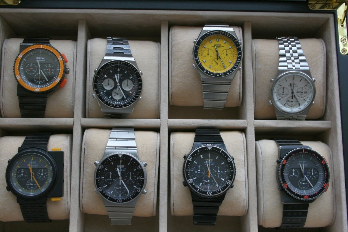

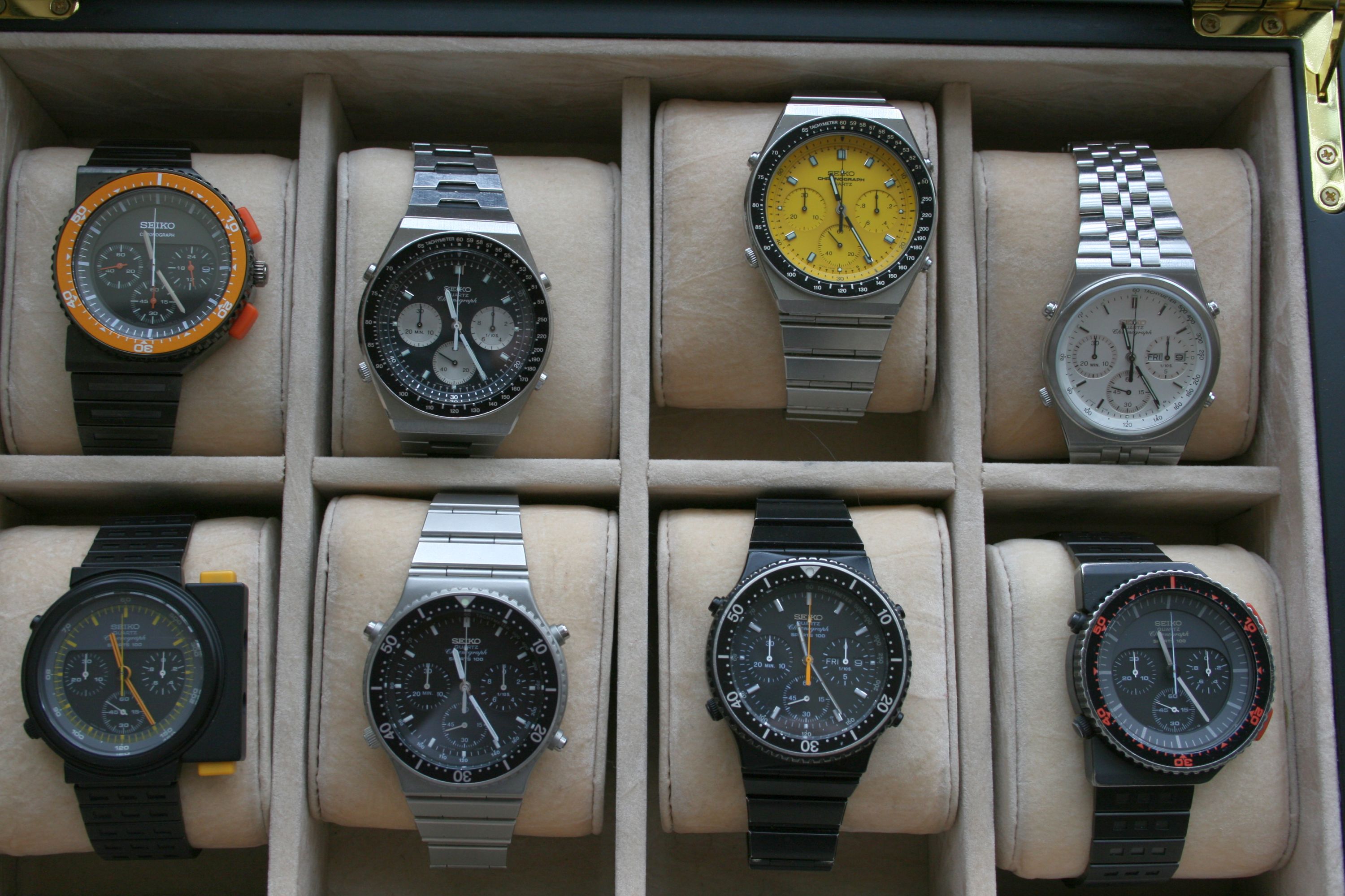

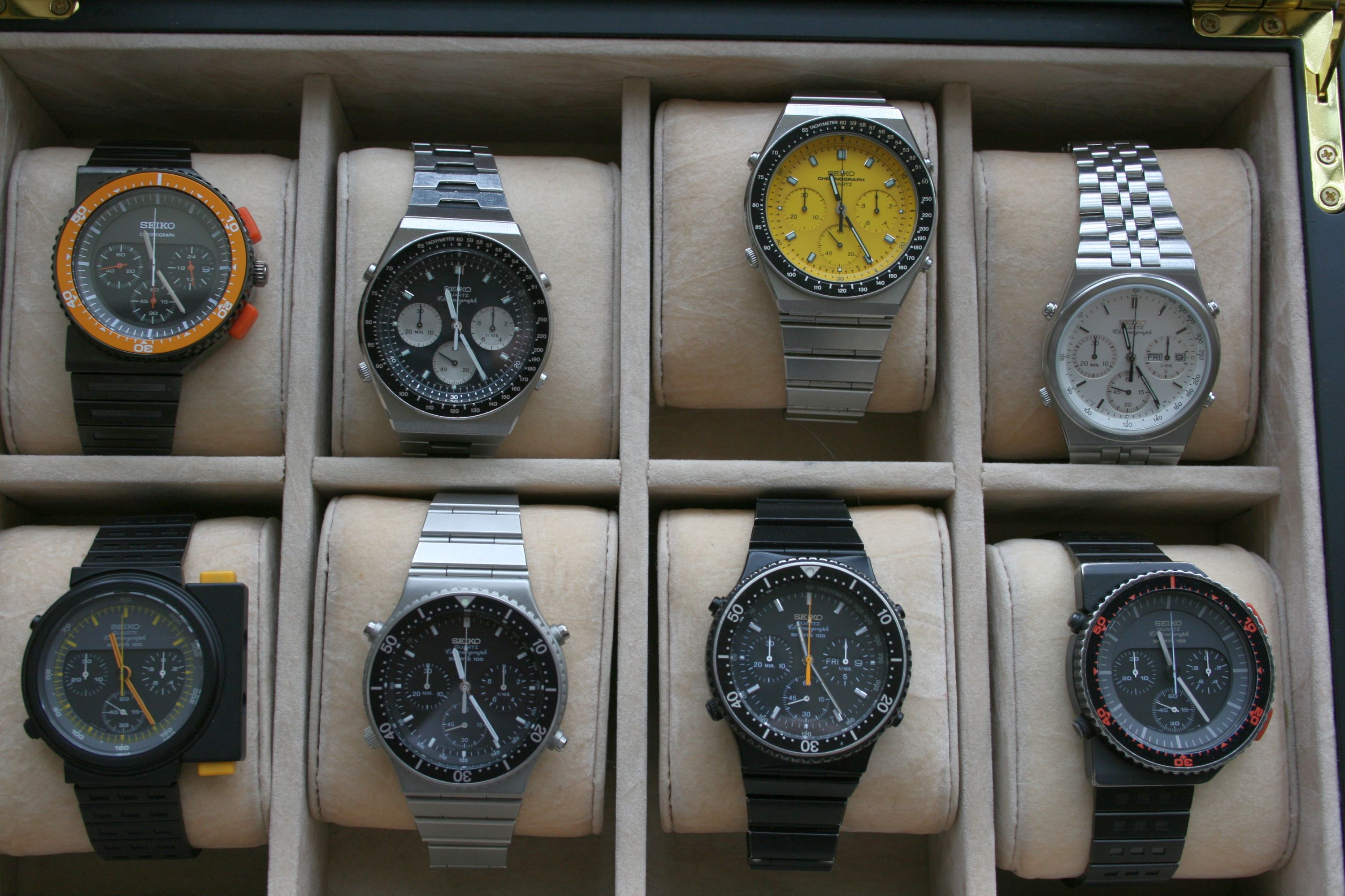

Great to see a fantastic 7A28 coming back to life. I've rebuilt a few 7A28 and thought they were quite decent to work on.
A few of mine........
