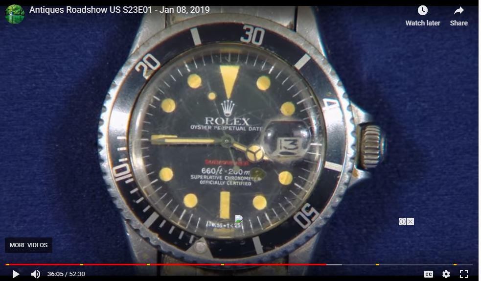

Is it just me or does the 1680 look a little weird here? I think it may be crystal distortion or something, but it looks closer to a rail dial than the normal 1680 dial from some angles. The bezel ring also looks a little off - thicker than normal and less sharp. Not saying the 1680 isn't authentic, as it clearly is accompanied be rock solid provenance...does anyone else see what I'm referencing though?

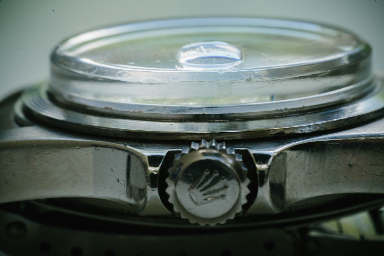

I think its just a combination of the photographers lens and the wrong crystal...all looks good. The insert is replaced though, and it looks like the crystal is domed, causing the distortion.

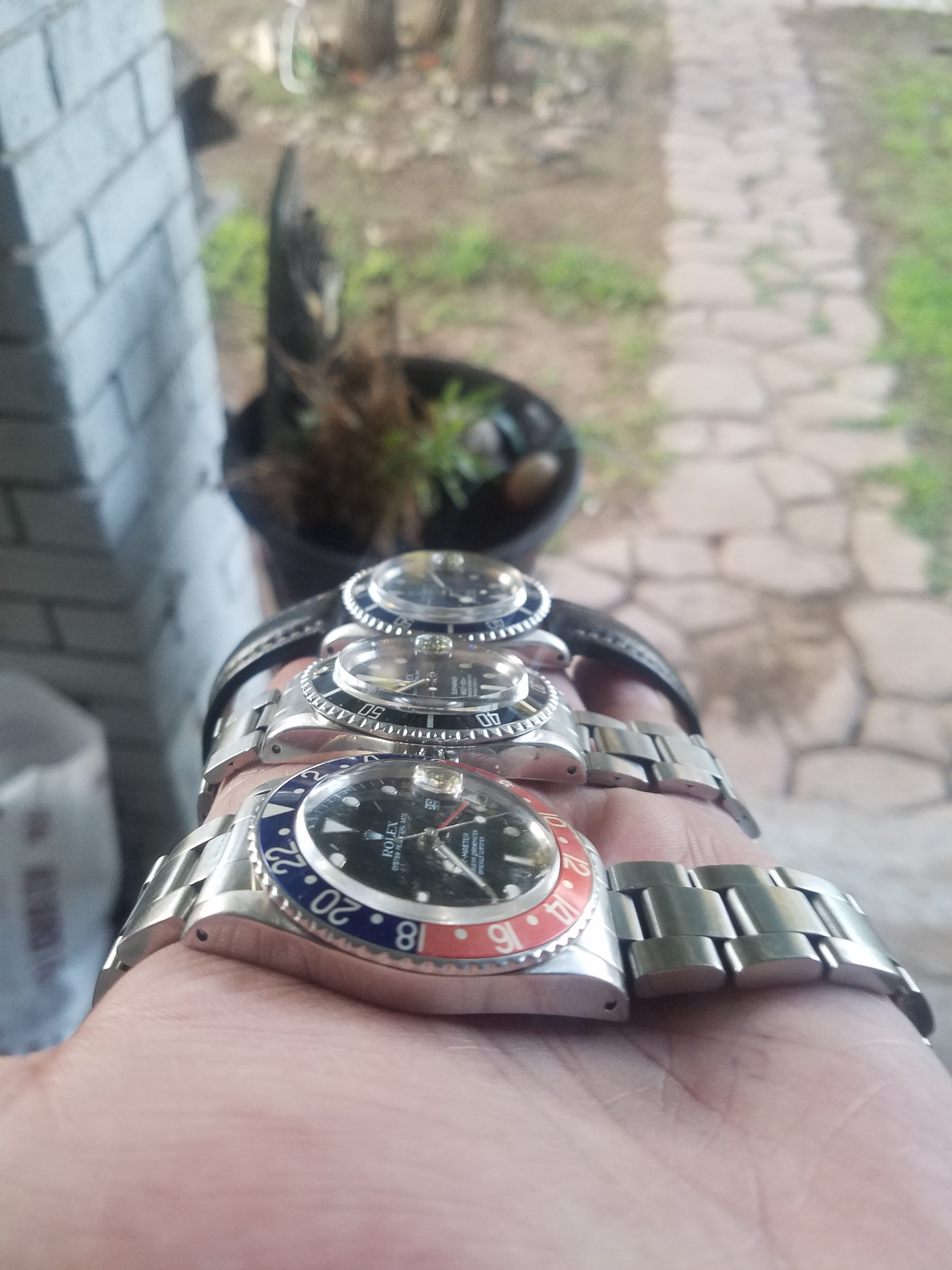

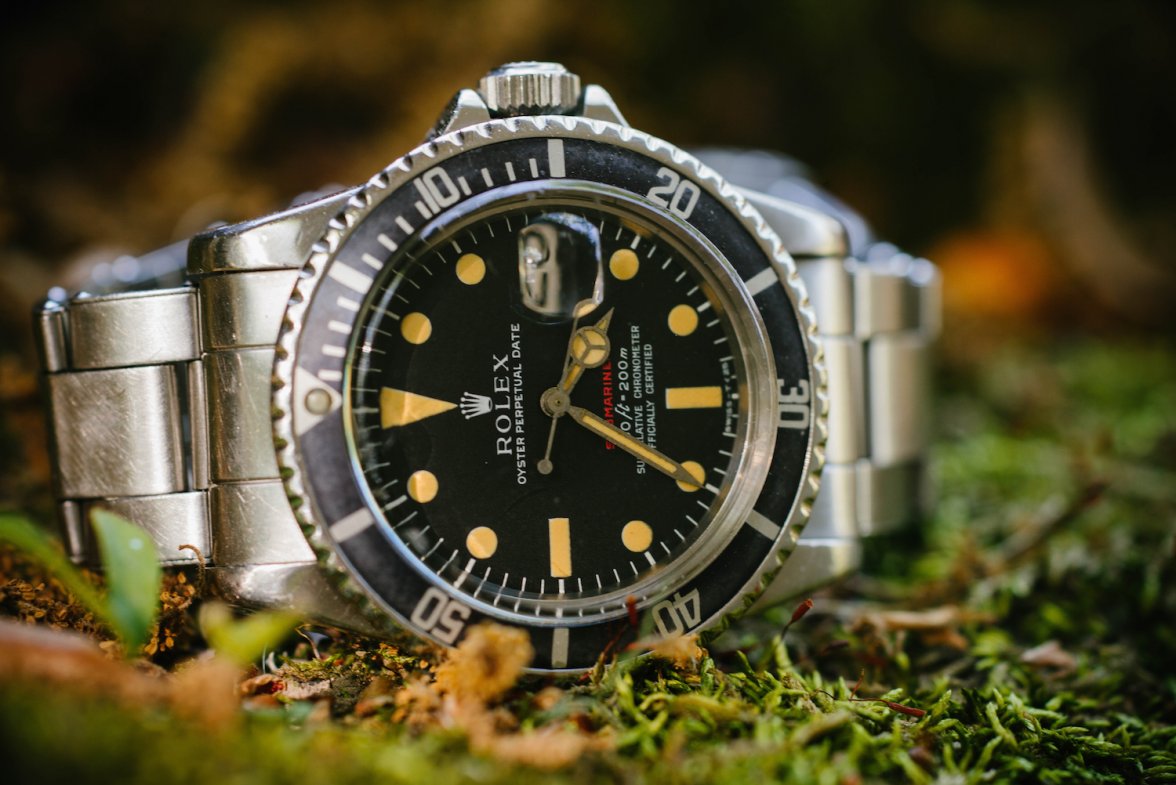

Here is mine for reference:
2,680
9,840

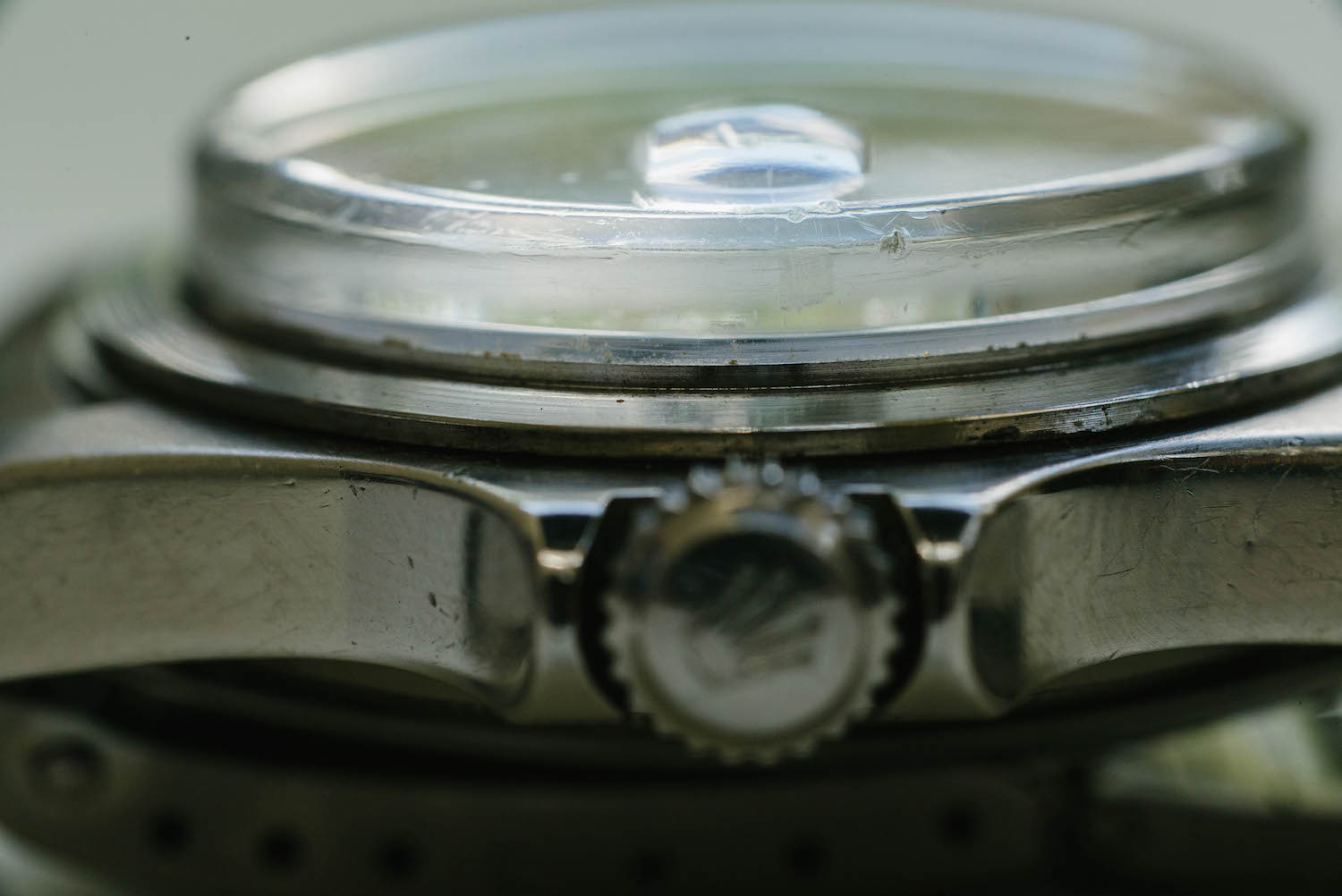

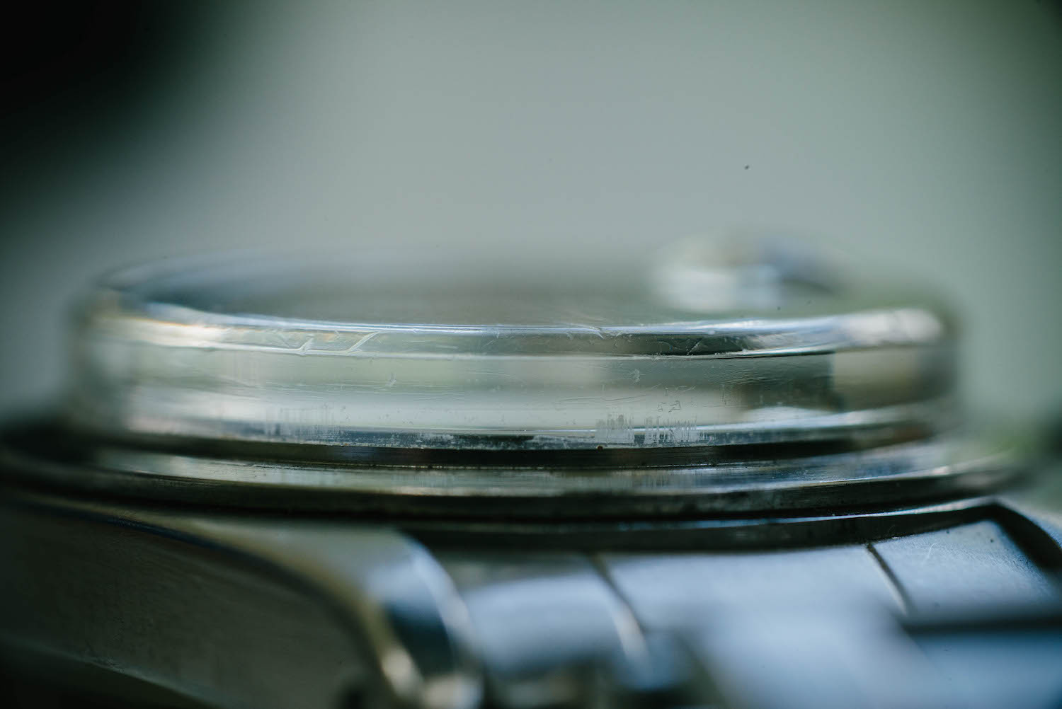

The correct crystal is referred to as a "top hat" Tropic 127...the crystal on the Roadshow 1680 appears to be a super dome style and its why the dial looks off...its distorting the outer edge and making the dial look small.
Mine is the actual period correct crystal with beveled edge...the service crystal, although flat lacks the larger bevel.
Its amazing how the wrong crystal can completely change the look of a watch (and its value). In the case of the 1680...the top hat fetches about a grand, if you are lucky enough to find one. But it looks so much better.
The 5513 and 5512 use a super dome...same thing, it completely alters the look of the watch when the wrong crystal is installed. Im anal about my crystals...the wrong crystal bugs me 😀
Speaking of Bob Ridley, he can modify a crystal to alter its appearance and make it look closer to the original...of course this can only happen with a select few models, but he created a super dome for a 5513 that looked exactly like the original which is no longer made to the original specs.
