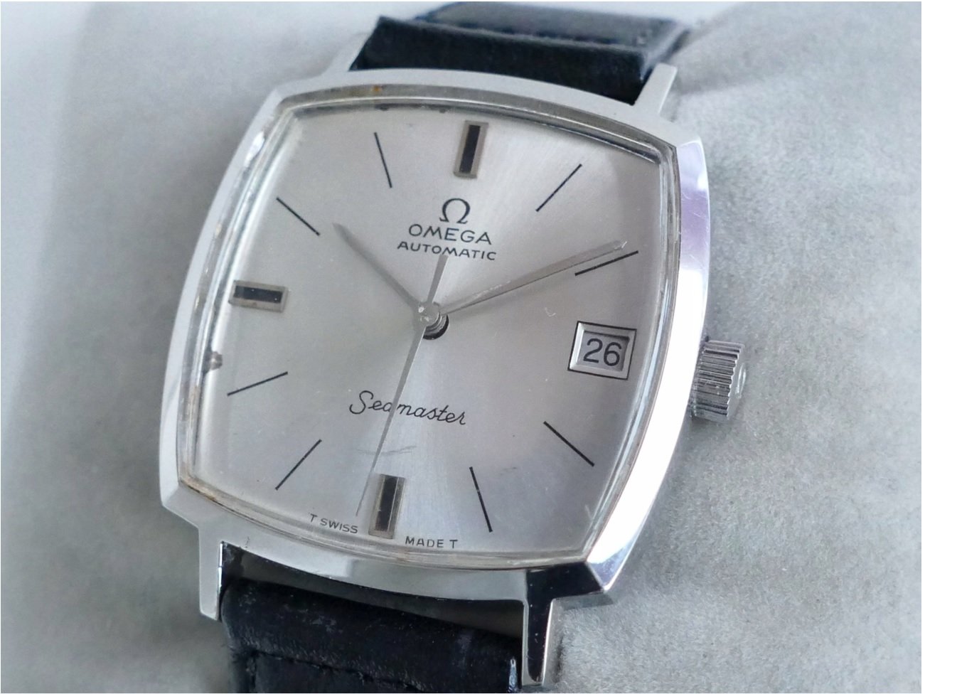

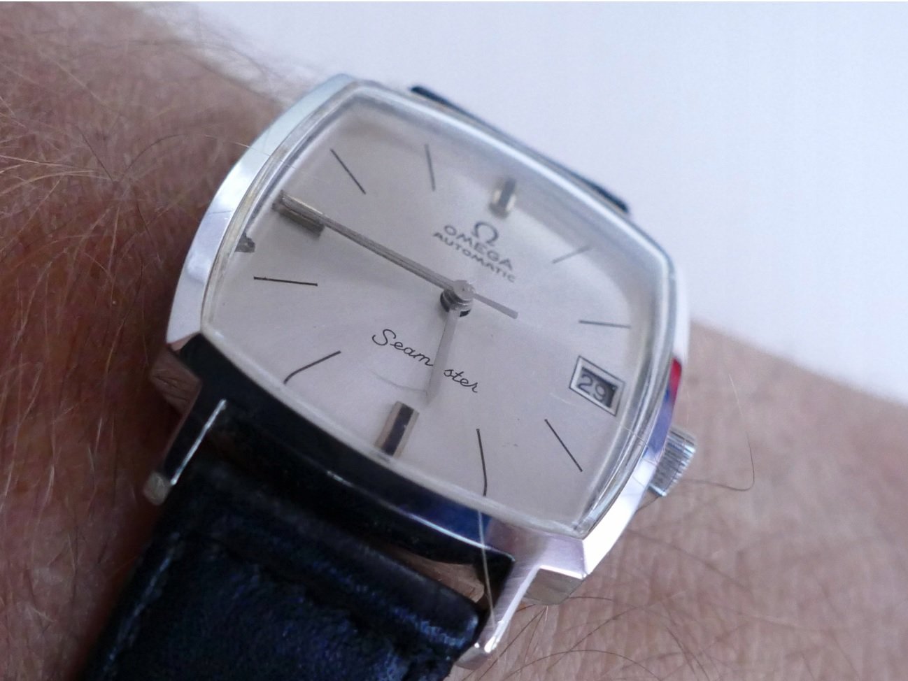

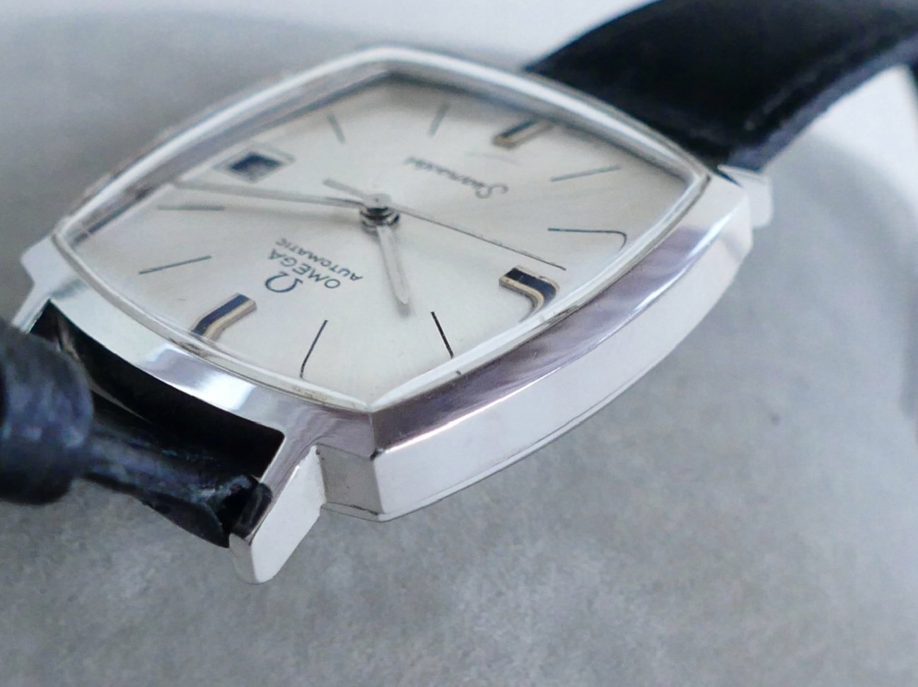

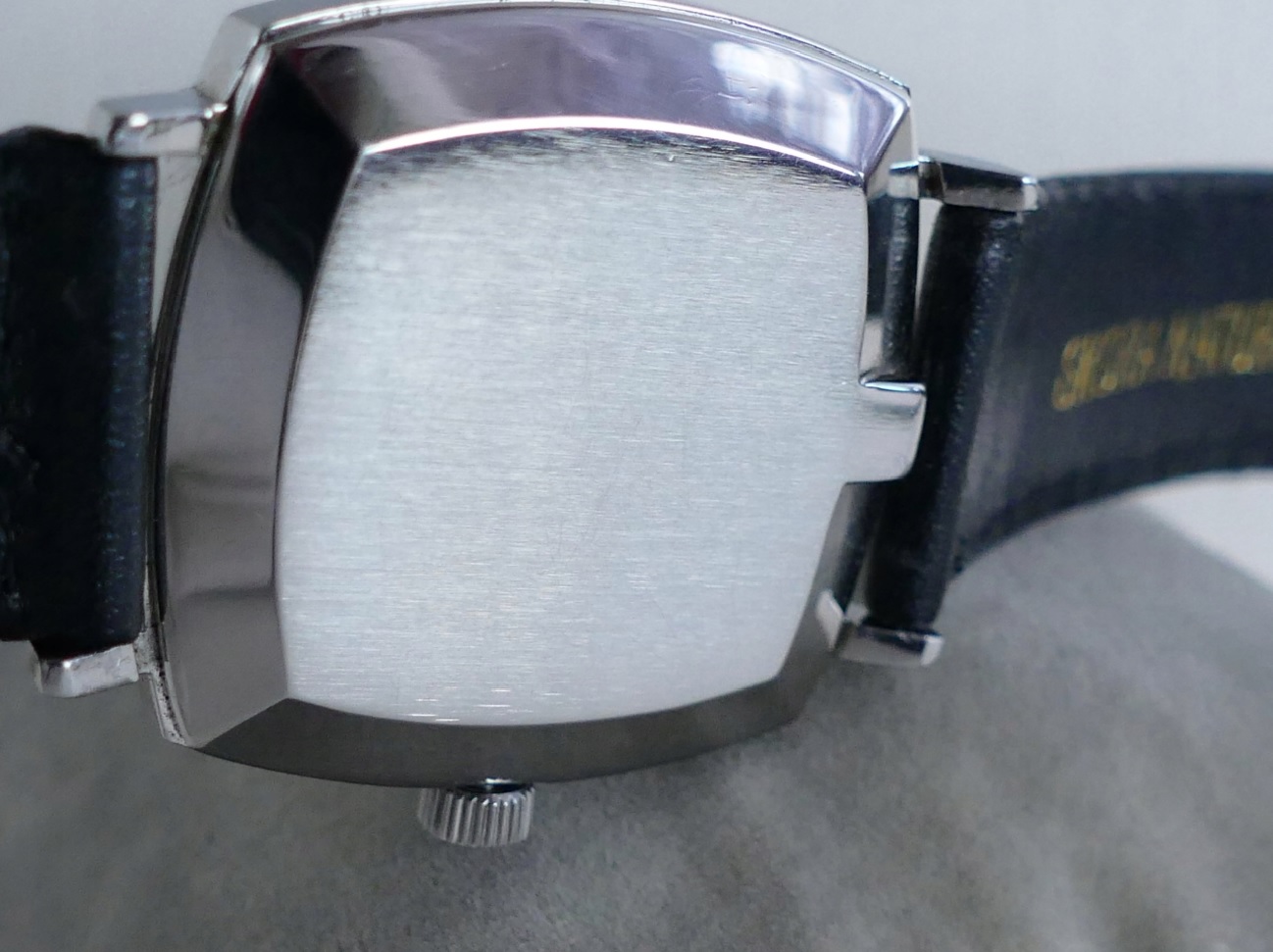

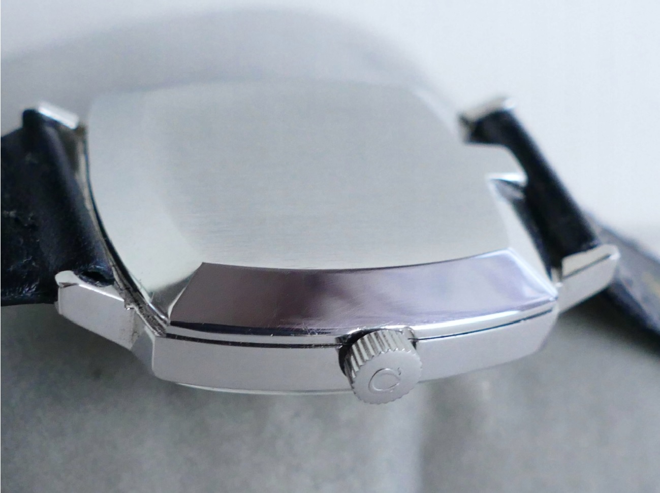

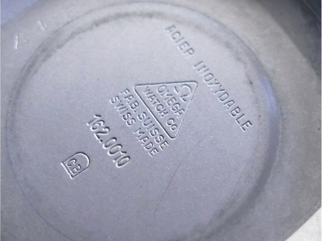

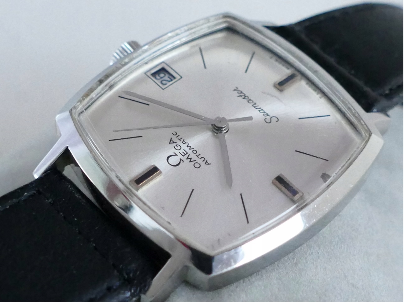

Posts 8 Likes 0 Jarek3050 路Oct 14, 2019 Please help me figure out what is wrong with this watch. I can't find such a seamaster.
Posts 282 Likes 1,229 Henneth 路Oct 14, 2019 Jarek3050 Please help me figure out what is wrong with this watch. I can't find such a seamaster. Do a Google search with the ref number 162.0010 馃憤

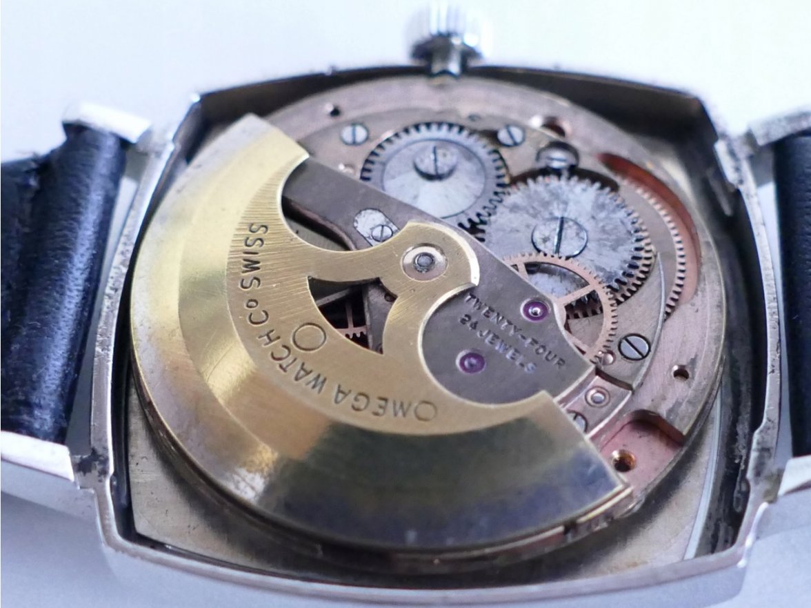

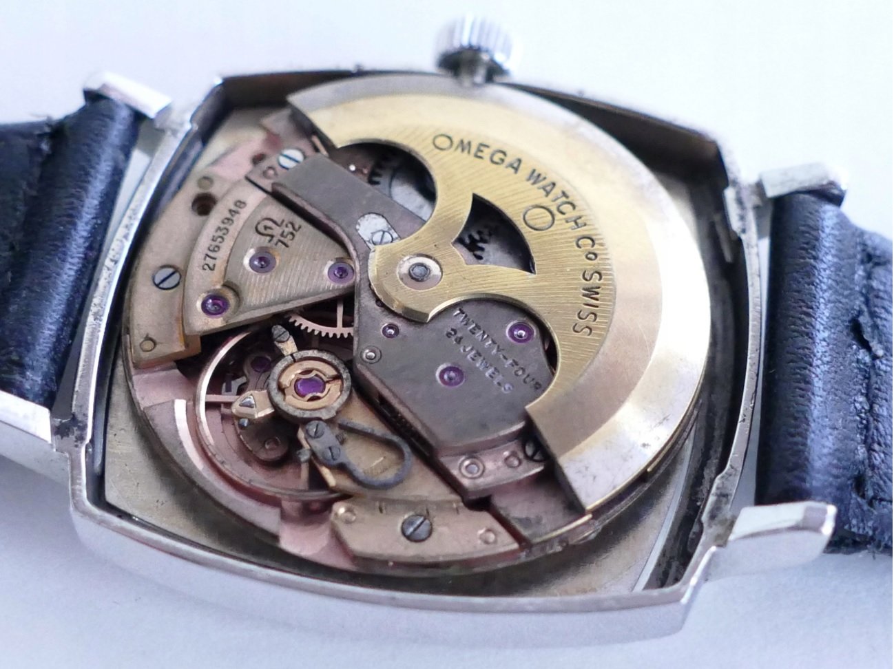

Posts 18,840 Likes 39,182 JimInOz 路Oct 14, 2019路Melbourne Australia Jarek3050 Please help me figure out what is wrong with this watch. I can't find such a seamaster. That's because it's a Gen猫ve, not a Seamaster. It also has a dog of a movement, not the correct caliber 565.

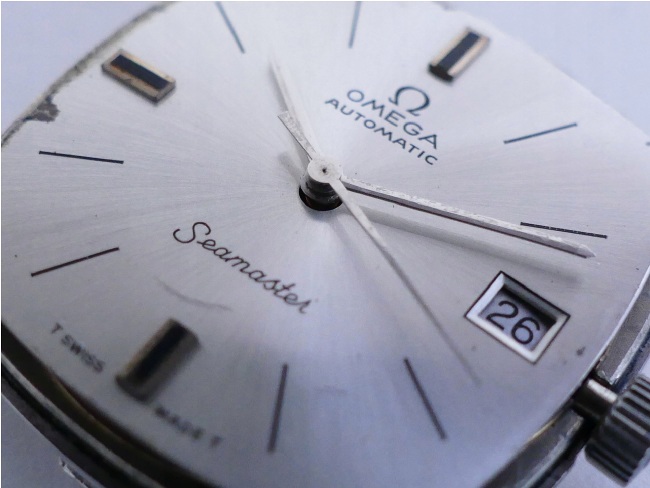

Posts 8,701 Likes 14,612 efauser 路Oct 14, 2019 Jarek3050 Then why is the seamaster on the dial? Because it has been repainted. Note the Ts on either side of Swiss Made. Do you see any lume anywhere? I'd say that just about everything that could be wrong with that watch, is.
