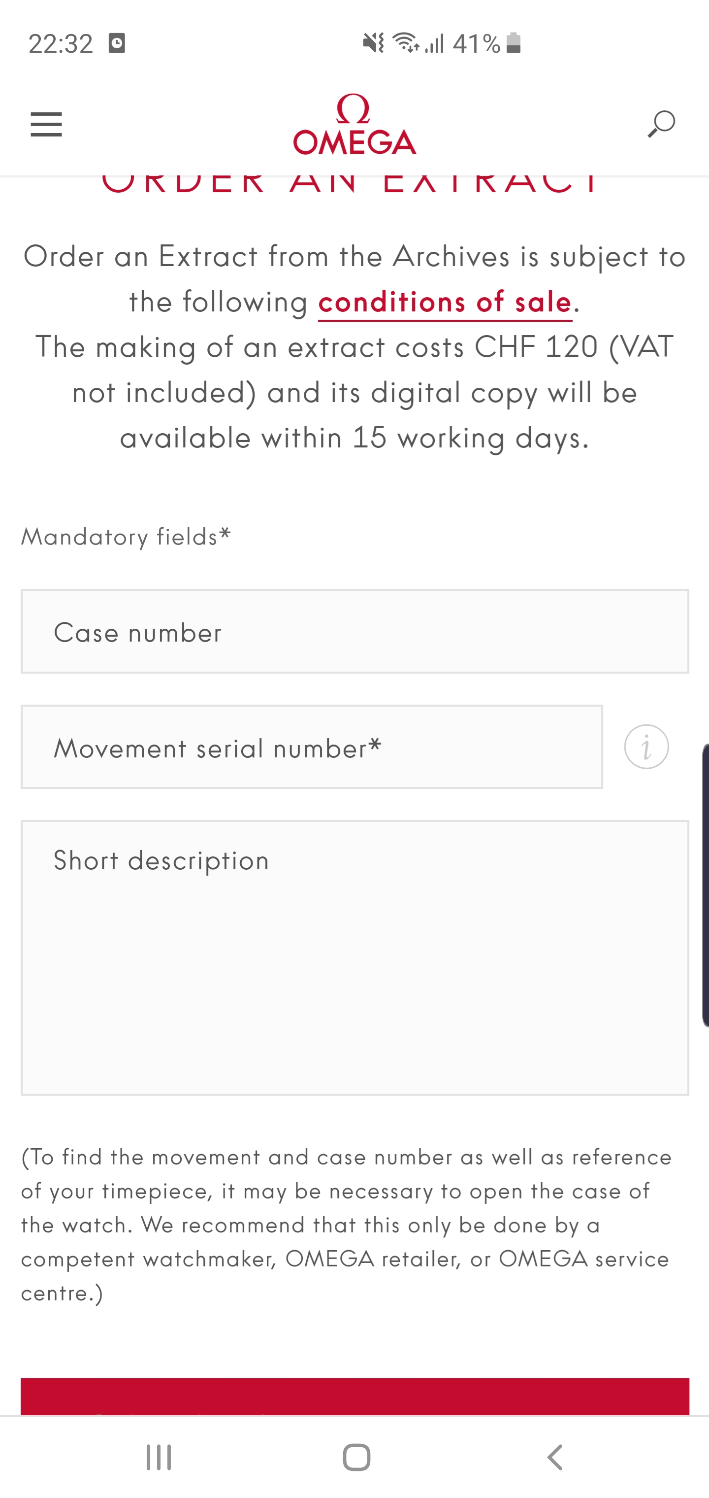

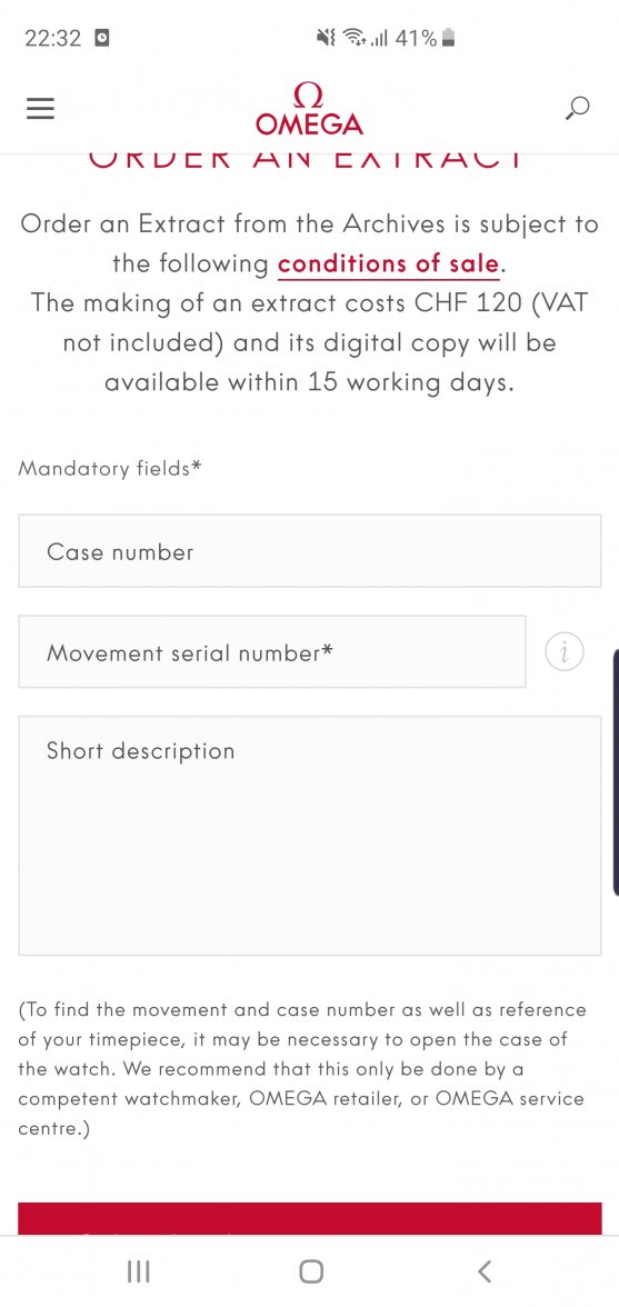

another question: do you know what details omega requires for an archive extract. only movement number, pics from all around the watch, any experience with shipping it to omega directly?
Here you are. Also you need to submit front and back of the watch pictures. Well it is gonna be fun.
