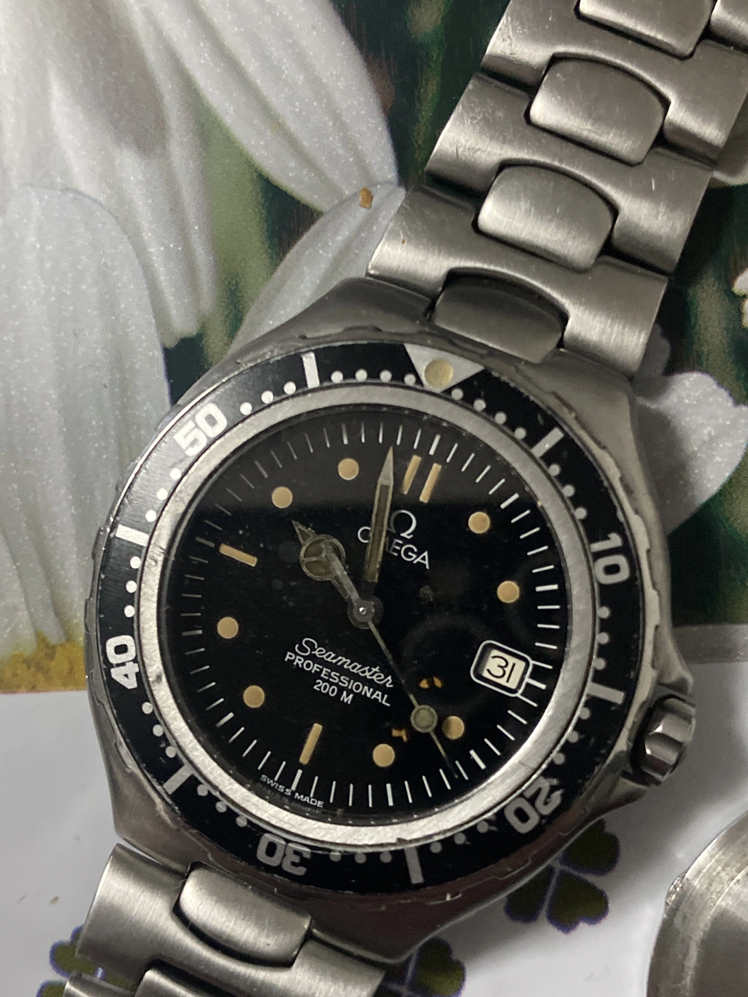

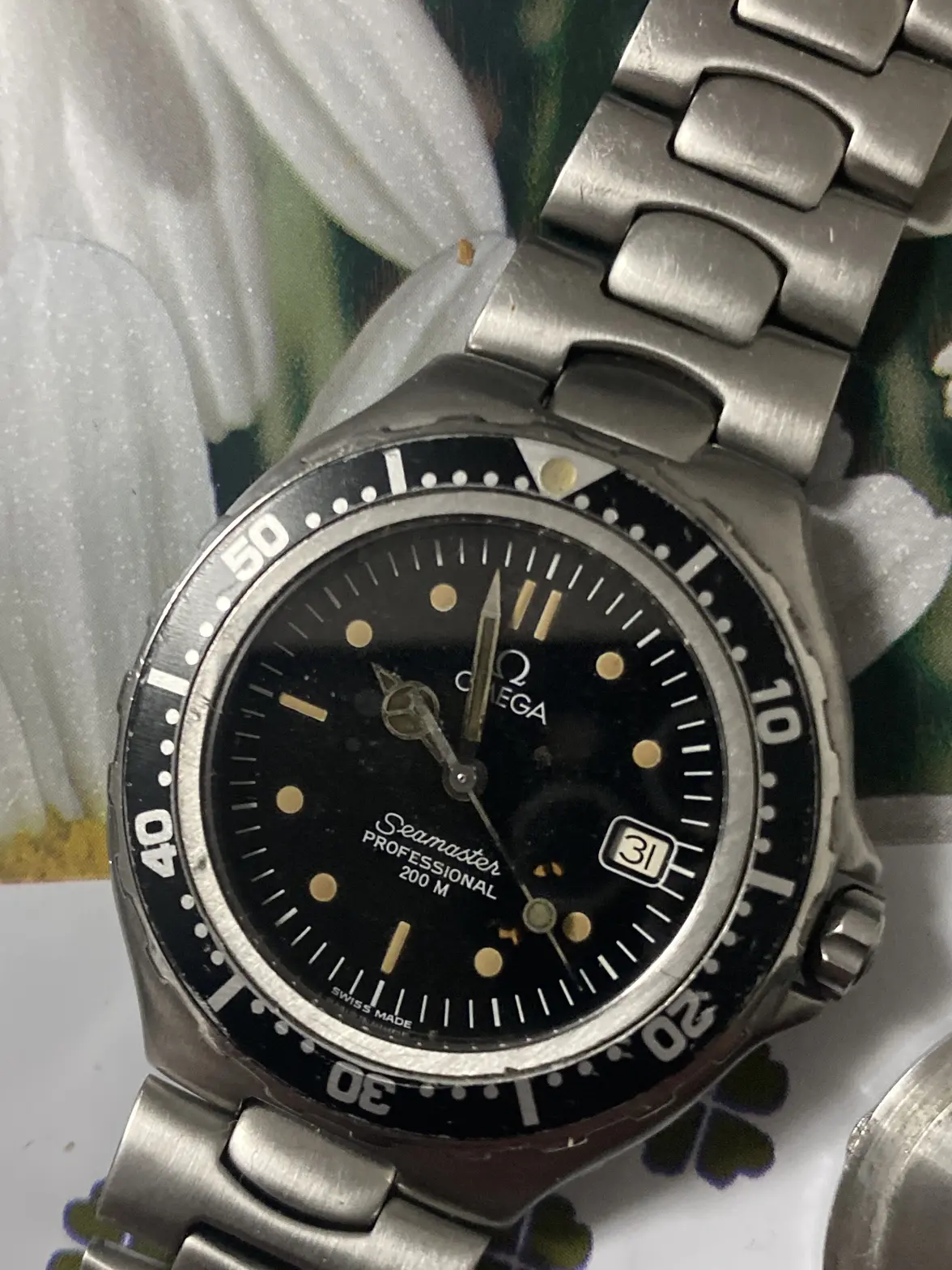

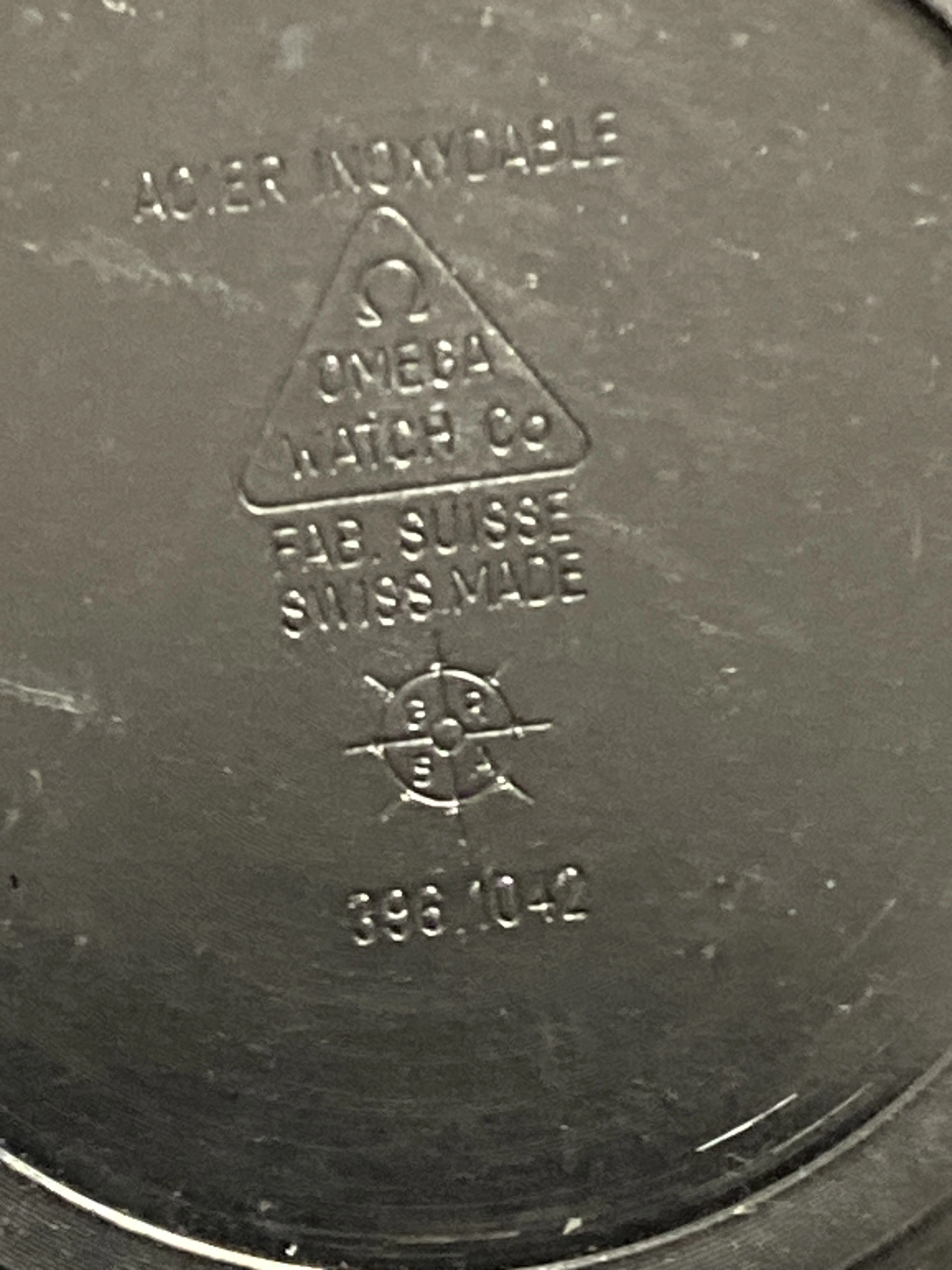

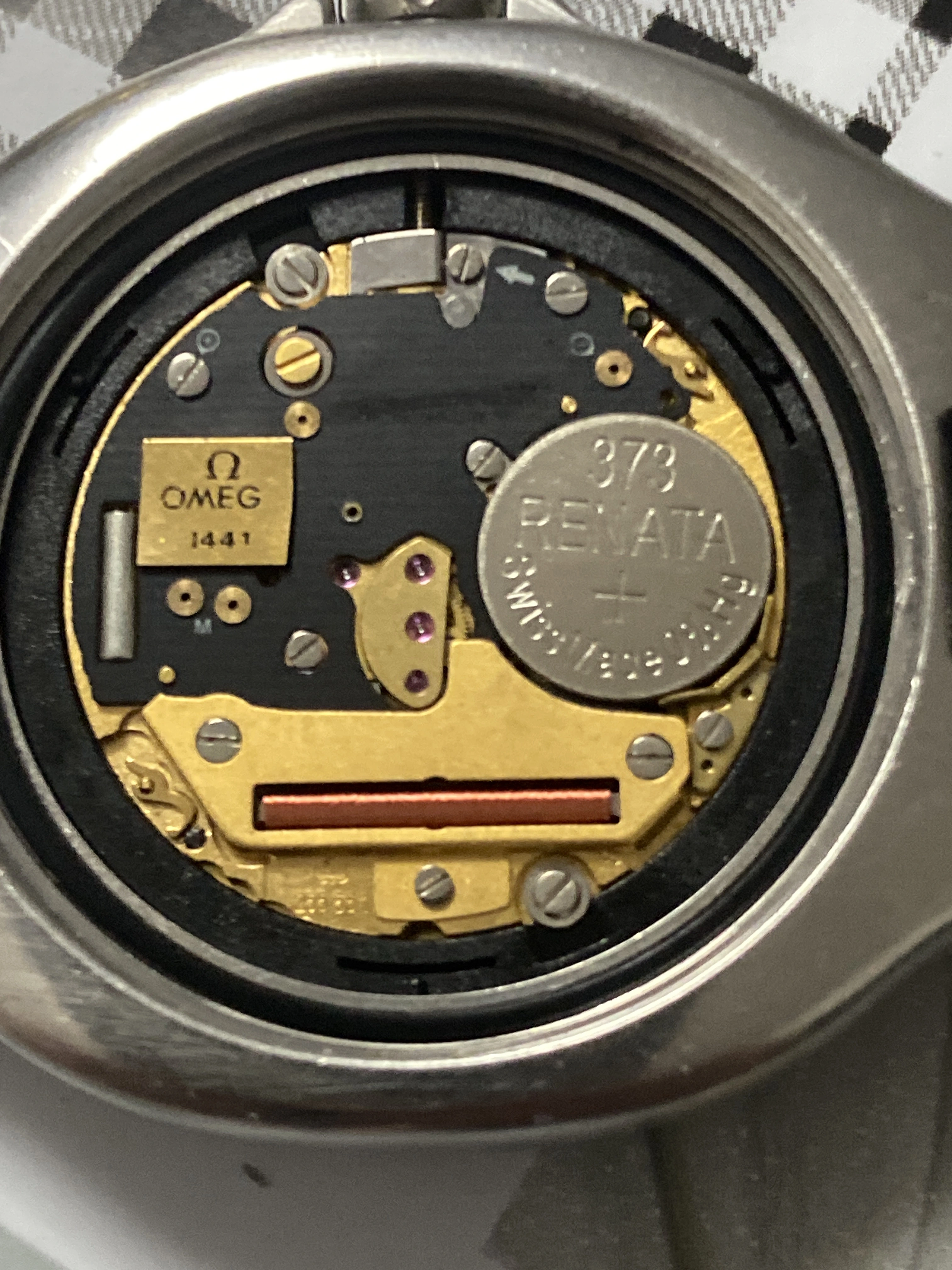

omega 396.1042 please give your opinion or original?
Proszę o odbiór zegarka omega professional pre bond 200m mechanizm 1441 ETA 255561

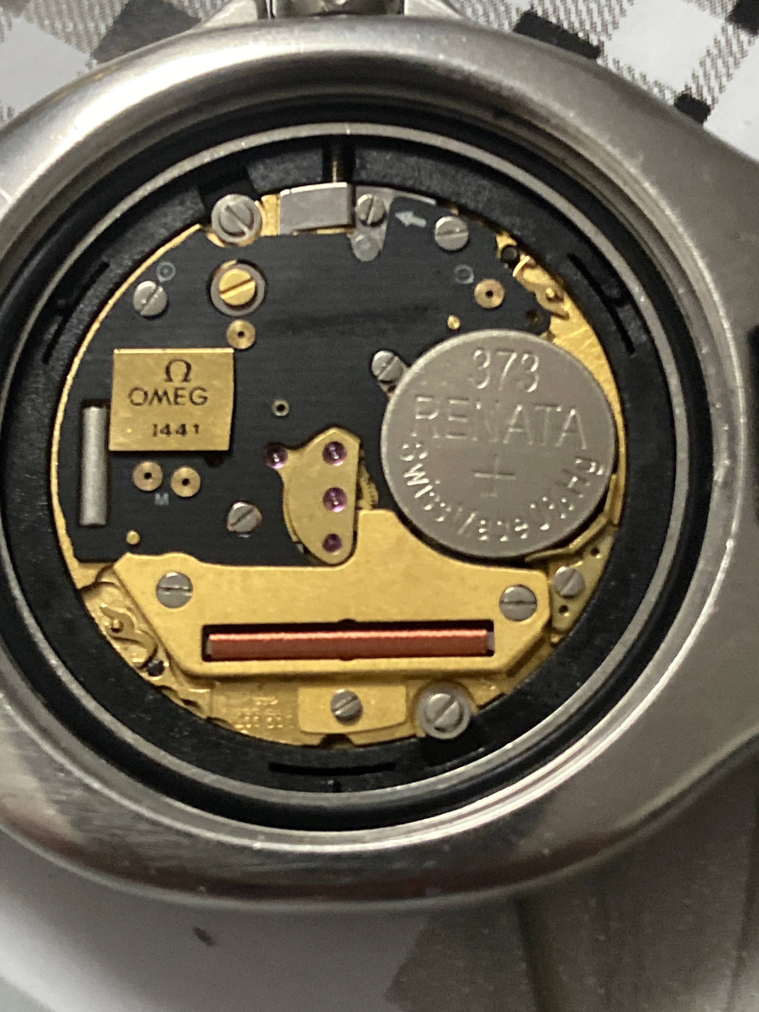

That's not a caliber 1441, maybe the ETA equivalent, but I can't see the numbers on the plate. 255.???.
If the numbers are 255.561, it's the ETA thermocompensated equivalent.
The crappy "OMEG" plate glued to the movement should be a fair indication that shenannigans are involved.
