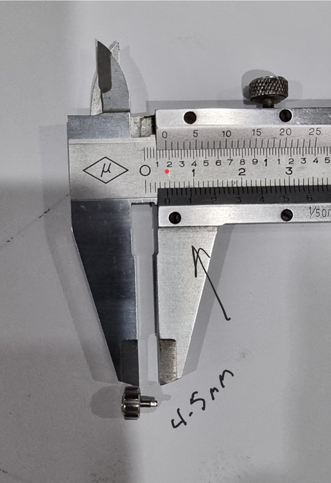

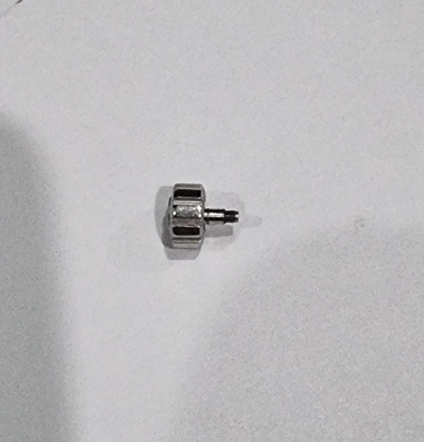

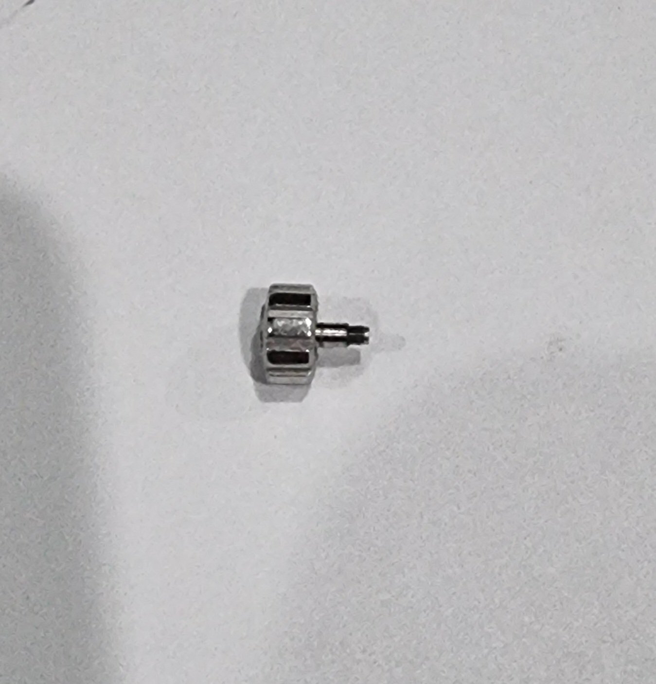

Please unscrew the crown, and take a clear photo of the crown and stem - it won't hurt anything to do so. Based on the length you stated, I suspect the stem has broken off - you won't be able to wind or set if that is the case.
7

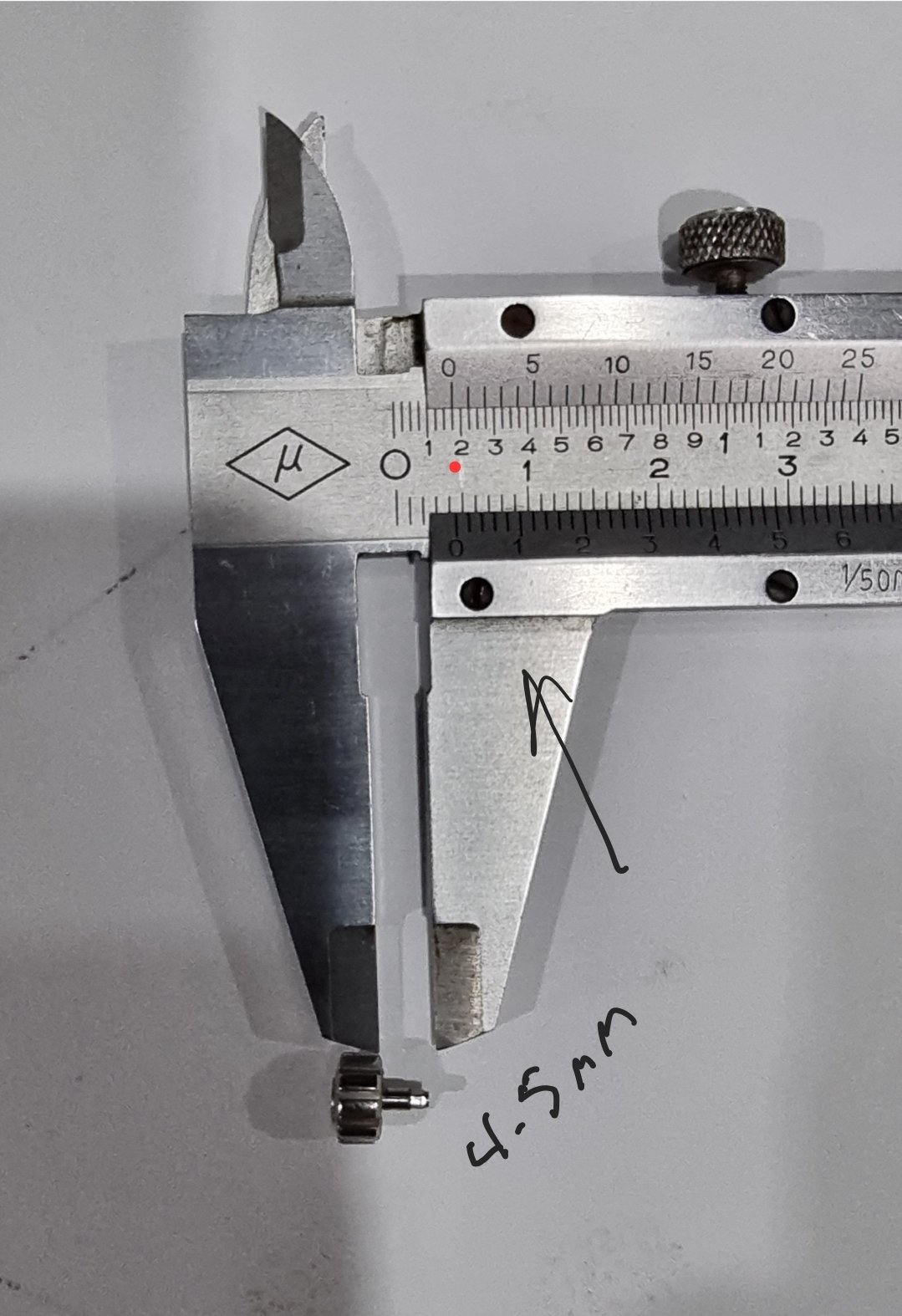

Thanks again Archer. Feeling much better to know what the problem is. Here is a photo of the crown and what is left of the stem. I also took a photo with a caliper so you can see the length of the stem, which is approximately 4.5mm.
Is this a difficult and expensive repair at a authorized Omega service center? Just curious approximately how much it will set me back.
Also wondering if when the stem snapped if it is possible that it damaged any other internal parts of the watch?

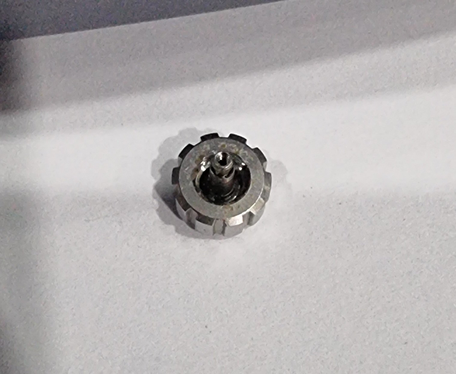

So, that’s just the crown. It may be that the crown has simply come away from the stem. If you look at the end of the crown that is on the right in your photo, is there a clean threaded hole, Oris is blocked with a piece of broken stem?
7

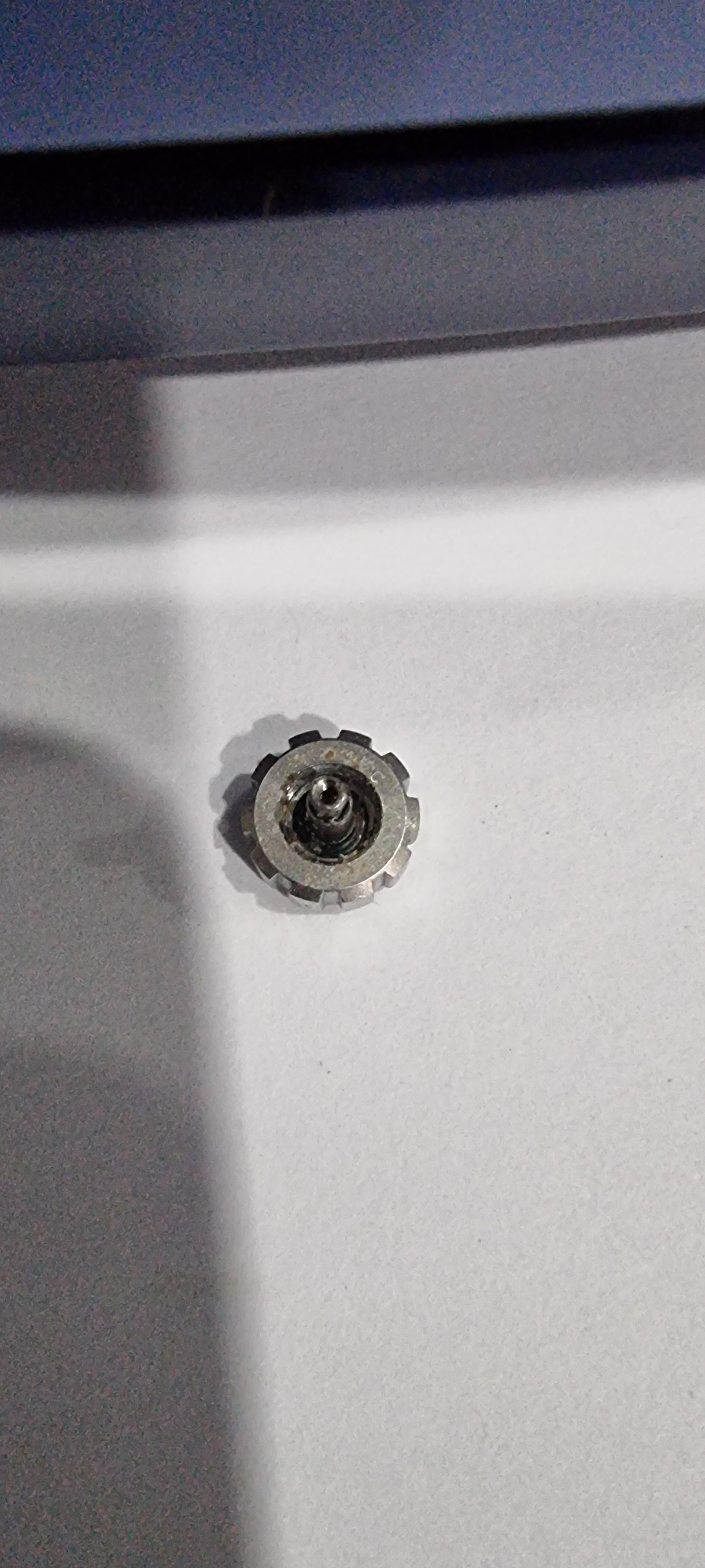

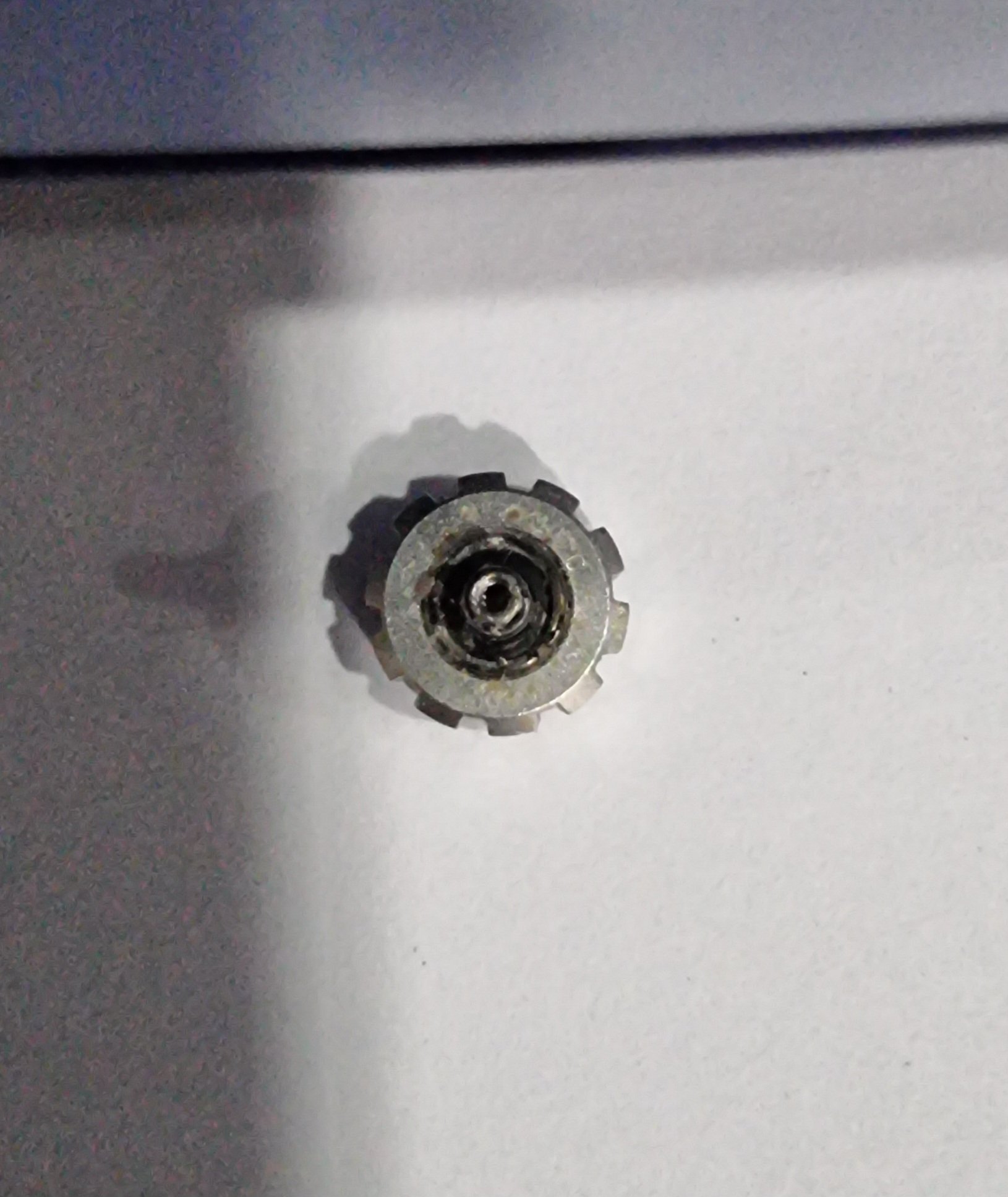

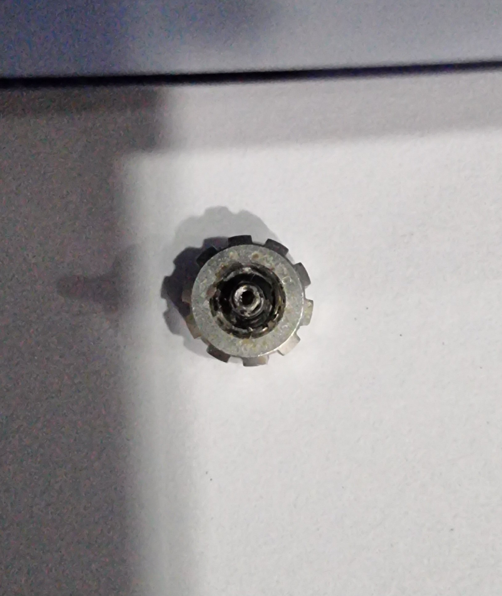

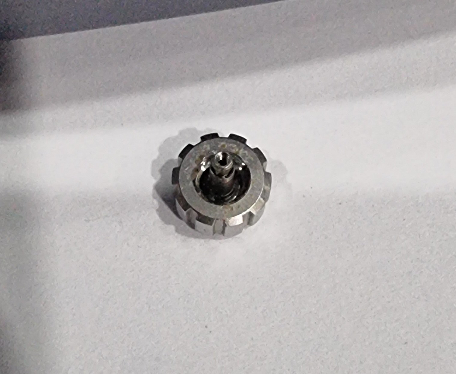

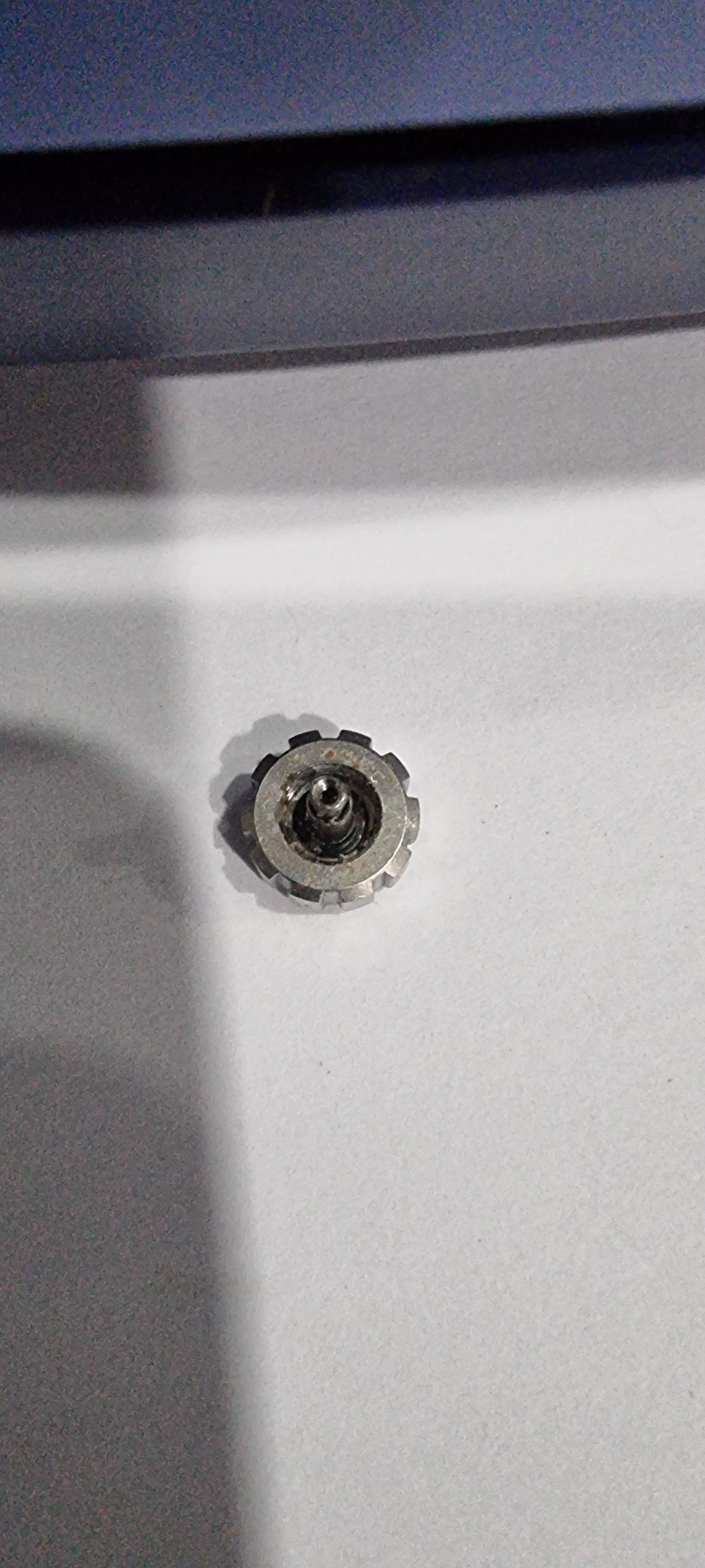

It looks like the crown has come away from the stem. There is a clean hole on the end but I can't see any threads as it's difficult to see, but there does not appear to be anything broken off inside of that hole. Here are some macro (close-up) photos. Not great, but maybe you can tell from these photos. Thanks again Archer.
30,339
78,284
It appears the the crown has simply come unscrewed. This is something that any competent watchmaker can repair for you in a few minutes.
