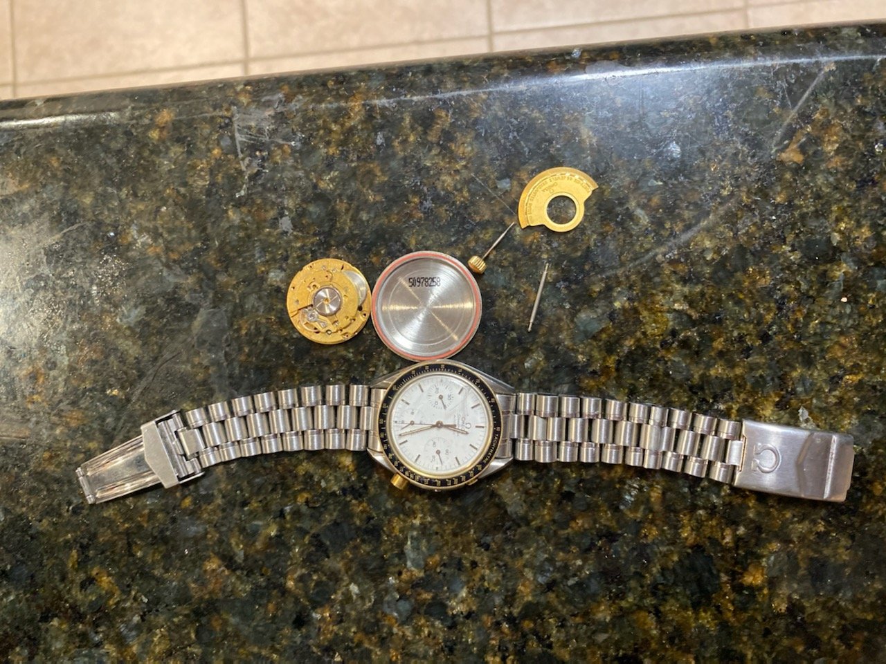

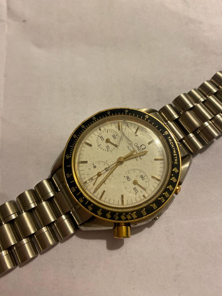

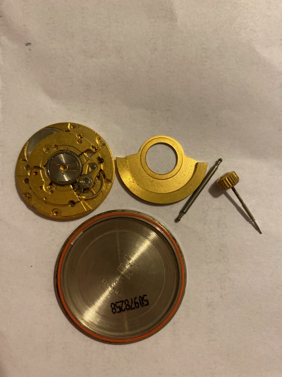

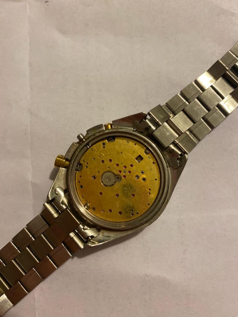

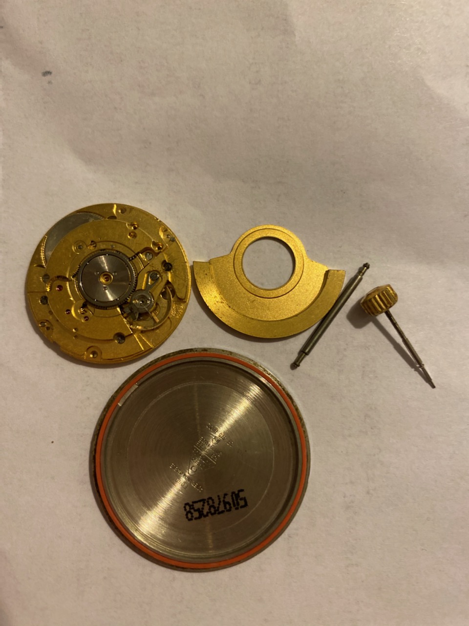

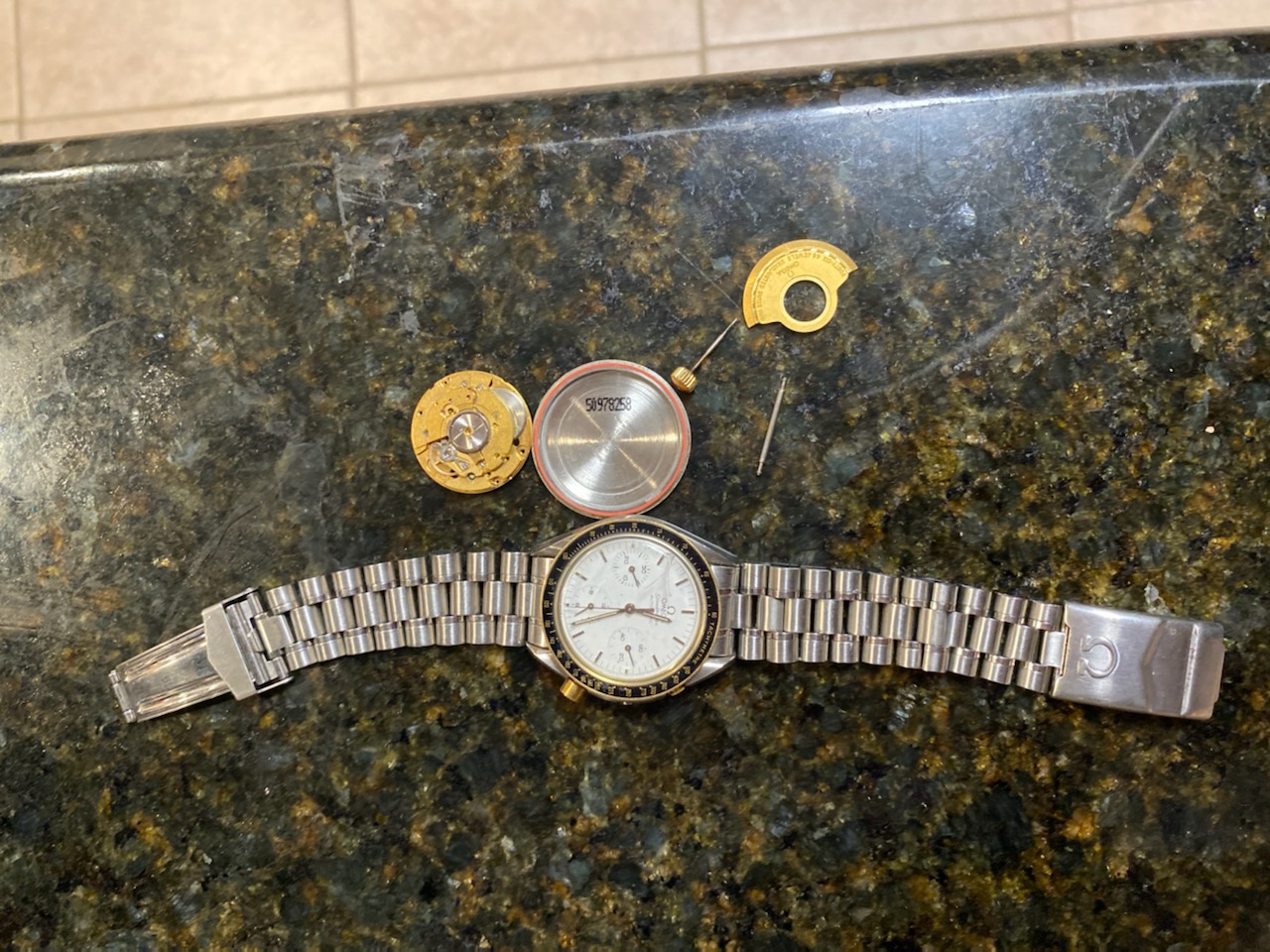

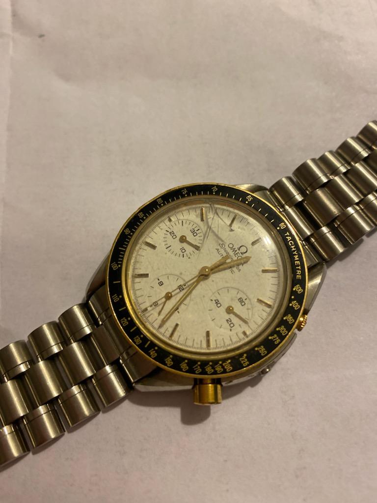

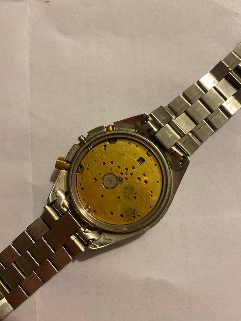

thanks for the info. I don't have the watch in my hand, but my relative did just take a picture of it. I thought I saw small cogs and other small parts over 10 years ago.
Here is a grainy picture

That’s a Speedmaster Reduced, with a chronograph module attached to a base caliber. Looks to me (and I’m no expert) that your uncle (or a watchmaker he hired) removed the base caliber from the module (or vice versa) then stopped when they realized they couldn’t do anything else.
your best bet on this is to send to Omega - they will replace the entire chronograph module with a refurbished one as that’s easier and faster. Many independent watchmakers won’t touch one of these module chronograph movements because it’s a pain to work on.
30,256
78,101
Omega will replace the entire movement, and with this one in the state it's in, that will be quite expensive...
