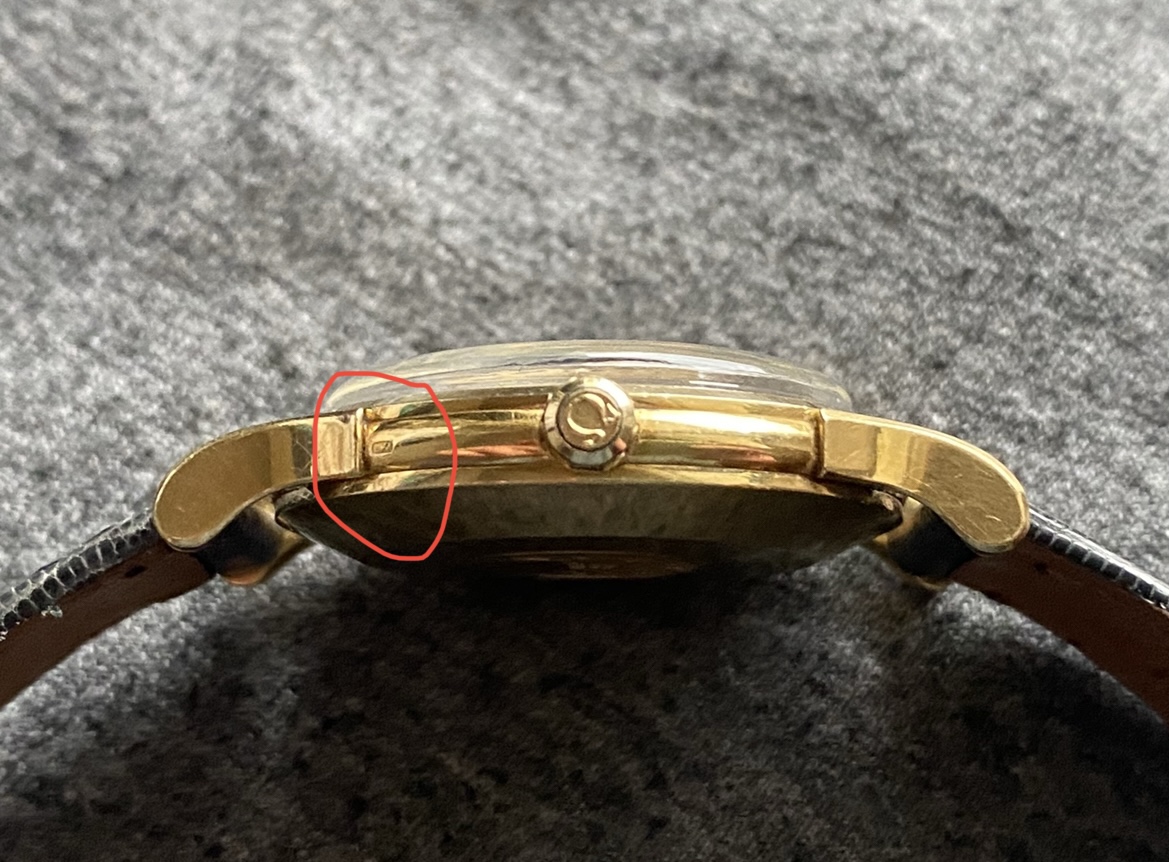

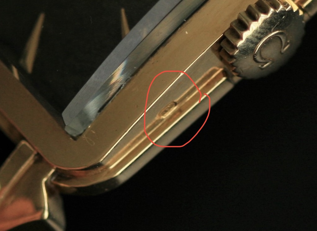

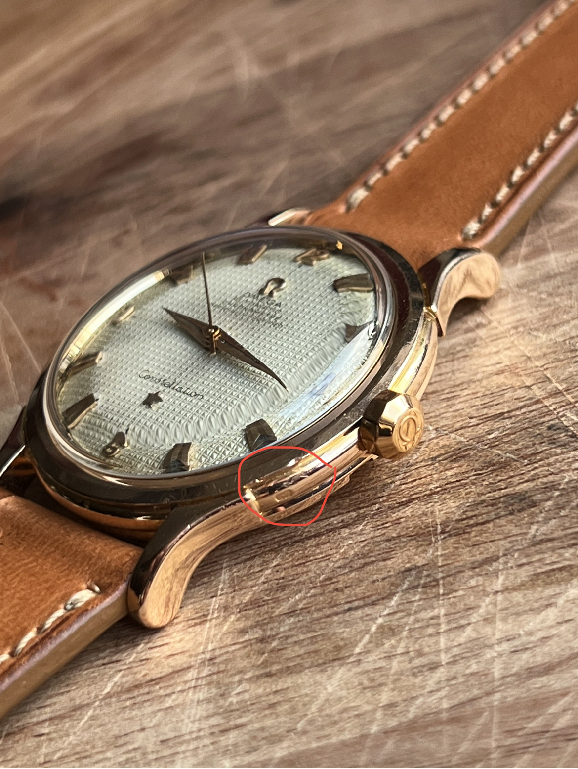

Check the engraved mark on the left of the crown...Should an authentic Omega watch have any ??
Are you referring to the hallmark, indicating an 18k case?

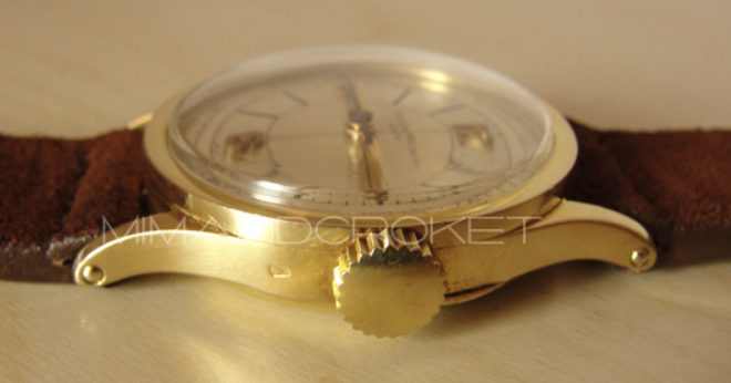

P.S. Here are a couple more extracts with production dates of 1947, just in case you thought the one that I posted was an anomaly. I would be interested to see an extract with a production date of 1947 and a serial number of greater than 12'000'000. You could always order an extract and quell any doubts. See here: https://www.omegawatches.com/customer-service/extract-of-the-archives
Can you please share the source you found, pointing that Omega used outside hallmarks in order to indicate case gold karads
besides the ones inside the case??
Couldn't also find it anywhere, even while I was questioning what a couple of old Gold watch dealers were telling me about.
But I must admit, it is hard for me even to imagine that a watchmaking company with such a story, finesse and style can hurt its watch's face (case) image for this purpose..
What's the indication for 14 or 18kts b.t.w.?
13,674
19,043

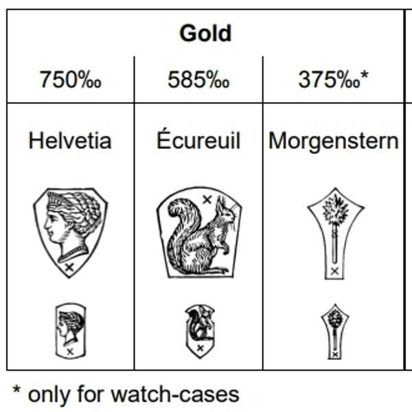

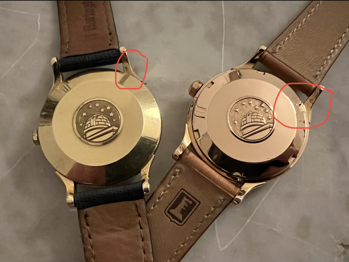

14K Swiss hallmark is a squirrel. 18K is Helvetia (sometimes called Queen’s Head, as it looks like Queen Victoria).
These are usually too small to be seen with normal photography. With Omega, you have to open the case and look inside for the larger versions.

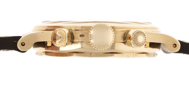

If you use the forum search you’ll find some more info on it. I’m sure I’ve learned this here at some point and since then seen hundreds of examples. Just a few pics I had available from my own watches:

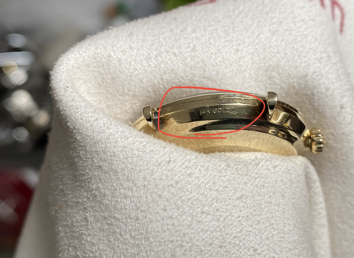

And something different: A 60s US collection SMDV that simply says “14k gold” in between the lugs:

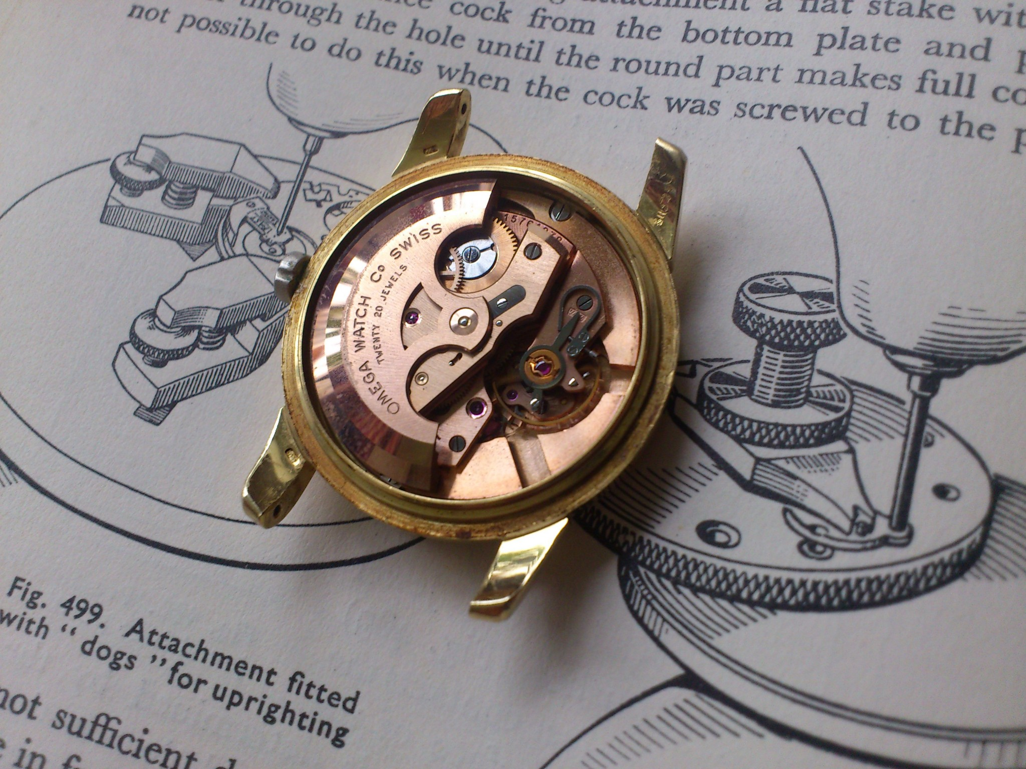

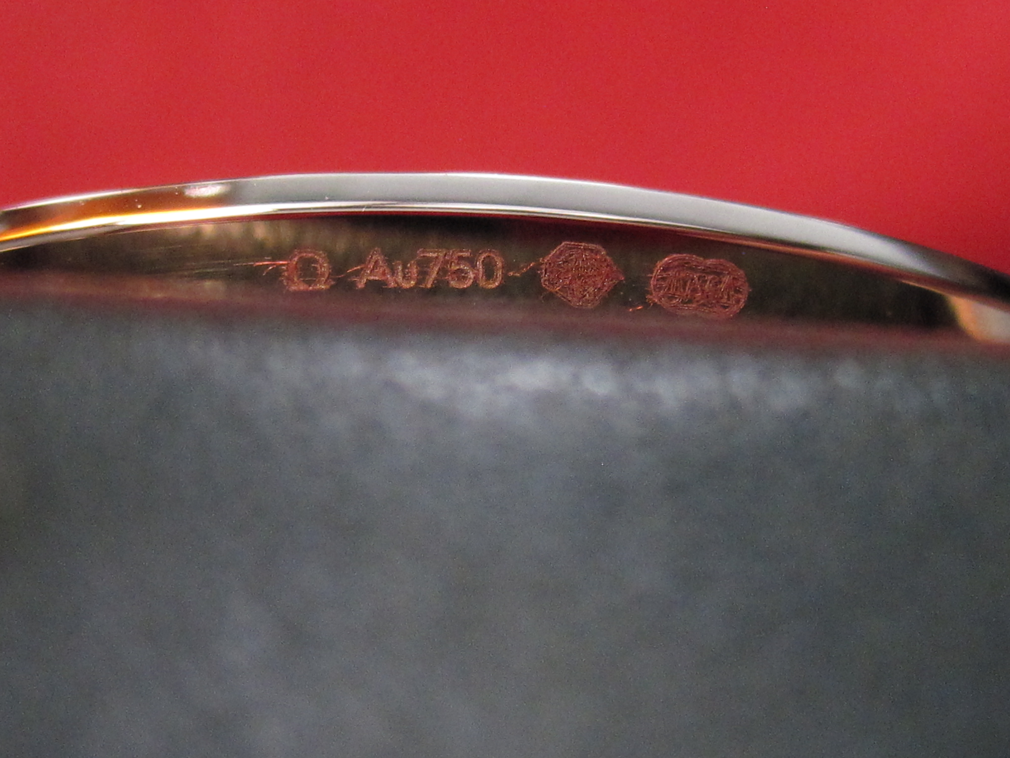

ALL Swiss gold cases made in that era had to be marked with two gold hallmark denoting what carat it was made of and these had to be on the midcase - no outside marking of the caseback. On 99% of Omegas, these hallmarks are on the rear of the lugs, though in few cases - often due to the size and/or shape of the lugs, I guess - they are placed on the sides. Other countries had different rules.
Swiss made Omega cases are always either 14 or 18 carat, here are the symbols:

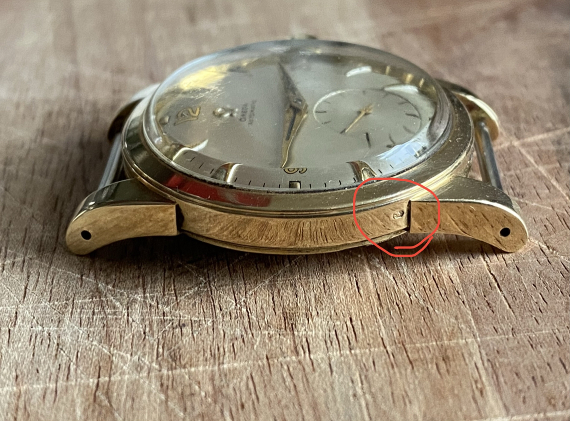

On this Omega Seamaster you can make out the hallmarks on the top and bottom left lugs:

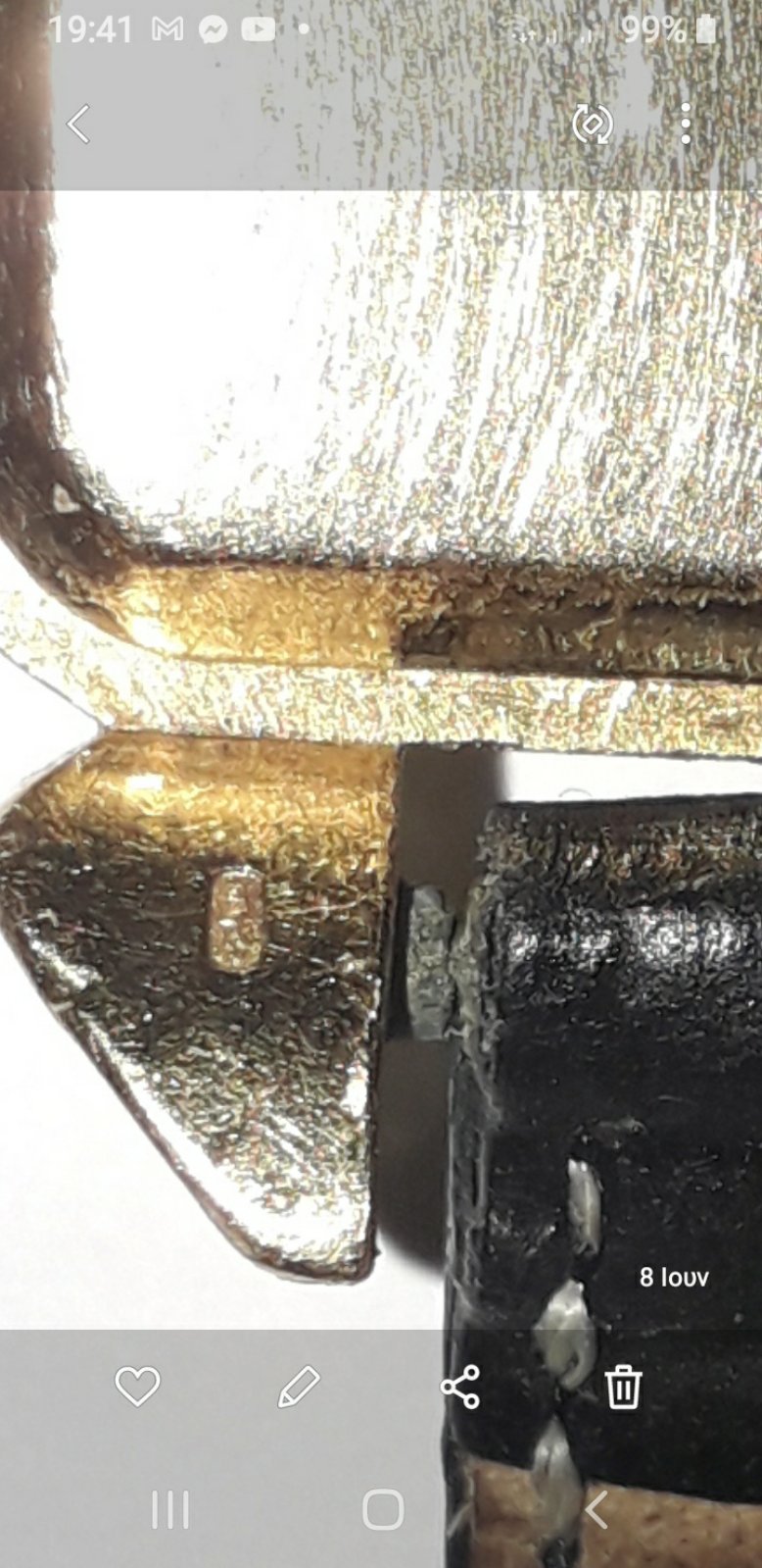

It was very useful info what you just shared.. I also found the link for these hallmarks and their meaning.
Although I can't understand why my watch had enough place (lungs) for these hallmarks and other same reference had not..
I tried to take a photo... the best results I got follow..
And the link which explains everything...but with a quick view there isn't any citation regarding hallmarks placed on the sides....anyway..
Thanks a lot !!!

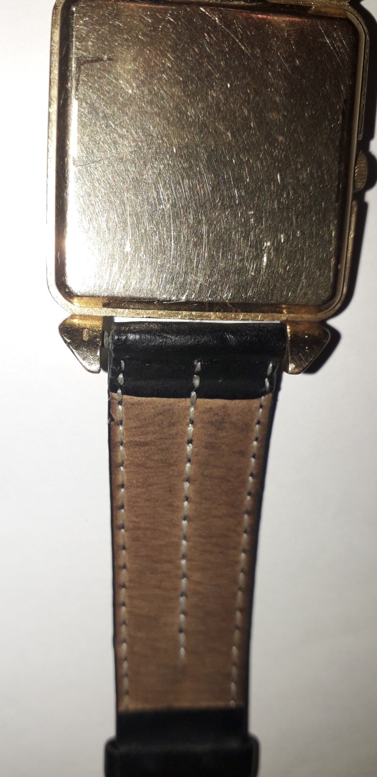

In all honesty this is a parts watch - worth the melt gold value plus maybe $100 for the movement. Case has been polished significantly, dial has been poorly redialled, crown is wrong and hands are wrong and/or damaged. It takes a seasoned collector about 30 seconds to figure this out.
