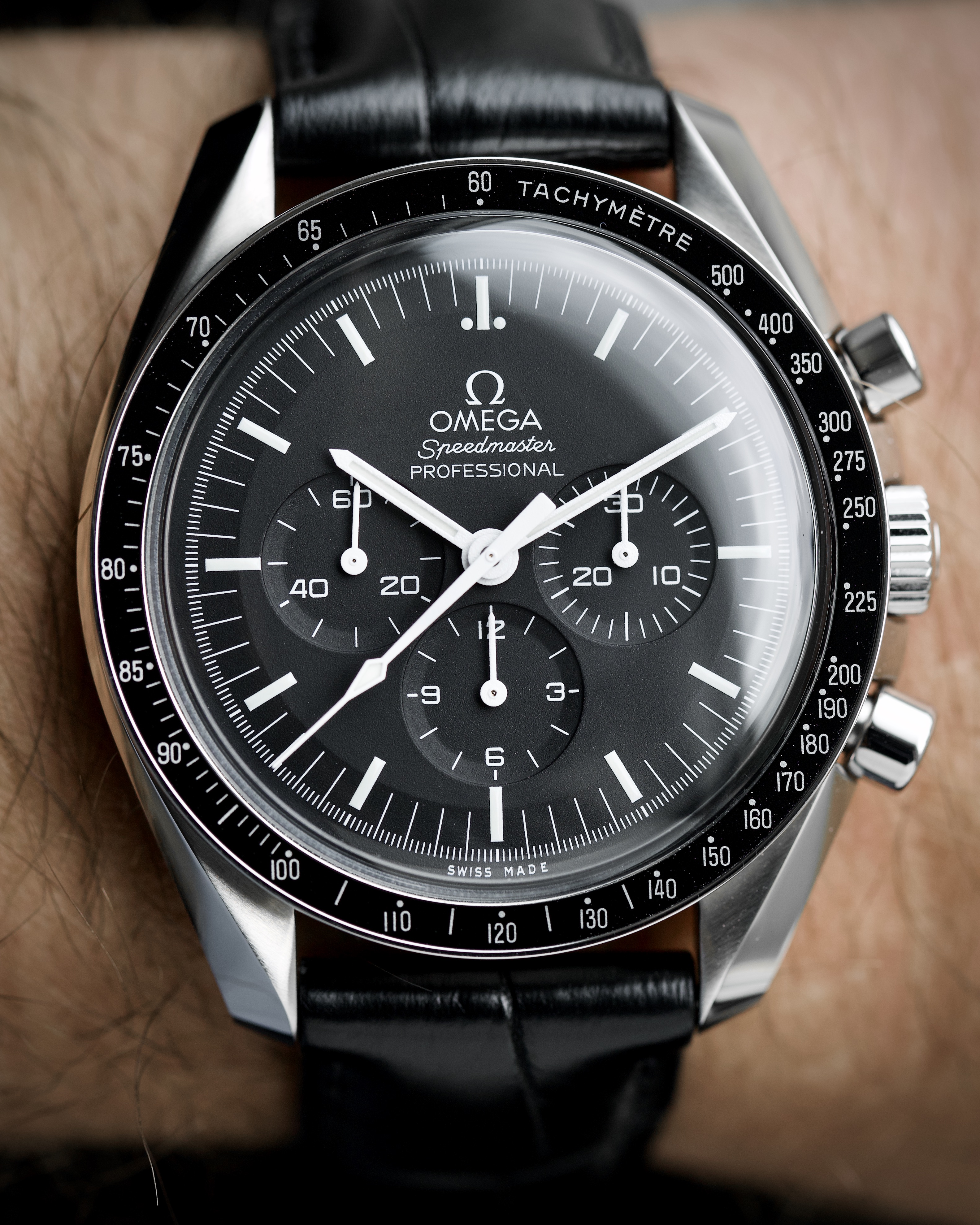

Hey everyone,
This is my first post on OF, but I'm a longtime lurker and found this forum really helpful over the years. I'm also active over on WUS and IG. I want to give this thread a bump because I also noticed the "rattle" that a few members have complained of with their newer Speedmasters (THREAD #1: This one, THREAD #2: https://omegaforums.net/threads/rattling-speedmaster-pro.94717/, THREAD #3: https://omegaforums.net/threads/speedmaster-moonwatch-rattle-noise.110299/). It appears the verdict is still out on what can be making this faint noice.
I also noticed it my particular Hesalite Moonwatch (purchased new in December 2019) when I was changing to a leather strap from the factory bracelet. It seems that a few members have taken their watches to the OB or sent them and were told that this vertical rattle is "within spec" and it's simply the "anti-magnetic cover." I know, I know...just don't shake the watch or acutely listen and it's case closed. With that being said, I heard it and was under the impression that "ticking" is the only thing you should hear in a mechanical watch.
After reading responses from @Canuck and @Archer in the above threads (as well as these two... https://omegaforums.net/threads/basic-watchmaking-tips-checking-and-adjusting-end-shake.100219/ and https://omegaforums.net/threads/first-vintage-omega-rattling-noise-after-service.30799/), I was wondering if the alleged vertical "anti-magnetic cover rattle" can simply be chalked up to hearing slight "end shake" within the mechanical movement? Is this something that can typically be heard within a watch like the Speedy? The dial/movement does not appear to be moving, nor does it feel like something is loose inside. Rather, it's only faintly audible. The only other mechanical watch I have is a Hamilton Khaki Field Mechanical and it makes a similar noise but I'm not sure if it has a movement cover inside. Any help would be appreciated, whether it's watch-related or simply recommending a psychiatrist. Here's a picture of the bastard in question...
