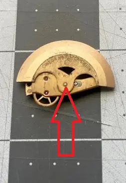

Hi there, I'm looking in to buying a vintage seamaster but I've been informed that it has a rattling sound when you shake the watch. I know it hasn't been serviced in a while so I'm sure that's part of the problem but does anyone have any idea if this is "normal" for a 60's seamaster? Any help much appreciated. Thanks

I didn't listen to the video, but unusual noises upon shaking could be a sign that the rotor is loose, and repairs/parts are needed in addition to a basic service. Of course, it's not uncommon for the auto-winding mechanism to need repair.
When you buy a vintage watch that hasn't been serviced by a known quantity, there is always uncertainty. It could just need a service, or it could need a few hundred extra in parts and repairs.

I watched the video. It's also possible that the movement is loose in the case. It's hard to say. If you really like the watch, just make sure you get it very cheap.
15,997
48,116
Broken rotor post, worn out rotor bearing gear, or both. If you buy it, be prepared to spend a packet on it!

Just following up on this thread for anyone that stumbles across it that may have a similar issue. Like previous replies pointed out, it was a broken rotor post. After trawling through the forum for UK repairers I ended up getting it fixed by Mitka in England for a very reasonable price (less than £40) and I'm incredibly happy with it!
