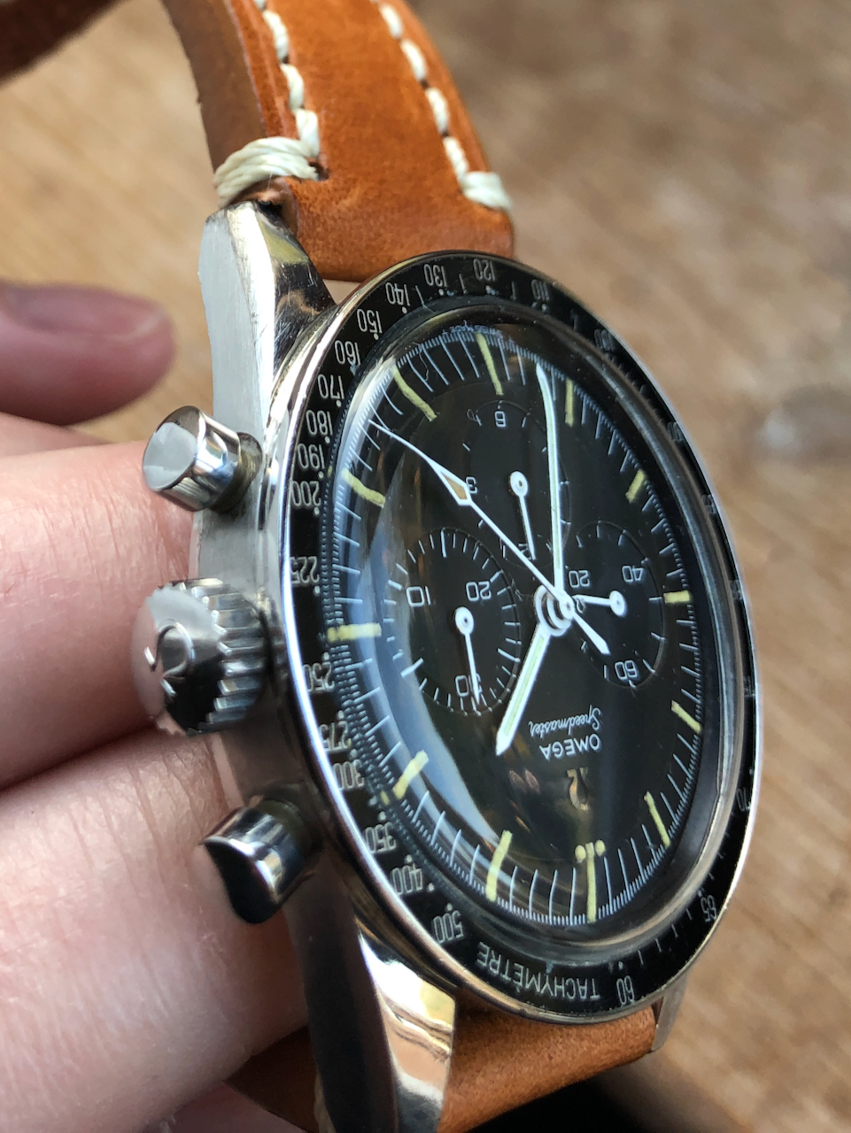

It has the correct crown, or am I missing something? Is it a Seamaster crown?

Perhaps I’m missing something, I’m new to vintage omega so quite possible! I was advised it should have 24 tooth crown, rather than the service one fitted.

That looks to me and apparently many others exactly like a 24 tooth flat foot crown. Note the boss of Speedmaster info (Spacefruit) also stated it looks right. His opinions hold great weight.

Yes I did notice that but Simon Freese spotted straight away it was a 30 something tooth crown? Worth a zoom in on a photo, I’ll have a check as I do t have watch at the moment!

Thats not a 32 tooth, but count the teeth and check. Yours looks very like mine:

I counted from one of the pictures in the first post and came to 24.
