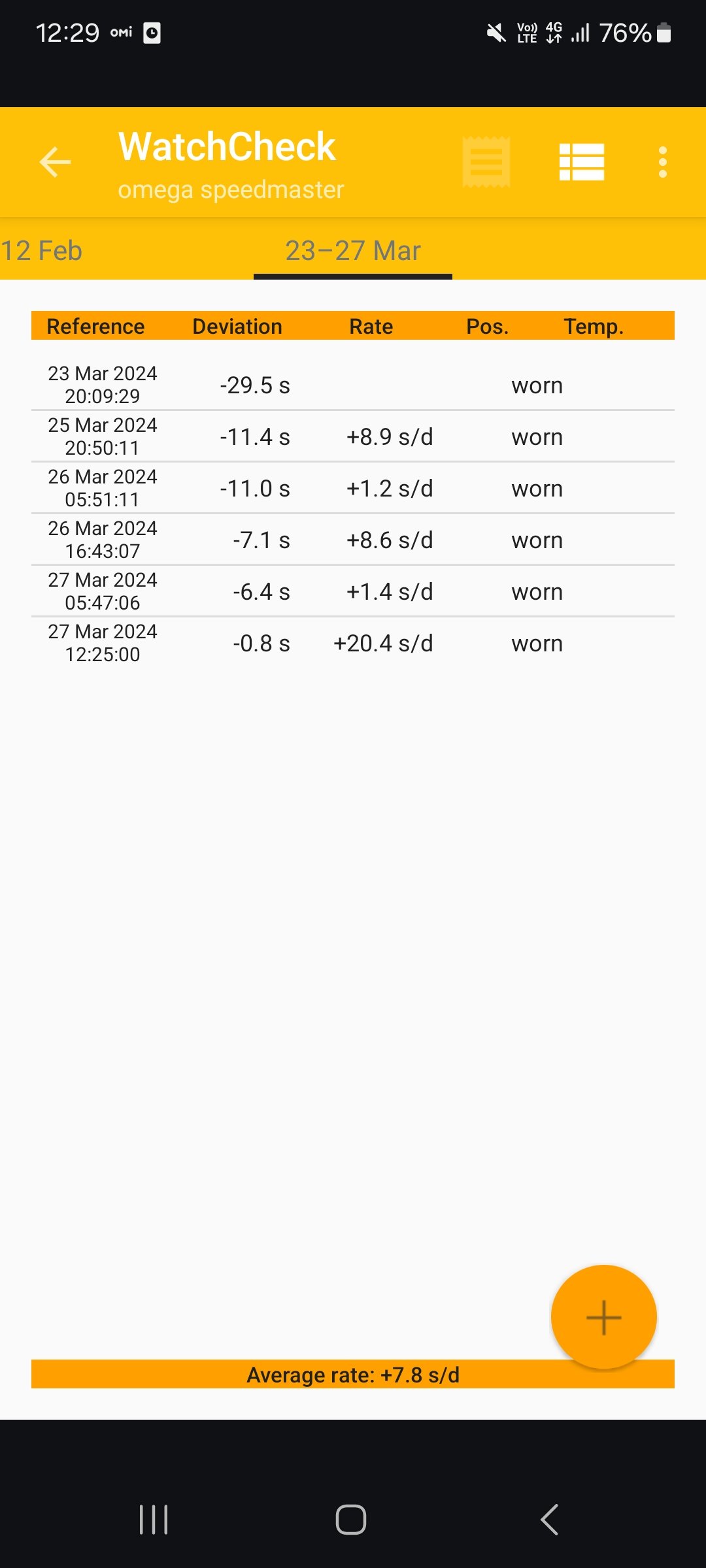

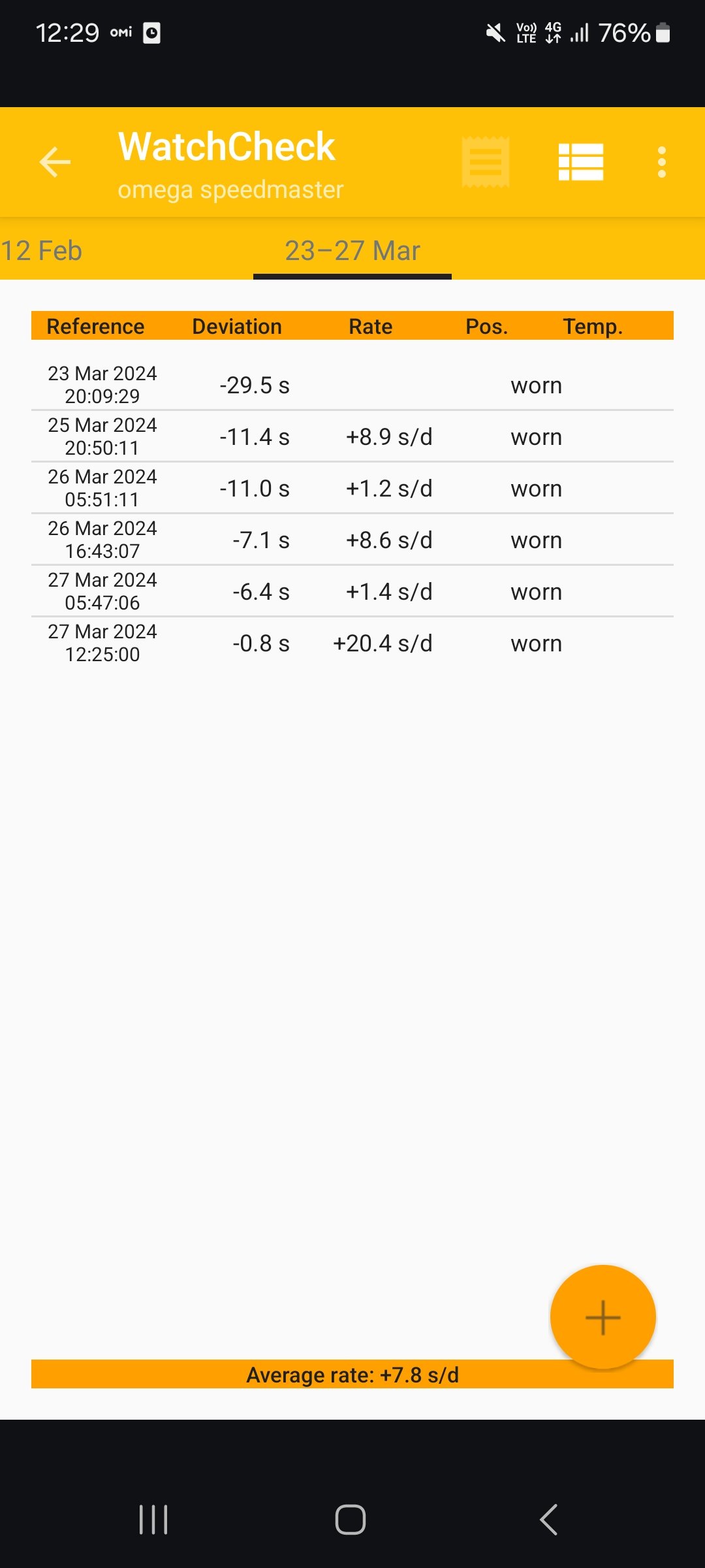

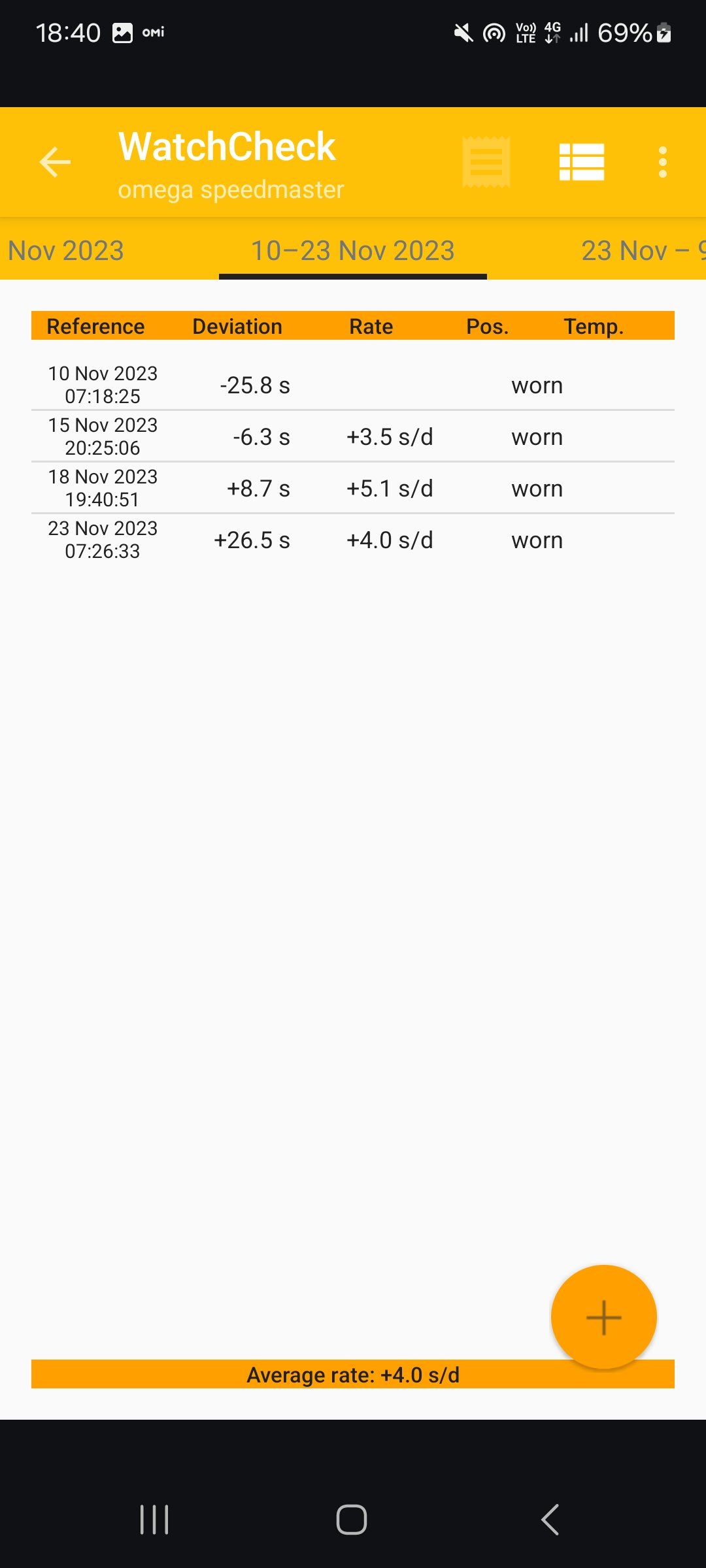

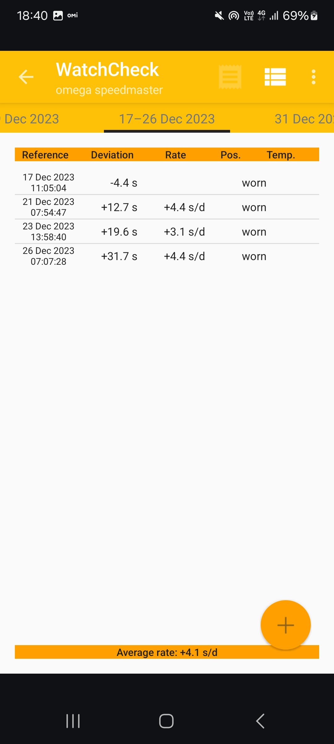

So I just got my 3861 back from a service, and pre-service it was very consistently averaging between 3.5 and 4.5 seconds a day.
Now the accuracy is fluctuating wildly and averaging out to around 8 seconds a day.
I haven't changed my lifestyle or habits in that time. Should I take this back to Omega to get them to fix it?

I would first try and see the positional variation by winding it fully, resting it in every position for 24 hours so you can see after 6 days how it performs.

Multiple measurements in one day are not beneficial unless the watch is gaining or losing a lot of time per day. On average, your watch is gaining roughly 5 Seconds a day (20.8sec gain in 4 days). I would continue to wear it, winded daily, and measure daily. You could also try leaving it for 24 hours in each of the six positions to see how it performs when it's static.

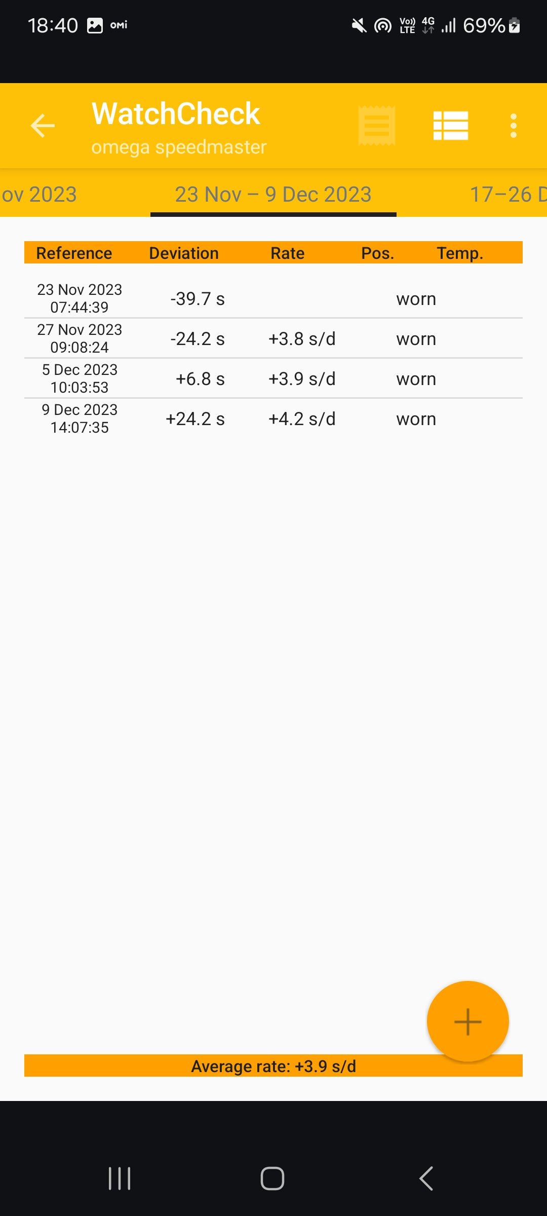

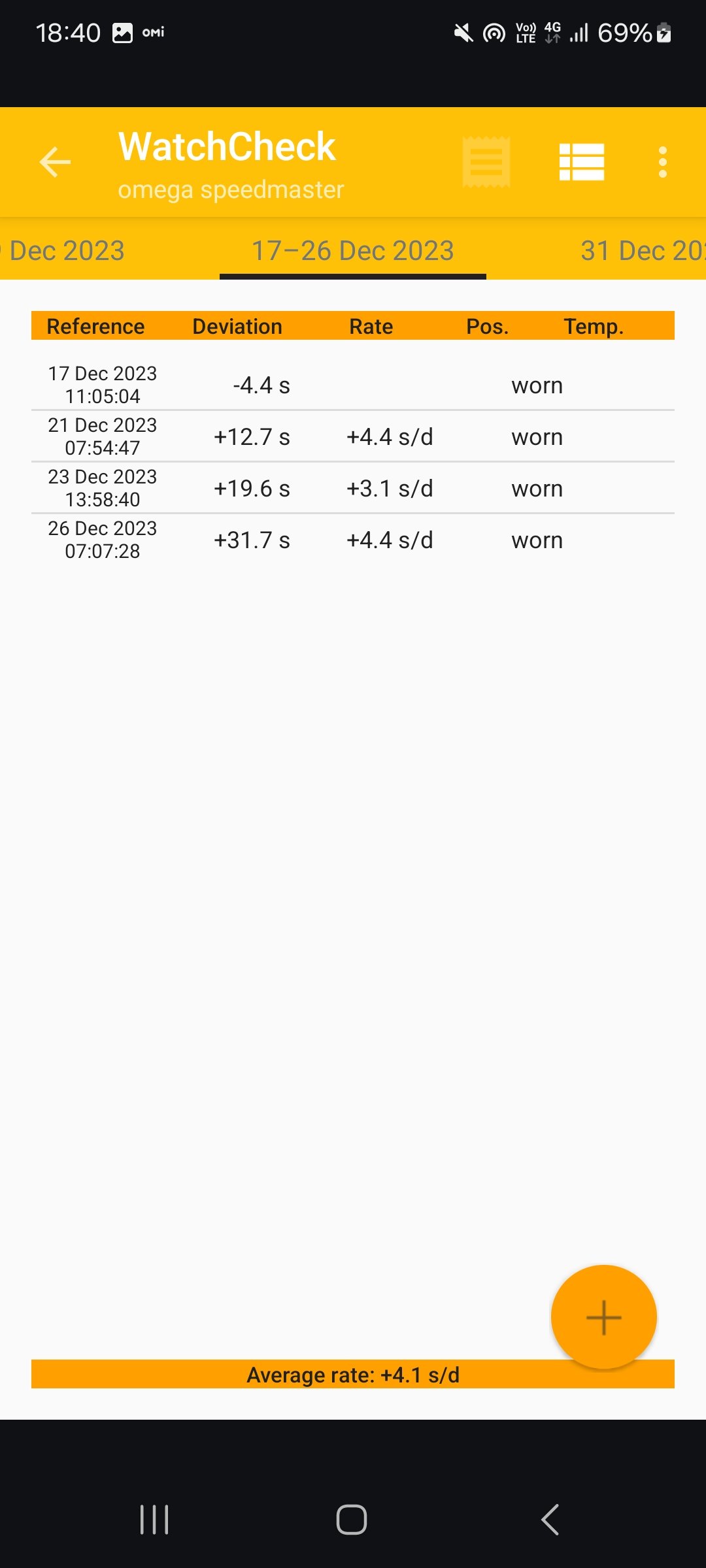

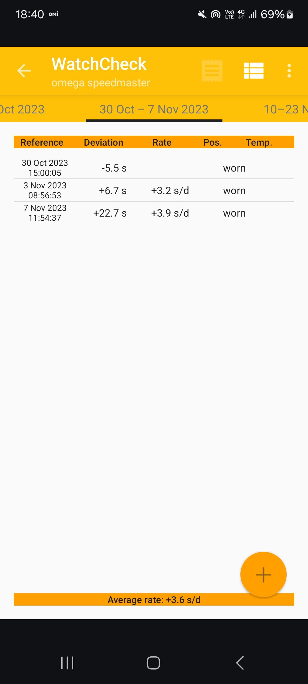

It's averaging about 7-8 seconds a day. By comparison here's how it was prior to the service.
Note, I have not changed my wearing habits, I wear the watch all day, including when I sleep, so there's a clear difference.

How do I see the results of that? The only thing I can see are the original tests when the watch was made.
Also, on its original test it averaged 4.1s/d, which is pretty much what I got from my normal wearing habits.

So Omega told me they got 3.1 s/d when they tested it. I said I'm getting 7-8 s/d, so they offered to take the watch back and regulate it for me again.
I'm thinking it might just be that when I wear the watch it's spending most of it's time in a fast position.
I'm going to get it regulated anyway though, because 7-8 s/d isn't really good enough for me.
