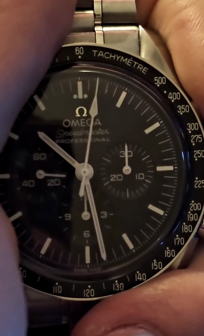

So I bought a brand new Omega Speedmaster. I was looking for a cool chronograph with a timeless and classy design but retaining the industrial and... uhh "toolish" looks. However out of the box, my Speedmaster has the following issues:
1. The minute sub-dial is not accurate. When seconds hand hit the 58-59 mark the minute sub-dial ticks one minute too early/ Is it 1 min or 1 min and 58sec?
2. The hour hand much like the minute sub-dial ticks too early. Is it 1 hour? Or 1 hour and 56 min(even worse than the minute sub - dial, it gets triggered at the 56min mark making it unpractical and rather useless)?
And the biggest one:
3. The Speedmaster Stutter. And no, I am certain of this issue it is not my imagination because each time it happens the watch makes unsettling grinding noise. The mechanism on the back shows the two gears in the middle moving erratically and making this... unsettling grinding noise...
stutter3-png.18055287
I am... extremely disappointed as this is my FIRST time I bought a watch that is faulty out of the box... And I did not expect to be a grandiose and reputable brand, kinda ironic. Anyway I fear that my Speedmaster is eating itself each second, although he keeps good time, just don't ask him to preform like a Speedmaster... Which is a shame since the chrono function is handy. So I essentially got half a Speed, more like SpeedTrainingTobeMaster.
I am not "trolling" and this is not my "attempt" to be funny. I actually fear Omega will say that "this is within tolerance lol" and tell me to f off. The watch is worn less than 24h and the most "extreme" environment he has been is a desk and a watch box.
Anybody has any idea what is going on? Omega support are contacted but from what I gather they are more as a decoration for the website...
Check out my imgur gallery with each issue documented: https://imgur.com/a/MRseYM3

What’s going on is you appear to be overreacting. Inevitably for a mass produced item there will be some which develop faults (as with cars). The watch will be within warranty and the stopwatch hand should not stutter (picking just one of the issues). Simply get the watch exchanged or return it via a boutique or authorised dealer for a warranty repair? Of course the service levels do vary by country/location and depend on your chosen purchase route. If you have an online Omega account it will be interesting to see what their customer service advice is (assuming they reply). It certainly looks like a valid warranty claim to me.
It is interesting to consider when and how any fault developed as the watch will have been tested with the results available online. Perhaps @Archer could comment on the nature of the possible faults and the timescales / usage profile you have mentioned.

A lot of (sensible) people will not want to click your link as they can be risky. I did and seeing your video the chronograph hand stuttering is clearly a fault. The watch needs to be repaired or exchanged. If it goes to an Omega service centre they should pick up all issues and in effect service and repair it. I would just focus on getting the issue resolved and then you can post up how it went.

Just a cross check but from your video what is the reference number for the watch you have With the noted faults, it looks like a standard Speedmaster?
10
6
310.30.42.50.01.002
