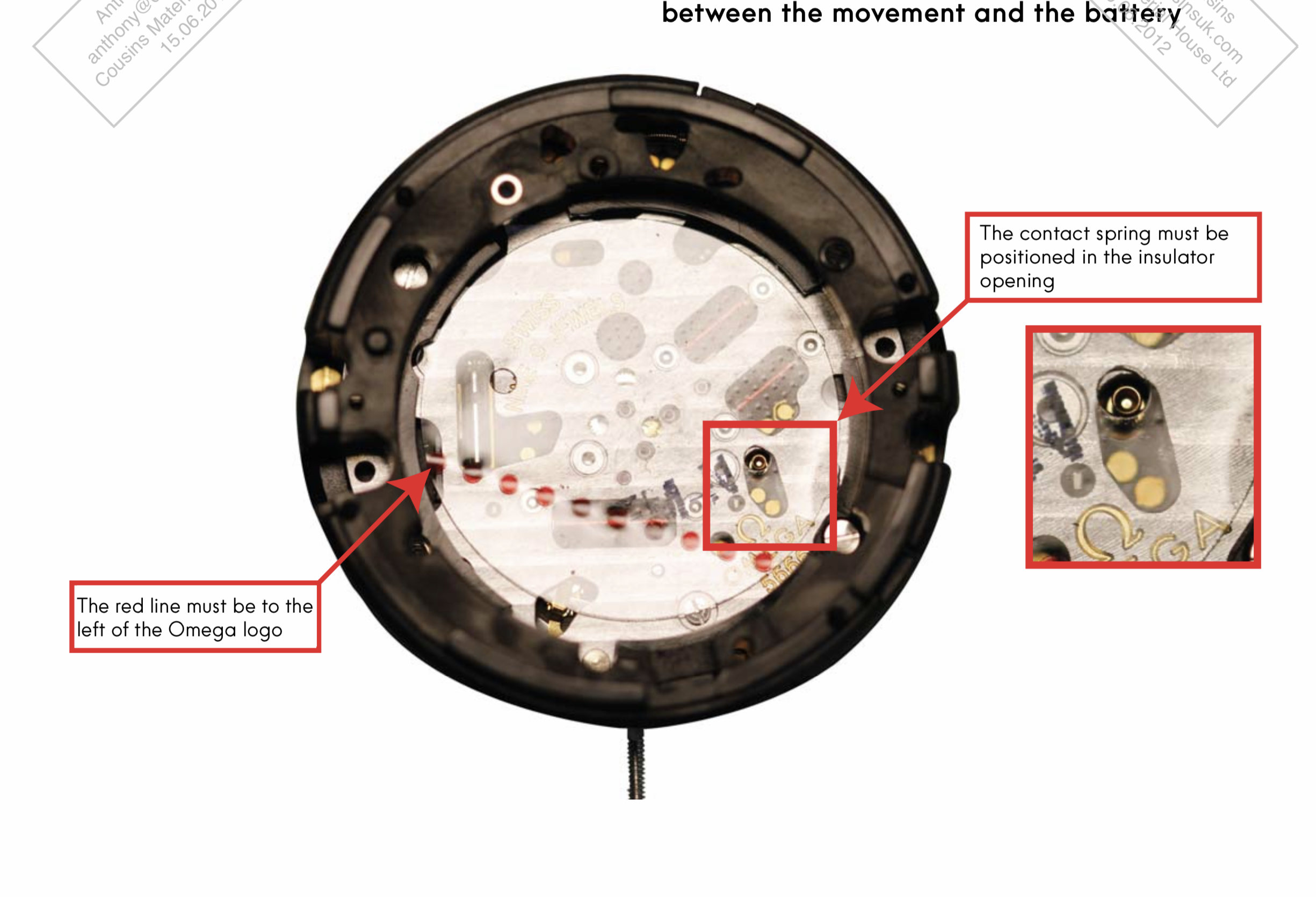

I had this issue with my X-33 when it came back from Omega having had its battery replaced (so definitely not the battery). What I suspect had happened is that something was damaged or incorrectly put back during the battery change. There is a thread here that discusses this (apologies if I am missing one from this forum) https://forums.watchuseek.com/f20/x-33-no-alarm-188723.html
I returned the watch to Omega, who performed a full service free of charge and the watch is once again working fine.

Or could it be this problem :
- contact spring fell off when battery was changed by the AD before the sell.
- or the insulator had been put over the spring and the hole is not in his place ...
