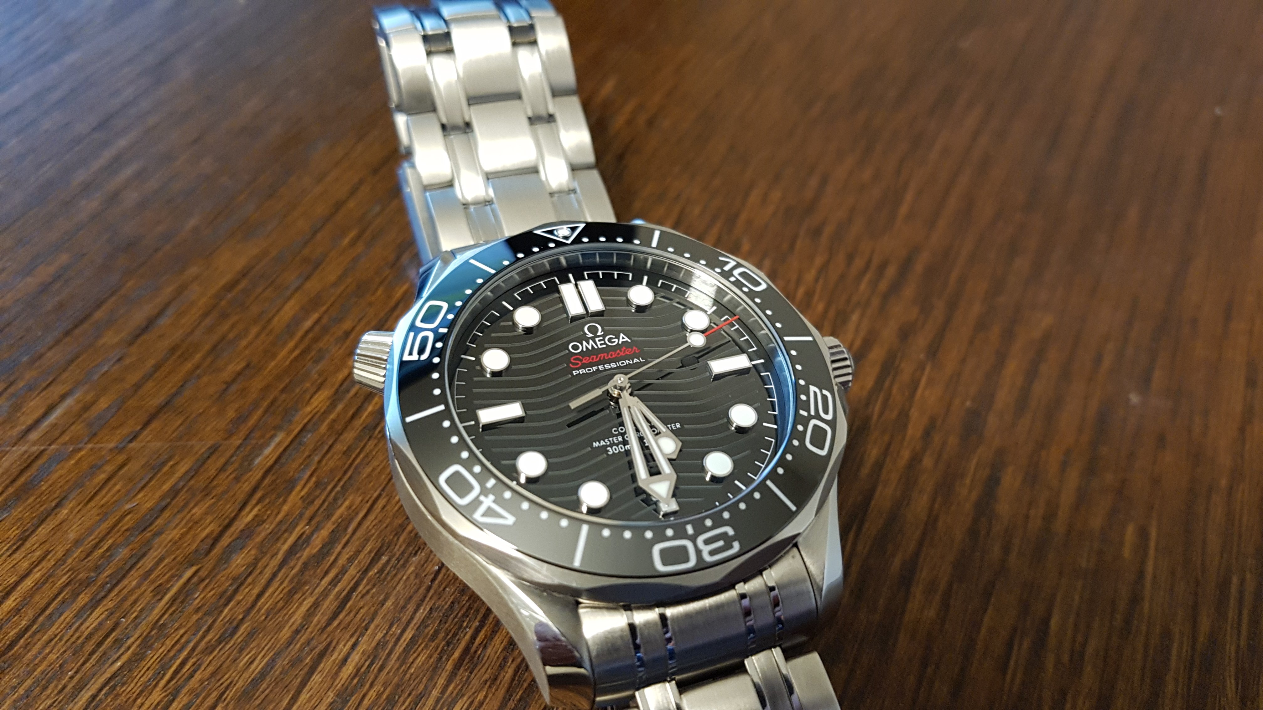

My first feelings with the watch after seeing the first pictures after Baselworld were mixed. I liked everything, but the wave pattern on the dial gave me some doubts. Still today, I don't like the waves on pictures, but in real life, everything changed! In reality the waves are much less of an eye catcher than on pictures, much more subtle. I can say I even like the waves, the way the dial catches light and reflects is different each time, depending on the angle. Sometimes the waves are very light gray, sometimes deep black… It' s definitely not a boring watch. The waves don't give a too busy impression, this was one of my fears before getting the watch.

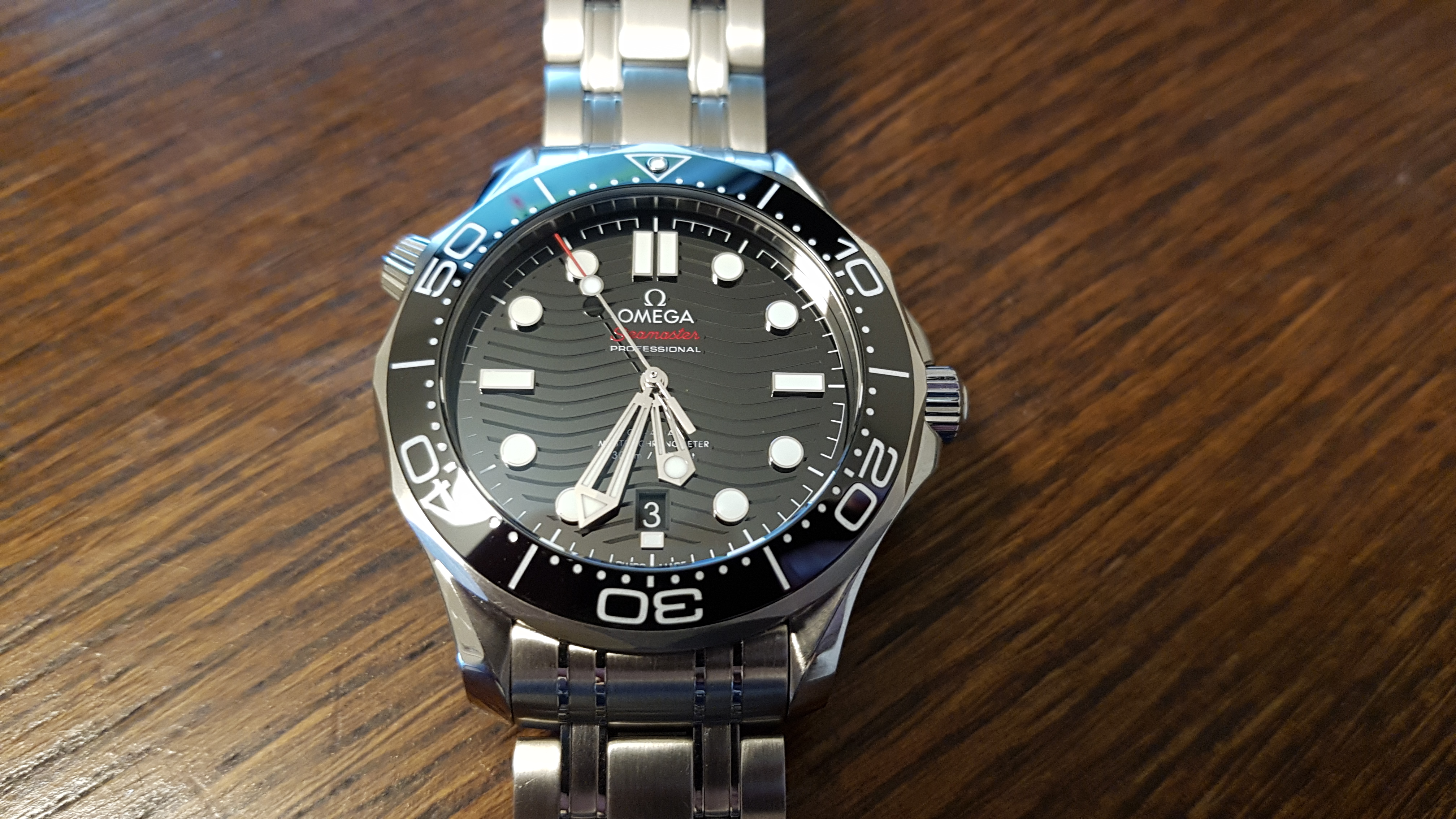

DIAL
The rest of the dial is superb… The big raised indices go very well with the updated skeleton hands. The legibility is top! Before I saw the watch in the metal, I had some doubts on the second track, but eventually nothing to dislike. The new position of the date window is a positive change according to me, the dial is very balanced because of this. What I also like is that the date window has no frame, very minimalistic, goes very well on this dial. Some regret the absence of an applied Omega logo, but on this dial with already bold indices, I think it's good the logo isn't applied. It would make the dial a little busier than needed.
The red accents on the dial look fantastic on the ceramic black background.

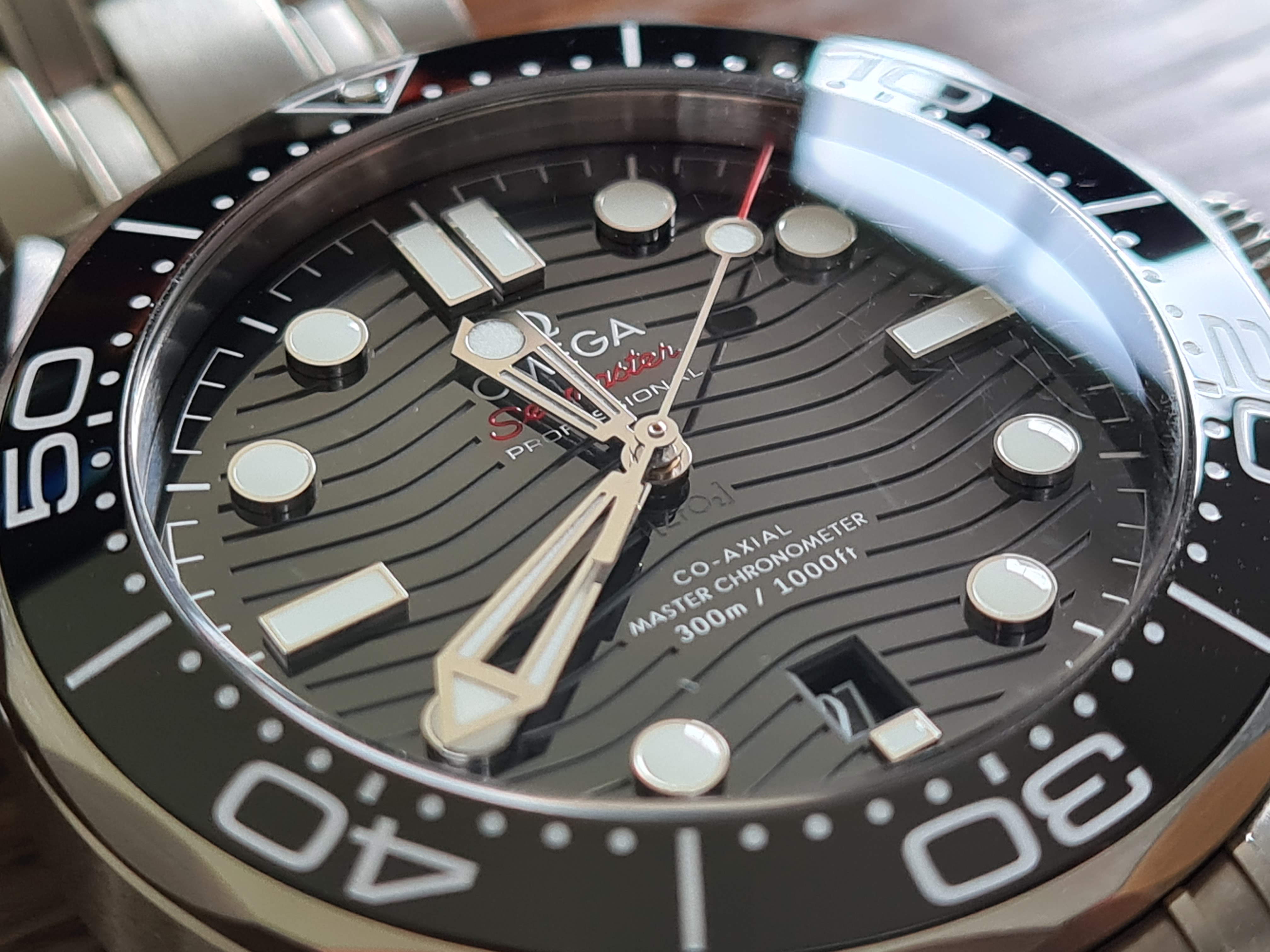

CRYSTAL
The double AR coated crystal looks as if it's not there! Visually it's a stunning crystal. Unfortunately the crystal also leads to the first negative point… After a little over 3 months daily usage, the AR coating has its first scratches. These scratches are very thin, an can only be seen under the correct light angle under LED lights, still… sometimes I do notice them! I was VERY gentle with the watch until now, only wore it at my desk and other 'light' activities. Whenever I thought there was a risk of damaging the watch, I switched watches. My other diver is a TAG Heuer Aquaracer WAN2111. The Aquaracer has a couple of years daily usage, and also has a double AR coated crystal. On the Aquaracer, no scratches can be found in the AR coating! It is still in 100% top condition. I didn't expect this from a new Omega, at least I expected it to be scratch resistant as the TAG. Fortunately, most of the time, this scratches are not visible at all. I tried to get a picture of the scratches, but I don't succeed to get it visible on picture…

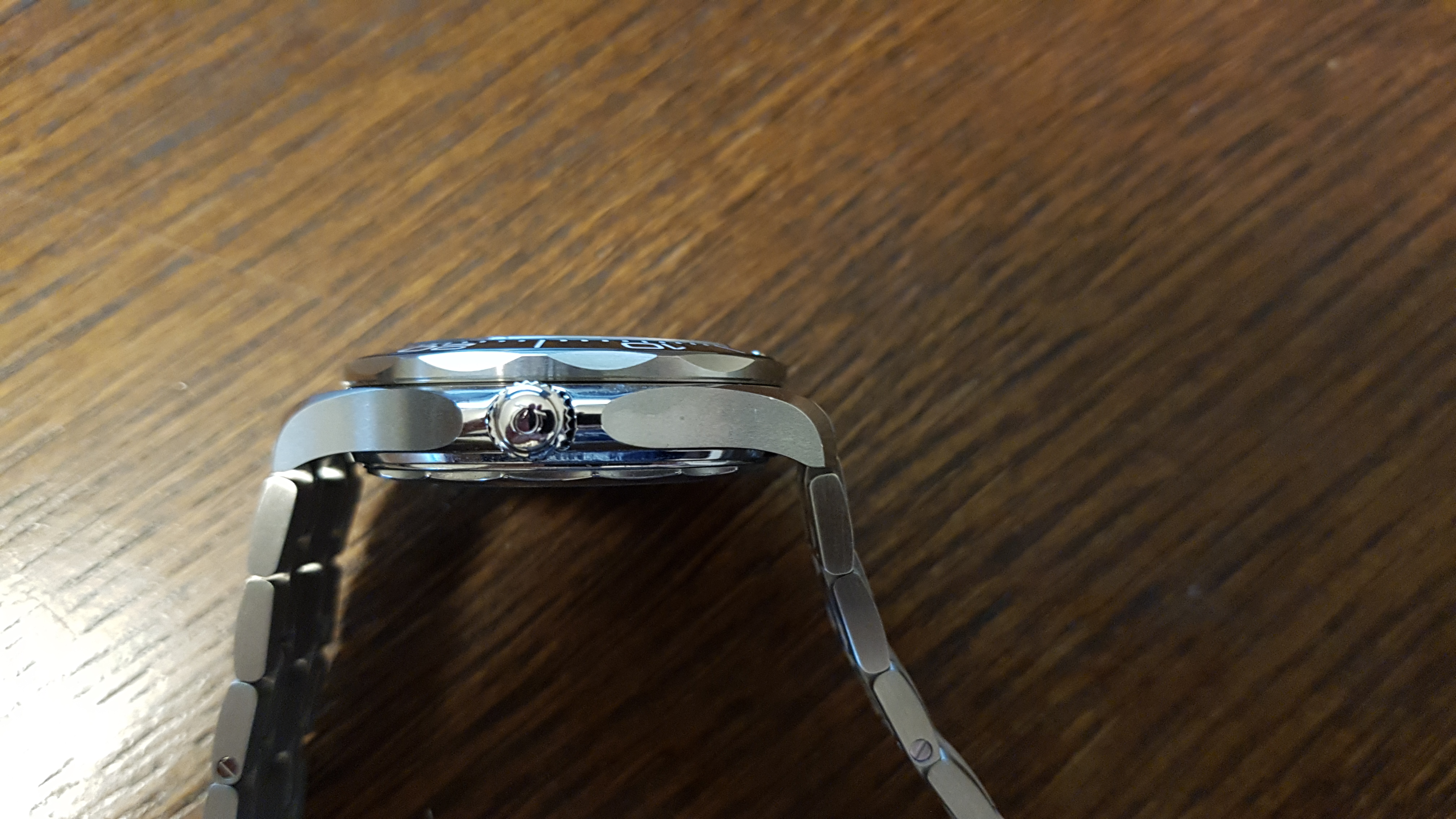

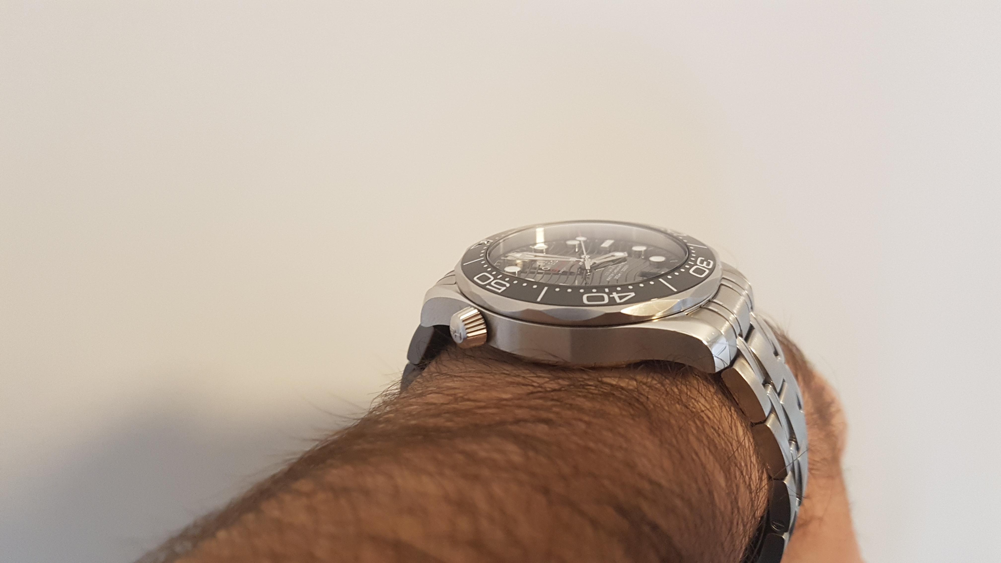

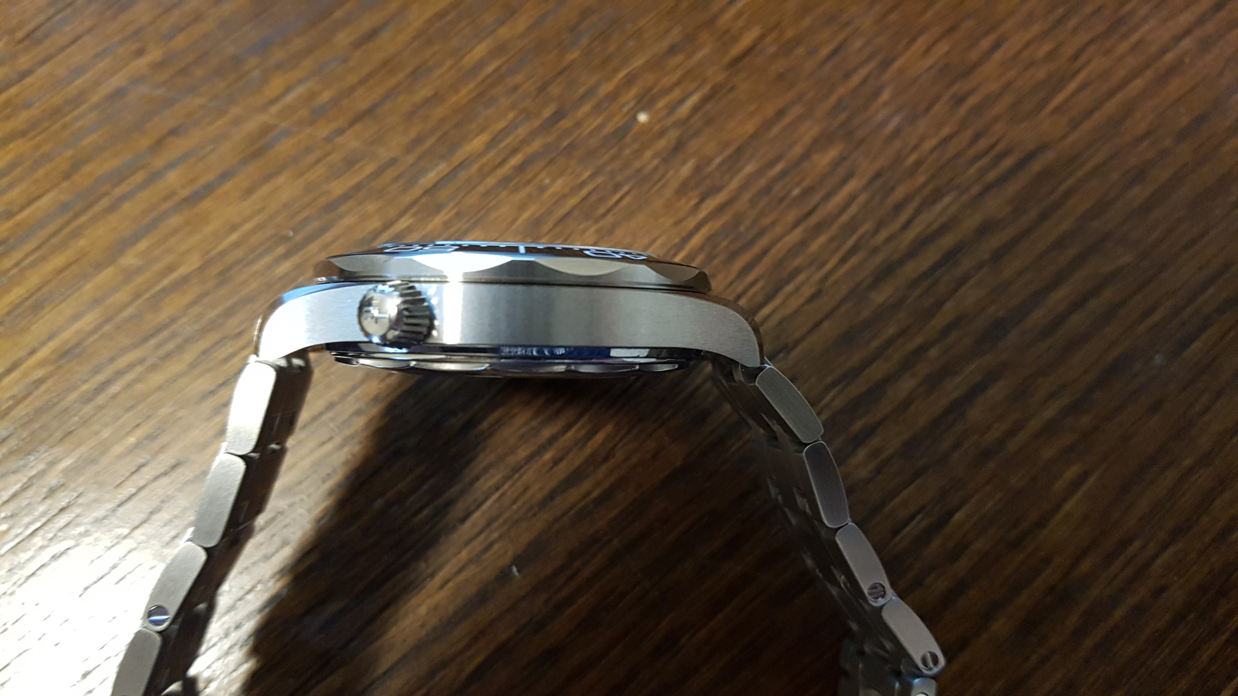

CASE
The case of the Omega is a beauty! The way Omega plays with polished and brushed surfaces is very nice… However, there are some complaints about the size increase of the SMP to 42mm. Personally, this didn't bother me at all until now (for your reference, I have a 17cm wrist). Also the thickness (slightly more than the previous gen SMP) is (again according to my feeling) well balanced with the size of the watch. The SMP doesn’t feel thick on the wrist, nor thin… Just right. I also tried the PO's when buying this watch, there you notice the thickness much more (same with the Tudor Pelagos, that I also tried, feels much thicker).
Another element that created some noise is the update HE valve. Honestly, I hardly notice it is there… Nothing good or bad I can say about it… It's just there and doesn't bother me.
What bothers me (very) slightly is the fact the Omega logo on the crown doesn't line up when screwing in the crown. It’s a small detail, but I can appreciate when the crown logo lines up with the case.
Another point of improvement is the combination lugs + endlink. There is just this tiny bit of space on one side of the endlink and lug. I prefer that this is a really tight fit. In my opinion, this is something Rolex does better.

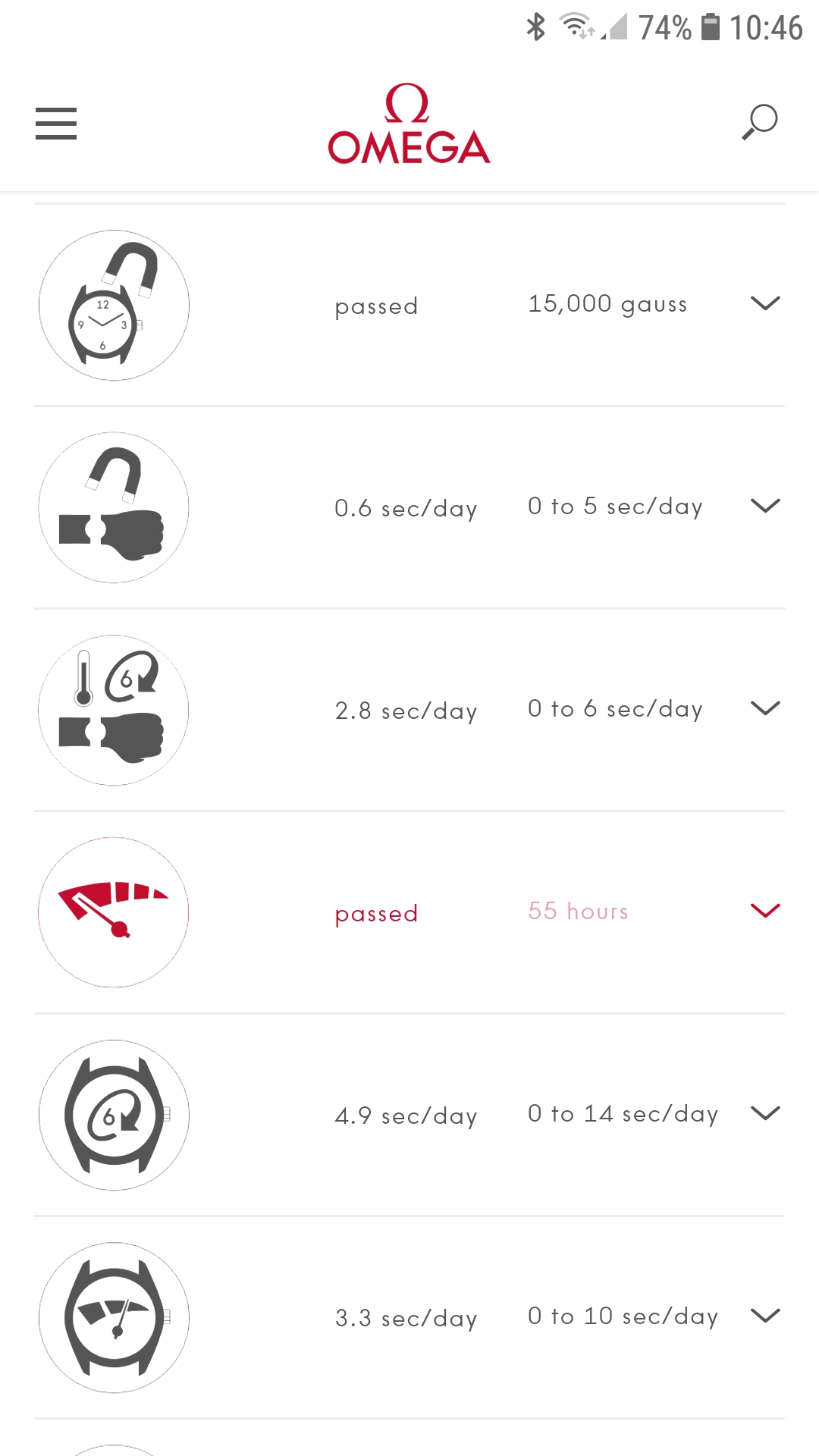

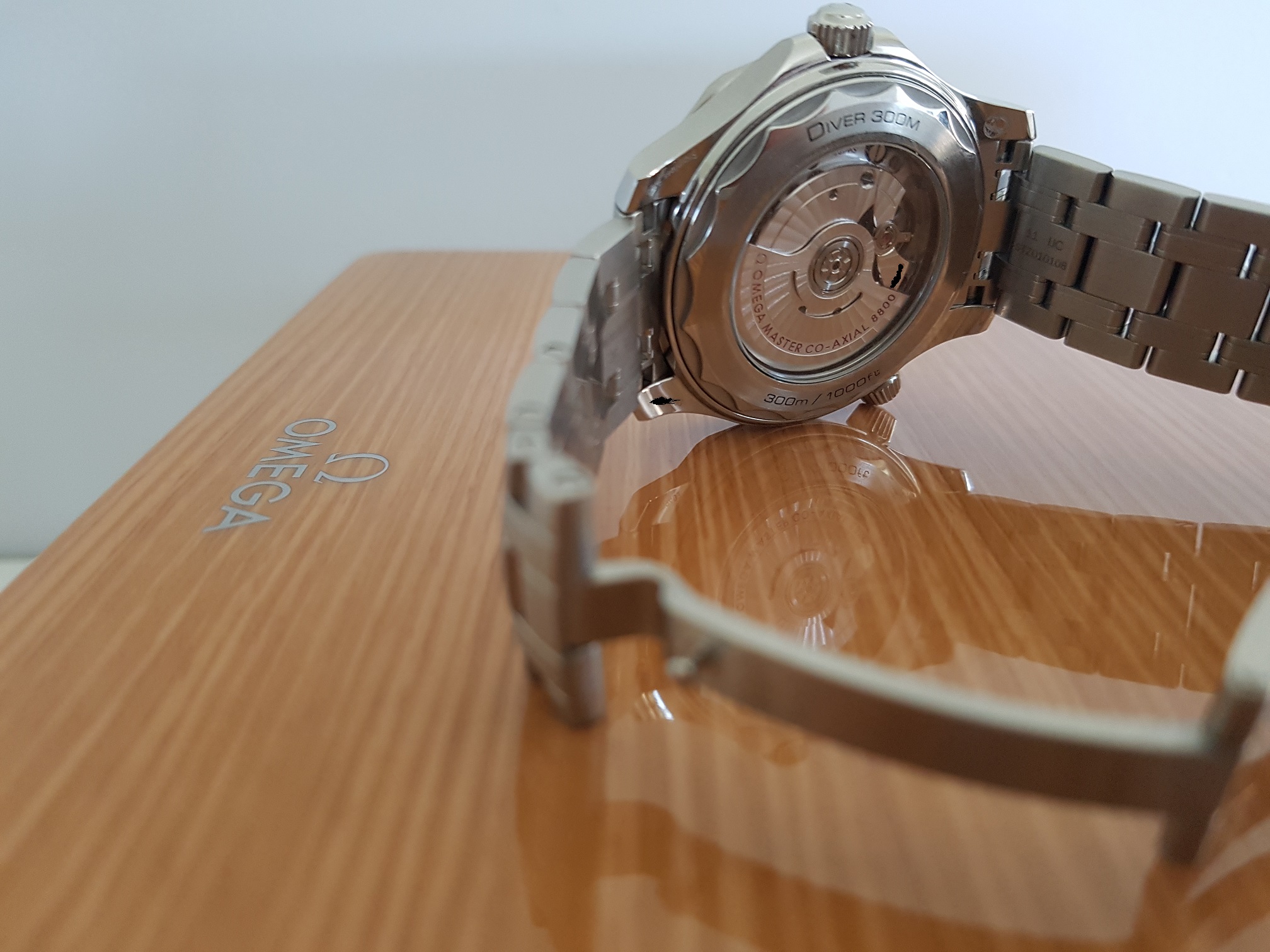

MOVEMENT and ACCURACY
One of the features I love on this watch is the display case back. Although a lot of people prefer a steel case back on a diver I like the fact I can admire the 8800 movement. So far the 8800 is keeping great time. My SMP loses between 1 and 1,5 second per day. Now this brings us at a very strange thing… according to my METAS test results, my clock averaged + 2,8 seconds per day during the METAS test. The +2,8 seconds per day, is the average rate of the 6 positions they measure (equally weighted). Still, the -1,5 is very far away from the METAS test results, and that made me curious… how is this possible (yes I know the 2,8 is an average…). I started measuring myself (test cycles of 24 hours per position) the 6 positions, this is what I measured:
My tests results -0,82 s/d is closer to what I see in reality (-1 to -1,5) with my wearing habits. Preferably the clock should run a little fast instead of slow, but at this point in time I don't mind this too much. I don't think it's worth it to get it regulated, maybe I get it back at +3 s/d, worse than it runs today.
Another impressive feature of the movement is the date change, on my clock the date flips over between 105 and 90 seconds before midnights and it does this consistently, very nice!
I only let it run until empty on one occasion, the 8800 stopped after 60 hours. 5 hours more than the advertised 55 hours.

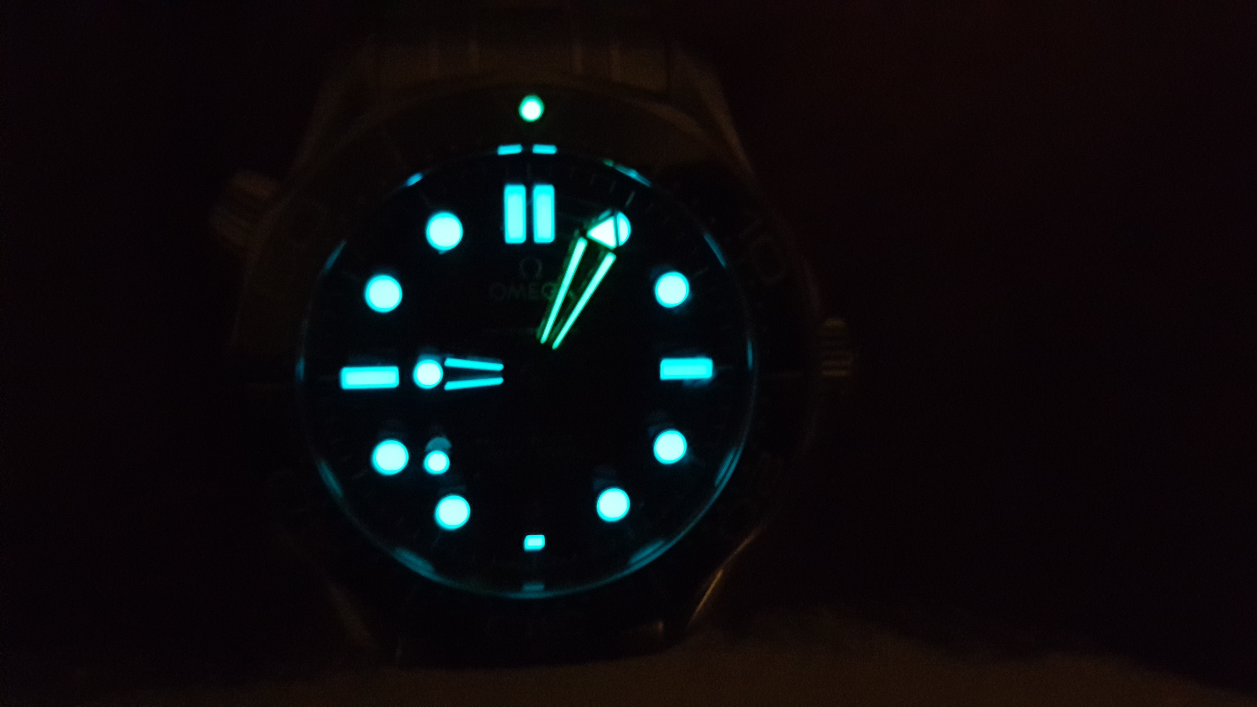

LUME
Lume is great! When not properly charged, the lume on the hands is less visible, except for the tip of the hands where there is more lume.
