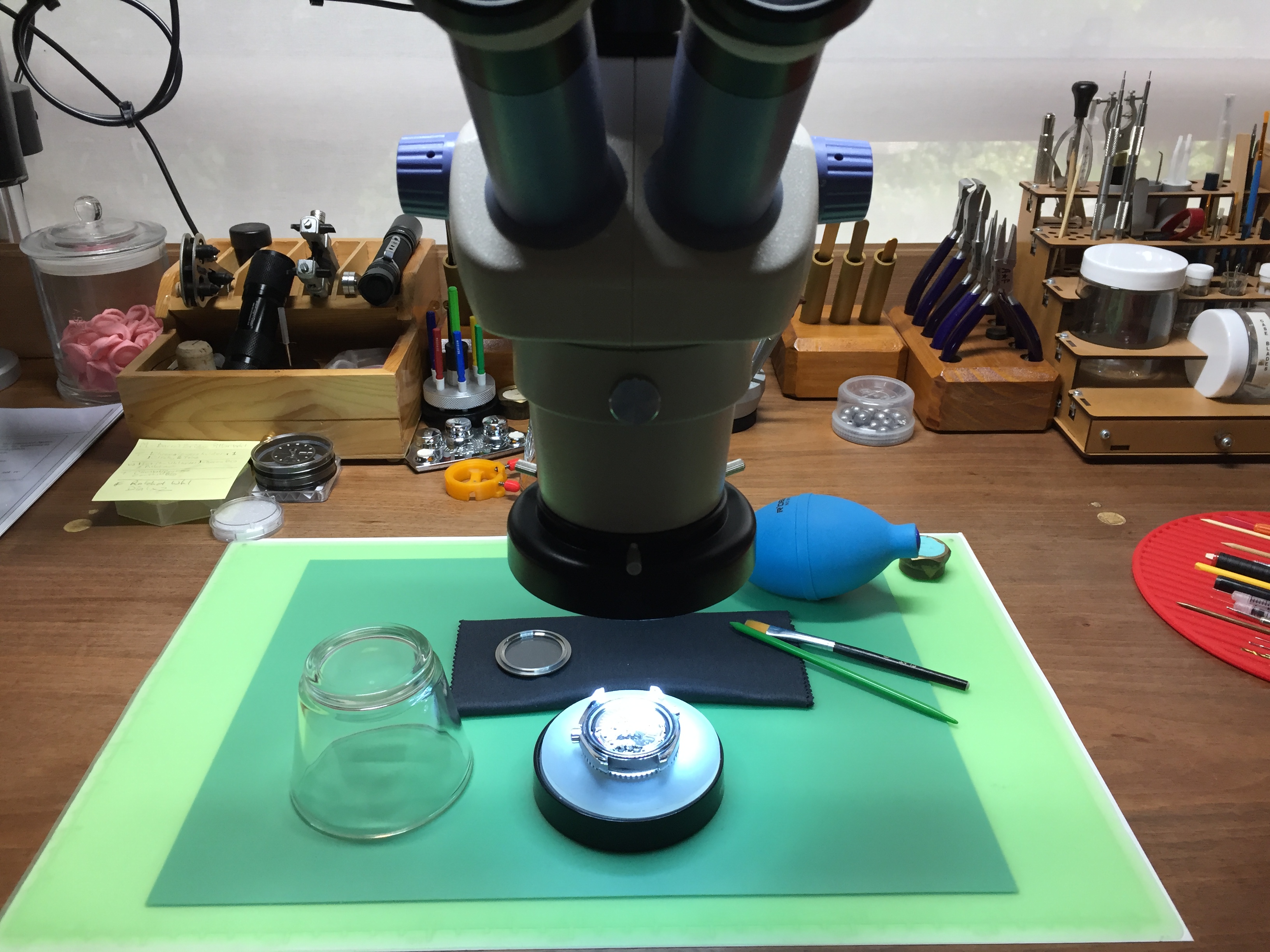

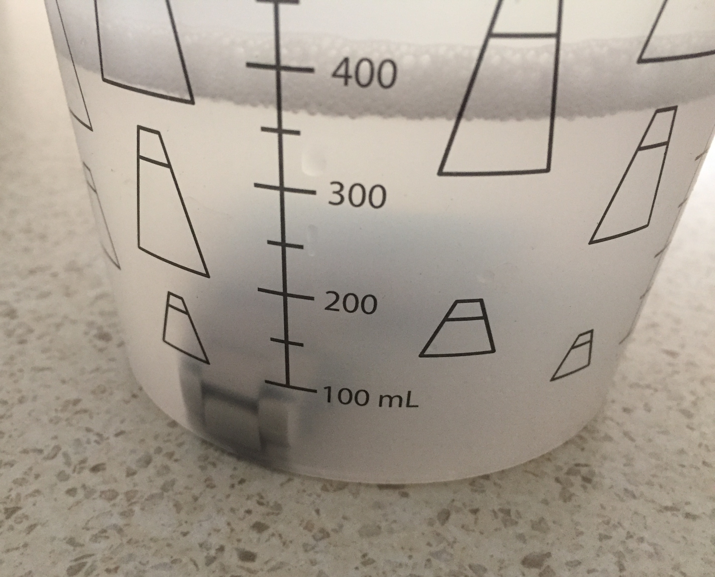

I agree Al. Even though the risk factor is low I took the normal precautions that we're becoming used to these days.
I wiped the watch/wrapping with benzalkonium chloride towelettes as I unwrapped it, then it was placed in room temperature water/detergent solution for 30 minutes. It'll be rinsed in lukewarm water and allowed to dry before I do anything else. It's been in there for about half an hour so here's a pic before I take it out.

I realize you know what you're doing, and that that is an extreme understatement.
But given that the reported problem was "water ingress" if that were my watch, I'd be having conniptions!
馃槻馃槻馃槻馃槻馃槻馃槻馃槻馃槻馃槻
馃槻馃槻馃槻馃槻馃槻馃槻馃槻馃槻馃槻
A short period with both watch and water at room temperature and no pressure variations and it'll be OK.
Nobody knows what caused the initial problem, but this activity is to eliminate any moisture remaining in the watch until the repair centre re-opens.

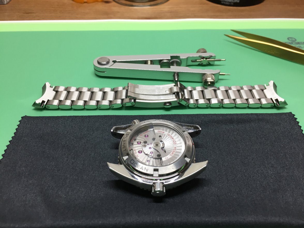

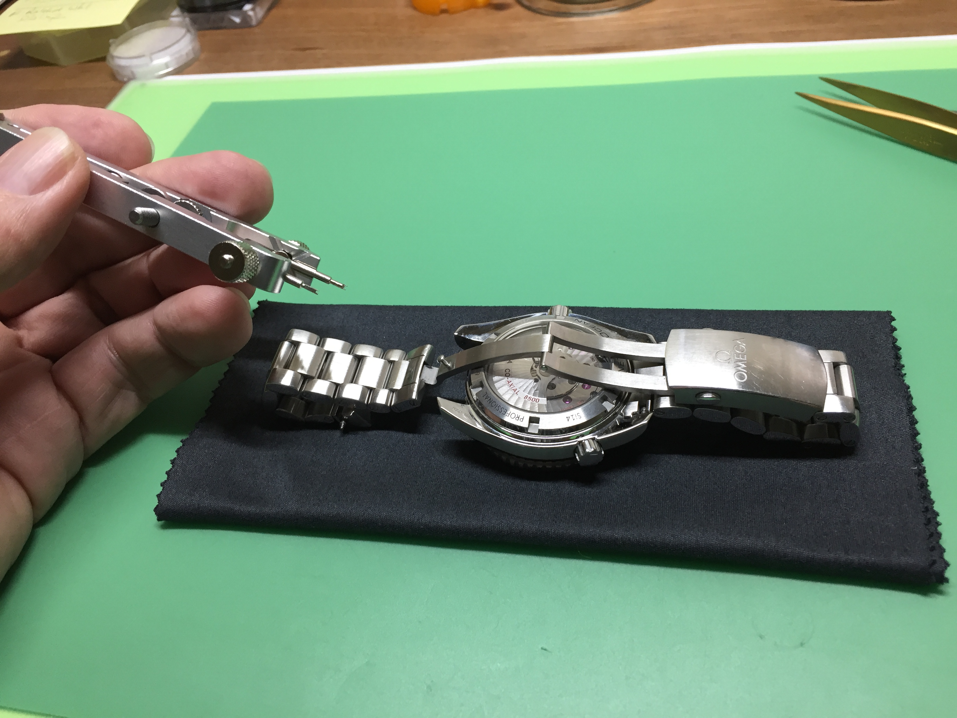

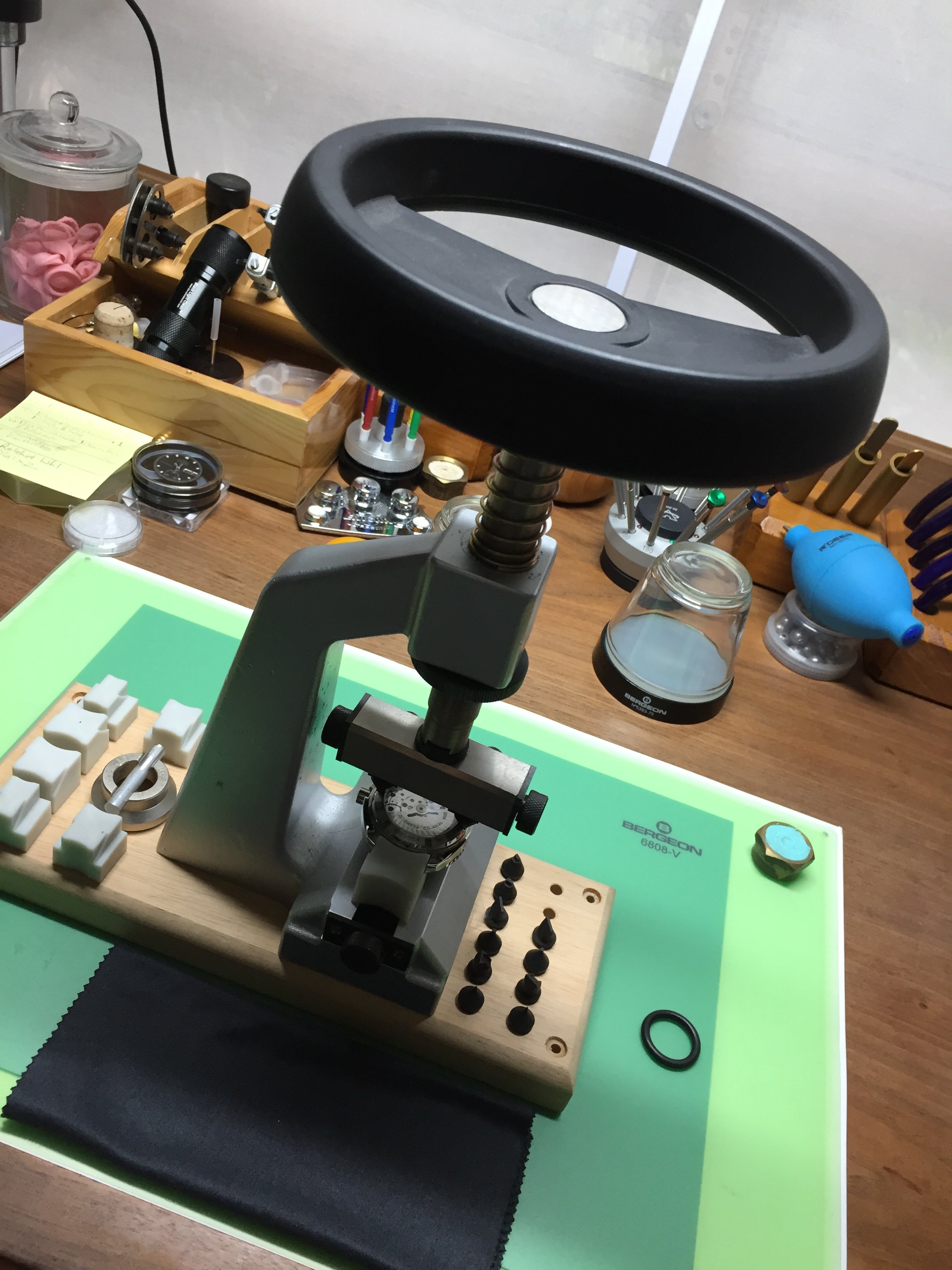

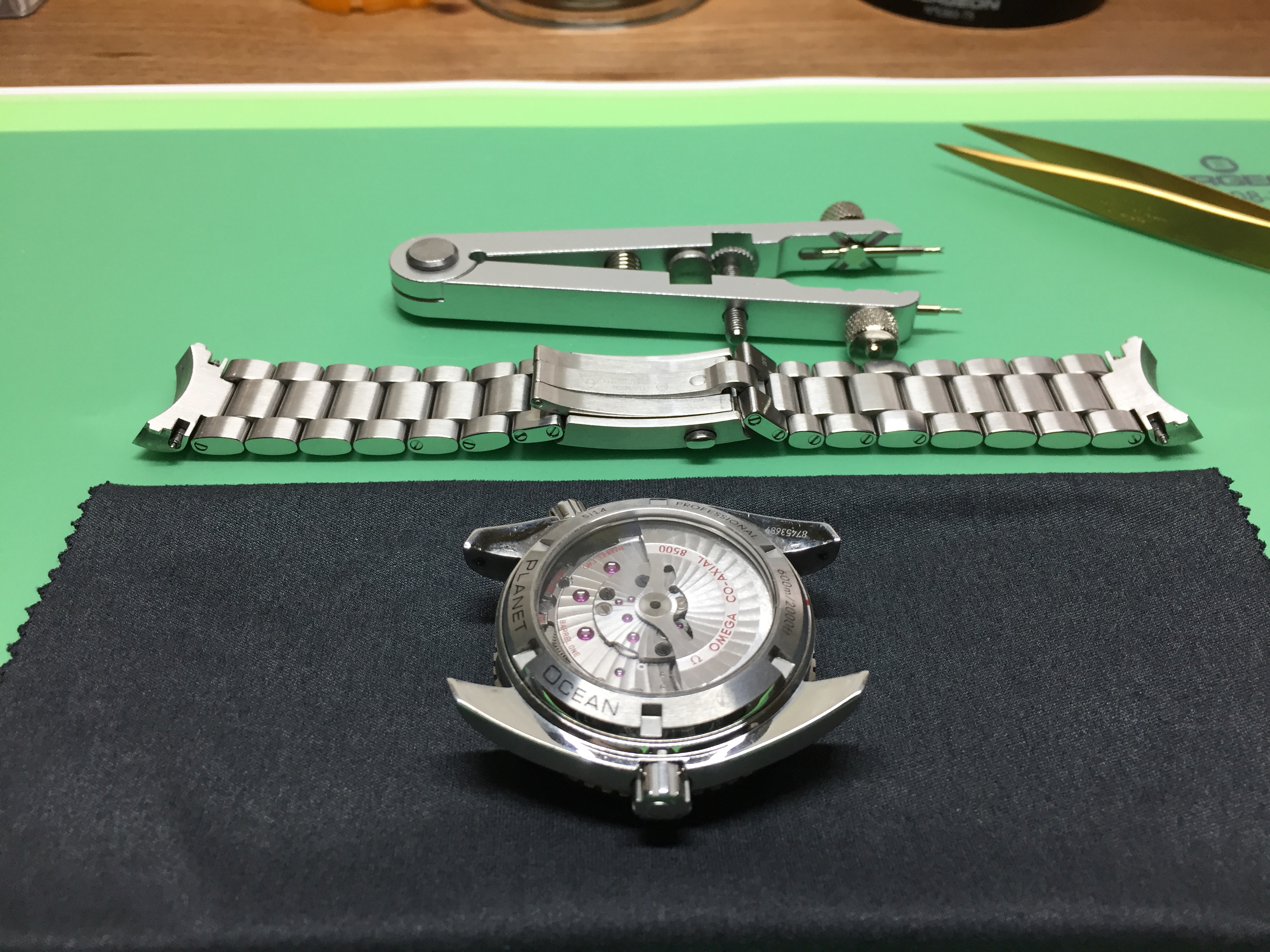

Now that the watch is clean and dry, first thing is to remove the bracelet.
Then I can clean around the edge of the caseback prior to removal.
Caseback is removed.

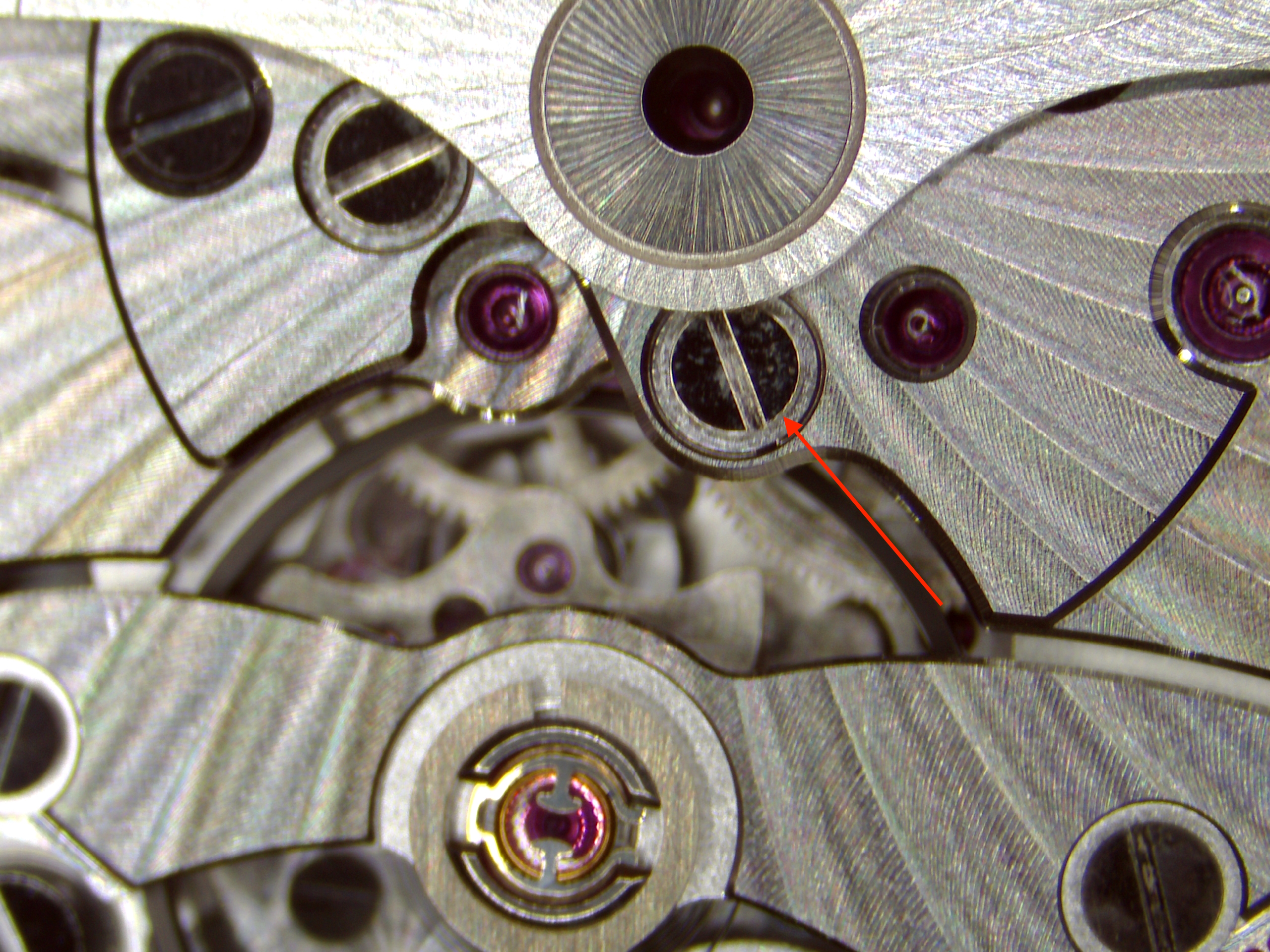

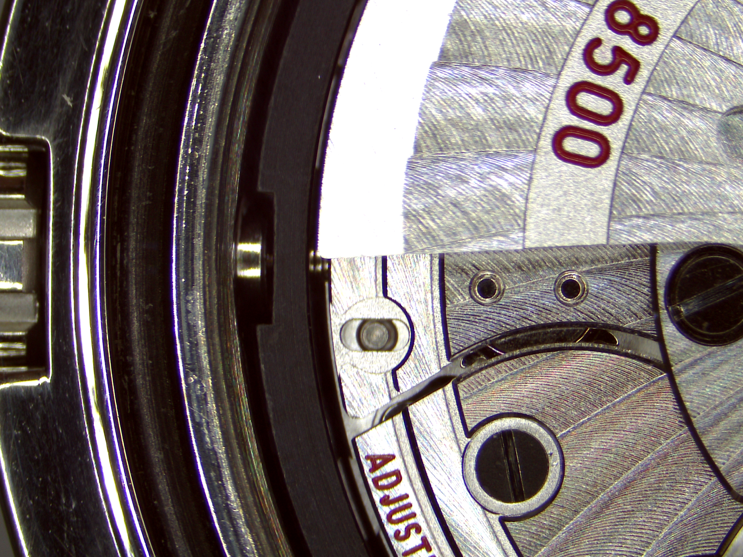

Movement is inspected for any signs of serious damage.
Nothing of concern, the crown area has no evidence of serious water intrusion.
Although some of the screw heads have a slightly frosted appearance, sometimes an indication of moisture but not always.

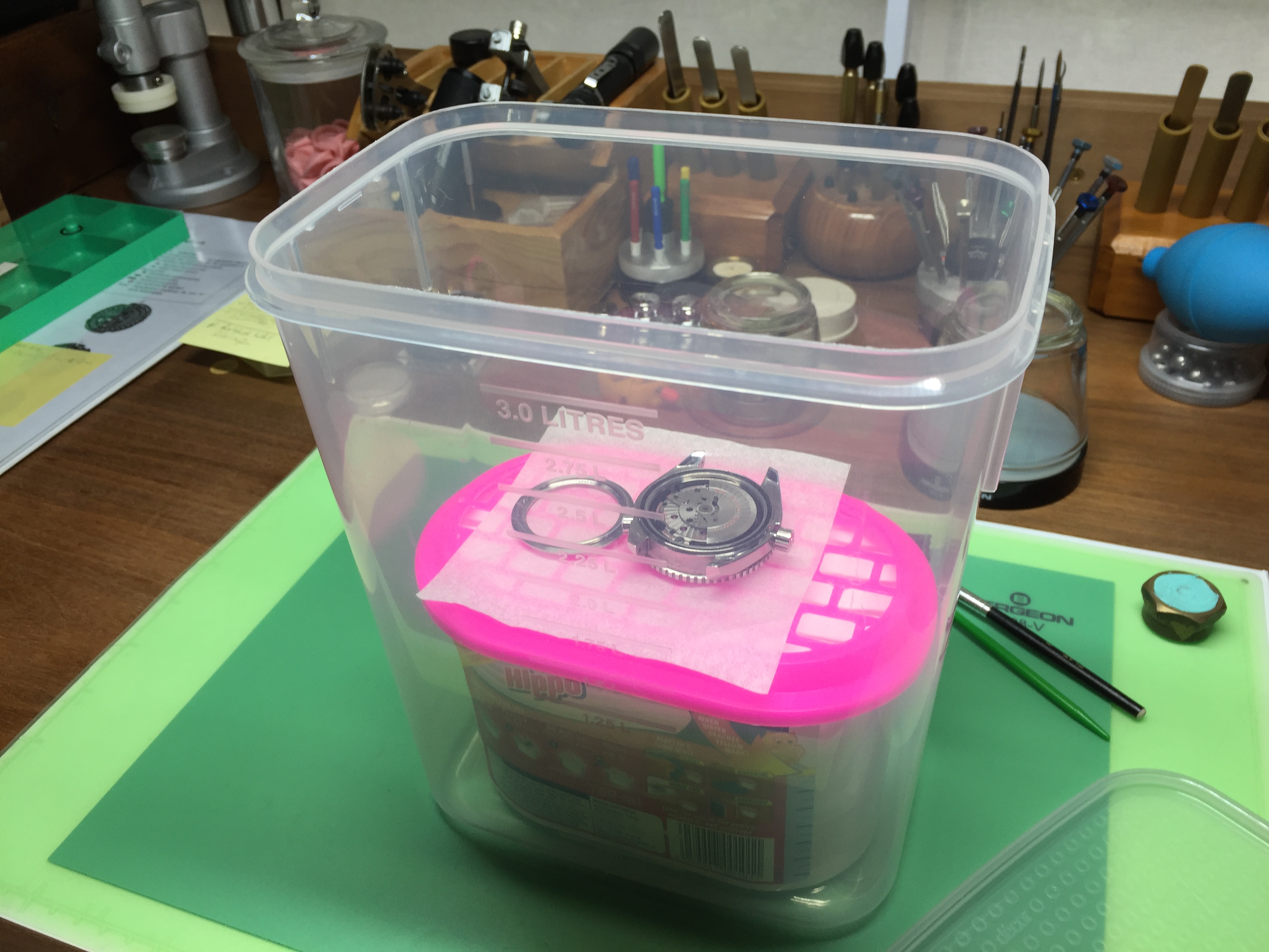

Now it's ready to be dried out.
The watch is placed on watch paper in the "drying machine" where it will live on a warm window sill for a few days before being sealed up again.

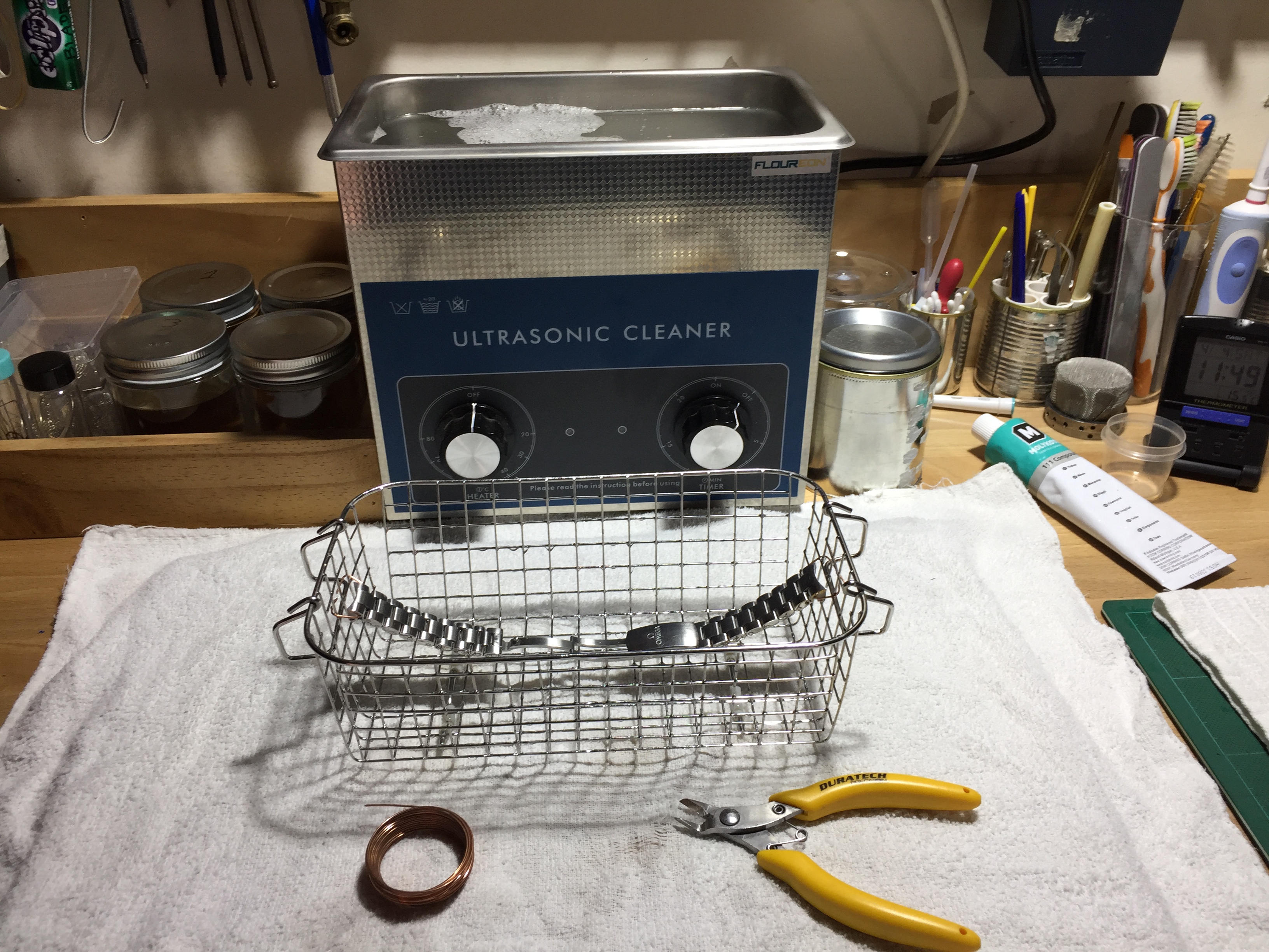

The bracelet goes into an ultrasonic bath for 10 minutes, then it'll be rinsed in hot water, dried, and then put away until its ready to go back on the watch.
