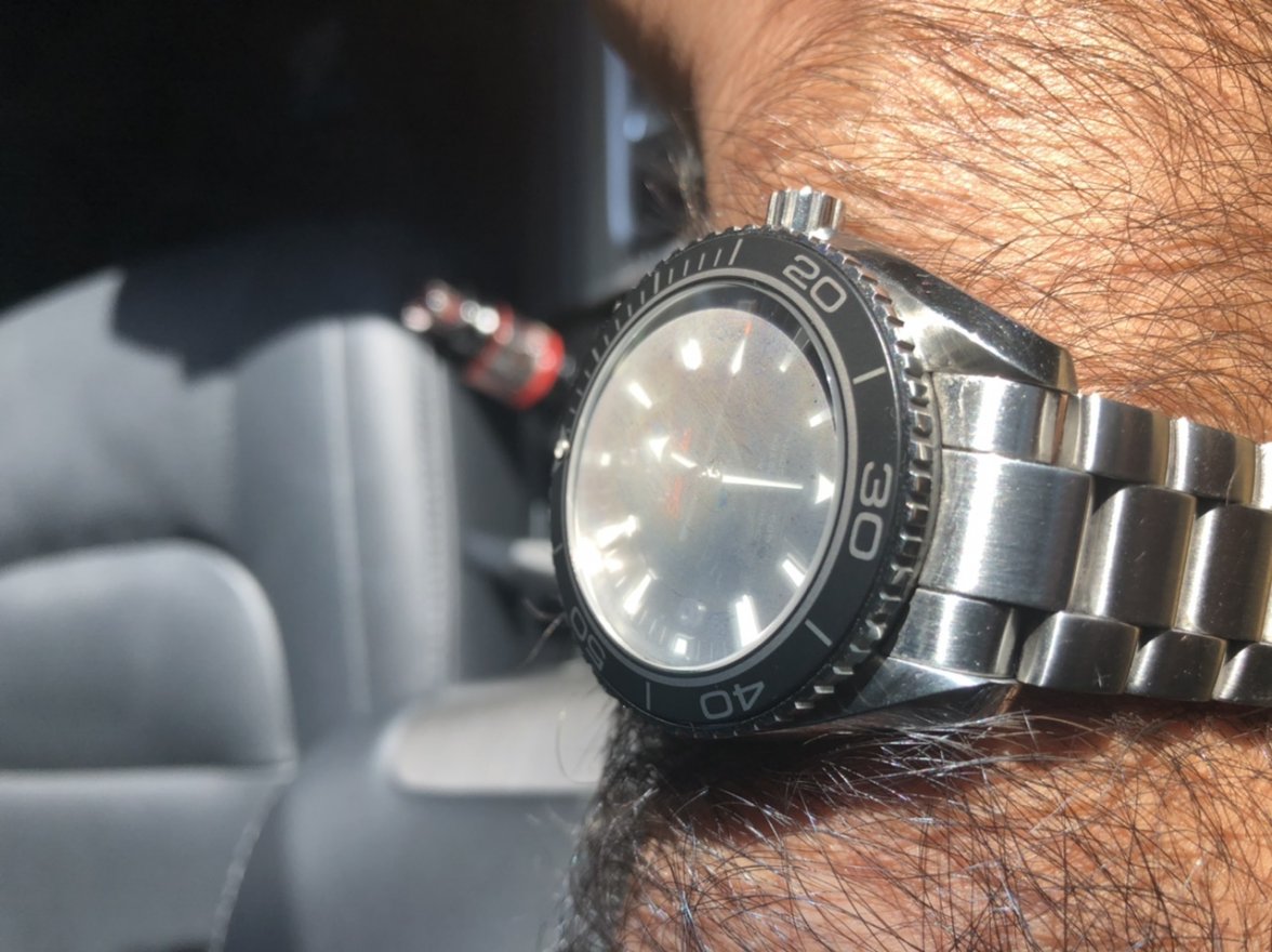

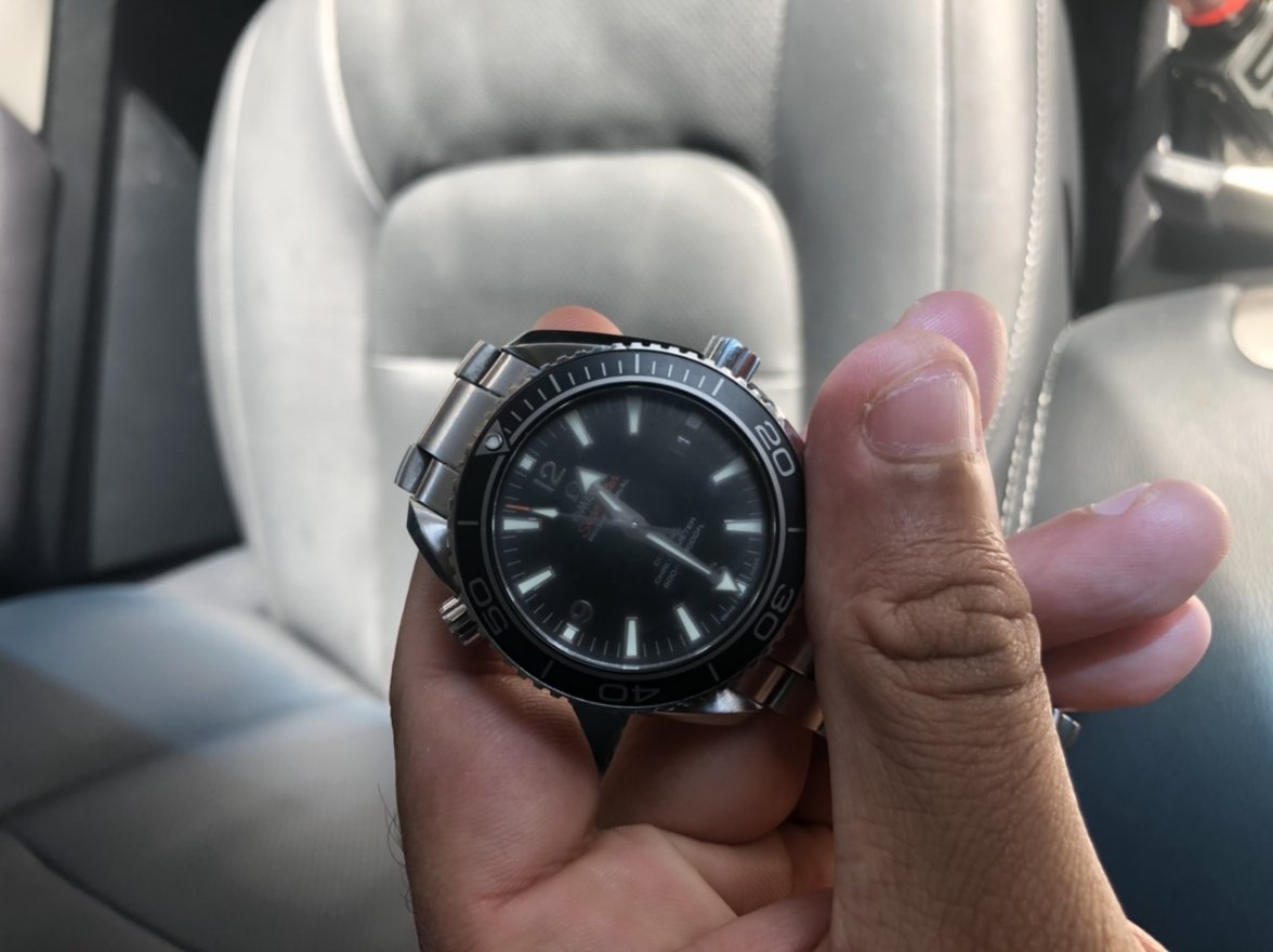

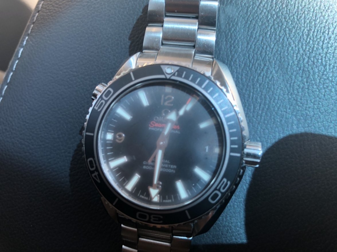

I really need your help in understanding this strange problem I’m seeing on my 4 year old PO600 (42mm) watch. Last weekend when I looked at the watch at some point I noticed that the watch has turned completely foggy and I could barely read the time. Initially I thought it was temporary and wiped the glass case with a clean cloth but the fog wouldn’t clear. Surprisingly though it got cleared itself after few hours but when I wore it today again the same phenomenon occurred. I can say following things about this watch.
1.very light use, wear it only in the weekends
2. Never I mean never used in water, not to mention hardly wash my hands whilst watch is on my wrist.
3. Watch has never been serviced, again it’s been only about 4 years since the purchase.
Please can you go through the photos and advice if you have an idea about what might have caused this? Is there anything I can do on my own to address if at all possible?
Thanks guys.
-Bindo

I would assume this is condensation, leave it in the sun. Take it asap to a good watchmaker to have seals checked and for water ingress.
Best of luck.

Even though you never took it in the water, one of the gaskets seals allowed some moisture into the watch - probably when you were washing your hands or in a rainstorm. It happens. Now that moisture evaporates when the watch is exposed to sunlight and gets warm enough, causing the fog. You definitely should not wear it until you can get that moisture out and get it serviced with new gaskets all around. As others have said, your best bet is to remove the case back and get the moisture out, then close it back up and keep it in a dry place until it can be serviced.
If you remove the moisture and start wearing it again, you are likely to get water in there again. This is one reason it is recommended to get a watch pressure tested every year or two between servicing to identify problems like this before you get moisture in the watch.
