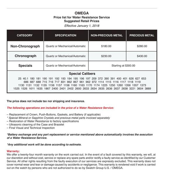

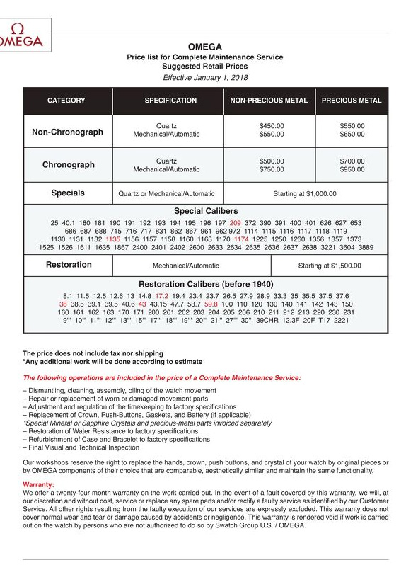

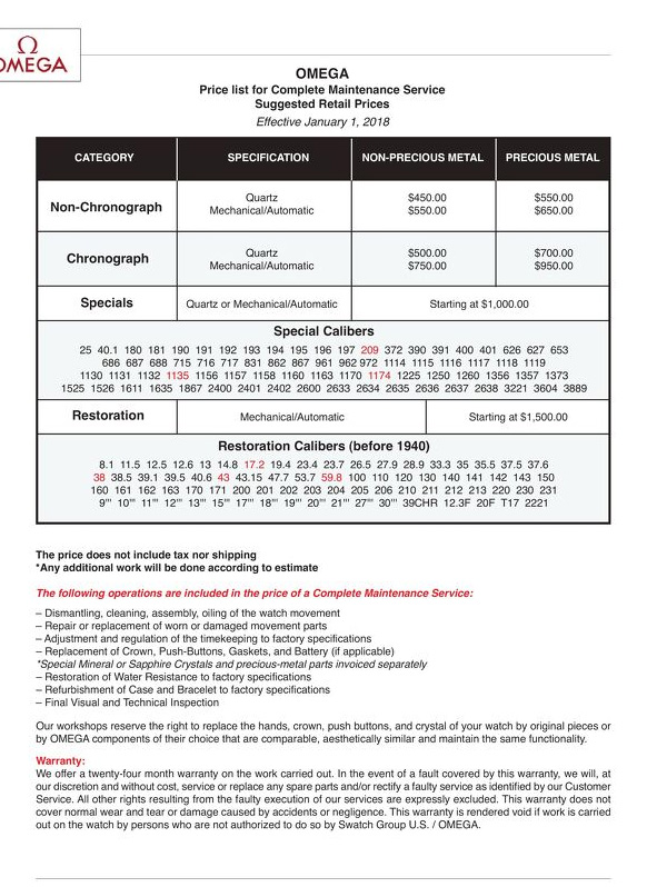

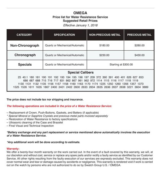

Have attached a few images of what Swatch/USA will do in the course of a full or partial Omega service, in case they may be helpful.
