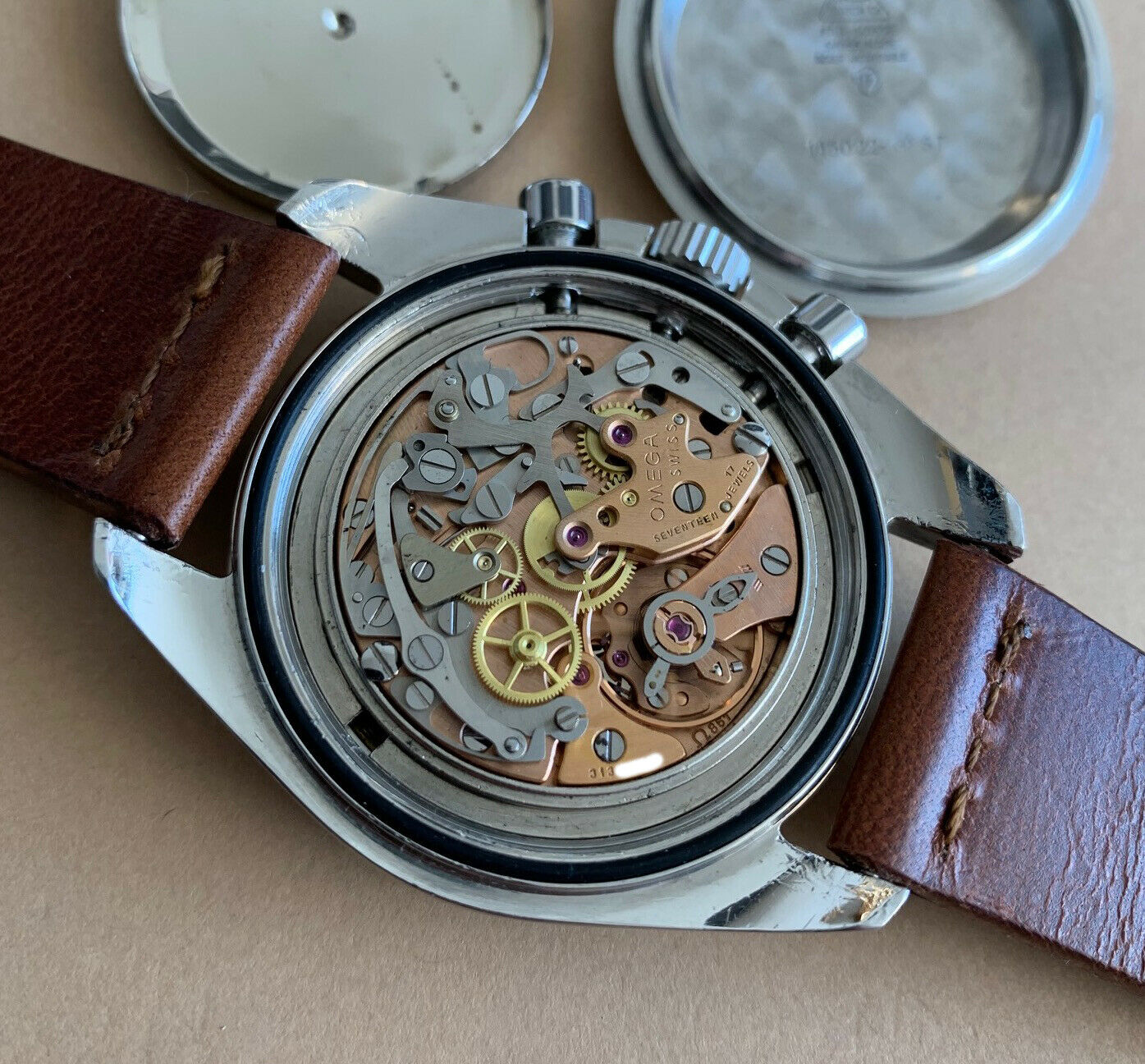

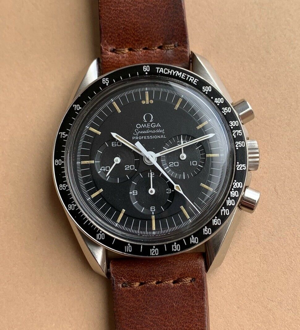

Hi everybody, I just purchased my first Speed, a 145 022 69 ST, a few days ago (I joined some pictures of it)
I managed to test my watch's accuracy on TG-timer, in order to know if it needed service or not.
The results I got are not so good (the watch was fully wound before the test, with the lift angle set to 50°) :
- Dial up : -11s/d ; Beat Error 0,8ms ; amplitude 230-245°
- Dial down : -5s/d ; BE 2,2ms ; no measure of the amplitude
- Vertical position (straight) : -7s/d ; BE 2,6ms ; no measure of the amplitude
- Vertical position (upside down) : -17s/d ; BE 2,3ms ; amplitude about 200°
- Crown up : -11s/d ; BE 2,4ms ; no measure of the amplitude
- Crown down : -6s/d ; Be 2,2ms ; no measure of the amplitude
It seems like the beat error and the amplitude are bad, do you think this can wait, or should I manage to service my watch rapidly ?
Thanks to all
8,701
14,612
If you don't know the service history and plan to wear it, assume it needs a service.
30,274
78,128
Based on those numbers, presuming it was fully wound, yes it definitely needs a service.
