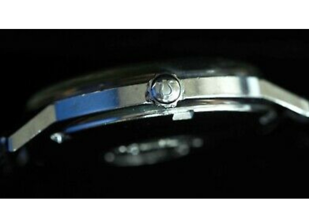

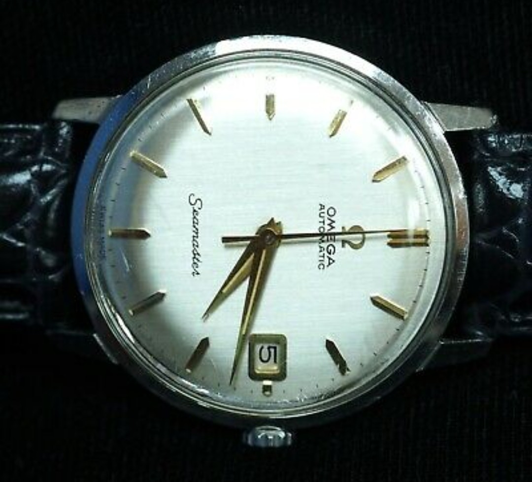

I m planning to purchase an vintage Omega seamster .See this one from trust seller on eBay. Don't know much about vintage omega watch . Therefore need help from OF member.
The watch look original IMO (166.001). Seller asking $750.
Is it worth . Need help

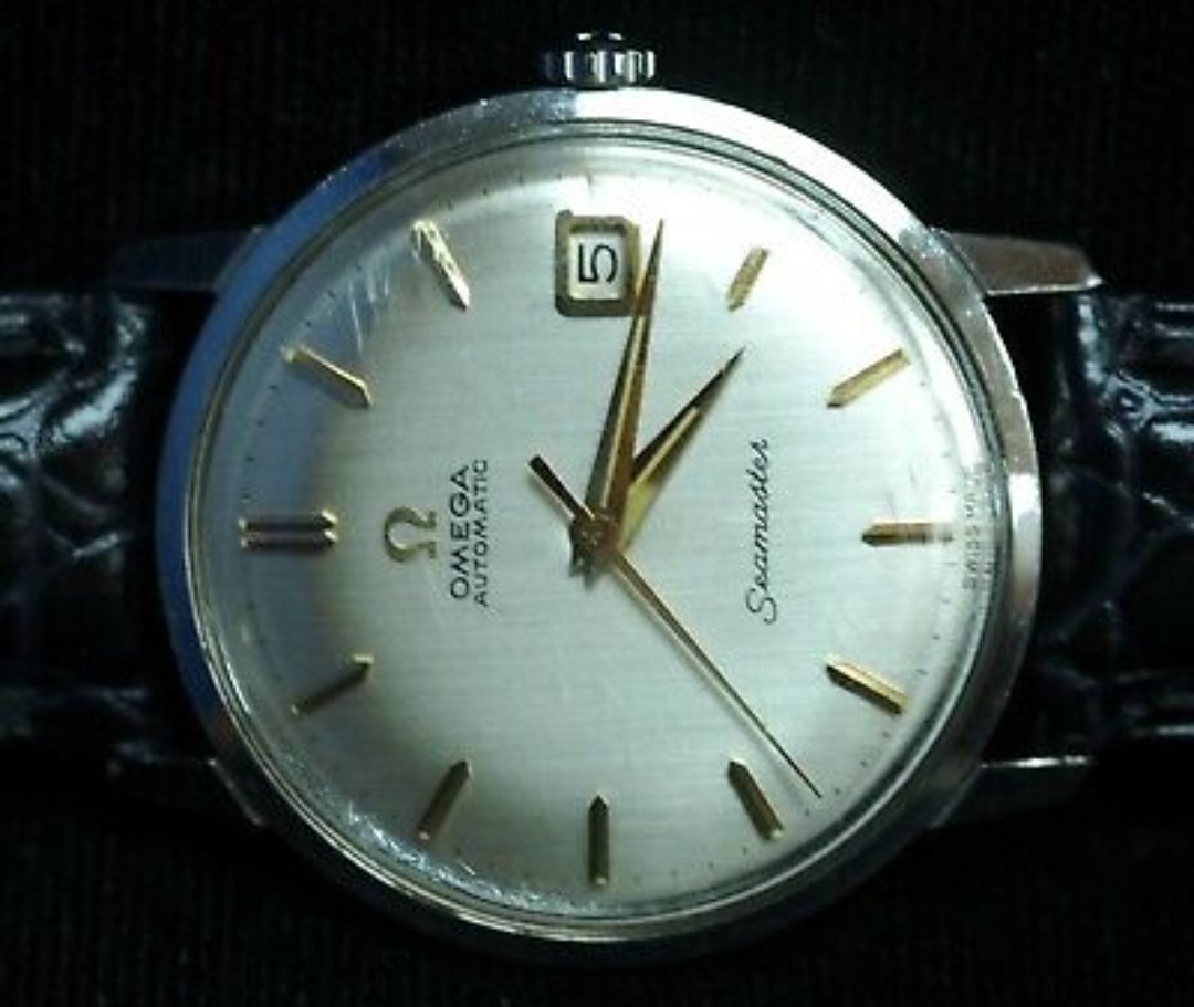

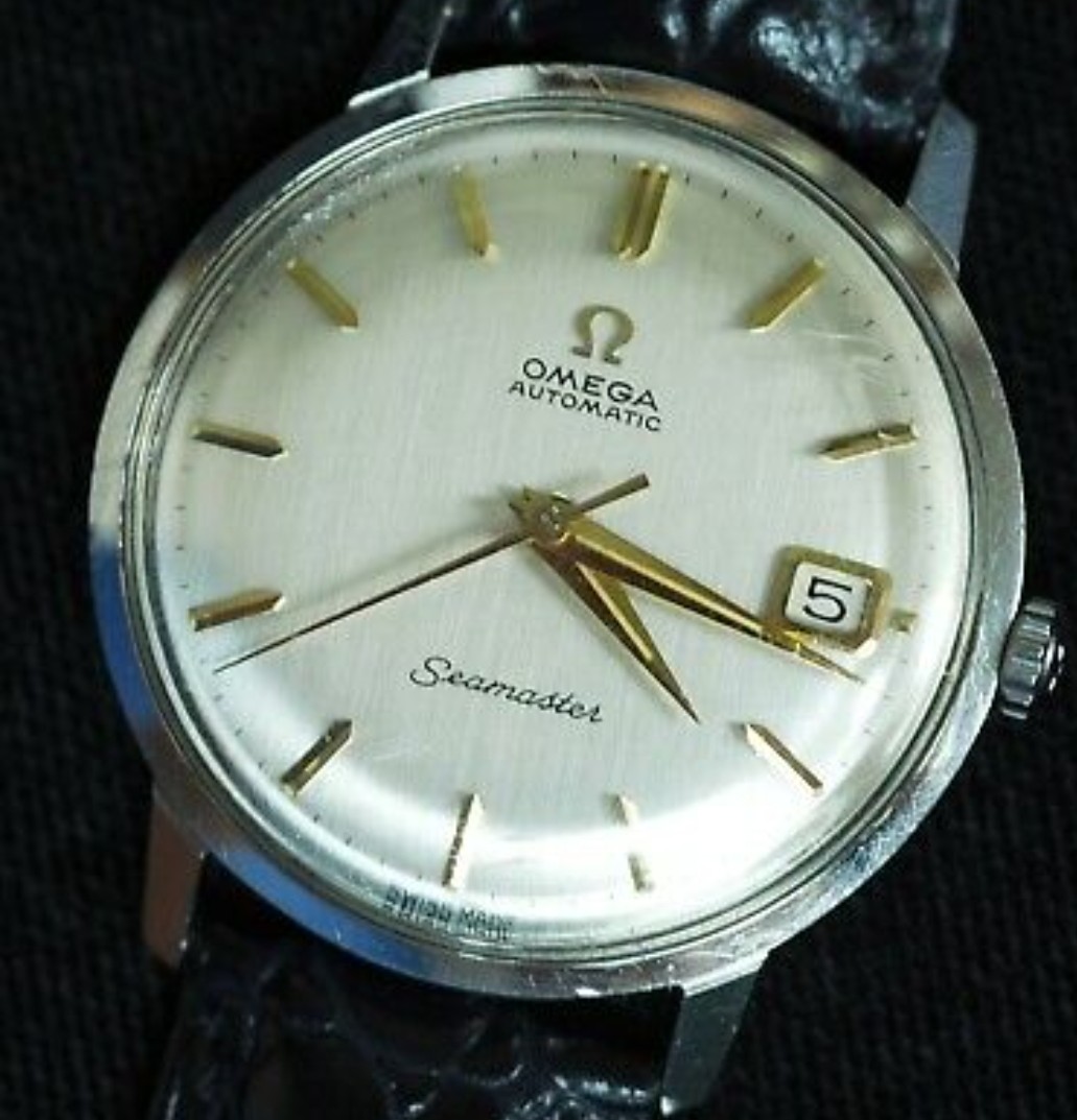

It's a Seamaster, not a Constellation. That said, all parts look original to me, and in fairly decent condition. The price is a little high, but I think it's reasonable. Not NOS by any means but the case looks fairly sharp.

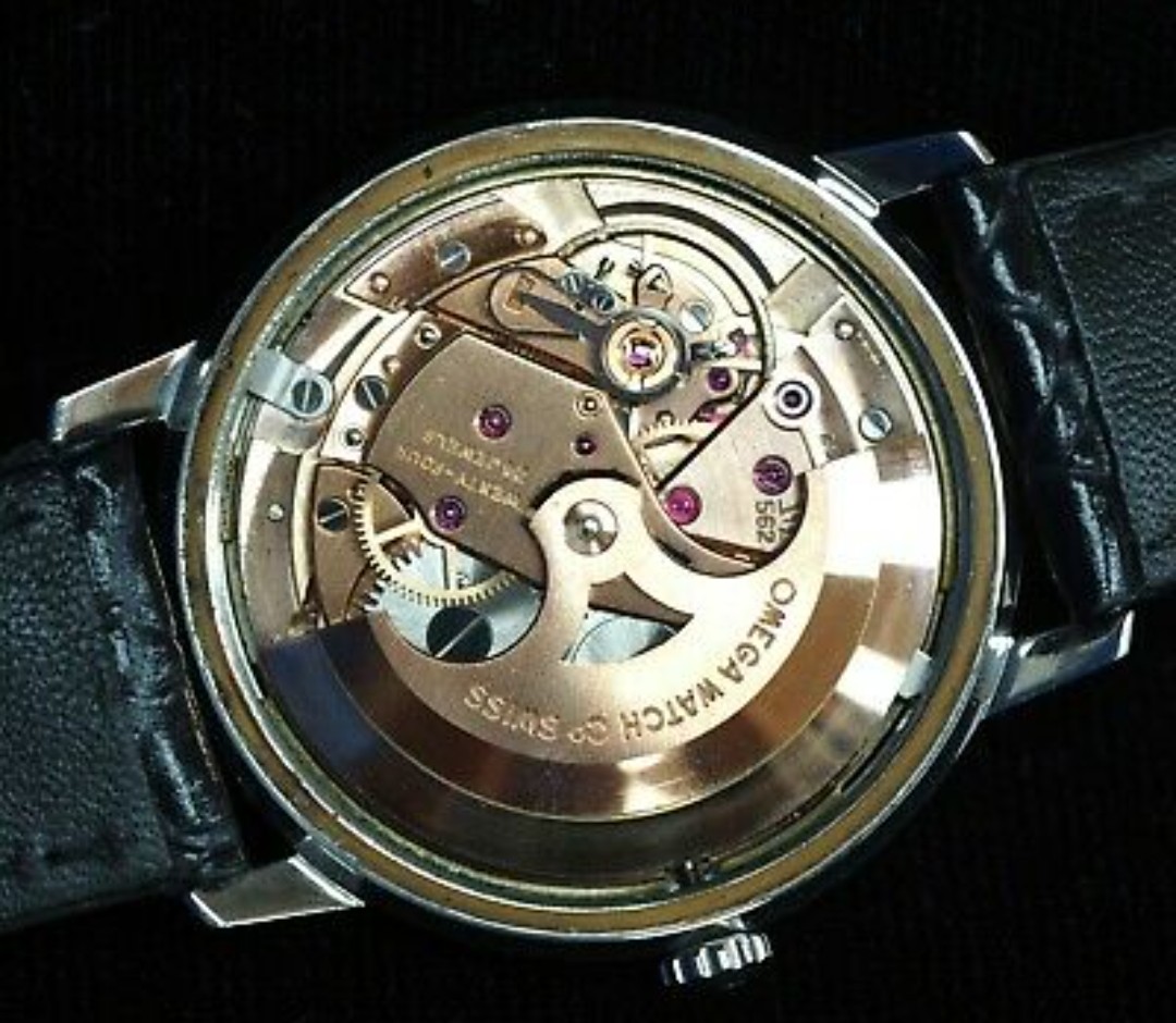

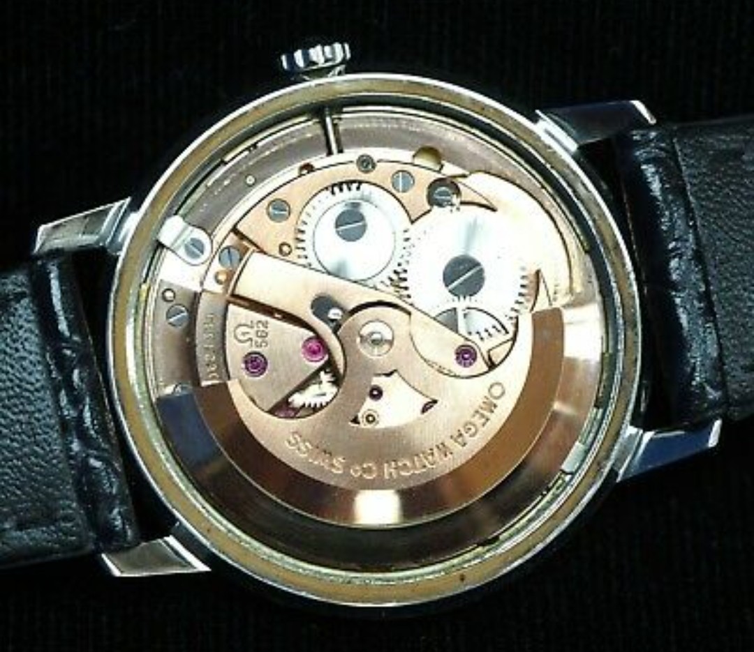

The face, case and hands seem to be appropriate and in nice condition but the photos aren’t particularly good, and I can’t see if they’ve been edited or not. On the basis that the watch is okay, I’d tick that box if I were buying.
I'd generally take a chance on an Omega 5** movement on the basis that I understand that these are usually straightforward to fix/service if there’s a problem. I can’t see any problems so, another tick.
If the watch is advertised as working well, and/or serviced (particularly if there’s a service receipt from a reputable watchmaker) and if returns/refunds are accepted I’d probably go for it.
The price is high, but not outrageous and so, I’d say that box is ticked too.

Movement is clean, but crystal scratched and case is fair/good.
Dial looks refinished
Pass for me.

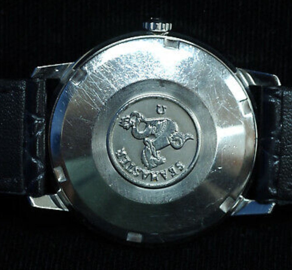

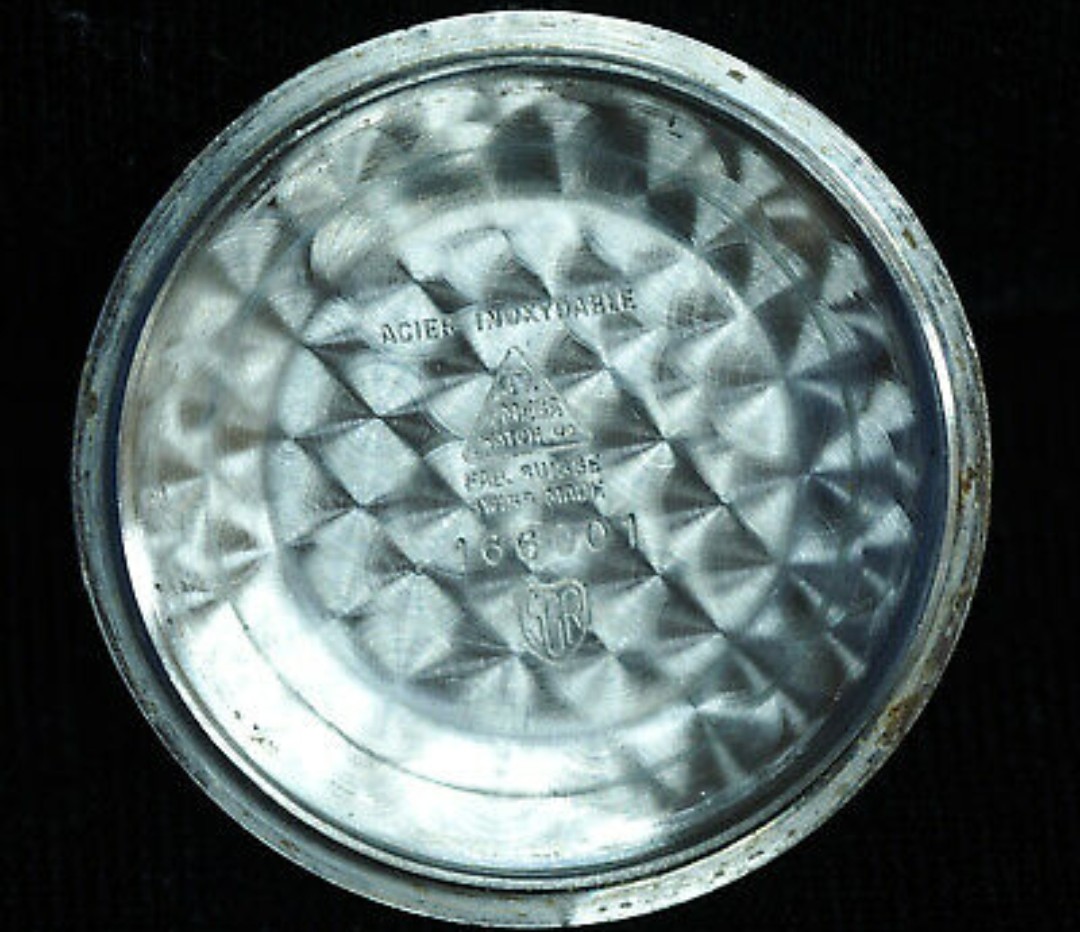

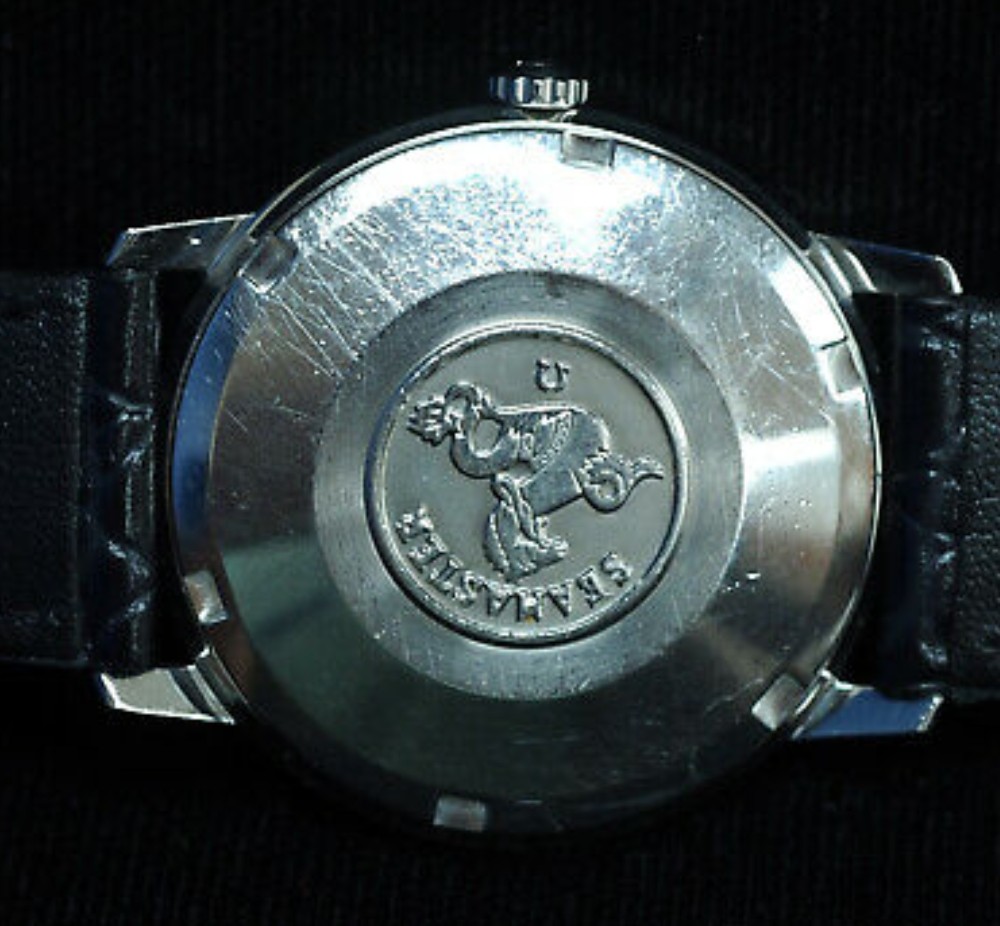

Looks real good!
Don't see a gasket though, the edges of the case back see a few rough spots from corrosion, seen rougher spots.
Slight rotor marks on case back inside, due likeley to lack of a gasket, this would drag the rotor motion & may not allow a full wind. Have it serviced in particular if you are going to use it.
A closer look, gasket appears present but dried out.
Enjoy your find, overall 😀
