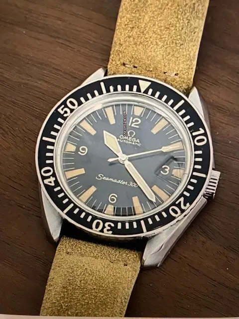

Hi There,

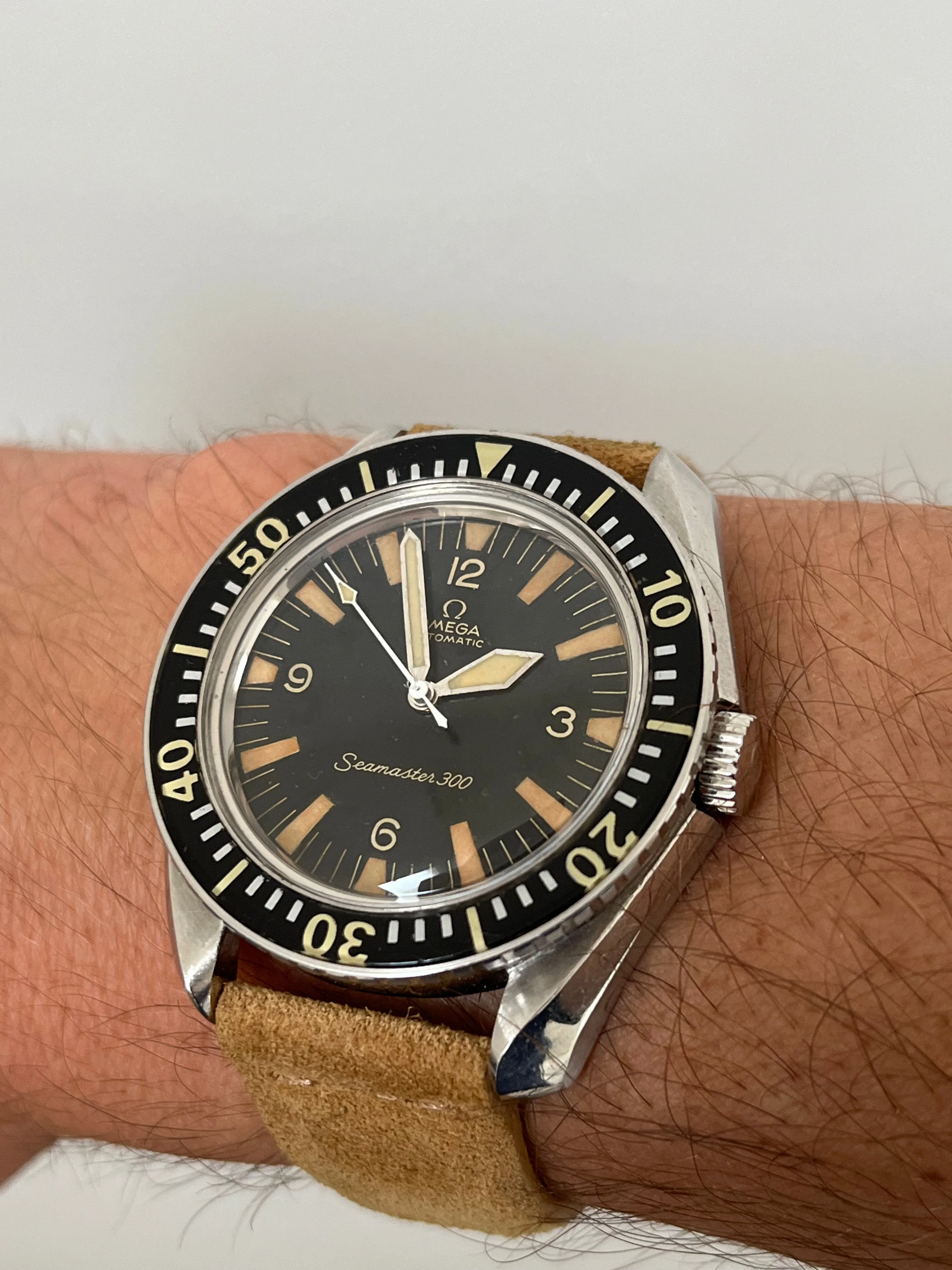

Bit of help needed before proceeding with this project. Does this Seamaster 300 (165.024) look all original?
My question: Do the Bezel, Dial, Hands, etc look all time correct and original? I understand that seen the crown type, its one of the bit earlier models.
Thanks a million!!

Hello and welcome to the forum. As you probably know, there are several reference sources for these references on the internet that you can use for comparisons.
I'm curious about what "project" you're referring to. Is this a potential purchase? An inherited heirloom?

Hi there, Its a potential purchase....

Thanks for your kind welcome! Should have indeed made it more clear in my post that its for a potential purchase. All the info online makes me a bit dizzy. Hoping for some opinions here about the chance of it maybe being original (or not)....

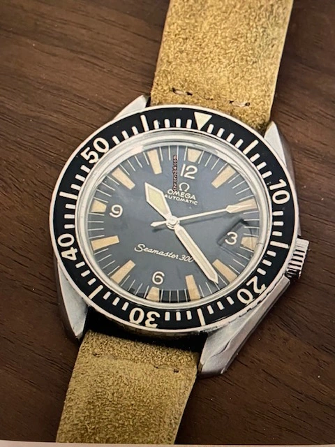

Case seems a little wonky, but I’m not sure. The insert in the bezel seems to be aftermarket.
Dial is clearly aged but seems artificially so.

Maybe just the photography angles but bezel edge looks a little wonky as well.
That was my thought, also. I didn’t think that there was a legit bezel that has both the serif “1” and the “4” with a pointed top. But I wasn’t sure about that.

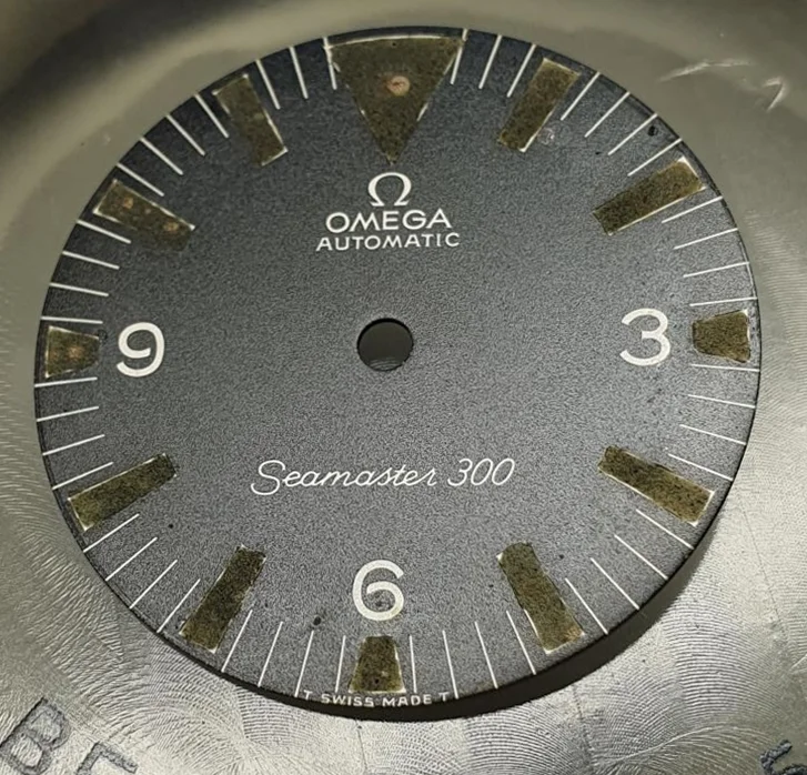

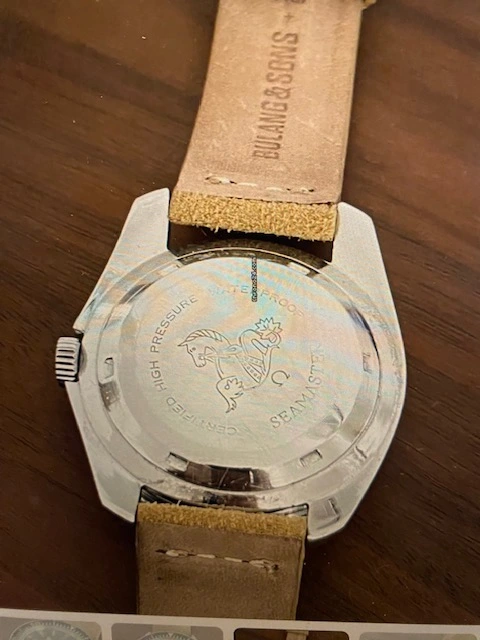

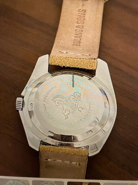

You need better pictures: for the serifs , the T SWISS T at 6 and the case, as said before. + inside caseback and movement. If not: do not buy!
Or tell us the asking-price.

Thanks for all the feedback, this watch will be a certain NO GO for me!

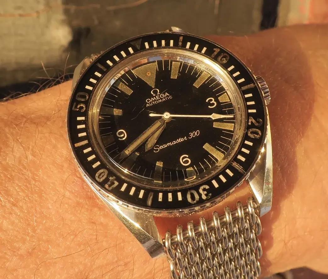

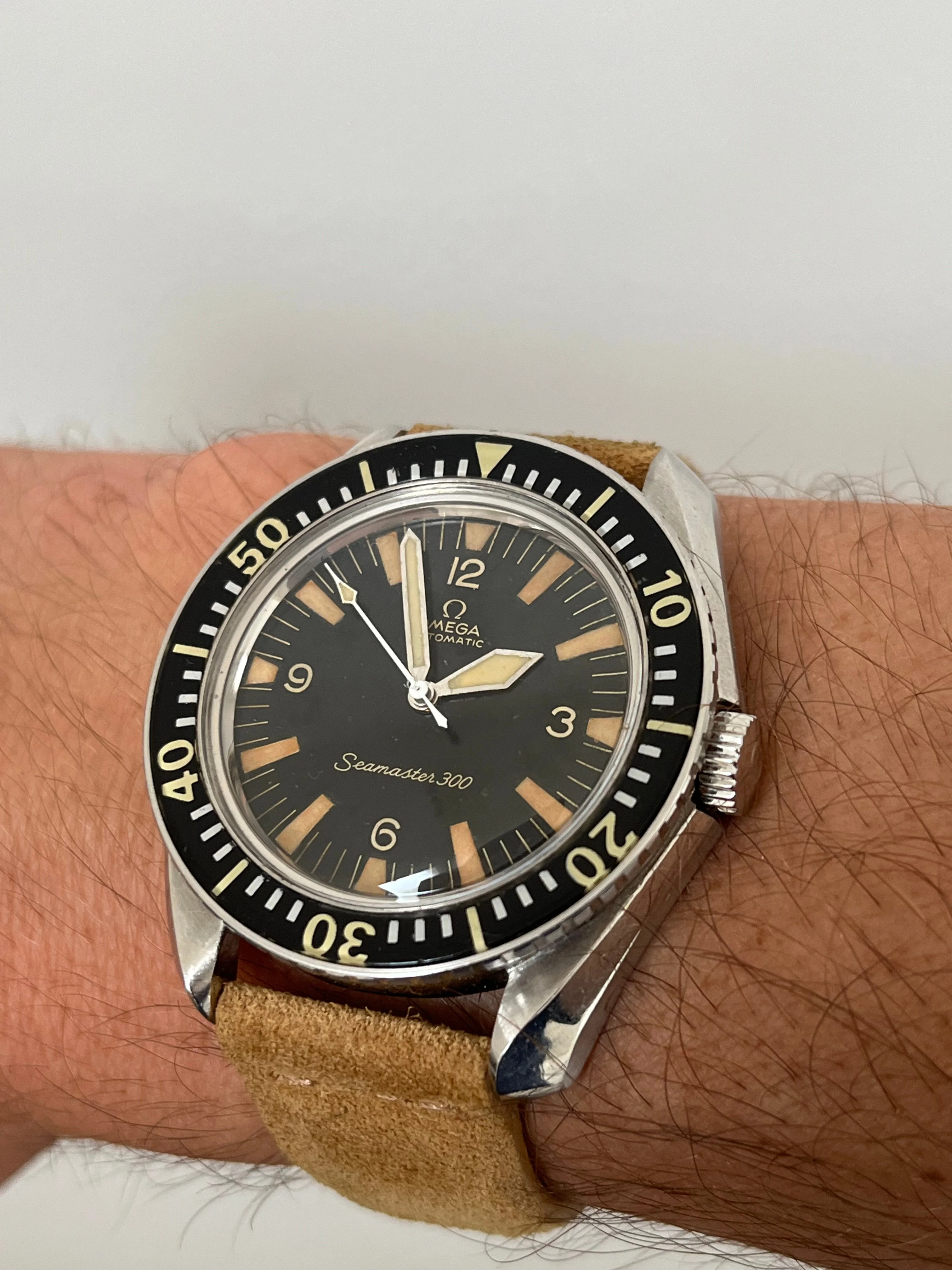

looks complete original (the yellow lume must be confirmed by other members) alwas check the dial: mine (1968) is greenish:

ask for a picture with a small piece of white paper beside- you or I can do the whit-balance after....to judgde the colours.
