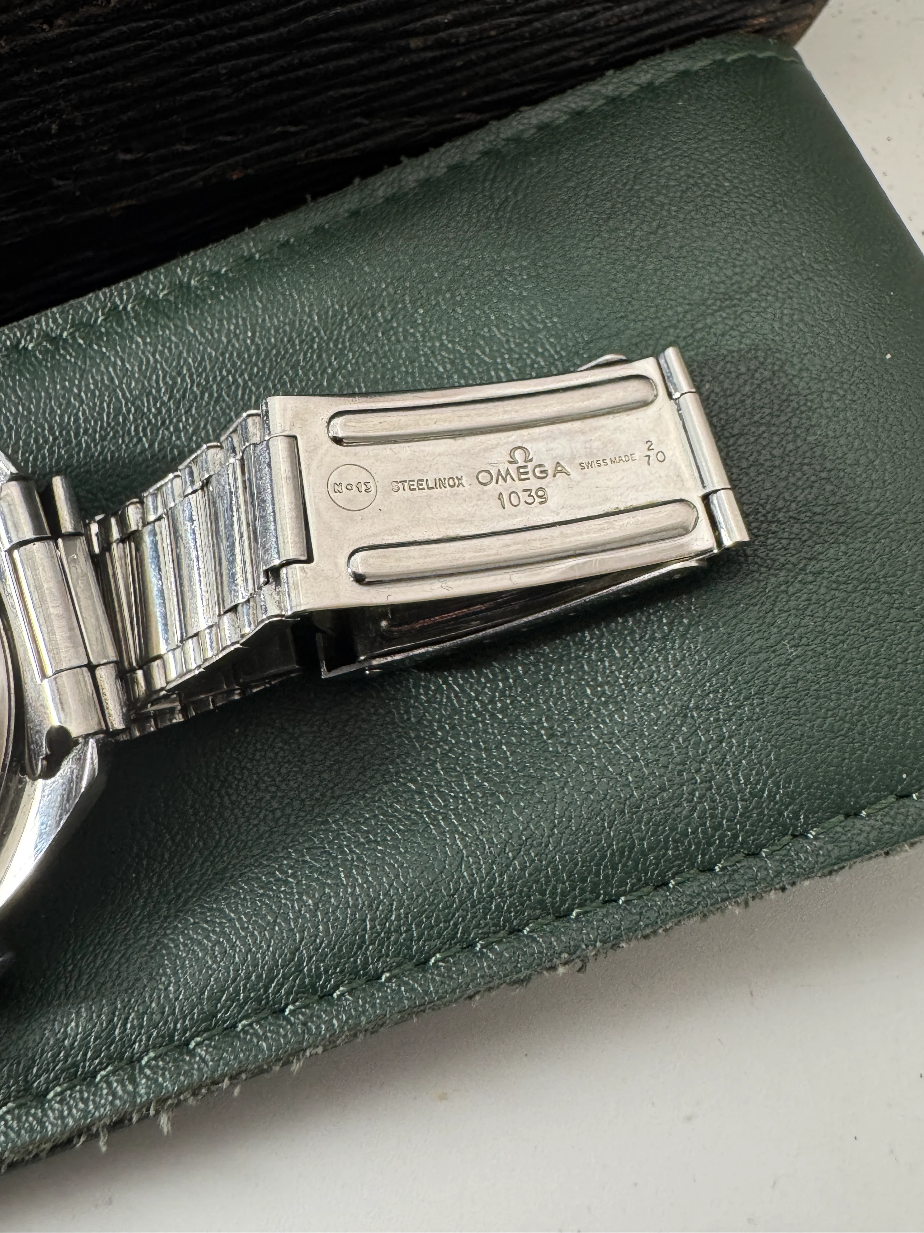

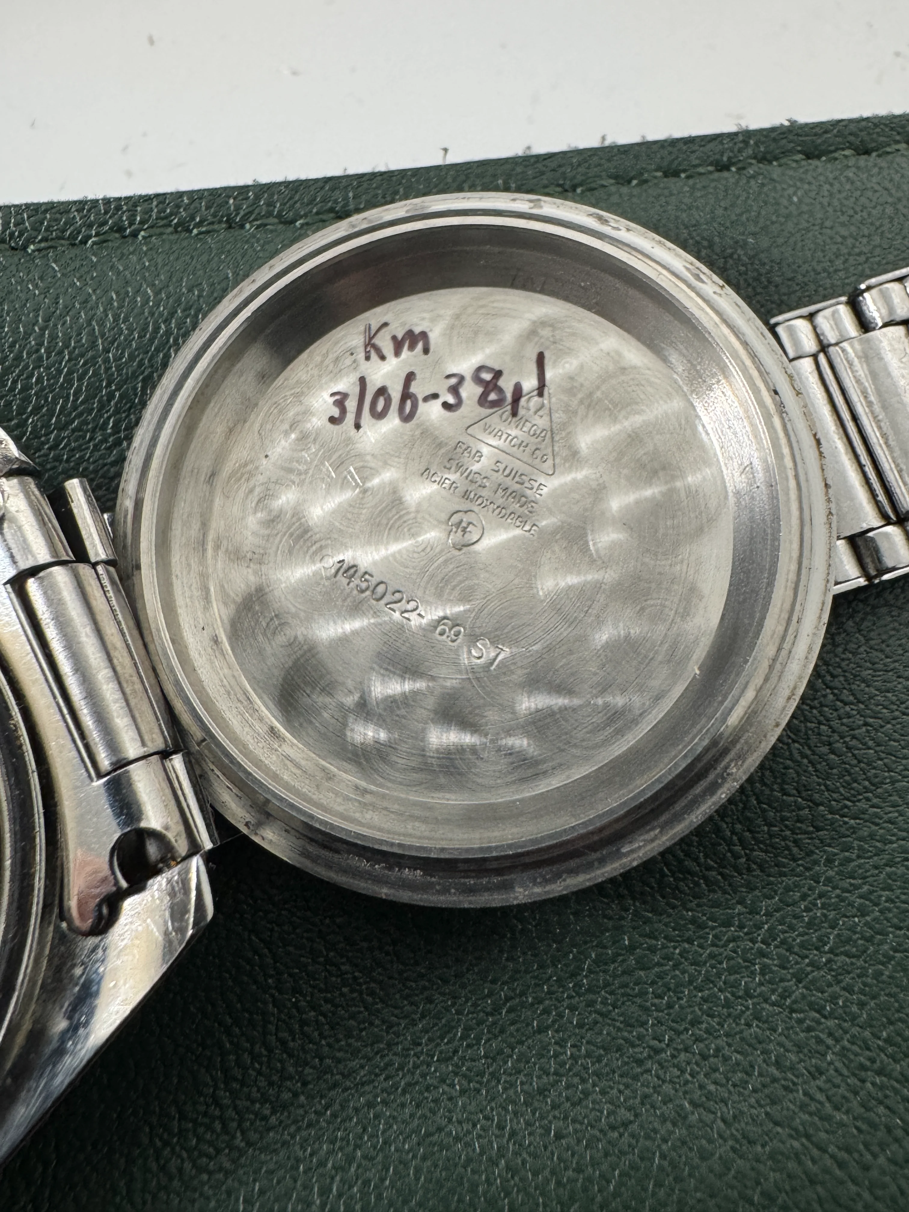

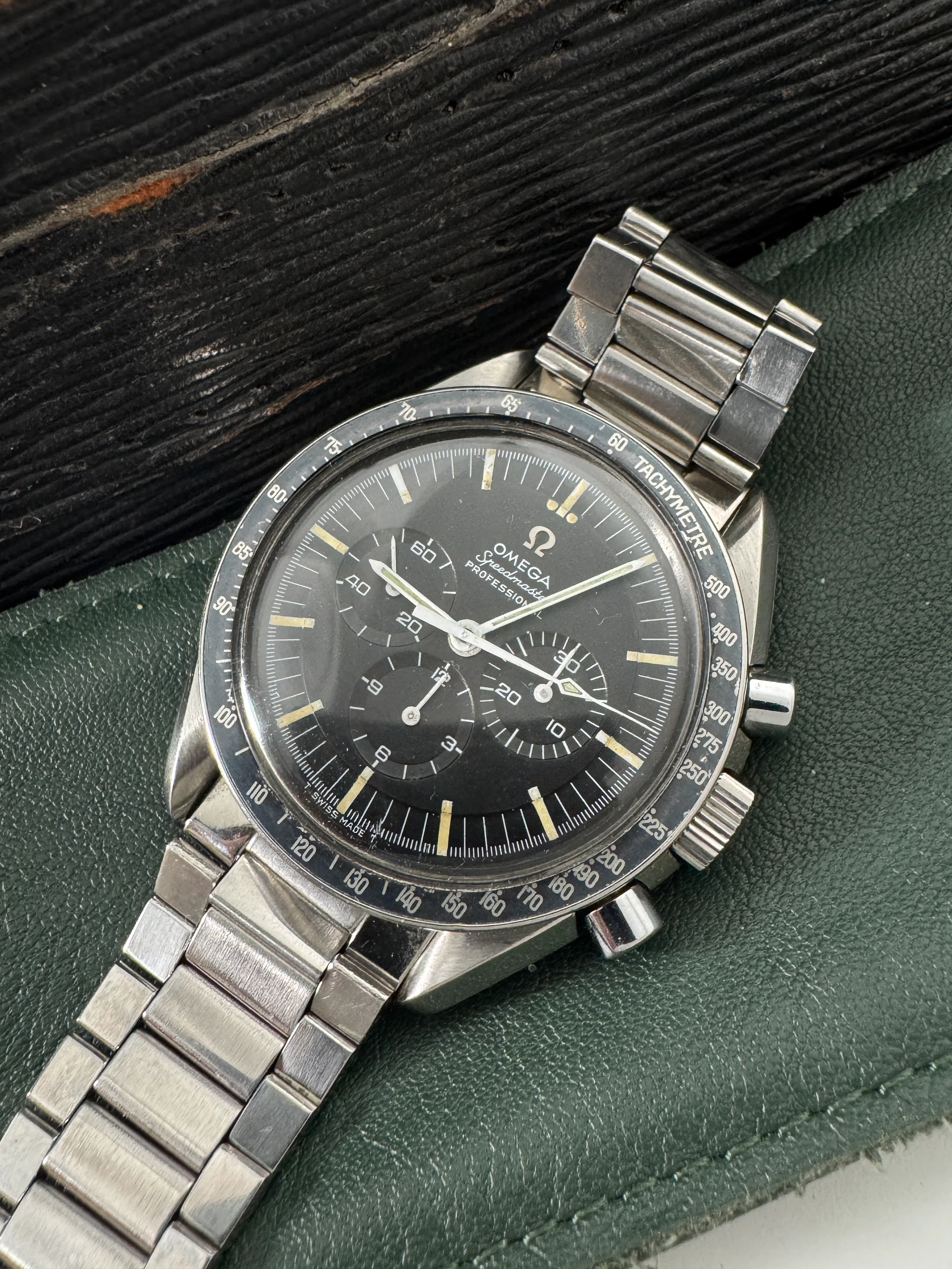

Just got an updated batch of photos from the seller (attached). To further deepen the mystery/raise my level of questioning the 1039 bracelet has a 2/70 date. I've run the serial number on ilovemyspeedmaster and it shows likely production of 7/69 (which given the 277 prefix would seem to make sense). I can almost talk myself into it's a late Transition model using an applied dial and a mid 1969 non DON bezel, but when I see a bracelet with a date six months after the estimated production date I start to conclude it's probably a Transition movement/dial with replacement parts. I still think it's a good looking piece but am not sure if it's worth going after. If I'm correct about the replacement parts (which I suspect can't be proven one way or the other) how much of an impact does it likely have on the value (estimated at $7800 for a Transition in very good condition at ilovemyspeedmaster)?

It’s extremely likely that it’s a -68 transitional with a replaced caseback and bezel. The bracelet is often dated 6-18 months after the production of the watch so that doesn’t concern me too much.
I’d want a decent discount for the wrong bezel and caseback though as the ones you have are not a straight swap for the ones you need.

What (if anything) would you make of the estimated production date of 7/69 from ilovemyspeedmaster? I've read conflicting articles relating to the possibility of a Transition model having a -69 caseback. Safe to assume you fall on the side of it's got to be a -68 caseback if it's a Transitional?
13,555
23,503
I don’t think there’s any credible evidence to suggest any -69’s originally came with applied logo (transitional) dials.

Talk yourself into what you like mate, but bring that on here and we are going to call it a Franken so it’s up to you really. There are features there that can not have left the factory that way, no matter how creative you get.
ps the bracelet is utterly irrelevant since they were usually added either at point of sale or later. They mean nothing with respect to dating the head.

Remember as this is not an original watch, any values you find will not be relevant.
With a watch like this, I would want to delve quite deep. For example I would go as far as checking the dial is a cal 861.
Discrepancies like this watch shows often mask a much greater deviation from original than one initially sees.

I’d walk away from this watch, too many discrepancies to justify the time and effort and absurd price. Additionally, there appears to be missing tritium on some of the markers and looks like it will need service to fix the chrono creep as evident on the sub register.
If you’re really interested in purchasing an honest 68 or 69, I suggest periodically checking the FS section on OF. They come up on a regular basis from fellow collectors that are not in the business of turning a profit. There is always risk buying from dealers who dress up watches for a quick buck.

I think the OP is very confused and does not realize that transitional -69 references are not known. They do not exist to anyone’s knowledge. He is focusing on things that do not matter, like the production date and bracelet, and ignoring the obvious facts that the movement, dial, caseback, and bezel do not match. It’s just a blatantly obvious put together watch, plain and simple.
Just walk away and spend more time studying. A year or two from now you will laugh at this thread.
