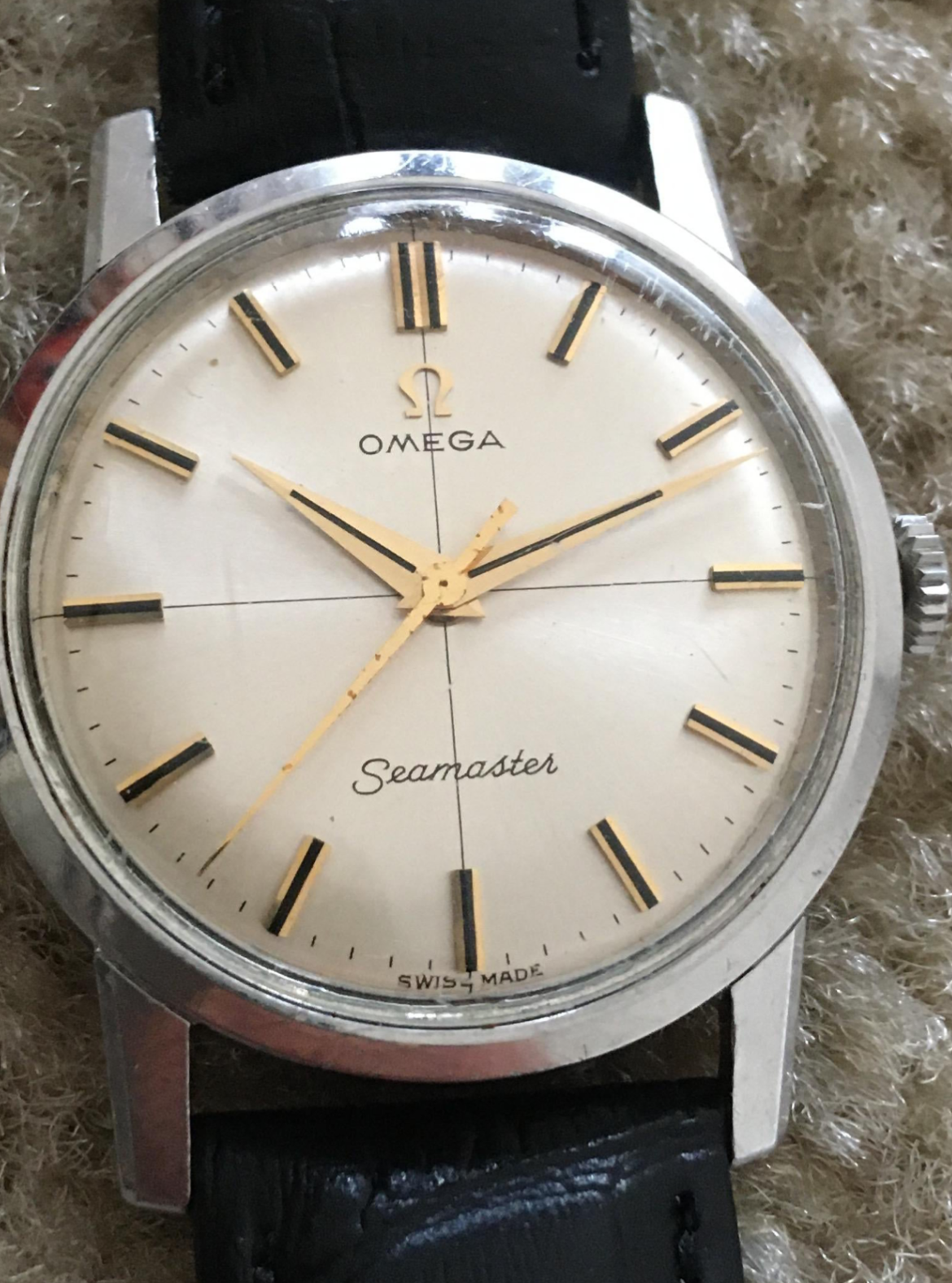

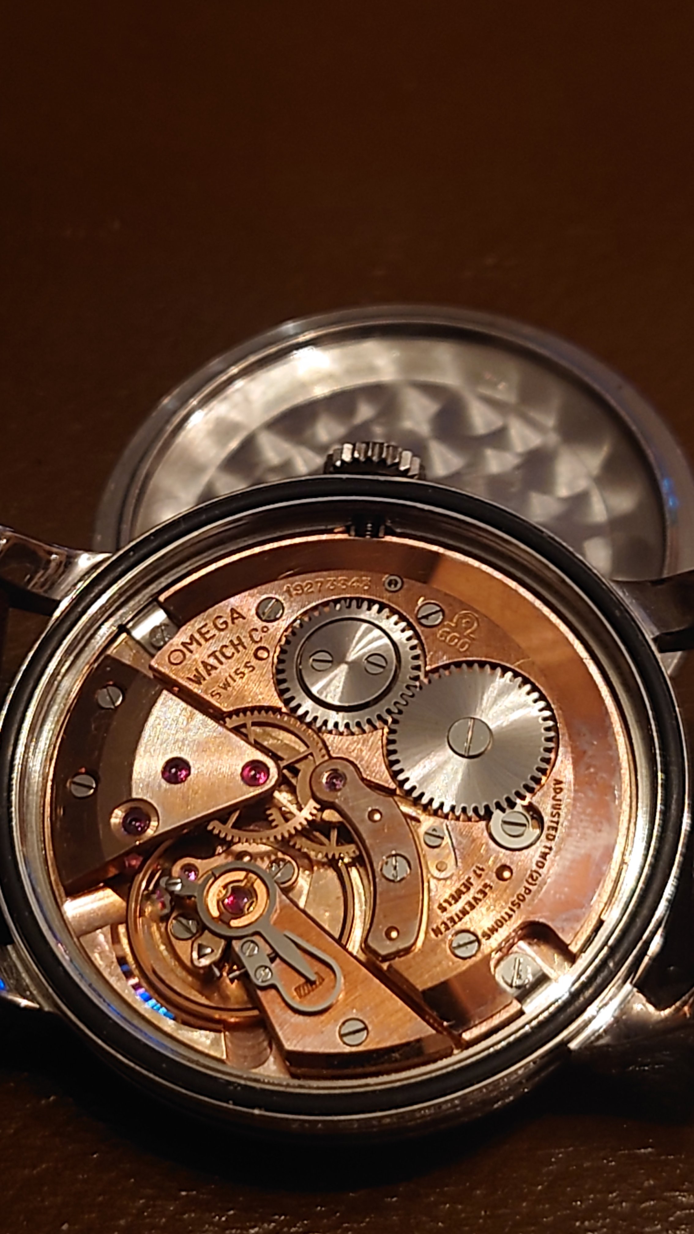

Omega seamaster original or redial
532
270
Come across this manual wind seamaster
600cal
Just curious if you think it's had a redial.i have my suspicions one thing did stand out to me just curious what you lot think. Thanks
13,674
19,043
I vote redial. The word "Omega" is not straight, among other flaws.

I vote for redial as well. The "OMEGA" looks off to me. The "O" is too stretched horizontally to begin with.
This could be a Geneve redialed as a Seamaster, but that's just a speculation without seeing the case back.

135.005 shows up as a Seamaster with a caliber 600 movement, so you can ignore my speculation related to this being a Geneve.
Haha it's ok. Thanks

Better pictures does look a fare bit better in person
Them scratches on the indicators you can't actually see in person.

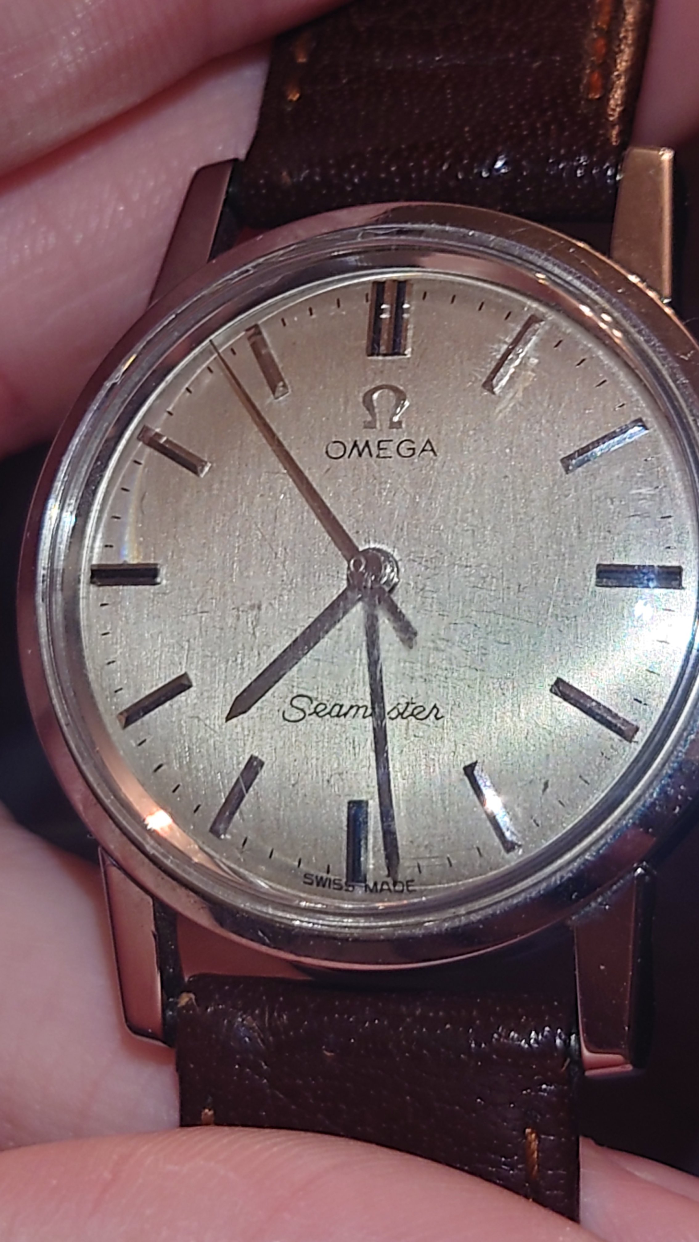

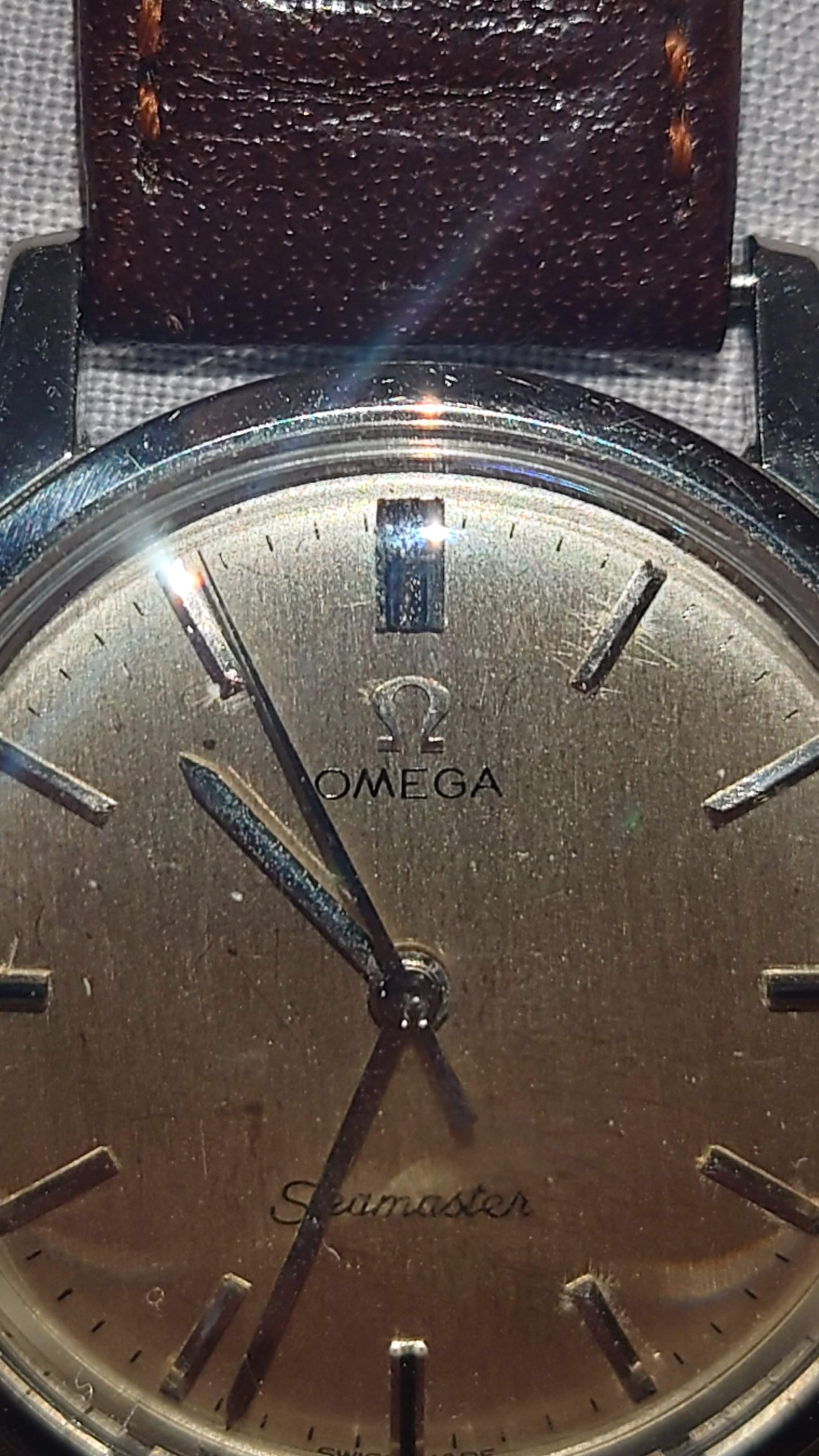

You tell me what you think.
OP's watch is missing the serifs in the "OMEGA". I think that's what caught my eye initially.

I'm seeing a re-dial due to basic format of Omega, minute tick spacings etc.
It is however, a fairly decent re-dial.
For a focussed collector this would be annoying, for anyone else it's a nice watch.
