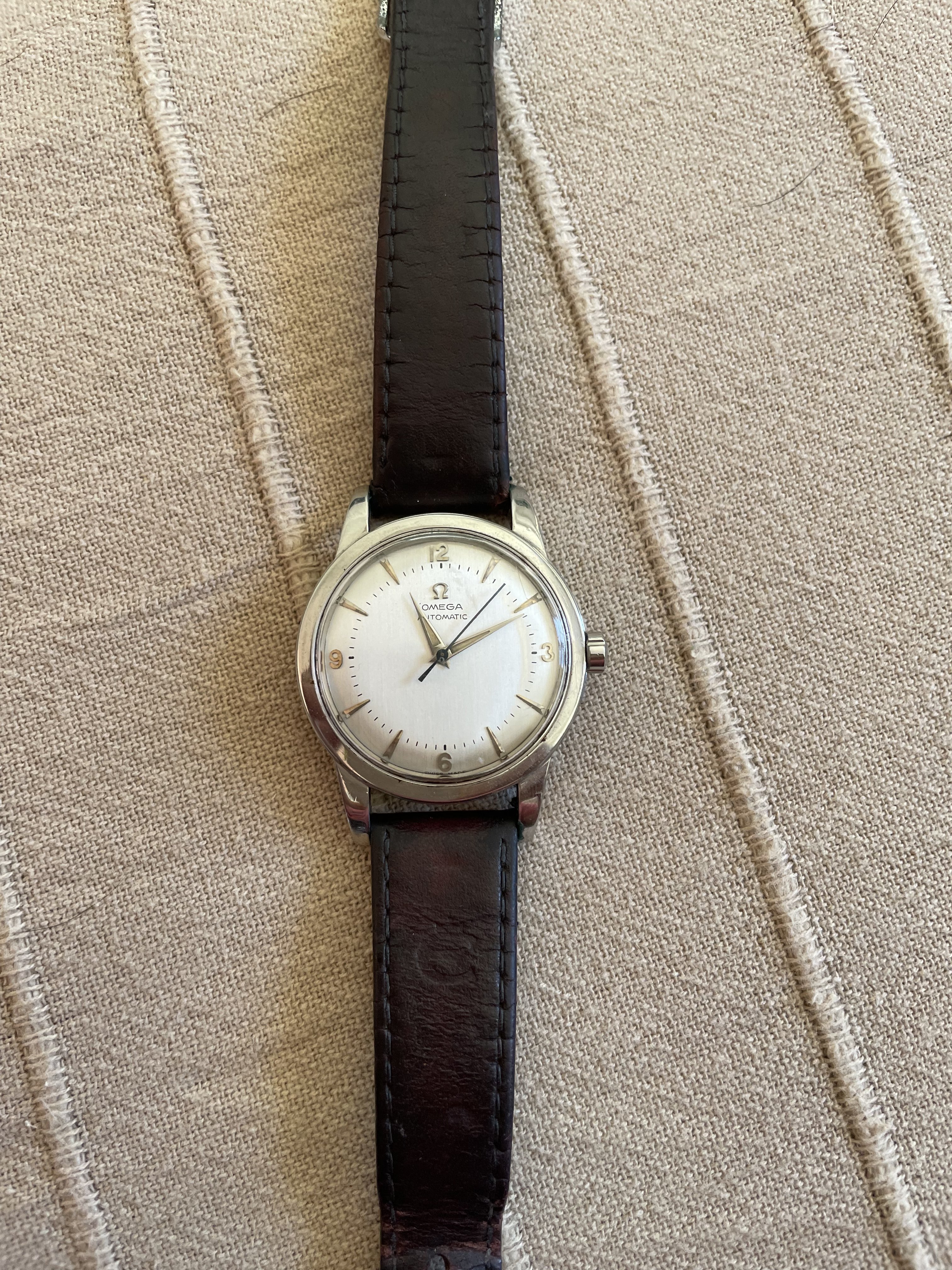

I have an Omega Seamaster that was from my grand father. Can someone give me more information? It has the incorrect dial.
regards
4
The original dial had seamaster printed over the 6. Is possible they painted the original dial. Is the dial colour similar us the original?
24,836
55,256
The dial is definitely repainted, but it's not possible to know what it originally looked like, or where (or even if) Seamaster was printed on the dial.
4

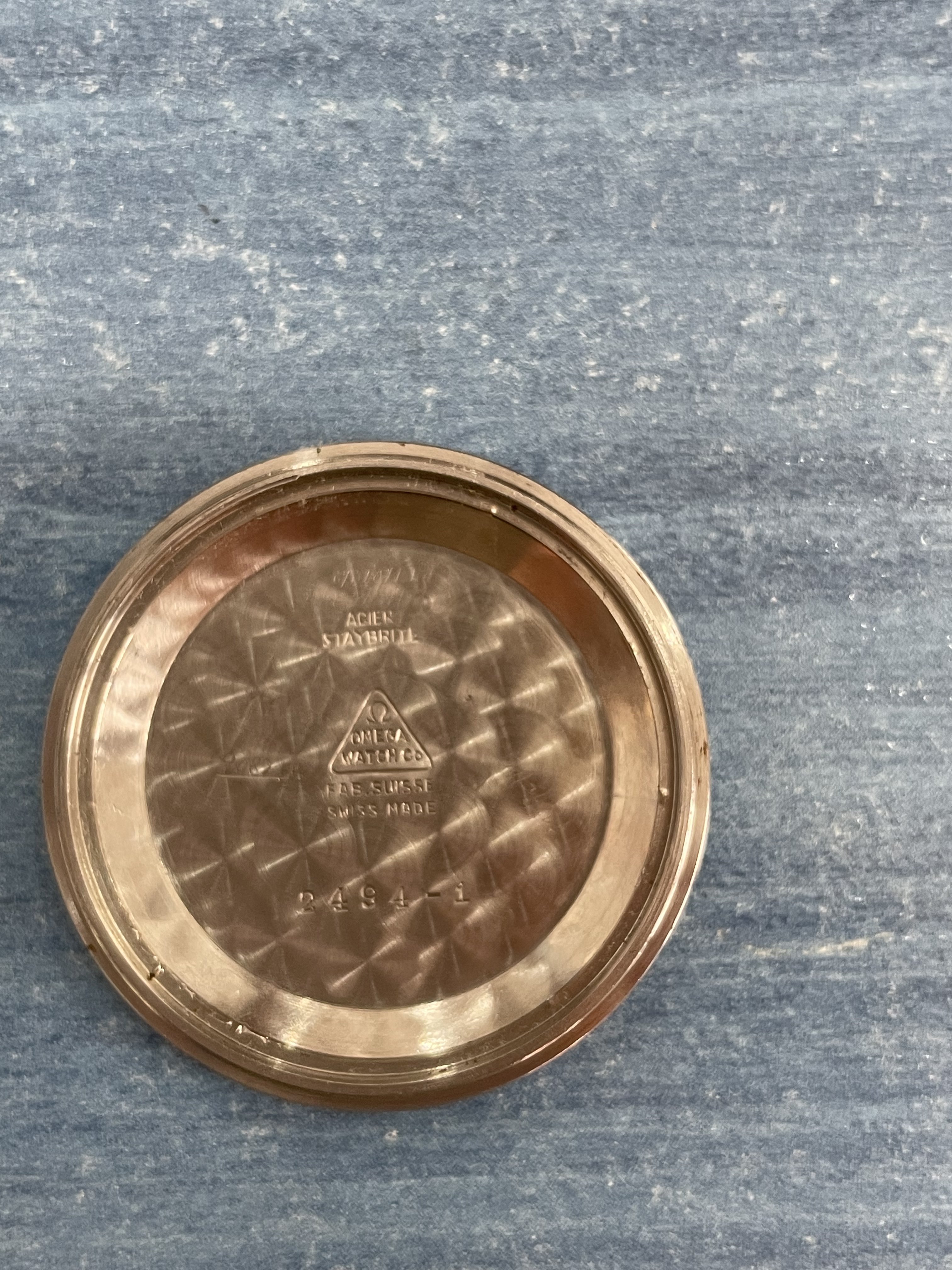

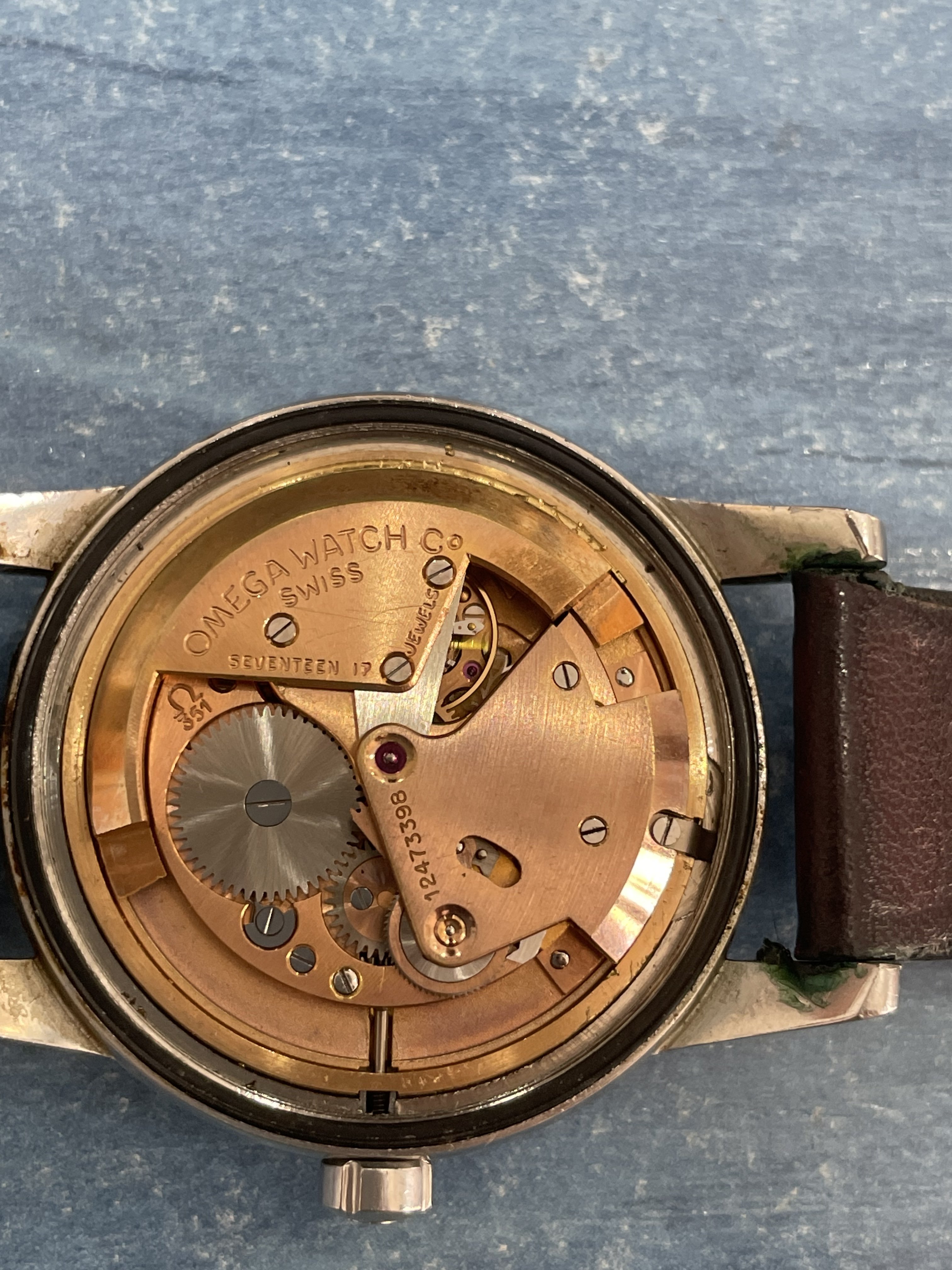

Thank you Dan for your help. Is possible to know the build year?
regards
10,804
16,814
The serial number suggests circa 1951 +/- a year. At that age, the Seamaster text probably was present originally, it was lacking on. the first year or 2 of SM production ie 1948-49
4
