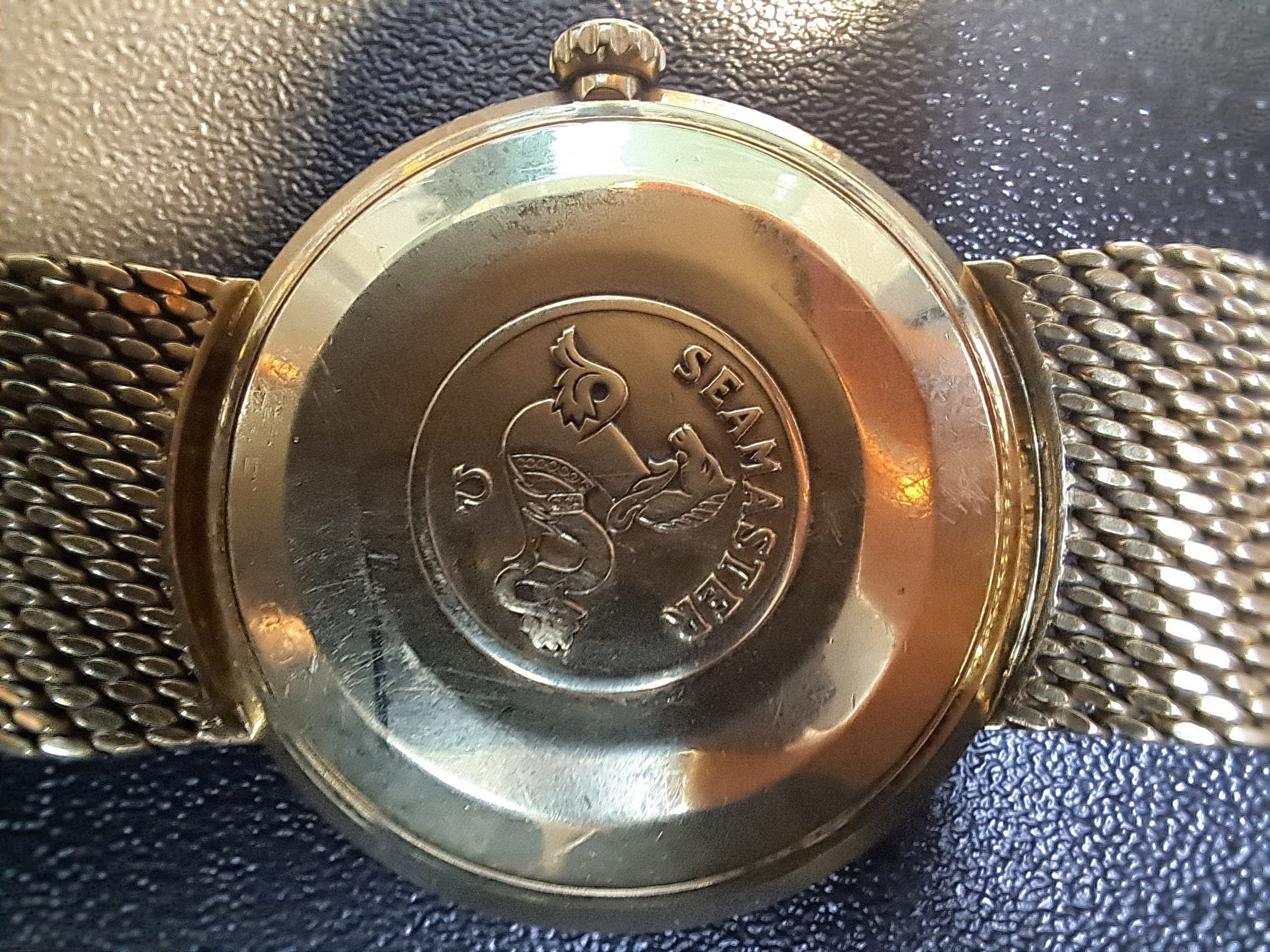

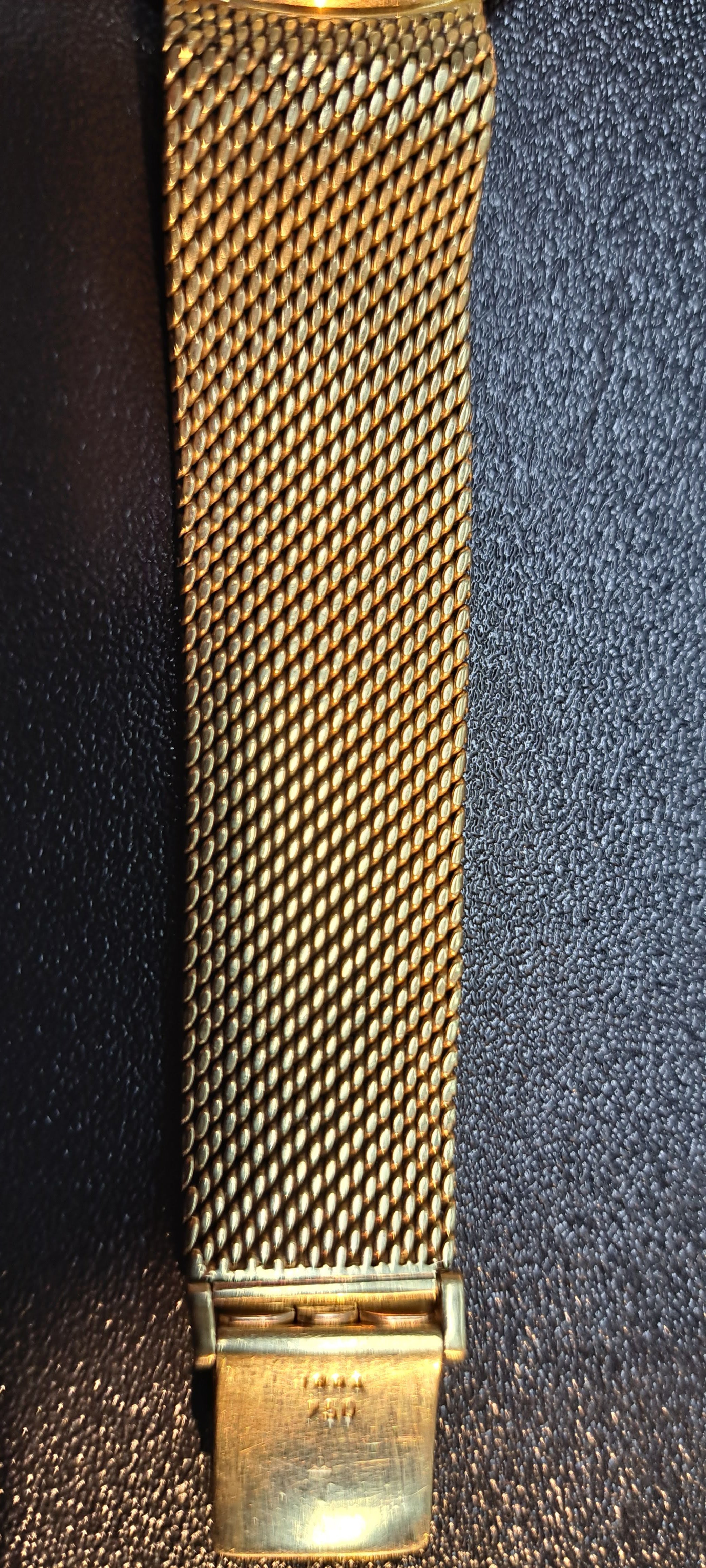

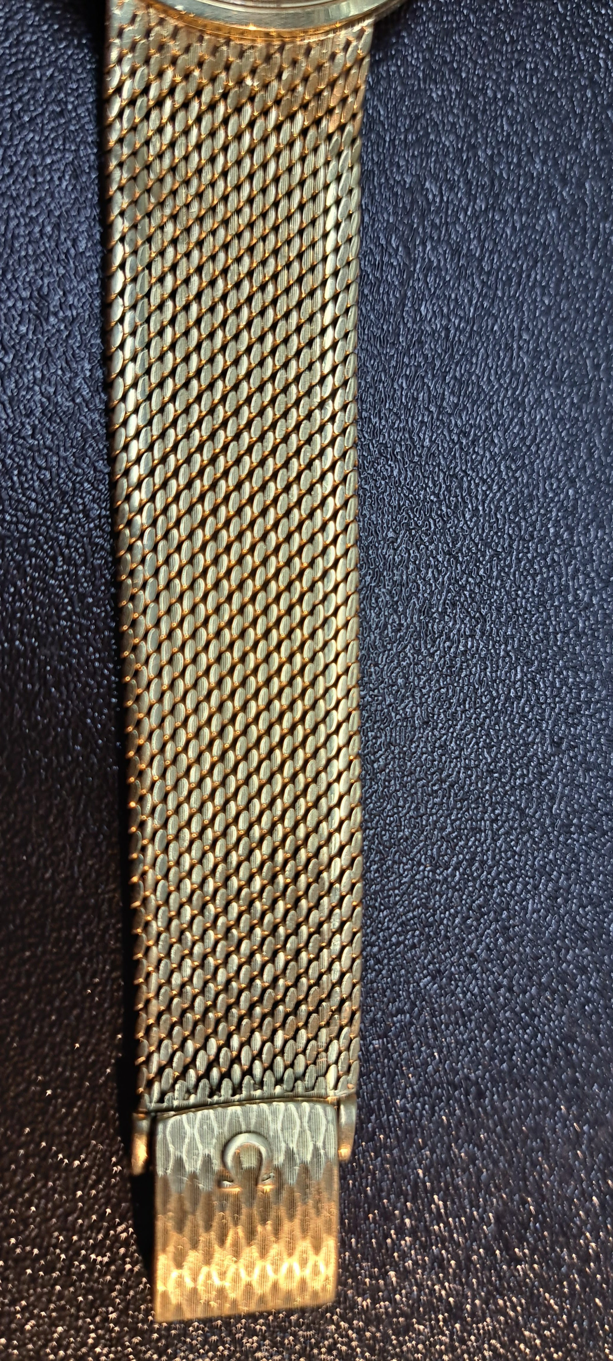

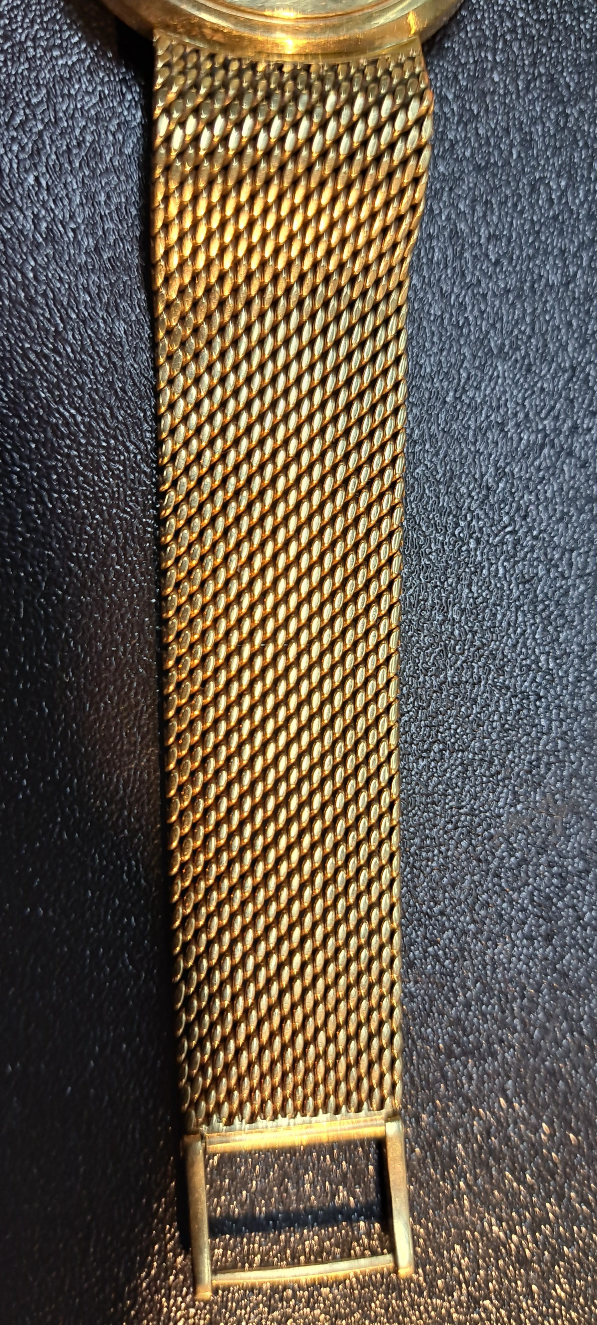

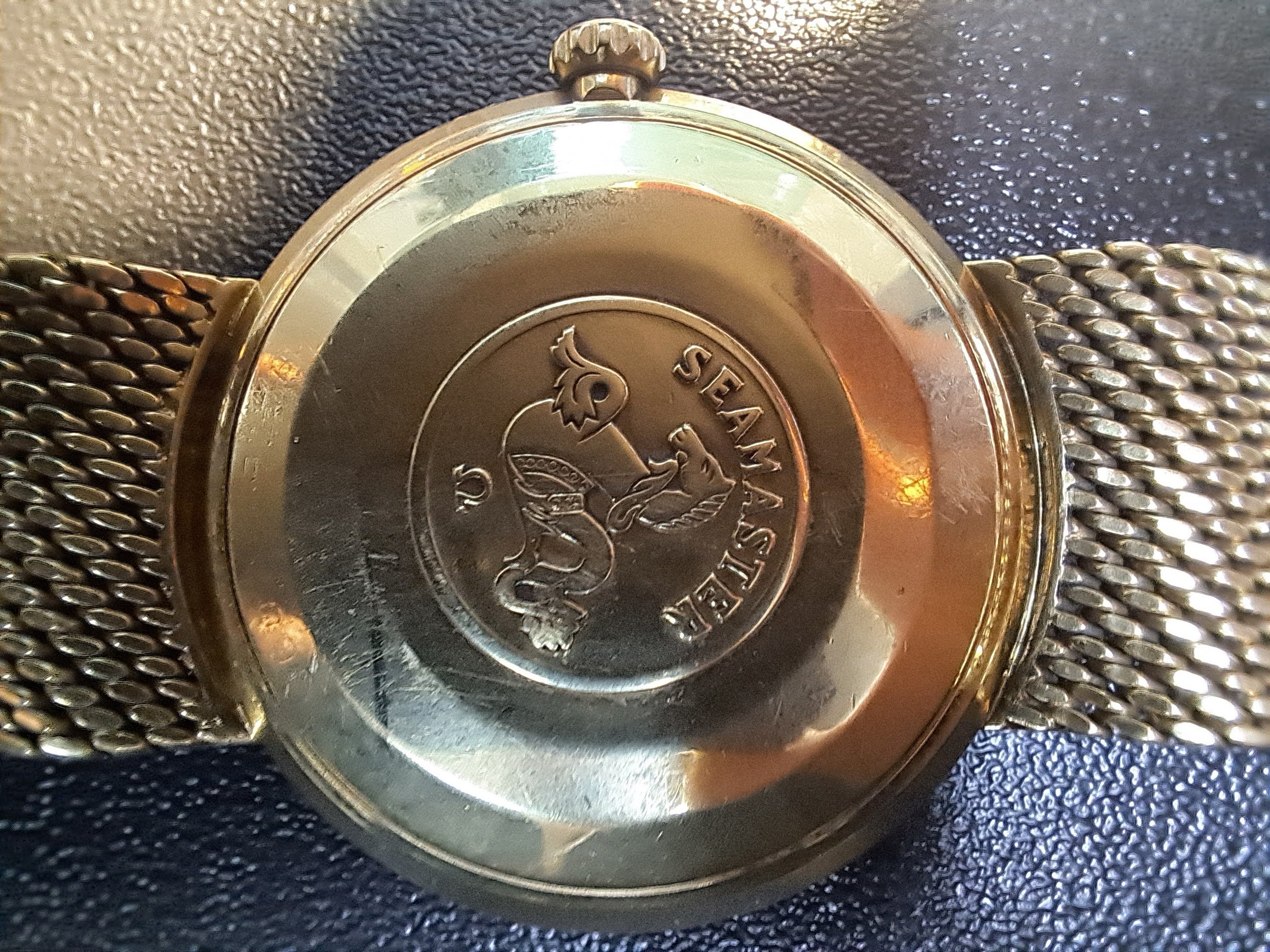

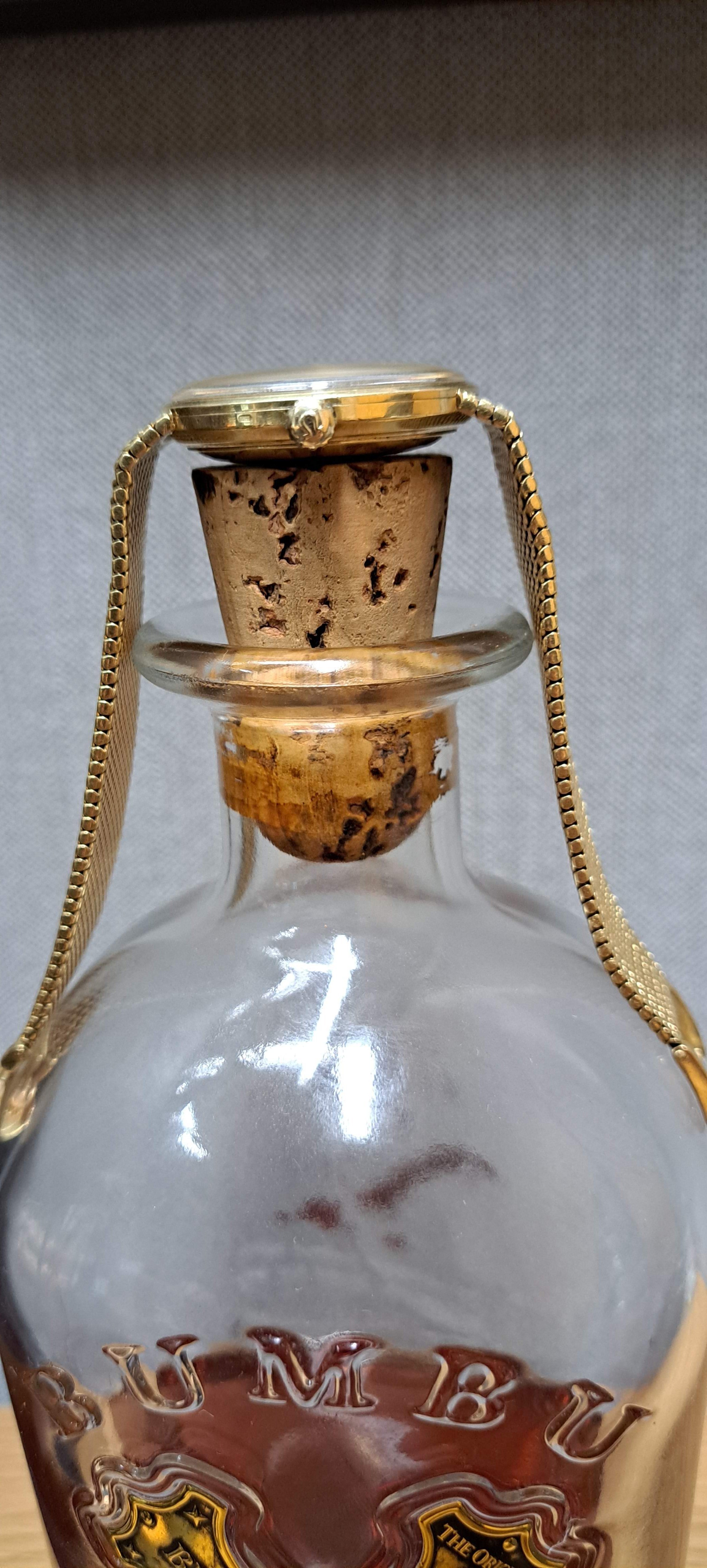

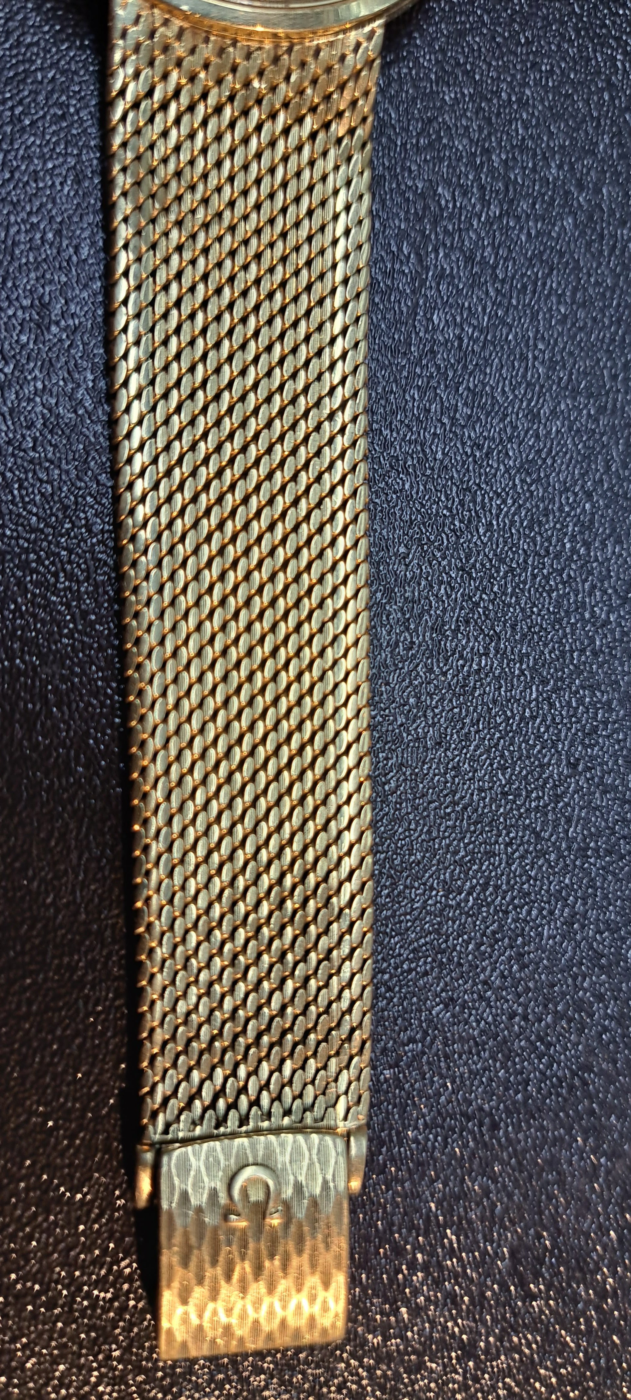

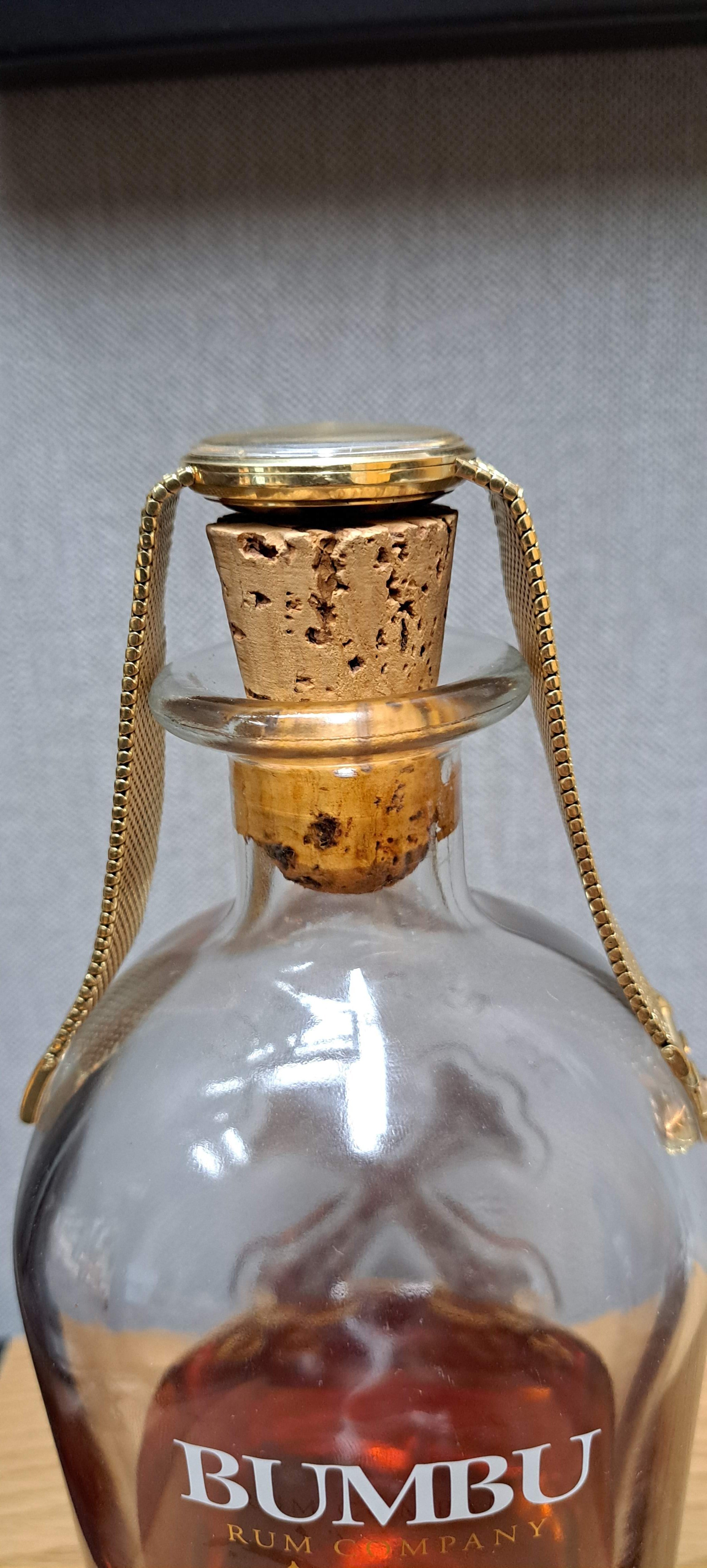

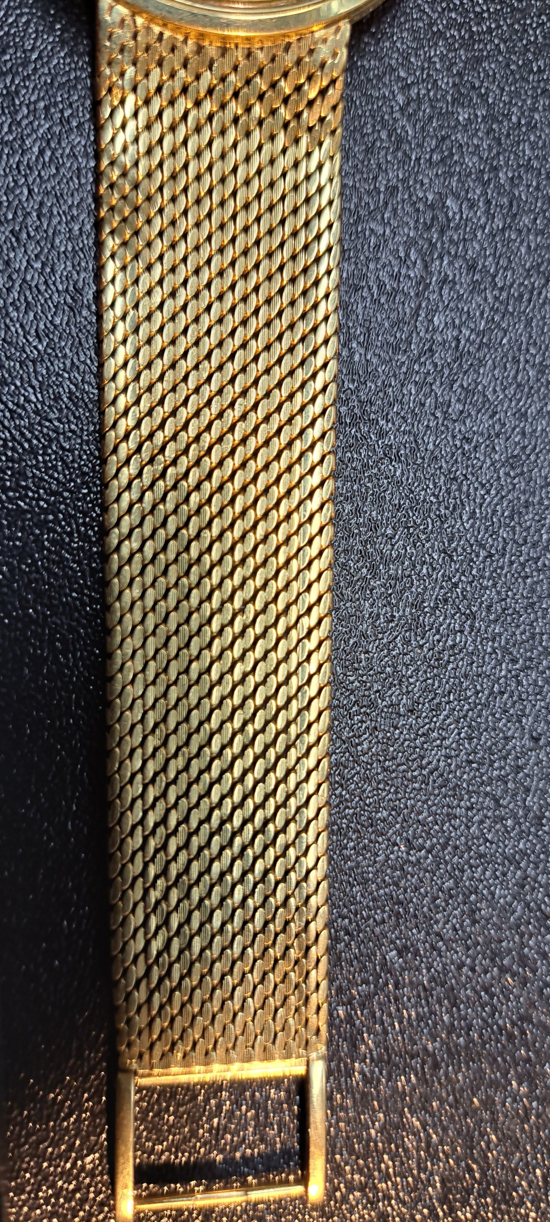

Here are additional photos of the bracelet. Here from both sides on a flat surface:

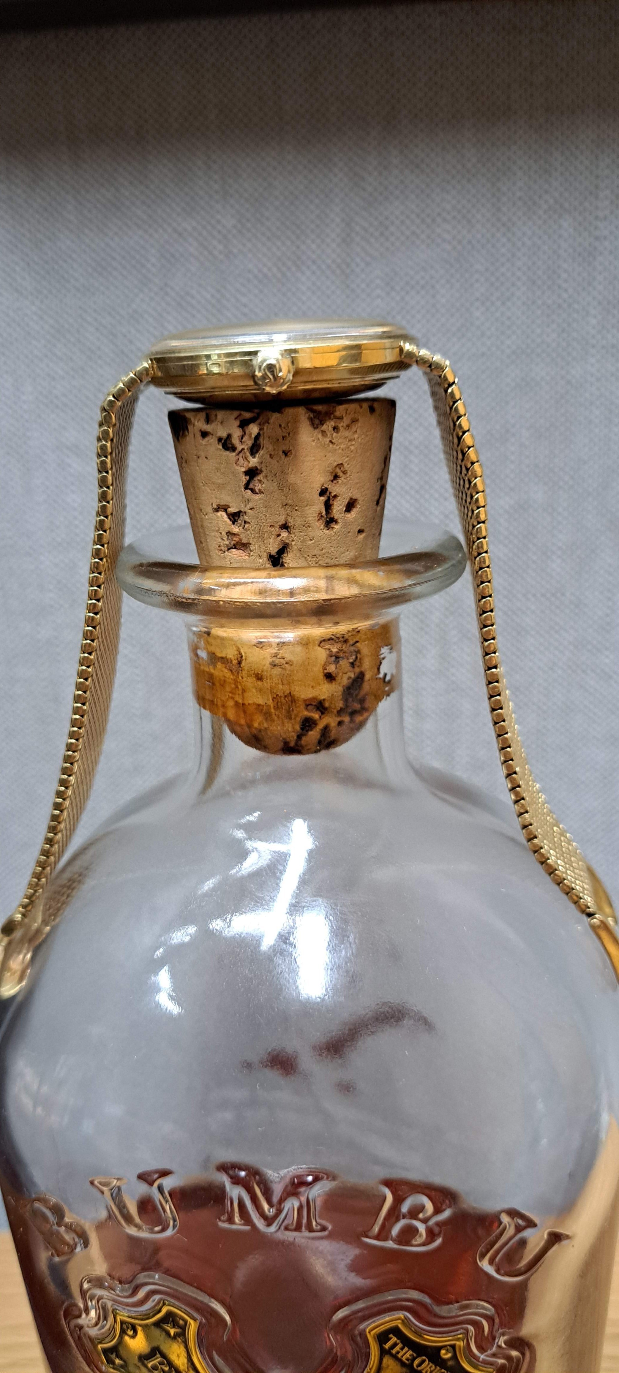

Here from the side in a hanging position:

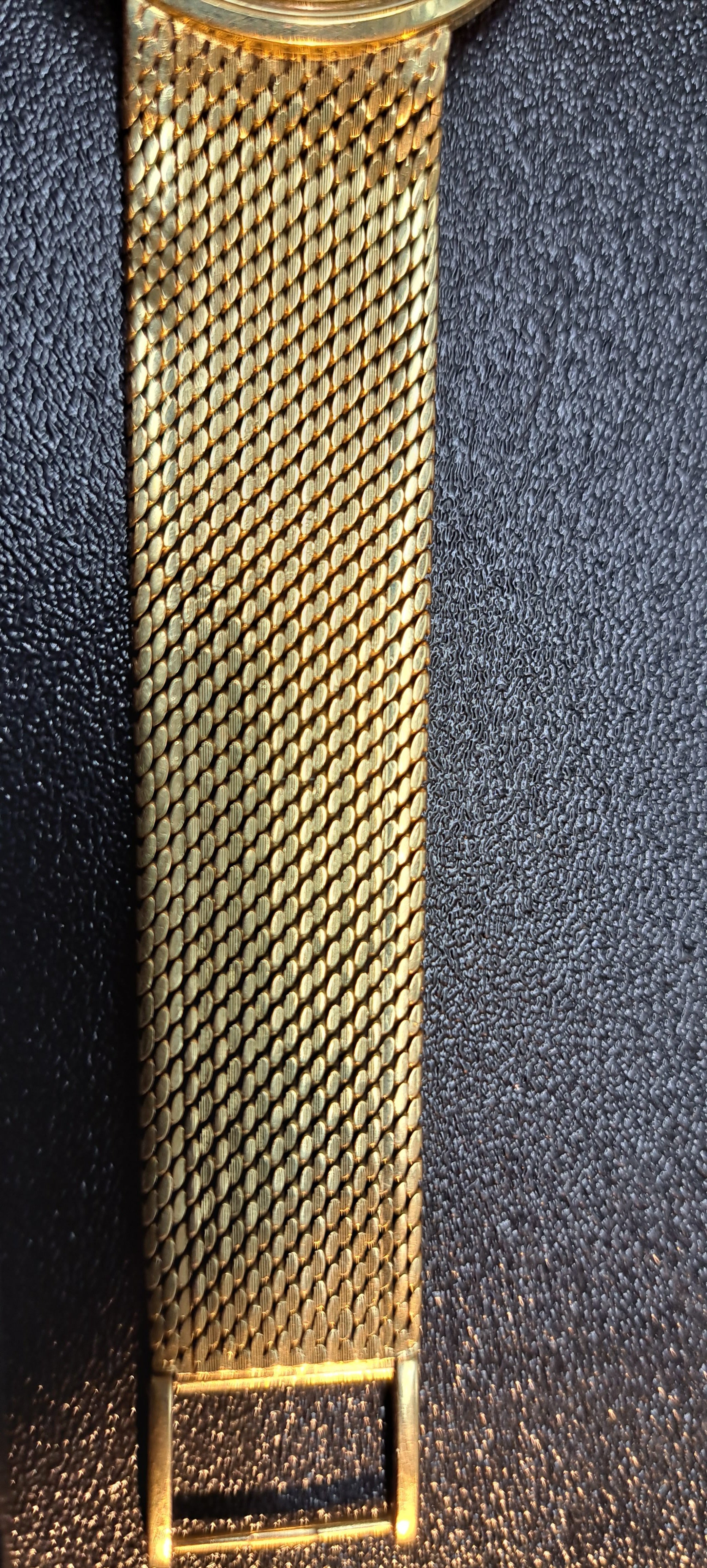

Here from the front in a hanging position:
And a closeup from near the case:
10,812
16,817
Your only option really is to cut it to fit*. A talented goldsmith could remove it altogether and weld on lugs but I think by that stage you are too deep into a financial black hole with no guarantee of success. Swiss Time Services do this kind of bracelet work, they can even remanufacture full bracelets but many talented jewellers can do so also. Normally the problem with vintage integrated bracelets is that they are too short, yours is the first where the problem is shortening it.
*if you don't want to do this, then realistically you need to either live with it as it is or sell it and buy one with lugs. That one looks nice so in your shoes I'd shorten it.

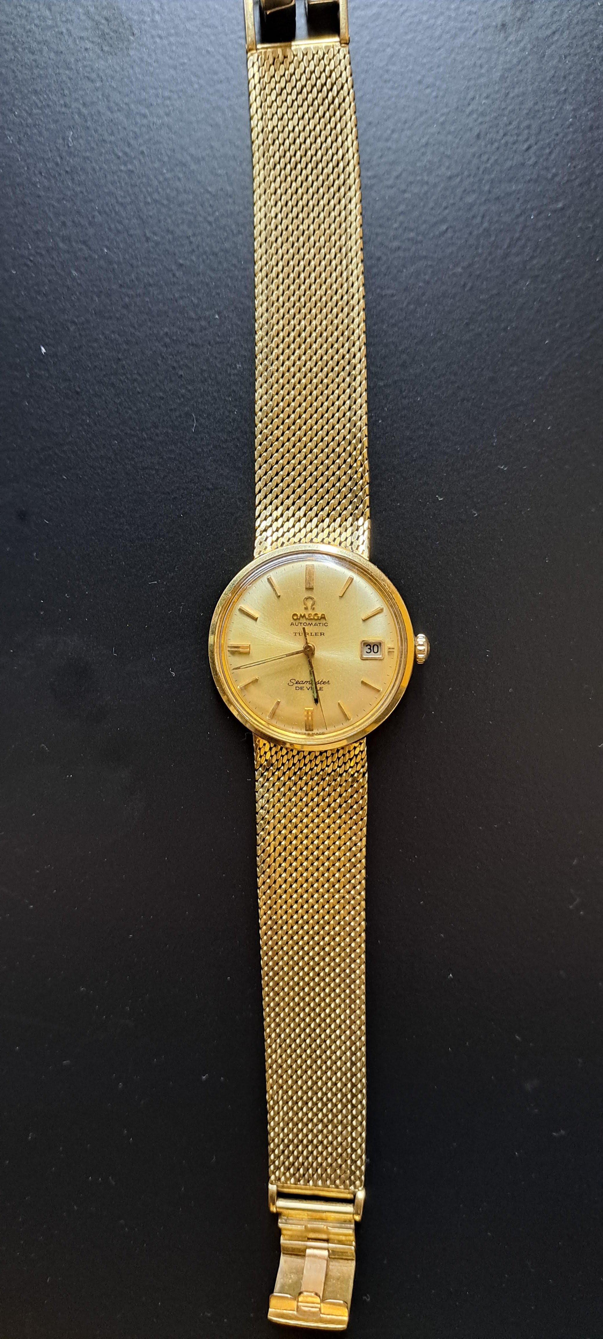

That's a beautiful Seamaster de Ville you have here, you did really well! I read that before bringing that watch to a watchmaker, you didn't even know that an automatic watch could be handwound. It seems that you have scored quite a stunning watch for someone who started with zero knowledge on the subject. You see, I wrote the thread about SMDVs especially for people like you, so more people are able to cross reference and check the originality of a watch. And of course, it makes it easier to get hold of original parts.
This could well be ref. 7161 but I might have missed a few special references like ones with an integrated bracelet and other fancy stuff. Plus, this would indicate that the gold dial on ref. 7161 was actually an option as this one is silver. Only opening the watch will tell for sure. What is certain however, is that this one is from between January 1962 and December 1963 because of the full 'Seamaster de Ville' text with a round 'S' and the absence of a tritium indication.
Funny that it came from a drug dealer, and not entirely surprising (although if I were a drug dealer I would prefer a ref. LL 6590-1 with a diamond dial but that's just me).
1 - Maybe first get an estimate of how many centimeters you'd need to remove, that might help you decide (and make sure you don't remove too much).
2 - Finding a matching 18K gold folding clasp would be very hard IMHO.
3 - The Seamaster de Ville has what's called a 'split-stem' crown, which means that the stem connected to the crown is separated in two parts that click together. Due to this construction, you can remove the crown just by pulling it hard, and put it back by pushing it back in place. You can easily find a new, original crown on the bay and replace it yourself without any trouble.
4 - The dial on that watch is originally silver, and the lacquer has turned into a beautiful champagne colour due to UV exposure.
5 - The bracelet is in good condition from what I can see.
6 - That watch store doesn't seem like a good place to have this watch serviced. I would go to an independent watchmaker with a good track record.
About this watch not looking like new: I don't like new watches, they are too big and have no soul. This one seems to be in very good condition and I'm sure this gold watch will look very nice after a good cleaning and service.
