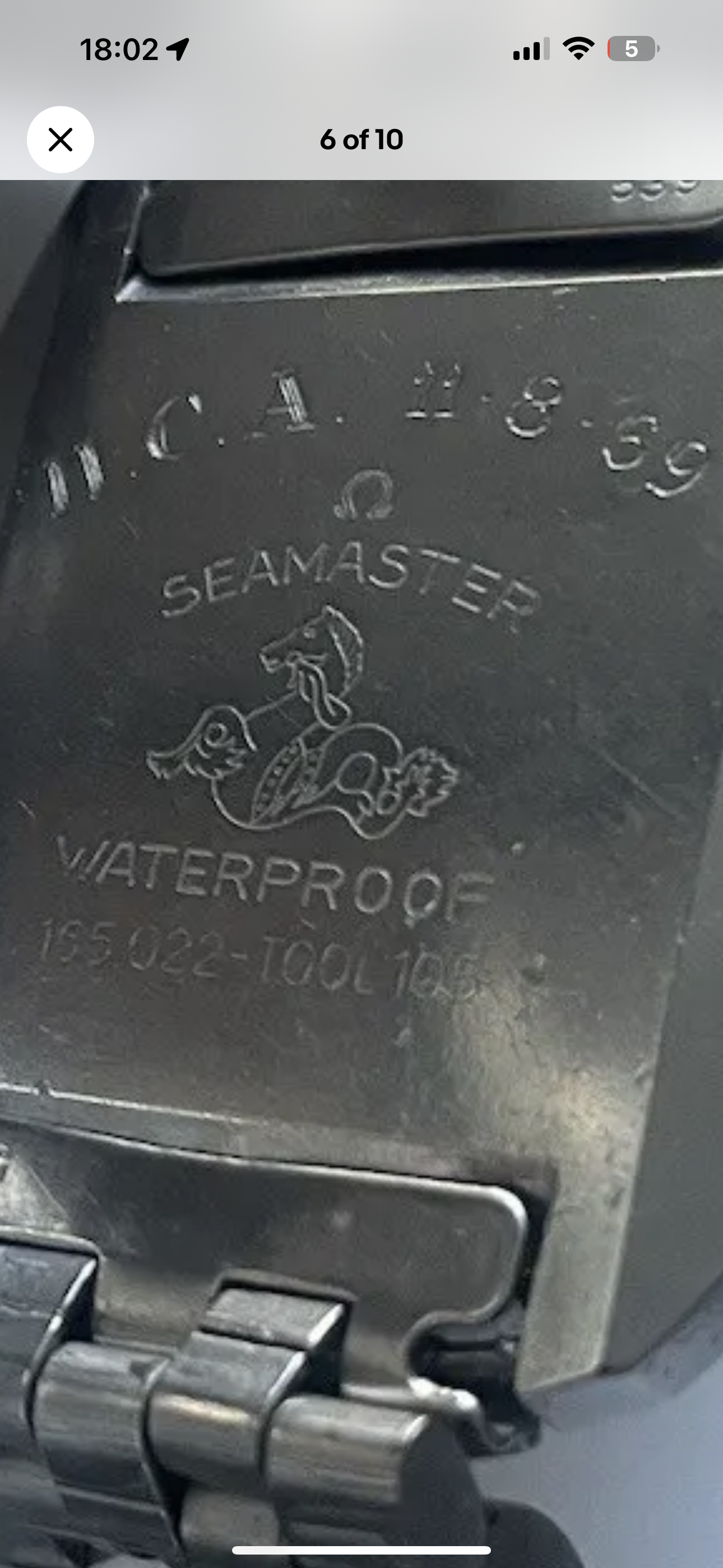

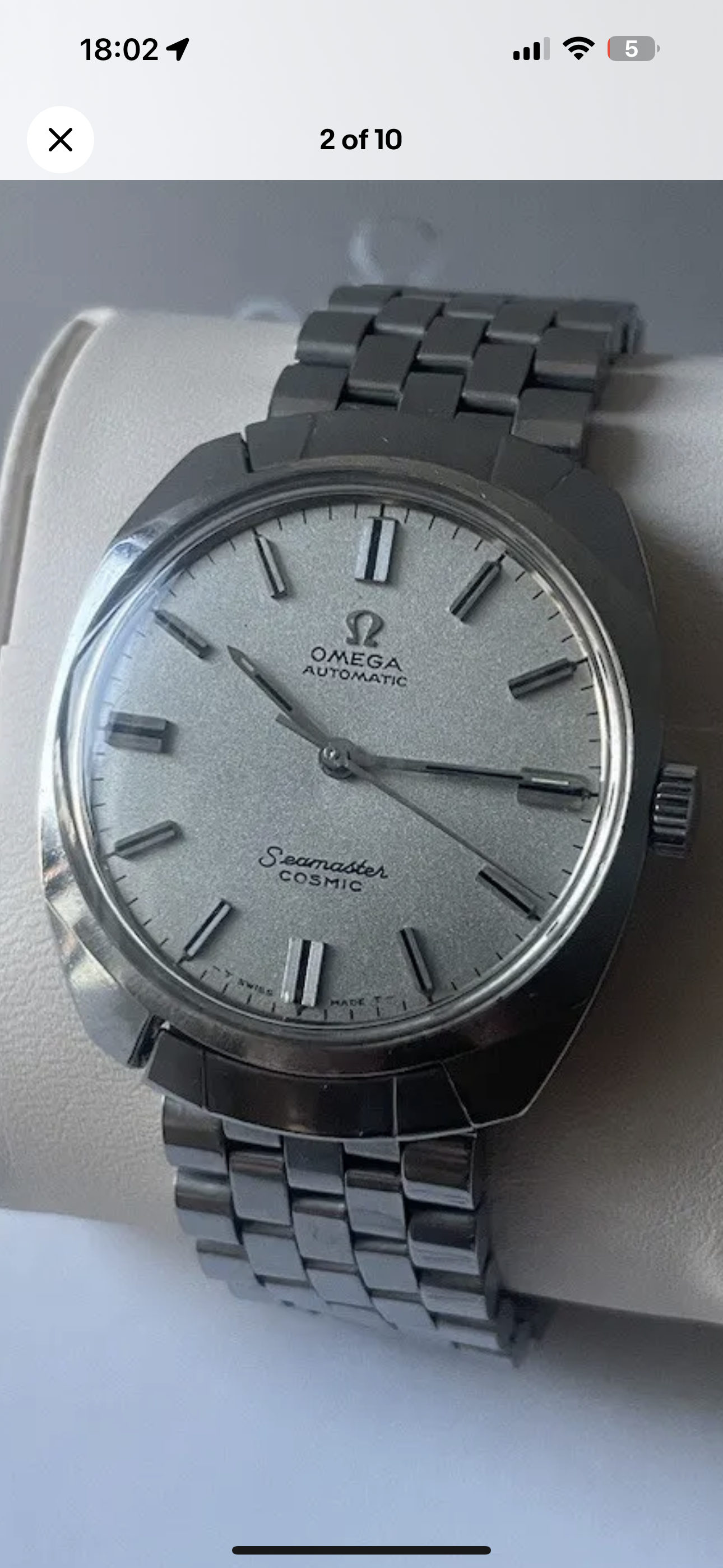

I recently purchased a vintage omega seamaster cosmic from eBay, however the crown is a replacement one. I am trying to get the original crown for it. Can anyone help me with the size I need and possibly where I can source it from?

What do you mean by Case 7224, 7223, 7251, 165.022, 565.005, 566.005?

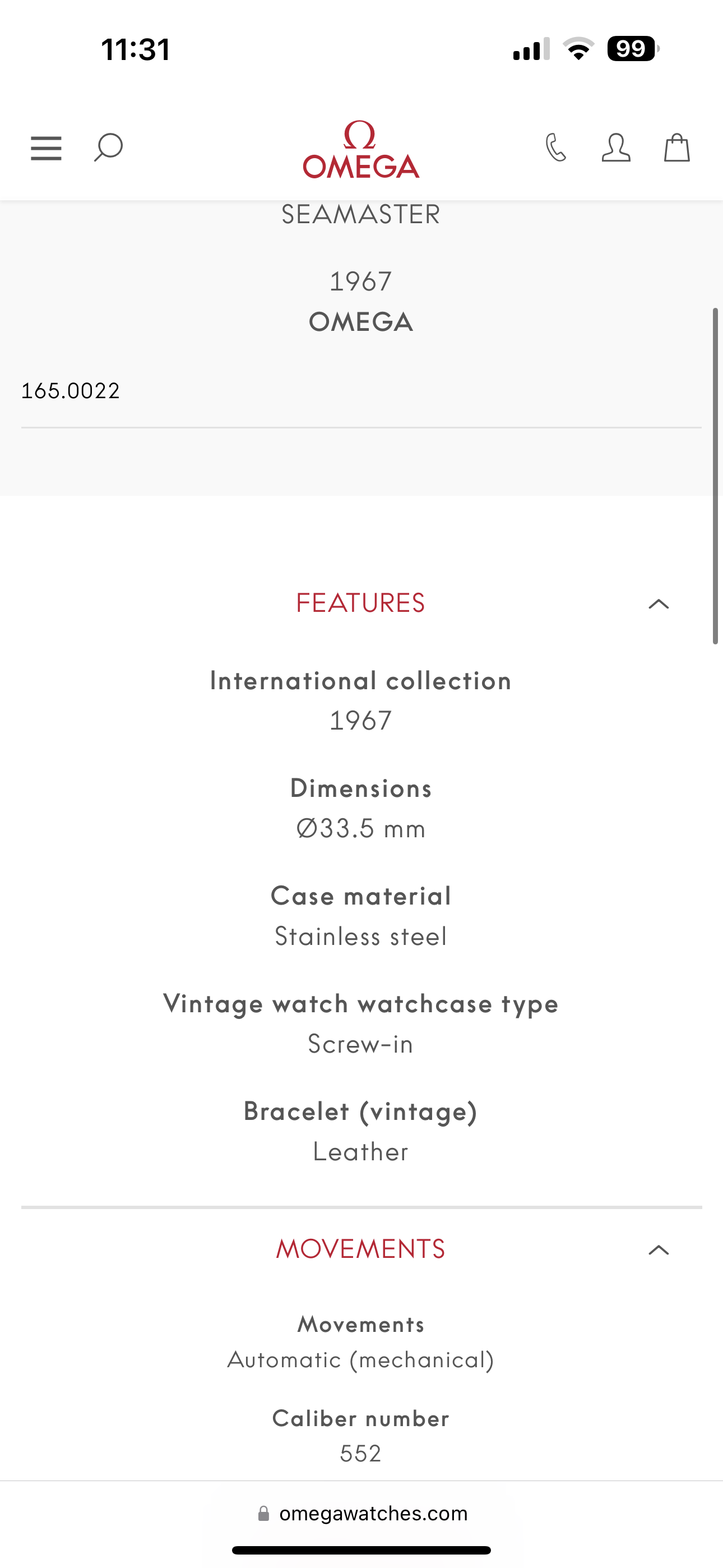

I know the case reference is 165.022 but don’t know what you are referring to with the other numbers. Sorry for my ignorance but I am no watch expert. Any help would be appreciated. Do you know anywhere in the UK I can source this replacement crown as the link you provided is for the USA/$?
