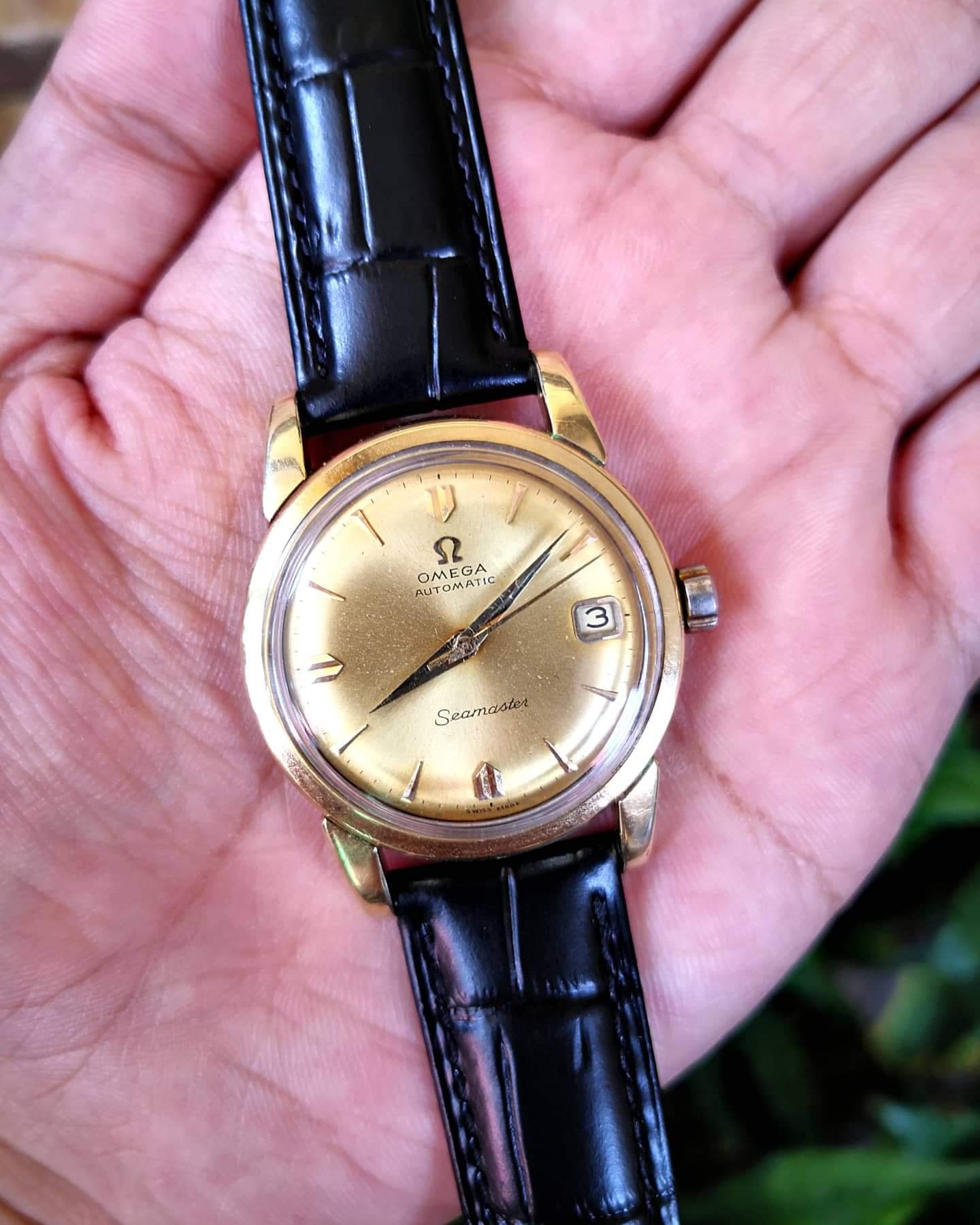

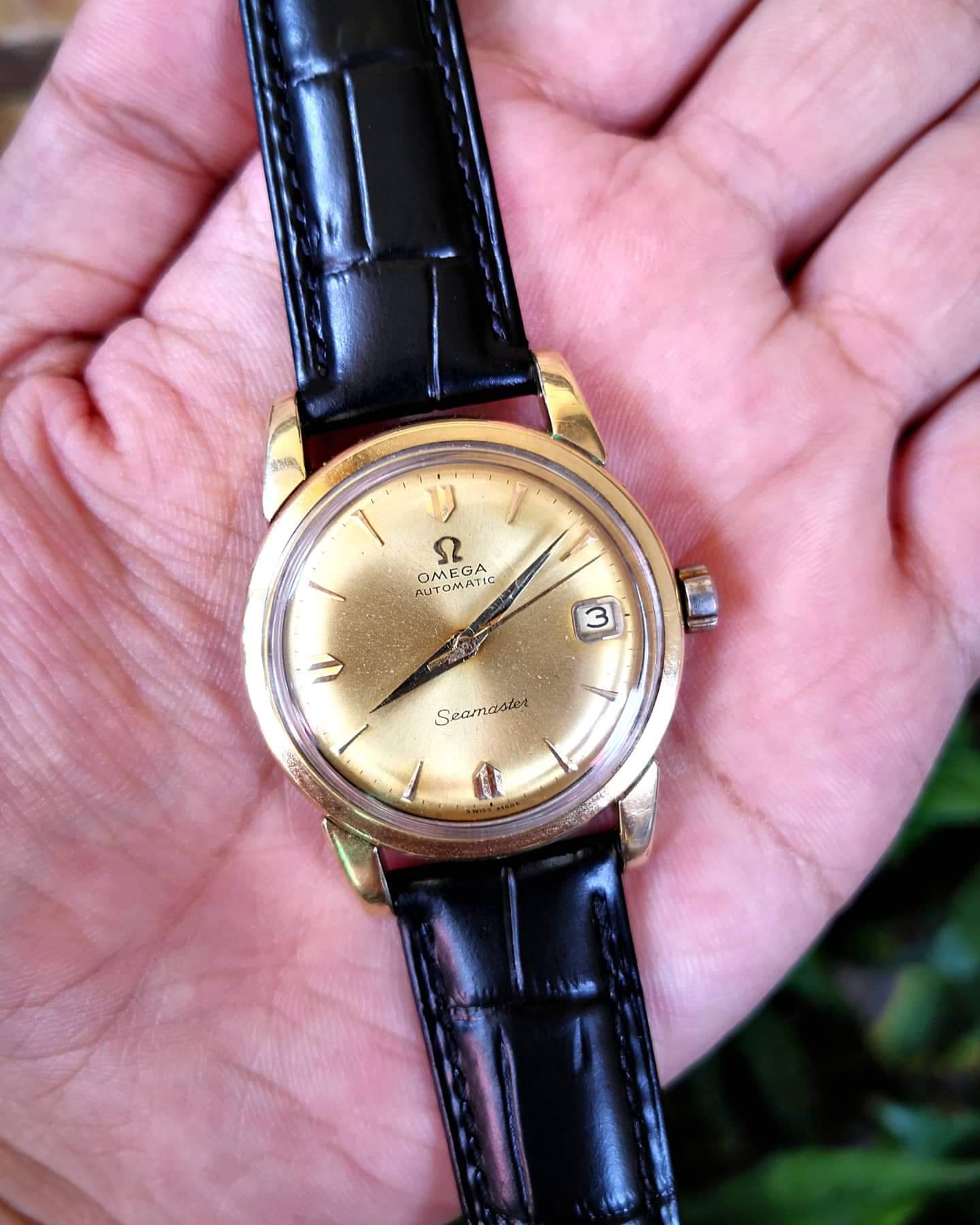

Can anyone confirm if this is all original and not a redial? Based on google search all Seamasters for this reference show the long elongated 'S' from the word Seamaster. This however is a normal S.
5,537
9,475
The spacing between some of the minute tick marks and the hour markers is a bit uneven (1, 8, 11, and the overexposure blows out most of the rest)
10,804
16,814
As above, either S is probably OK, but the misaligned minute ticks are not and in any case all the text looks slightly off. the r in Seamaster is very short vs other round S versions.
I say redial.
617
2,986
Not an expert like many here, just an enthusiast but I also think the S looks off and I get overall a feeling of redial.
Very overpolished case as well (not the main topic, but wanted to get that out of my chest).
188
41
Sorry for the late reply. Thanks everyone for all the input. Happy to know I got the S issue as well (i.e. starting to get better in detecting redials). I love browsing through and closing up on these omegas. Haha such a watch nerd. Cheers
