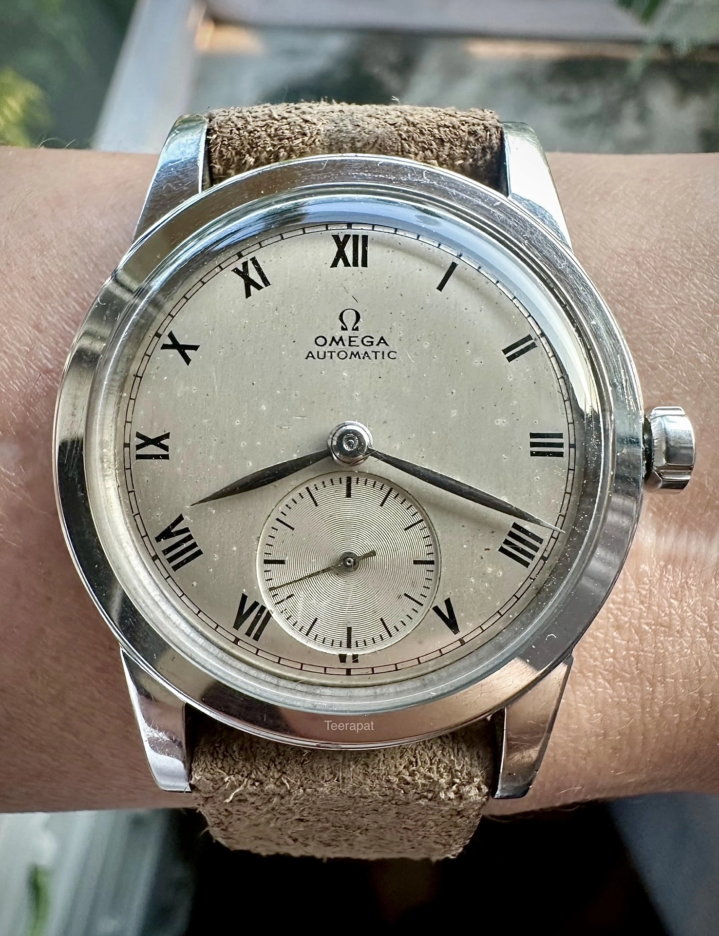

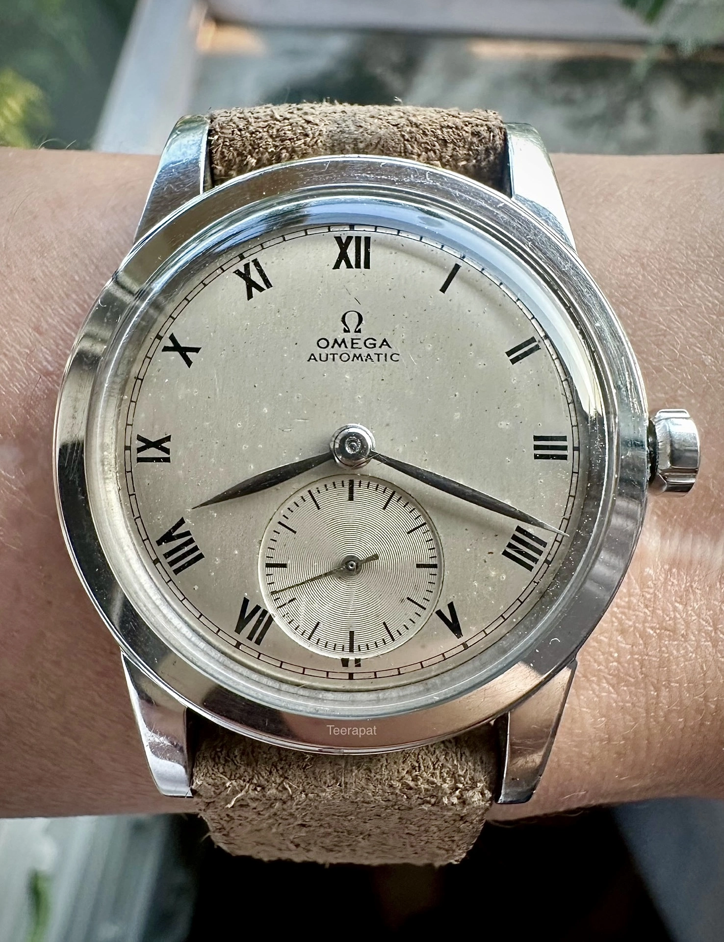

Hello, all members,
In 1949, the first Omega Seamasters appeared. These early Seamaster models, across both references, can sometimes be found without the word Seamaster printed on the dial.
In this thread, I will specifically focus on Omega sub-second version. The movement used in this model is typically caliber 342 or 344 (for later production periods). Almost all examples of this reference feature the “applied” Omega logo.

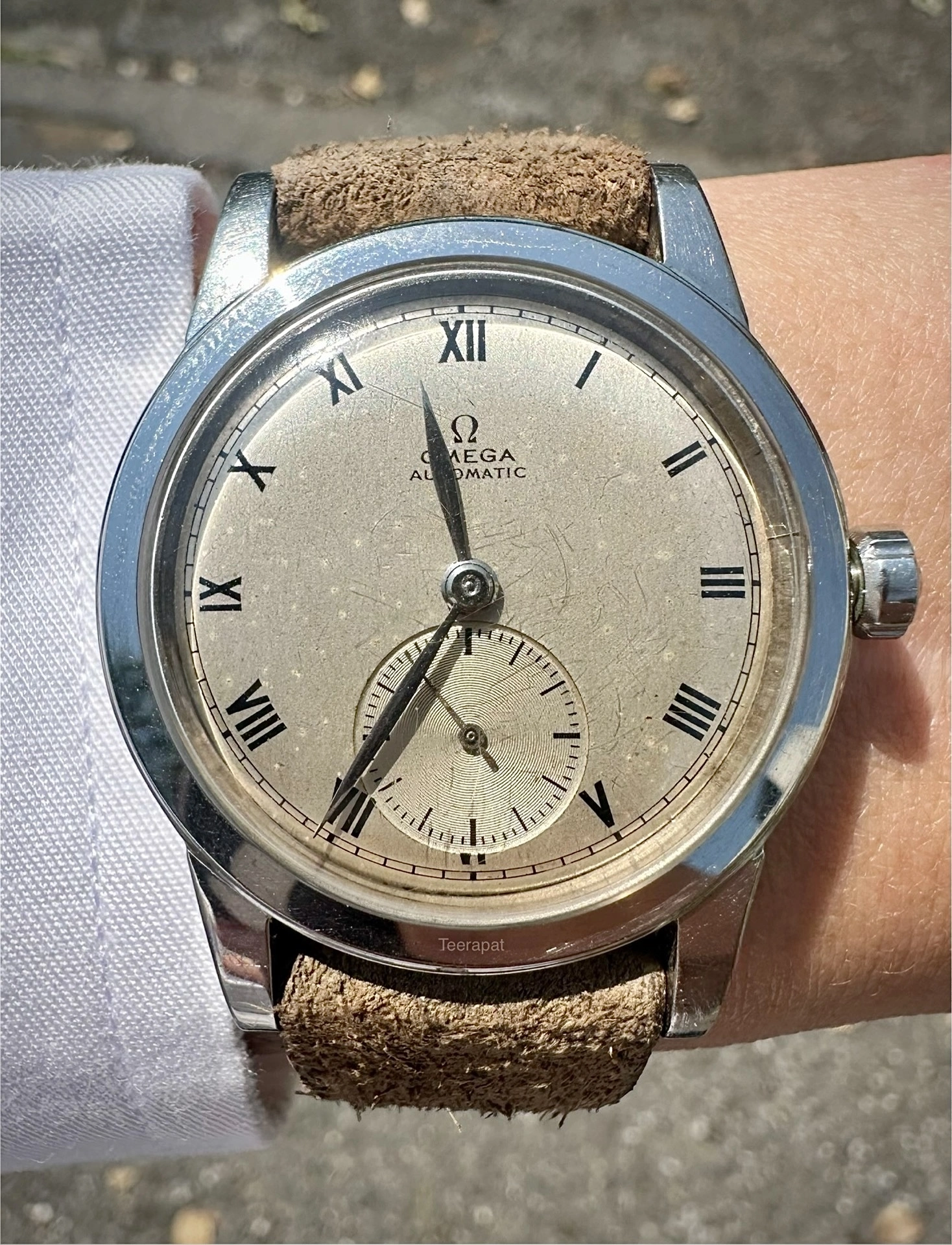

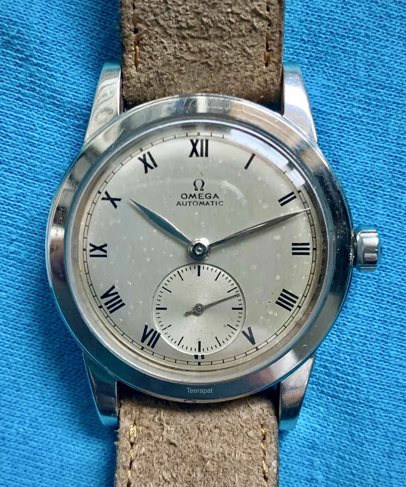

First and foremost, I would like to acknowledge that I am uncertain about the originality of the dial on this particular reference. Plus, I appreciate the help from the people I asked via p.m.

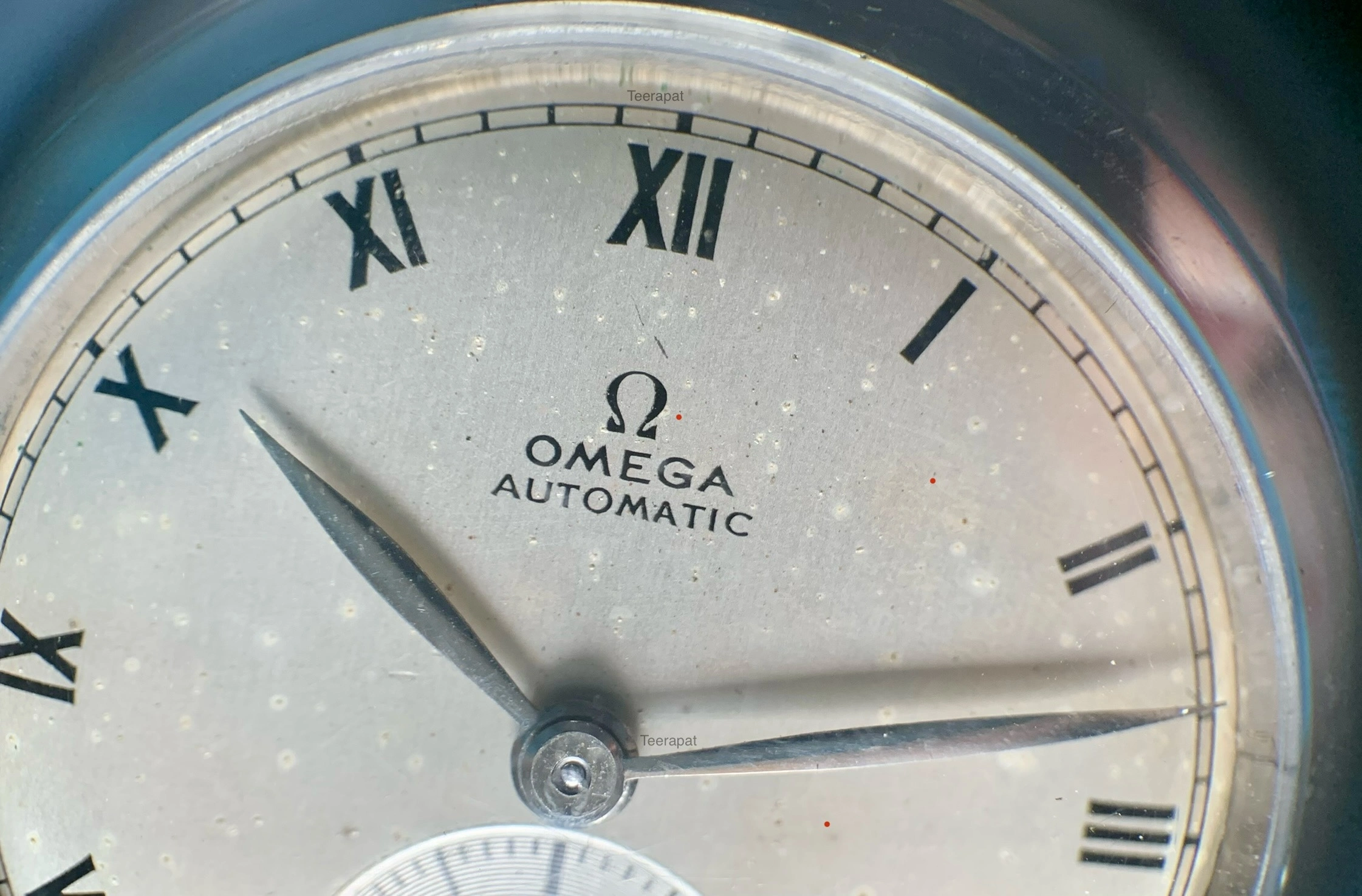

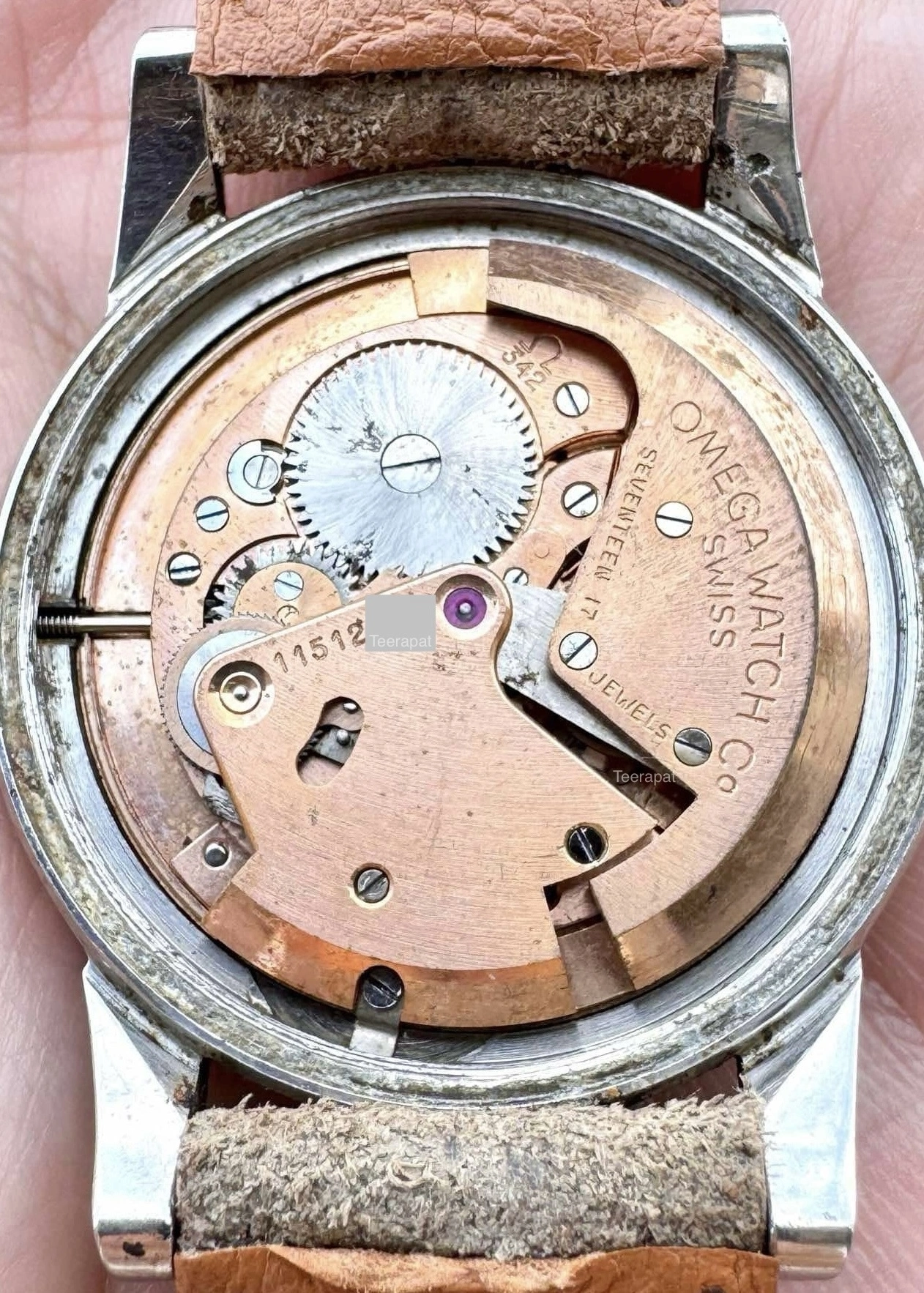

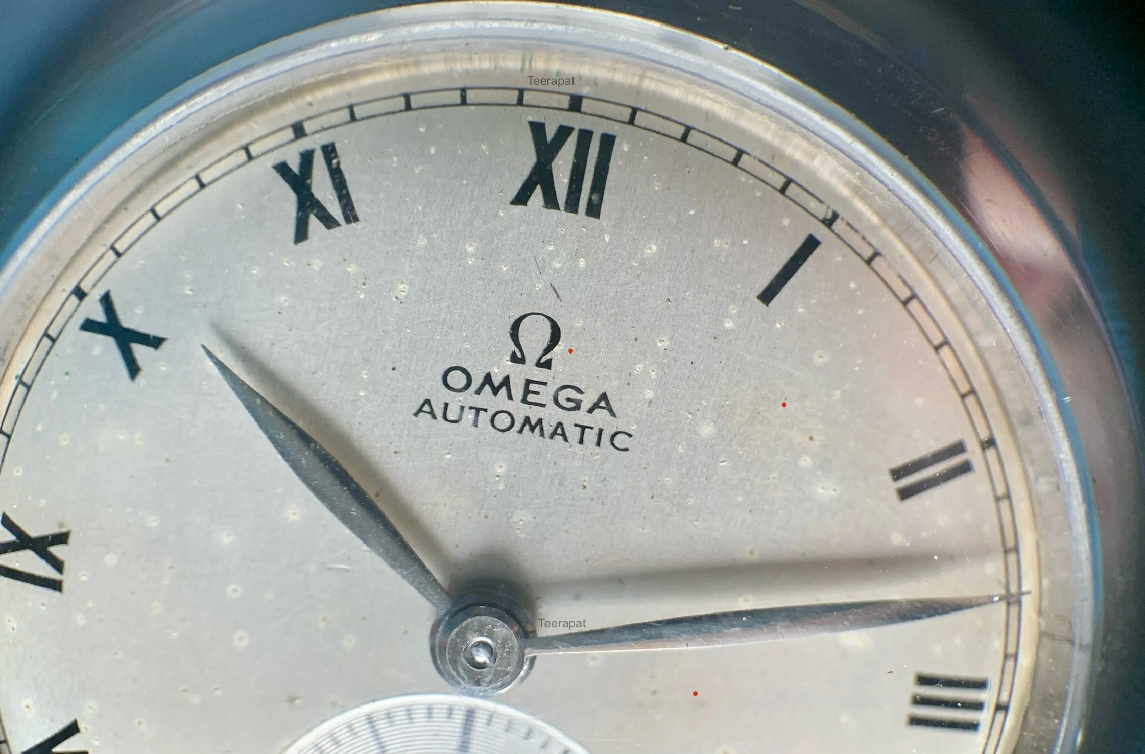

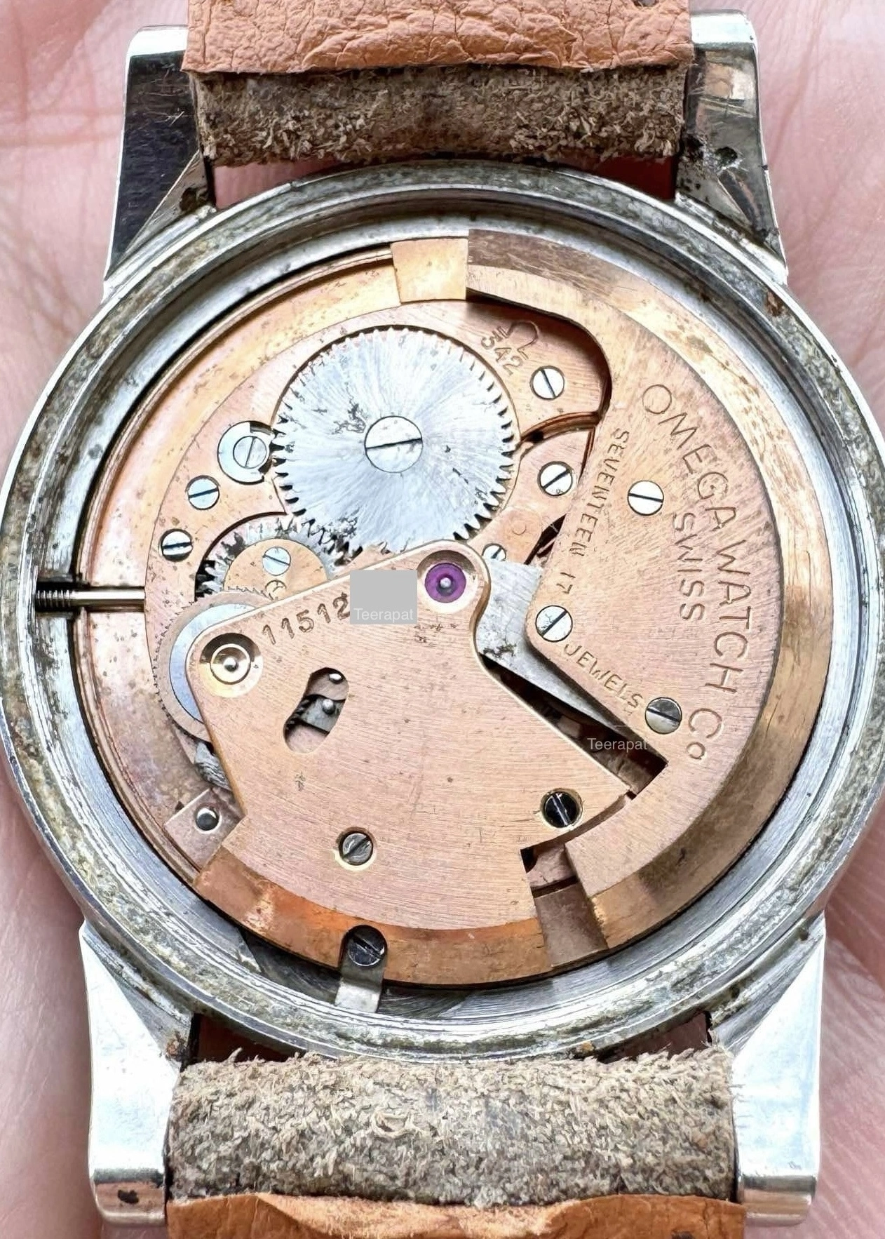

Today, I would like to share my “printed” Omega logo, which has a movement number 11,512,xxx, matching with caliber 342. Based on my research, I estimate that the production year falls between late 1950 and early 1951.

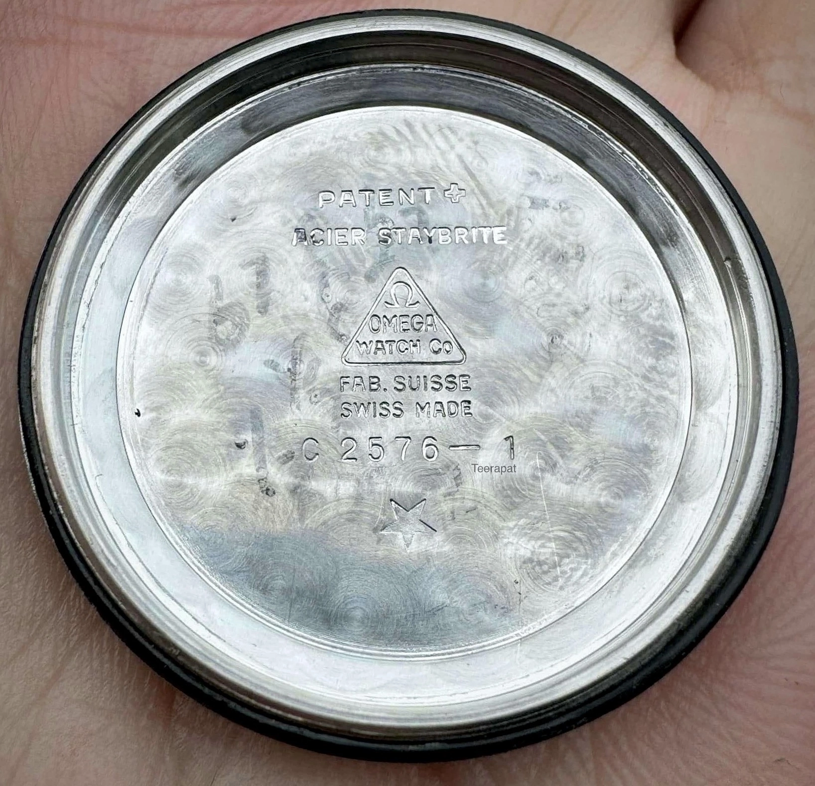

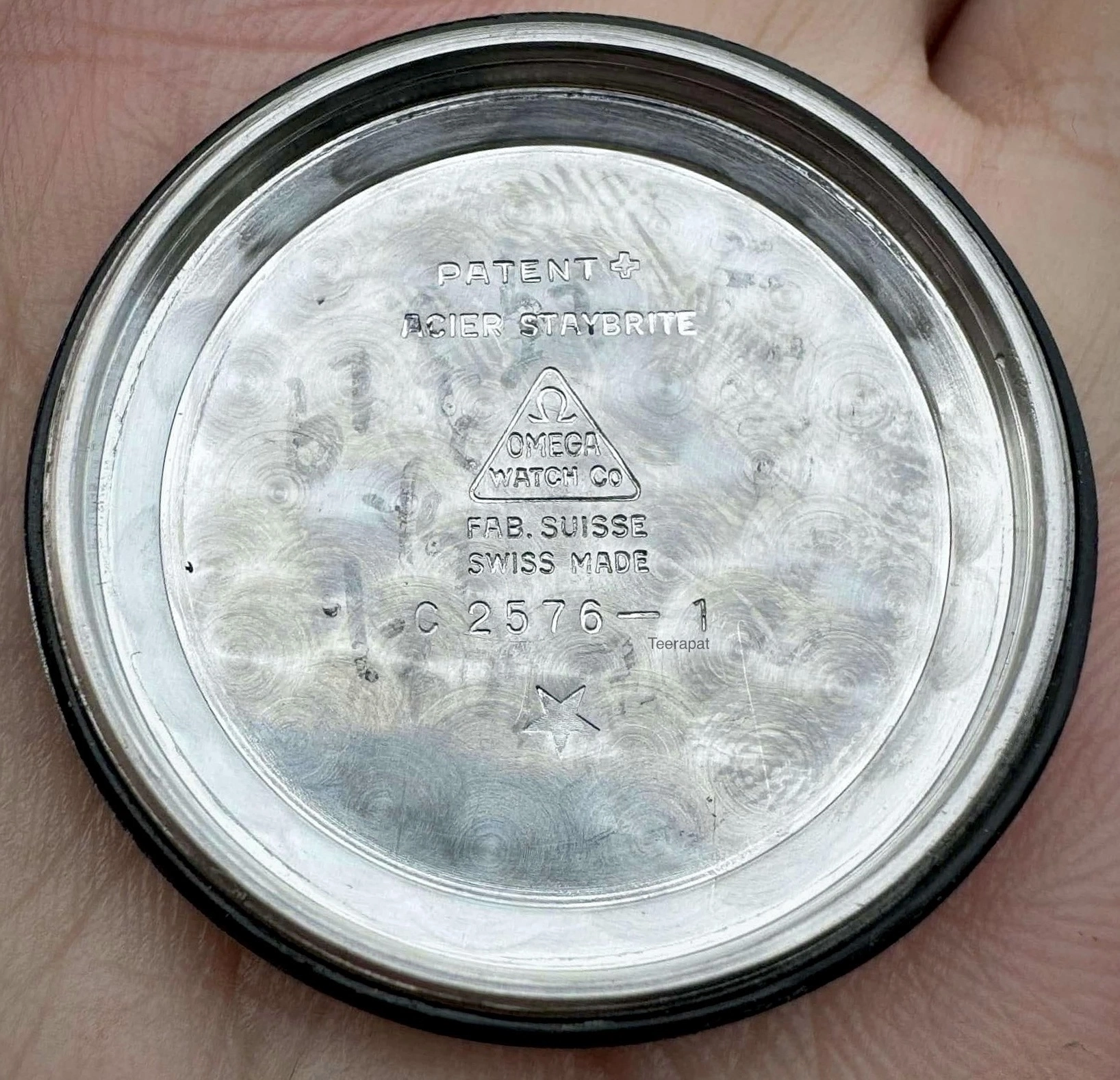

My research has found fewer than 10 watches with the reference marked as my watch inside the case-back.

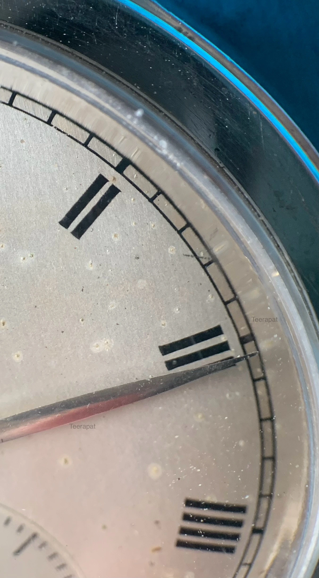

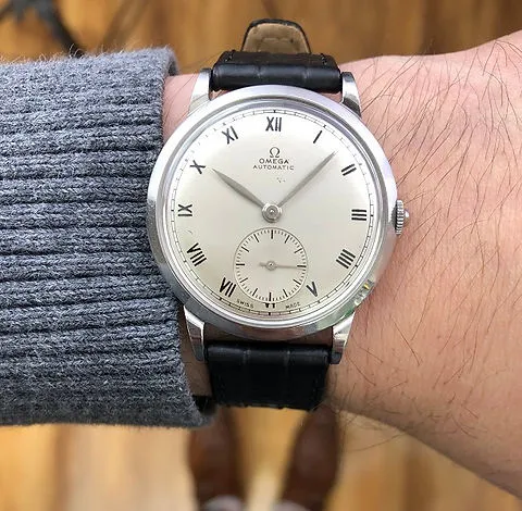

The hour markers on my example are printed entirely in Roman numerals, a feature that my research could not find on any other reference. Additionally, the rail-track minute markers, the leaf-style hour hand, and the overall handset design are uncommon for this reference. This specific hand style was typically found in the late 1940s.

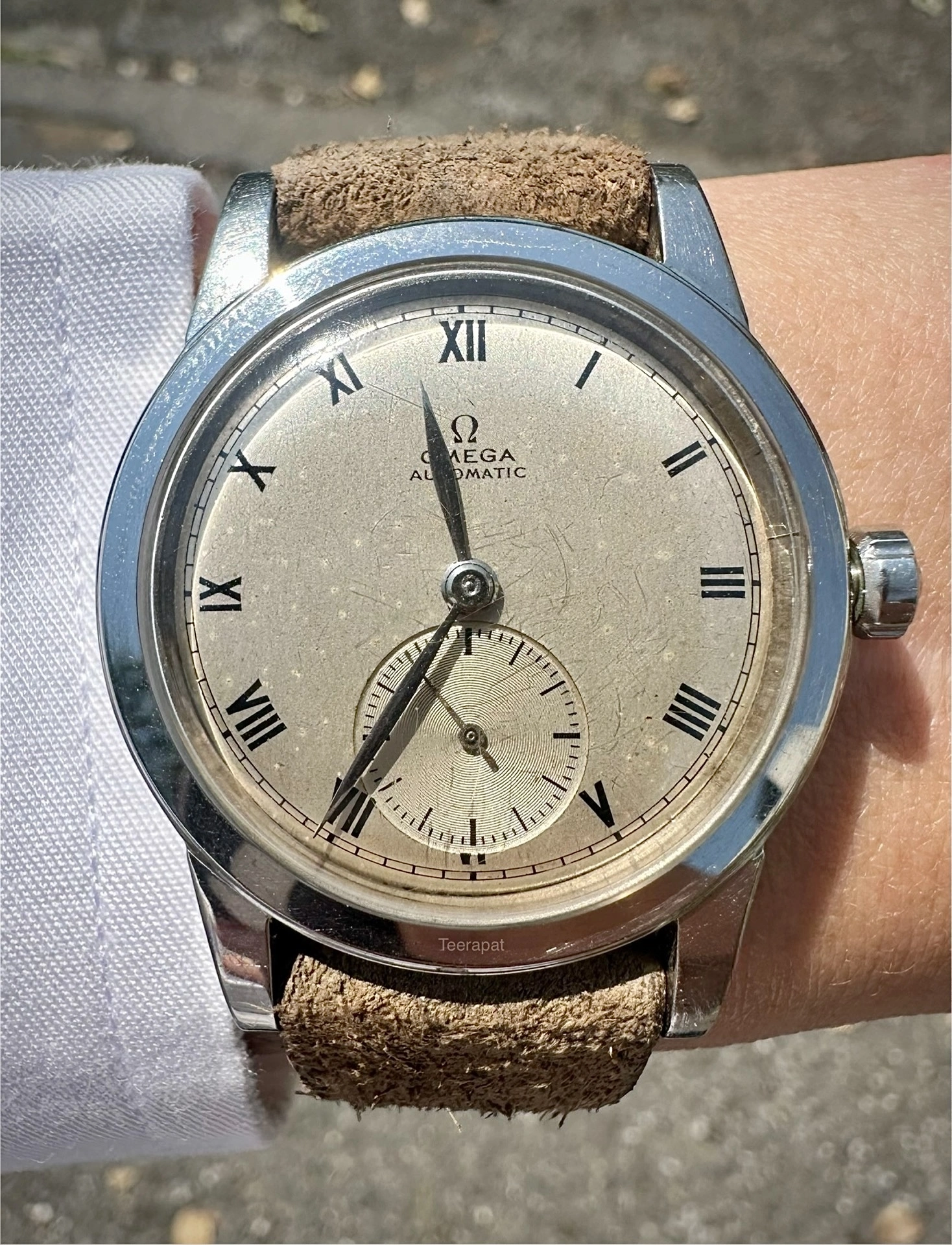

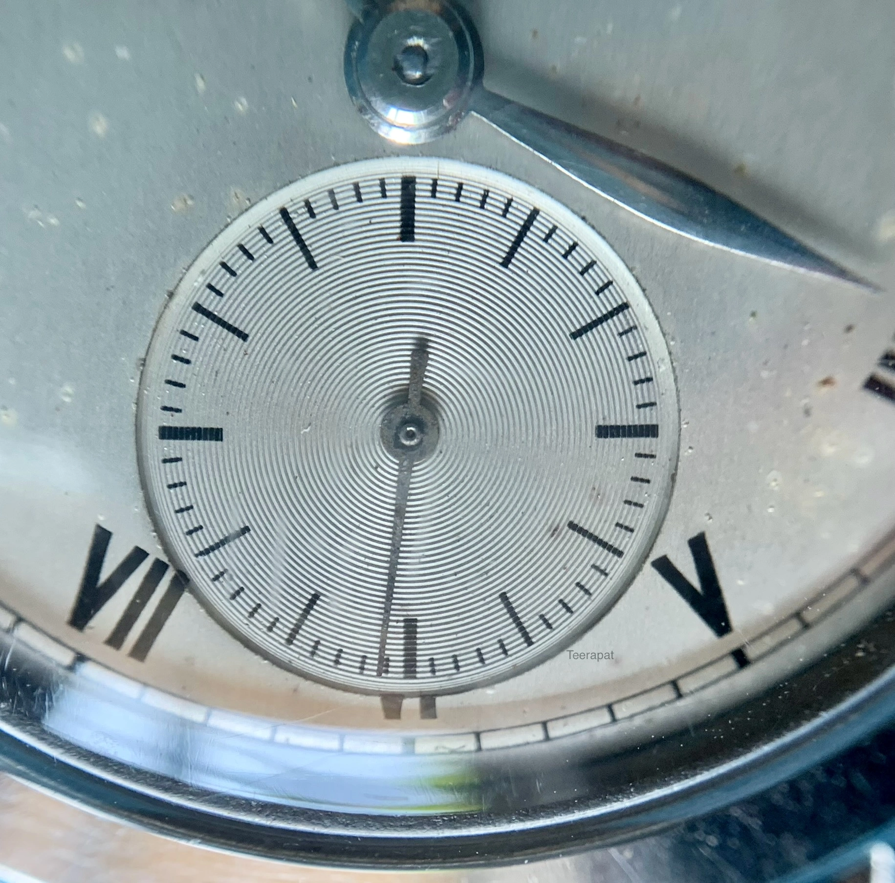

Additional Dial Details

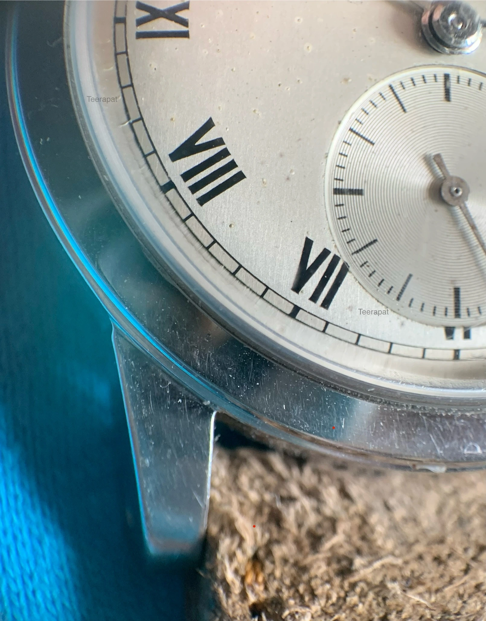

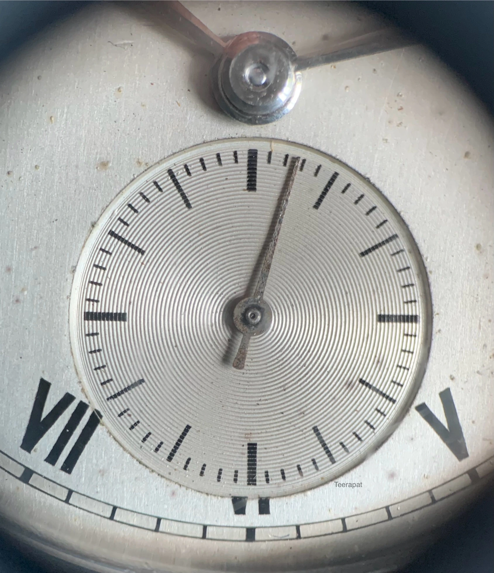

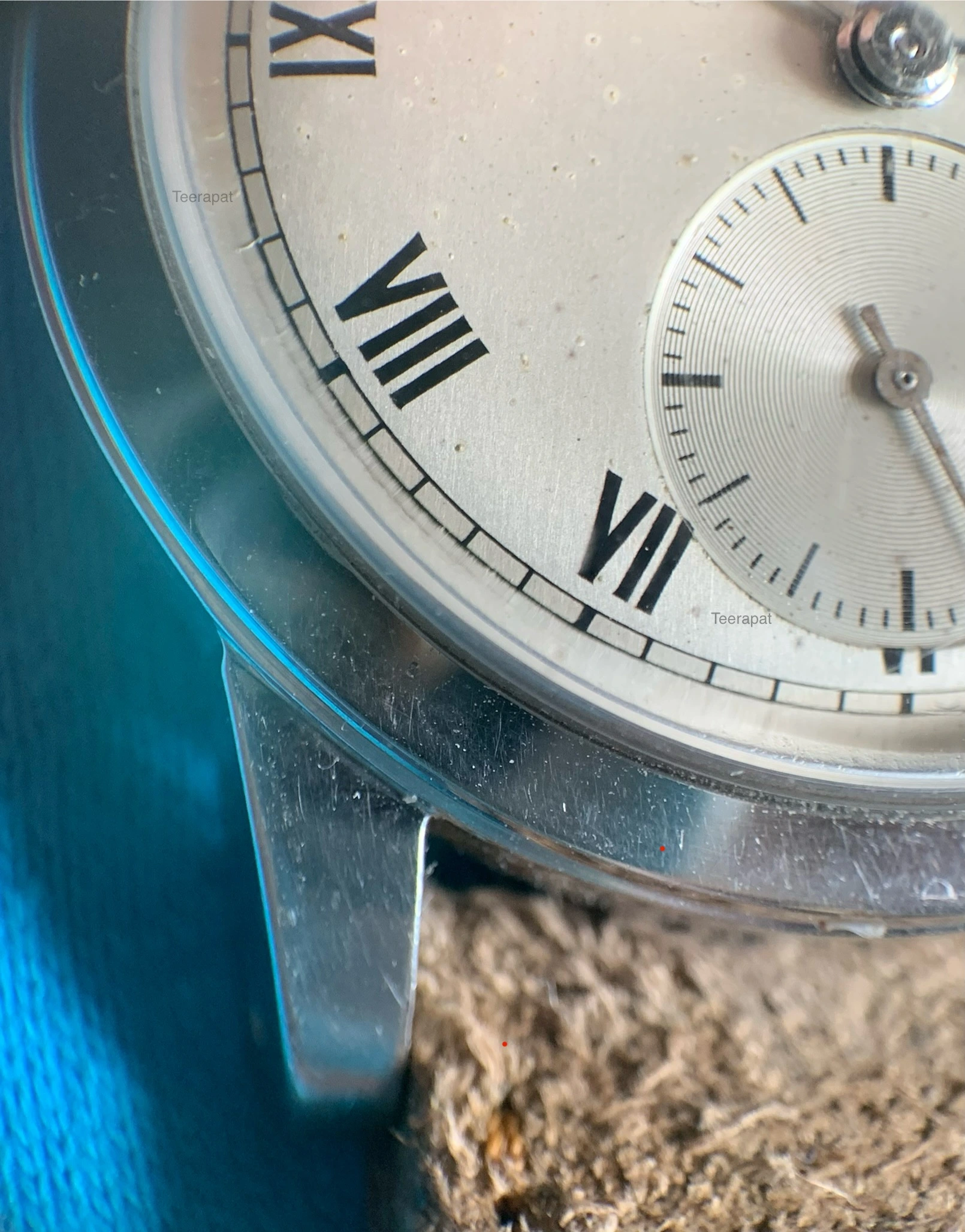

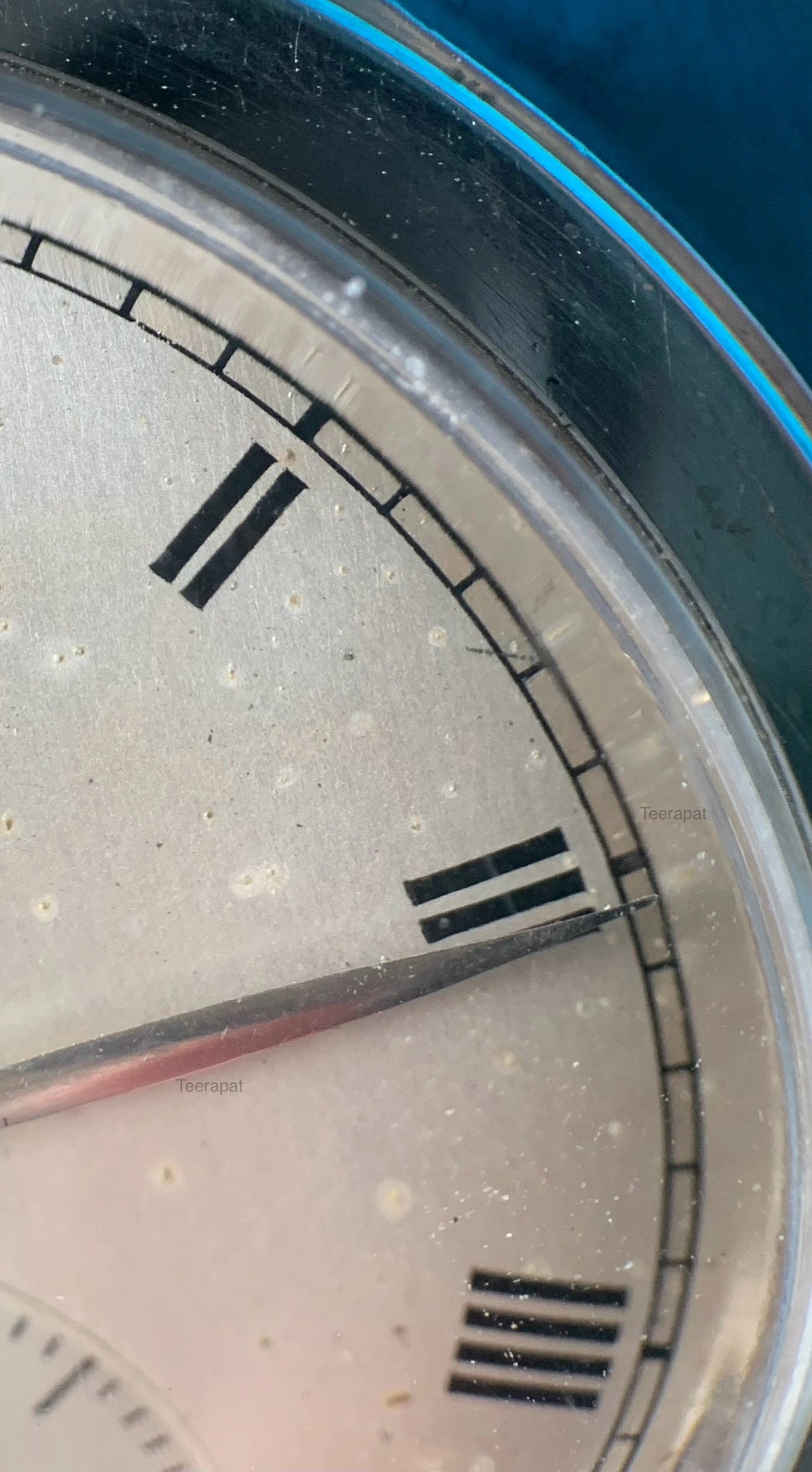

Below are close-up images of the dial, rail-track, and hour markers.
Please note how perfectly the minute hand aligns with the minute track at the end of each marker.

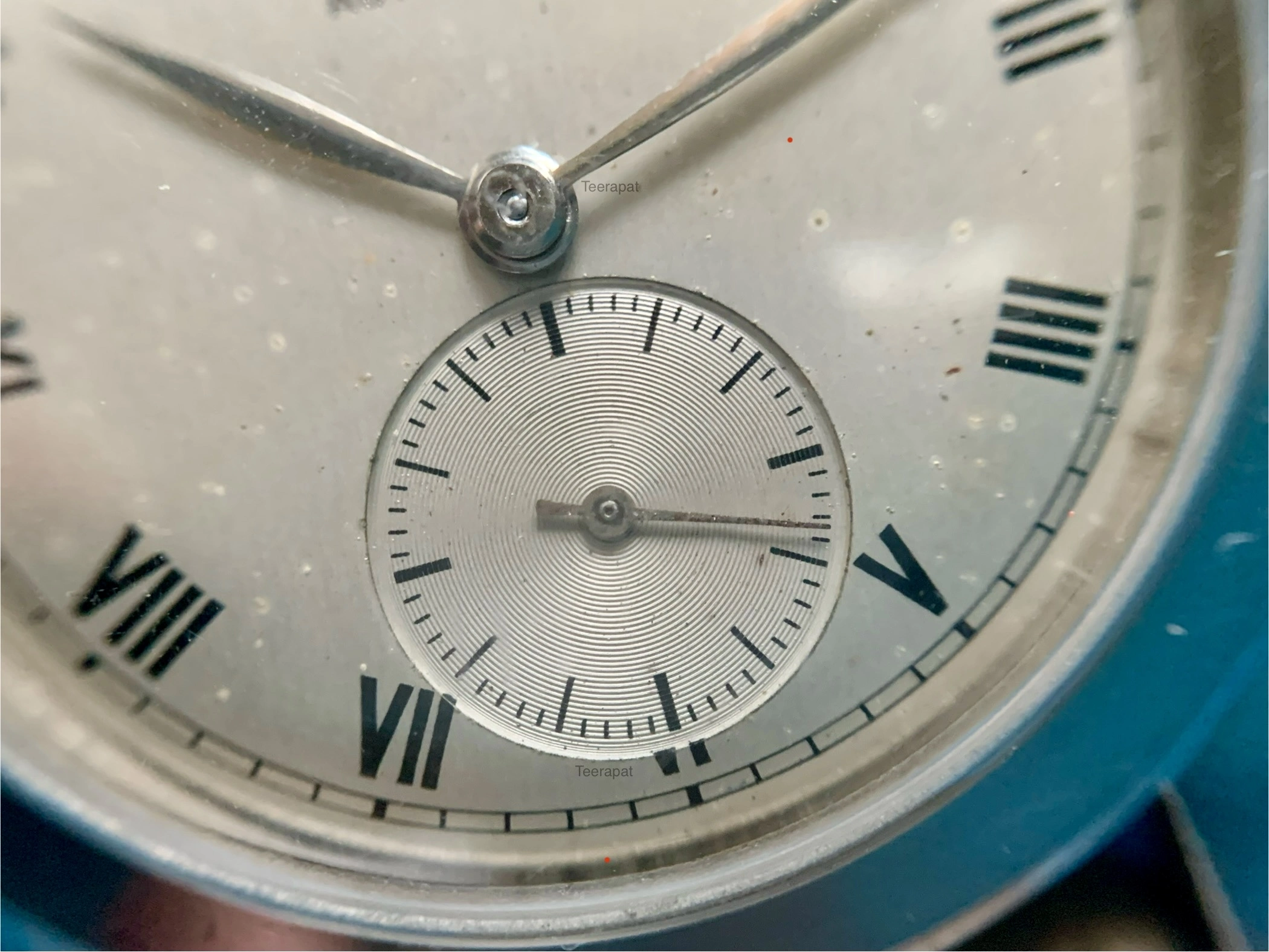

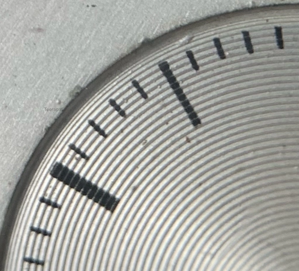

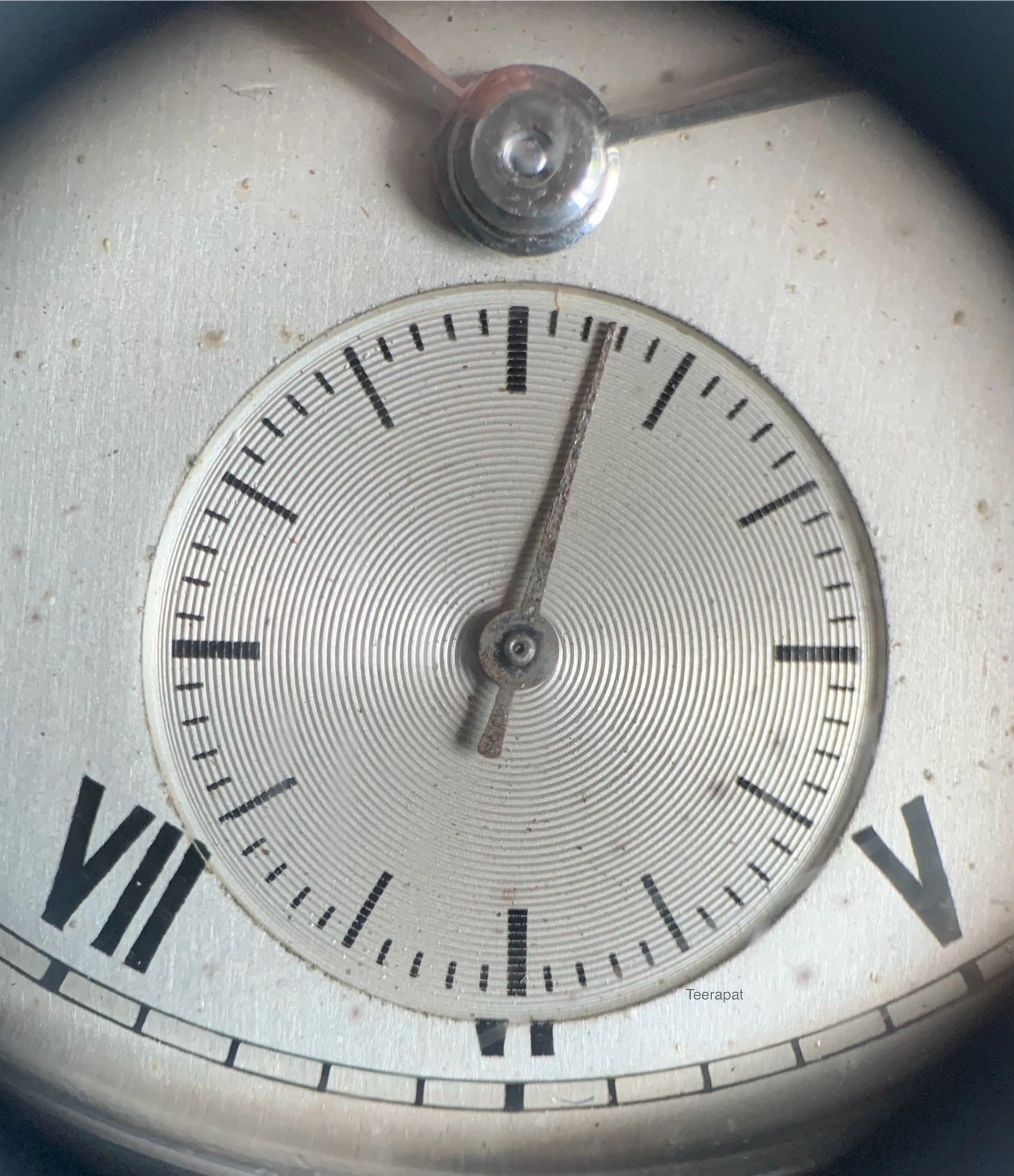

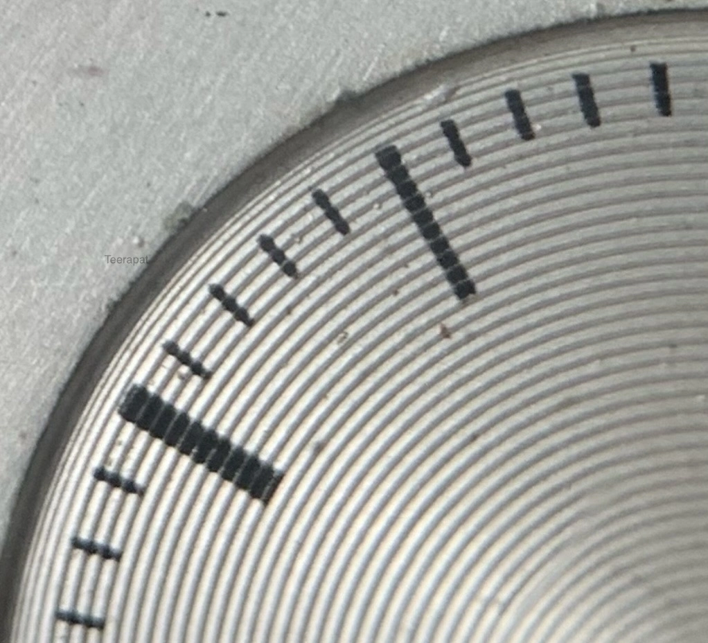

The sub-seconds dial exhibits a distinct circular texture.

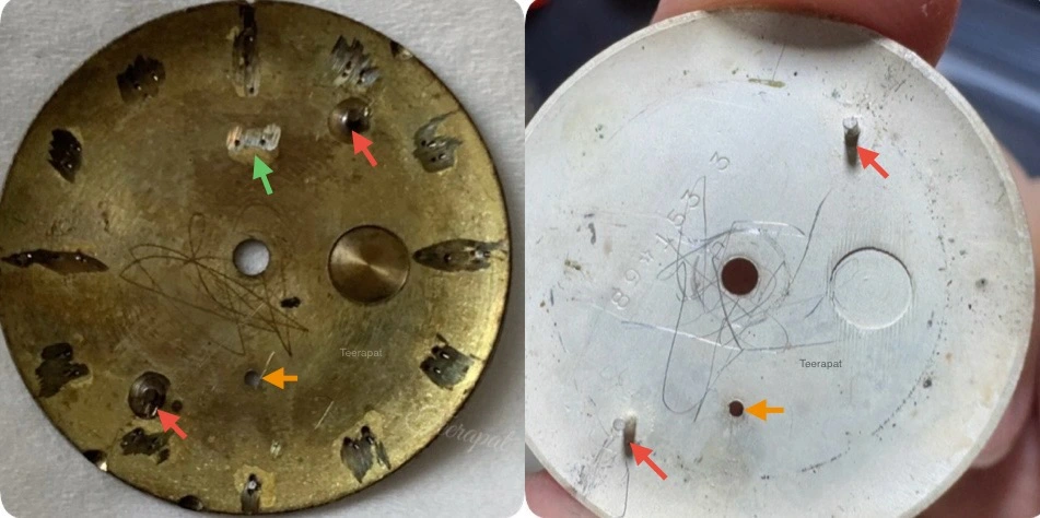

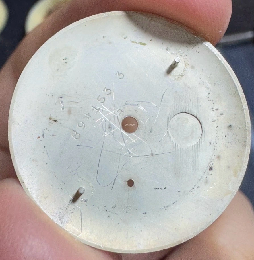

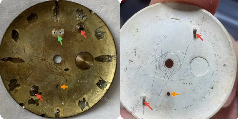

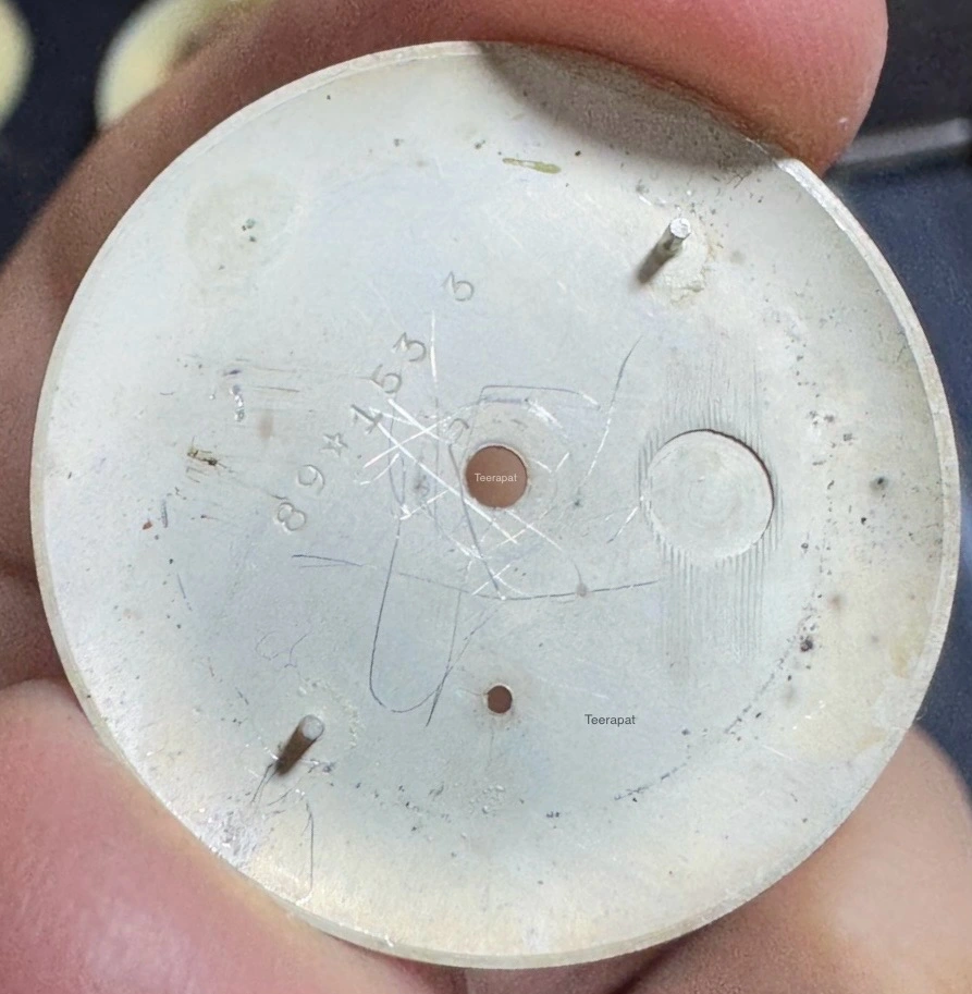

Given the uncommon nature of this dial, I prefer to examine its reverse side. The back of the dial shows that both dial feet remain intact.
Comparing my reference 2657 with another of mine with an uncommon dial pattern, I observed that both dials have a hole for the sub-seconds hand (marked by orange arrows). Additionally, the dial feet are positioned identically (indicated by red arrows).

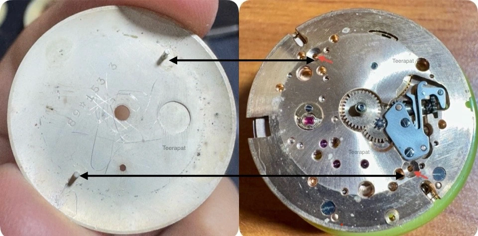

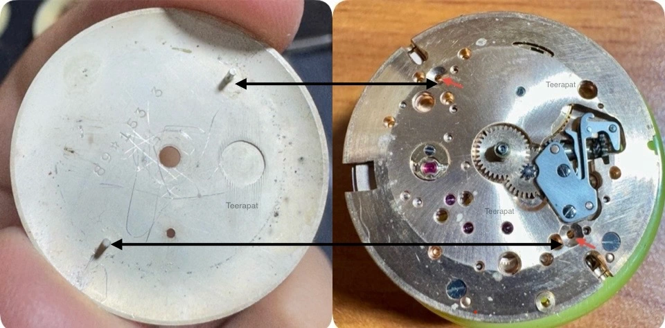

Furthermore, most reference 2657 dials designed for the applied Omega logo have an additional hole for securing the logo (highlighted by green arrows). However, this printed version lacks such a hole, reinforcing its distinctiveness.

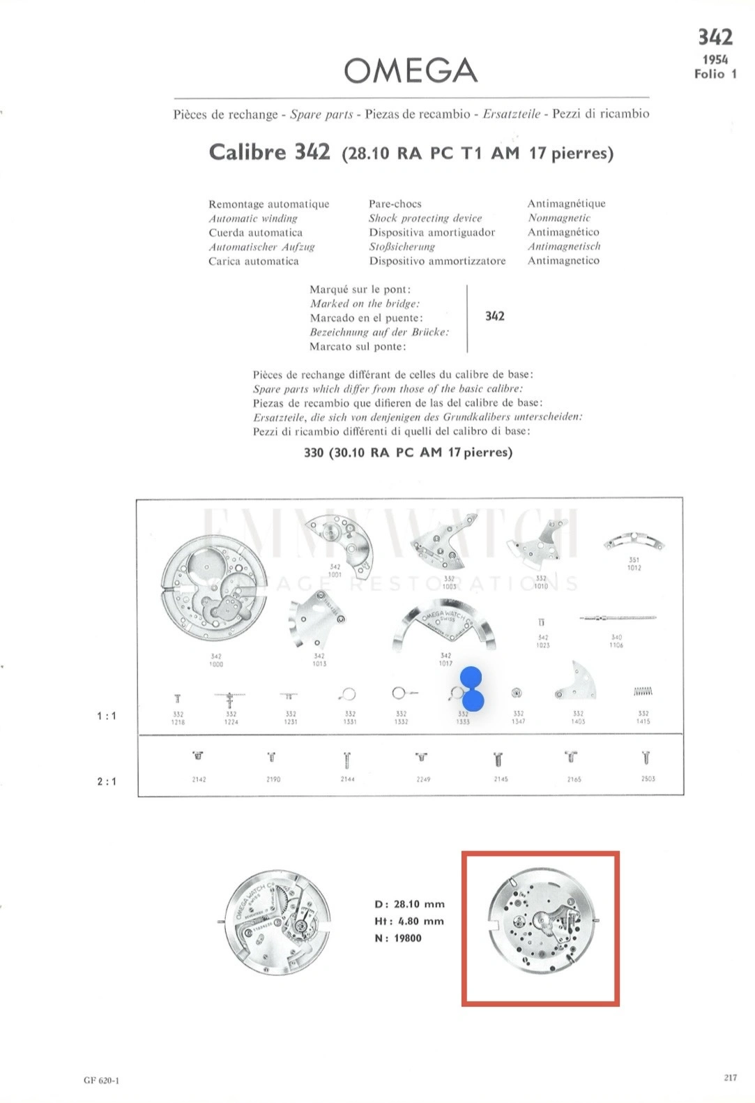

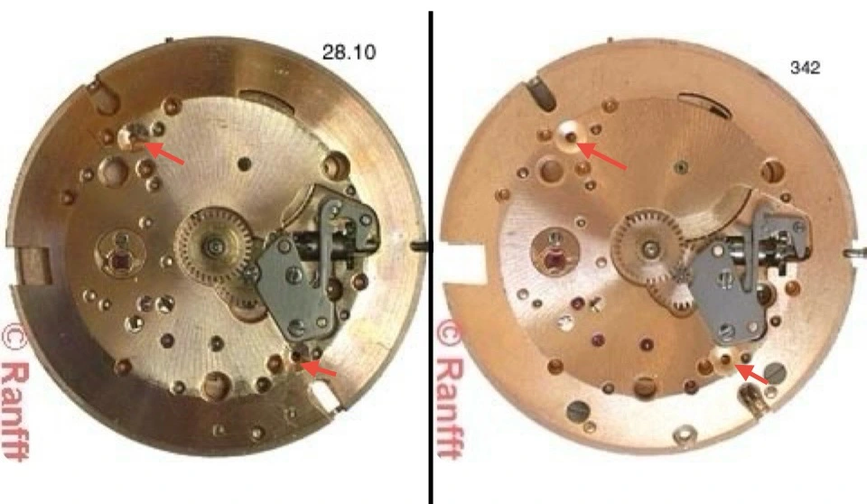

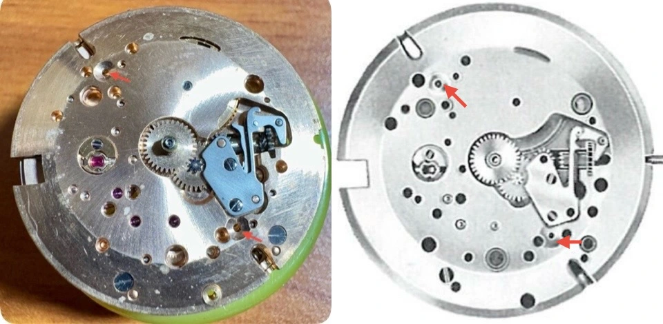

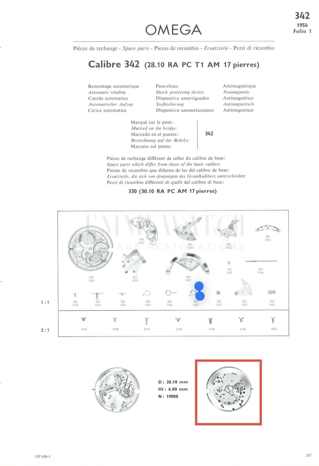

Regarding the Caliber 342, the following image presents the movement number attached to the dial (image credit: emmywatch.com). My watch appears identical to the example shown. The red arrows indicate the holes where the dial feet would be inserted.
Please visualize the alignment of the dial when rotated into position over these holes.

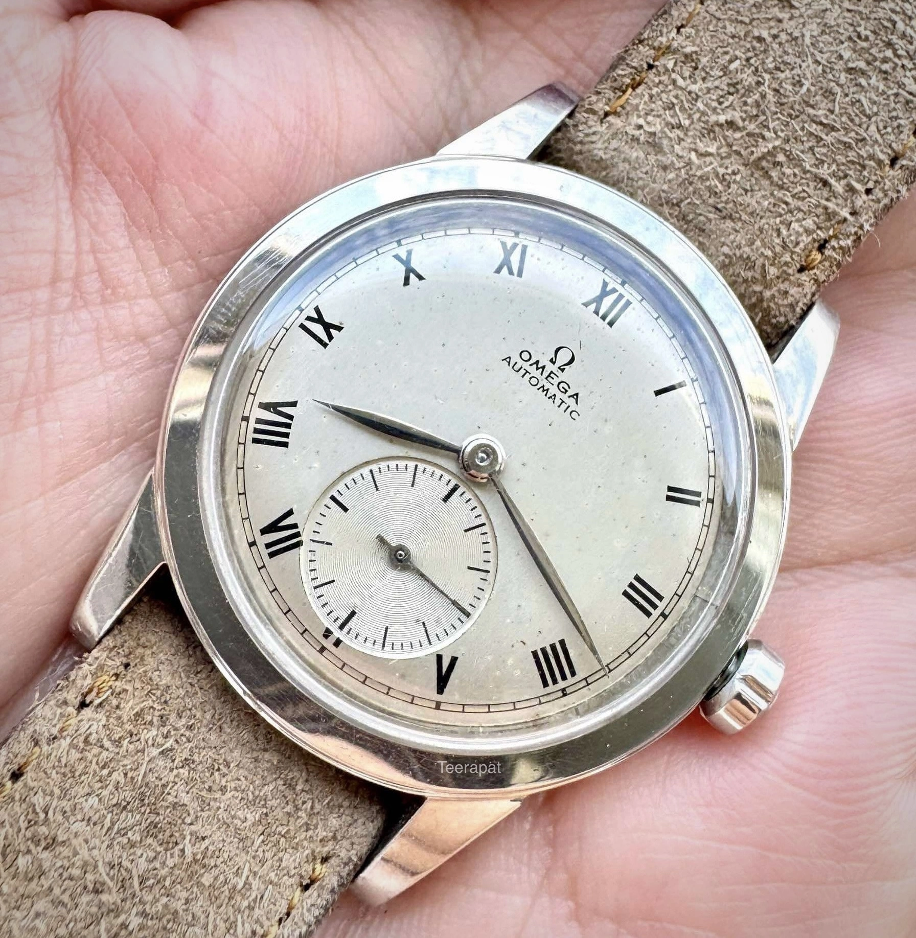

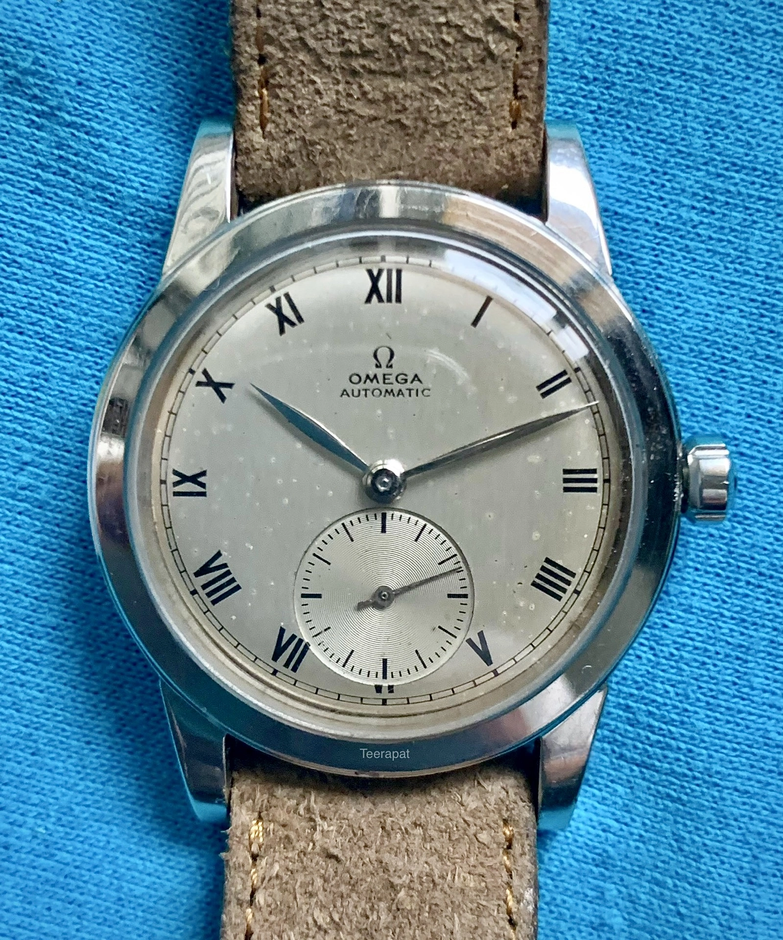

Lastly, here is a wrist shot of my watch.
I apologize for the large number of images, but I wanted to provide as much detail as possible.
Thank you, everyone, for your insights regarding the originality of this dial.
Is it possible that the printed Omega logo corresponds to the early production period of this reference?
Additionally, if anyone owns an Omega model from the early 1950s with a printed Omega logo, please feel free to share your examples.
If my watch was indeed redialed, it is one of the finest redials I have ever encountered. However, I am curious as to why the redialer would go to such great lengths to repaint all the minute tracks with the great skill in the sub-dial, as this feature is generally not found in this reference (as demonstrated).
Best,
Teerapat

Based on the serial number, I would say that your watch dates from 1949 to 1950. I know that I have a 1950 Omega catalog in my digital picture stash on my computer at home. I will look at the Seamaster pages there later. However, I think that the pictures shown there have a gold applied logo on the dial.

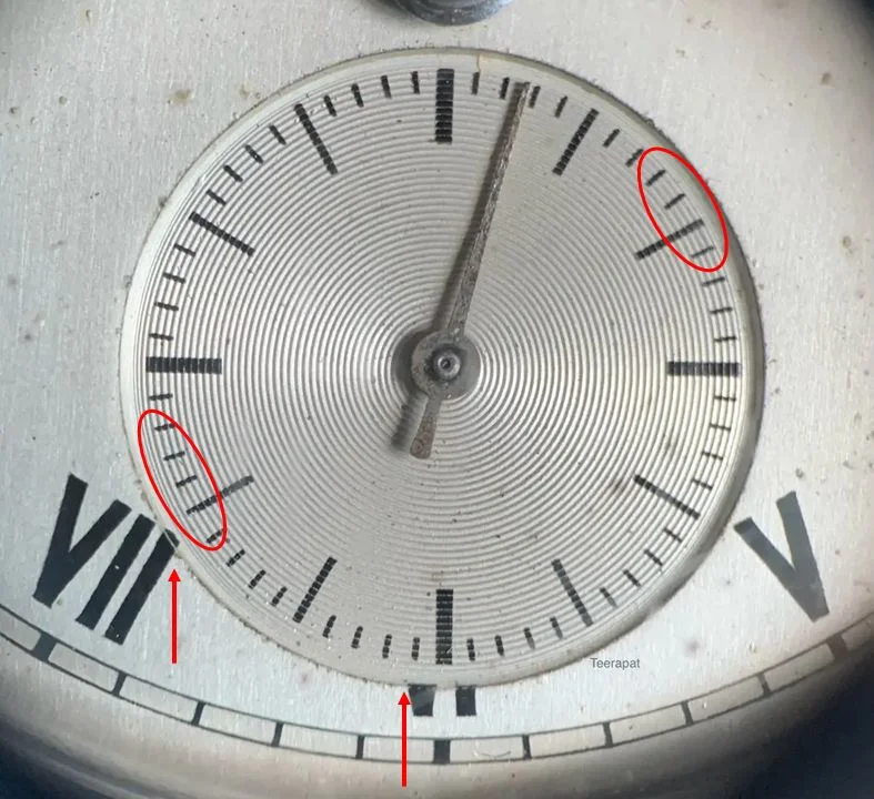

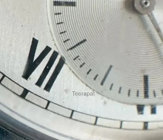

After posting above, I noticed this picture from your original post:

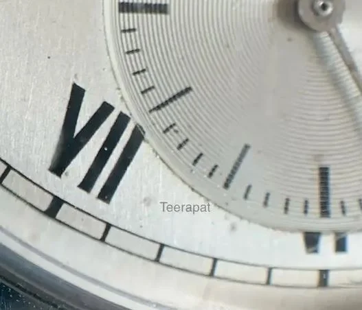

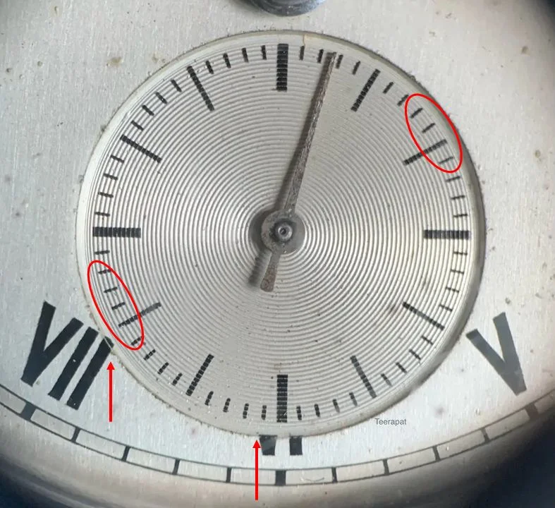

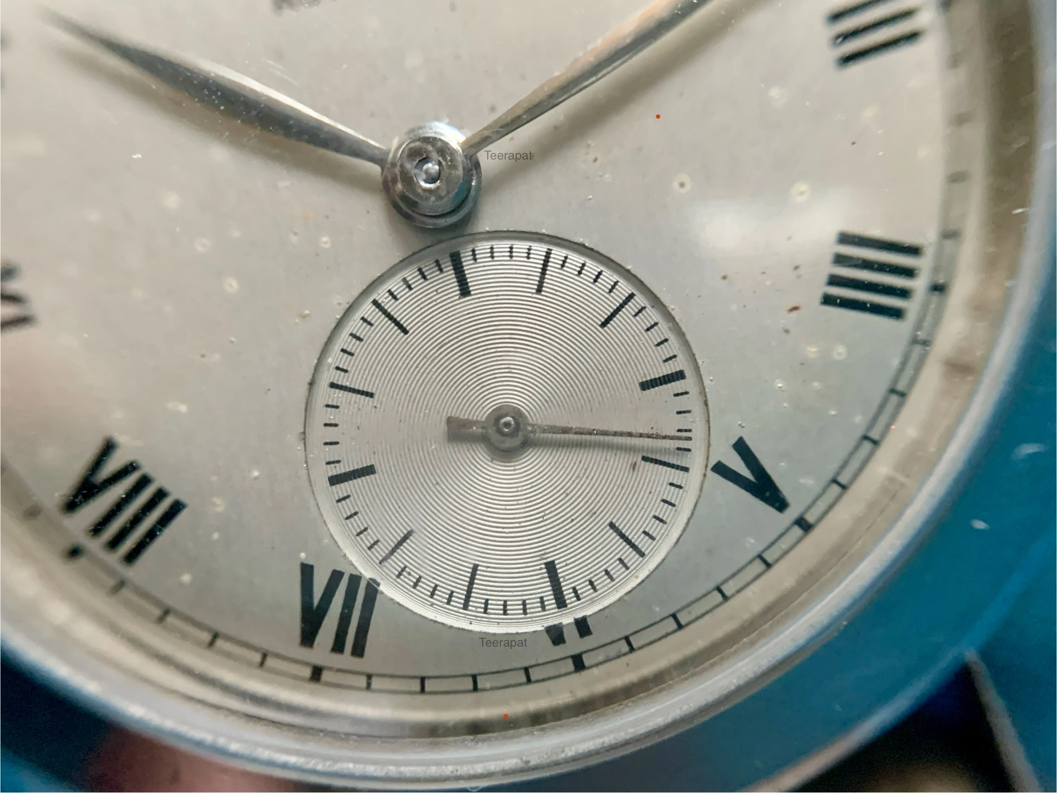

Not loving the top of the 2nd "I" in "VII" bleeding into the subdial. Could possibly be a redial. If so, it is a very nice job.
gatorcpa
3,653
7,770
In all respect but IMO this is not a red flag towards redial at all - I have seen this multiple times on fully original dials, even NOS examples where there is no doubt... We had this discussion already many times.
This dial is 100% original in its condition but unsure if it left the factory on this particular watch - the possibility you mention that the dial came from a diferent reference is the most logic and realistic explanation.
I must admit I am not very familiar with these very early Seamasters, so my comment is not meant to say that a dial without applied logo is original to this watch - I simply don´t know.
But I know when a dial is in its original condition and this is.

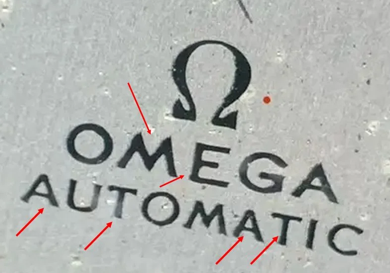

I am skeptical that the dial could be redial. If it is, it's certainly one of the best I've ever seen. Getting those spiral sub-dials right is very rare on non-original dials.
If it were a redial it would also beg the question - why would such a fine artist make a mistake like the one mentioned by @gatorcpa ? I agree with Erich, that it's more likely to be a small, factory misstep.

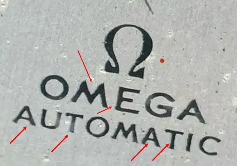

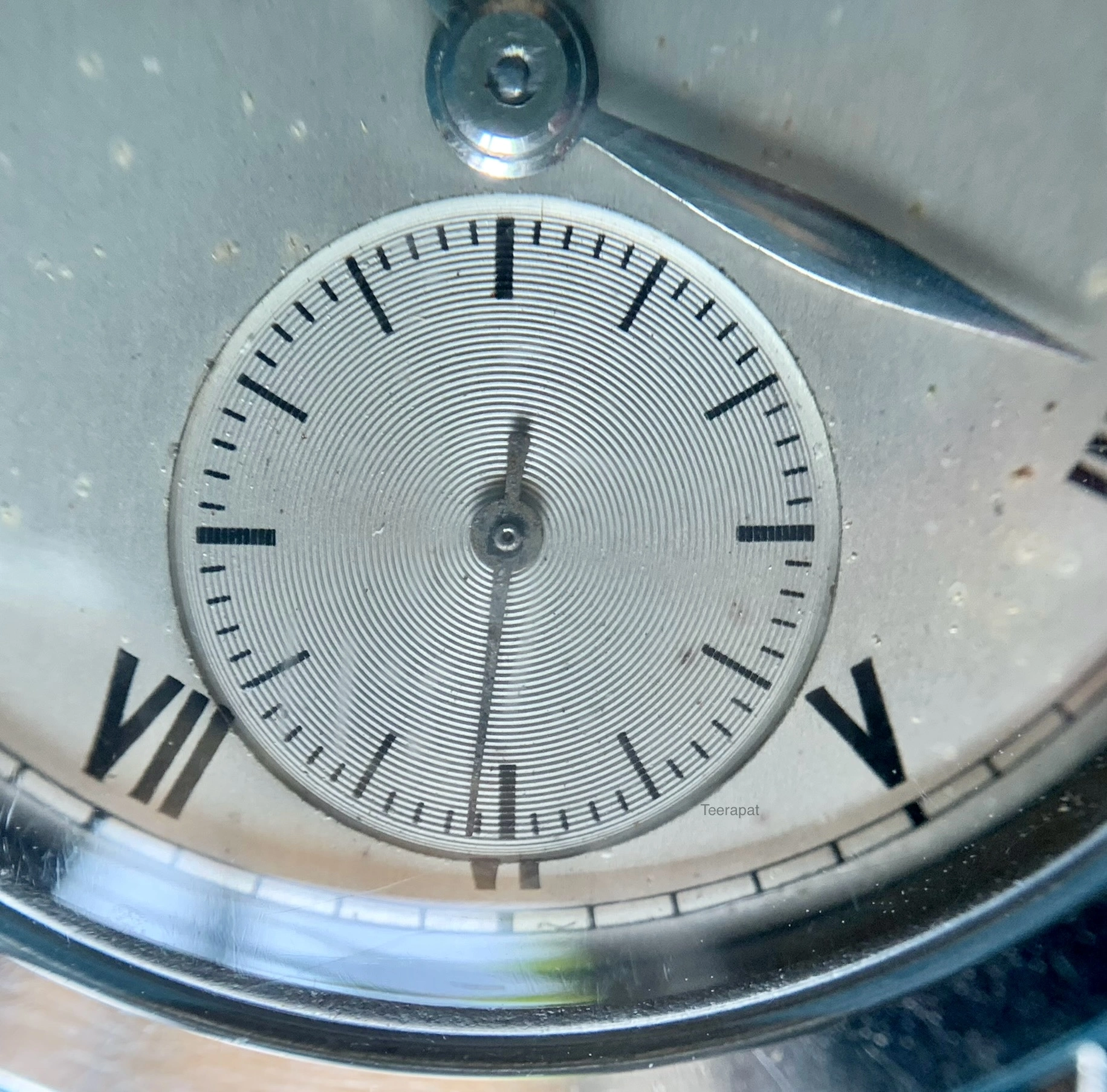

The dial is probably original, however there are several imperfections in the subdial.
All the Omega Automatic font also has some "oddities"
1,024
4,124

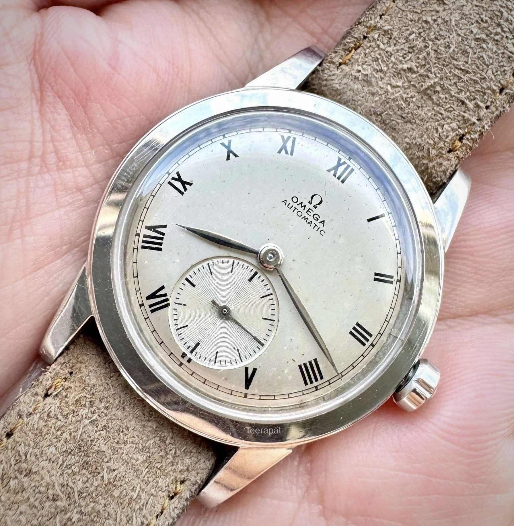

I have added more close-up pictures of the sub-second dial.
Please note that there are grooves between each circular pattern. I wonder how the redialer can paint the minute tracks while maintaining the depth in each groove.
The craftsman is highly skilled.

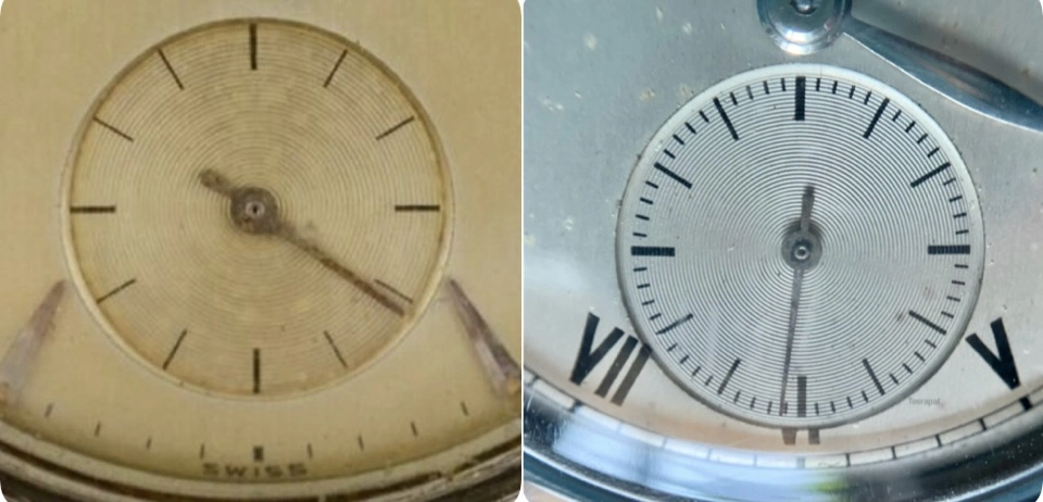

This thread is worth a look. It concentrates on the SC 2577 but there is some crossover. Note the serial table
2,816
6,951

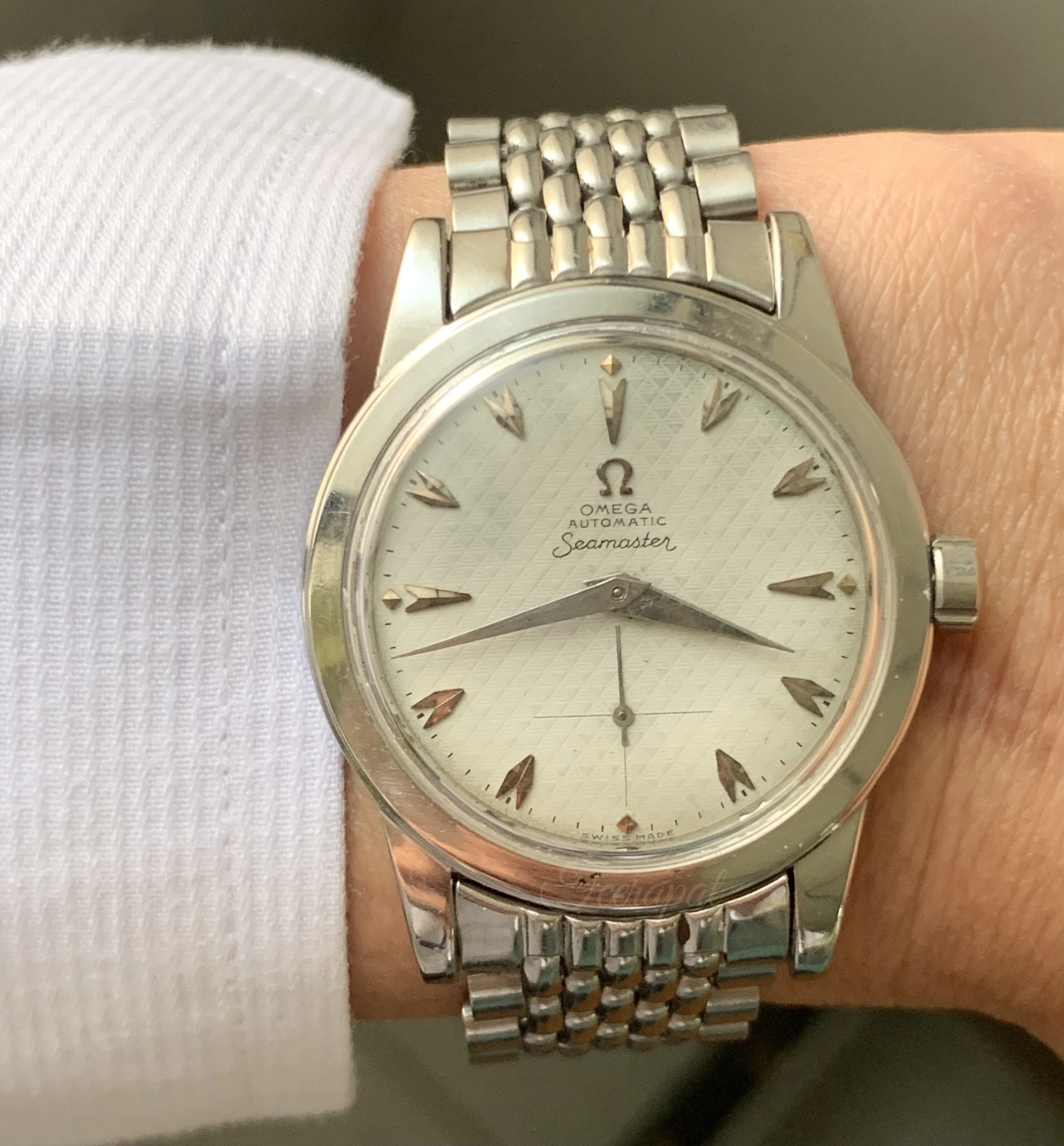

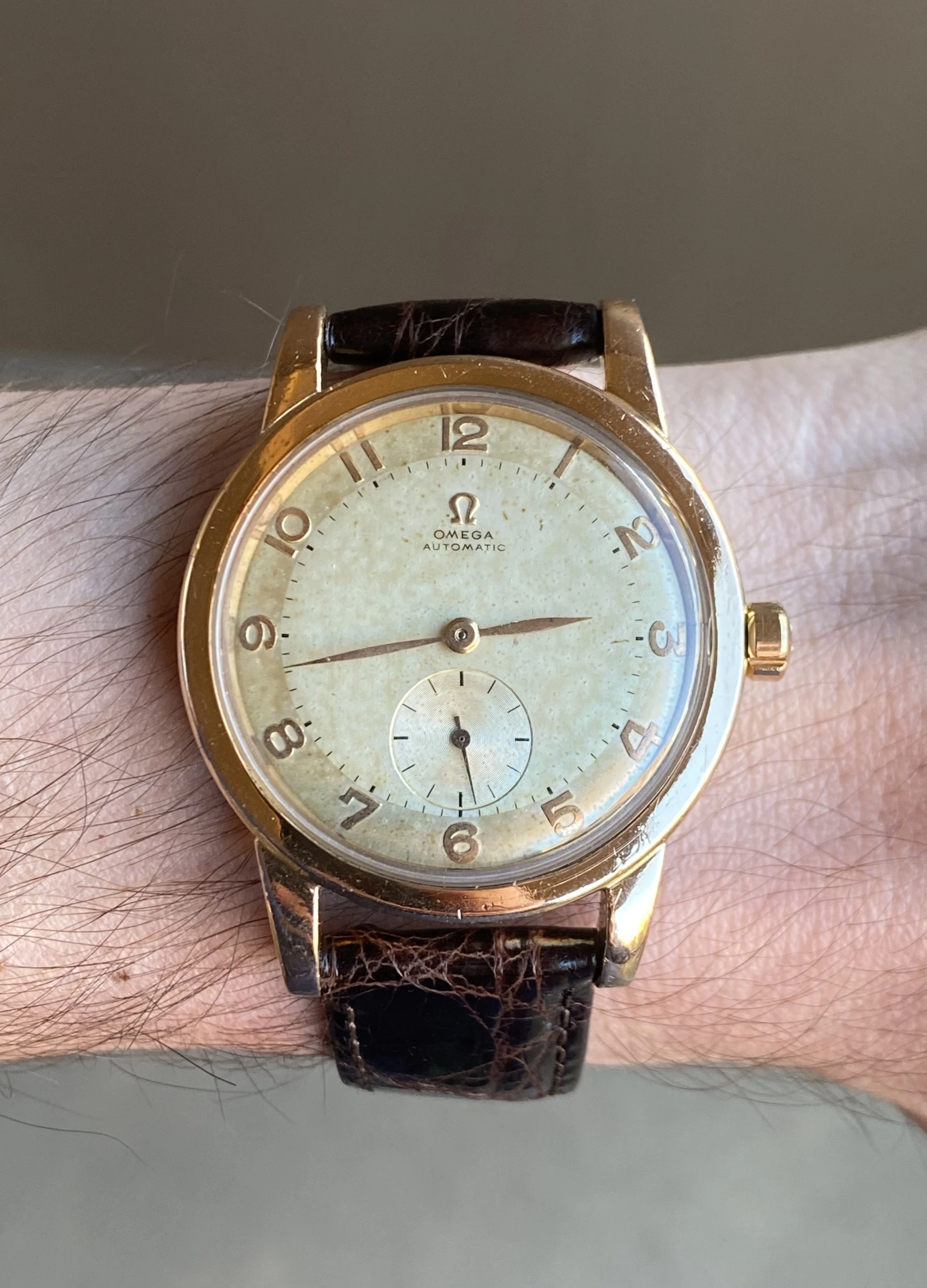

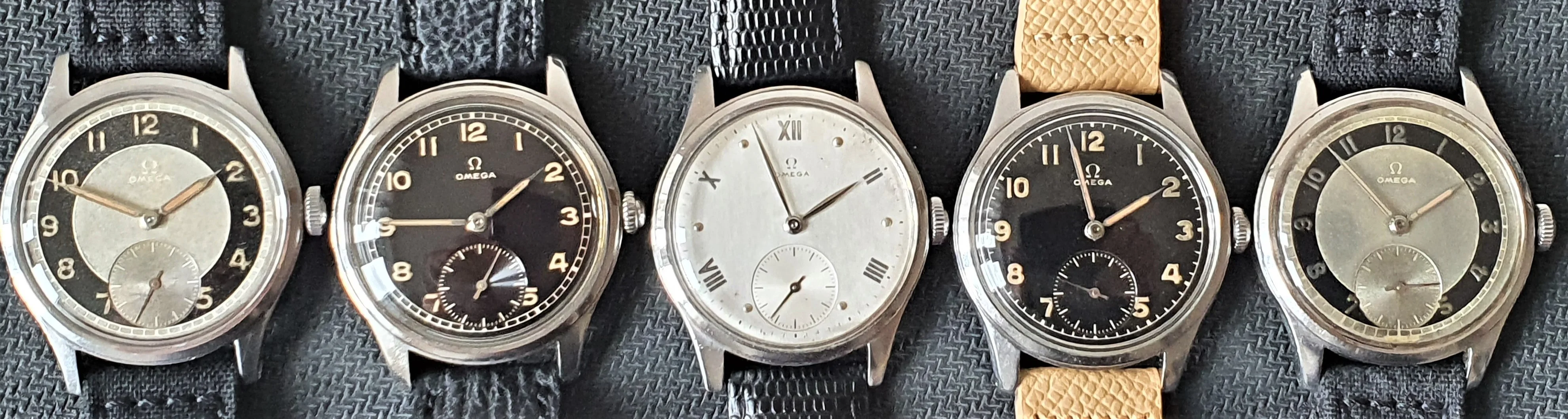

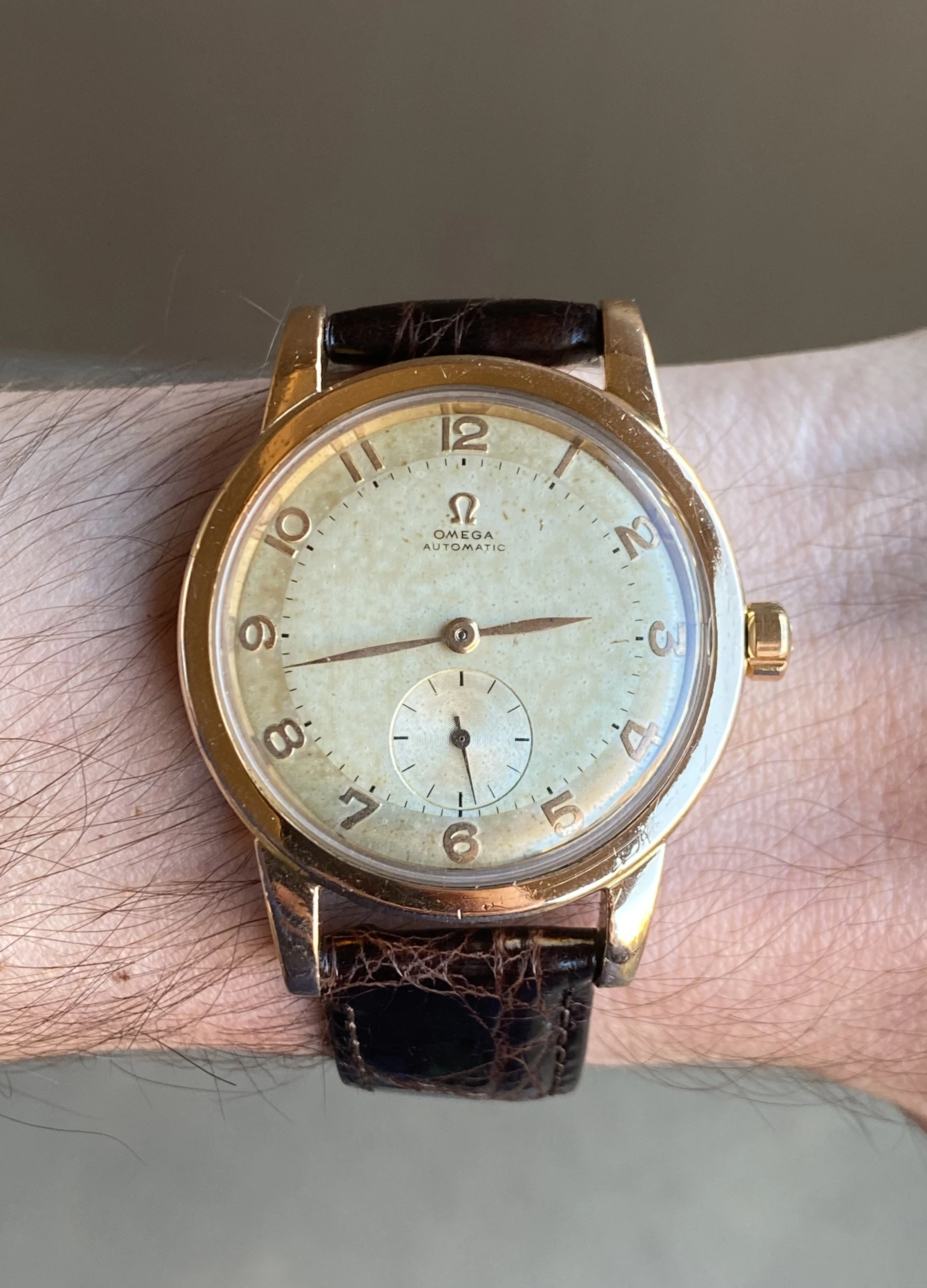

Personally, I’ve never seen this dial style in a 2577/2576, and I don’t think it’s an uncommon style for other ‘40s models, so I see dial swap most likely. Here’s an example from 1943:
https://www.omegaenthusiastltd.com/product-page/1943-vintage-omega-automatic-watch
Regarding the hands, I have seen leaf hands on original bumper Seamasters, however only when paired with dials that feature full applied arabic numerals. I owned this one a while back, it was a jumbo but I believe I’ve also seen them as regular size.

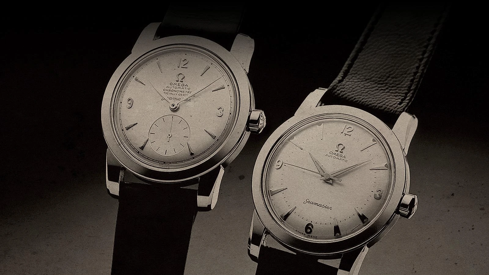

Of course we shouldn’t forget the Omega 1948 promo photo that has a leaf hands model I’ve never seen in real life.

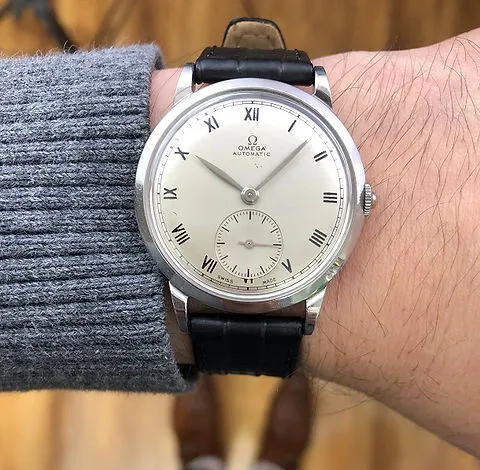

Thank you for sharing the dial pattern, which appears nearly identical to that of my watch, @seekingseaquest . However, the movement used during that period was the Omega caliber 28.10.

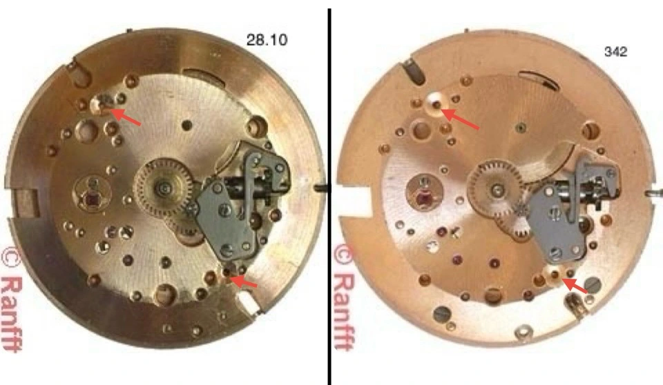

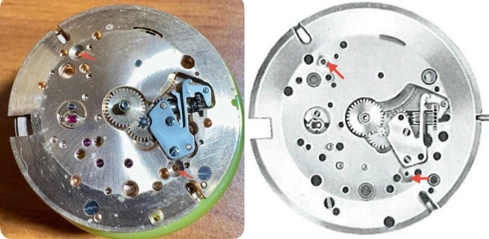

From my research, I am wondering whether caliber 28.10 and caliber 342 are interchangeable. I believe that both movements share the same dimensions (28.5 mm). However, I am uncertain about differences in movement thickness, dial leg position (nearly be the same), and fitment, as well as other potential issues that might obstruct such a modification.
Perhaps @Archer can help clarify whether both the “dial and movement” from an earlier model in the late 1940s can be swapped and inserted into reference 2657.
Or what might be a possible explanation?
Also, If anyone has knowledge of a 1940s reference in which this dial is compatible with caliber 342, I would greatly appreciate your insights.

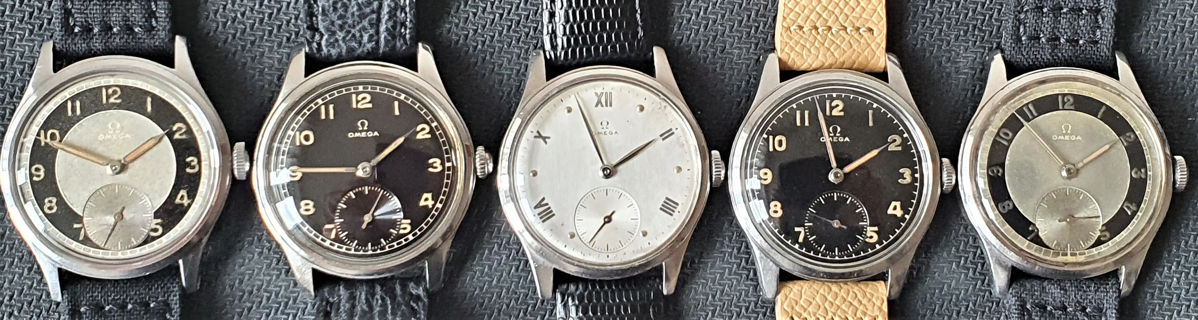

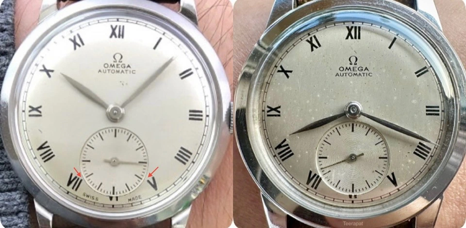

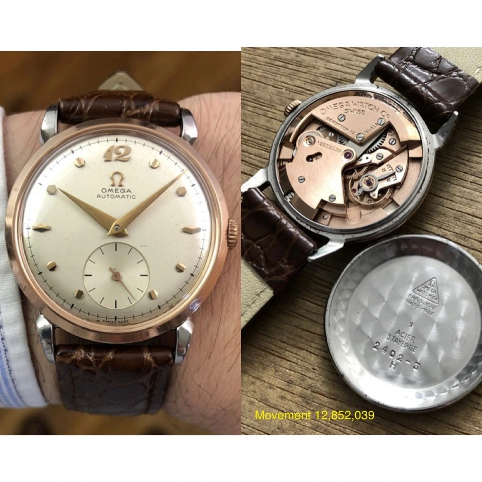

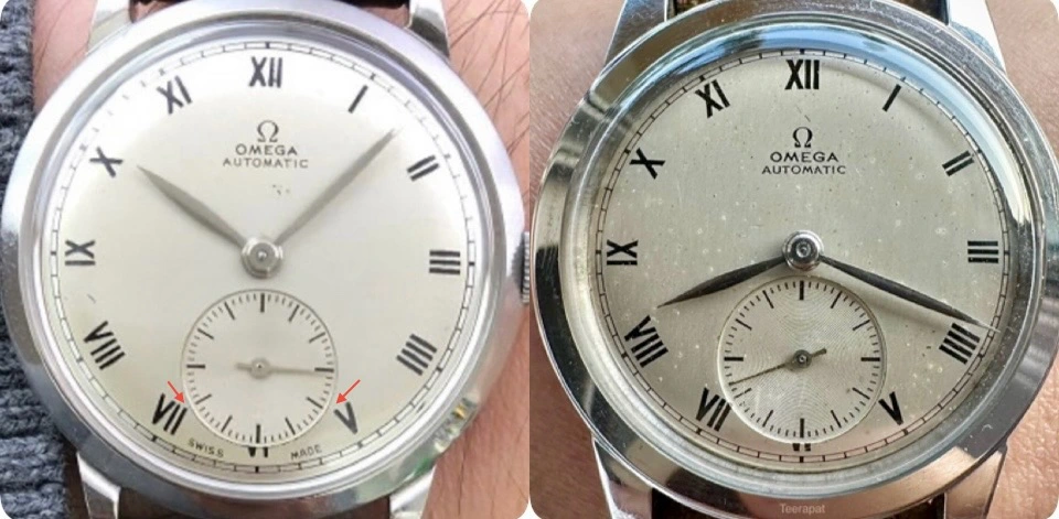

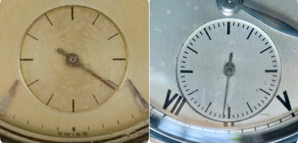

When comparing both examples, I noticed that the printed Omega logo and the thickness of the font are not the same. Additionally, ‘SWISS MADE’ is present on reference 2402.
More importantly, as marked by the red arrows, I noted that the ‘V’ on reference 2402 is not too close to the sub-dial (as it is on mine), so the leg of the second ‘I’ in ‘VII’ does not extend into the sub-dial.
I believe I may know the answer to this, due to the “larger size” of the sub-dial on my watch. By comparing the closer gap between the center of the hands (where the hands originate) and the upper end of the sub-dial.

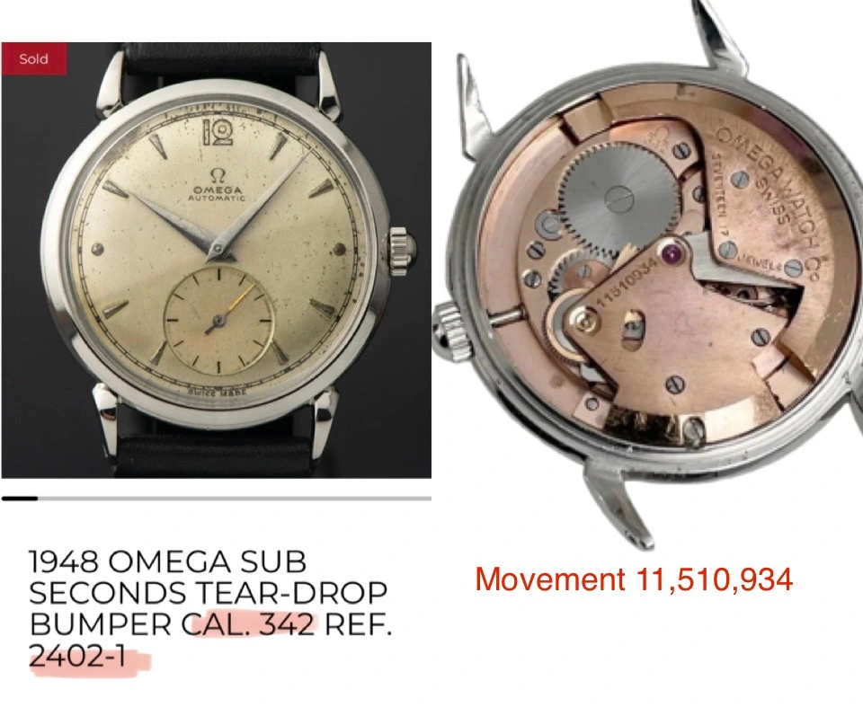

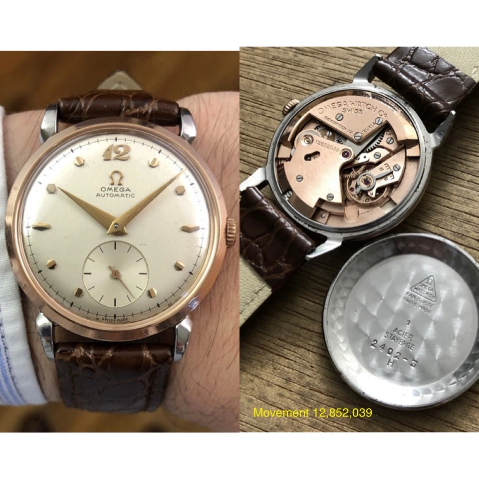

My research indicates that the Omega Reference 2402 with the “printed” Omega logo can be used up to movement number 11,510,934, corresponding to Caliber 342 (rather than Caliber 28.10).
https://watchvintage.co.uk/products/1948-omega-sub-seconds-tear-drop-lugs-bumper-cal-342-ref-2402-1
Furthermore, the movement number for Reference 2402 may be as high as 12,852,039; however, it is important to note that this variant features the “applied” Omega logo.
https://www.omegaenthusiastltd.com/product-page/1951-vintage-omega-watch-1
From my perspective, my watch—an early example of Omega Reference 2576 (specifically 2576-1) with movement number 11,512,xxx and an “applied” Omega logo—is highly likely to be authentic.
My conclusion is based on the fact that its movement number differs by “only approximately 1,500” from that of Reference 2402, which also features an ‘applied’ logo, and aligns with the production period of Reference 2576 in comparison to Reference 2577.
I would greatly appreciate it if you could share your thoughts with me.

If your watch had the dial and hands from that 1951 2402, I’d buy that logic. However, your watch has a dial and hands from a 1943 2402. I still think dial and hand swap for your watch. Your movement is probably original to your case, not the dial/hands.
You can try tracking down the different references that used this dial style and measuring the dial diameter. If those dials would fit in a 2576/2577, then that’s just another sign for dial swap. If none of the other models have the same dial diameter as a 2577/2576, you could have something.

From the attached picture, I believe that these dials were compatible with both caliber 28.10 and caliber 342. Please note the identical positioning of the dial legs on both. Credit for the picture goes to Ranfft.

1. Cal 28,10 and 342 were the same base movement. So dials would likely fit both outside the case.
