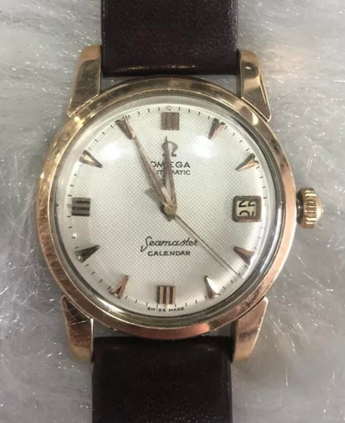

Hi Omega Forum,
i bought a Omega Seamaster Calendar Reference 2849 caliber 503, i want to know more about this particular model i just purchase? Is it all original ? (will attach pictures down below)
So basicly i paid $640 include shipping, i want to know if it worth it too ? And , what is the value of the watch considering is condition.
The case is a Rose Gold and Steel, i dont know if it's plated or capped ?

Unfortunately the dial has been re-painted, so this was not a good deal. Crown is incorrect as well. Value is probably in parts, at least to a collector, so probably a few hundred.

Looks plated to me, and indeed not a good deal at all if you care about originality.

50s SM will be capped, not plated. But most of all: redial :/

If you note. Top is gold colored while back of lugs is s/s. Ergo - gold capped

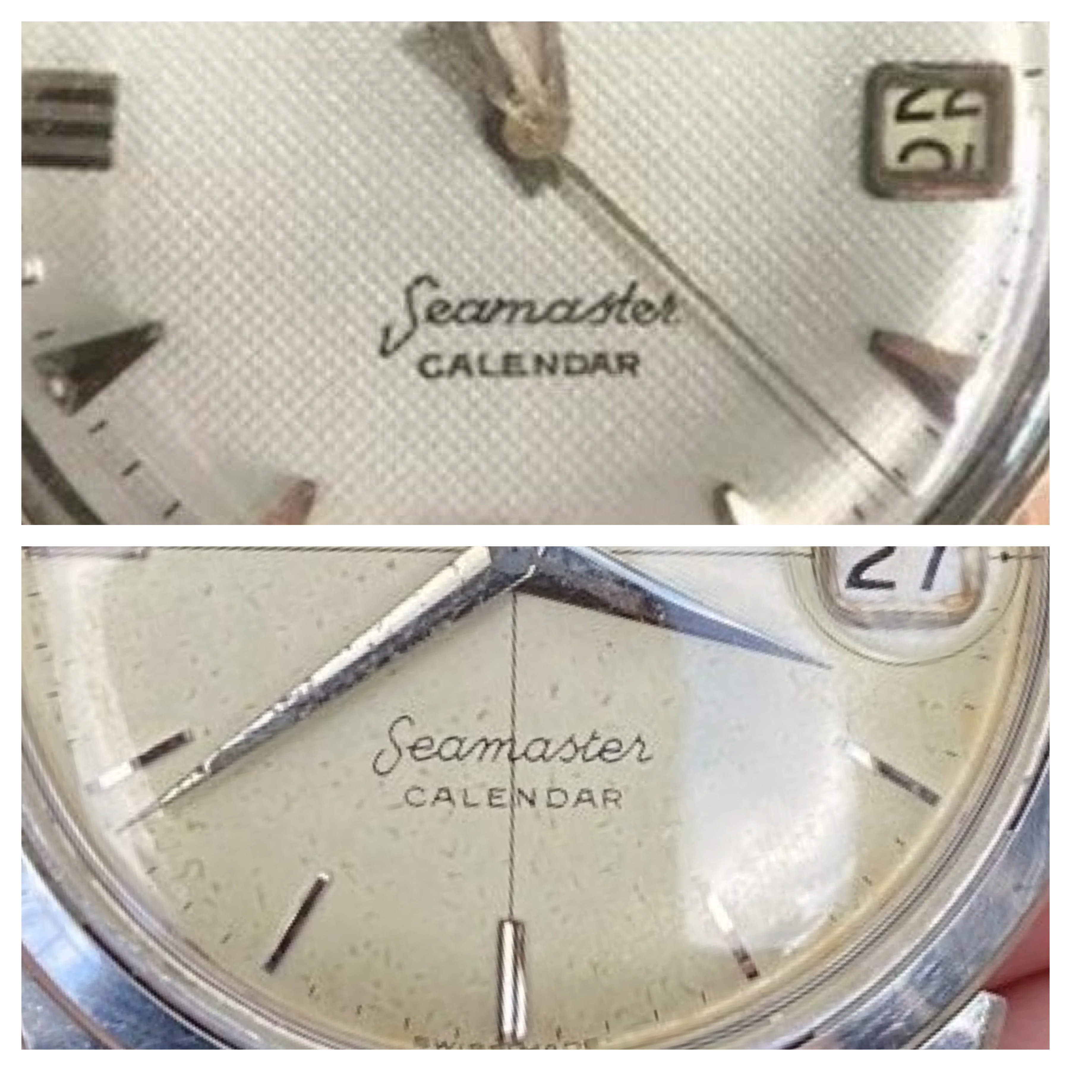

Just by looking at the thickness of the font, for example. It鈥檚 not delicate - it looks like it was drawn with a sharpie.
Compare (I hope @seekingseaquest doesn鈥檛 mind me using his former example):

Compare the fonts, especially "Omega Automatic" and "Swiss Made" to a correct specimen and you will see a lot of differences. Also, the stark white dial is always a bad sign - the clearly redone lume plots too.

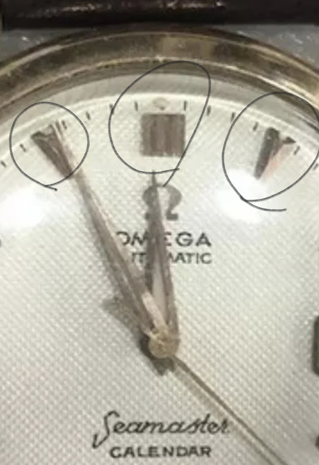

To illustrate another point of the repainted dial, or as we call "redial" of your watch, pay attention to how floppy the minute markers are when they overlap with the hour indices:
If you can send the watch back, do it and tell the seller he is wrong. This is a redial.

Firstly there are several forms of font used on 1950s Seamasters, including rounded and coat hanger S shapes, secondly, you can't treat the Vintage database as gospel. There are dozens (hundreds?) of omissions and in some cases there are photos of redials (though not in the case of the watch you show).
Your watch is a redial. Not a bad one but not one that will appeal to collectors with experience.

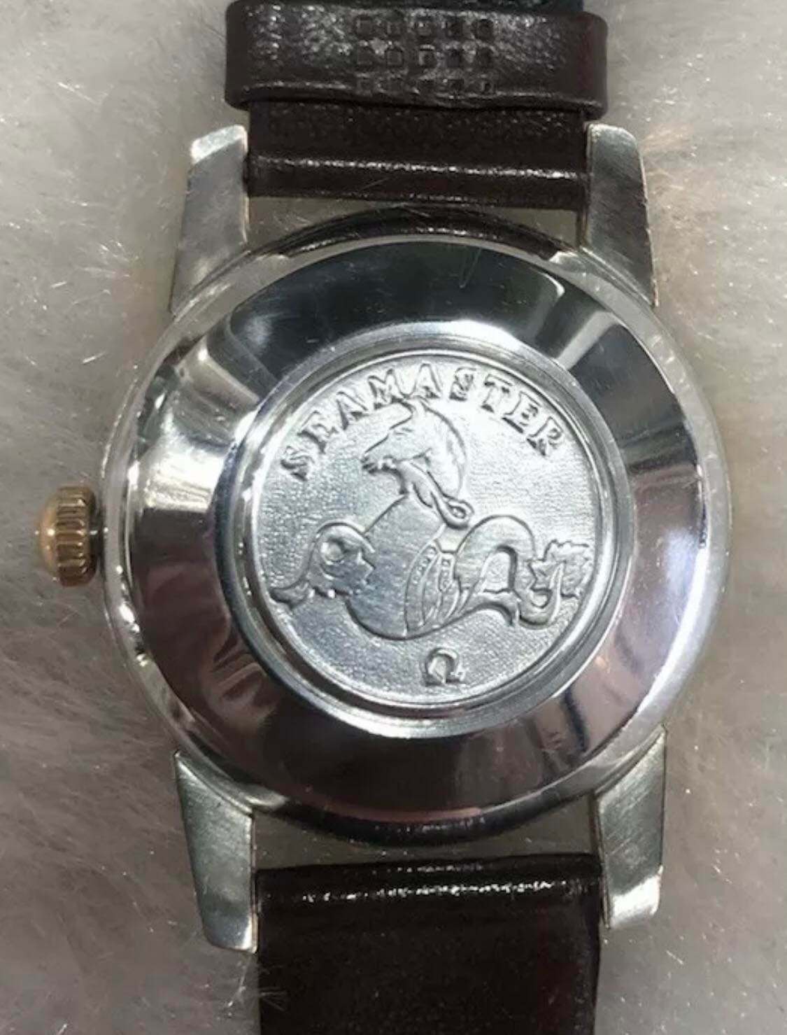

Oh and I really don't like that medallion, it is very rough cast compared to what I would expect and I wonder if it has either seen a lot of wear or may even be a fake. Probably just a lot of wear.

The "Seamaster" and "Calendar" inscriptions aren't even aligned. I would send that back into the seller's face with a slingshot.
EDIT cross post with above, most of which says what I do!
I was having the same feeling about that medallion.. how can it get to look like this?

I have an absolutely original 50s dial where the "Seamaster" was overprinted and crooked. It can happen. They didn't apparently inspect as closely as they do today or have the precision we can get today.
