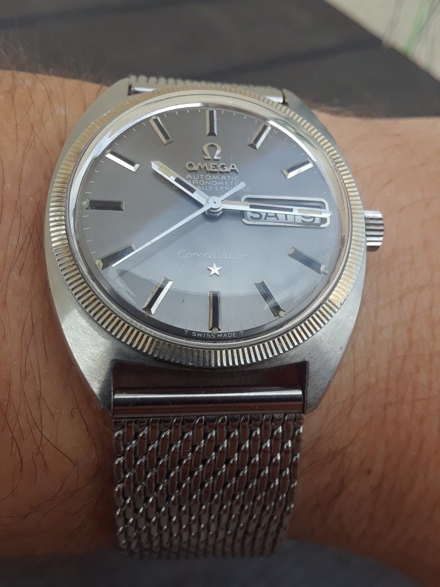

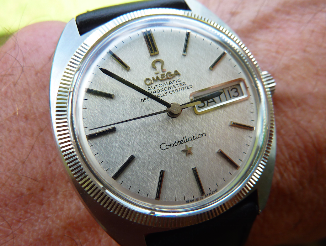

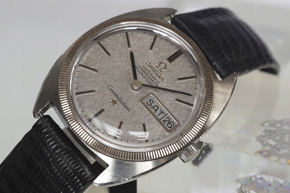

What do you think about this Constellation cal 751?
*Disclaimer: I'm a complete newbie at this, so take my words with many grains of salt*
It appears that this watch is missing a seconds hand and that these hands don't look original, based on the examples that I've seen in the past.
18,840
39,182
You mean this seconds hand?
Hour and minute hands look OK to me. Just plain silver probably looking off due to lighting angles/reflection.
Yeah, that's the one! ... Clearly it's too late for my tired eyes 馃槦
Sorry, now I'm extra confused. Comparing OP's photo to two other C-case Connies, shouldn't the seconds hand be more tapered and extend past the centre point?

It probably would if the OPs picture had been taken in better light and a higher shutter speed.
The seconds hand has "vanished" due to a slow shutter speed.
Ahh makes sense!

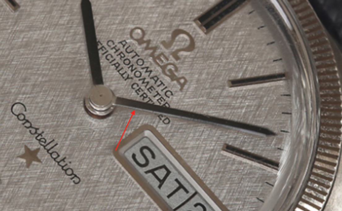

So this was actually pointing to the minutes hand then?
18,840
39,182
Ahh makes sense!
No, it's pointing to the seconds hand just coming past the minute hand.
If you look at the centre you can quite clearly see the centre boss and pipe of the seconds hand.

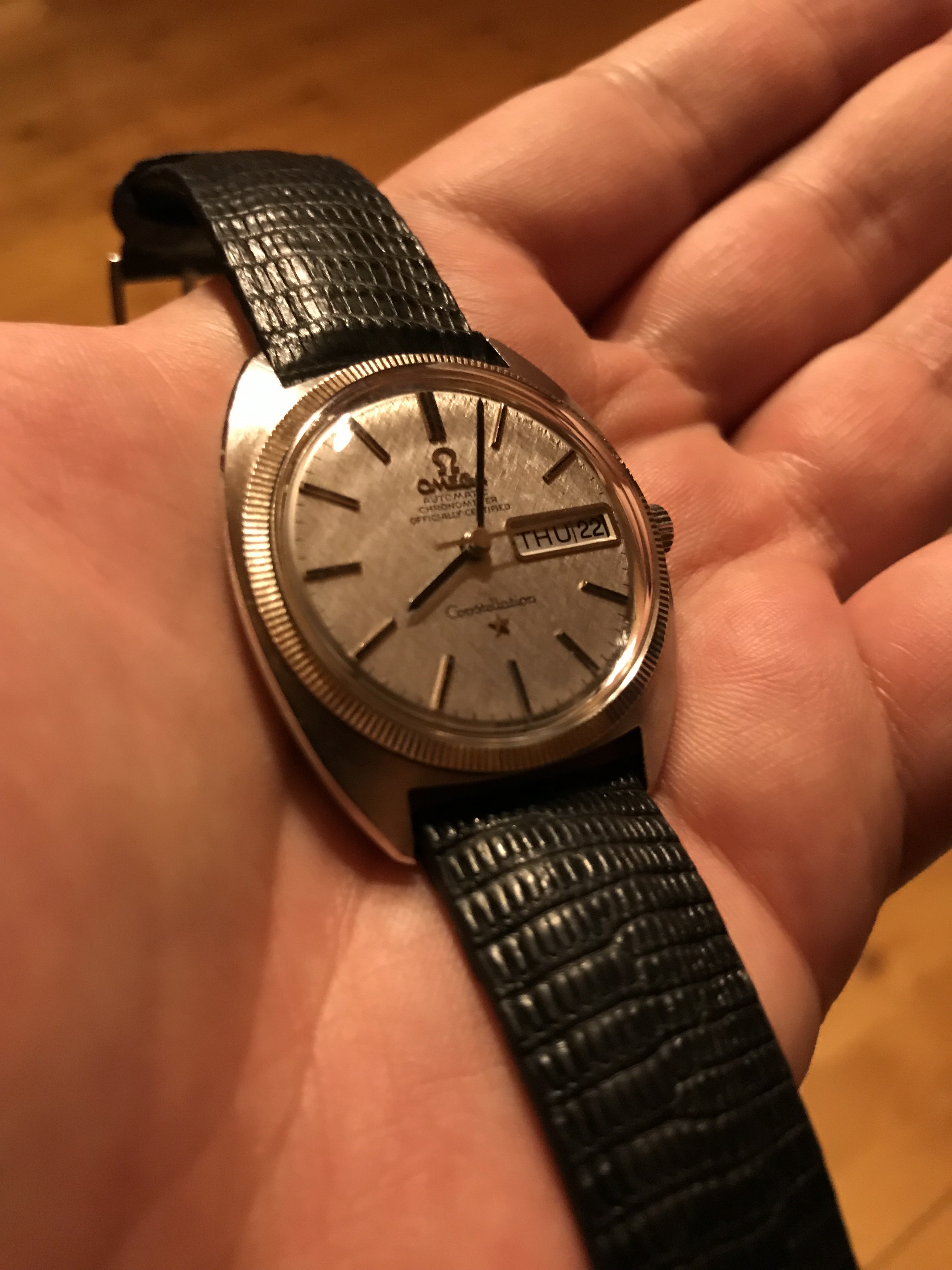

Thanks guys. It has arrived today and the second's hand is there 馃槈 Quality of the photos not so great - they cannot reflect reality 馃槈
The sound of the caliber 751 is hypnotizing ...
I should have access to some better camera tomorrow 馃榿
