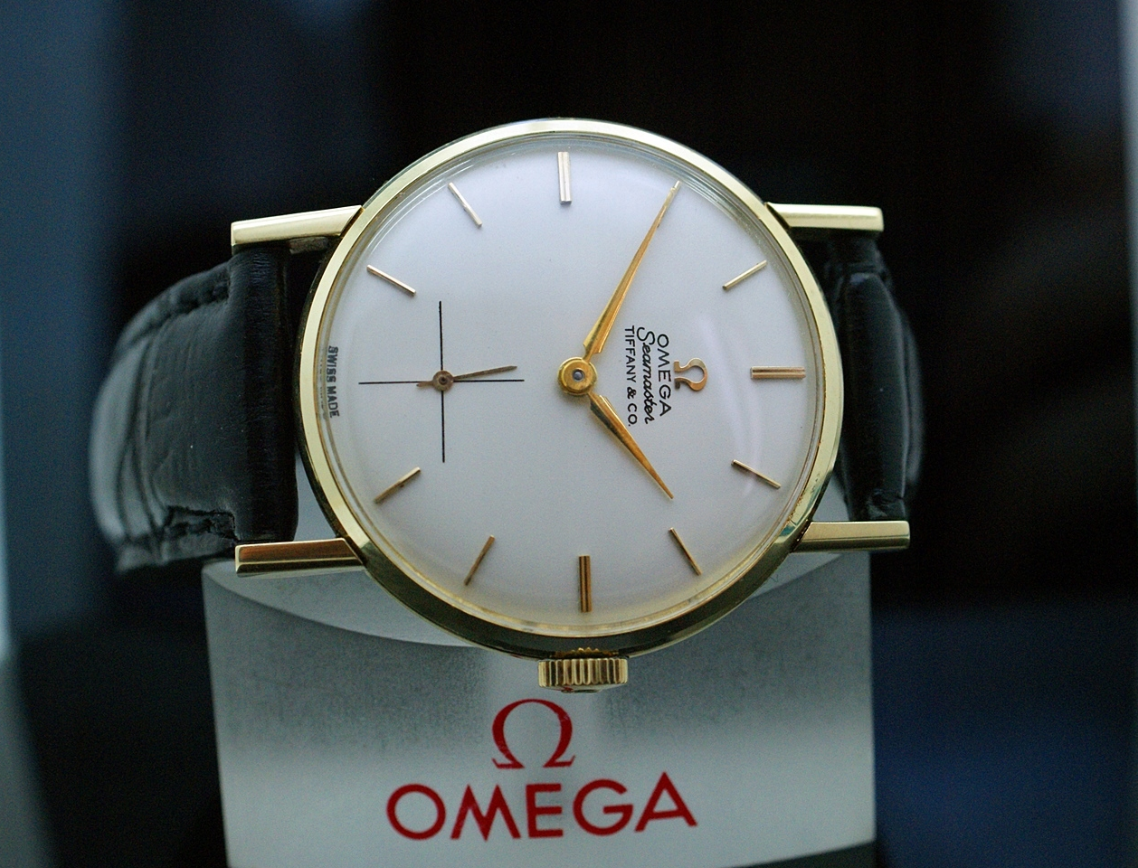

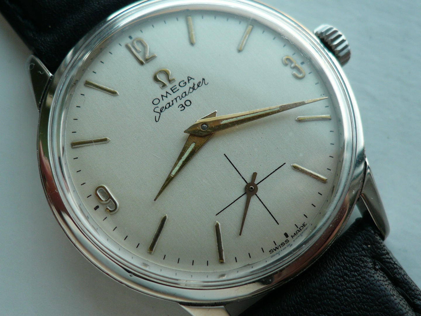

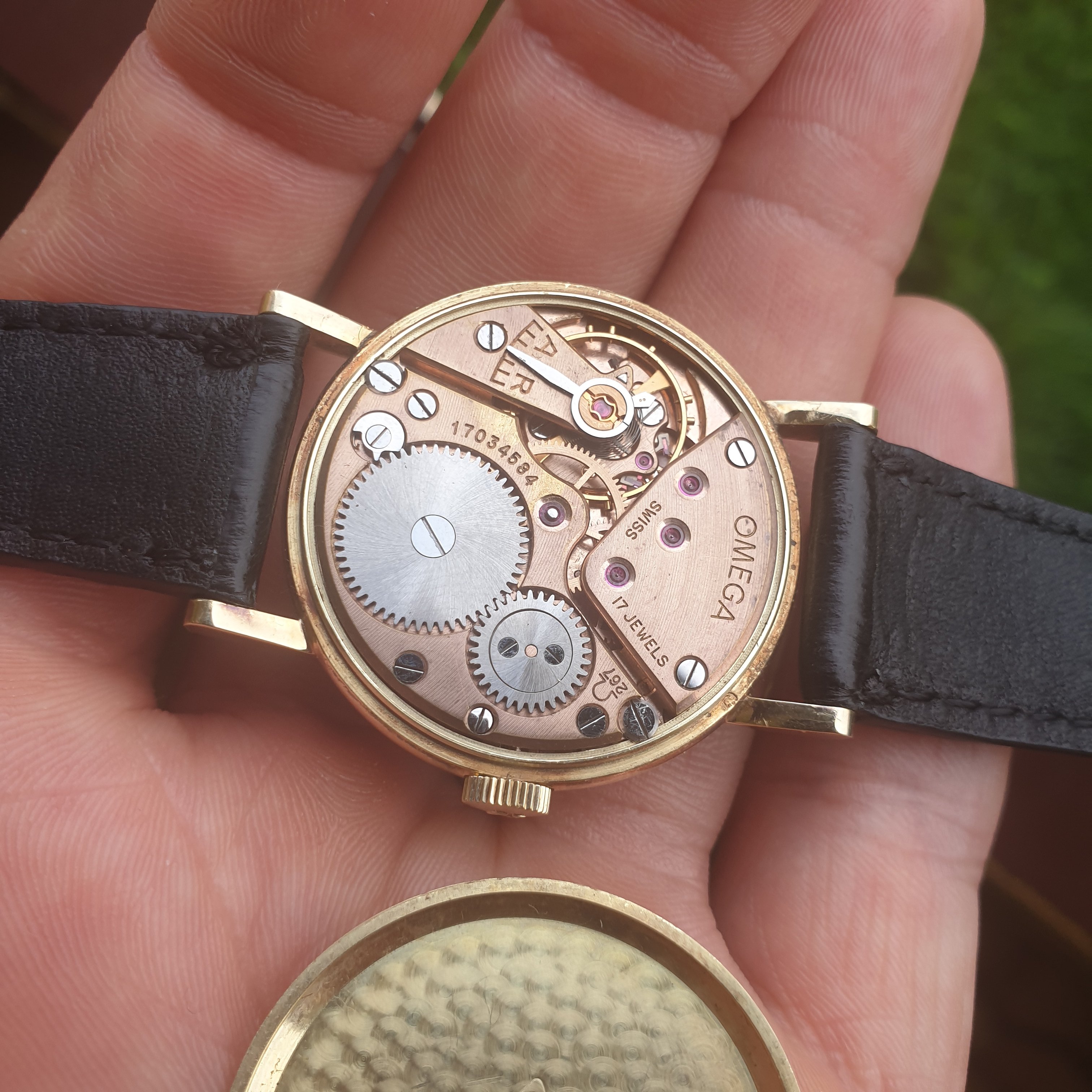

Dear All,
Can you please have a look at this watch and tell me if it does look like legitimate cal 267 Omega Seamaster to you?
SWISS MADE does look like a little bit off to me.
Happy to share more pictures if needed.
Thanks,
Z
414
609
It’s really a bad picture - it’s not very clear. But both the text and Omega logo looks a little off. I think the dial is a re-dial.

Thanks for instant reply - some more pictures below.
5,537
9,475
Surprised the redialer did not add Turler and Anti-Magnetic while they were in there 😁
536
5,368
Why to stop there - additional proposals "Constelation", "DeWill" and "Hronometer" 😉
Apart of the redial, if I like it and will not be planning to sell it any time soon, anything specific to look at regarding cal 267?
I cannot find to much detailed information apart of it seems like it is 50-60 caliber any idea if it will be serviceable in the near future?
If I will buy it I intend to wear it 😁
5,537
9,475

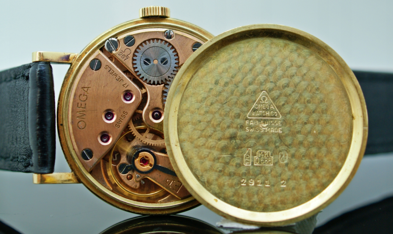

It's a reference number 2911. You might want to Google that, or go to Omega's web site and see if they have info in the vintage database.
The seller is being economical with his photos, possibly blocking a large part of the movement on purpose.
536
5,368
Thank you very much for instant replies and word of advice - will not be buying this piece. 👍
5,537
9,475
Looks like a horrible redial! There are even a couple blobs of ink in the text.
536
5,368
Looks like a bad redial, well chosen pictures to trick a buyer. Run!🤮

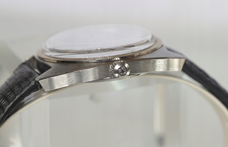

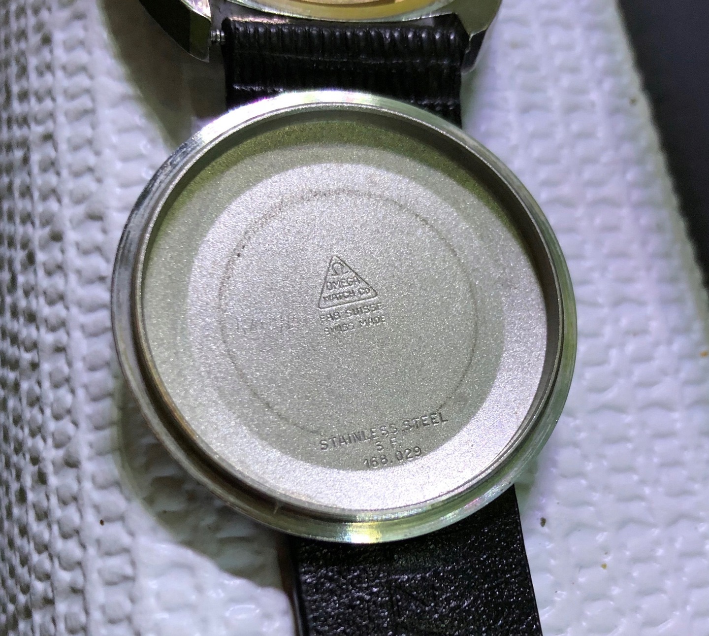

What about this one? Stainless cal 269. Redialed as well...
24,836
55,256
It seems that you are choosing re-dialed watches with over-polished cases deliberately, perhaps because you really want a new watch, not a vintage one. You are also concerned about whether a vintage watch can be serviced. I think that you might want to seriously consider a new watch with a vintage style.

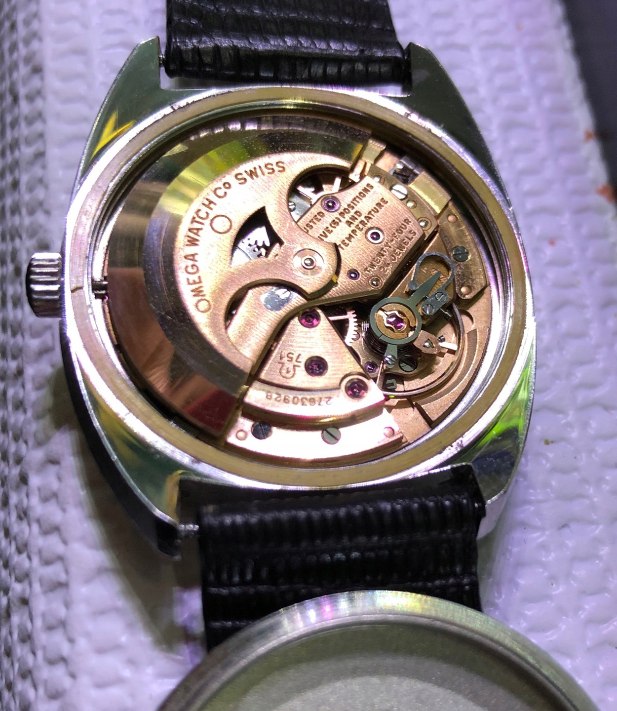

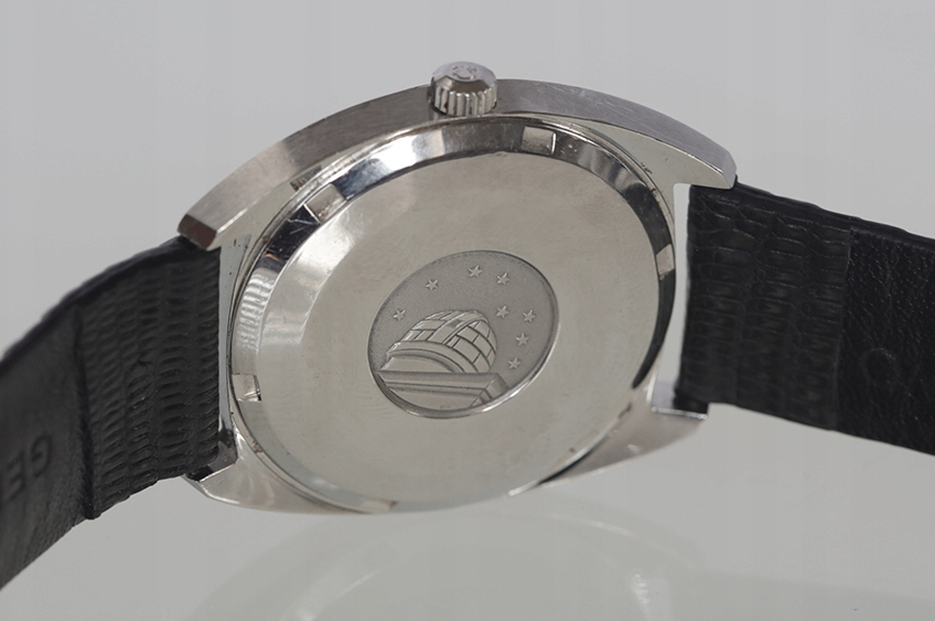

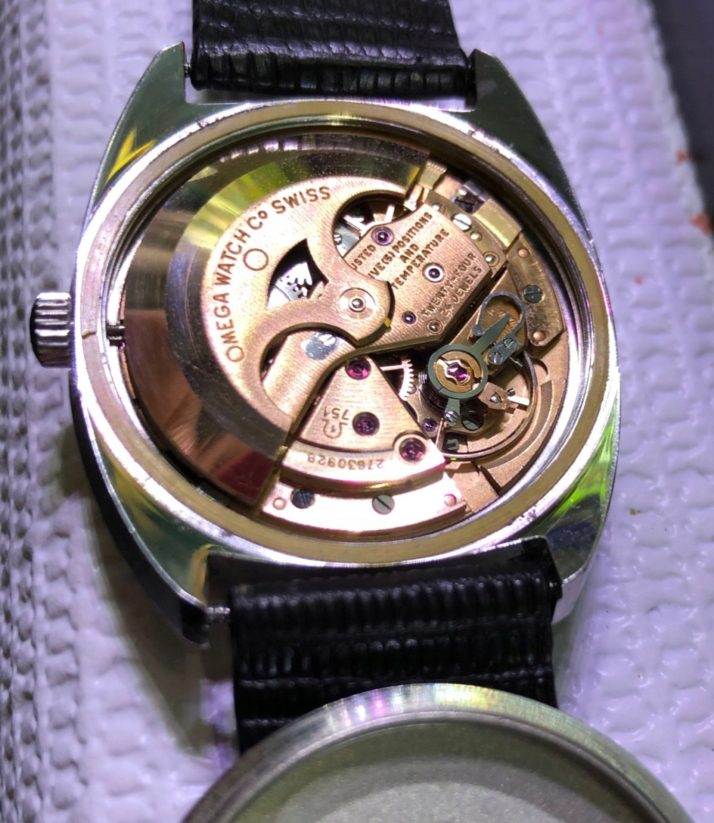

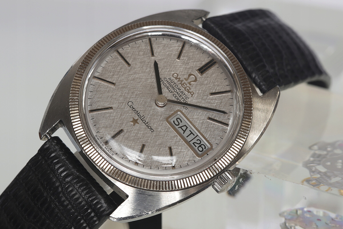

What do you think about this Constellation cal 751?
13,493
31,814
Thanks Dan. I think you are right, but I really hope I will be able to find the right mixture of both with a soul...
Based on that single photo all looks well, appears to be a nice honest original watch.
5,537
9,475
That looks like a beauty. Just take note of the rotor rubbing on the caseback -- unless it has already been serviced to correct that issue you will need to get is serviced ASAP.
