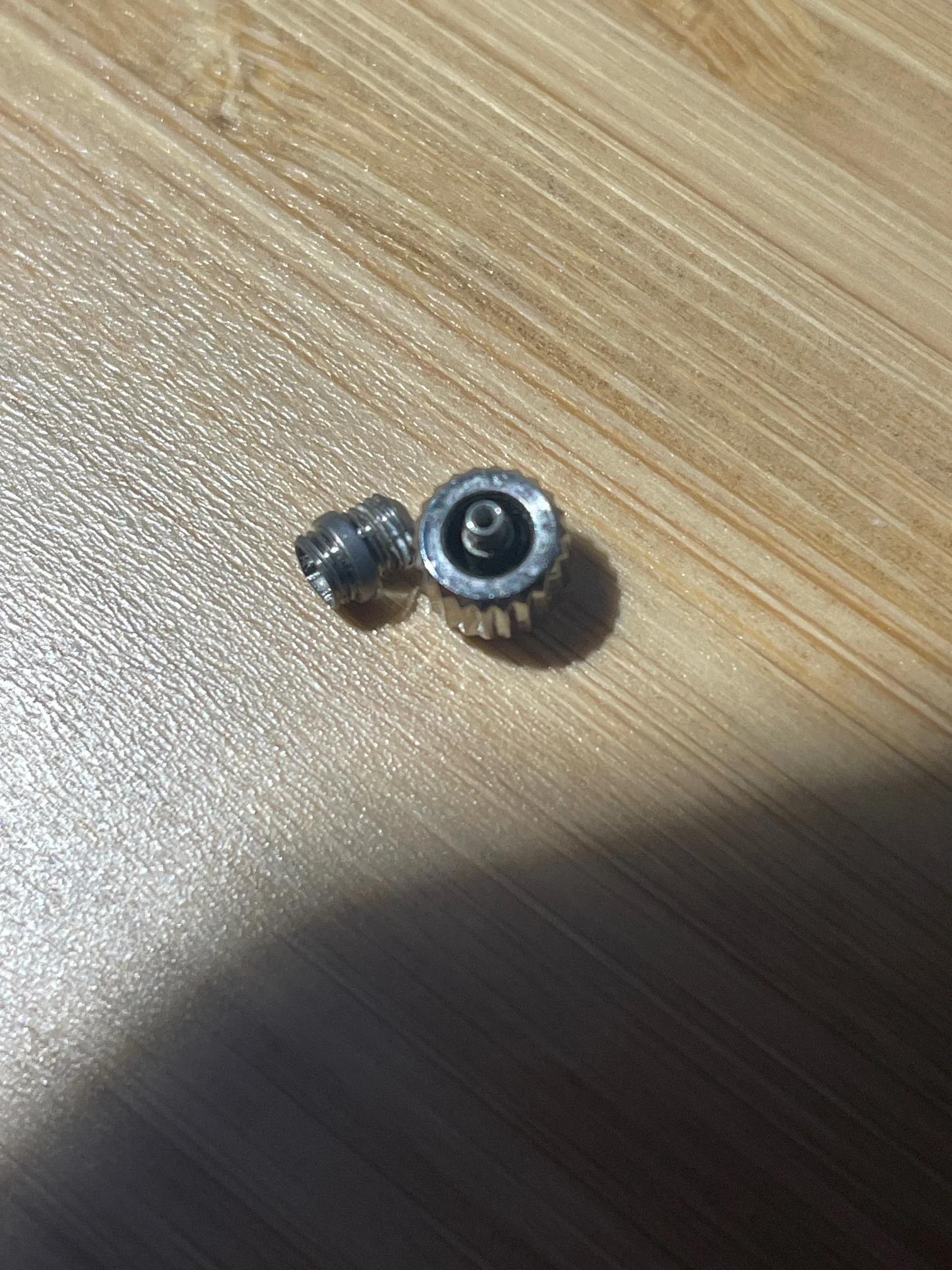

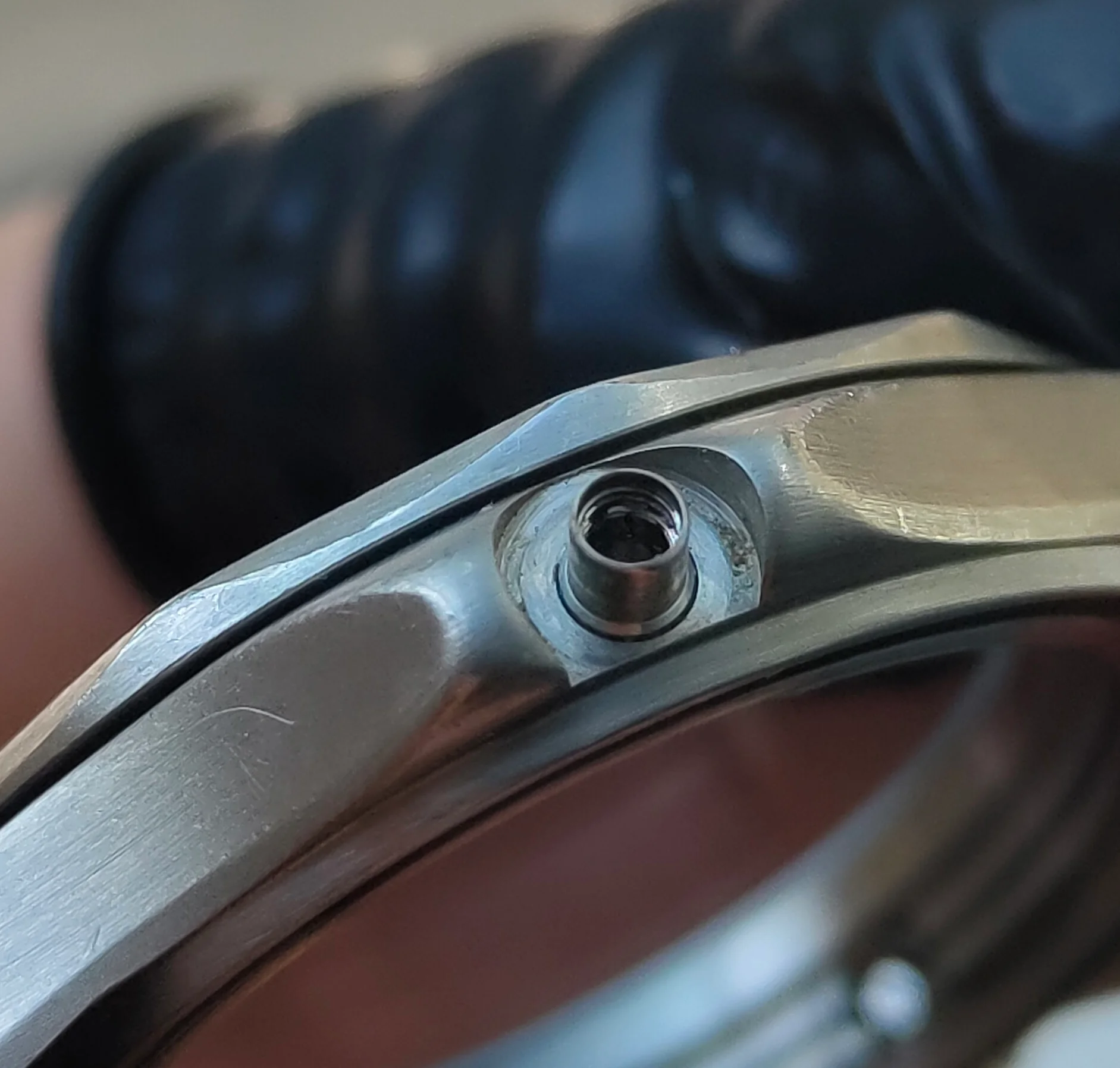

I had just received my watch back (Ref 2551.80) from Omega's service and noticed that the crown tube does not have external threads on them.
The crown still screws in though so I'm assuming the threads are on the inside of the tube. However, when digging out the old crown tube from the bag of parts, I noticed that it was threaded. Is it standard practice to replace a threaded tube with what I presume looks like a press fitted one?
Would love some education! Thank you
30,187
77,937
The tube you show in the second photo is not the case tube for the crown. It is the tube for the HEV.
The case tube for the crown always had internal threads…

Thank you Archer for the knowledge! I guess I havent noticed that before

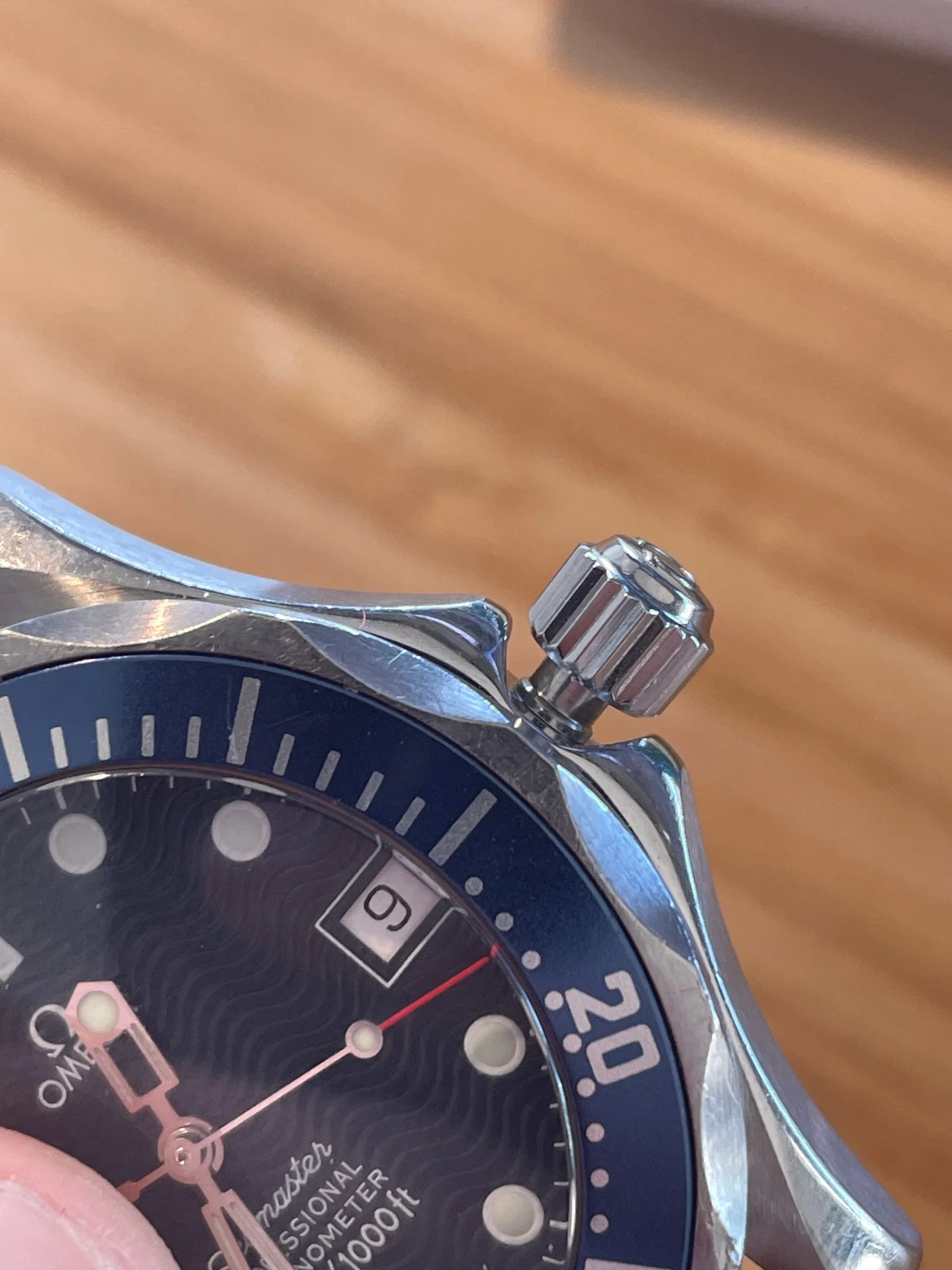

Hey guys, I'm trying to work this out with my titanium 2231.50 and what crown tube I need to find to replace it but there seems to be mixed information online. I can't work out wether the crown tube is pressed or threaded on this watch. Is there any way you could shed some light on this?

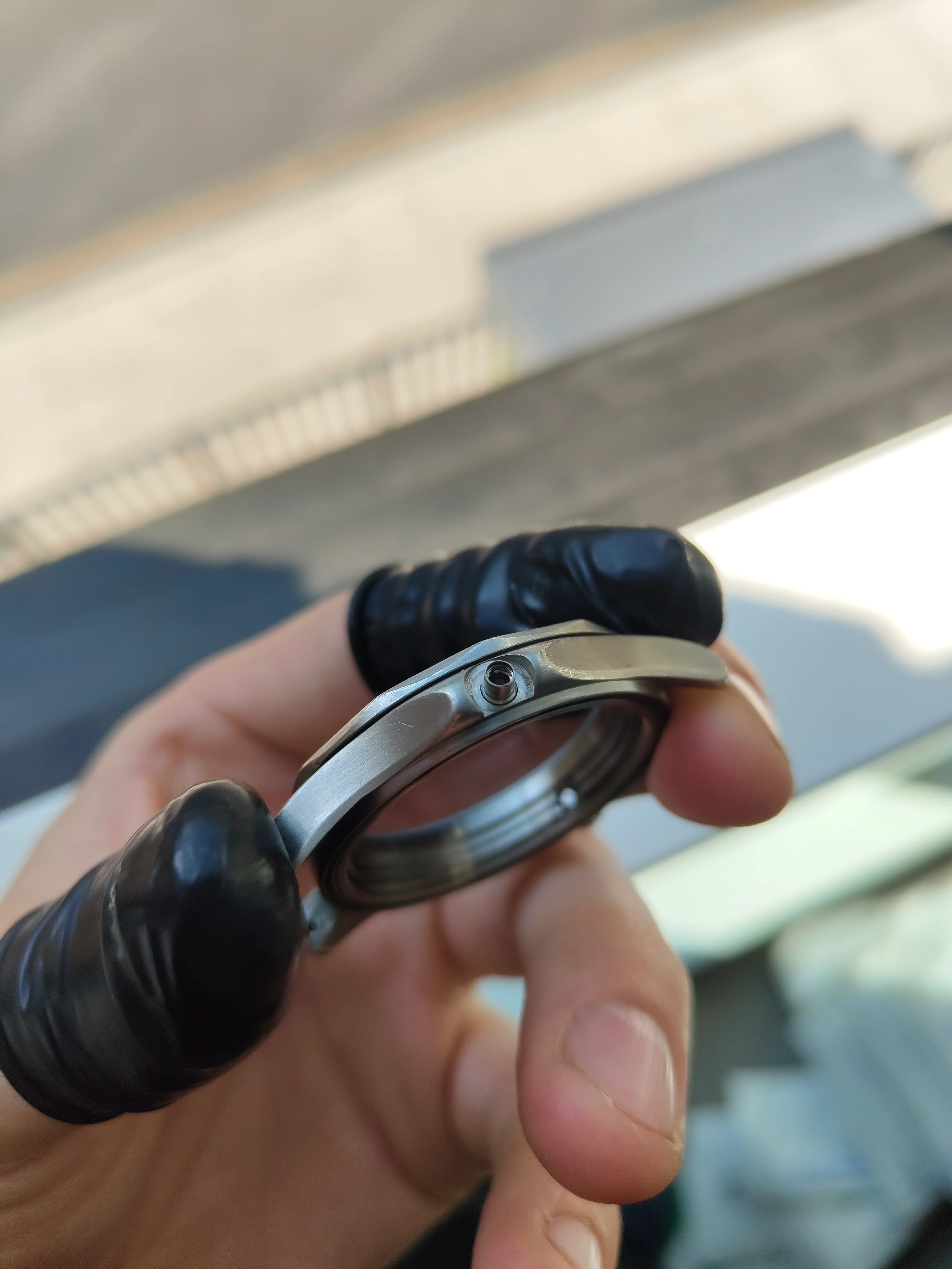

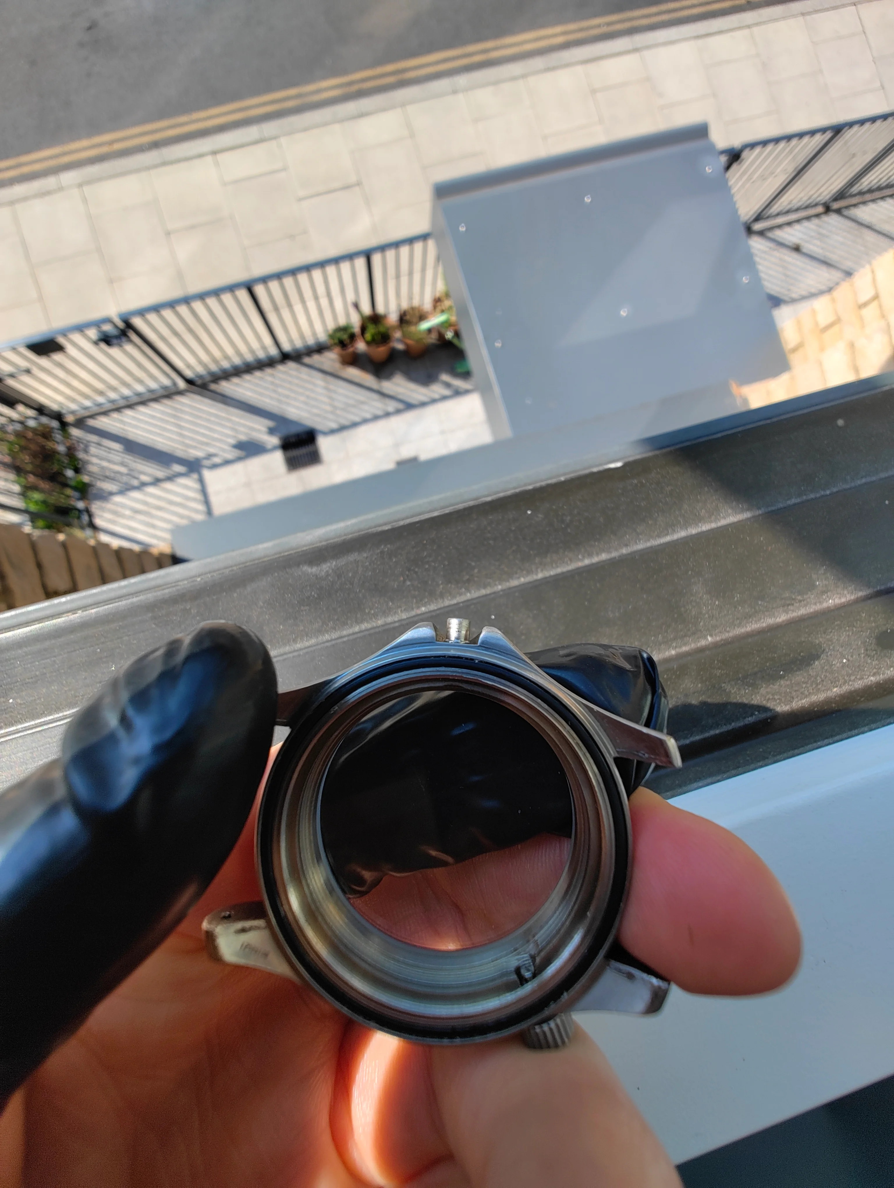

Hey! I've finally been inside the watch and had a look. To me it's not so clear that it's threaded or a push fit. I took some pics, what's your opinion? Apologies, they aren't so clear
30,187
77,937
Need a view of the tube from inside the case...

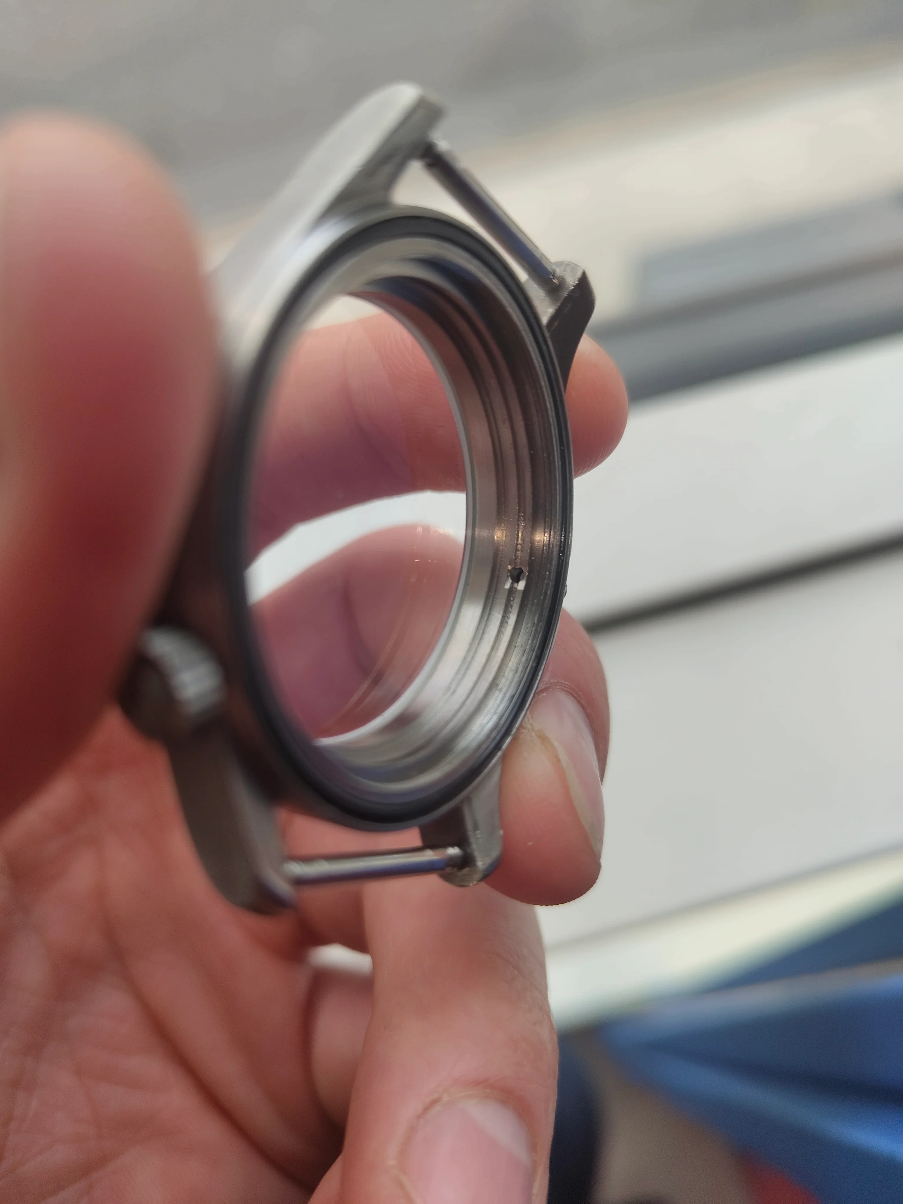

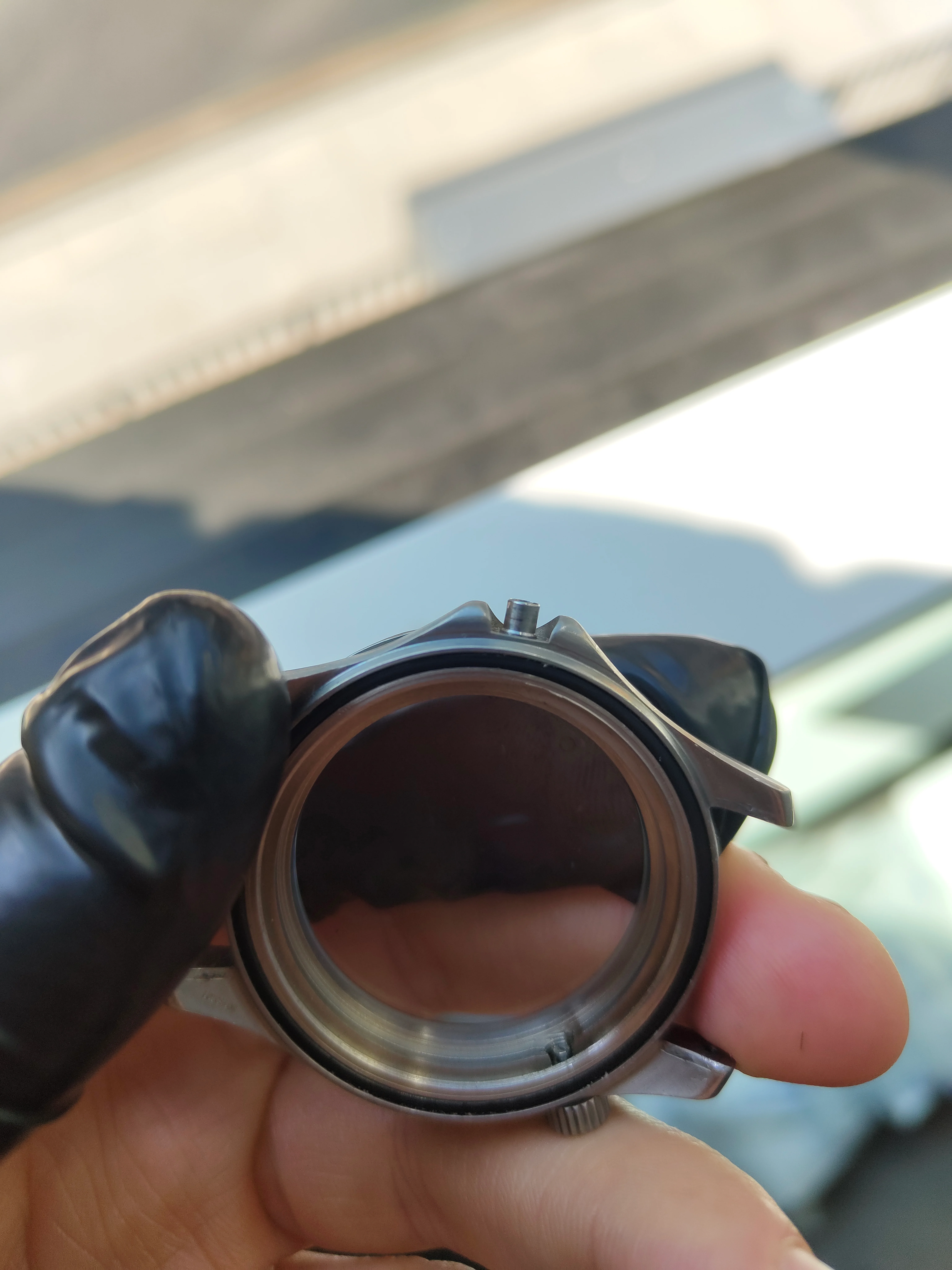

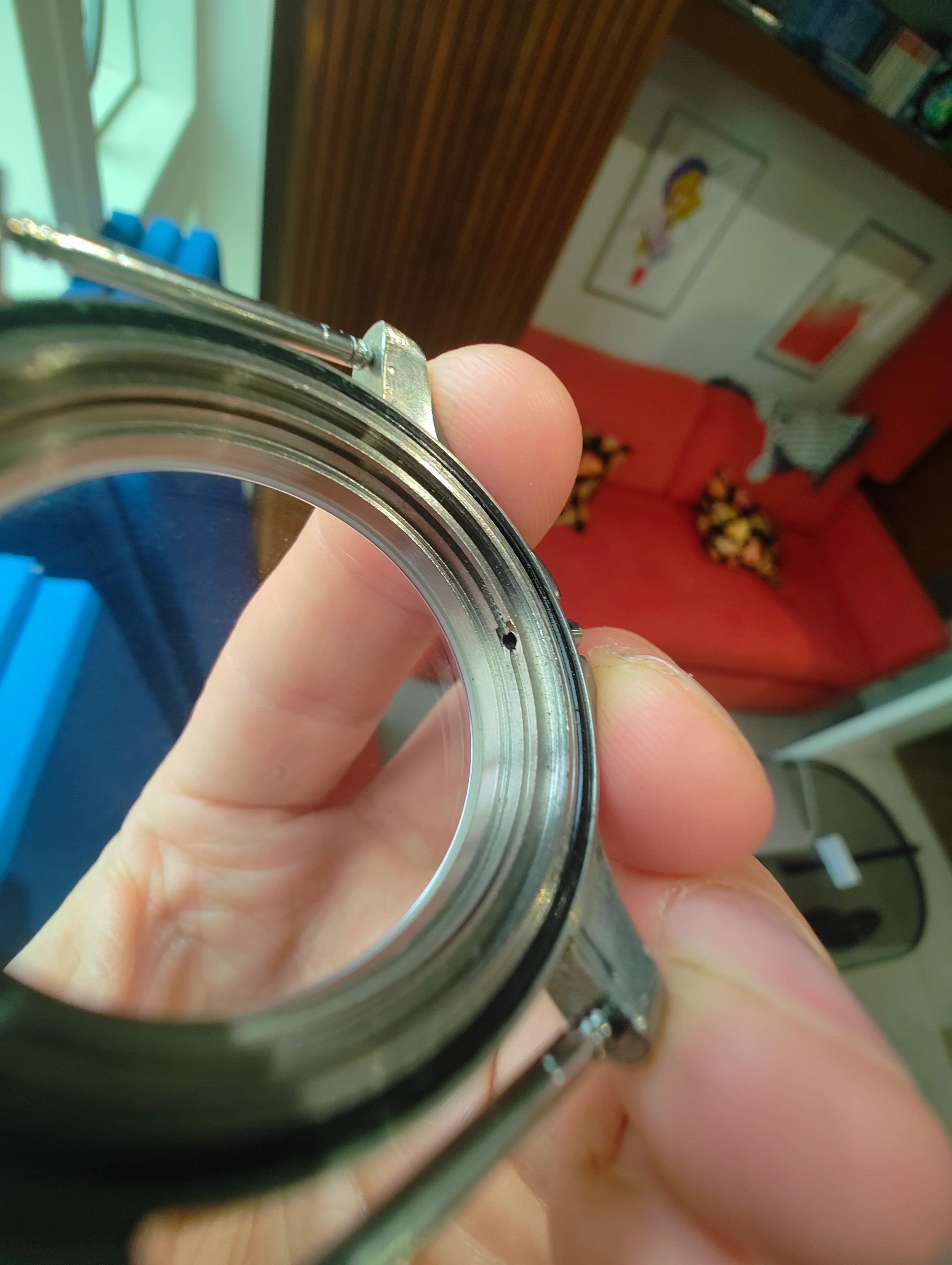

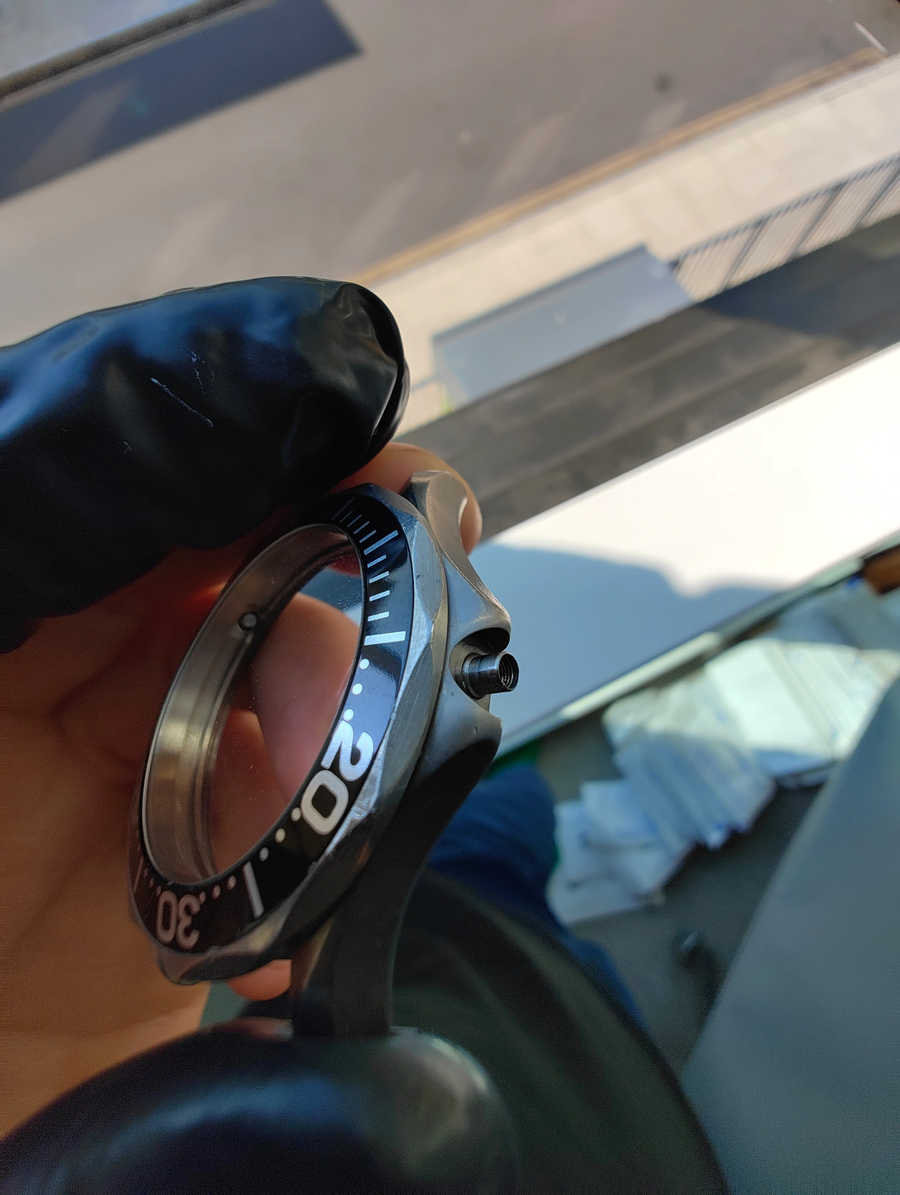

Ok, a month later I'm back! Life's been getting in the way of my hobbies 😀 Here's some pics of the inside of the case. It's really hard for me to work out if it's threaded or push fit but i'm sure you'll know. I also have a 2255.80 with a very good condition tube and crown on it so I was able to do a swap of the crowns between both watches and have sadly concluded that the titanium 2231.50's crown and tube both need replacing. It's a bummer as the titanium crowns are rare and expensive. However, I believe the tubes are cheap and plentiful, right?
Thanks for the help!
18,746
38,895
Based on the second photo I'd say the tube is a press fit.
Thanks so much! yes i'd agree. I'm going to get the part and try the repair. I've changed tubes in rolexes before but never on a seamaster.

Yes, it's definitely a press fitted version, and these can be very problematic to remove. This is nothing like removing a Rolex case tube.
Please look at this thread:
Pliers are not a good idea. As the thread shows, you will need to apply heat so it's pretty standard practice to remove the crystal and crystal seal - you could leave it but the heat may damage the seal and possibly the crystal. You need to heat the case very well, then use the easy out style tool to remove it. Even doing that, you risk having the tube snap off inside the case, so be prepared for that to happen.

The push fit case tube for the titanium 2231.50. The case I sent photos of the inside case tube. You said it's defiantley a push fit. Just double checking it's a push and not a screw? the tubes aren't too expensive but the titanium crown is a different story sigh

090ST1232 - this is a threaded tube but your watch appears to have a press fitted tube, so something is odd here.
Normally with a threaded tube, there is a through hole and threads all the way through the case, not the sort of partially blind hole you have on your case, so not sure what to tell you. Maybe they do things differently with the Ti cases? You will only know for sure when you get the old tube removed.

Okay this is very curious indeed! I read your very good instructional about tube removal and saw a hex shape on the inside of an omega tube you had. Is it possible mine has that if I remove and check? Sureley that will tell us if it's threaded or not?
