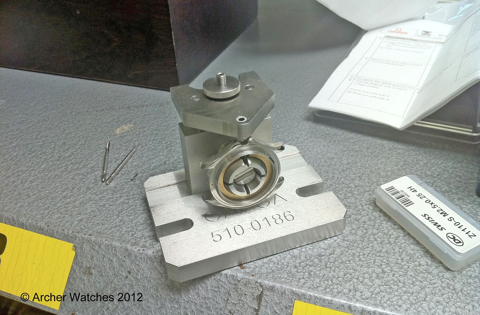

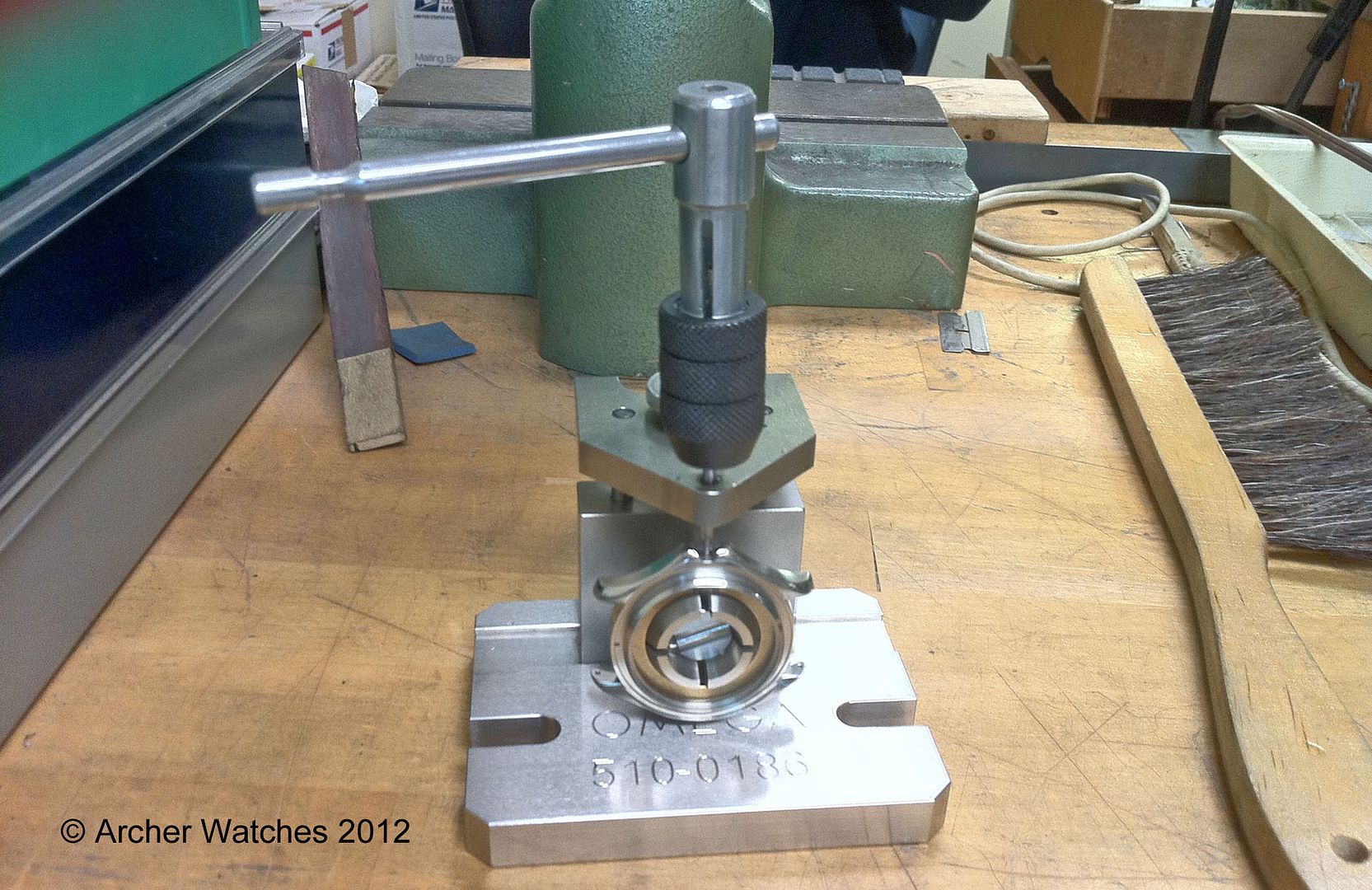

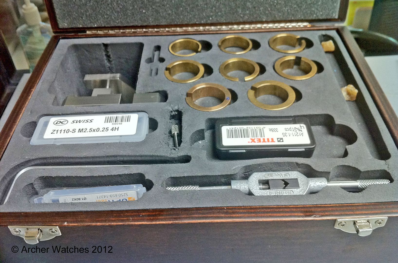

Here it is...
Ready to drill out the old tube:
Now ready to tap the case for the threaded tube:
They don't sell it as a complete kit in the box anymore, but to give you an idea the base alone is about $2600, plus a lot of smaller bits and pieces. I think when they offered thew whole kit it was somewhere around $5k or so...

Here it is...

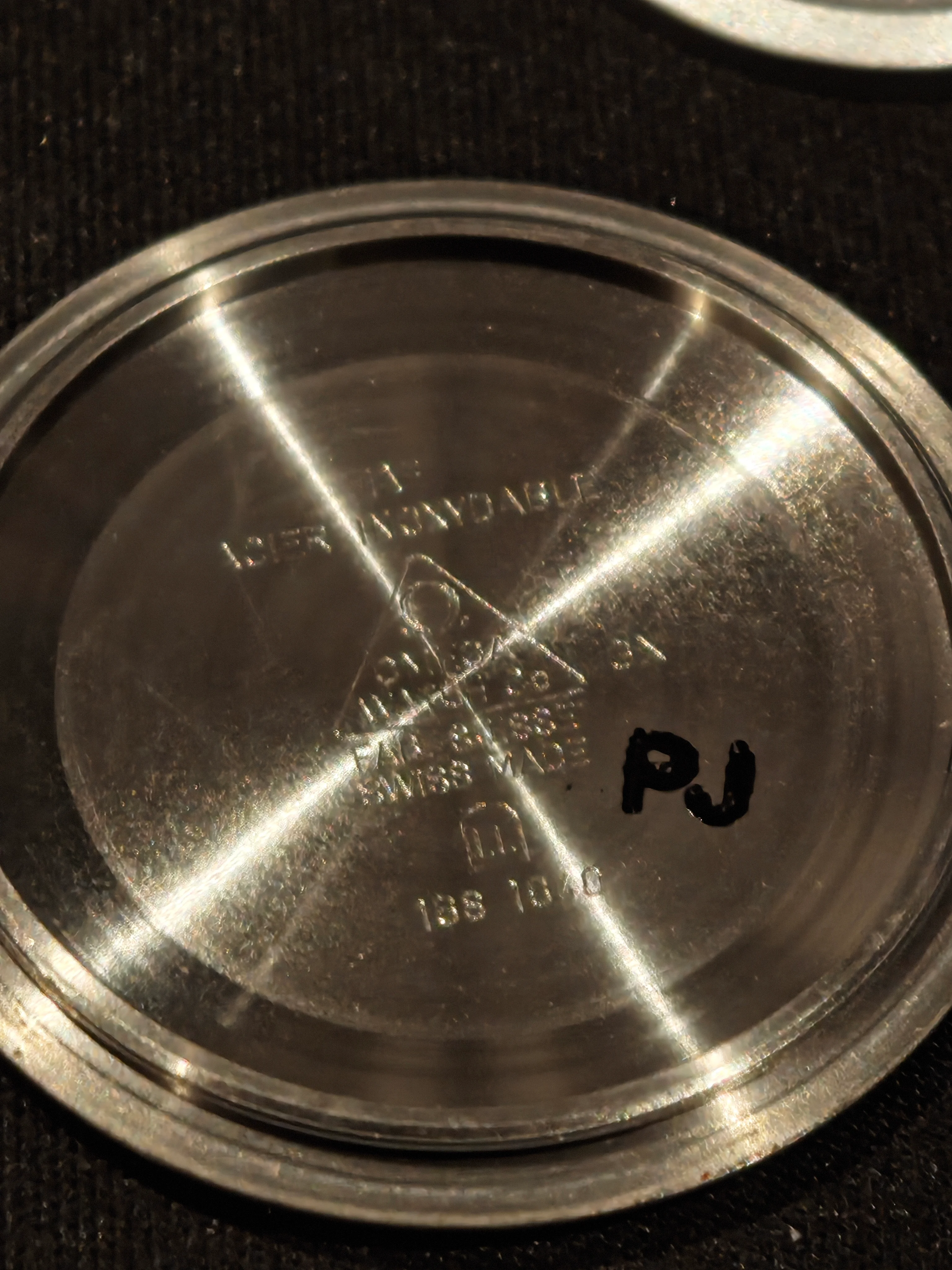

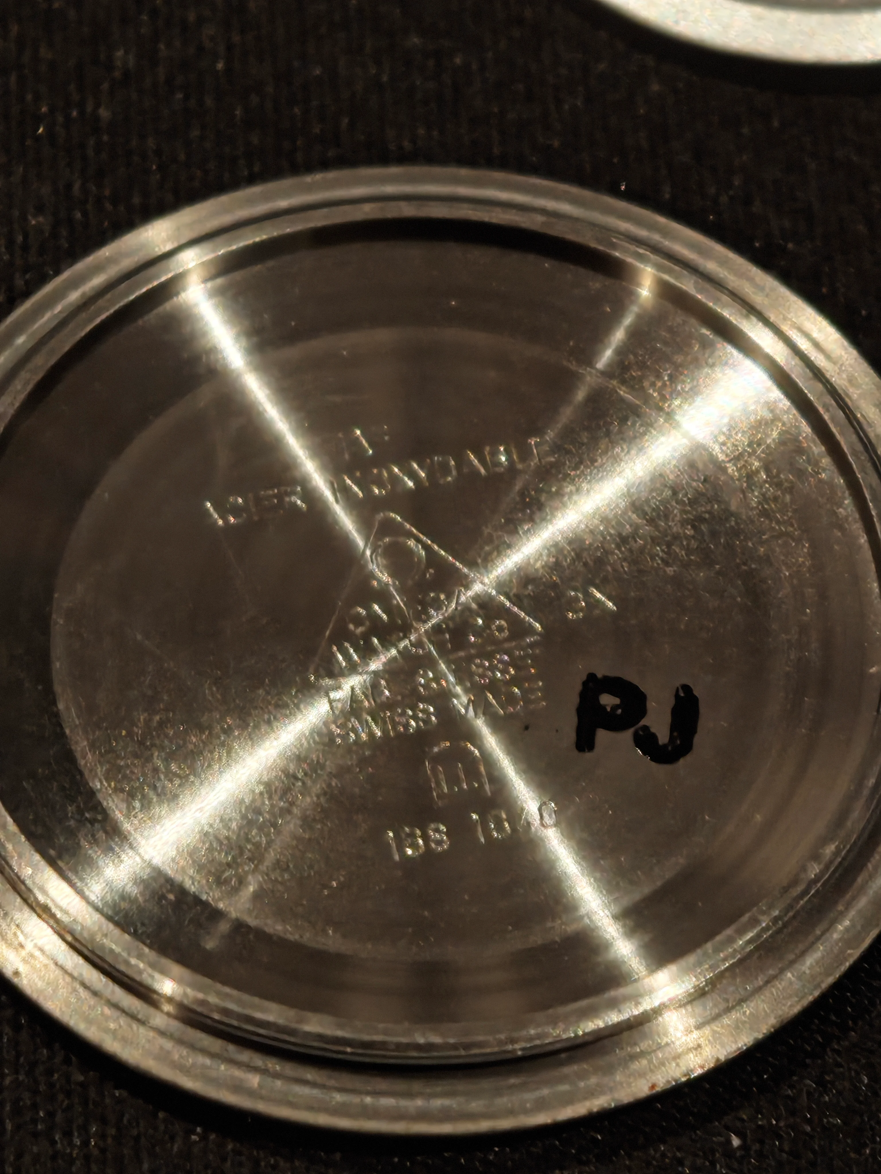

Off topic but I just cracked my 2231.50 open and there's the letters PJ printed inside the case back. Any ideas?

I see this often, but not sure what significance it has…
