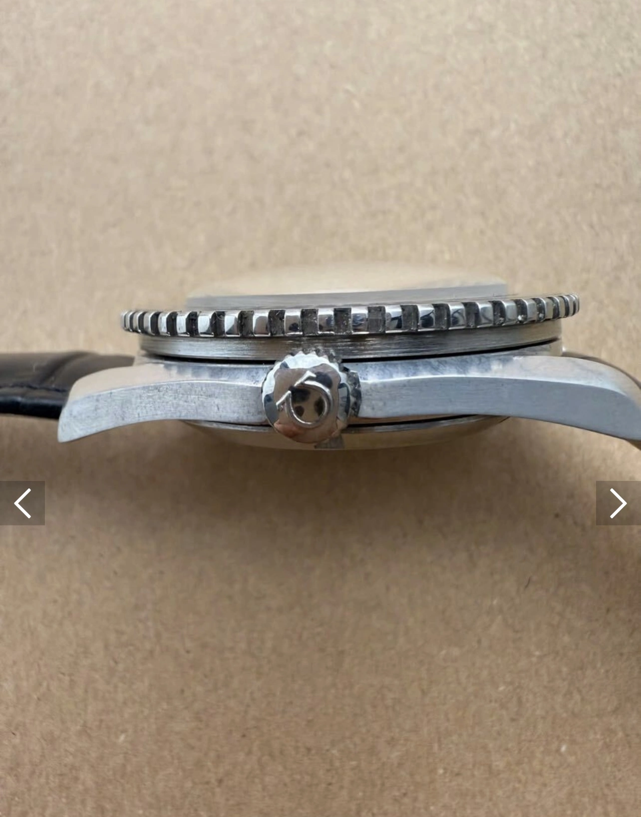

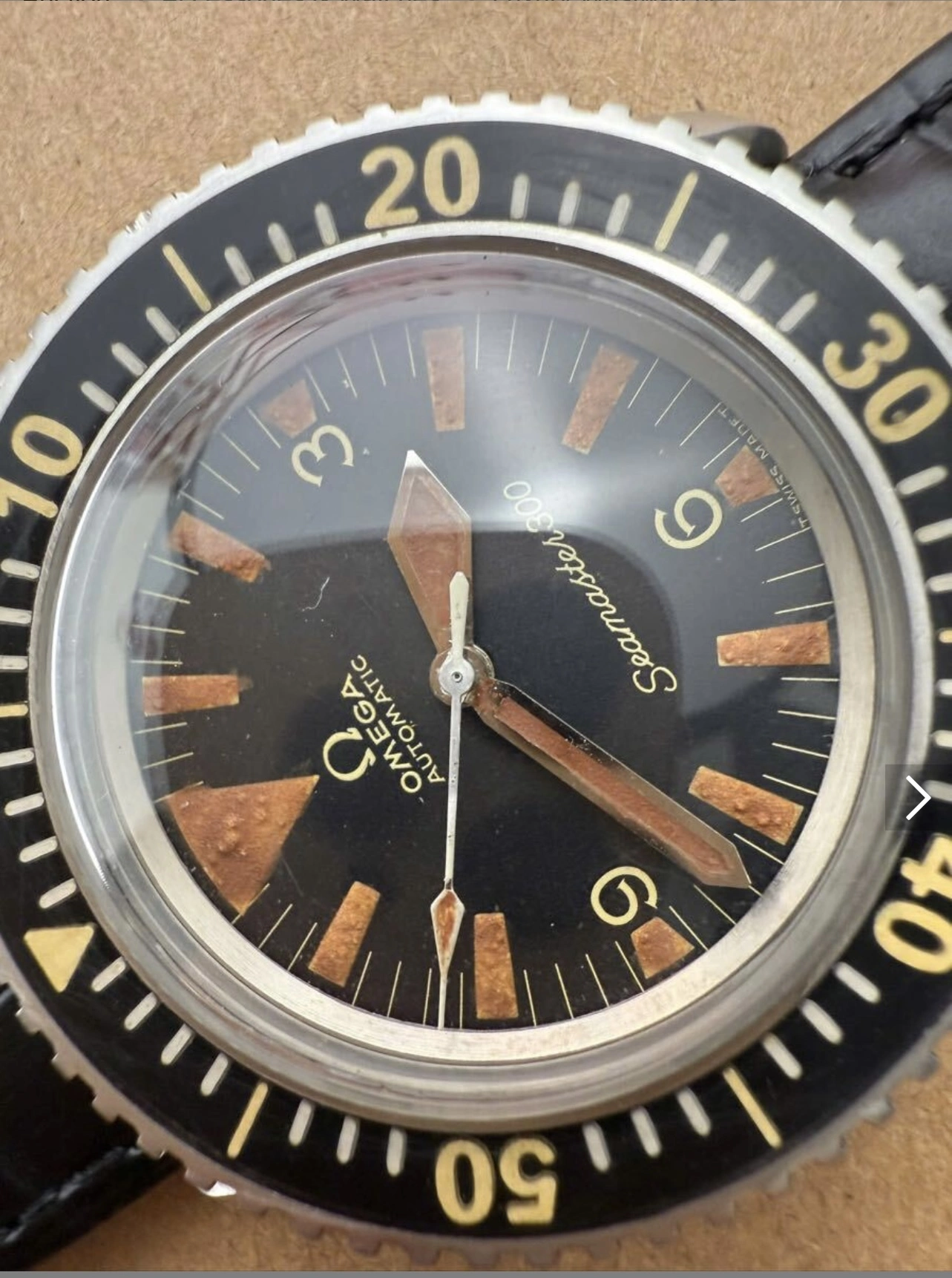

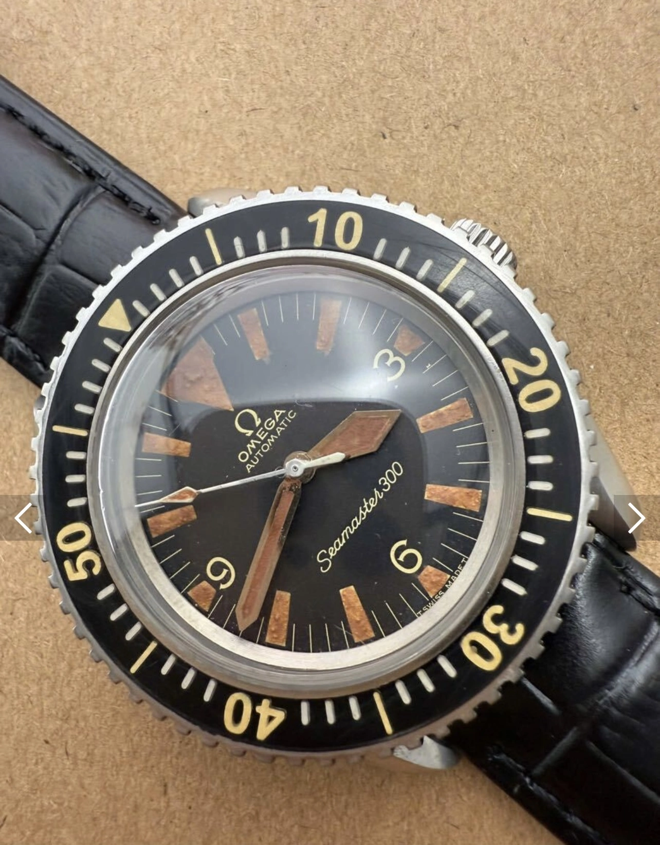

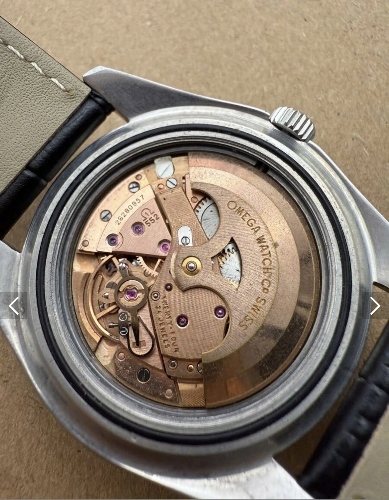

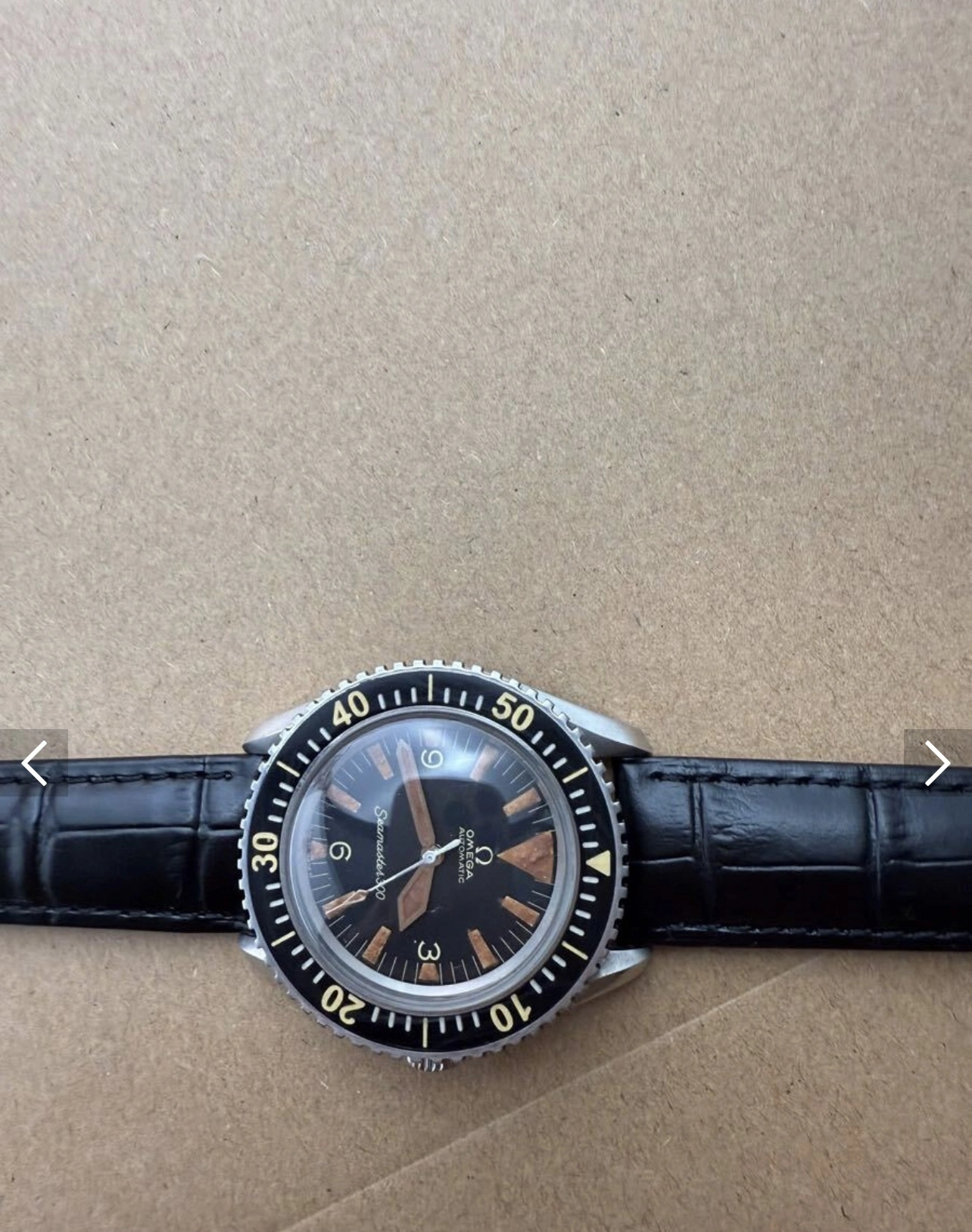

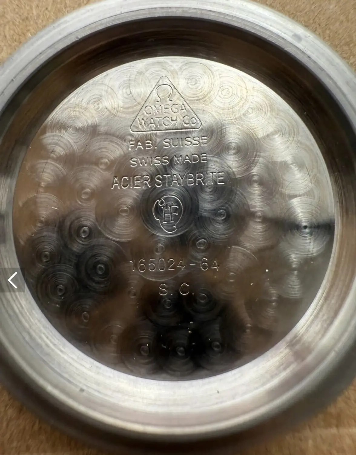

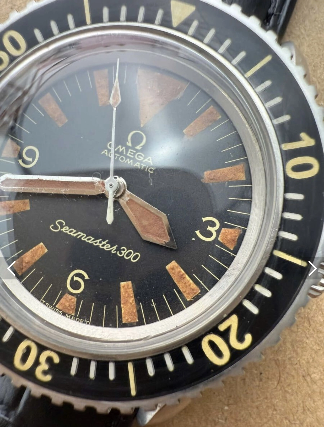

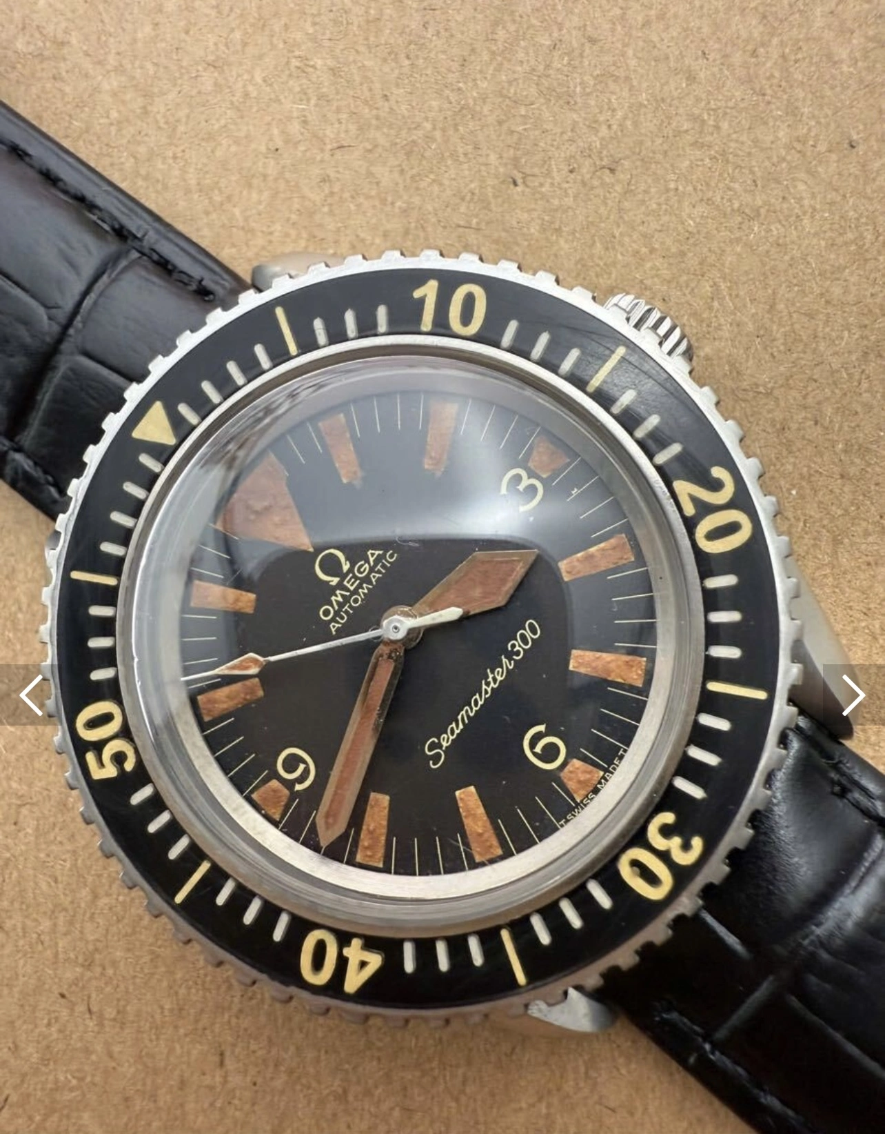

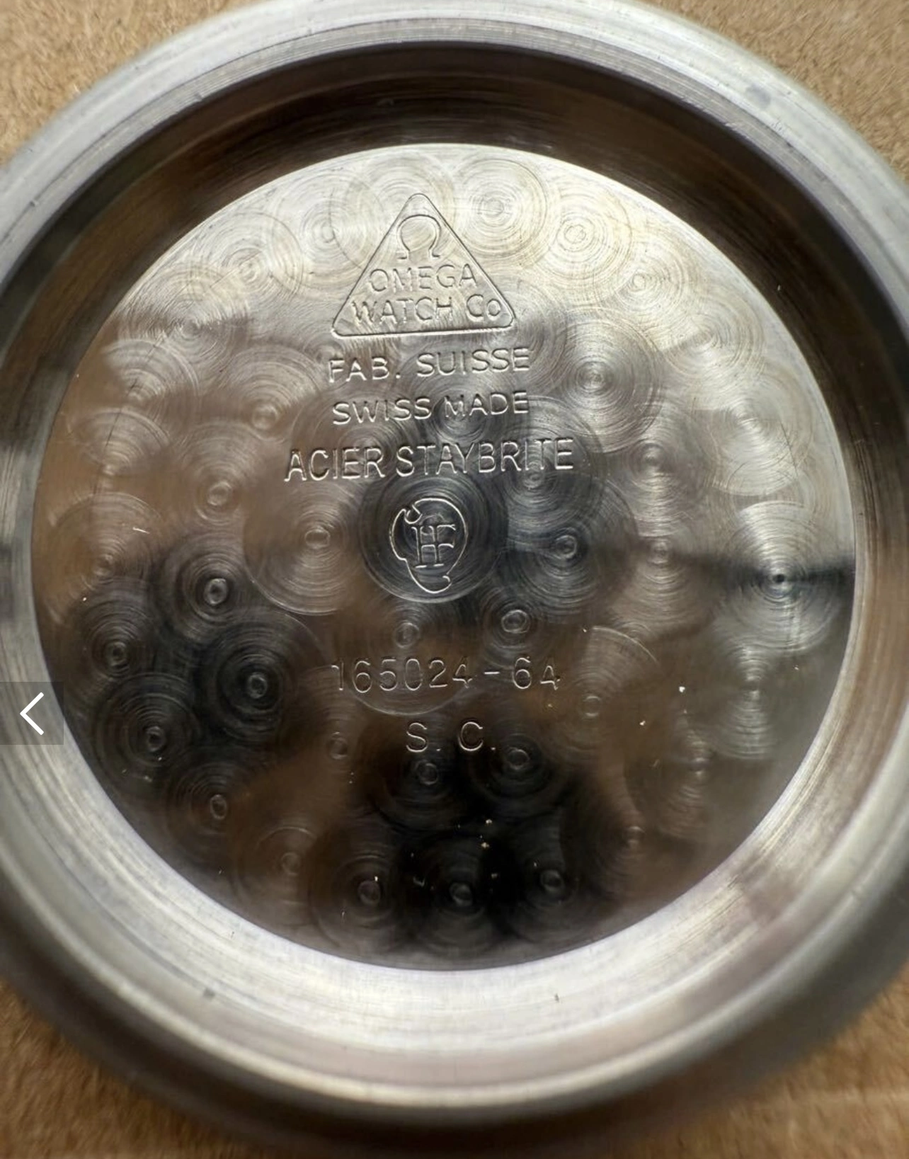

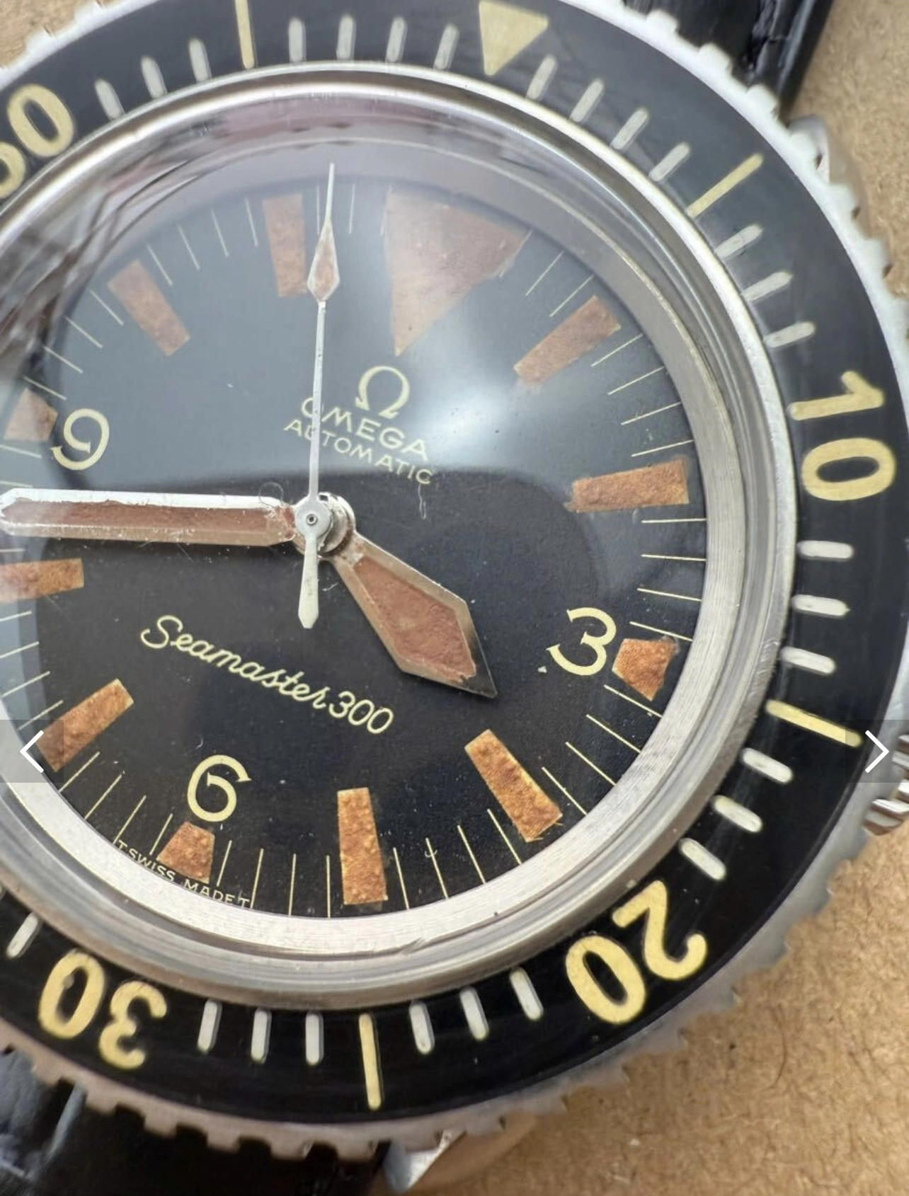

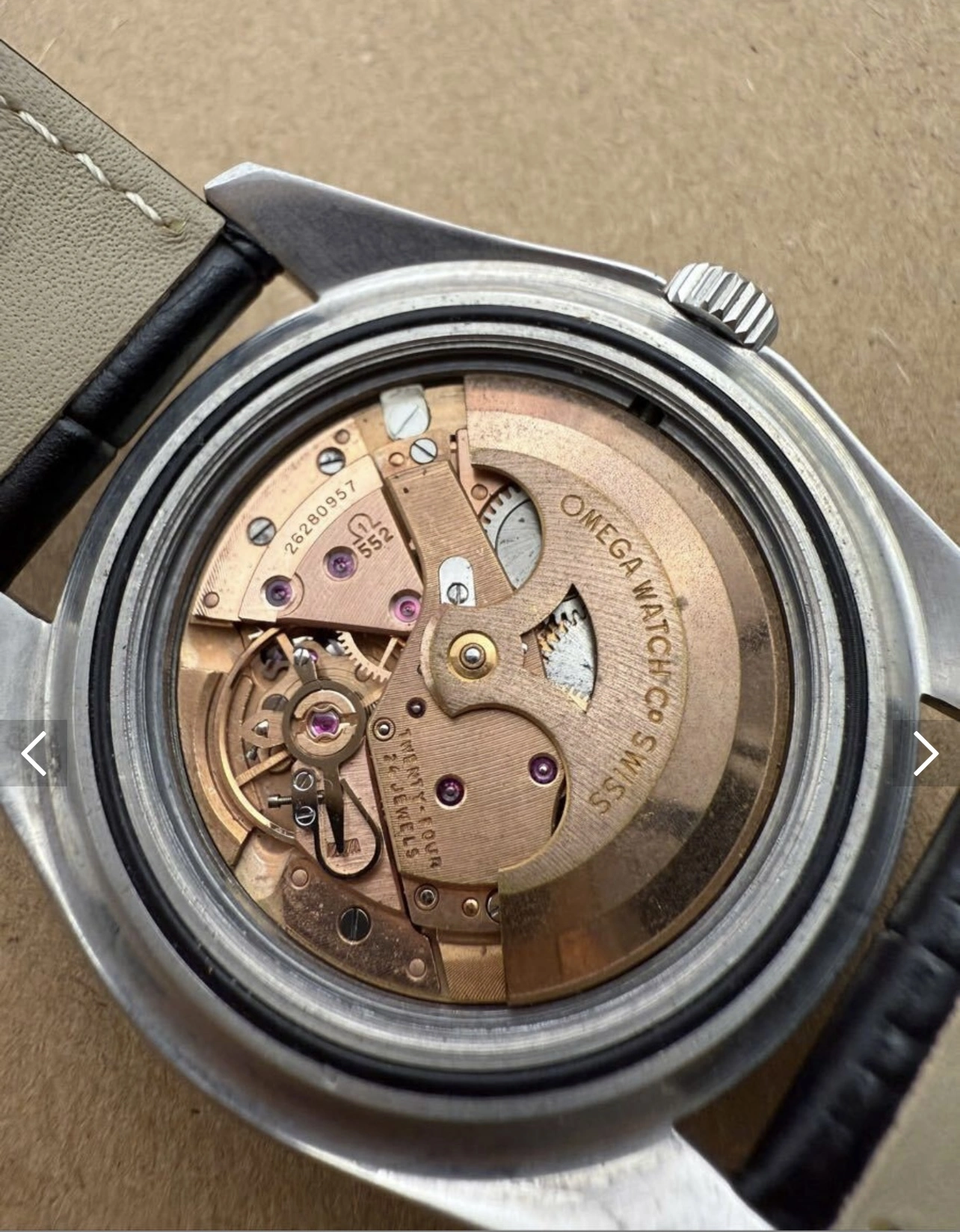

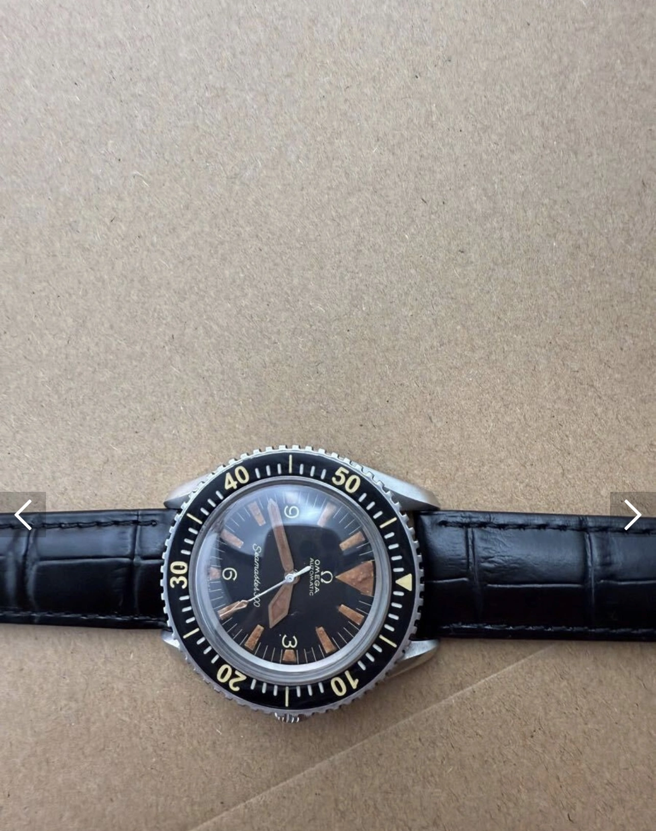

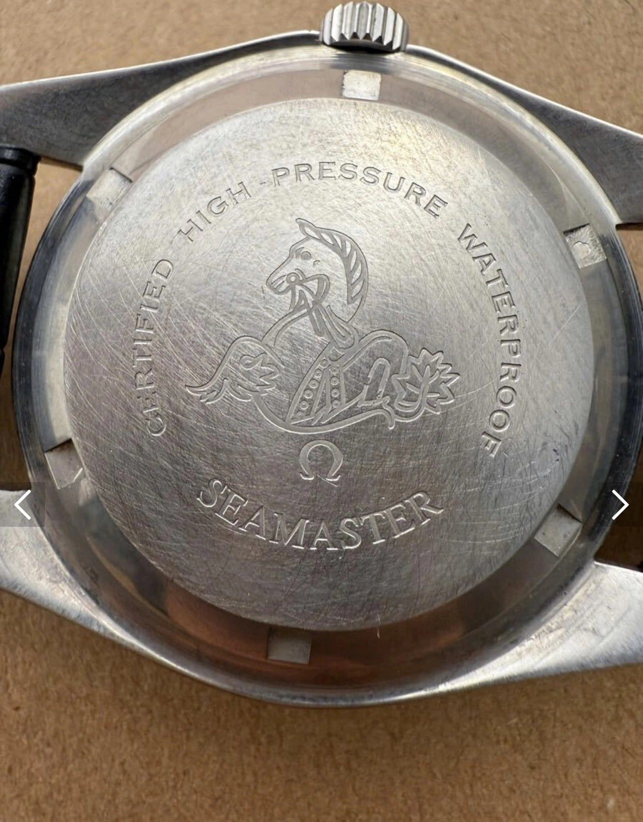

Hi all, thanks in advance for any help. I have looked at previous posts on similar/like models and think this is genuine seamaster but would really appreciate members feedback who are more experienced than I.
Model seamaster 300
Calibre 552
Case: 165.024-64
3
Unfortunately this is not correct.
Thanks for the quick reply. What is not correc so I can known for future? Movement, crystal, face and hands look correct to me but was the bezel I was most unsure of?
562
2,731

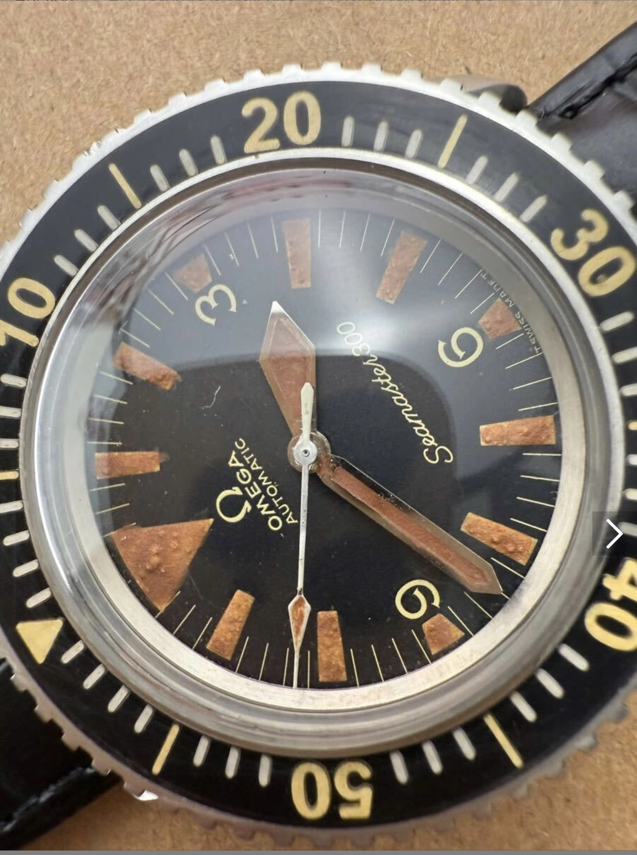

I didn't look at other part. The dial is not correct. Look at the serif on the 3 6 9 and compare them with a genuine one you will see the difference.
562
2,731

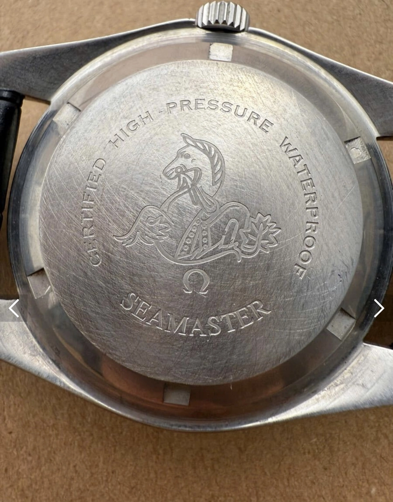

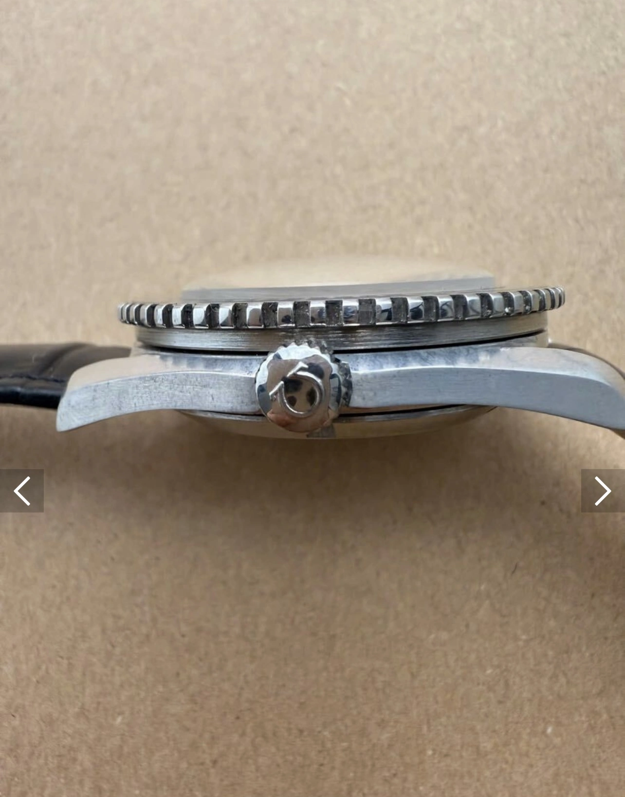

I'm afraid the case, crown and bezel all looks incorrect to me.
3
Appreciate both replies. I will remove my offer on this piece. Thank you for your help and guidance
975
4,118

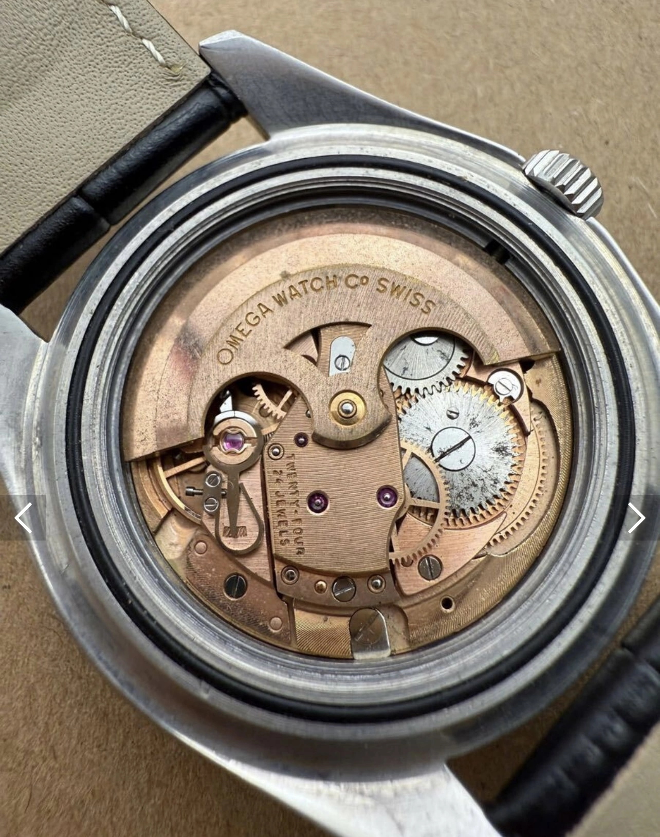

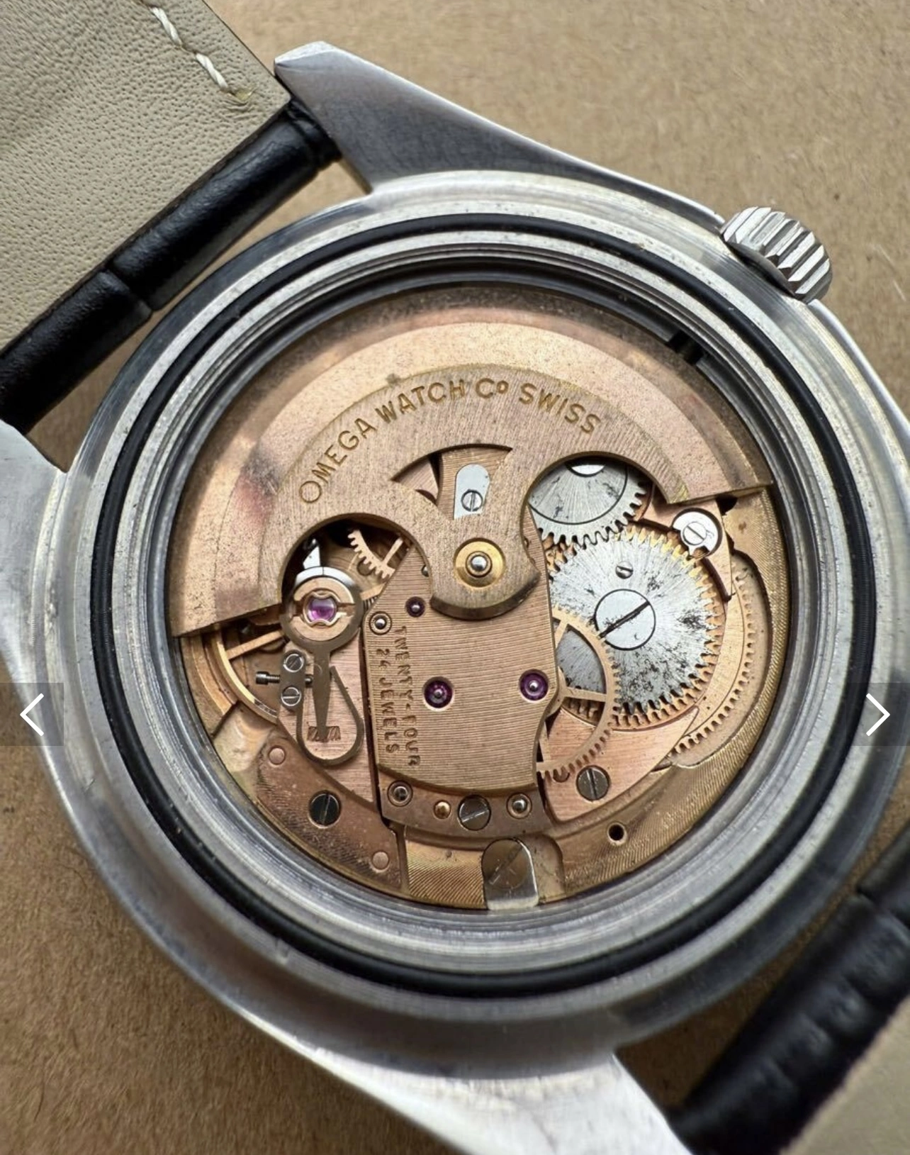

This is a fake watch. As wrote before, only the movement is original.

The deliciously bubbly grilled cheese on the markers is making me hungry.

It’s a genuine movement with new (and artificially aged) case, bezel, dial etx.
8,174
36,709
Do we call that dial aging faketina?
