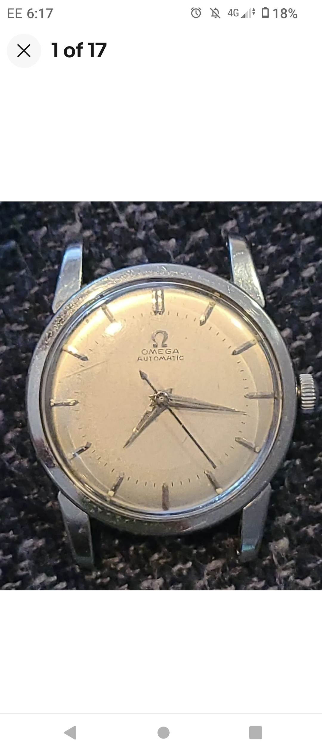

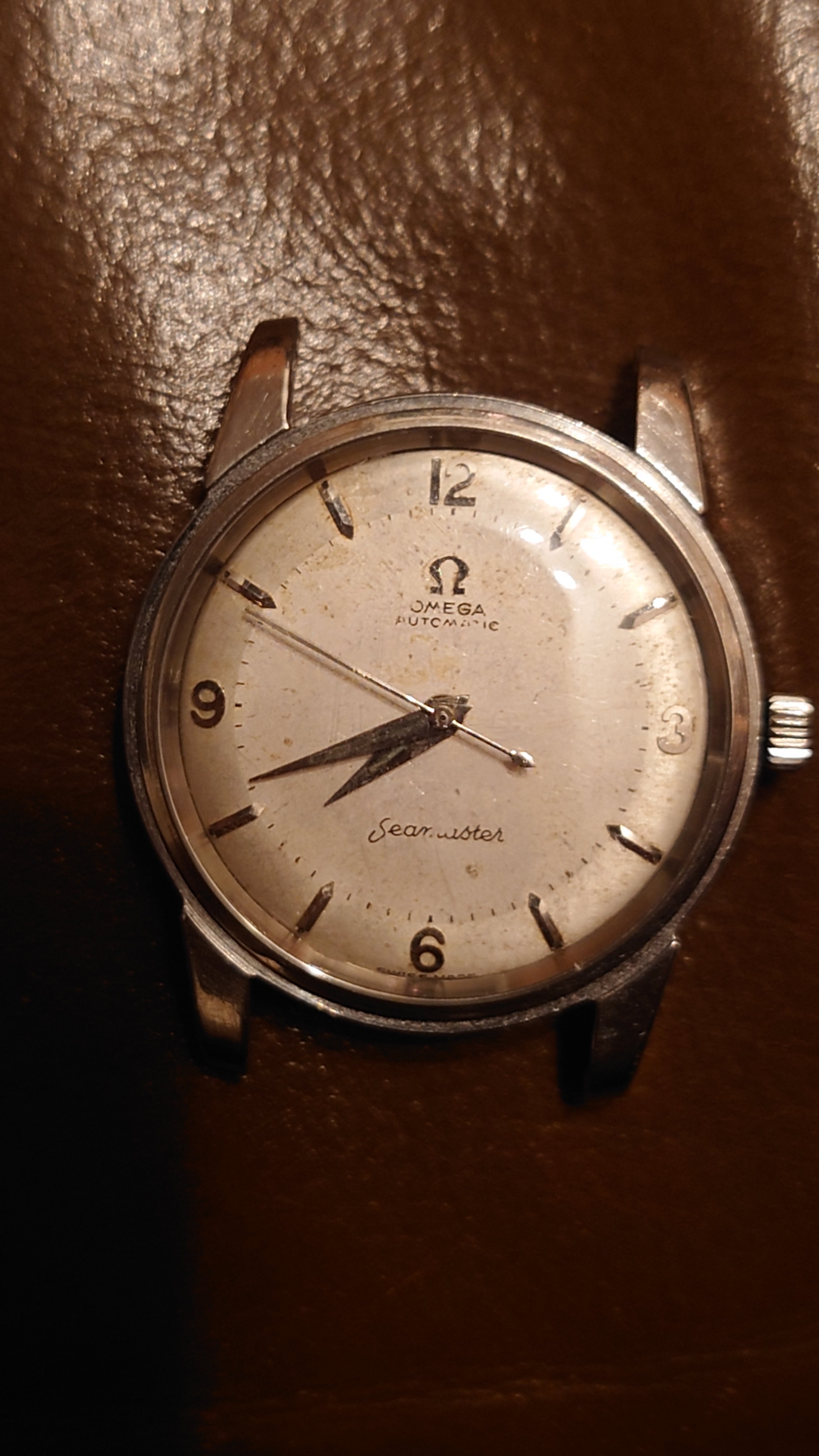

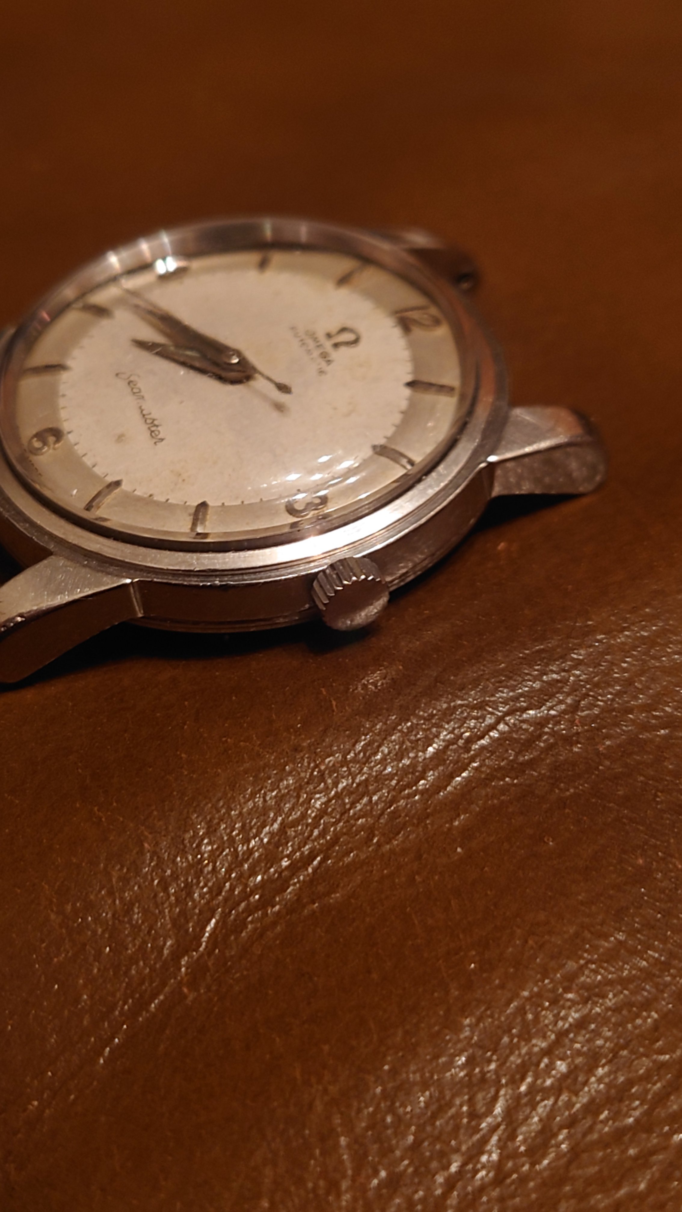

Just received this 501 omega 2846-2sc
And upon receiving I didn't realise it's got the bezel missing lol oops How difficult are these to find ?

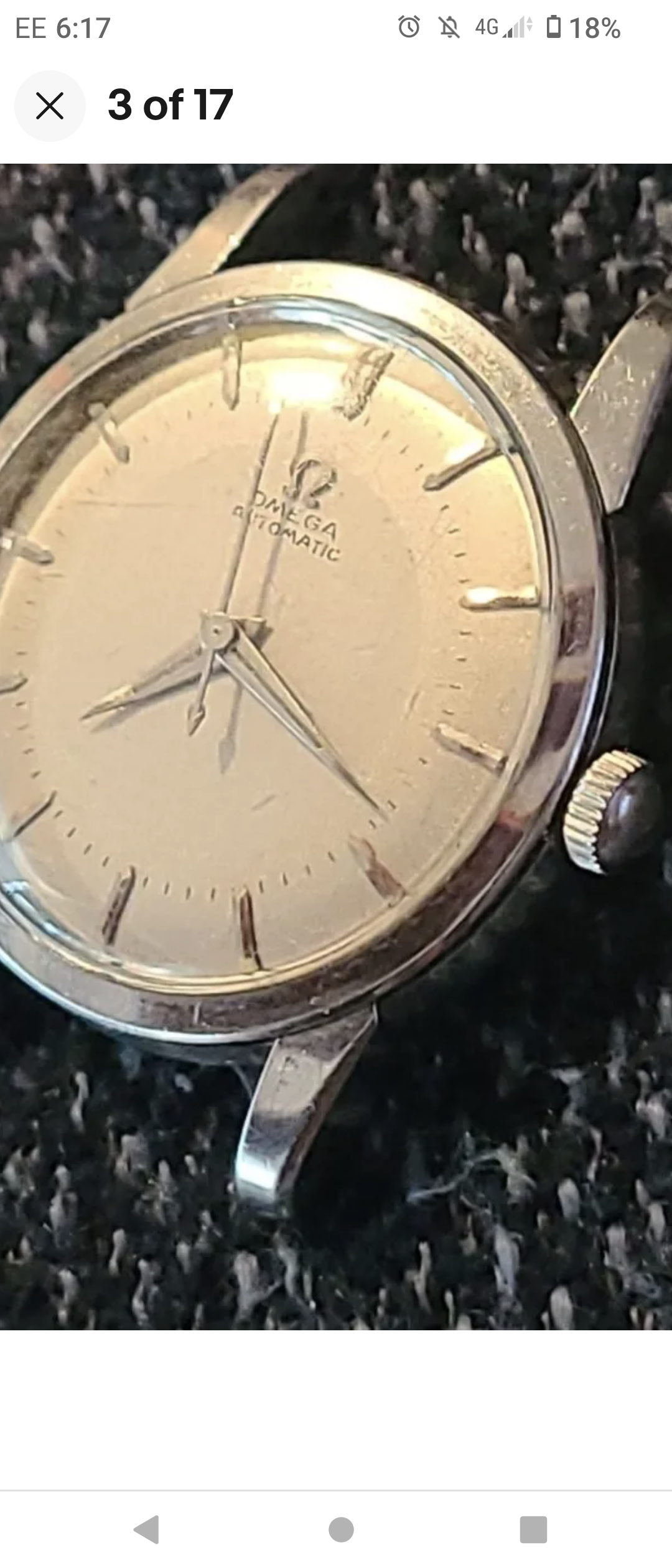

I noticed it's got a very unique second hand which at first I thought it could have been replaced but I actually found a very similar one on eBay with the same second hand but different dial same movement and case
To me it looks a little long or is this normal, also the crown has been replaced or has it just worn the omega logo off it
I am somewhat happy with my purchase working movement and signed dial
What do you guys think?? Mines the top two pictures. Last two are what I found on eBay

Talk to the seller, return if you can. Second hand is a replacement, so is the crown. Hand and crown can be found, but it's work, it'll cost you, and with the condition of the dial, the question is if it's worth it. Bezels are impossible to find unless you buy a full spare case.

I also thought it's a replacement but it's very strange to find one on eBay with the same (replacement) second hand on the exact same watch case / movement

It's not the same, just a similar style. The center cover is significantly larger on the eBay example, yours is longer.

Didn't send me a different watch I was just comparing the hands to mine.
