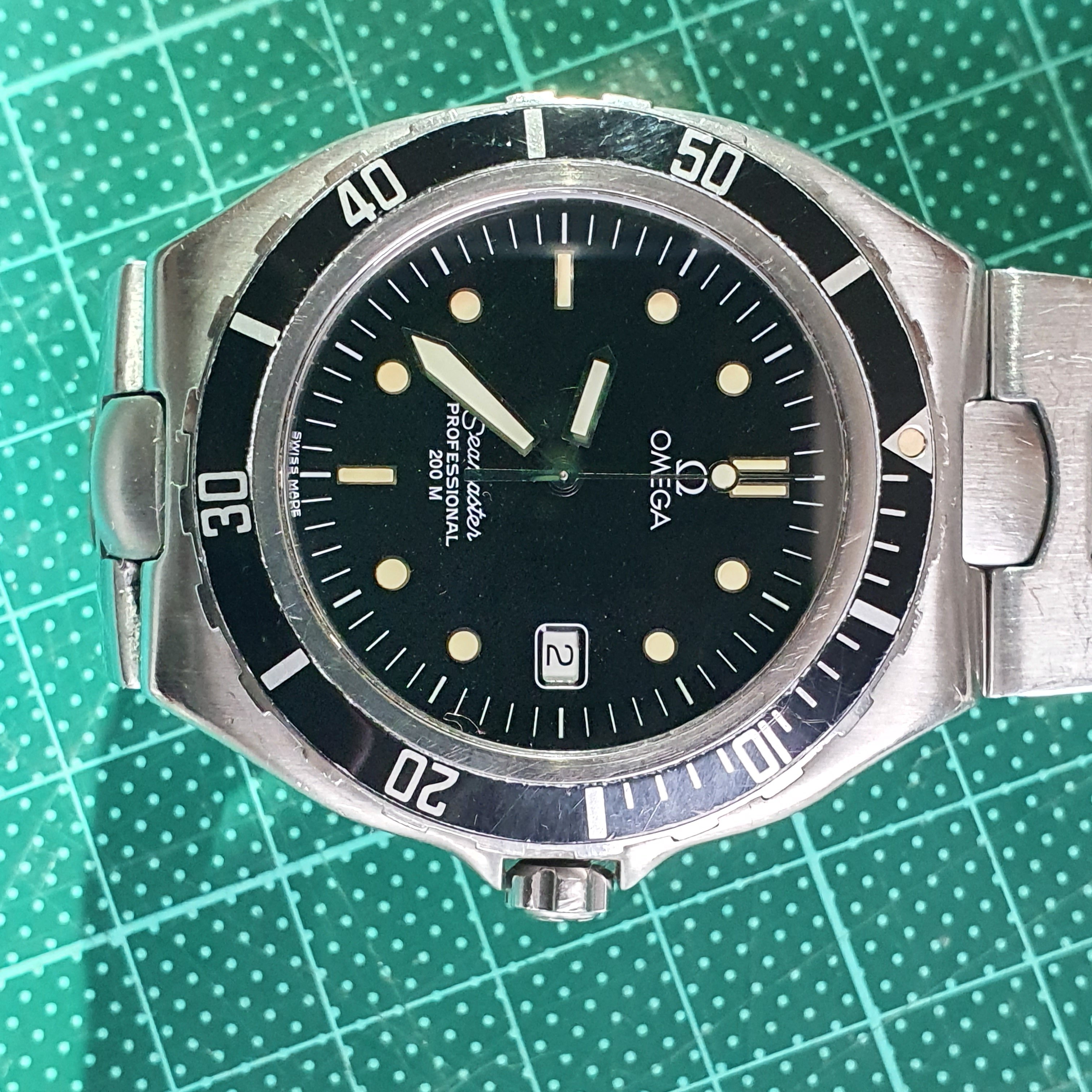

Hello All!
I'm posting for the first time because my Seamaster has developed a problem keeping time. I'm interested in any advice and especially if you could recommend a watchmaker I can find in Sweden. I guess I could just go via Omega but any alternative suggestion welcome.
I received this watch 12 months ago from my father and with a new battery it has been running well. I wear it almost everywhere but not in water since I do not know the service history if there even is any.
I noticed a few weeks ago it was slow so I corrected it. Then it was a minute slow per day for a while. Most recently it seems to have lost about 15 minutes in a day. Since then I have been afraid to look!
The only unusual event I can think of is that maybe about the time this started the watch was off my wrist at minus 15 Celsius for about an hour.
I can't take the back off though the inner working might be very interesting to see.
Any advice you can off would be welcome.
Thank you.
