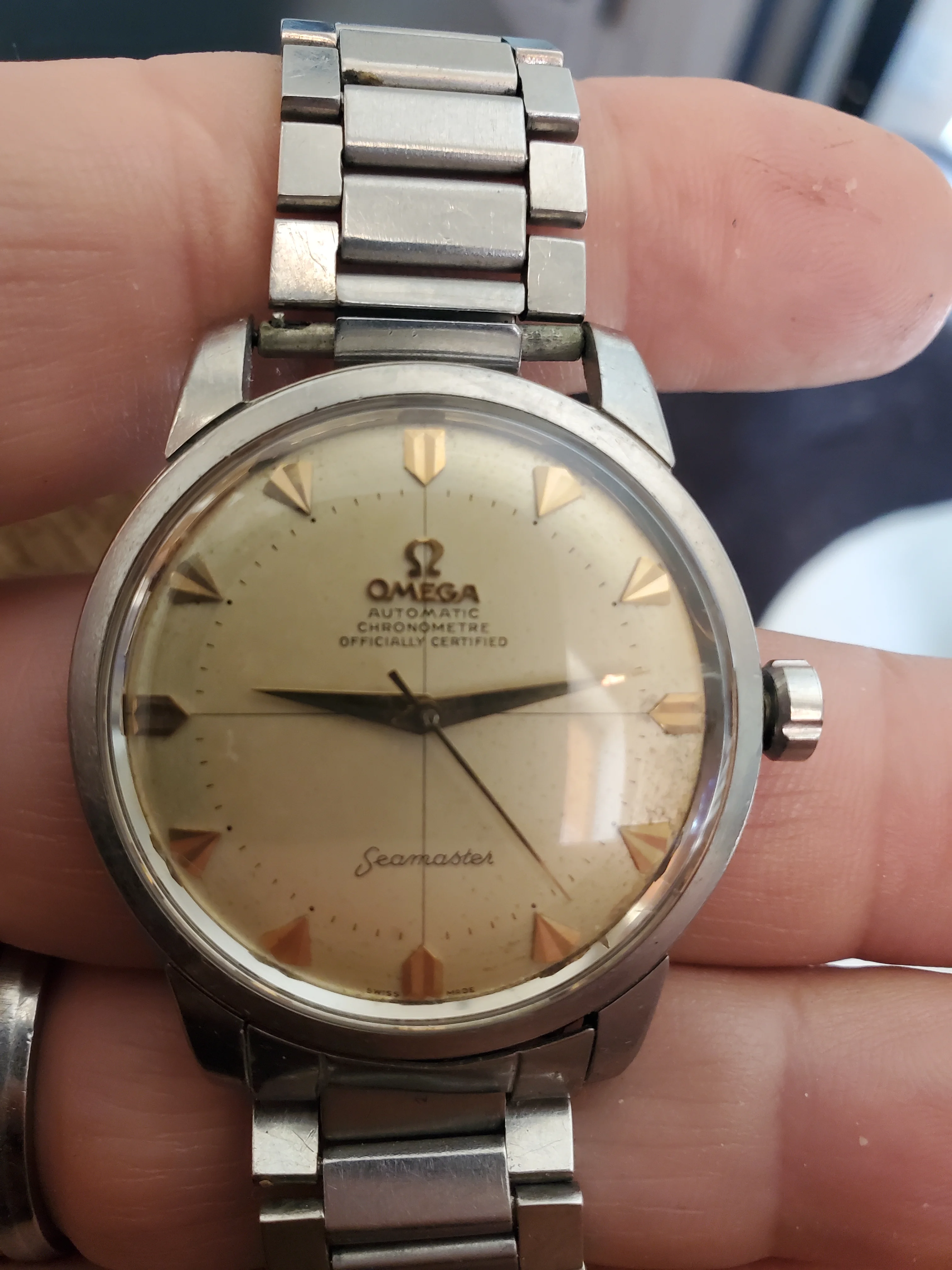

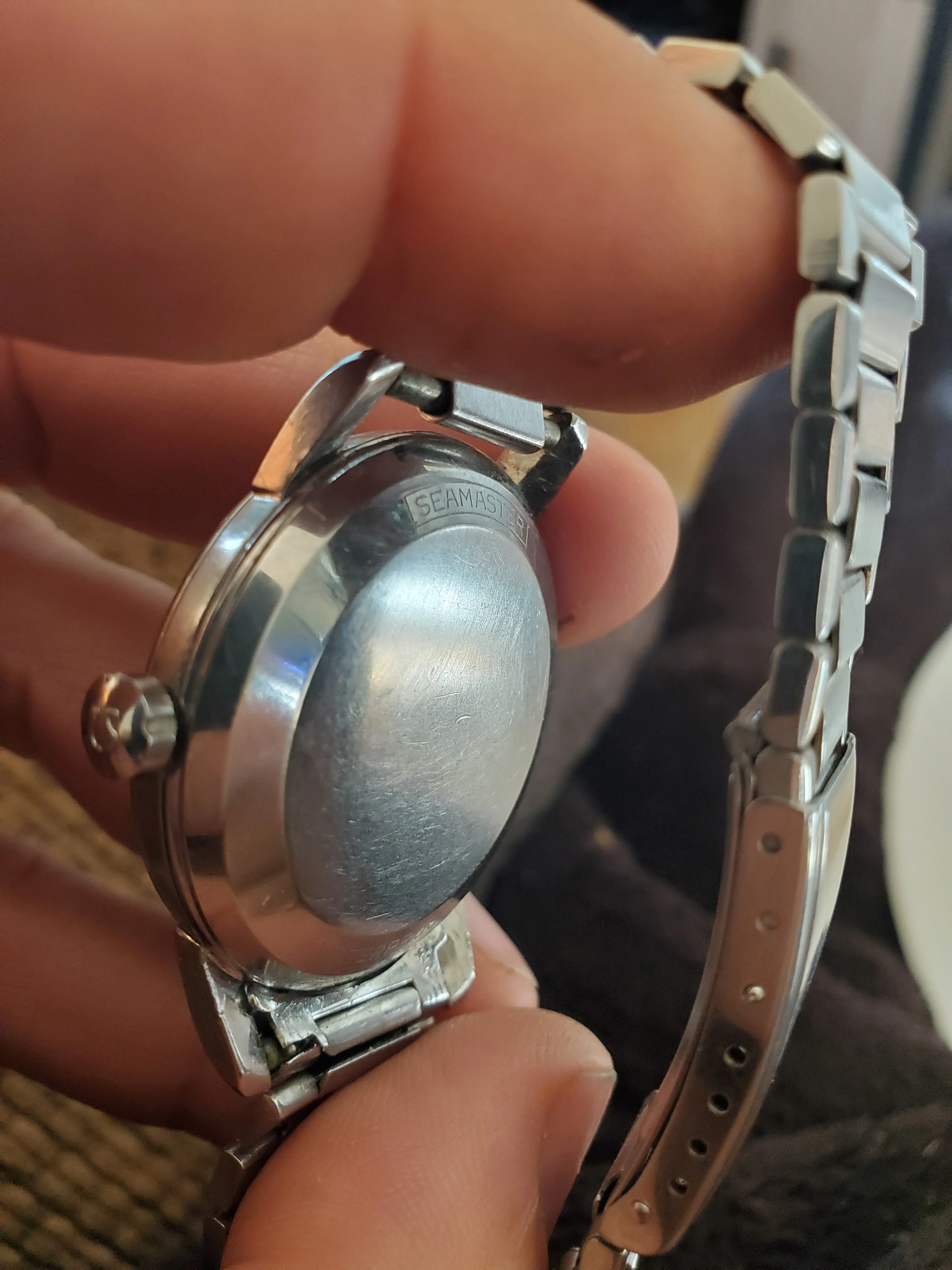

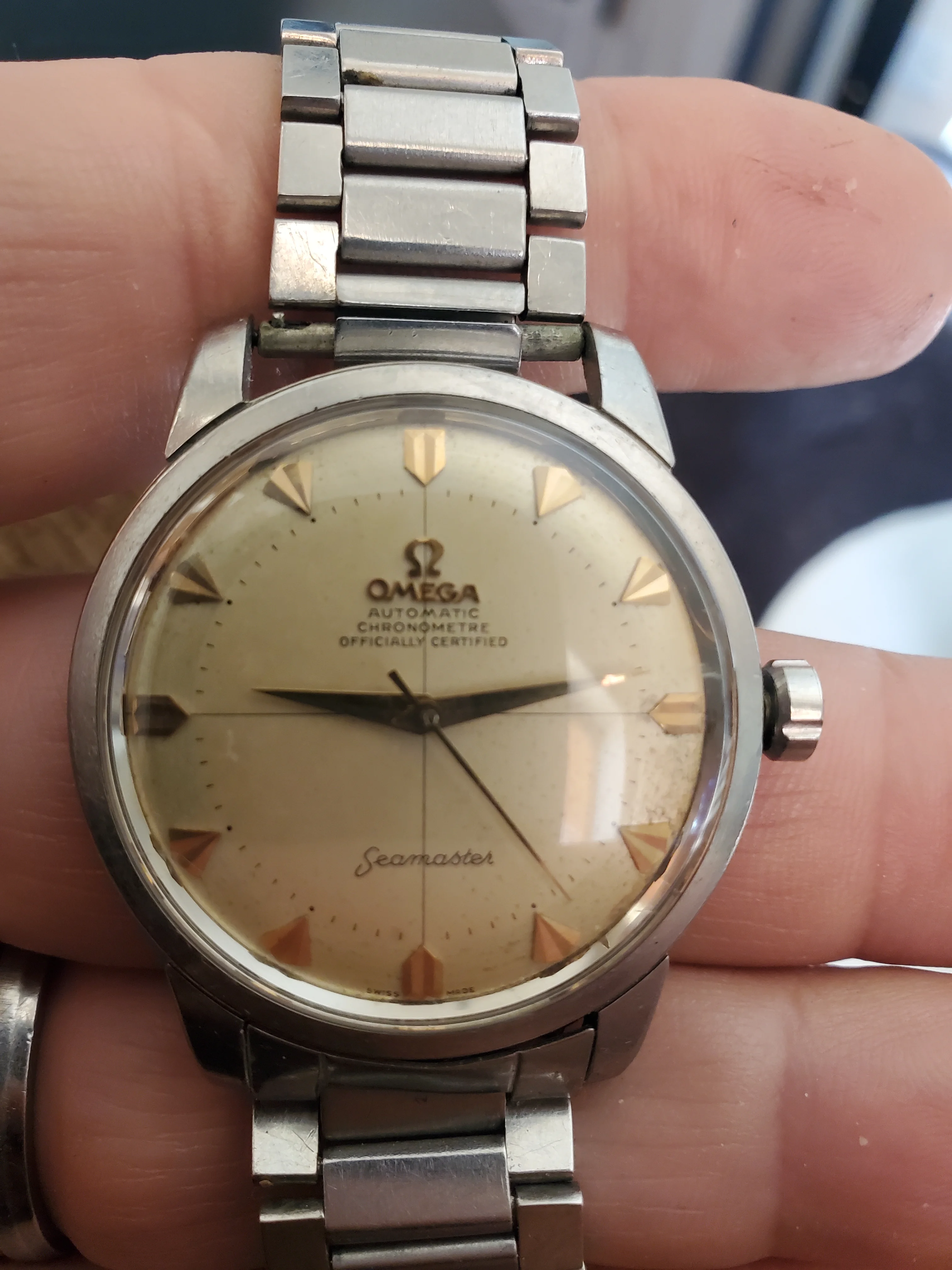

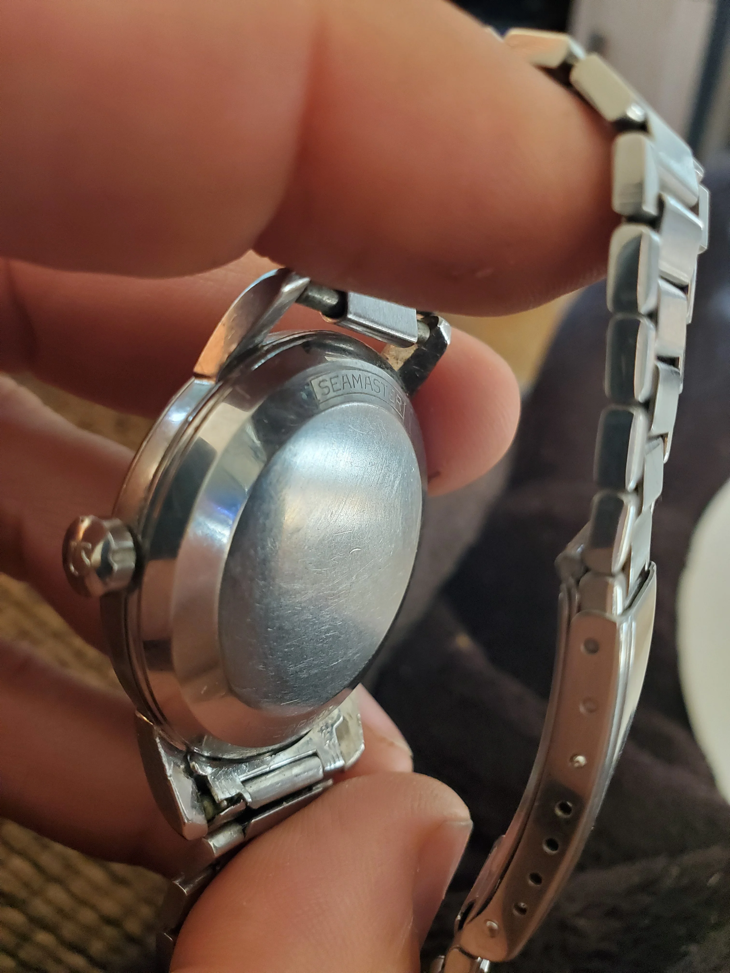

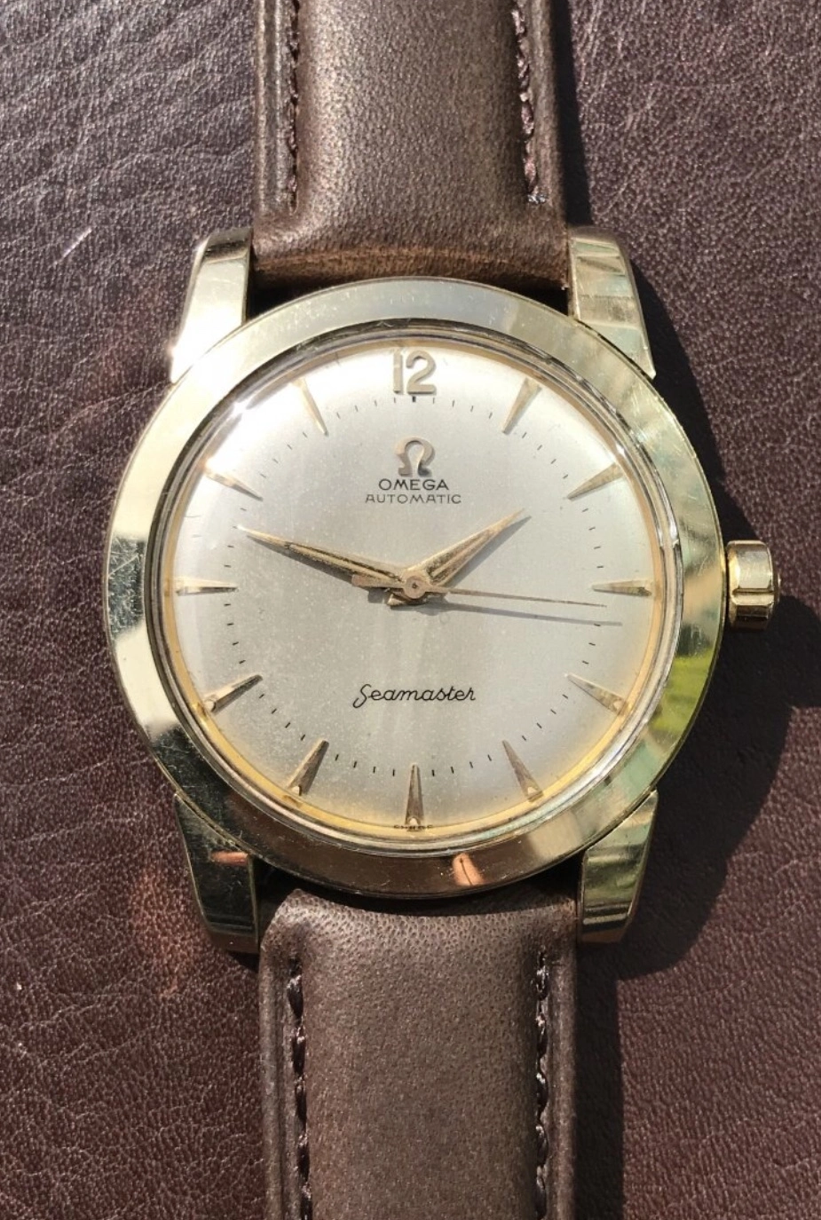

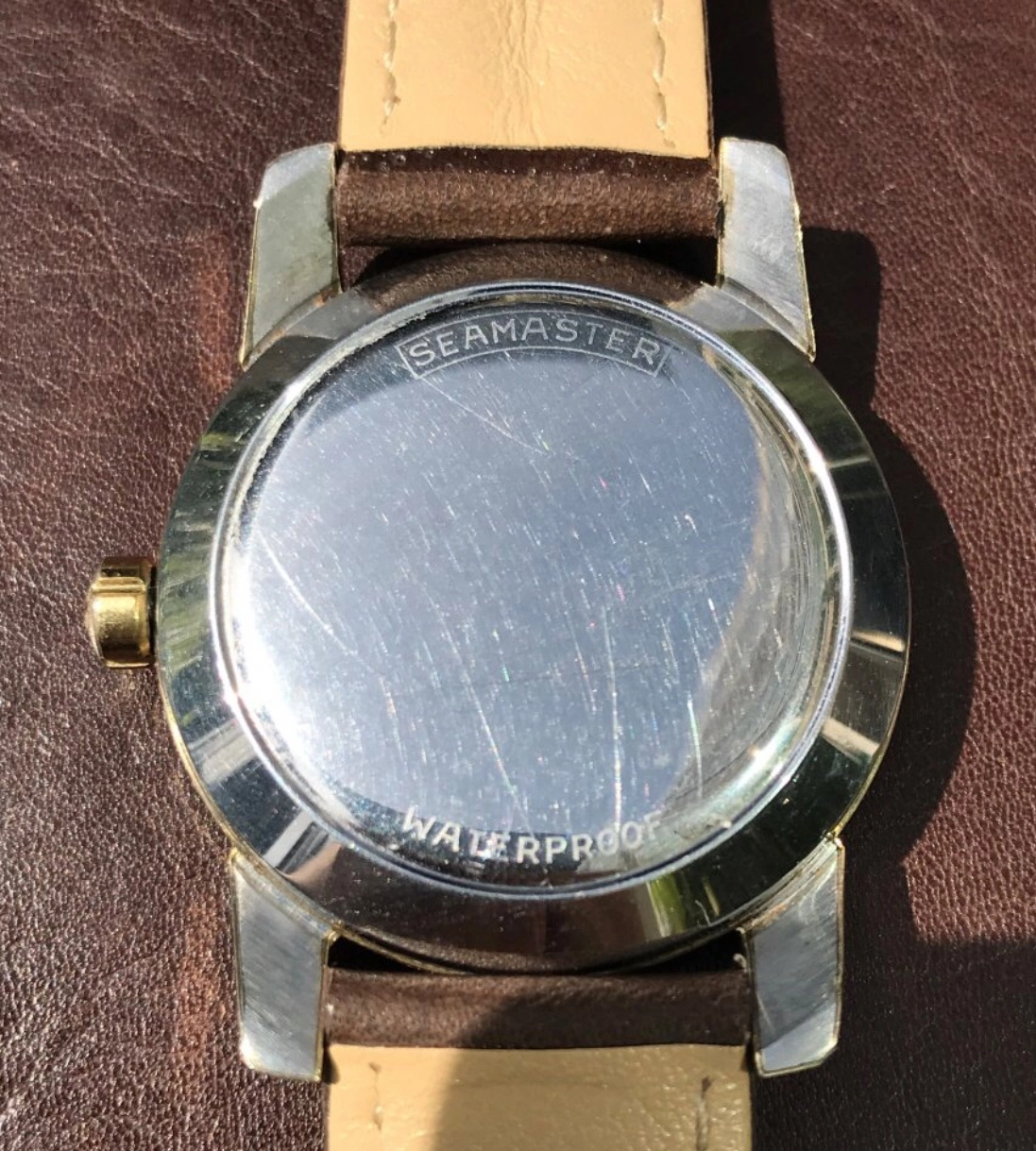

In a box of my deceased Fathers stuff. I never paid any attention to it for about a decade. Thought I would do a Google search based on pictures of similarity. Not much out there...perhaps rare. I think the markers are "sharks tooth". It runs smoothly. I know nothing about this watch and would appreciate any expert info and value. Thanks in advance.

Bracelet missing end links. Probably a 50X caliber movement. Get a watch maker to pop the back. Get reference number on inside back and caliber # on movement. Take pictures of movement

As DON said. It's a shame that the end links are missing. A complete 7912 bracelet is valuable. Nonetheless, you have a vintage Omega Seamaster that will likely clean up very well. I'd keep it and wear it. It's a nice way to remember your father.

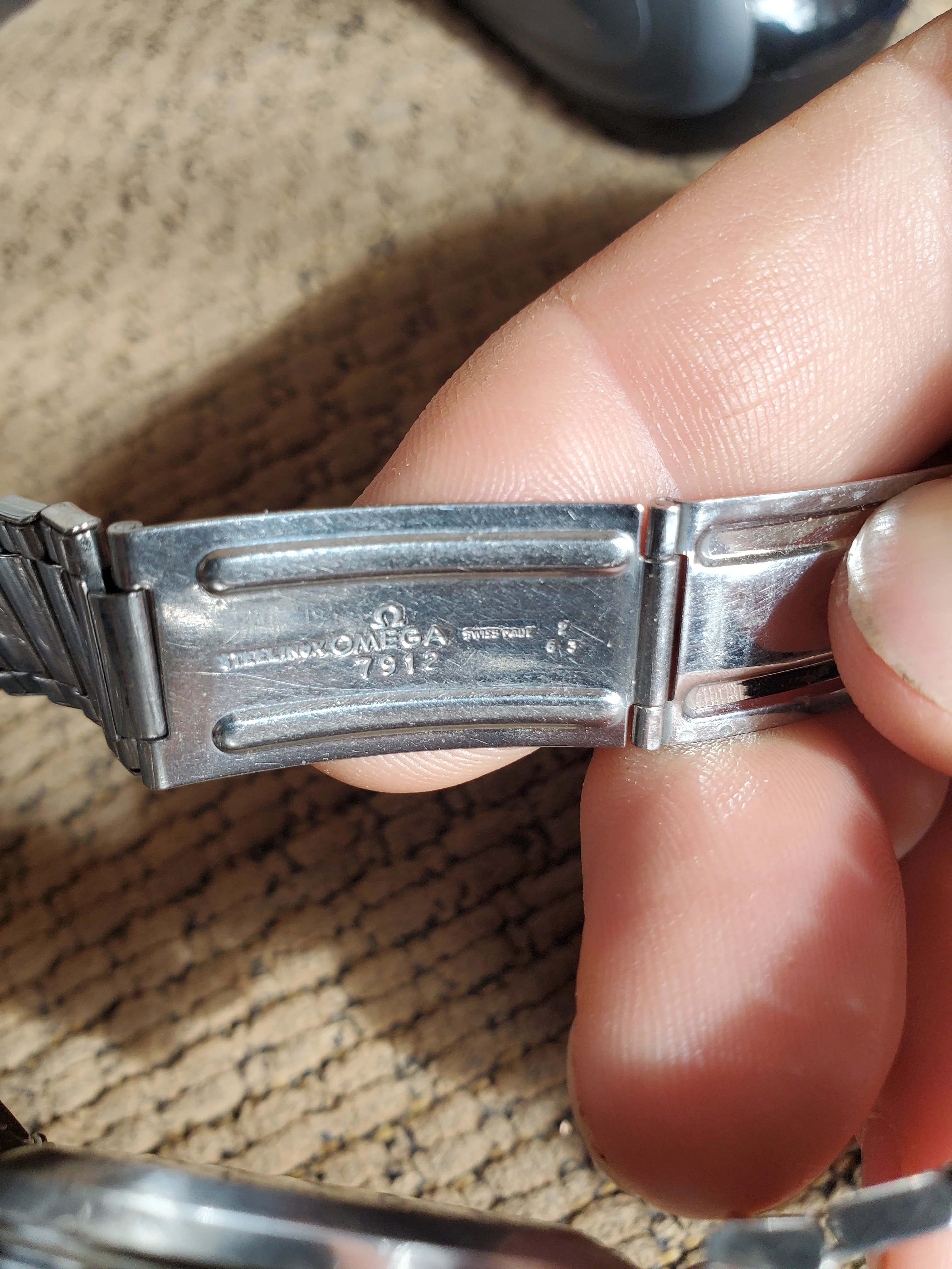

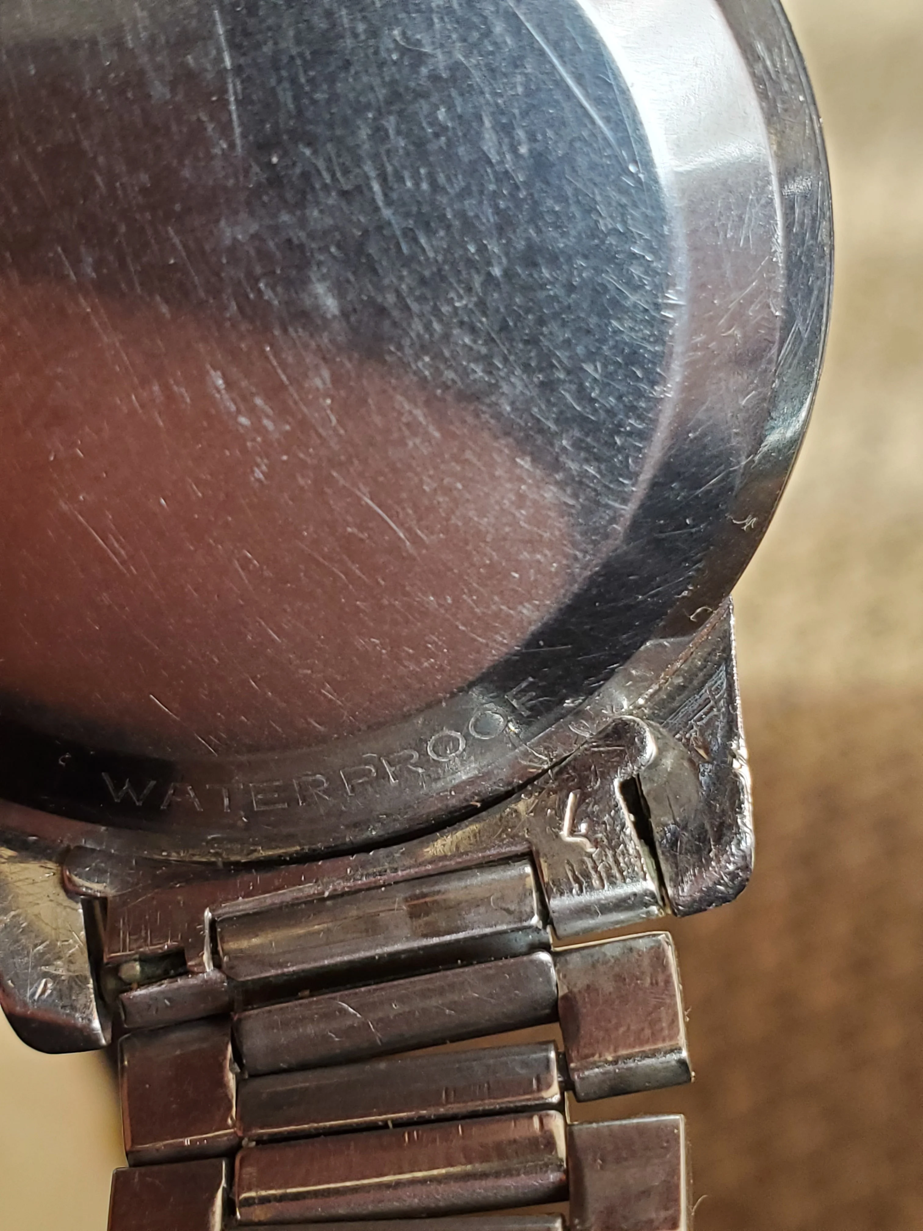

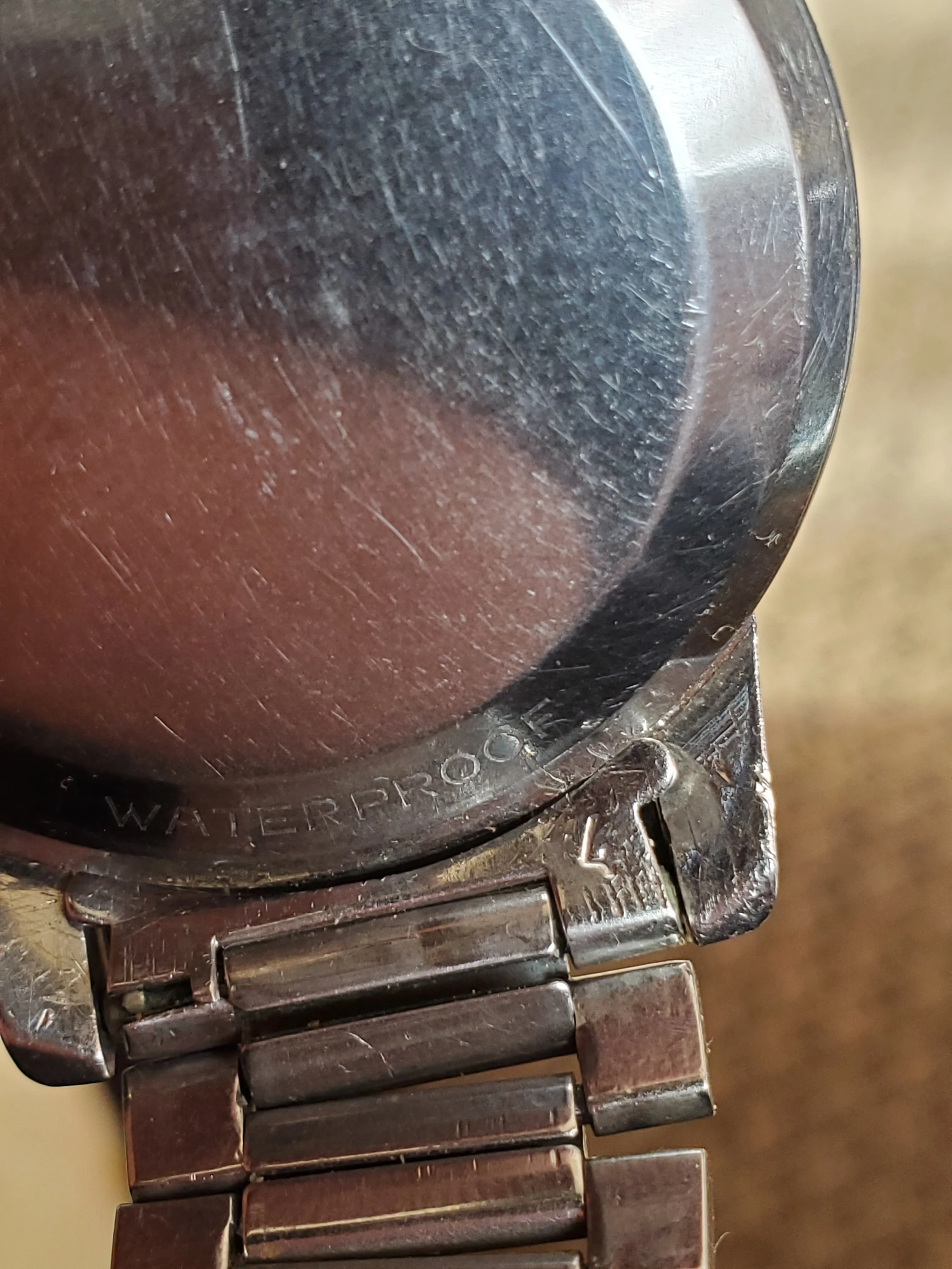

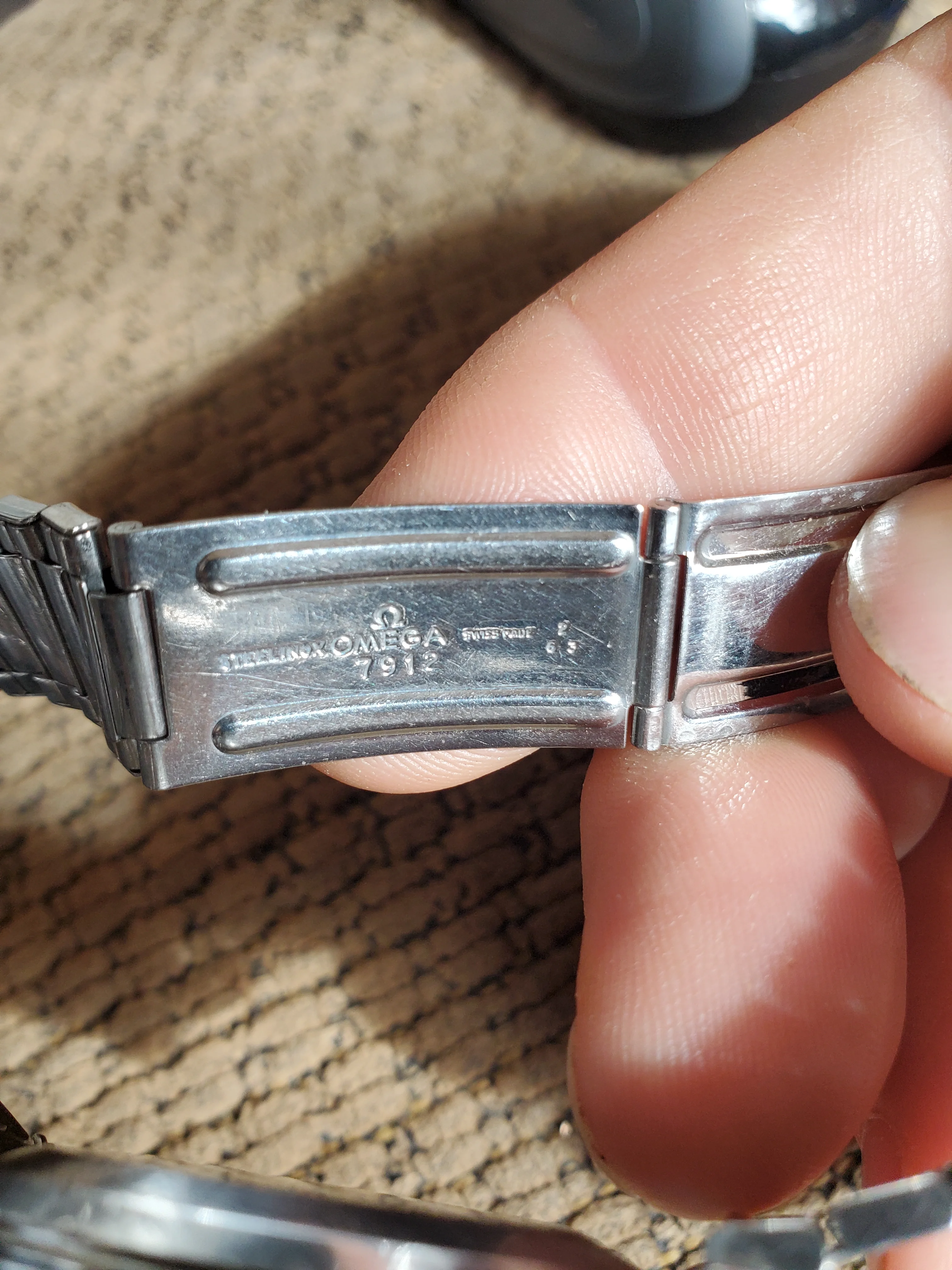

Even without Endlinks (although one is present - what is the number on the underside?) a 7912 is worth several hundred £.
I’m undecided whether the dial is original or not as the picture is poor but a few hundred for the watch as well. More if the dial is original and clean.

That's true, even if there is one genuine 7912 end link, it's valuable. I am also not sure whether the dial is original, but it's still nice that he has the watch from his father.
It looks like the number 4. Maybe this is a better pic.

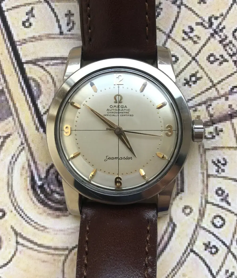

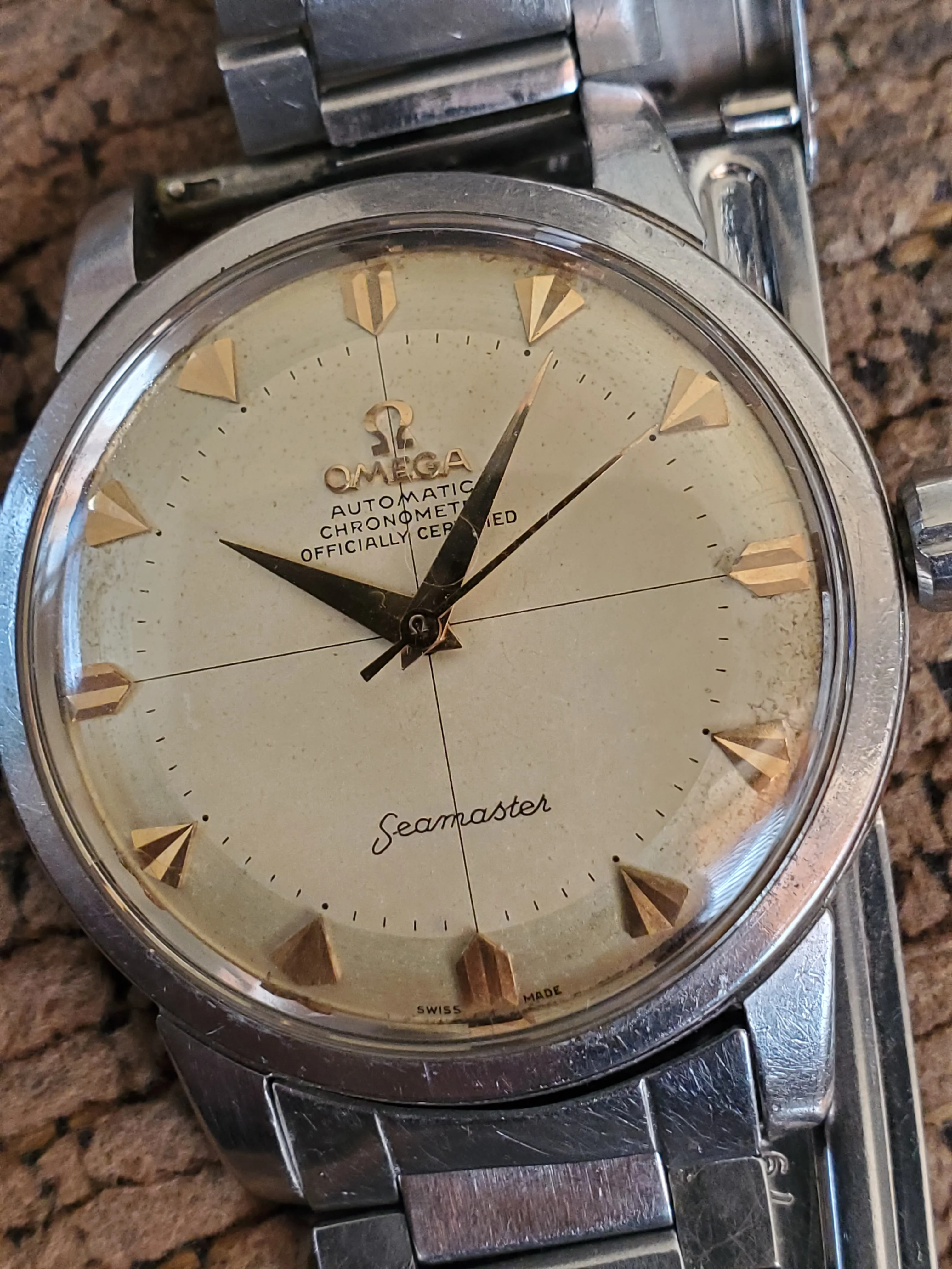

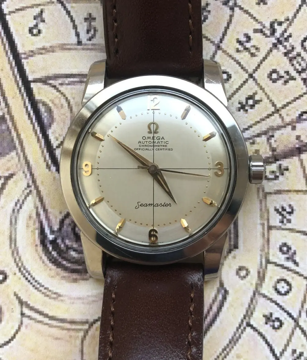

As for the watch, I'm inclined to think that it's a 2577 and that it's original. Here's an example for the dial text.

4’s are not in the same league as 6’s but they still have value

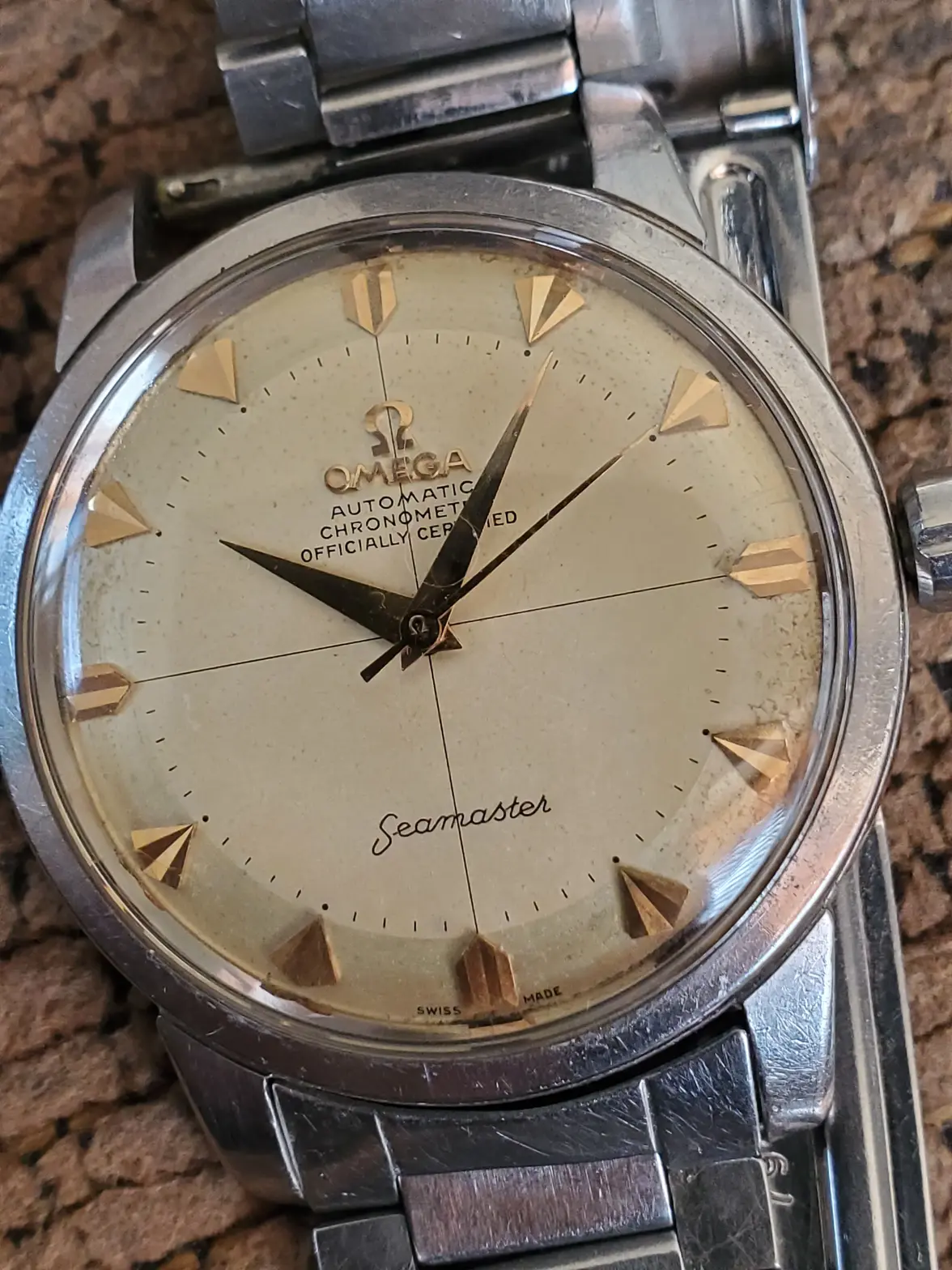

I’d agree dial seems original from that pic but clearly has ageing so not a top example. Probably £600-700 value wise.

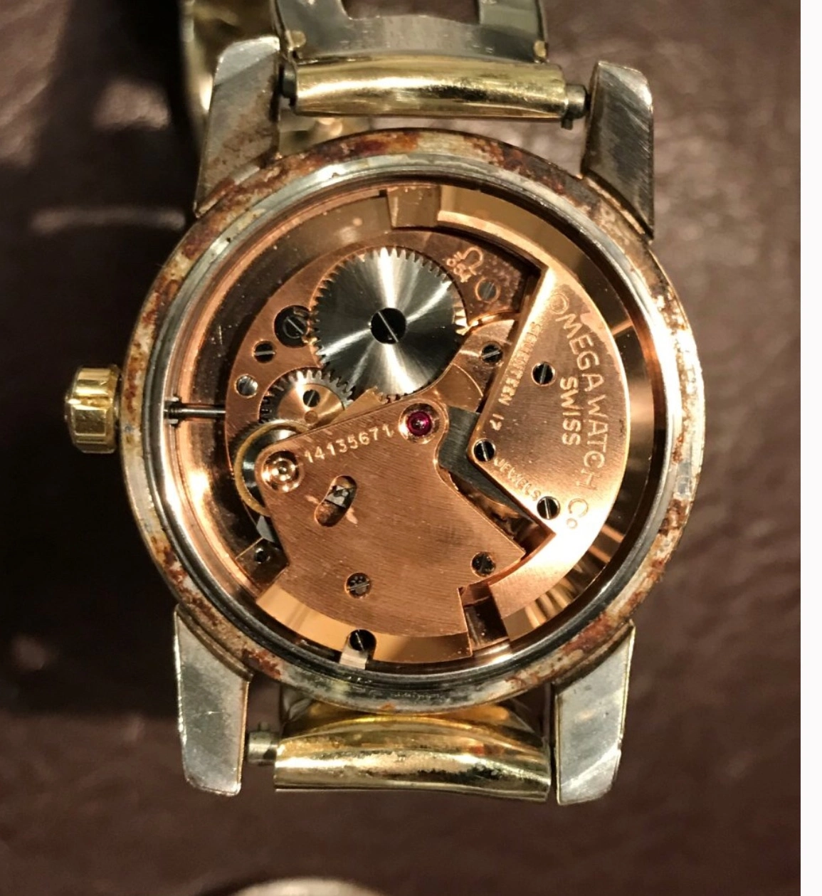

I think it would be more likely a calibre 354 or maybe even 352

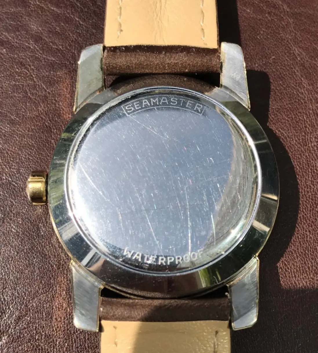

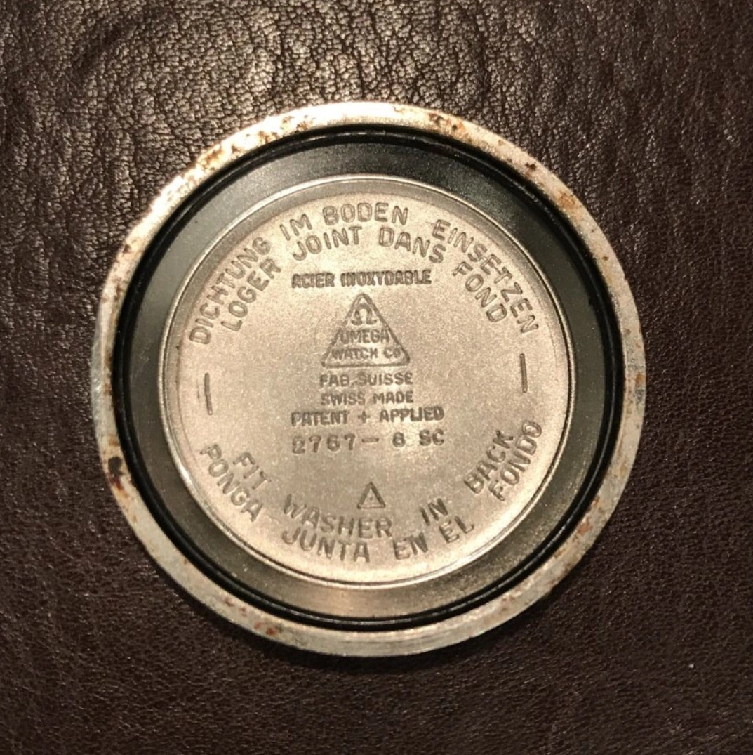

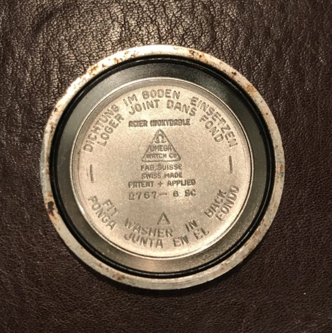

It won’t be a 2577 as those have a screw on back but there was a bumper model with a press on back whose number I forget. 2767 maybe. Or it’s a later 50x model like the 2846. My money is on 2767

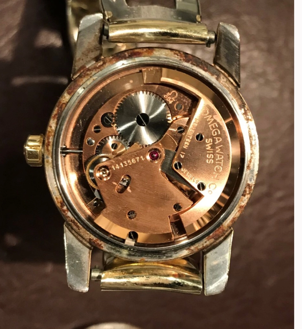

yes, most likely ref 2767 with cal 354 👍
Ah, good point I agree 2767.

Have a 354 movement on the bench so my initial reaction is a bumper and that would be the one.
