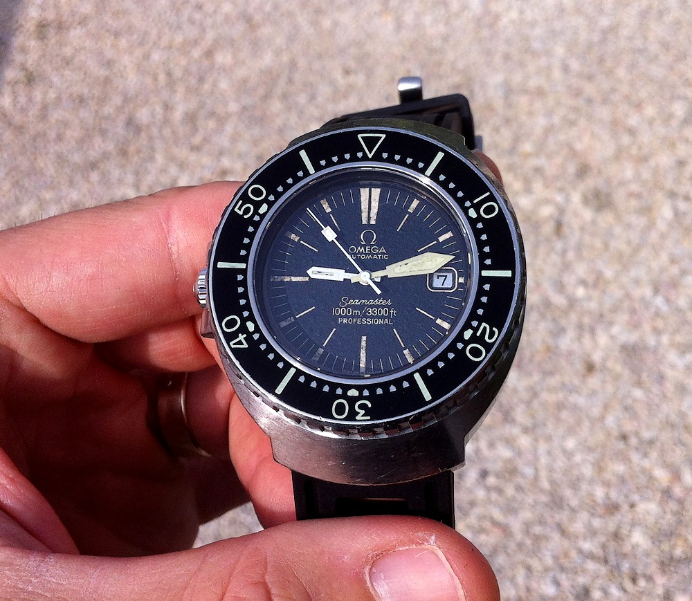

I am not sure if there were 2 different modells perhaps, starting in the early 70ies till the late 70ies.
The glowing time of the fluroscent material could be a hint. Is it possible to charge the tritium hands?
I had an NOS Fortis with tritium hands, it was possible to charge them because they not only used tritium
but also a fluroscent helping material like luminova, the hands glowed pretty strong but only for a Minute or two.
Is it possible to charge the old Omega tritium hands? On the other hand I couldn`t charge the hands and dial of my
vintage Daytona, no glow at all.

[...] Is it possible to charge the tritium hands?
Yes you can "charge" old tritium hands. Tritium (as well as Radium) was just the fuel that triggered the actual luminous material to glow (radioluminosity).
But in most cases the luminous material can still be activated by light, although this only lasts for a few seconds or minutes.
My 70+ year old Glashütte Tutima (with radium dial) also still glows for about 30 seconds after being exposed to bright light.

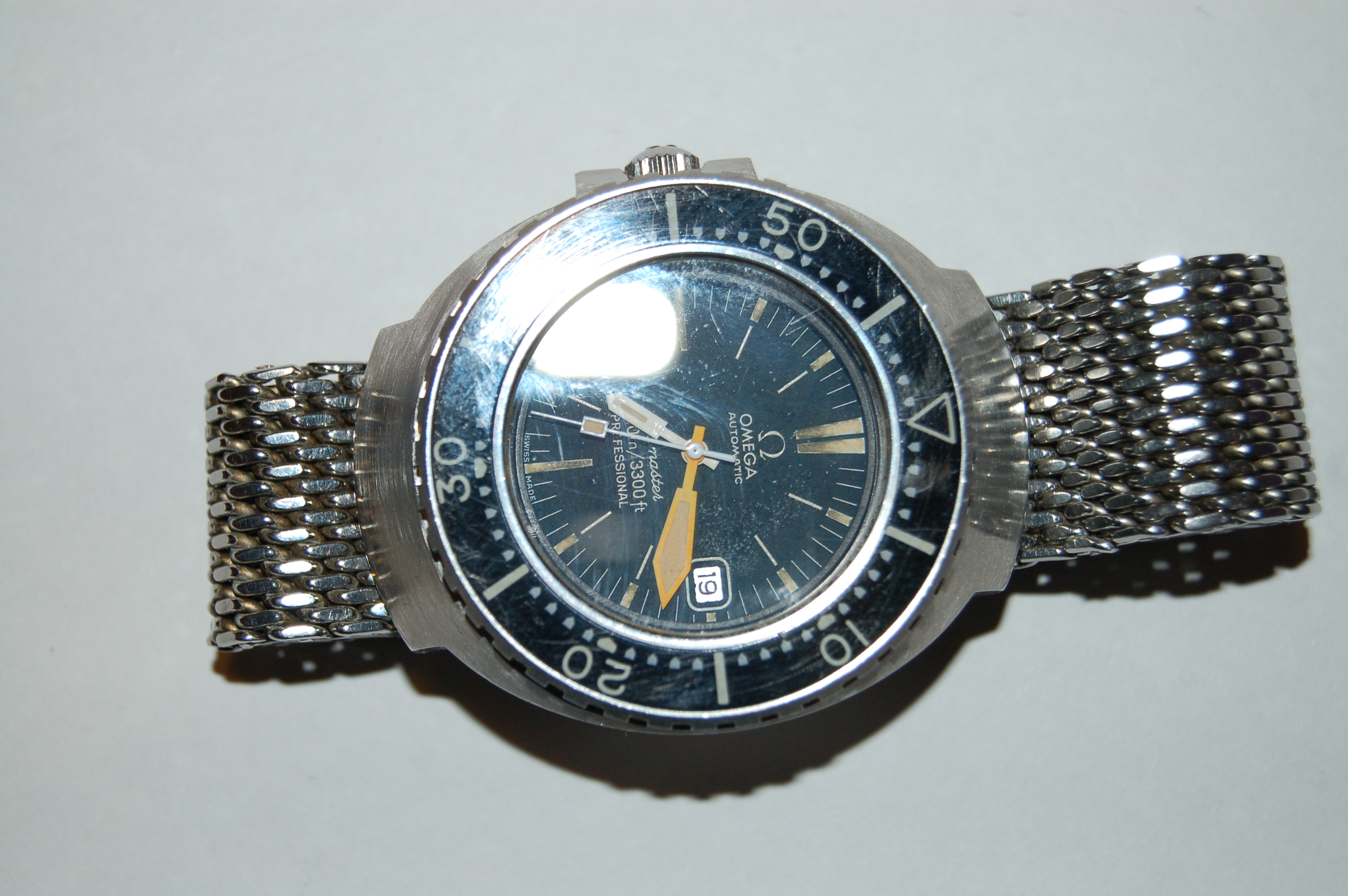

Are there any service dials known with split indexes? I thought replacement dials have only one index per 5
minutes...
Maybe the easiest way would be writing a friendly message to watchco Australia, they should know if that
is a service work or maybe even came from themselves.

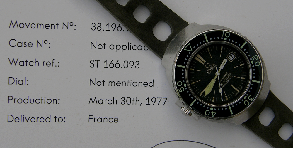

Here's my watch, bought from the grandson of the first owner here in the South of France.
The Extract from the Records conforming delivery to France in 1977

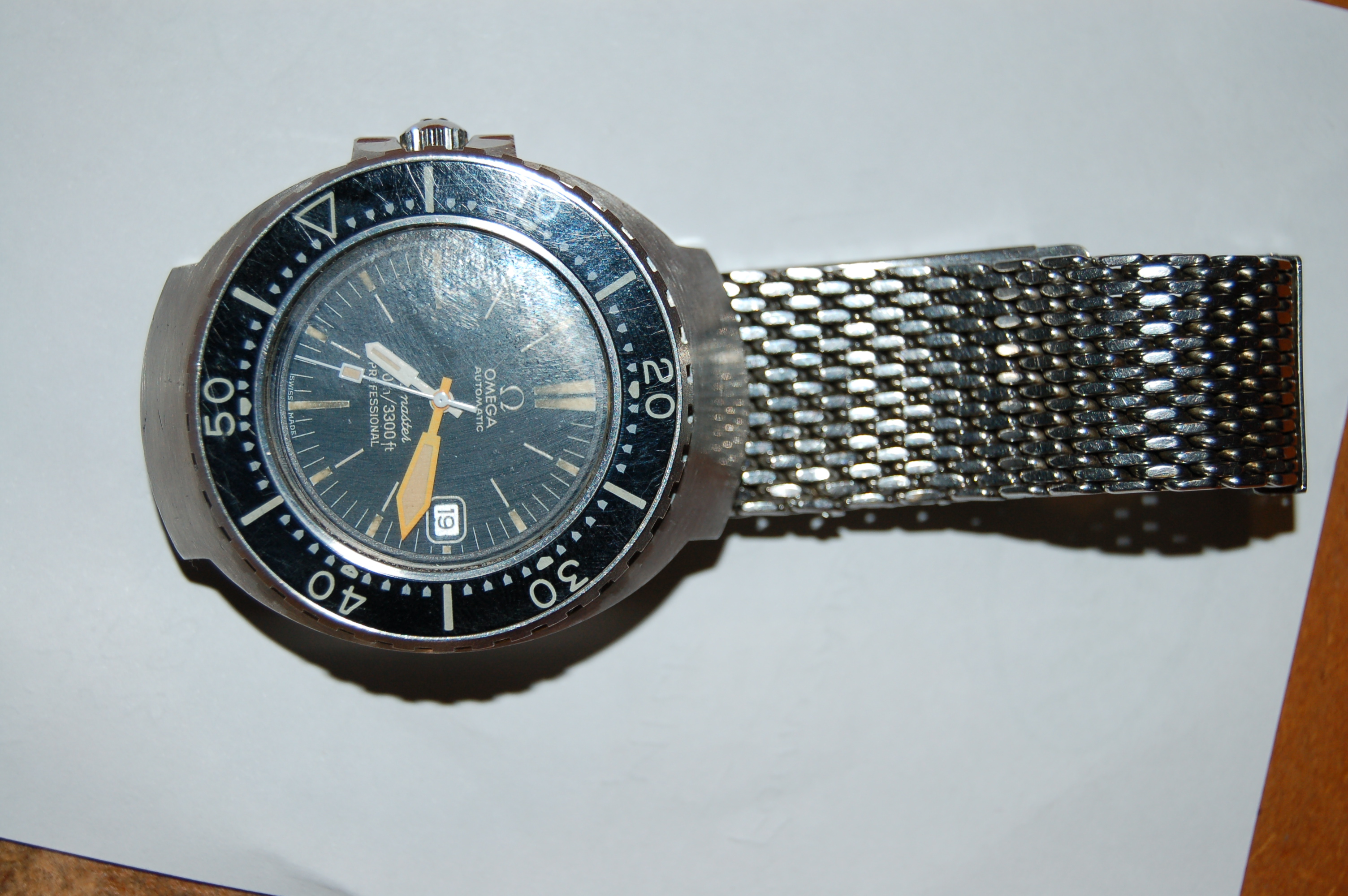

minutes...
Yes there are service dials which look like the original one and there are the ones that have the small indices at 12 o clock.
I bought one of same dial you have from watchco some years ago and thats how it looks like, except for
the hands everything is service parts on this watch, thats why i sold it to finance the one which comes next
image-jpg.21097
That is exactly how the watch should look like.

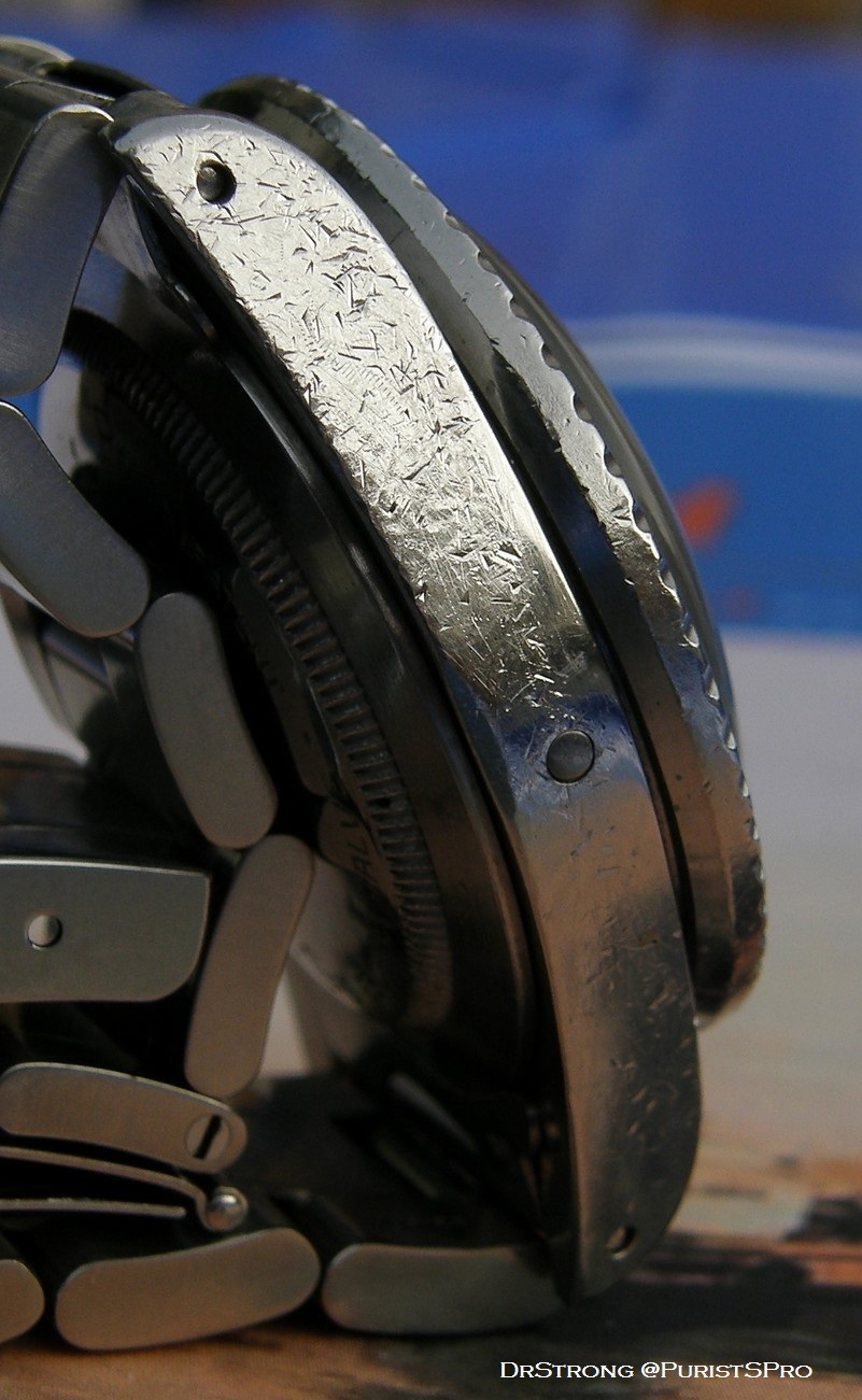

62
58
Give to me
unpolished with scratches, dings and dongs but please not thin, round, shiny.

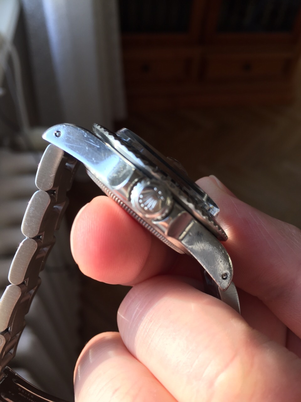

Here's the case of my Rolex 1665 Comex.
Is that enough dings ?
1,634
1,125
Have you been using it to open beer bottles for thirty years?
35
57
The large bruise at the bottom would be to much for me to justify a premium price.
My 1680 unpolished:

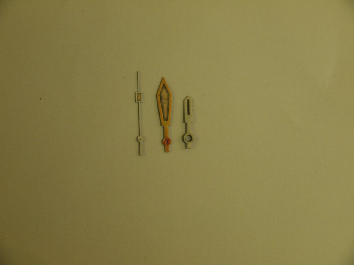

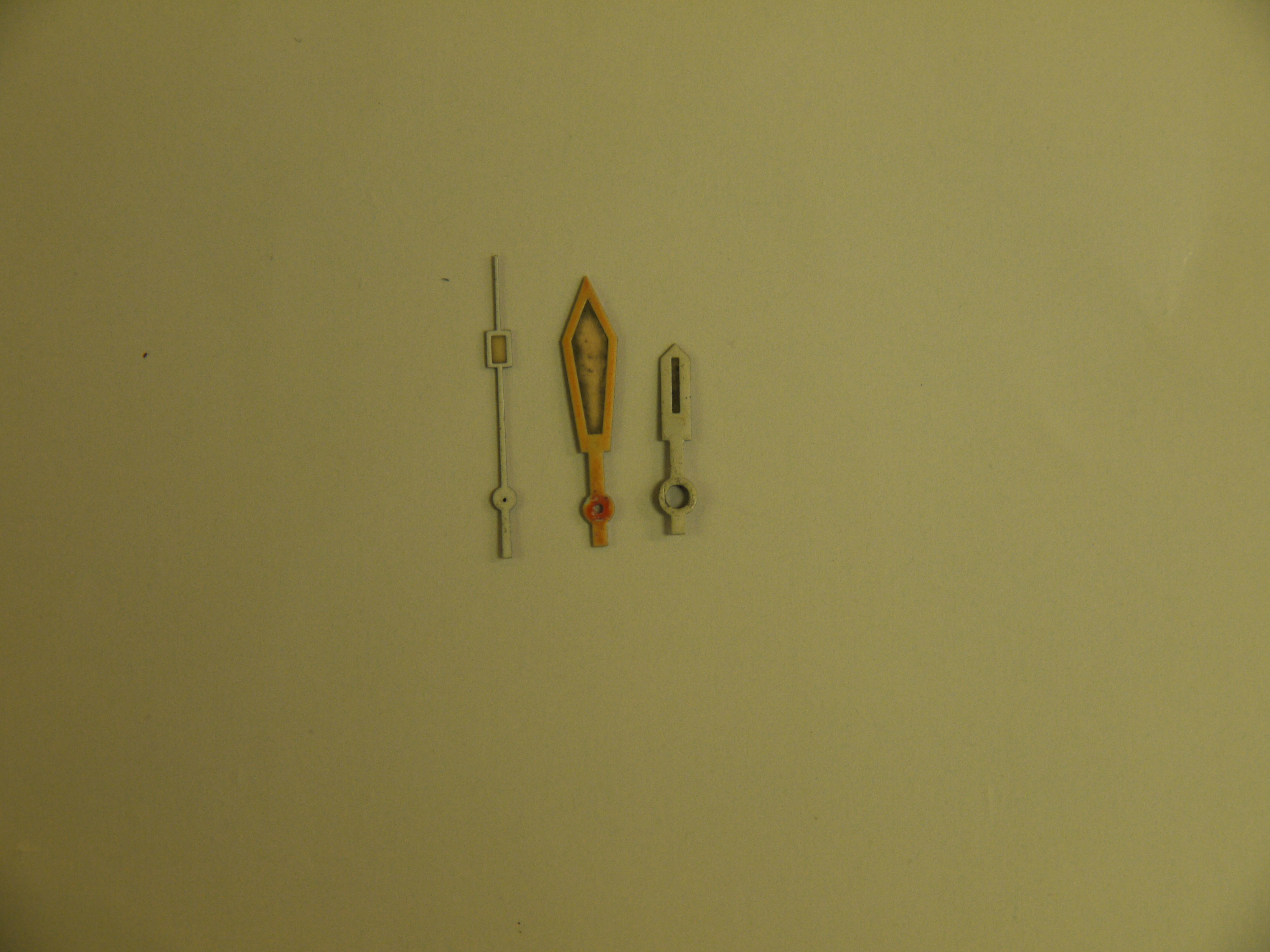

I have found some original Seamaster 1000/ Seamster 600 hands - is there a way for me to offer it in the sales corner?
It says, I don't have enough privileges...
